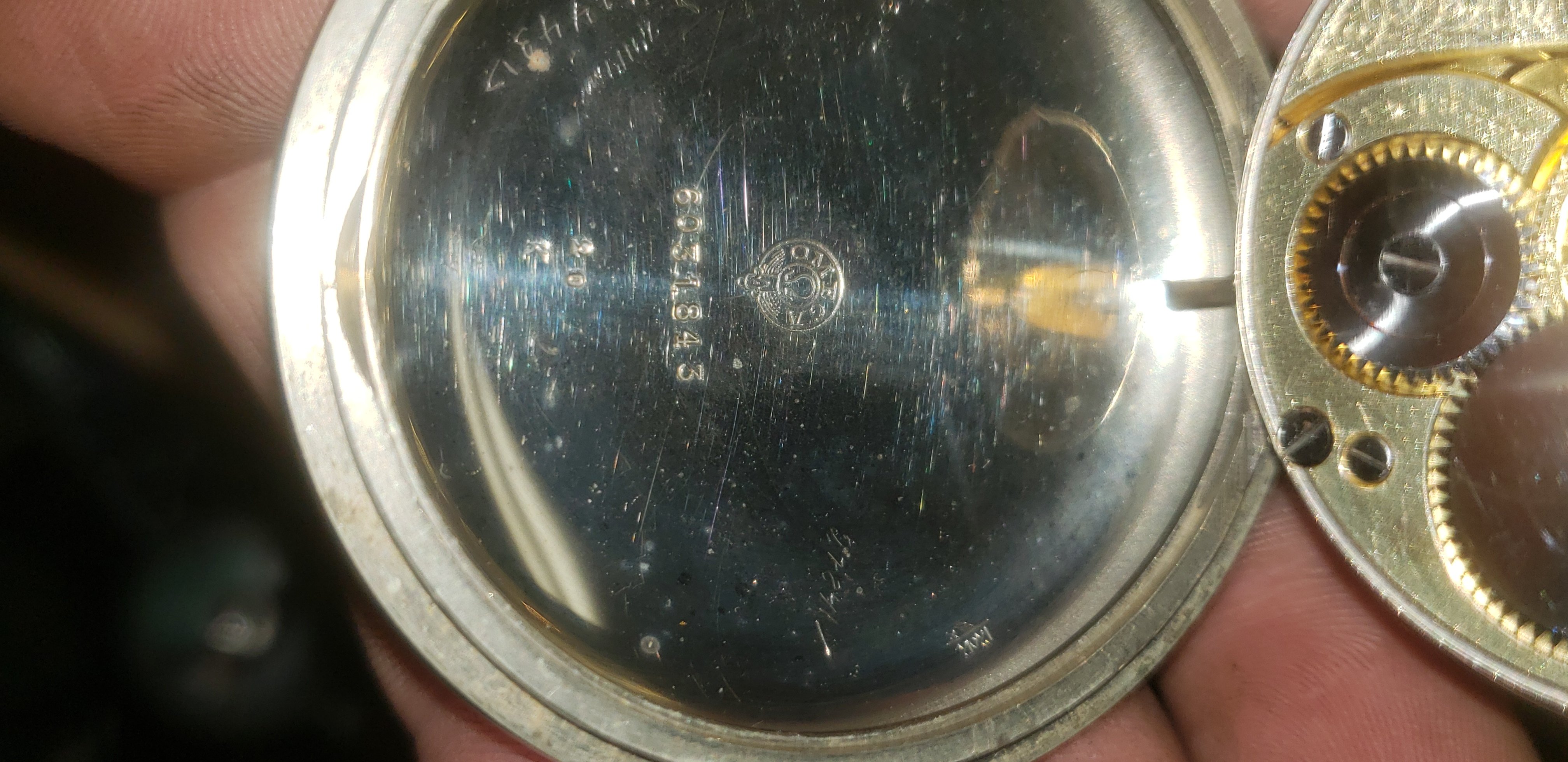

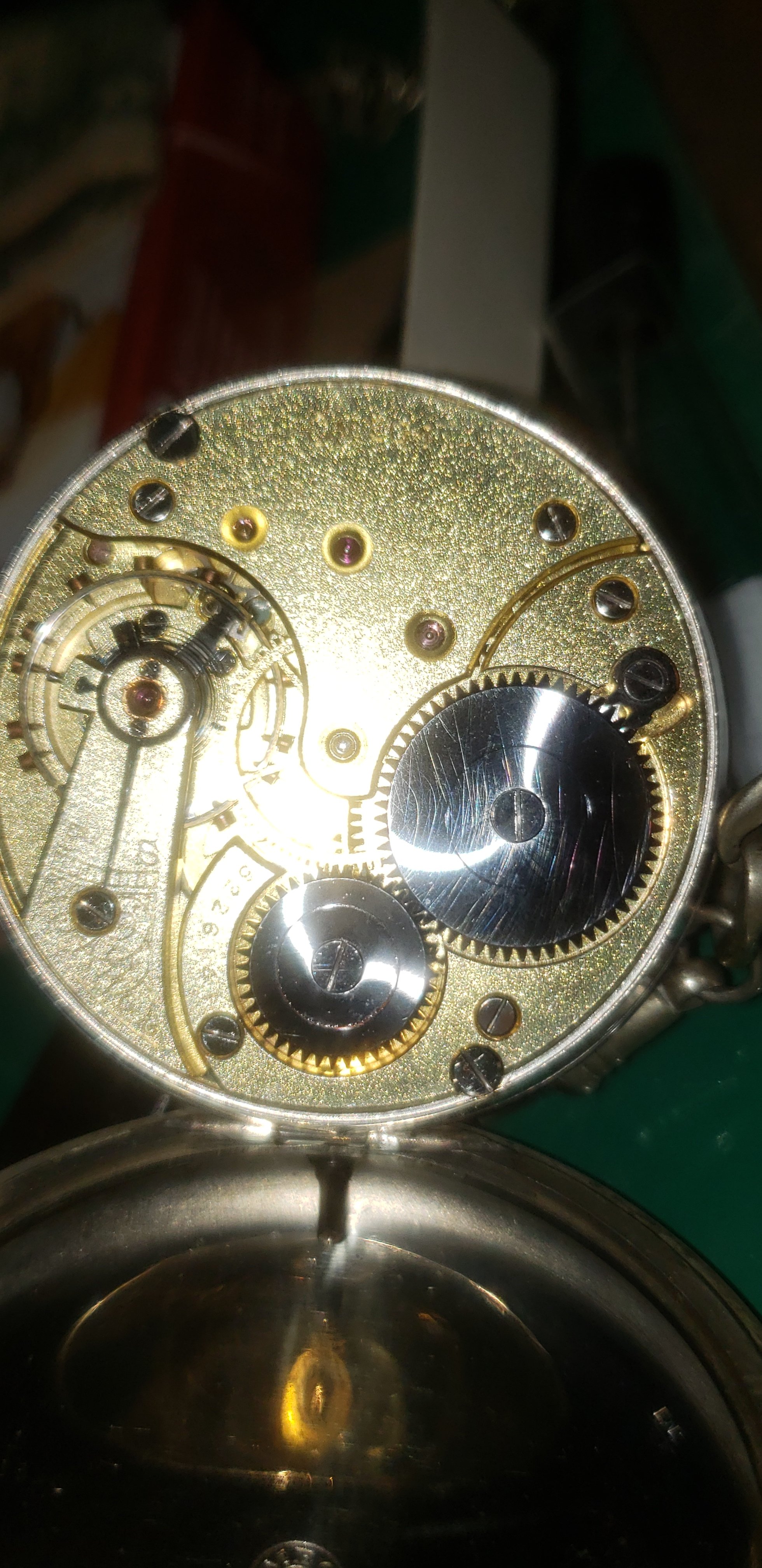

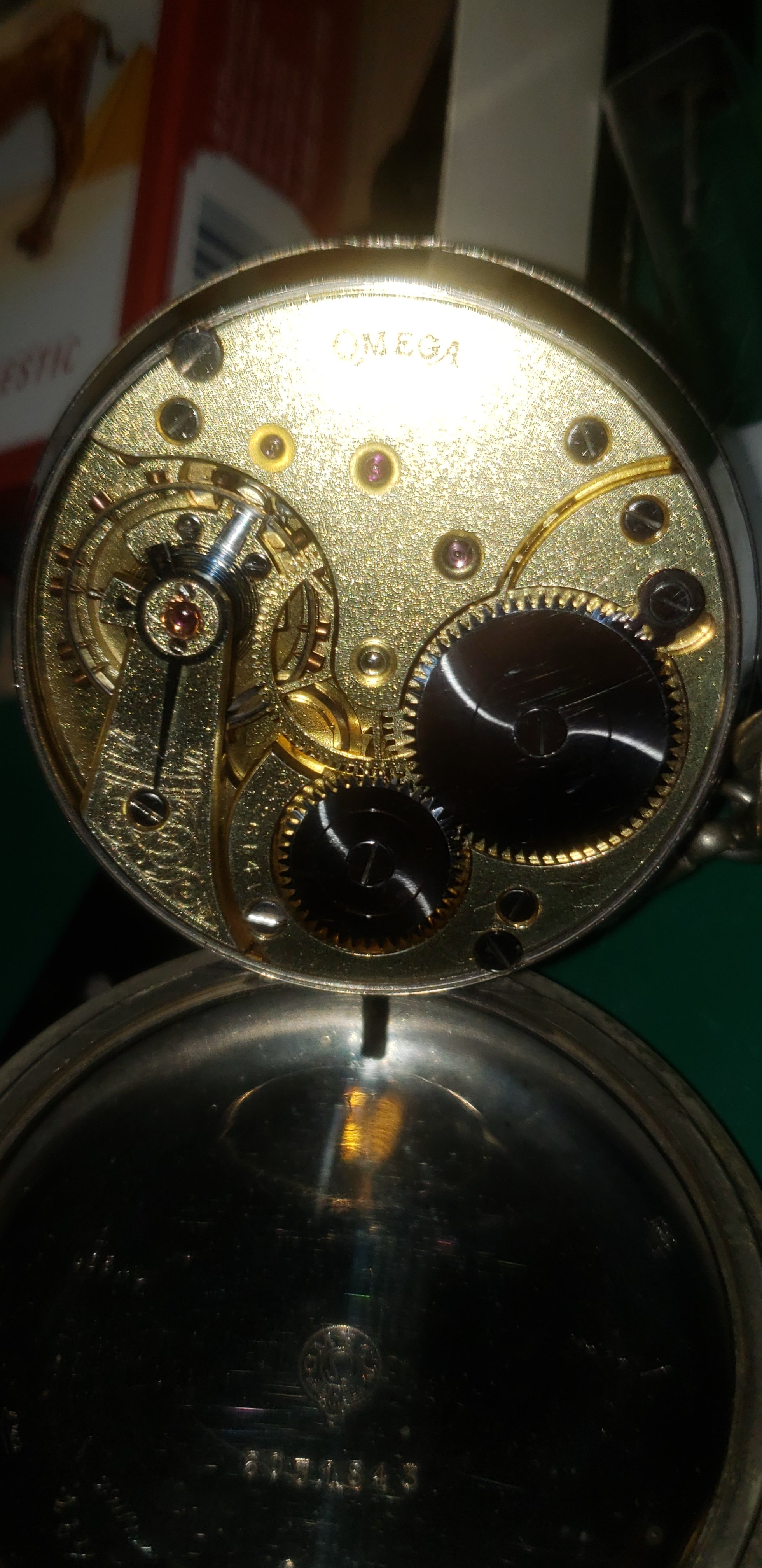

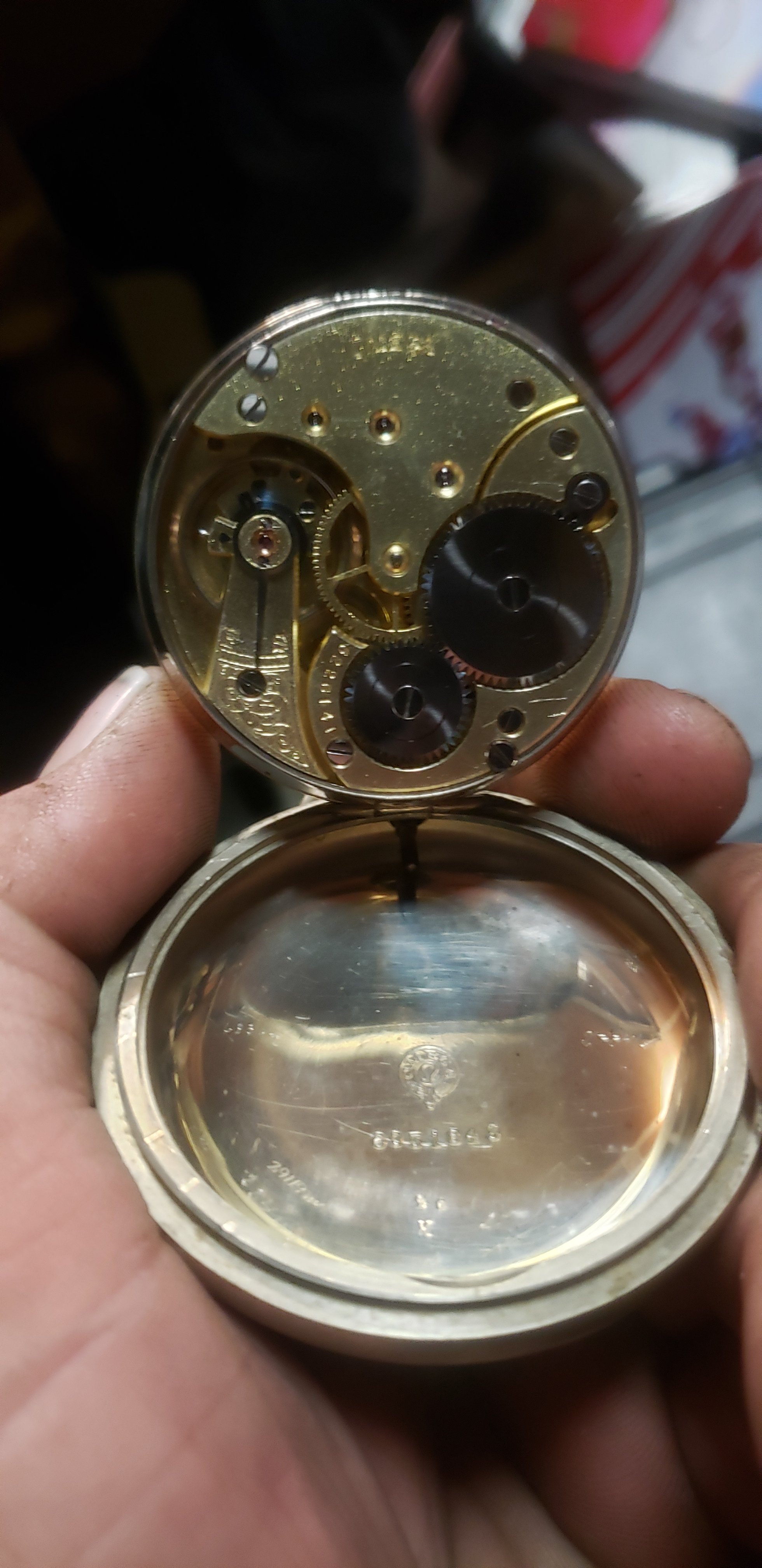

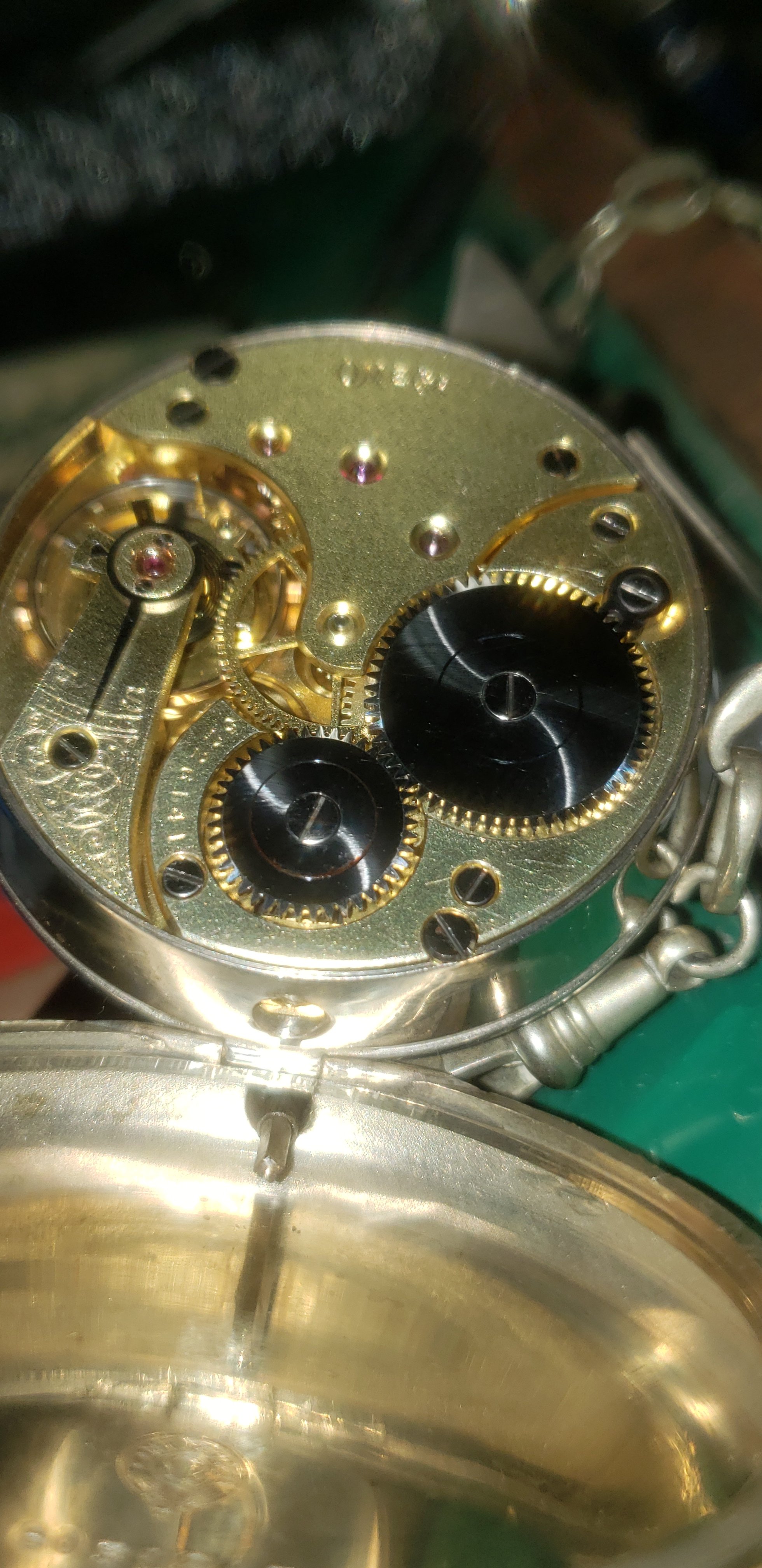

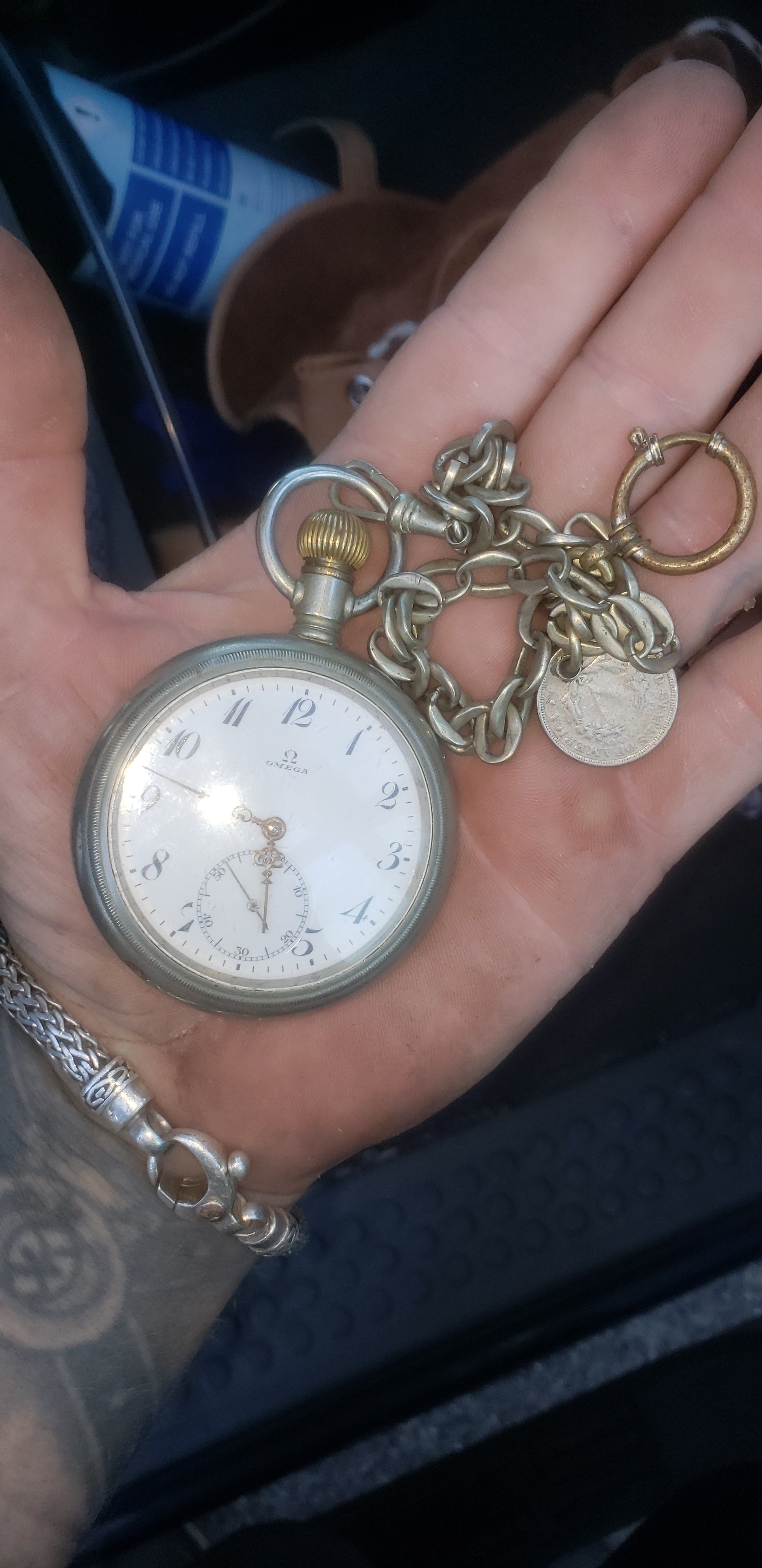

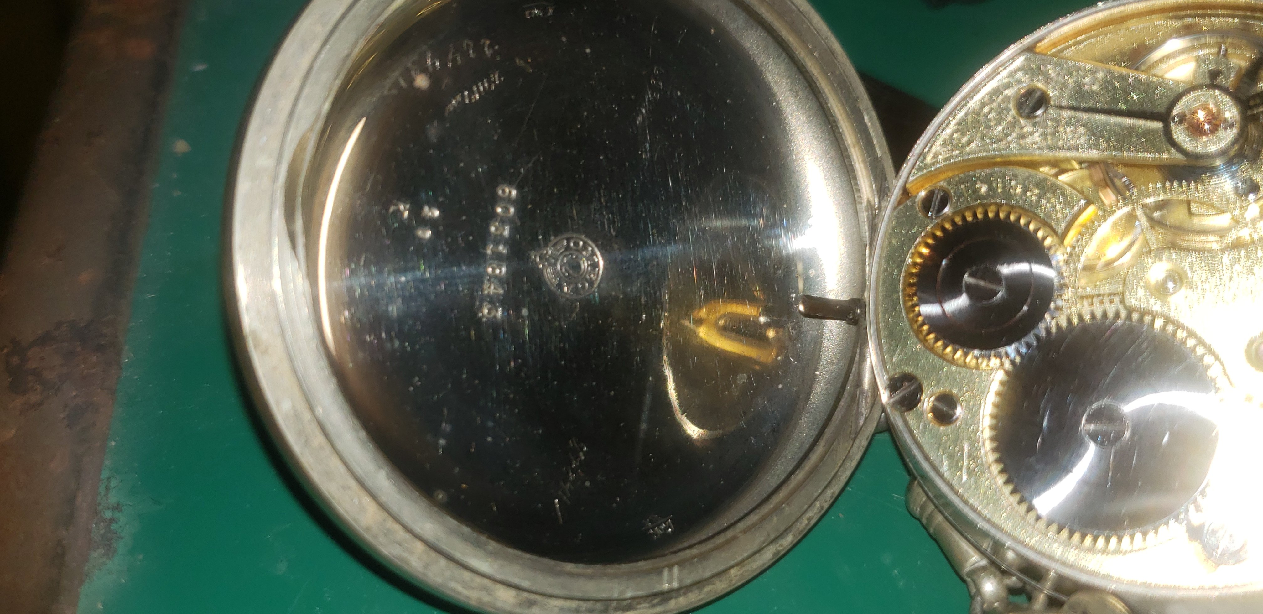

Inherited a cool omega. I think I have it dated to 1918 but am I right and what model is it? Planing on keeping it since its just my style and came from fam but would like to know as much as possible. Thnx!

Welcome to the forum. Could you provide better quality pictures and update the thread title to include Omega pocket watch?

There’s not that many pocket watch fans around just because they’re a bit out of style these days but that one does look like it has an uncracked dial which is nice and in decent shape. If you get it serviced it should actually keep quite good time, I’d just go to a local independent watchmaker not to Omega, and probably get it polished too if you like that, then enjoy it.

I love them. This one came from a death in the family so has an extra bit to it sadly. Works great, totaly matches the image hanging in my hotrod as THE clock in that car. But I'd like to know if it has a model name. To me its an important fact in the story, and I am into stories, as anyone who knows me and is annoyed by my telling of them could attest to lol. Even knowing what models were produced in 1918 would help. I could Google it, but Google is notoriously inaccurate. Figured ask here

For better photos, try to avoid direct lighting and use natural daylight, near a window with soft light maybe. If you can, provide macro pics of the serial number on the case and movement, as well as pics of what I suspect are hallmarks.
Providing the diameter of the main plate (in millimetres) will also assist in identifying the exact movement.
Omega pocket watches at the time (early 20th century) didn't have model names like current editions (Seamaster etc). They were simply a "Gents Omega Lépine watch" or similar for Hunter cased (Savonnette) models.

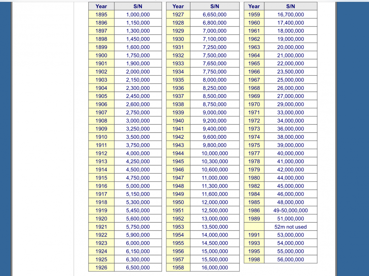

As already noted, the watch has no model number. However, with better photos of the movement (high resolution, in focus, with better lighting), we might be able to identify the movement caliber. However, to be honest, it's not likely to mean much to you, it would just be an identifier for the mechanical movement inside. The numbers on the movement can be used to estimate the year of production using a chart. The movement caliber and approximate year of production is all the information you're likely to get.
1,610
6,045
Serial number looks starting with 622 to me, so it could be from 1924
