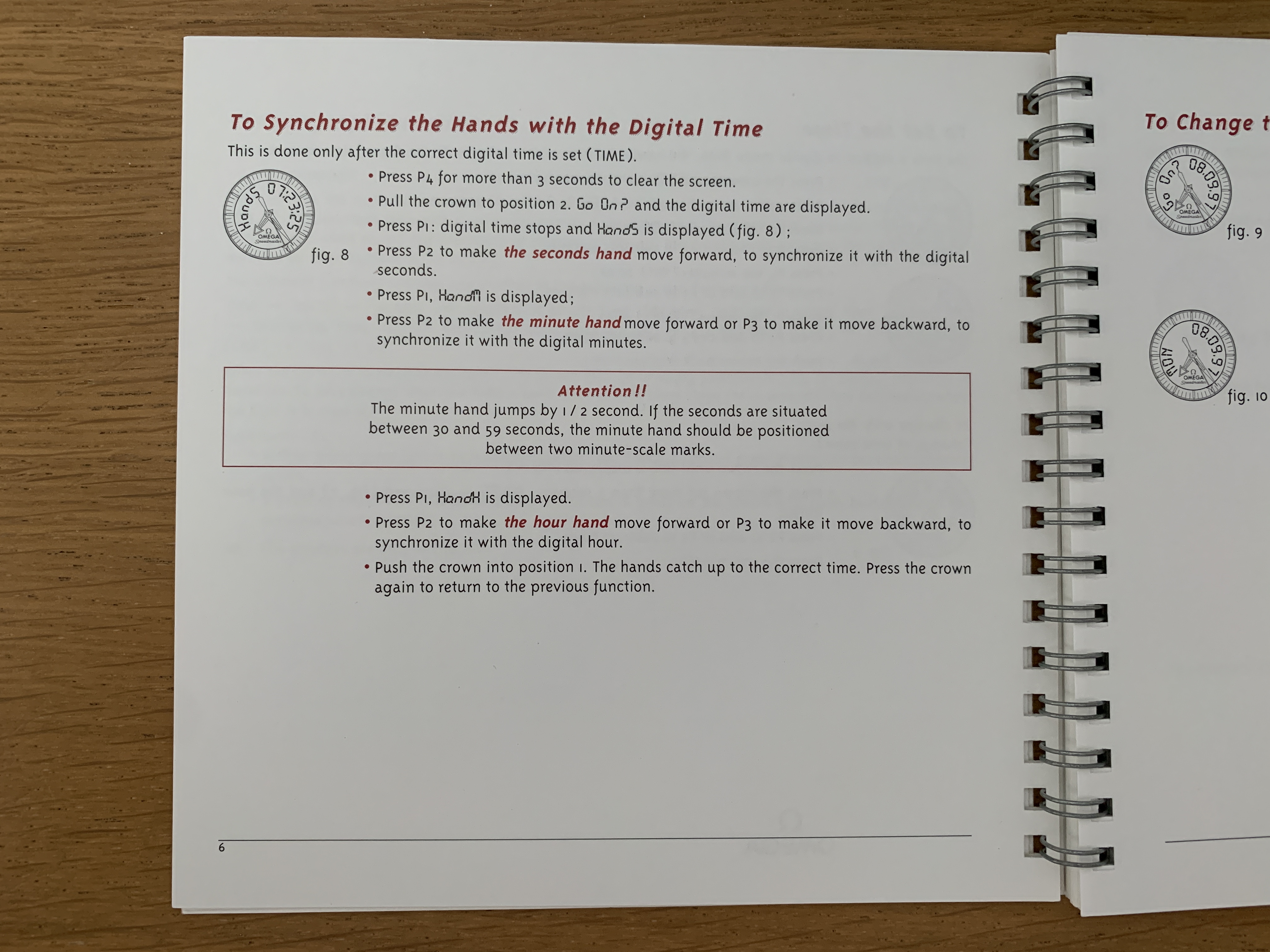

Do you know if this procedure is the same for the X-33 first Gen?

The gen 1/2 modules don’t have power saving mode - think that’s unique to the Skywalker. 👍
The only part in the gen 1/2 manual that talks about hands is this:

Yes, thanks mate, I just dug out the manual and checked my photocopy of the manual. I also found a note that I had made (some years back) on the page: "set minute hand while seconds and minutes between 1 - 29 secs" and related to the highlighted Attention!! note.
