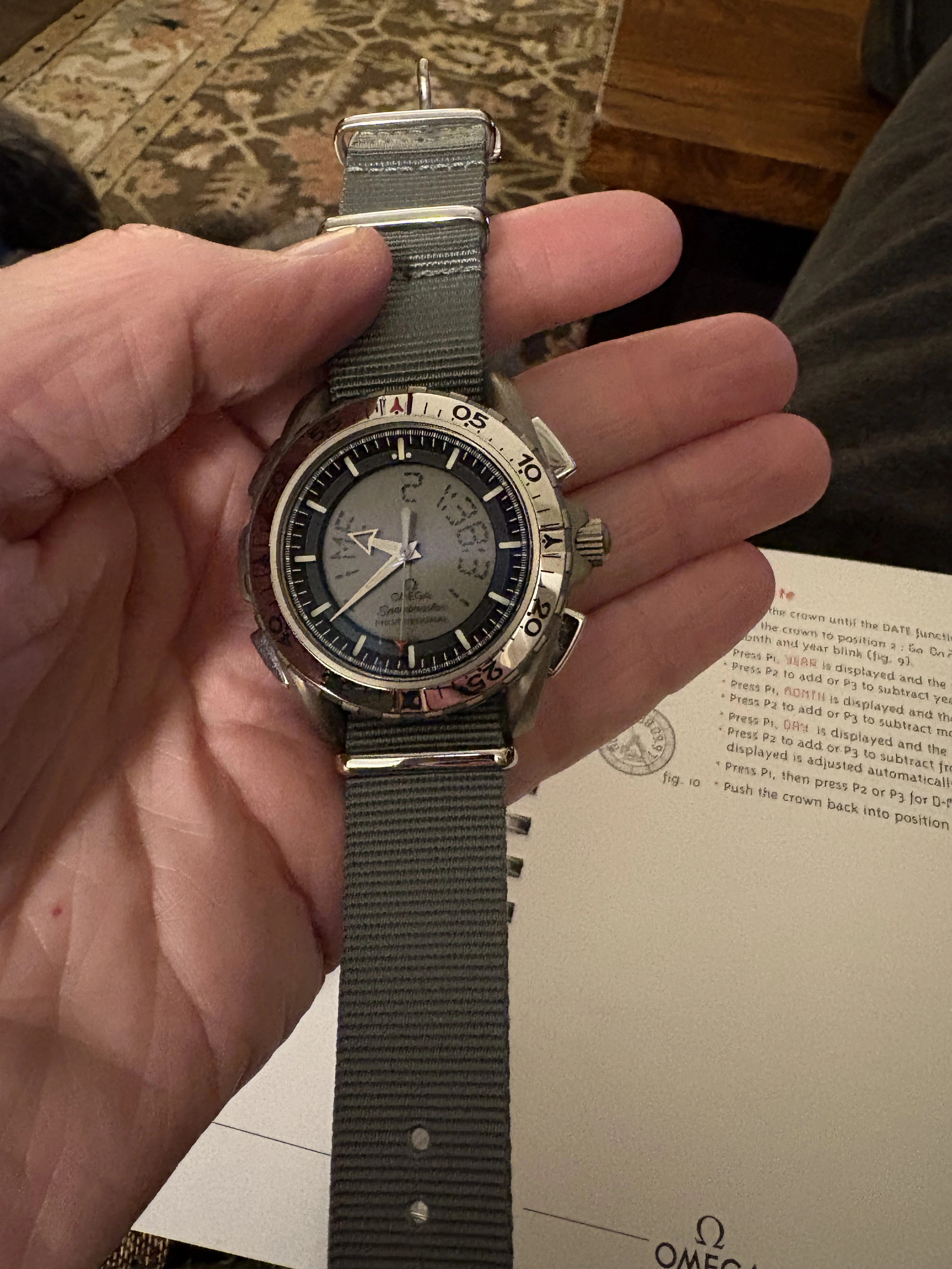

Hello - haven’t posted in a long time, but recently acquired a remarkable find in the form of a New Old Stock Gen 1 X-33. Yes, it was sitting in a local jeweler for 25 years! I’m really enjoying it, but it seems like they are quite fickle with batteries. The movement is obviously an original 1666, and I have experienced instances where the minute hand will stop for 10-15 minutes, then start up again, leaving the hands and digital readout out of sync. Have other Gen 1 owners experienced this, and has a new battery resolved? It has happened twice in about a month of ownership. Thanks! Battery is currently a Panasonic, but I do have a new Renata CR2320 available.

Congrats on finding one as NOS. Taken any photos of it yet?
