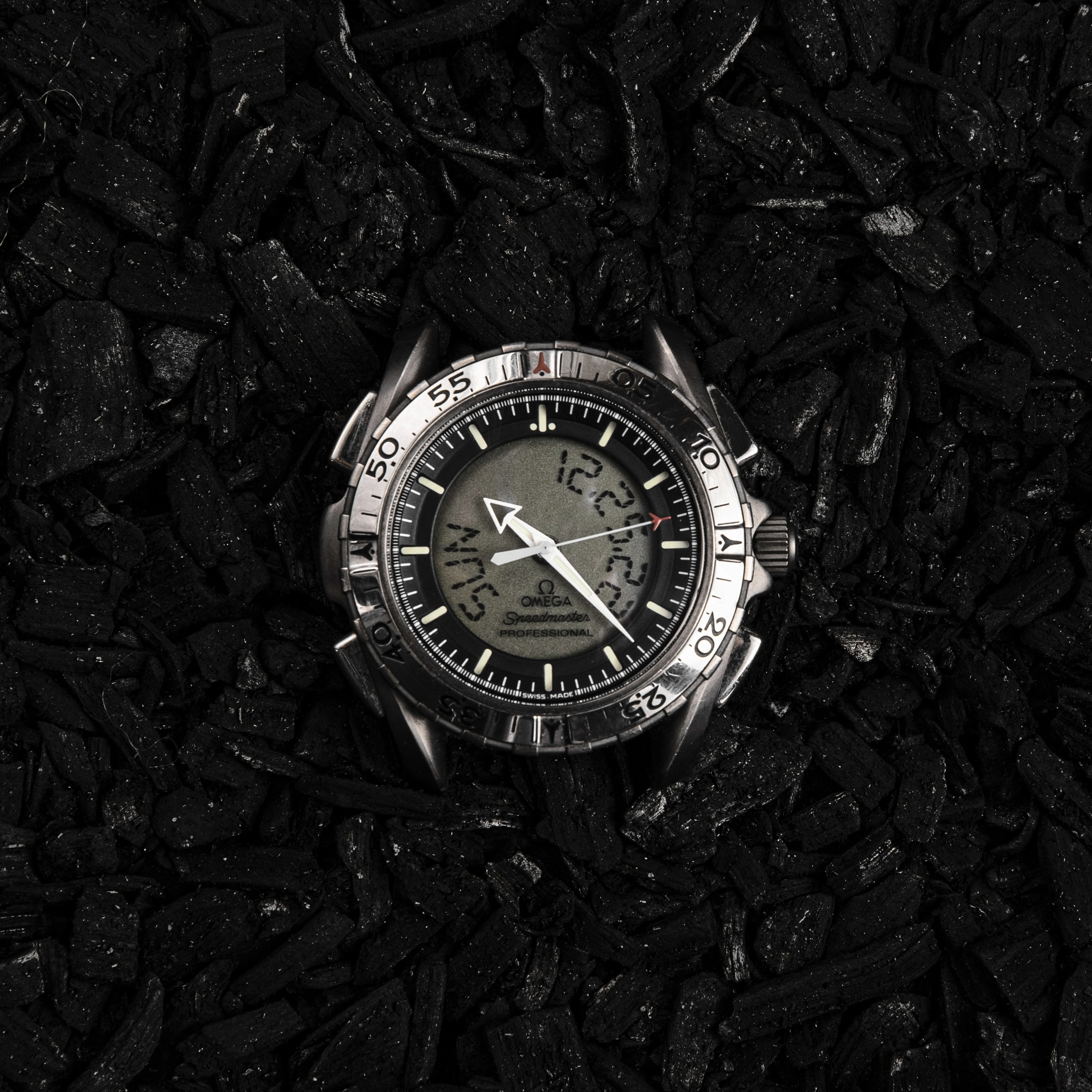

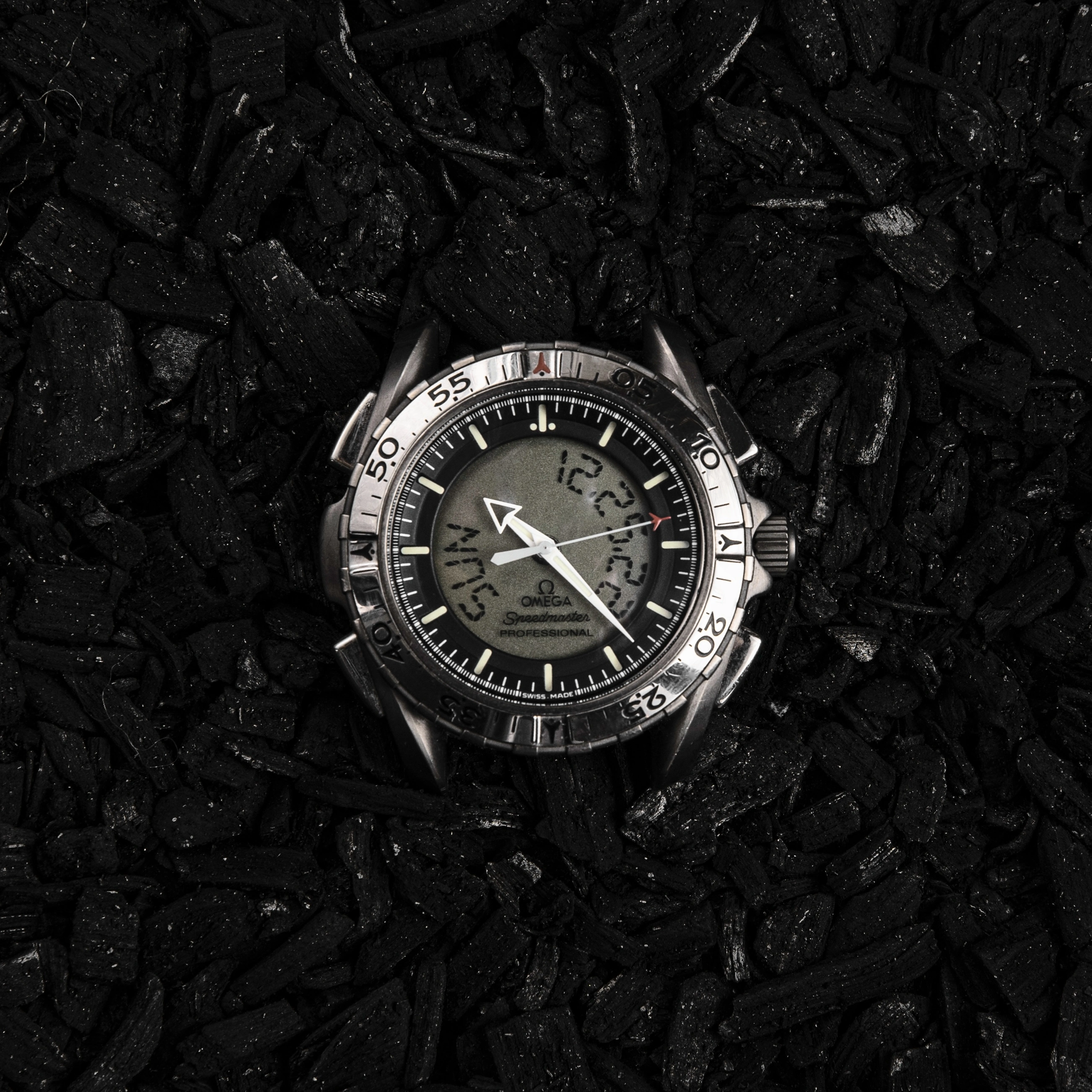

Recently bought a Gen 1 X-33 and while putting in a fresh battery I realized it is missing the dust cover. I wouldn’t be too bothered by this but I think the missing cover could be the reason the alarm isn’t making any sound. Everything but the sound is working.
If anyone has an idea on where I can find a replacement dust cover I would appreciate it!
