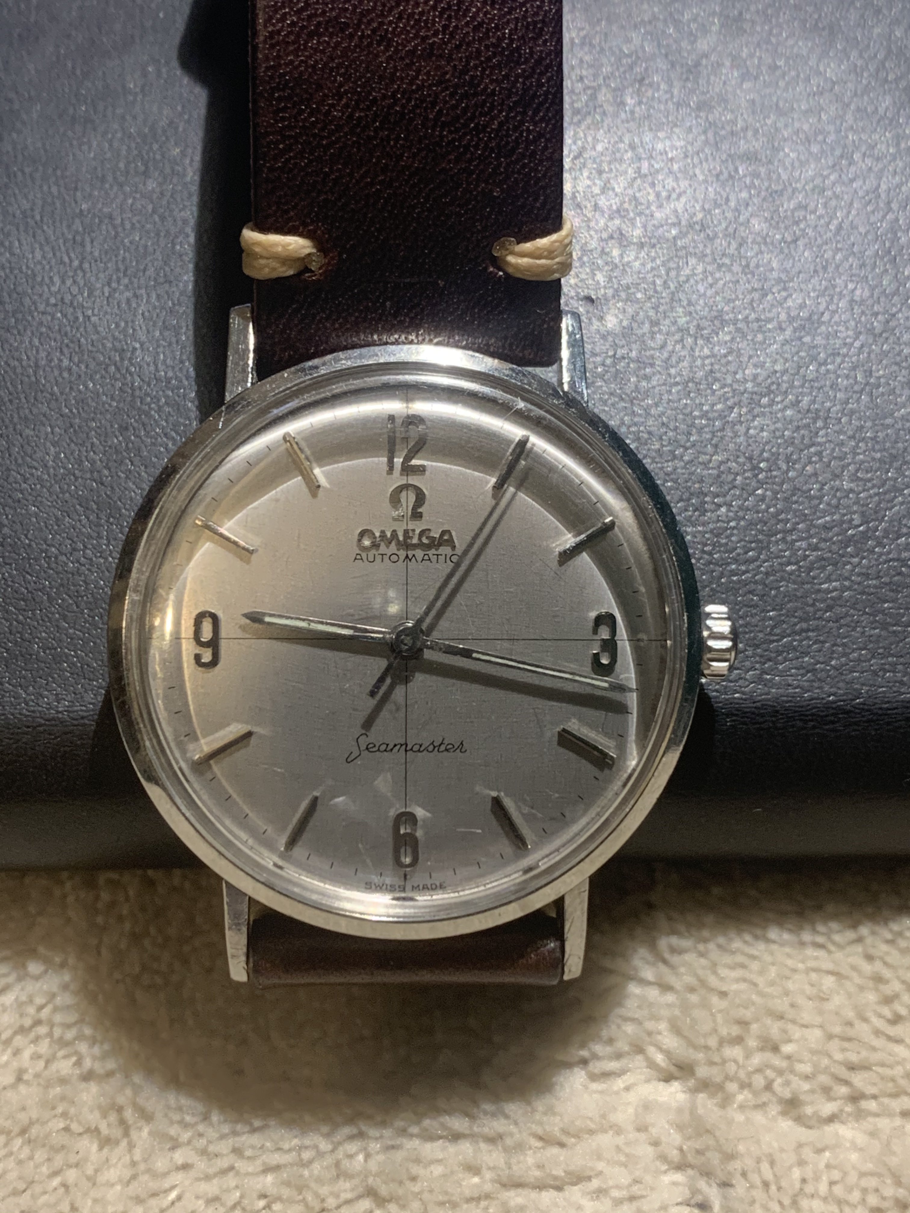

Any idea which endlinks would work?

I've had this watch a few years now, and I'd like to track down a bracelet for it. It's a front loader, and I'm not keen on opening it myself, so external pics are all I have. Been told it's an early 60's "pre-deville deville". As per the title, the issue is endlinks. Does anyone know which specific endlinks this watch would use, based solely on a photo?

Well, a leather strap is probably most appropriate, but if you want to try a bracelet, you could go with a 7-row BoR with curved 18mm end-links. So something like a 1037 or 1503 bracelet with #70 or #570 endlinks.
To double check, you would want to use Google images to search for similar watches with bracelets and check the endlinks.

Would you hazard a guess as to the caliber inside? 550? Is there a way to tell without opening it?
