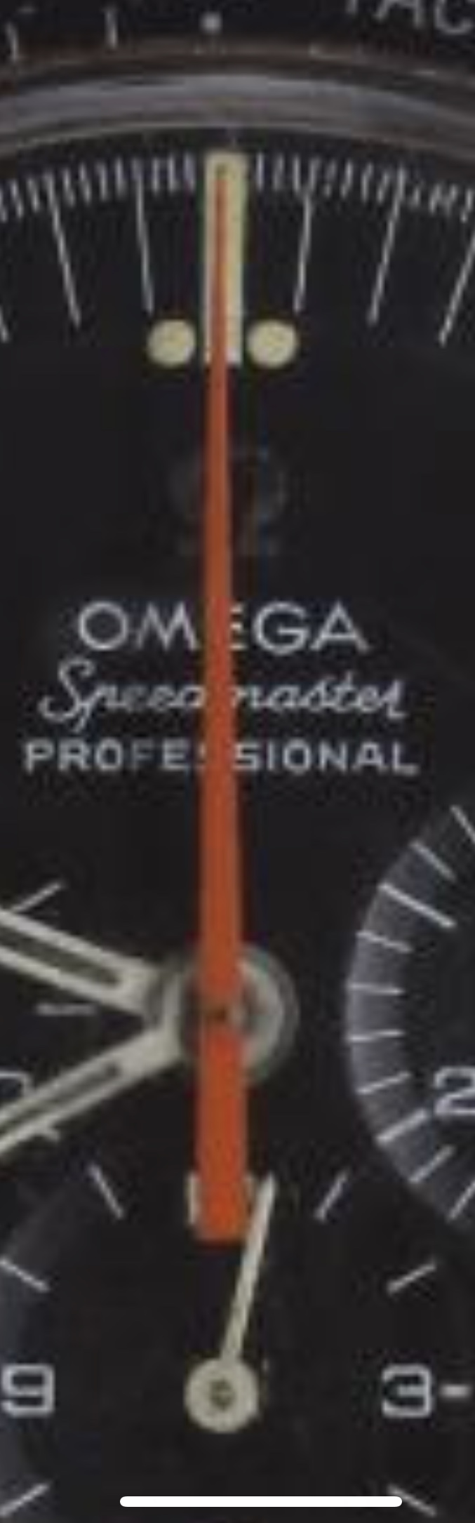

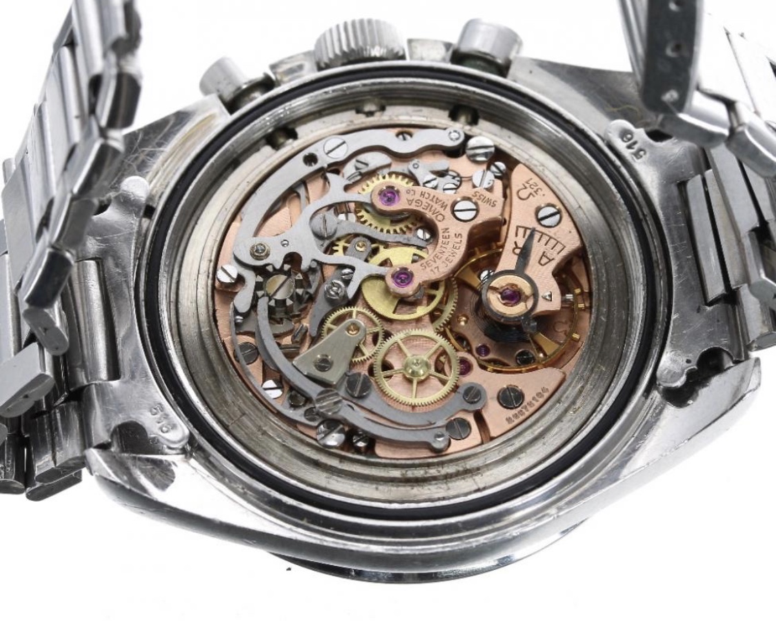

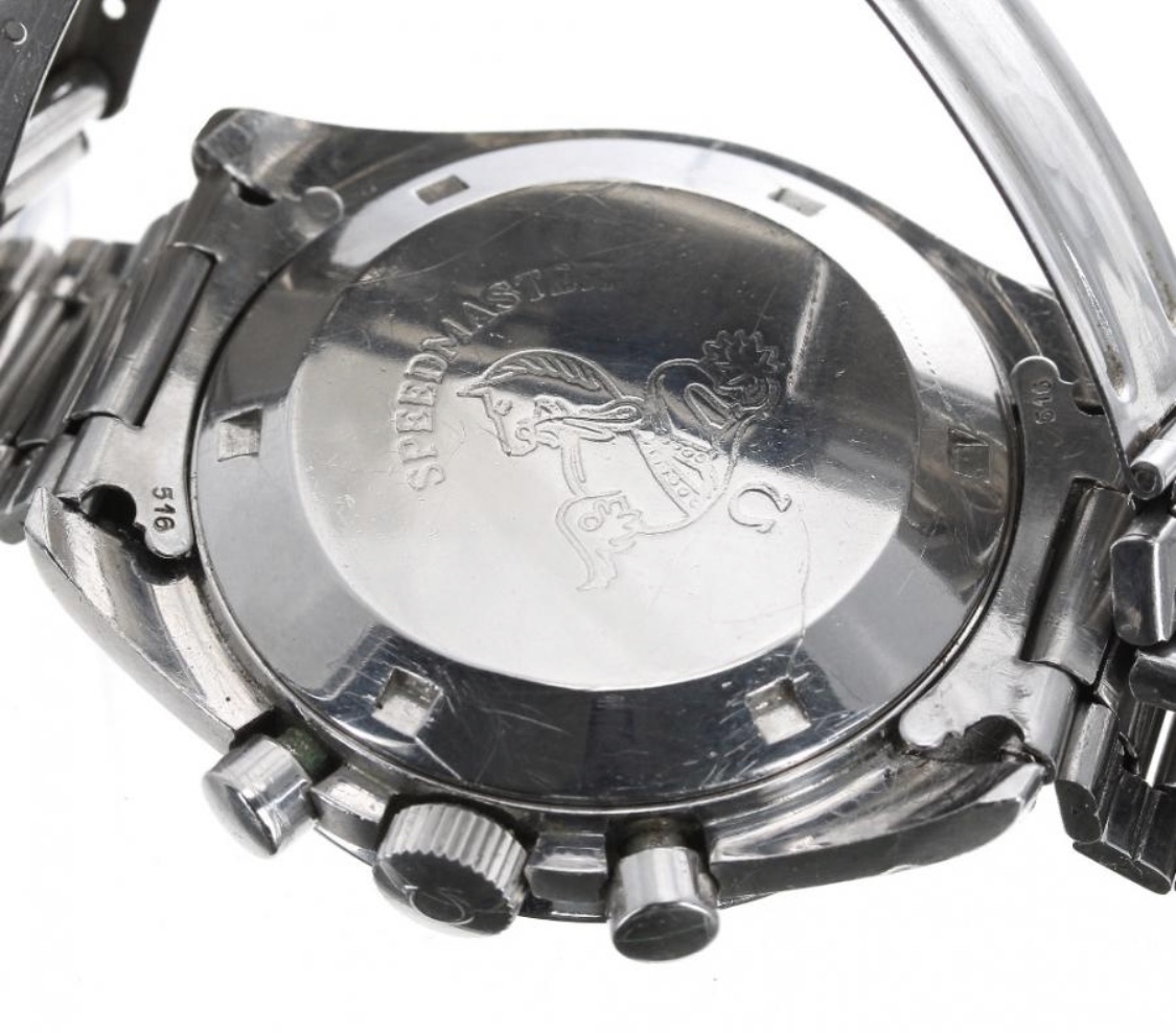

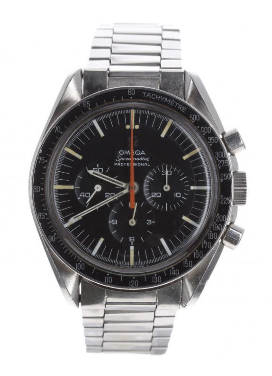

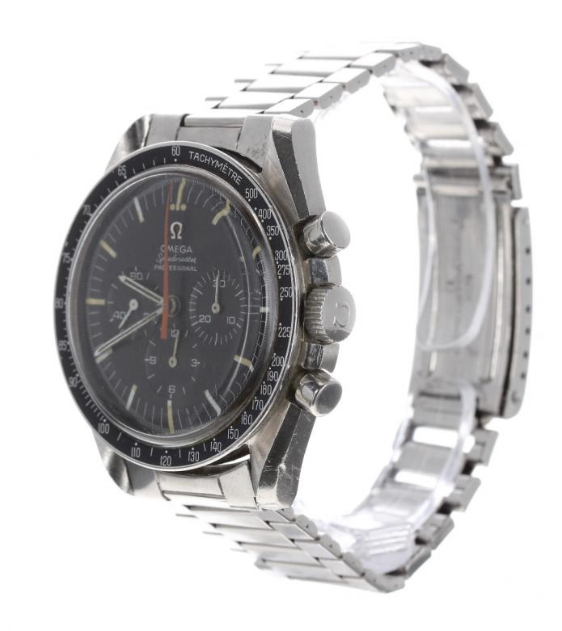

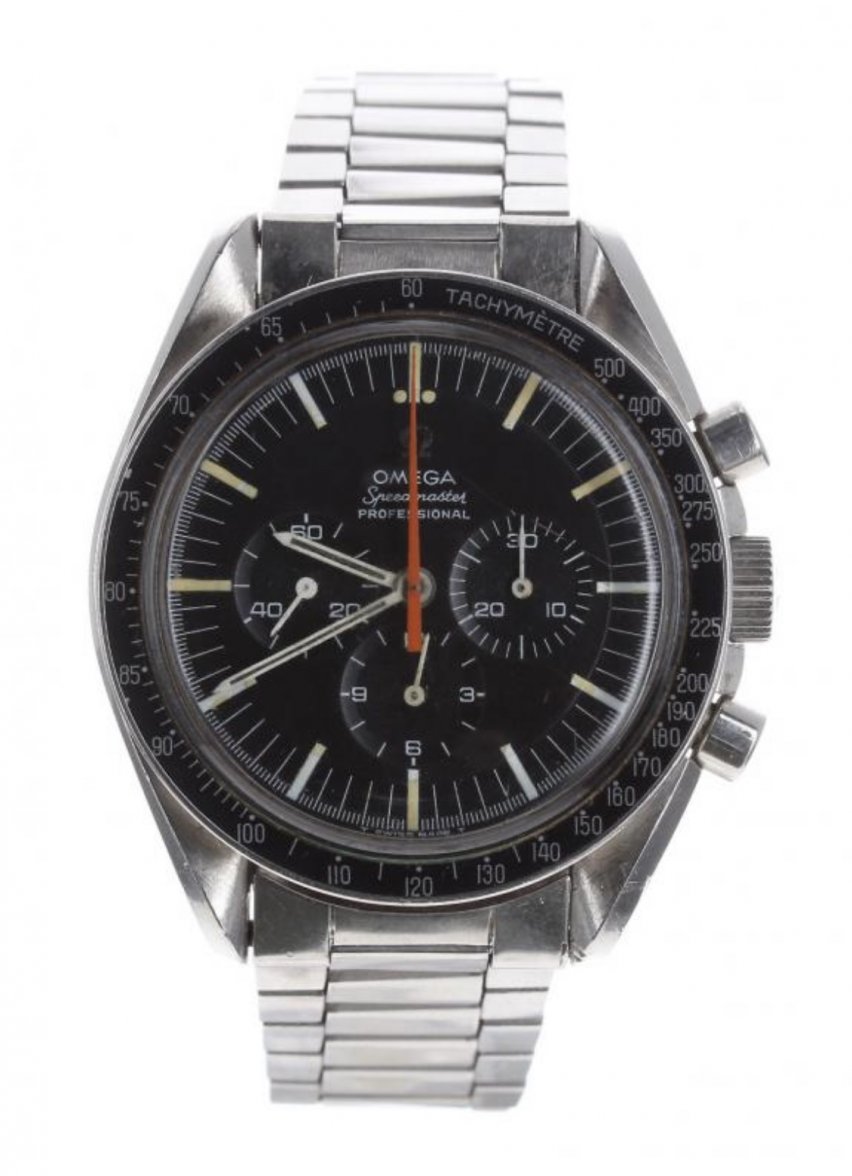

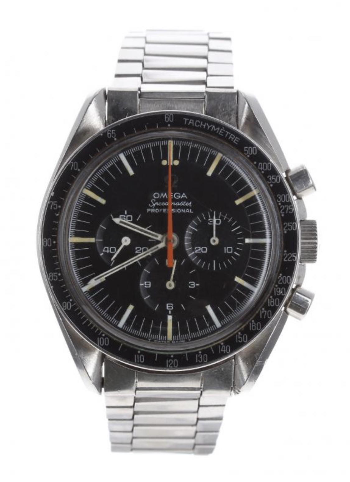

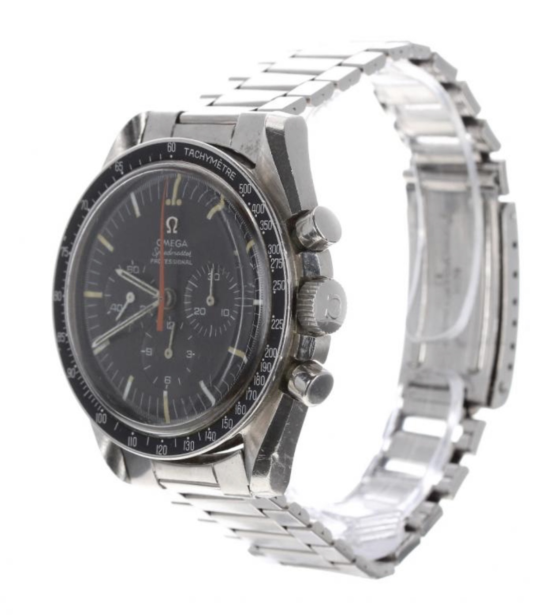

Hello all,
Posting for everyone’s consideration since I find topics on this model extremely educational, I hope it’s the same for other members (I am not related to the owner of the watch).
Especially when it comes to Ultramans coming up for public auctions rather than popping out of grandpa’s drawers (although this could well be one of the recent Ultramans posted in this very same forum..).
As I am not an expert at all I am just going to mention that the listing states serial is 2607xxx which may be in the correct range and the extract of archives confirming special second hand fitting is dated Oct 1st 2019 which means it was obtained through the new process whereby you have to submit a picture of the watch and hence validated by bienne.

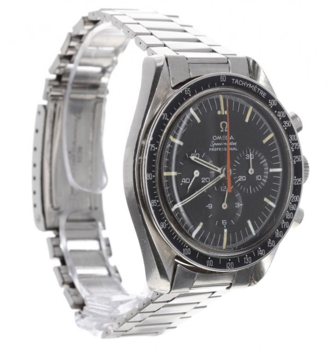

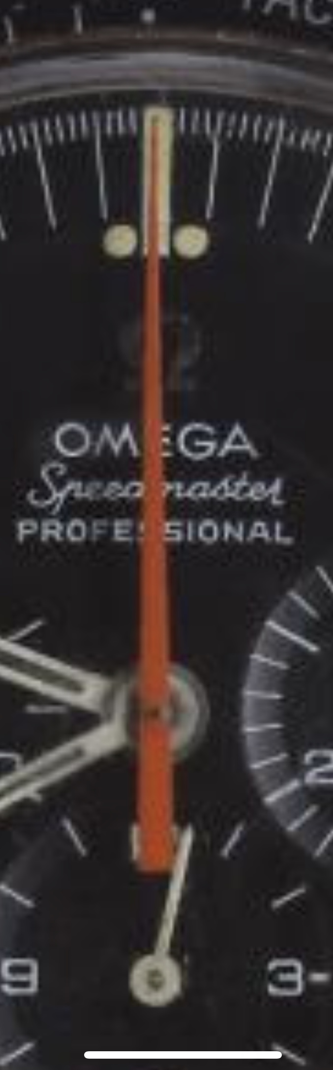

I am attaching some pictures, the main question mark relates to the second hand’s length, some members stated in previous posts that the hand should reach beyond the seconds track whilst this one seems shorter.
Any comment from the forum members is highly appreciated
thanks
Duccio

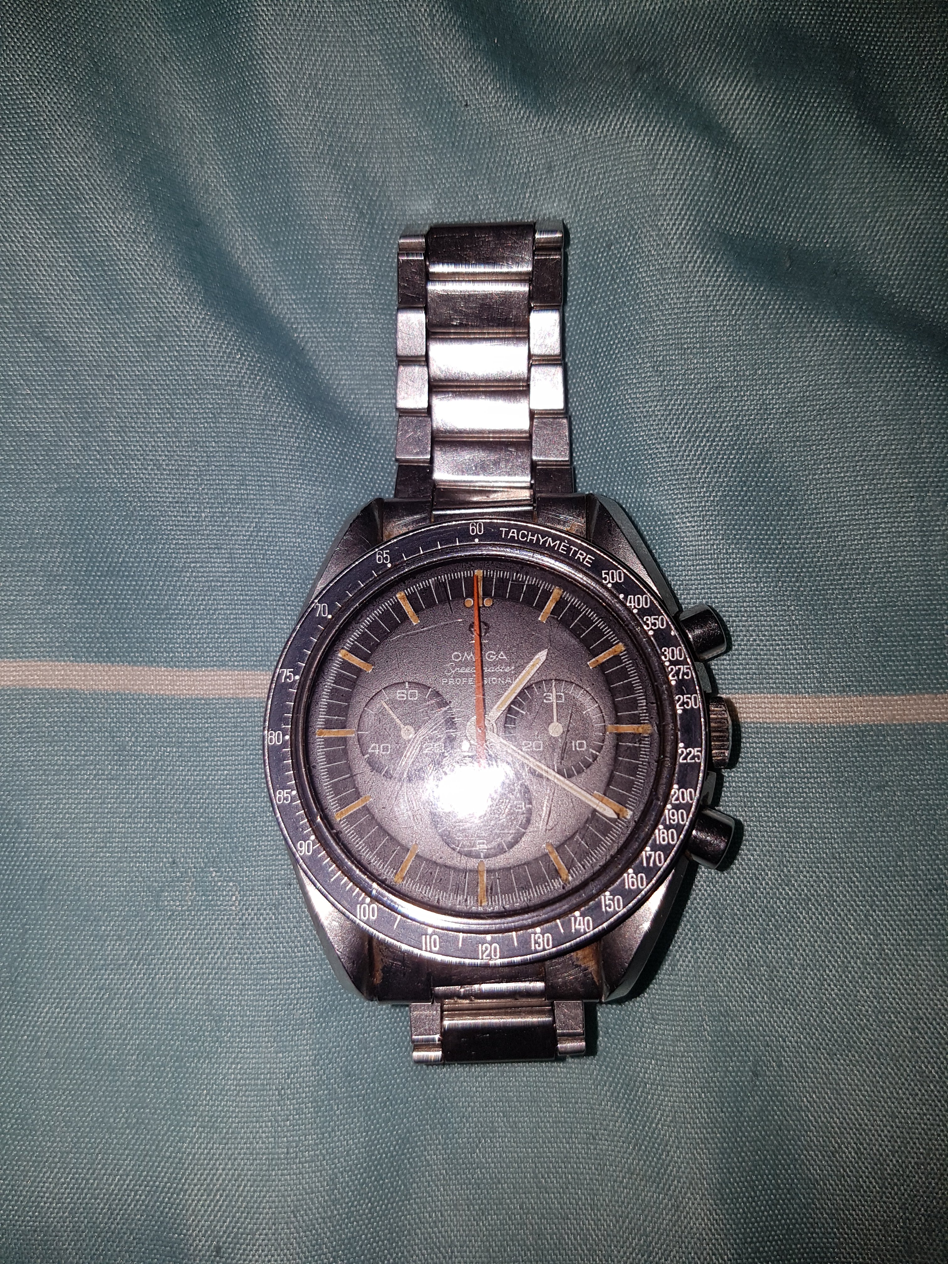

I have a '67 with tritium hour and minute, but SL chrono second hand.
The EOA states it was delivered with an orange chrono hand (text on EOA like shown above).
Most likely the chrono second hand was swapped for whatever reasons in the past.
Is this watch a put together now?
30,274
78,128

So what is the consensus on the orange hand length?
Some are obviously way too short and are not in the correct range anyway so lets forget about those watches.
Some say the orange hand should go beyond the minute track but when I see watches (Ultraman) square on and with very little angle in the photograph I see it is pretty much at the very edge of the track. Also some chrono hands have a little more curve to them which makes them look slightly shorter so a in person inspection would be needed I guess. With watches photographed at an angle, the hand that was previously in line with the minute track goes way beyond it then.
Are real Ultraman watches with straight on photos getting dismissed because the hand does not go beyond the minute track when straight on?
Interesting comment above, how does this happen if Omega are giving out Ultraman archives for anything with a orange hand that is in the correct range?
And am I wrong in thinking there are still only less than 70 Ultraman Speedmasters with archives?

From this forum. I say incorrect. Verified by EOA
Lovely looking watch but the hand would stop me buying it because the hand is obviously way too short or the tip may be missing? With these watches it is an important part after all.
