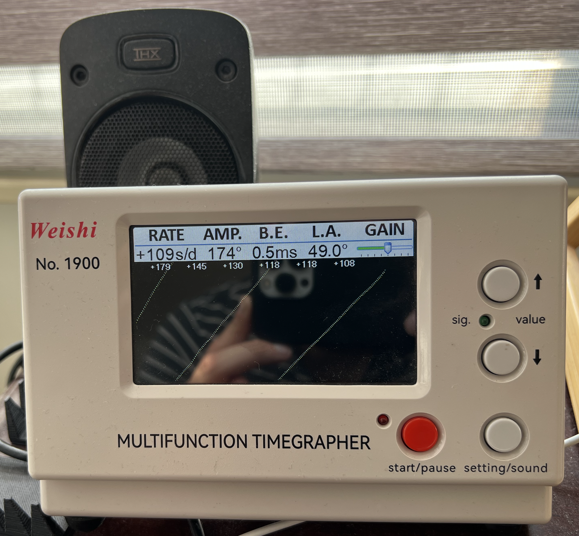

Finished up a watch, timing was +2 / 220 / 0.3
Installed the auto bridge, timing became something like +400 / 140 / 2
Removed the auto bridge, back to awesome rates
Demagnetised the watch, but both the watch and the auto assembly didn't register magnetism to start with on the Lepsi app - however such a drastic change could only be magnetism I think. The reverser wheel is also failing, but not failed yet
Any ideas before I test illogical things?
I guess my approaches are:
- swap auto bridges with a healthy watch and time both watches
- individually demagnetise the auto bridge
Looking back I think I experienced this before too, get an unexpected rate after assembly, going forward I'm definitely going to time before/after the auto bridge as a controlled experiment, I do wonder whether it's the reverser wheel somehow affecting things - is it possible, maybe not the +400 - but reducing amplitude and causing waves in timing

It's most likely that the hairspring is catching the bridge because the hairspring is not level and/or flat. There's not a lot of room to the hairspring from the auto bridge on the 550 series.
Good luck, Chris

Never thought of that, but I've tried another auto bridge and timing was good - right now the only logical explanation I have is that the balance assembly and the auto bridge are in love, and when they get together, there's this phenomenon, a spark, that dissipates and normalises over time - you can observe the reducing rate here:
It eventually got down to +40 / 180
I've demagnetised the auto bridge individually a couple of times, and the entire watch together a couple of times, I think it's persistent weak magnetism and my cheap demagnetiser is just not taking it away effectively
Good luck, Chris
Lifting the auto bridge slightly gets the rate in line, so you're right, thank you for the suggestion!

Sometimes you can trace this sort of fault by checking dial up and dial down. If the contact is very slight then it may be fine in dial down.
Good luck and be very careful if you try to manipulate the hairspring. Sometimes, it can be just that the stud is too low or high and that's kicking the hairspring over. You may be fortunate... By the way, I don't know what wind condition the watch is in but the amplitudes seem low.
Cheers, Chris

The issue was reducing the amplitude as well - my temporary solution was to just replace the automatic assembly for the time being, others don't seem to cause the issue and I can't see anything apparently wrong with this one yet - after spacing myself a bit from the issue, maybe something was causing this specific bridge to be seated slightly off angle - I've deferred the issue though
Thank you for the suggestion about testing different positions as well, makes sense

If those readings are at full wind, it was low before the bridge was put on...

220 is what I strive for, I don't replace or service the mainspring and only open up watches if there's a major issue, in this case it was a heavily oiled watch with wrong screws inside, wonky armor ring risking the dial, considering the treatment it got before I'm very happy with 220
Living in Turkey it's pretty challenging surviving inside a self embargoed country, I couldn't find the right sized mainspring tool from Aliexpress (privileged company, only place that can bypass the customs wall) and it just seemed not worth the extra risk to import the right sized Bergeon winder
I really hoped one of the many popular movement winders would be compatible with the 550 barrel, but at one point I checked the sizes and as far as I recall none of them seemed to be
