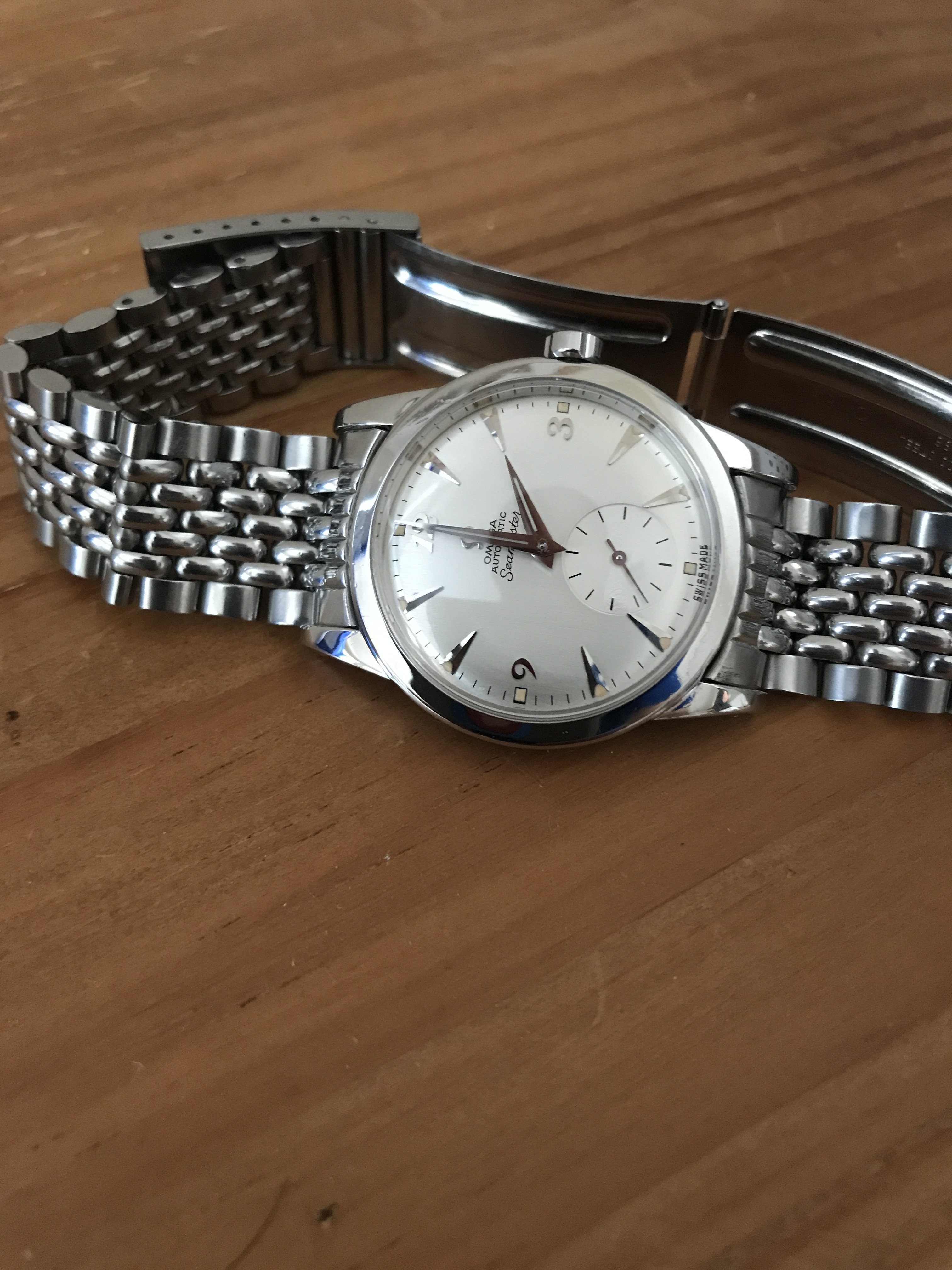

I got this done by Omega this year. I really like the way it came back. Before and after.
That's a beautiful new dial, even if it isn't absolutely identical to the original. But it seems like there is some luck involved with Omega's service, and no guarantee you'll like the results. Still, congrats on that one.

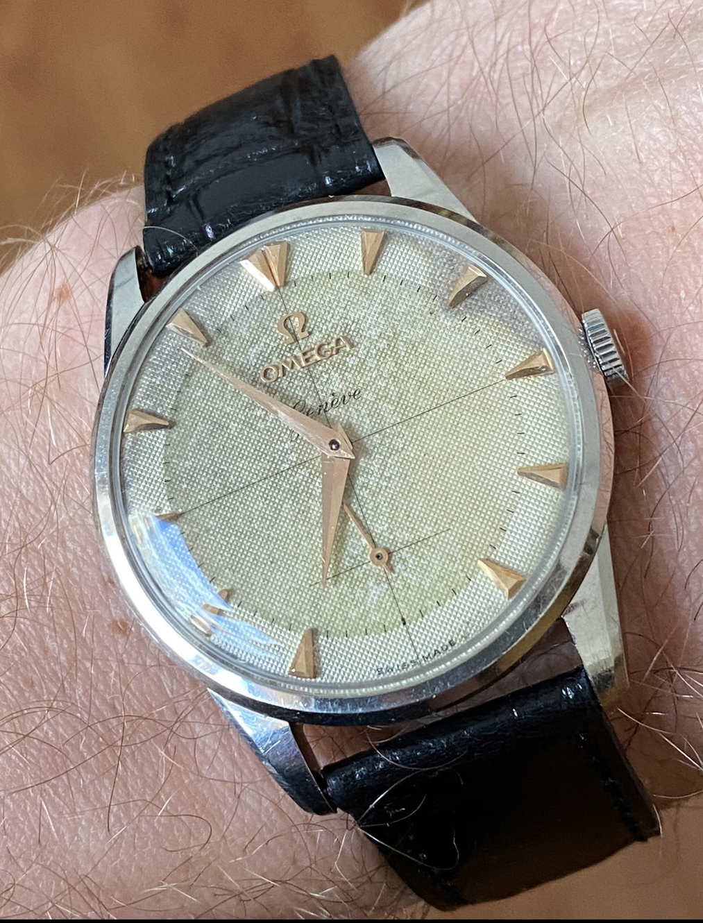

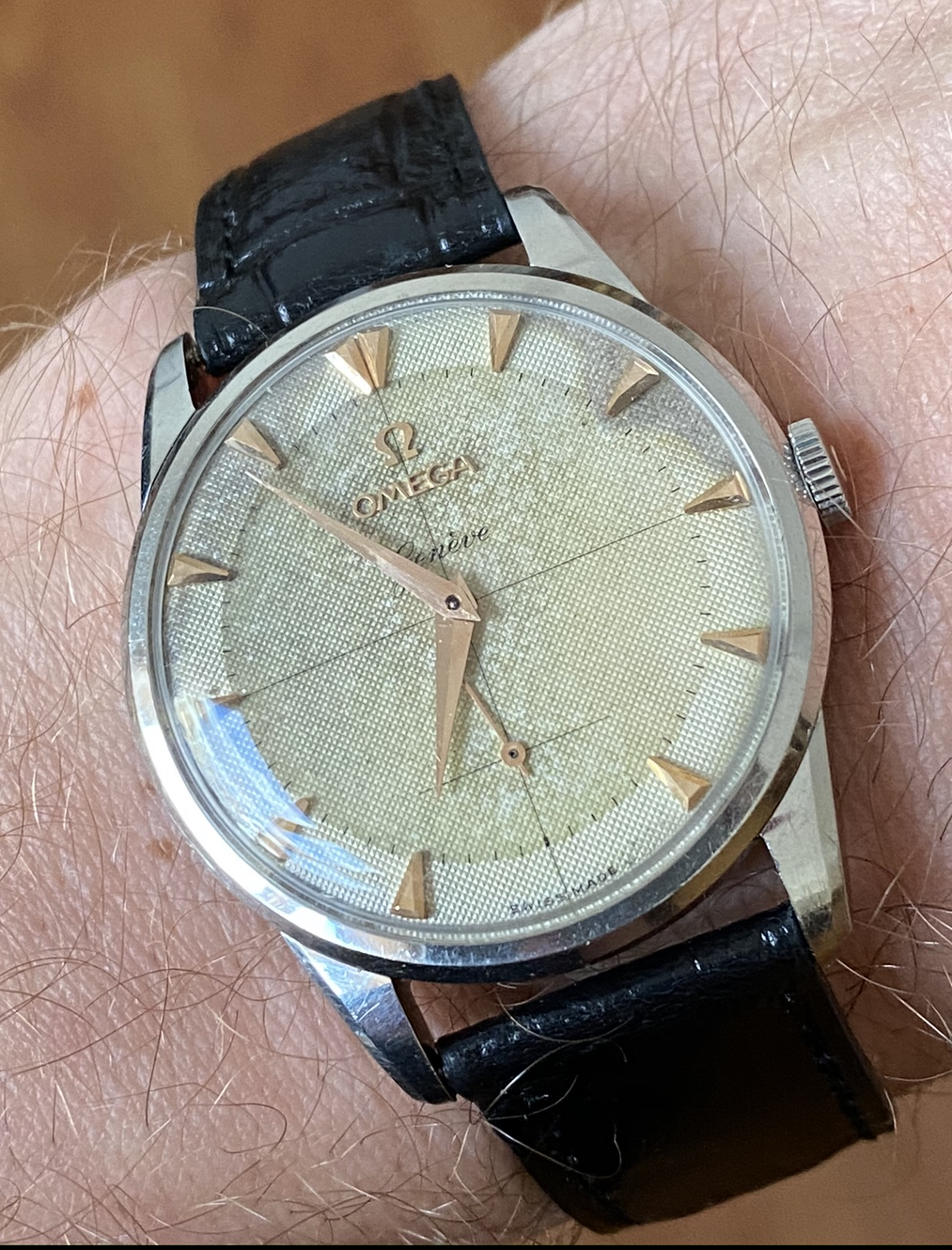

If I may come back to the topic redial vs dial cleaning - I‘ve wondered how well the latter actually works. Having recently acquired a ref 2748 Genève (the 36mm version, that is) because they are hardly available and the price was right, even for the condition the structured dial is in, I was wondering if cleaning the outer circle of the dial was a possibility. I wouldn’t wanna touch the inner part with the writing, I think, and I don’t mind the patina/damage there, but the dark spots around 11 and 2 I could do without. Redialing it wouldn’t be an option.
If anybody has experience with this kind of work I’d be grateful to hear about it. Also, hope it’s ok to use this thread for this question - I felt it kind of fit in, but I don’t wanna „highjack“ it. I’d be happy to open a new thread, if that’s preferred.

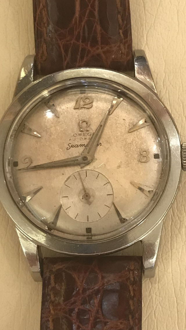

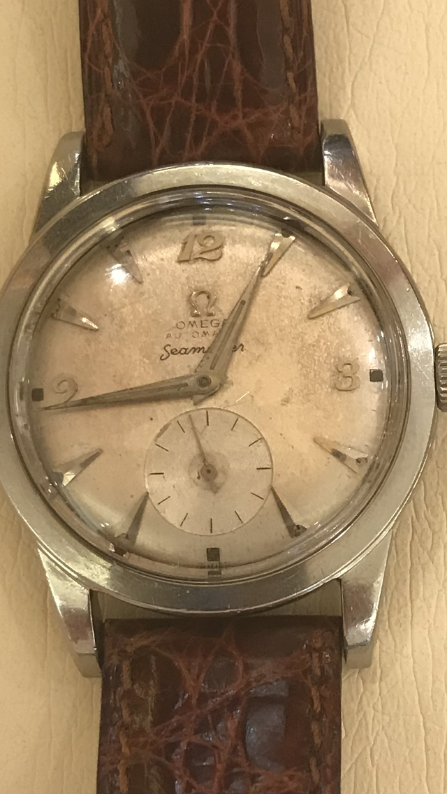

It took me several tries, using different dial refinishers, and much experimentation to only achieve marginal results at best. Finally, I would see the folly of a refinished dial. In the end, nothing beats an original dial, even if it has some flaws/patina or is imperfect. Here is a compendium of my direct experience. I will only show the refinished dial results.

I may have some controversial thoughts on dial refinishing. First, I'd like to say that none of my vintage pieces have refinished dials. However, if you are not a collector, and intend to wear your watch, I have no issues with refinishing a dial, especially if it has gone past the point of having "patina." There are so many people who are new to collecting who pass off a watch as having "patina" when, in reality, it is completely illegible and has suffered major damage. To reiterate, these are damaged dials, not "patina'd." If one were to sell their refinished dial later on, obviously it would be imperative to describe the watch accurately to the potential new buyer.
This being said, I do agree if you are a collector who is looking for an OG, completely untouched example, don't refinish your dial. But I think these types are also the people who will search for a good example and won't make an impulsive decision to buy a watch with a damaged OR refinished dial. Personally, I'm somewhere in the middle; I have a 2451-7 321 which has patina'd into a beautiful, cream colored dial. But again, this watch clearly has patina and not damage (for the most part, obviously ~70 year old watches are going to have their flaws).
