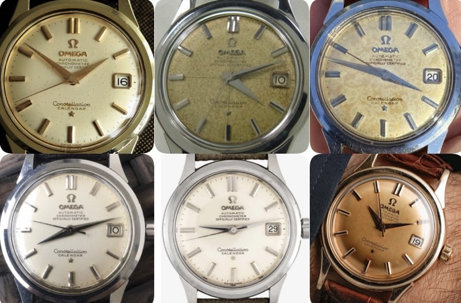

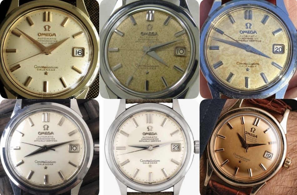

In this thread, I will specifically focus on Omega references 2943 and 2954. Firstly, in these references, the “no lume” hour-markers are far from uncommon compared to the lume version. Three types of hour-markers can be found: lume (most common), no lume, and ONYX insert. Some examples with no lume markers from my research:
My research found at least 5 examples with the “original” black dial.

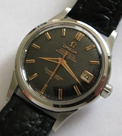

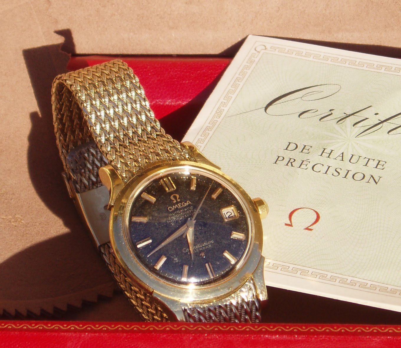

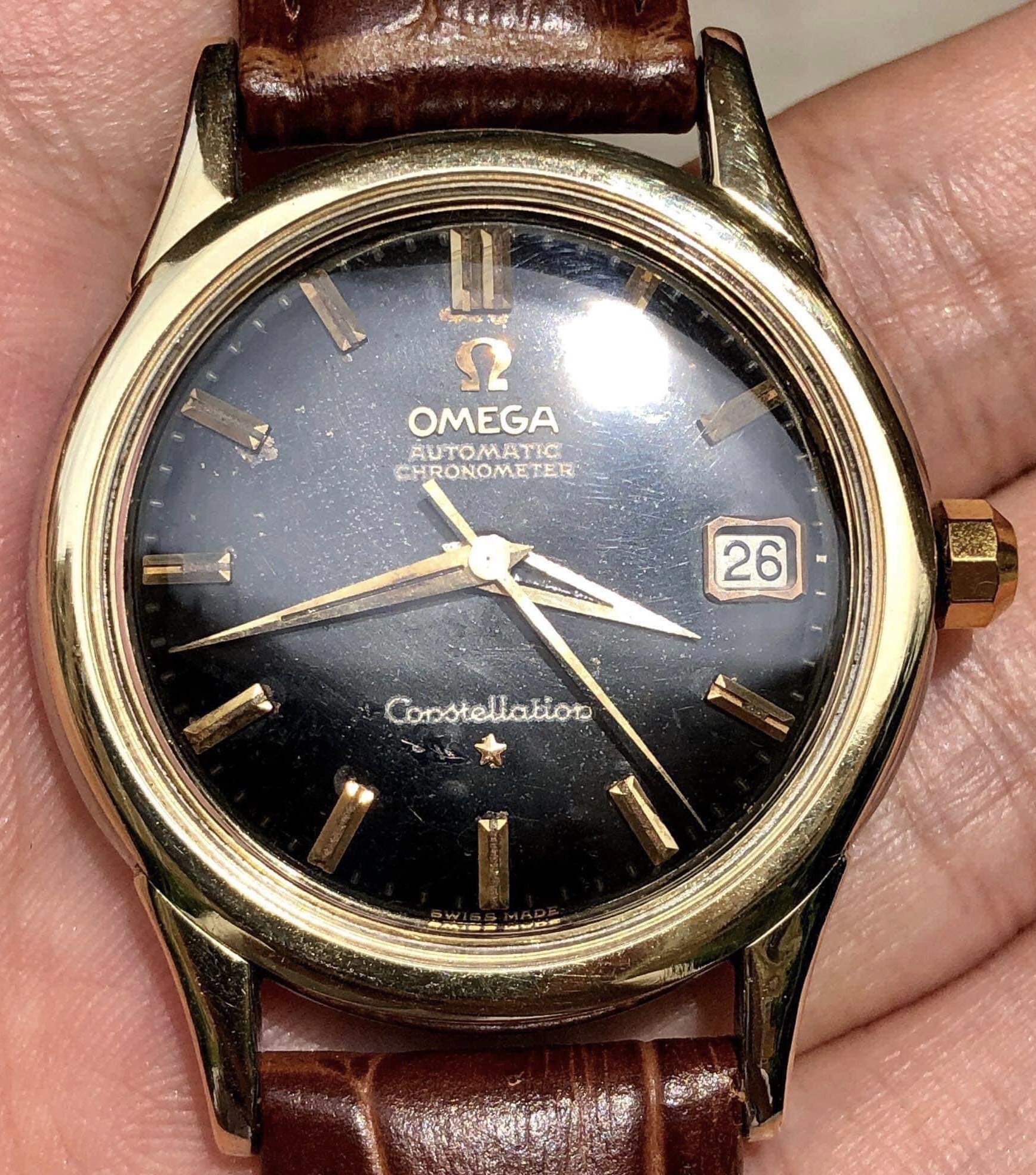

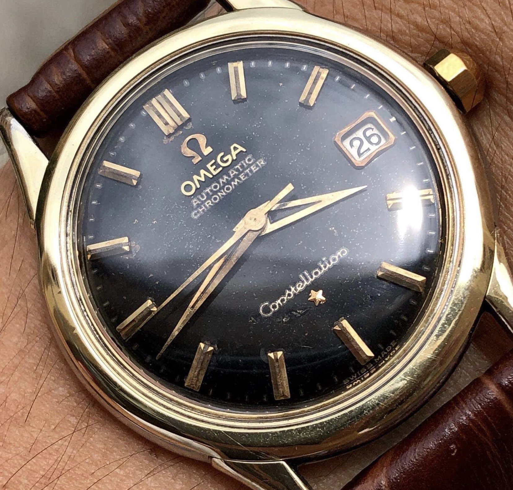

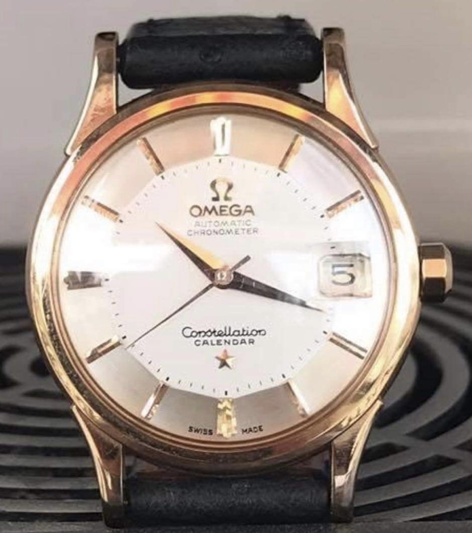

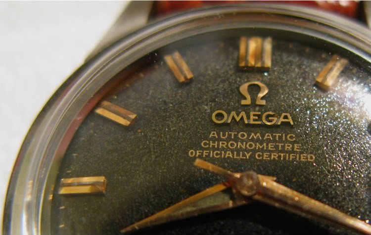

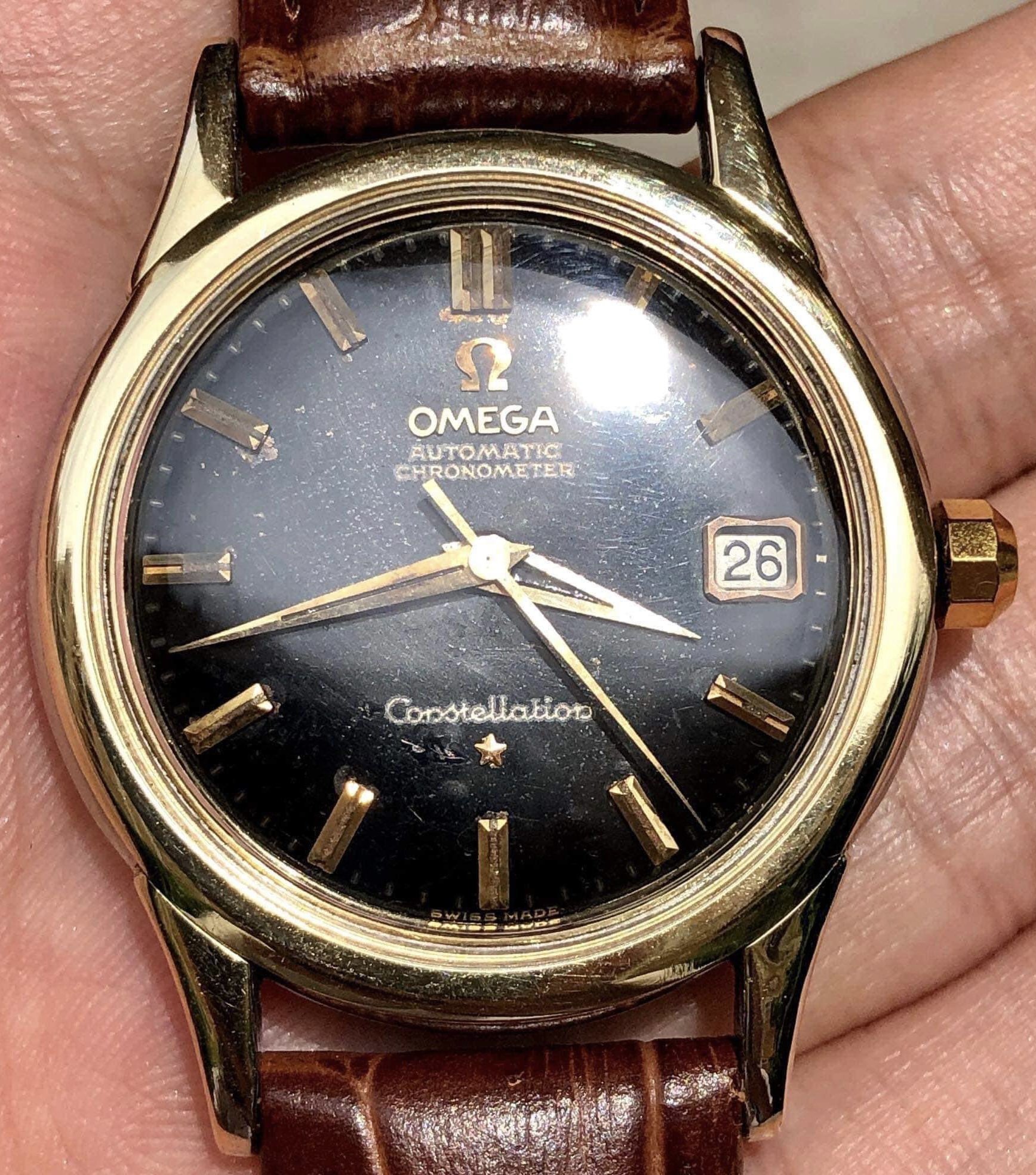

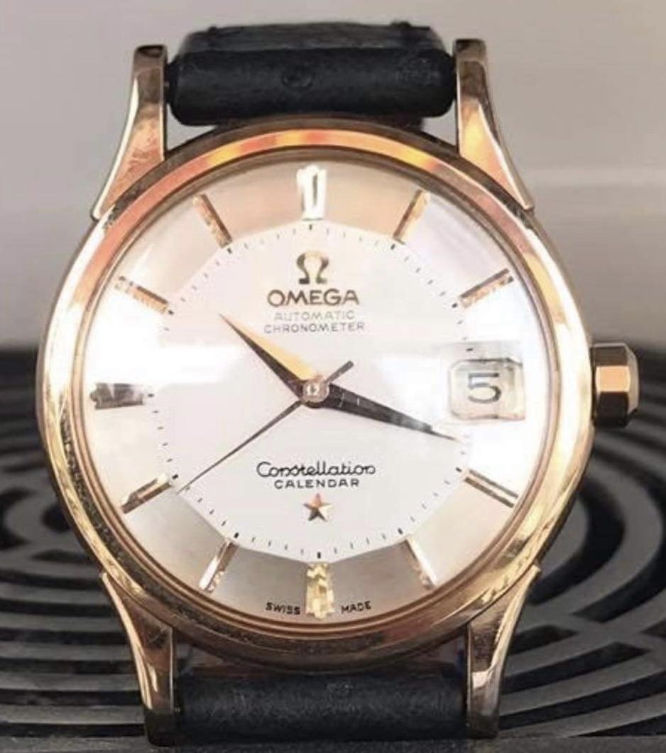

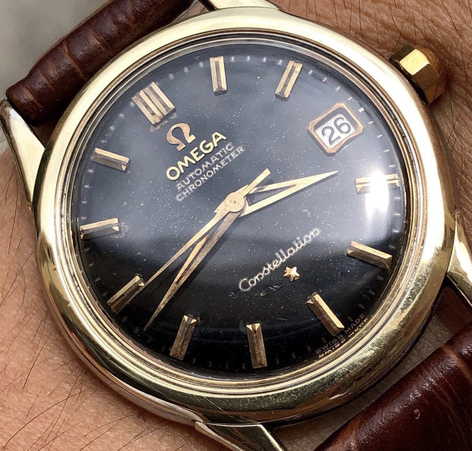

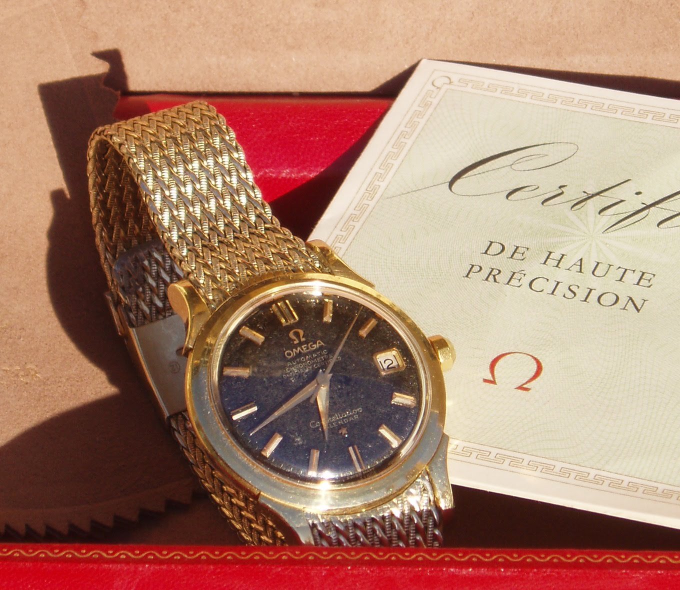

Firstly, the very nice gold-capped watch that was hardly worn by Mikes (@MSNWatch).

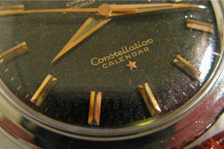

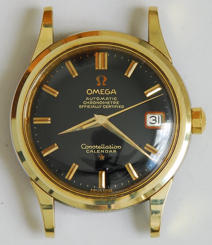

Desmond (@mondodec) reviewed another 18k watch here: https://omega-constellation-collectors.blogspot.com/2009/11/story-about-original-black-dial.html

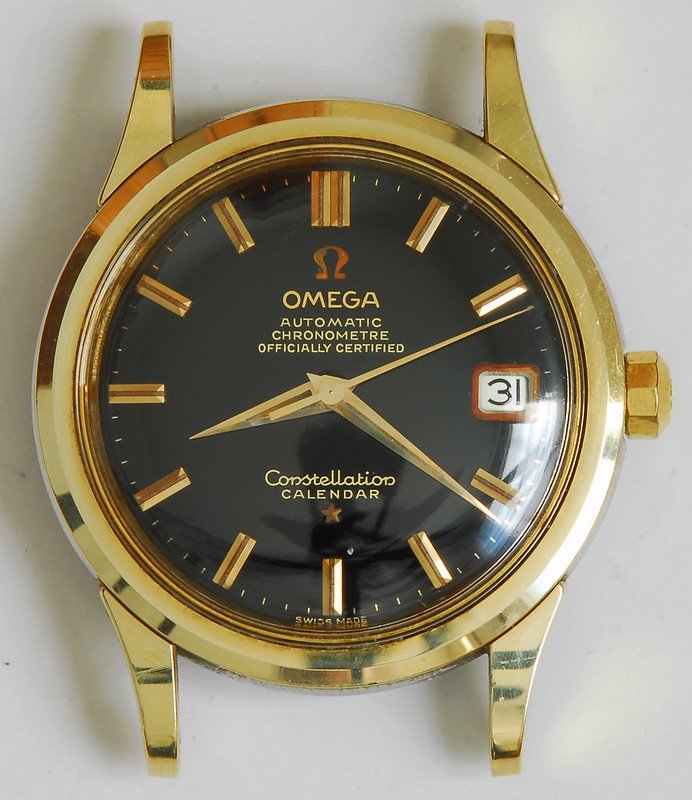

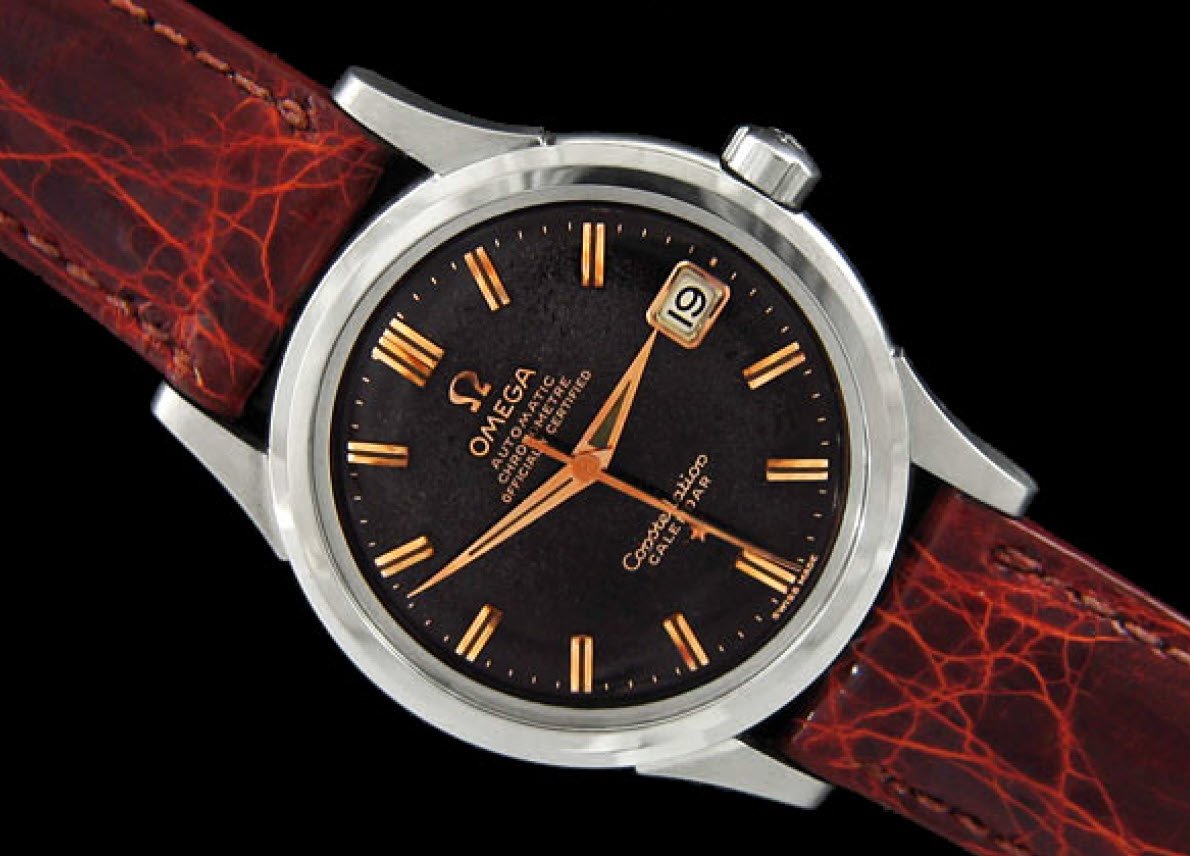

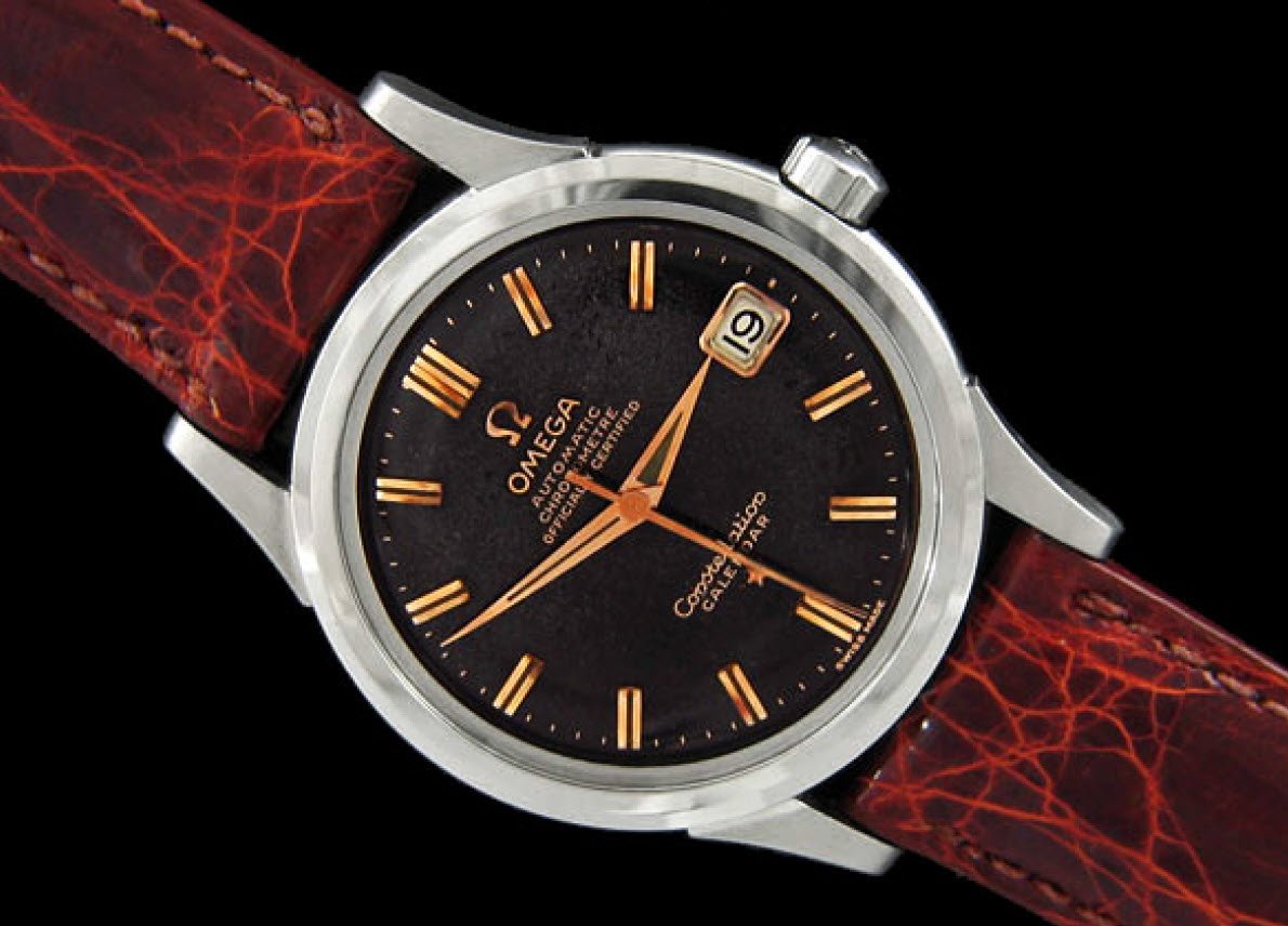

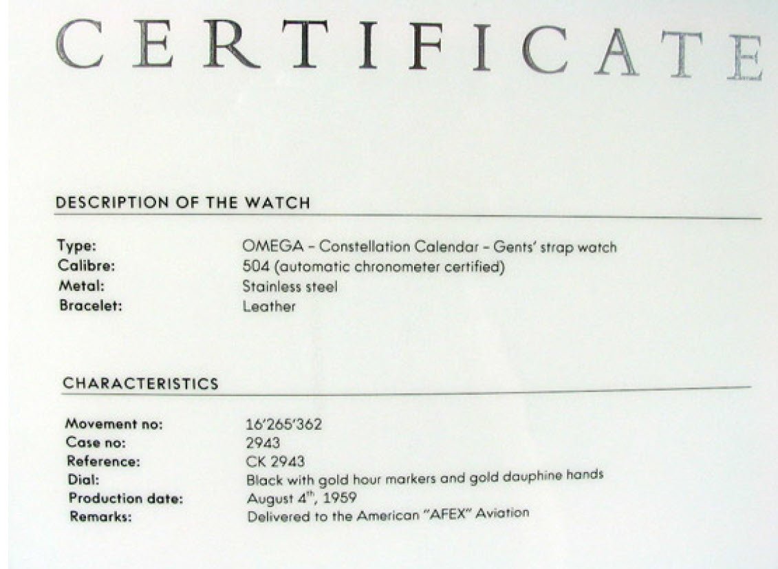

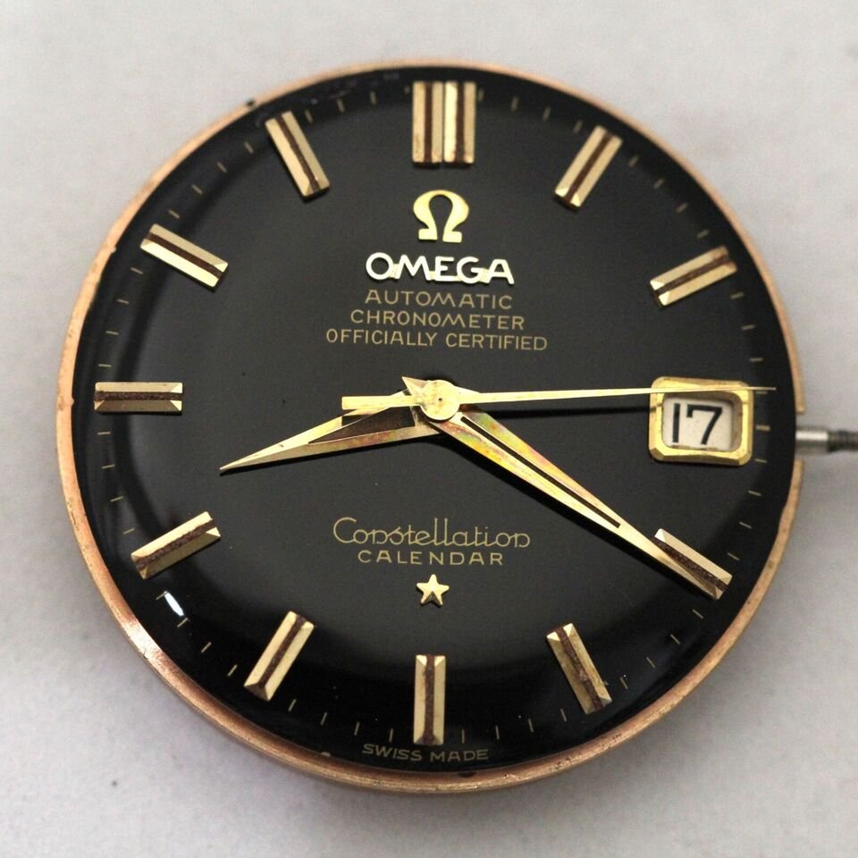

Another rare black dial, steel case reference 2943 with pink gold hour-markers, ranked by Desmond to be the “star of the month” since April 2008. This special watch came with the movement number 16,256,362, with the production date confirmed by “Omega Extract from the Archives” to be produced on August 4th, 1959. https://omega-constellation-collectors.blogspot.com/2008/04/star-of-month.html

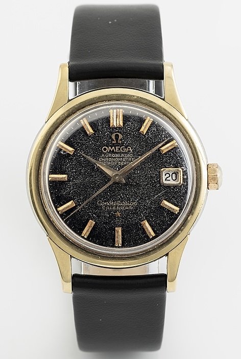

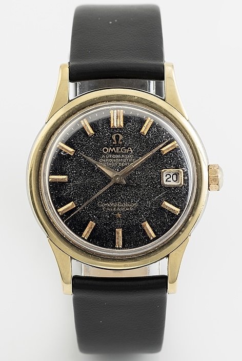

Moreover, I found this gold-capped case with strong patina through the dial. Even though the picture is not clear, I believe the dial is original. https://www.bukowskis.com/en/auctio...omega-constellation-calendar-wristwatch-35-mm

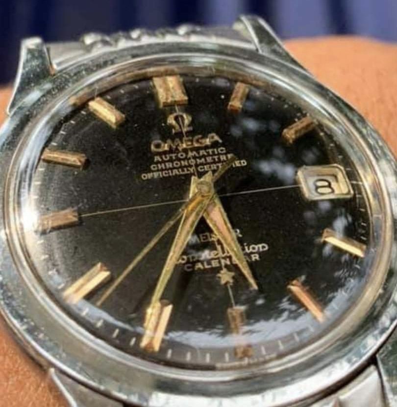

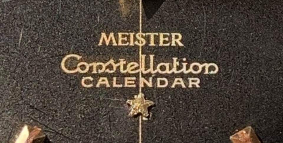

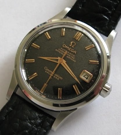

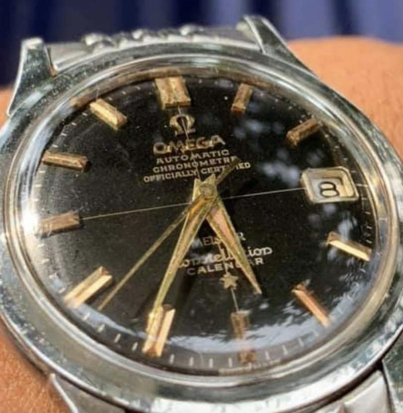

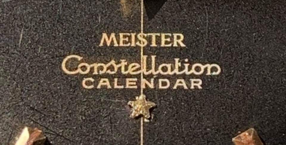

Next, I found this black dial in a steel case with yellow gold hardware (plus the crosshair and Meister). This one came with thicker fonts than usual, also too many serifs. These fonts were suspected to be redialed by many experts. https://omegaforums.net/threads/constellation-calendar-2943-with-crosshair-and-meister.110360/

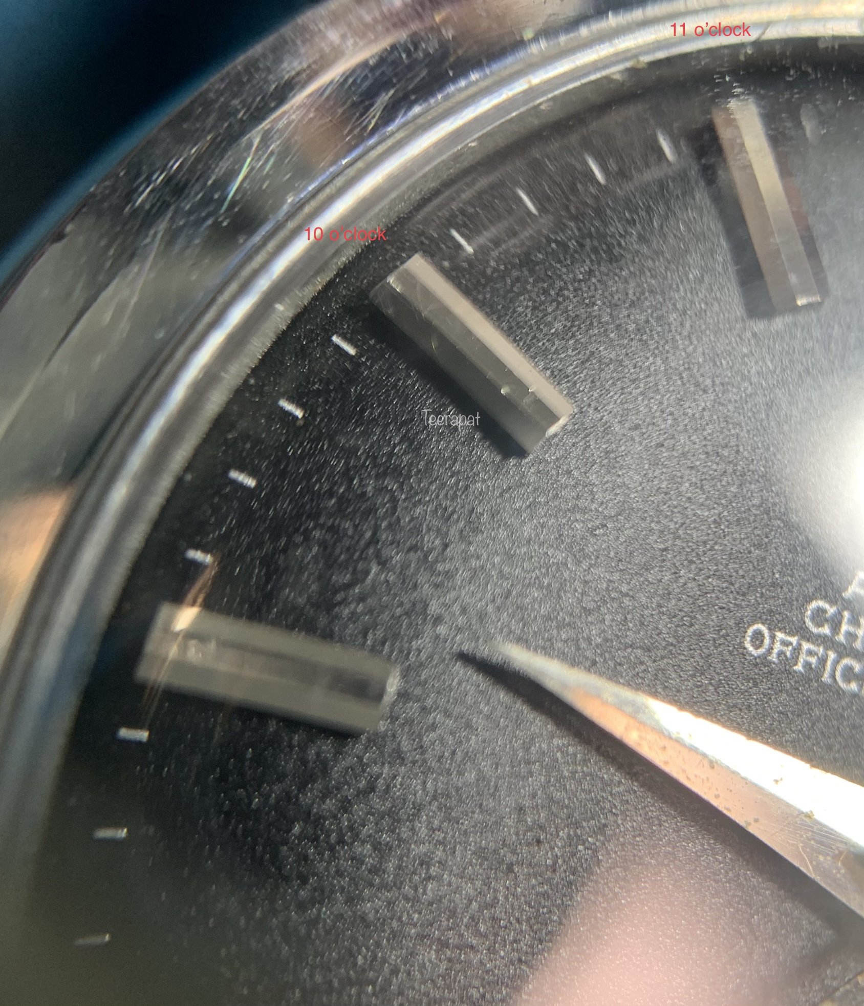

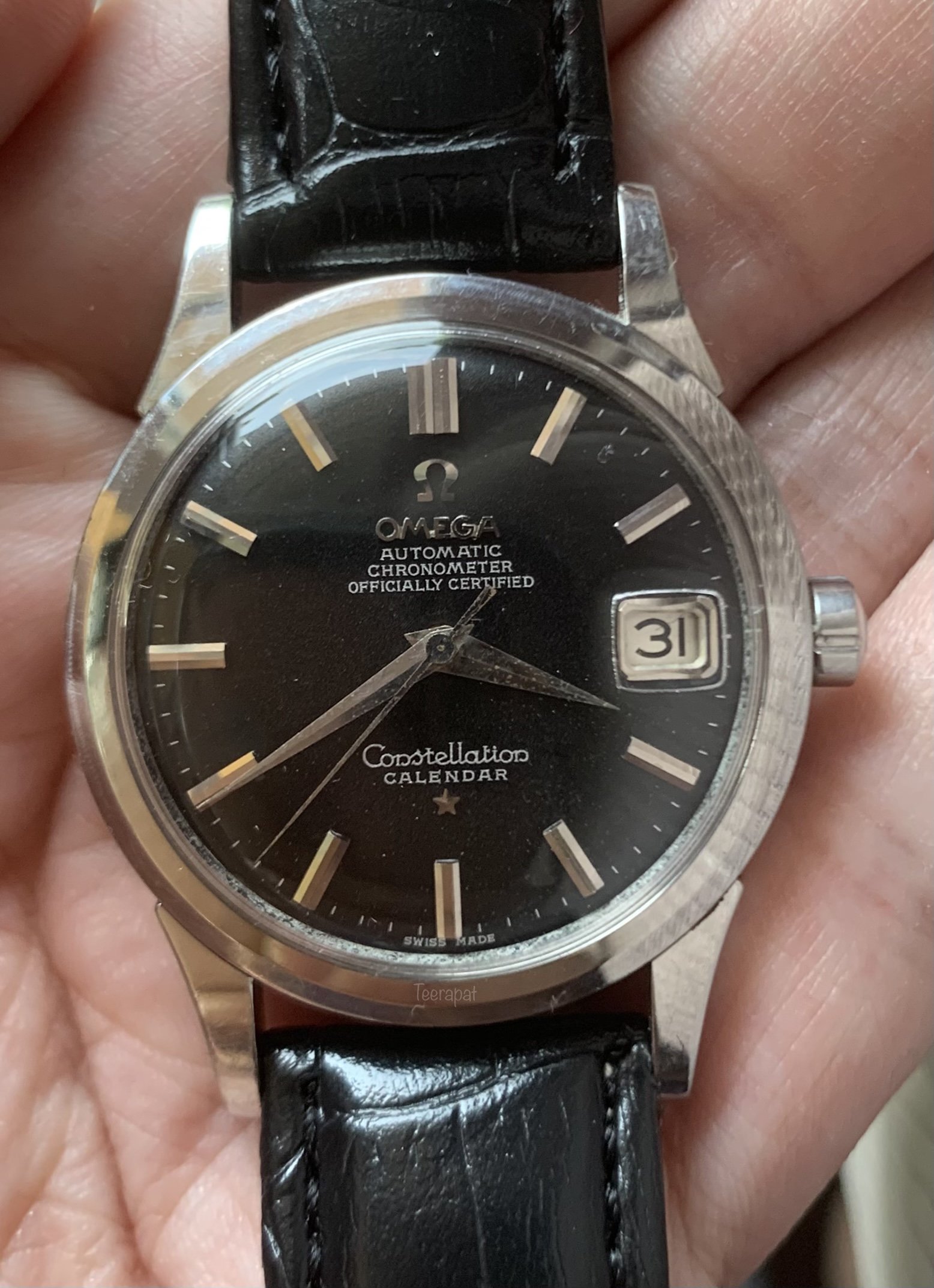

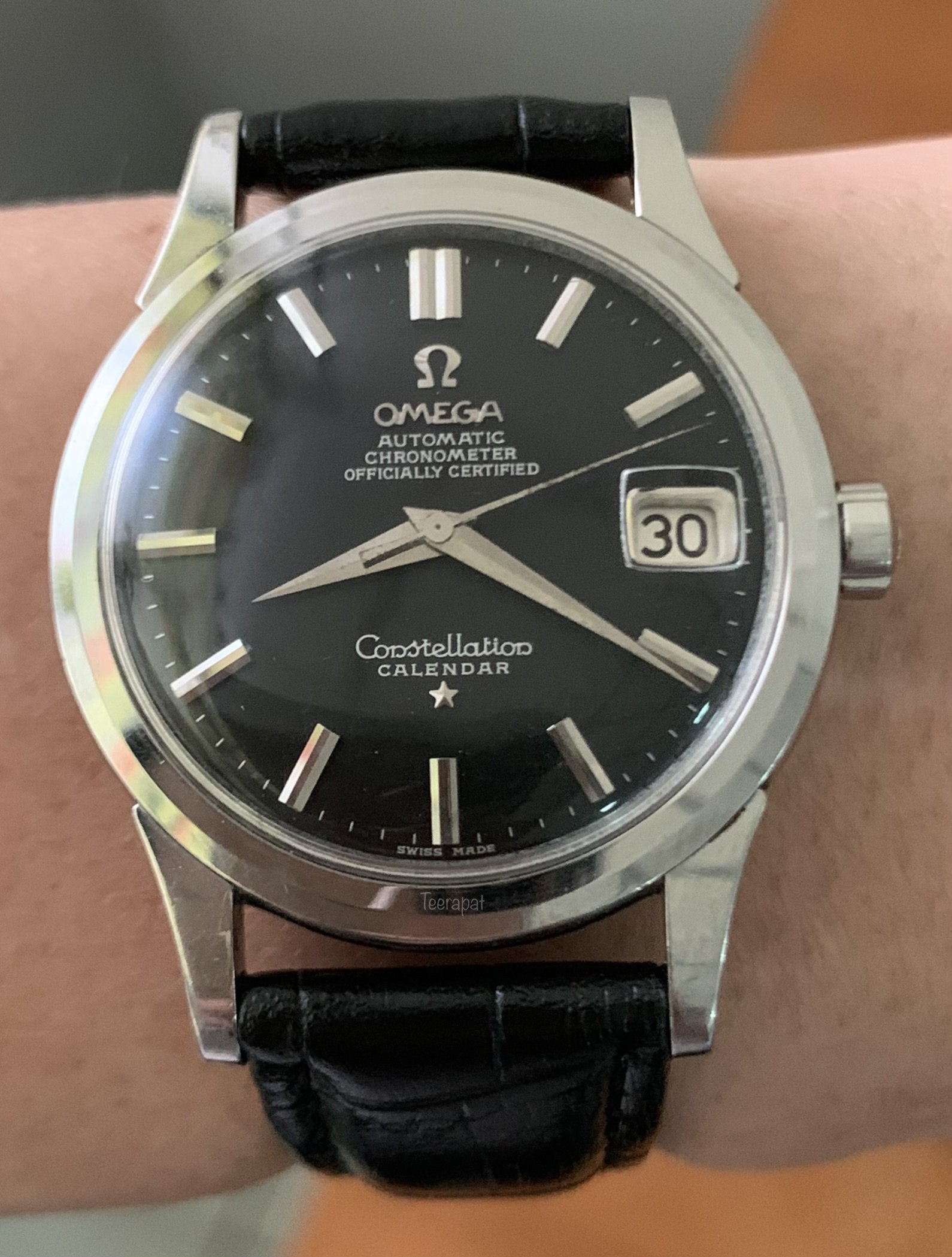

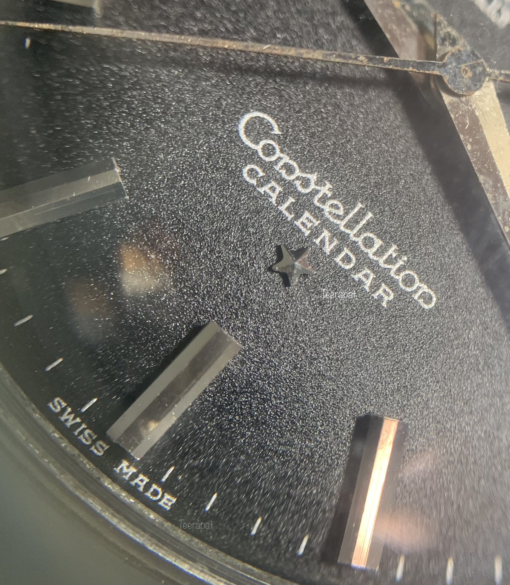

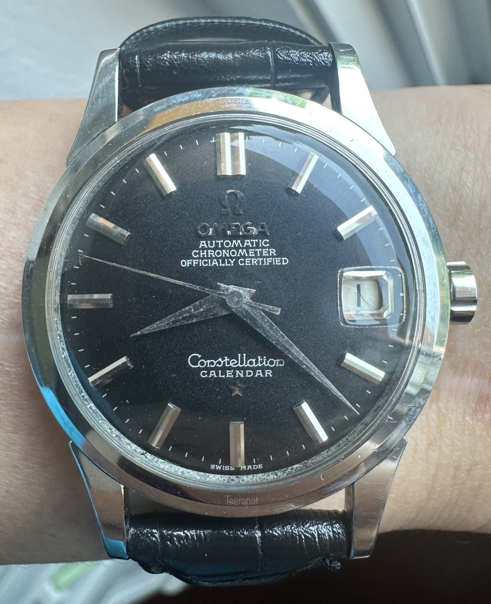

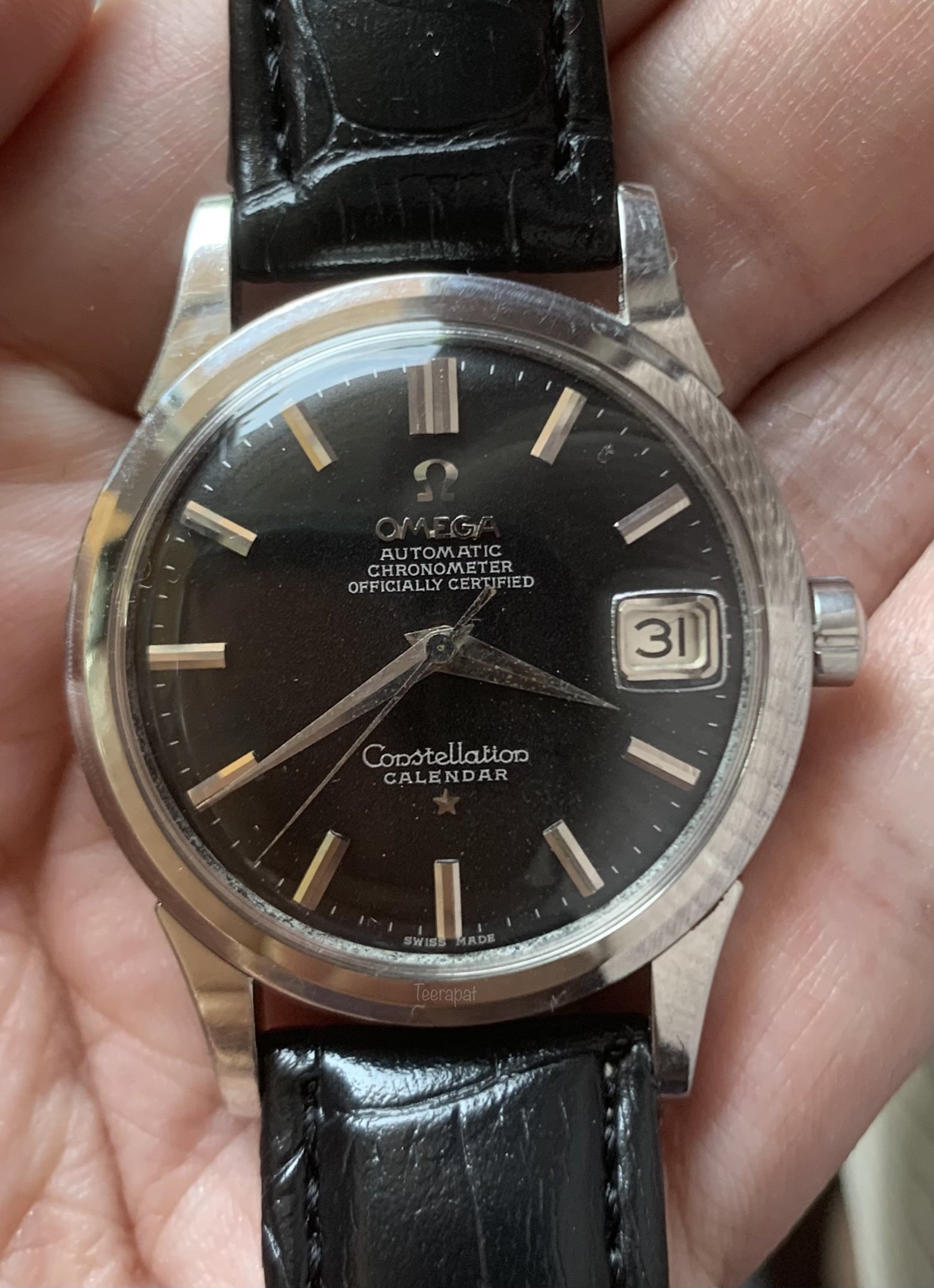

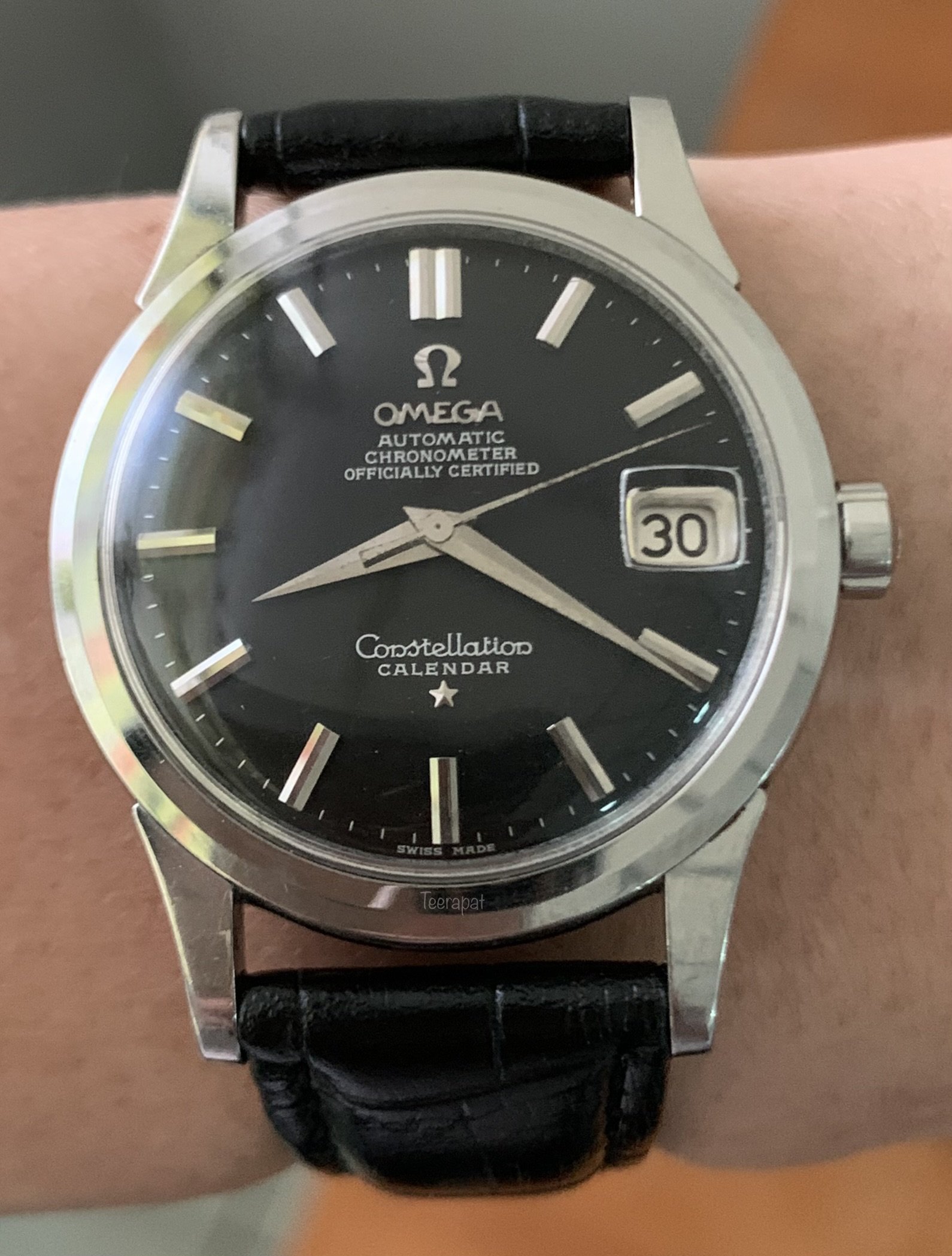

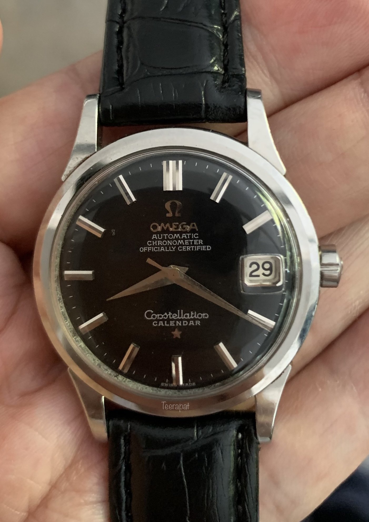

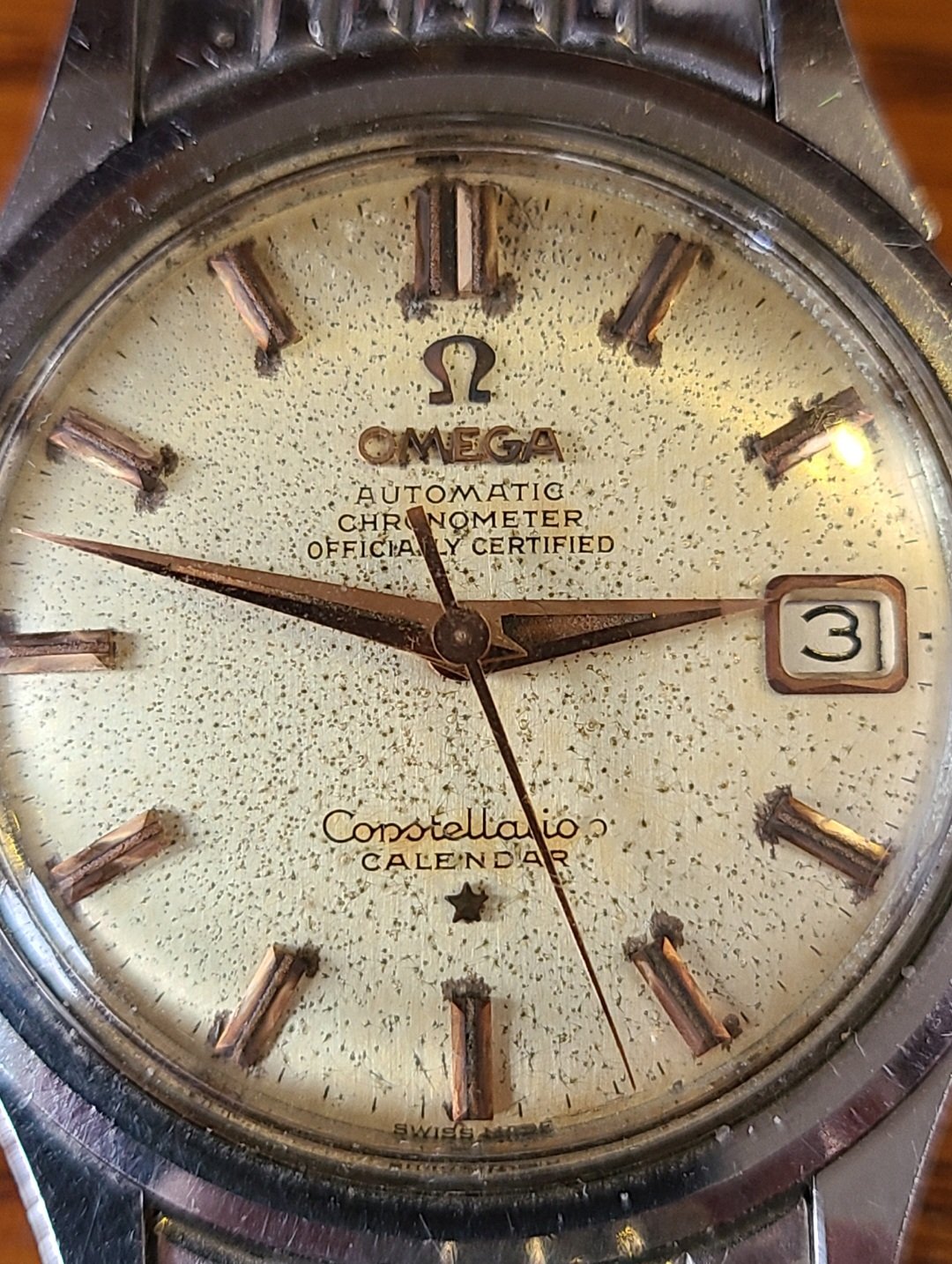

Today, I would like to review my new incoming watch, which is the all-steel case with the steel hardware. I tried my best to provide clear pictures of the dial; despite that, the black dial is not easy to capture. Besides, in some pictures, the markers might look like the gold color from some light reflection.
I apologize for the numerous pictures I added.

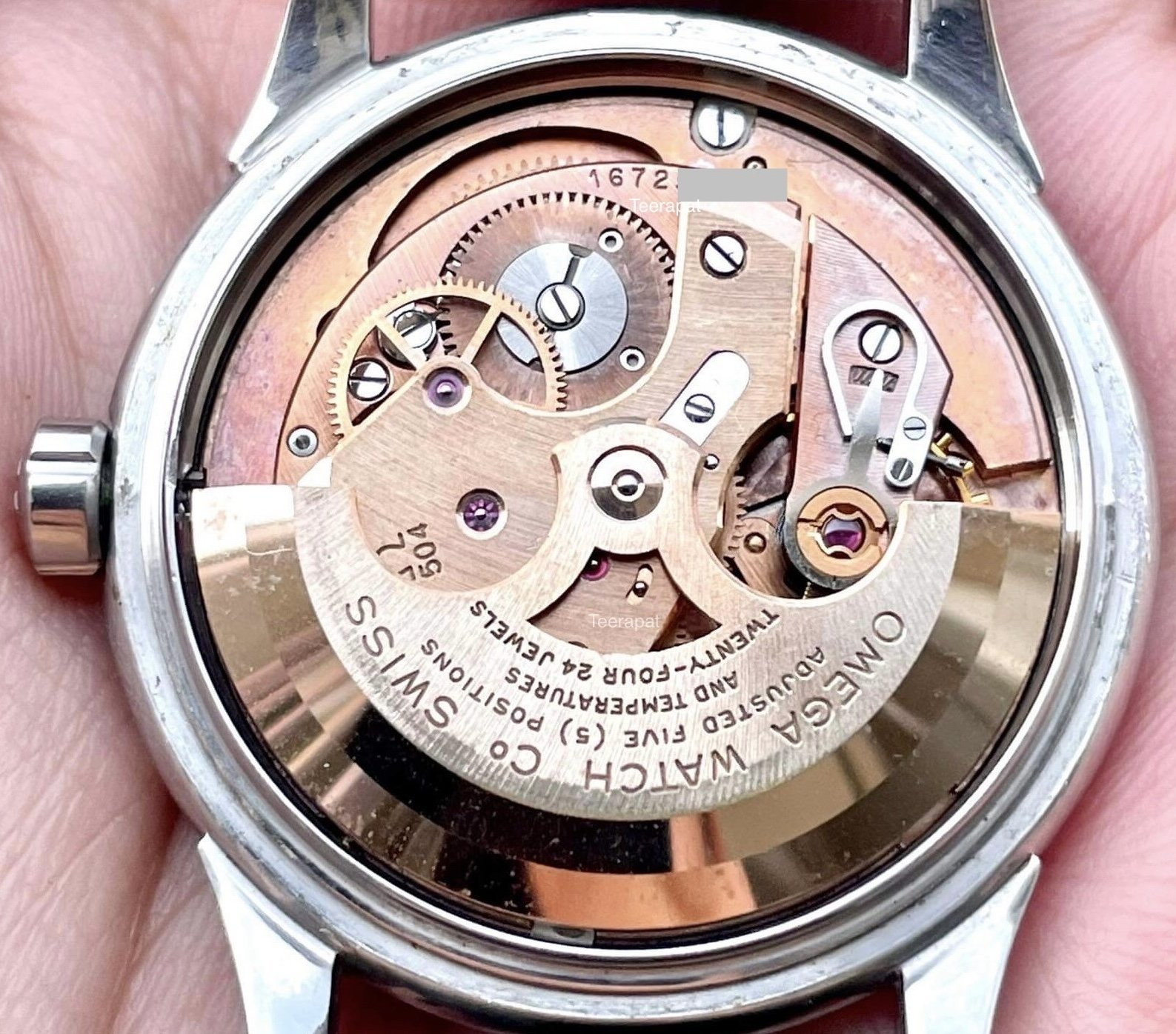

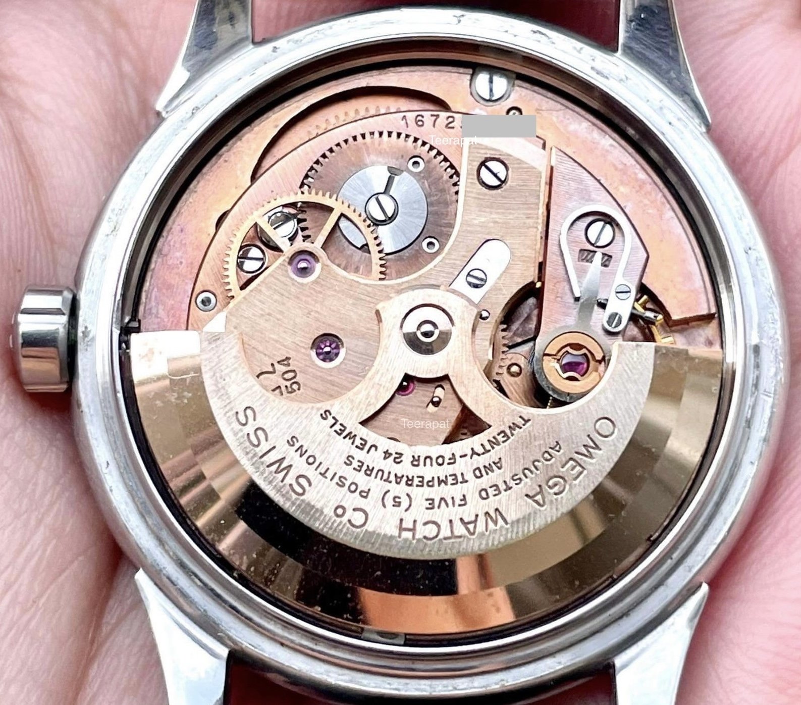

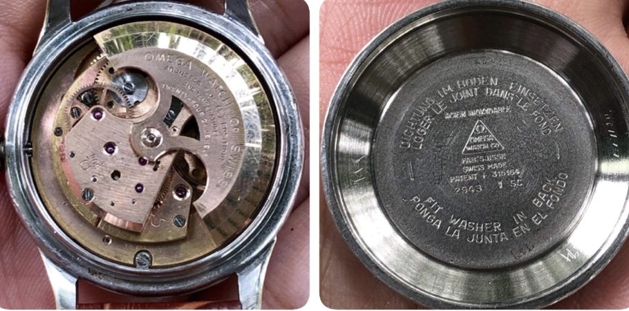

It was the only example I found in reference 2943 (also 2954) with all-steel case and hardware, with more uncommon “no lume” hour-markers with a black dial. The movement number was 16,725,xxx, which I believe was produced around October to November 1959 when compared to extracts from two other watches.
The steel hour-markers were original no lume hour-markers. It matched well with the steel dauphine-type hands.
The clover leaf crown can be the correct version, especially for this reference.

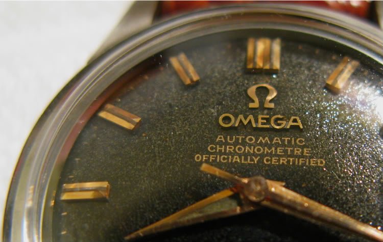

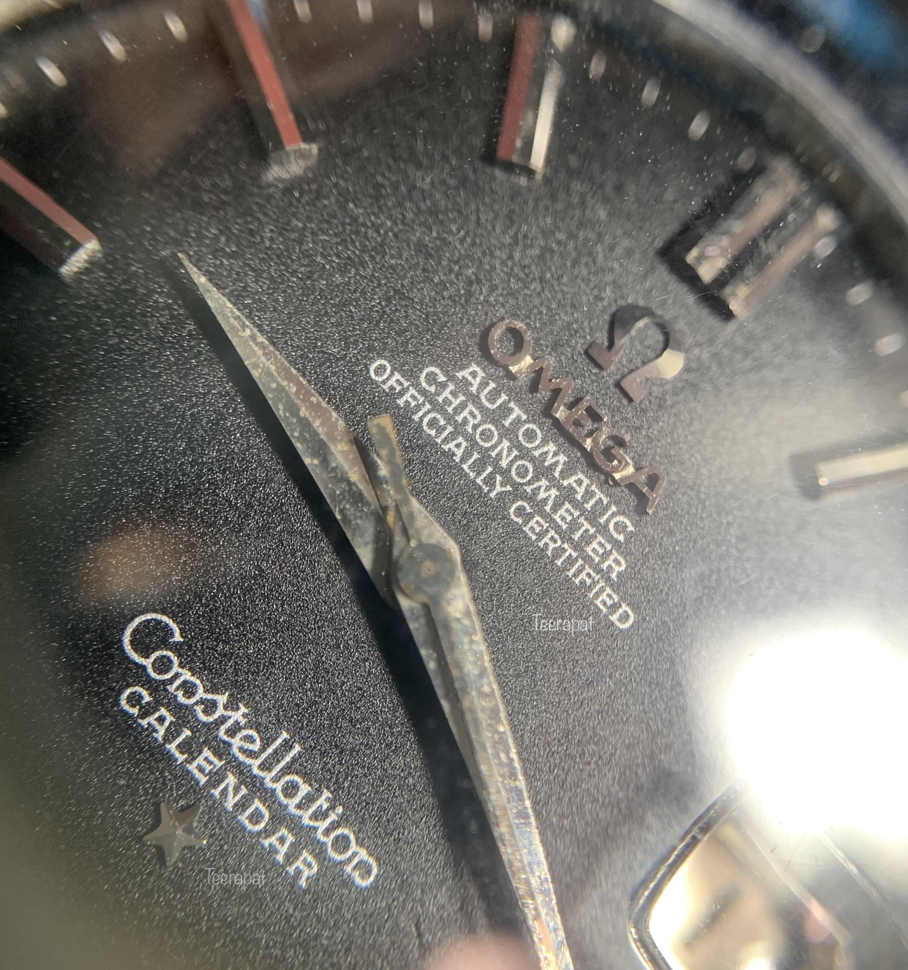

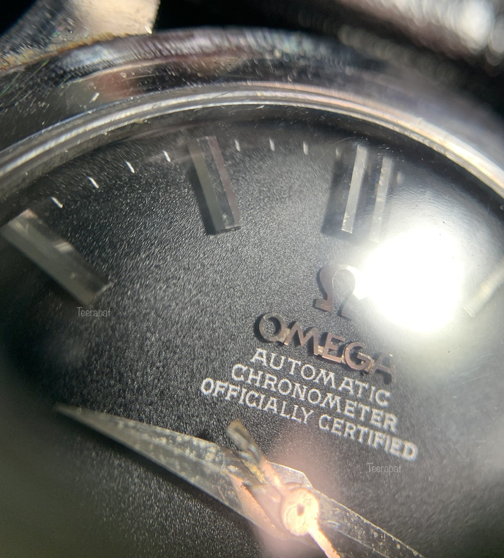

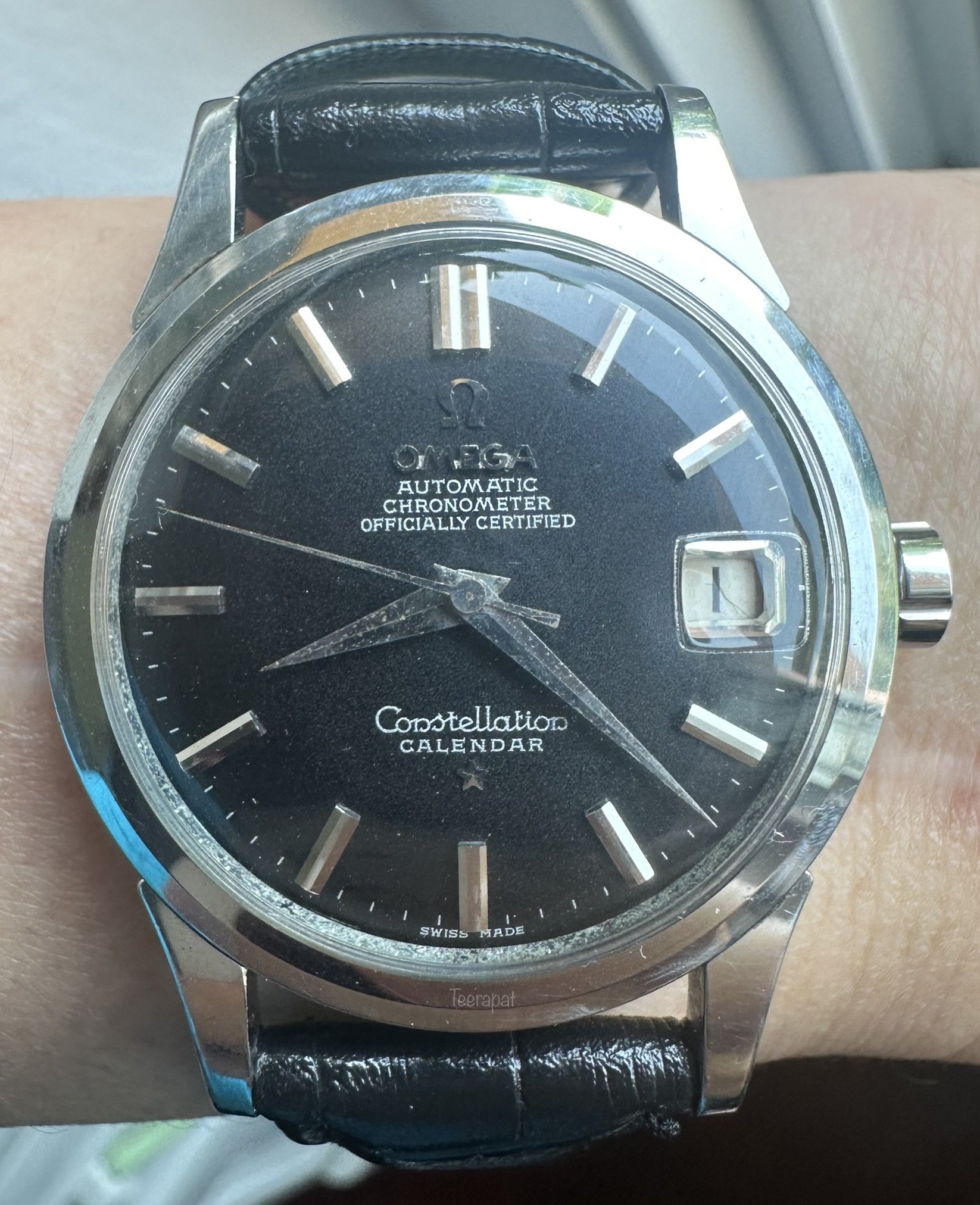

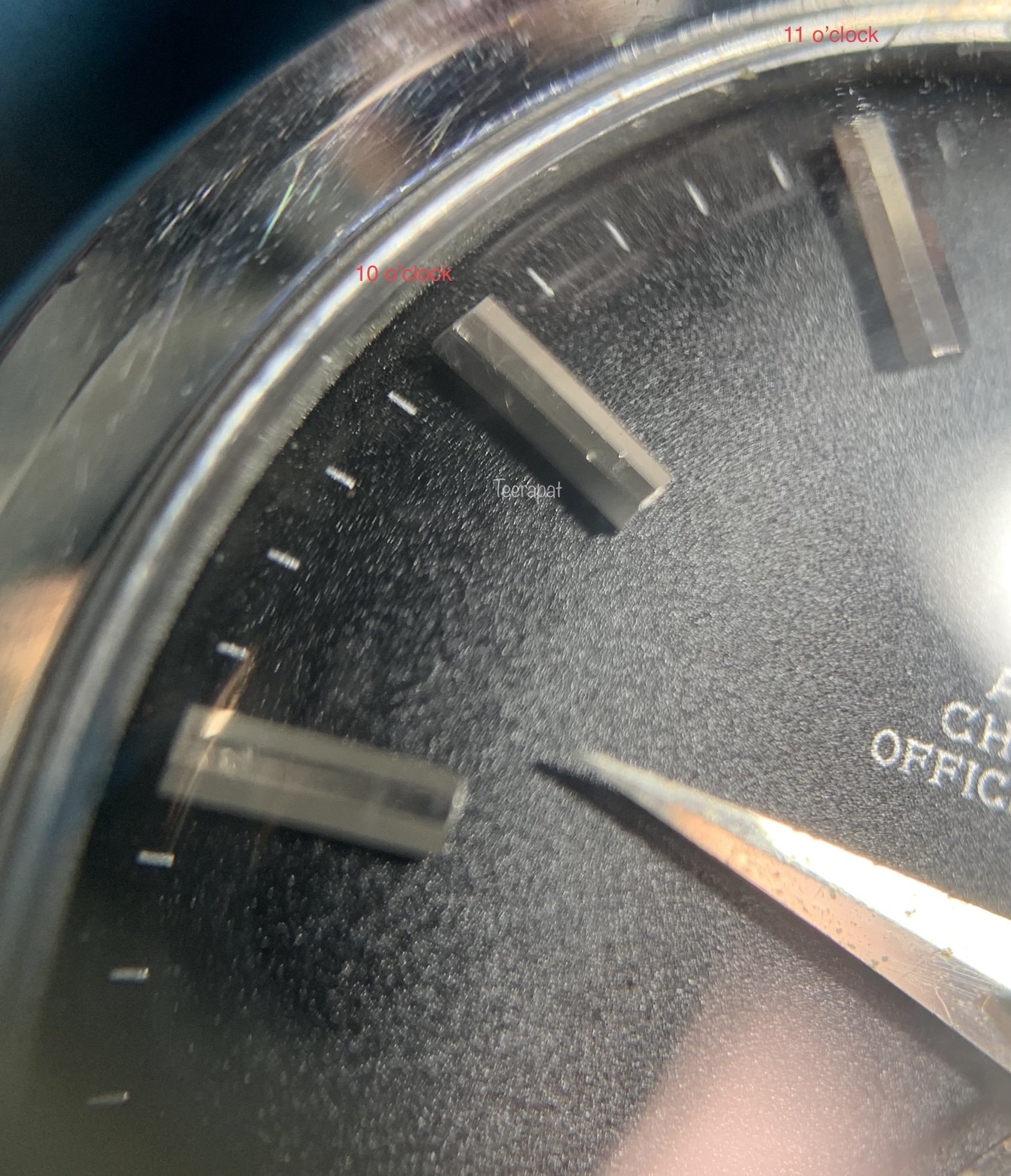

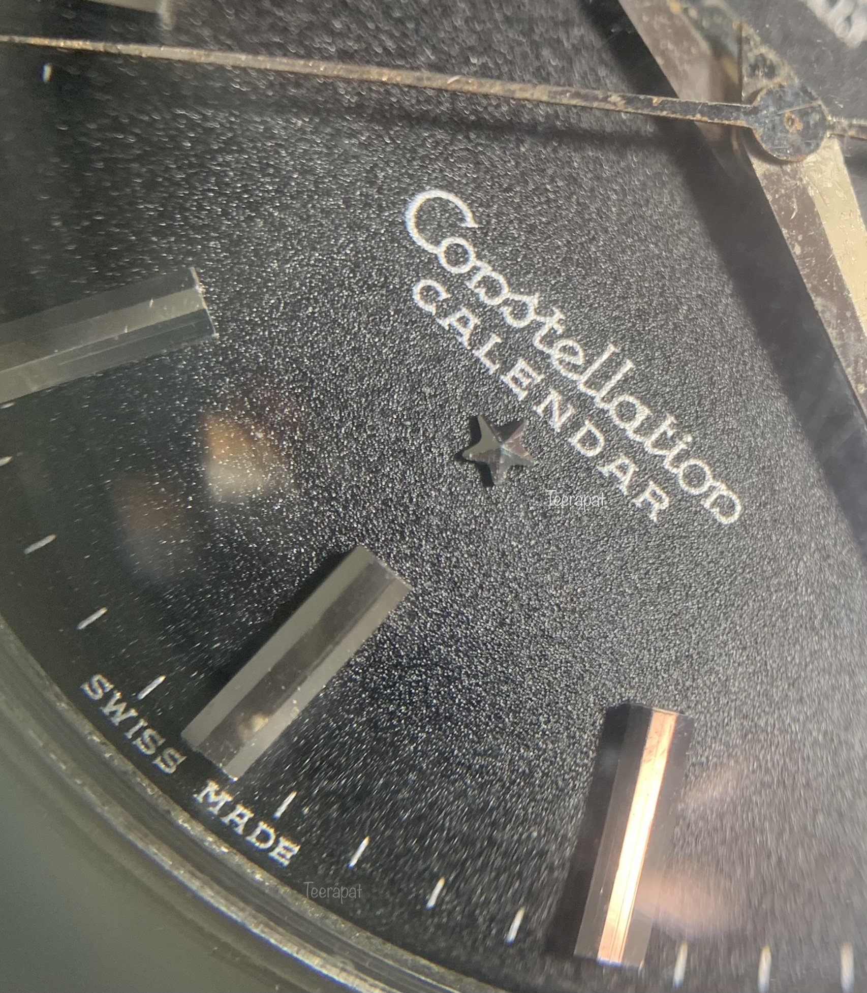

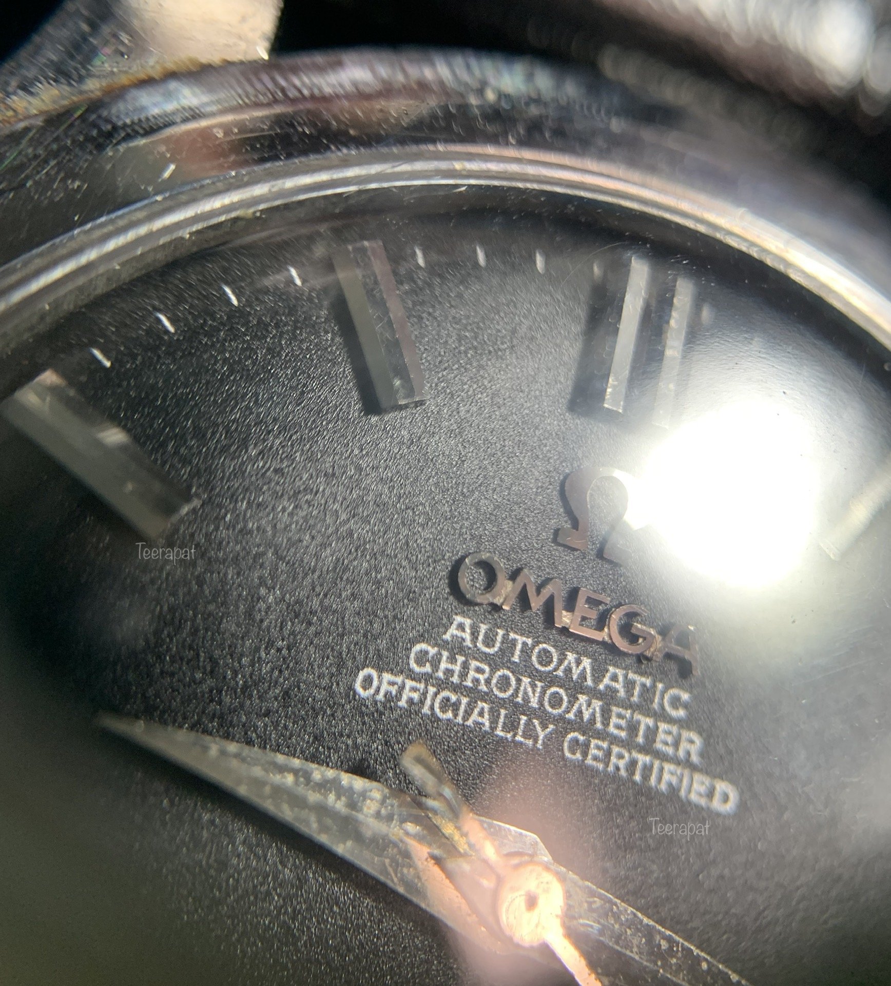

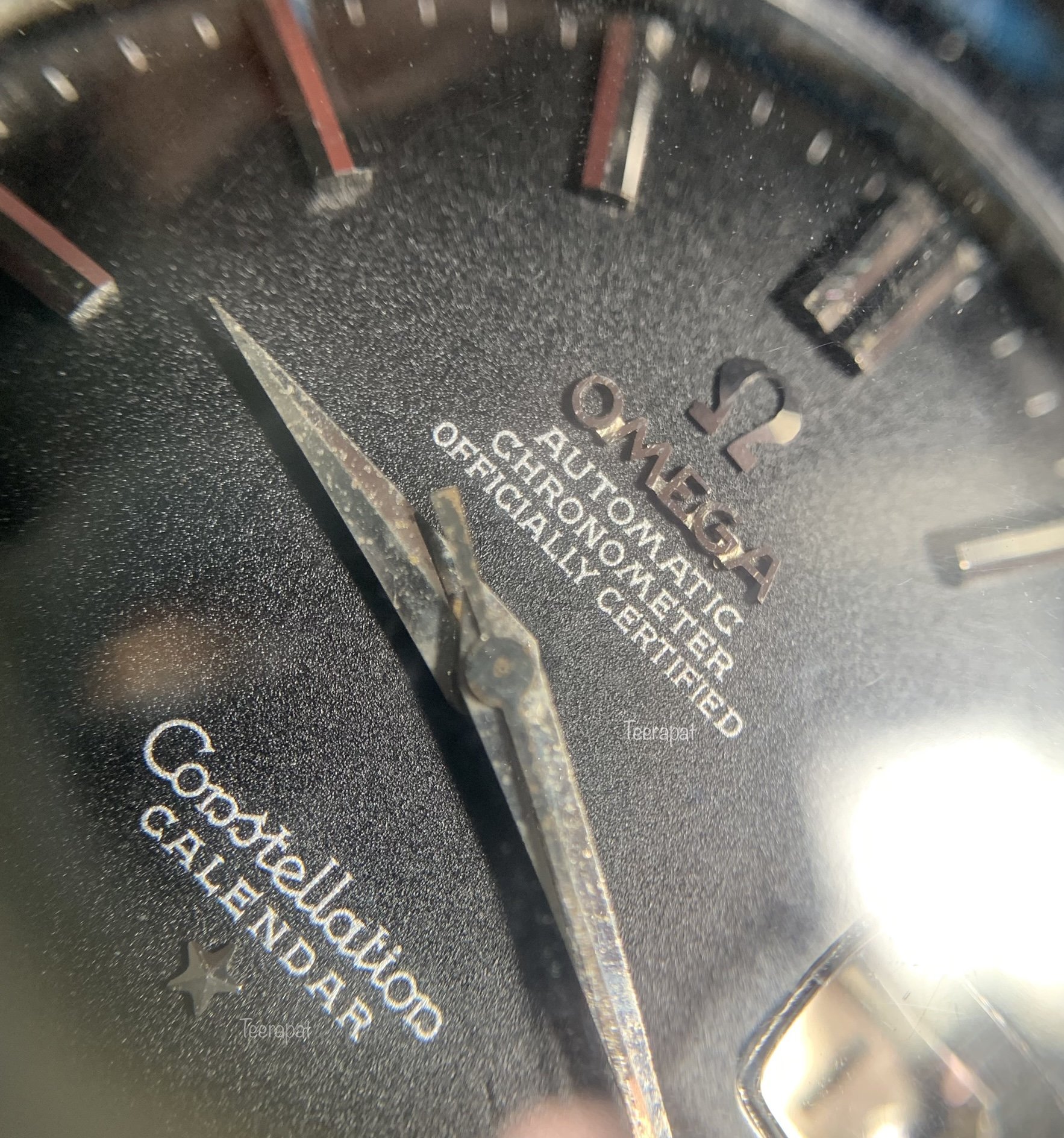

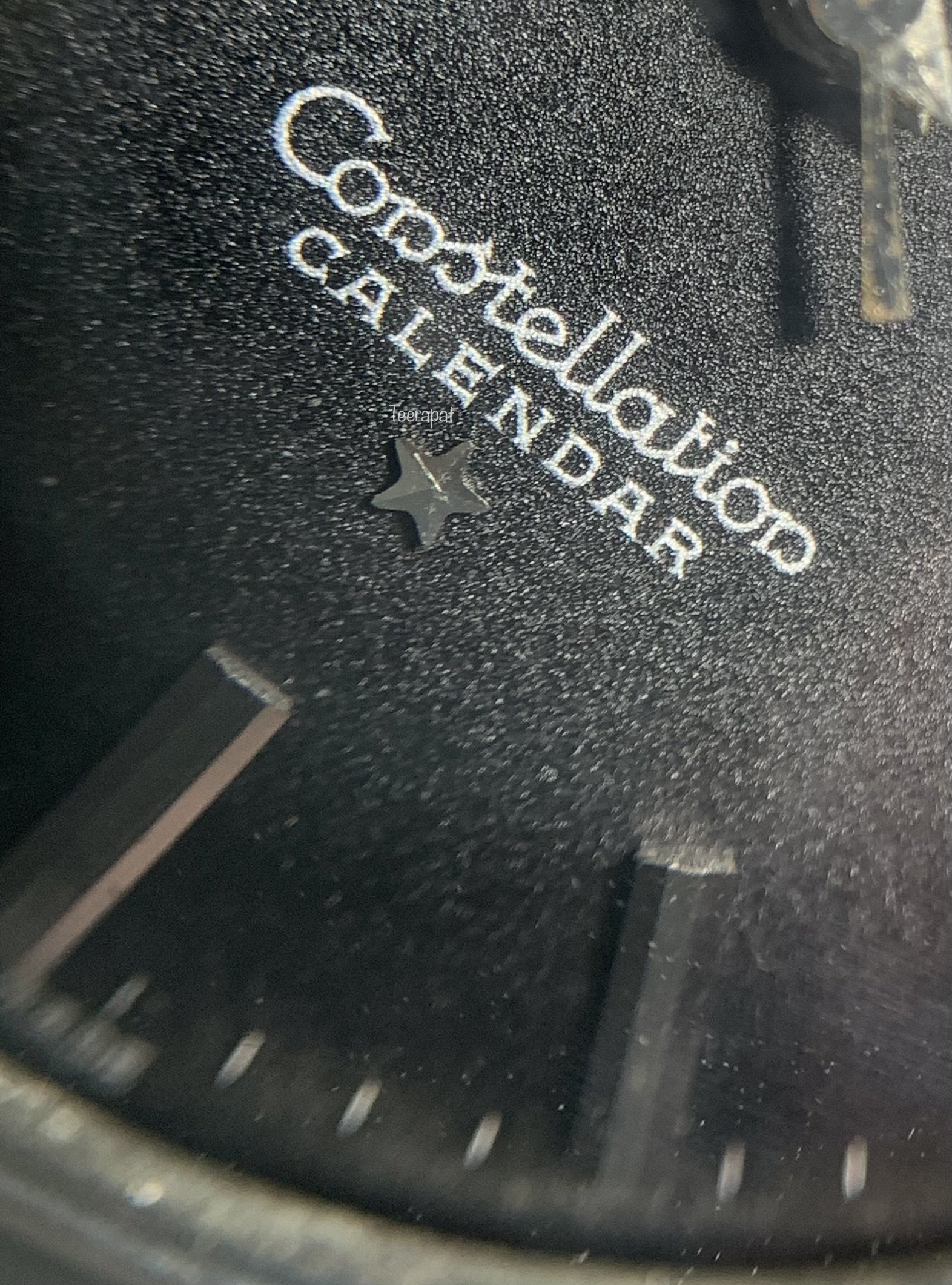

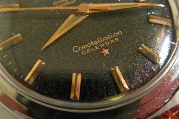

More close-up pictures of the font.
The black dial surface has a slight patina, plus unusually heavily serifed font. Please note the white spots are well spreading around the dial, as same as on the printed fonts. I assumed that it was the same production age.
In my humble opinion, it might be the original dial. However, if it was redialed, then it’s done by very professional people.
My wrist shot:

Nice research
If yours doesn’t look like Mike’s then something is up.
my eyes tell me the “n’s” in Constellation with yours are too uniform and the “M” should have a straight leg. All like Mike’s
Another dial maker?? Maybe. But only one have surfaced?
Whatever, you have a very nice Constellation to wear and enjoy.
8,286
29,309
I'm no expert on the model, but the serif on "CALENDAR", in particular, leads me to a redial conclusion.

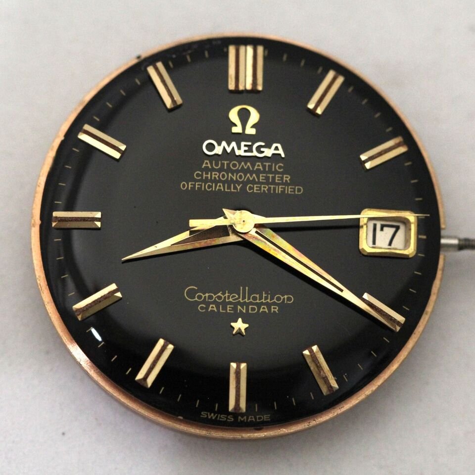

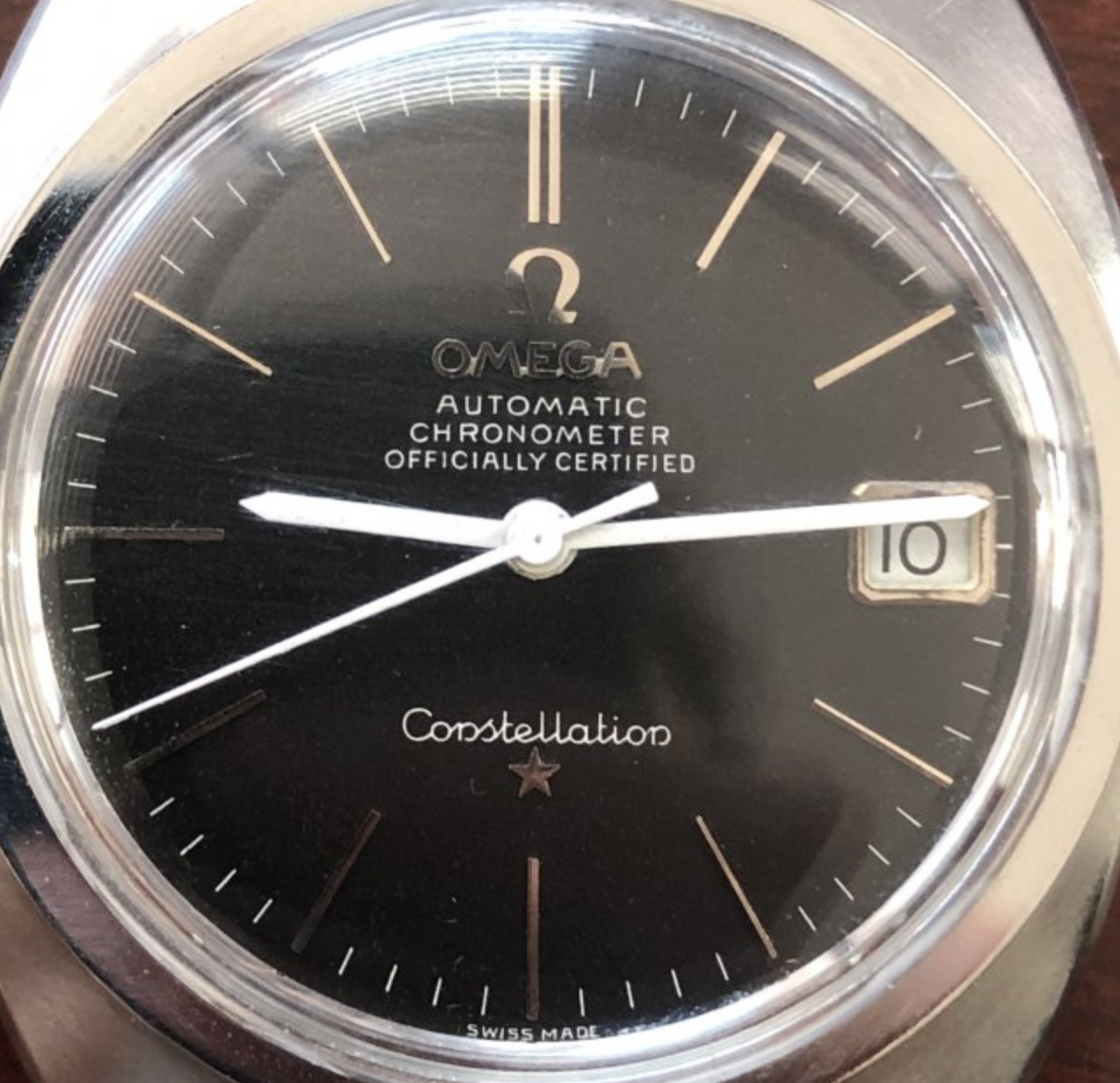

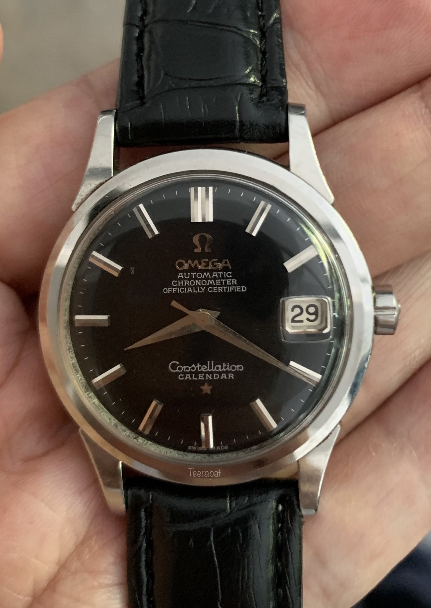

Finally, my friend just sent me this black dial. Unfortunately, we didn’t know the movement number. It could be another uncommon pattern in this reference without “OFFICIALLY CERTIFIED” and “CALENDAR”. But for me, it looks legit font.
Please note the ‘slant M’ in CHRONO’M’ETER word can be correct for this reference too. It’s the only one example I found with ‘slant M’ in this reference.

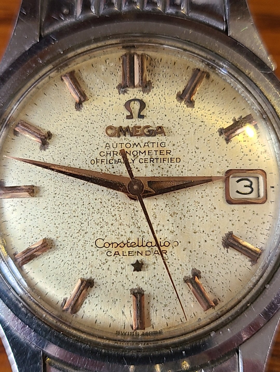

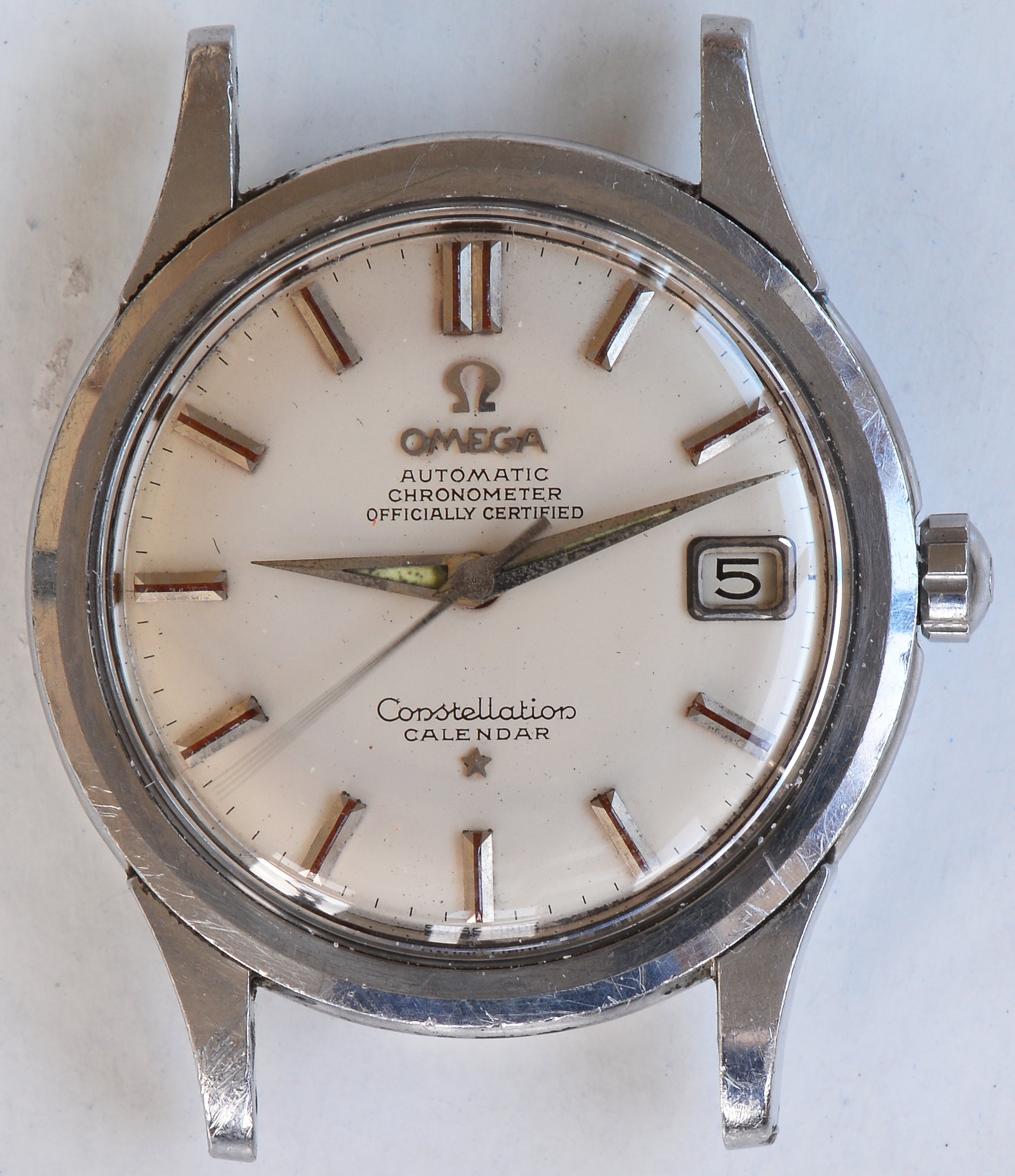

Another example of mine for reference - this one in a stainless steel case. Similar condition to my gold cap version.
1,024
4,126
Another outstanding example, Mikes.😀

Based on your macro photos, Teerapat, if it is a redial, I agree that the artist was very talented.
1,024
4,126
Could not agree more @Tony C. .
Perhaps that individual could undertake the task of painting my car and my house.

In my opinion, this is a redial. Omega did not use this type of granular paint finish on their black dials from that era. It almost looks matte.

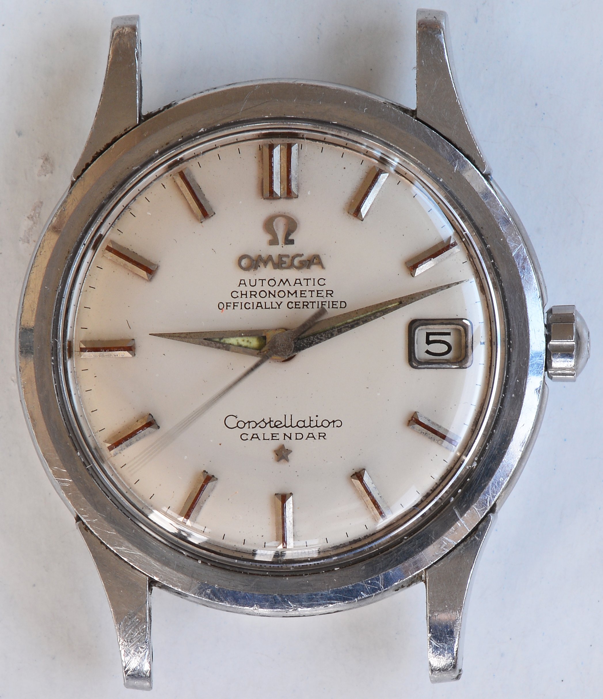

White dial with serif font. Kinda forgot I had this. 😀

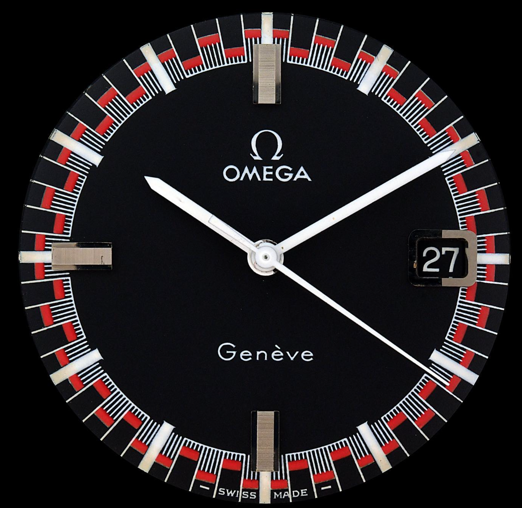

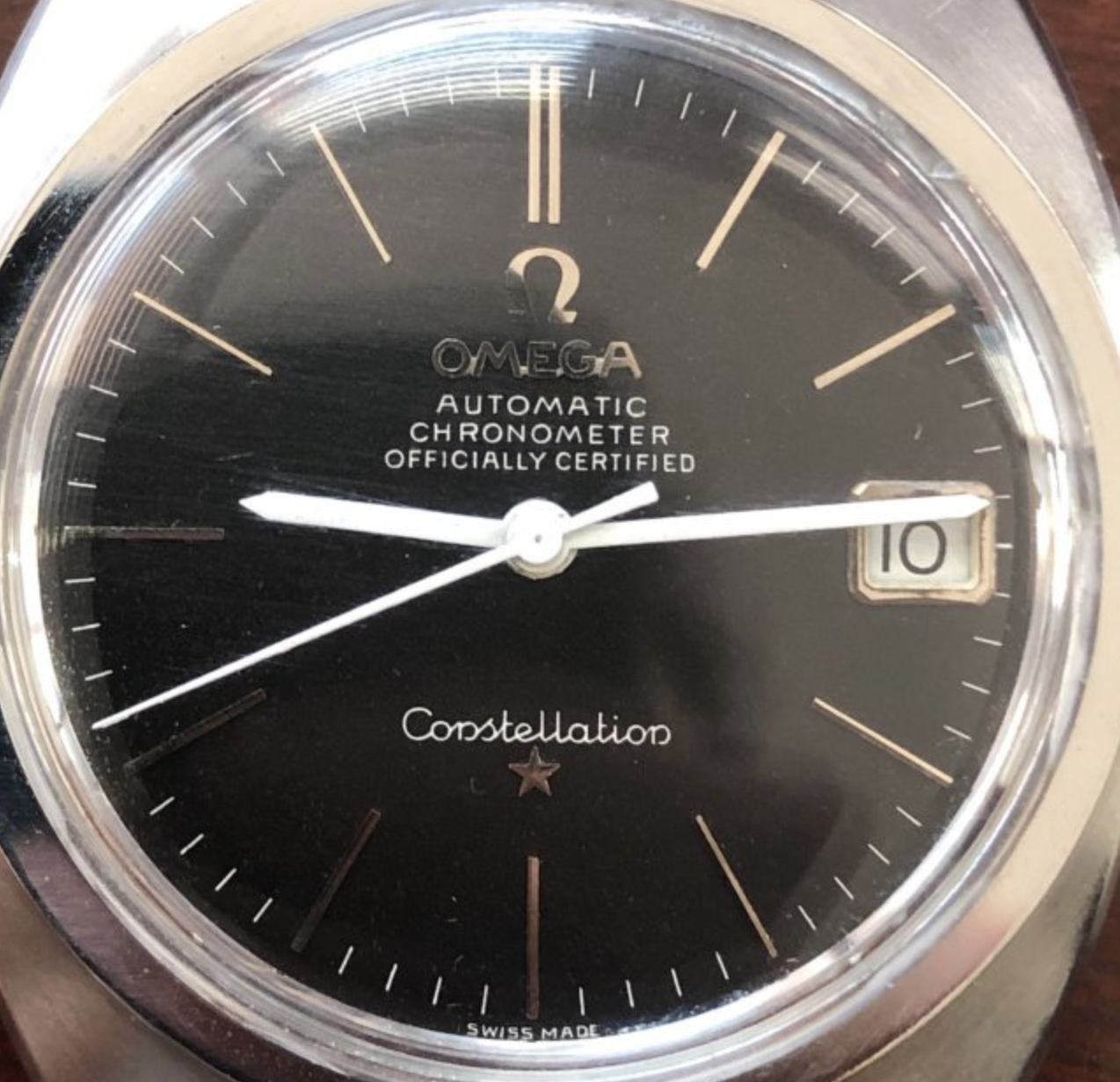

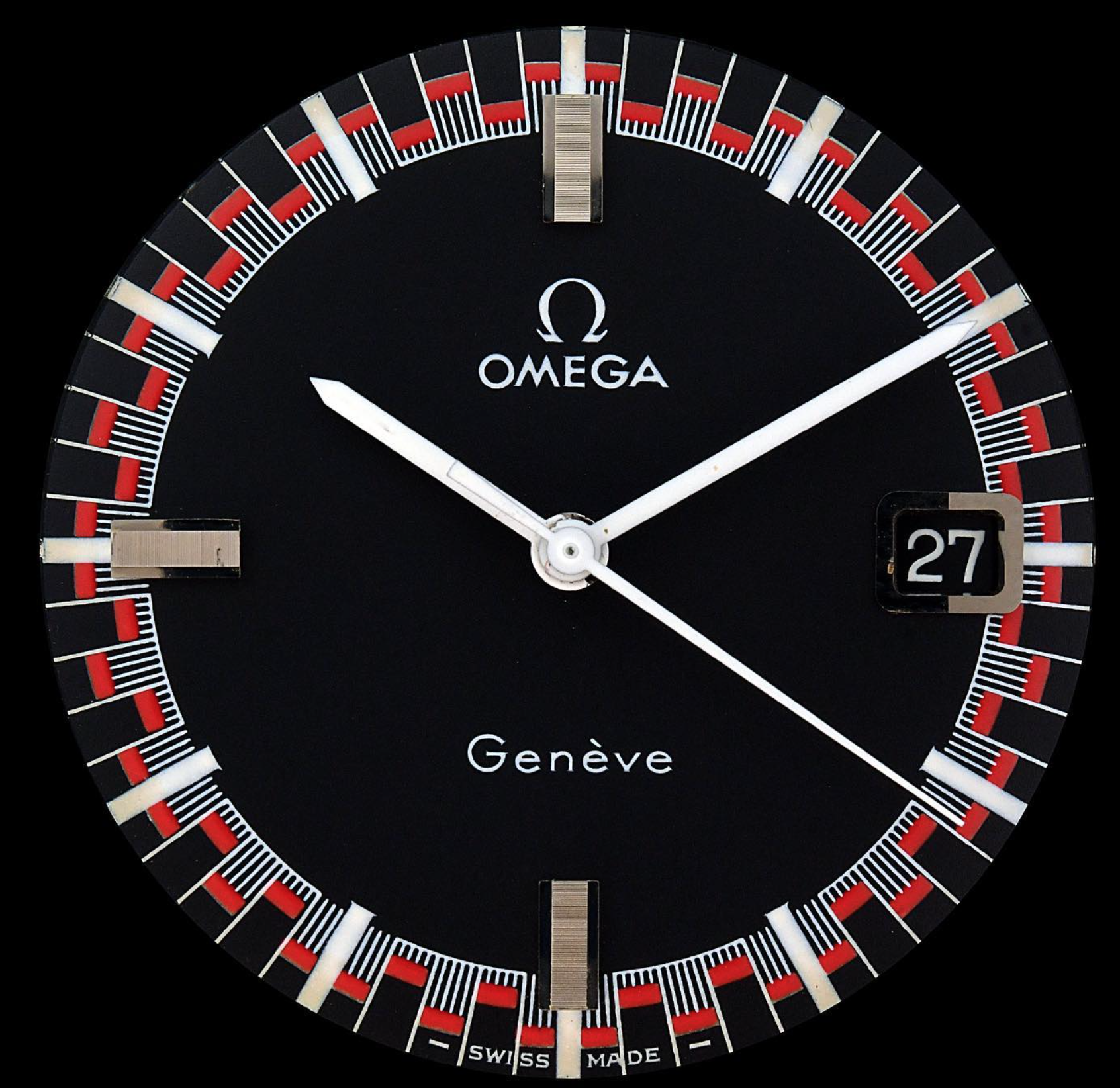

My .02 is there is a unique C-Case with such a black dial:
You can see my, maybe unfortunate journey here:
https://omegaforums.net/threads/1966-matte-black-c-cased-constellation-a-good-re-dial.136285/
As I'm used to the quality of Constellation's - I assumed hands were painted later on, so I depainted them, only very later on to discover this watch was 100% original in every way (5-6 exact examples seen later on)
After what's done is done, I didn't go back and paint the hands though, it's part of this watches journey, from a companion watch of sorts, it was pulled back to being a more proper Constellation
My theory is that a US manufacturer made these dials / watches

I would say redial too, but the backside of the dial looks clean to me...
Very nice watch though

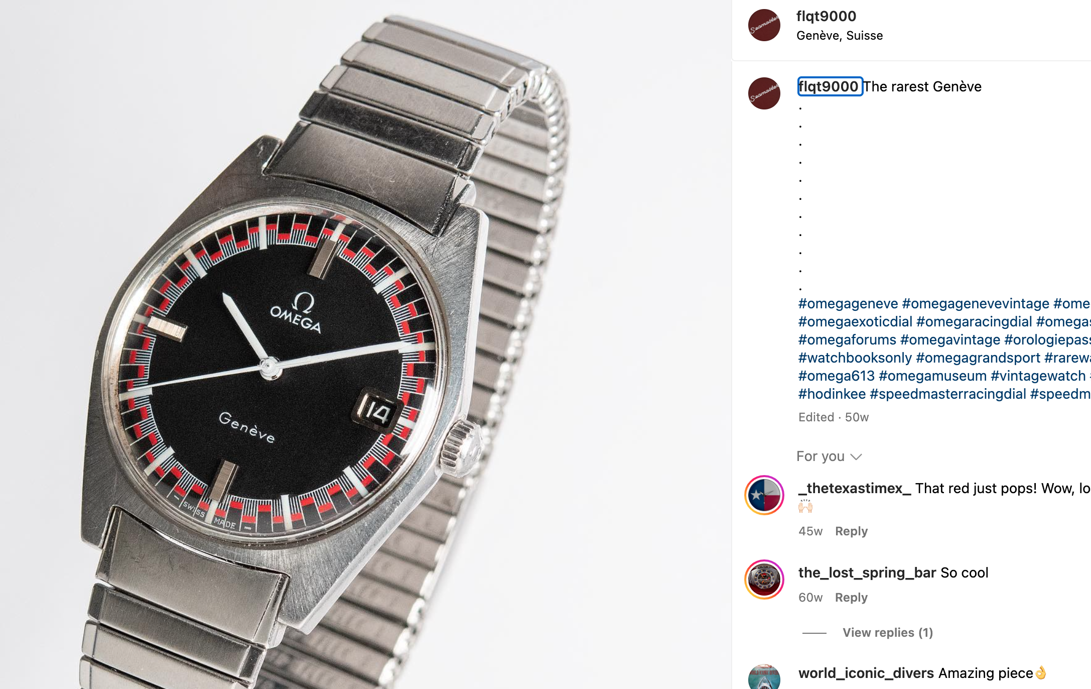

@flqt-9000 was very instrumental in tying my C-Case to these unique Geneve's - he had a macro shot of the hands, it was 1:1 matching the paint quality on mine, low quality paint versus perfection of Constellations
I suspect this dial could be original, and from the same dial manufacturer that made these Geneve's and my low # C-Case model
The question is, even if there is a tie, was that manufacturer around ~10 years ago for this model, maybe, and maybe they just produced a service dial and this is a service dial

I believe that it’s the heaviness of the serifs on Teerapat’s dial that is in question here not just the white script.
Where is the connection to Teerapat 's Constellation?
