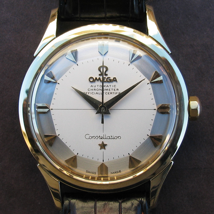

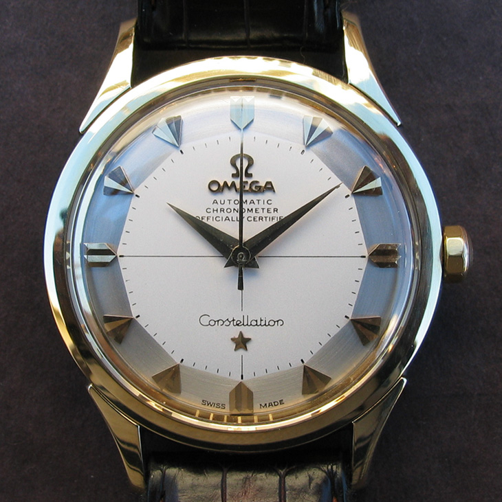

1st example, a 1957 Connie. A decent job from a US-based dial refinisher, but the cross-hairs are a no-go and chronometre was spelled wrong.

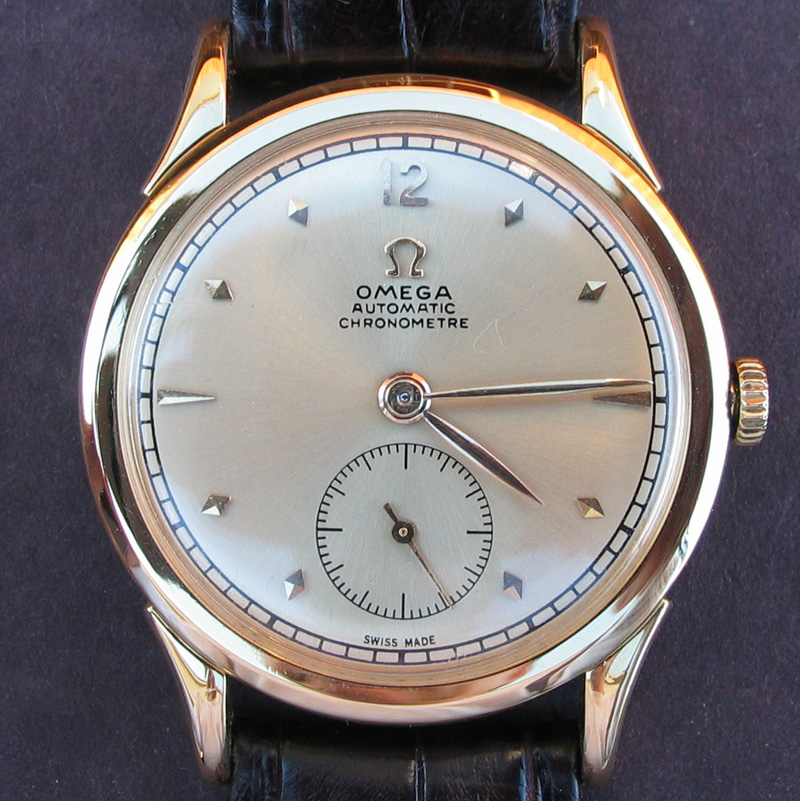

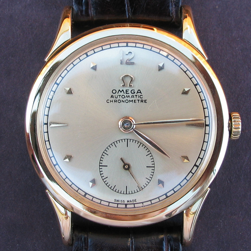

2nd example, I found a beautiful 18k bumper chronometre that had an excellent case and a great movement. The dial was very poor, so I sent it off to a Germany-based dial refinisher. Here is the result. Not bad, but printing is too thick.

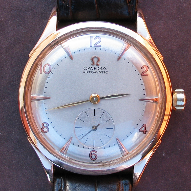

OK, let's try this again. Found a really nice 18k rose gold Cal. 30.10 automatic. One more time, maybe it will turn out good . . .
Ah-ha, finally a decent result. But don't look too close - you will see the flaws.

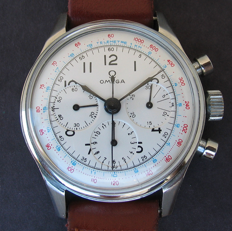

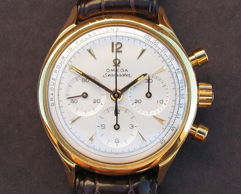

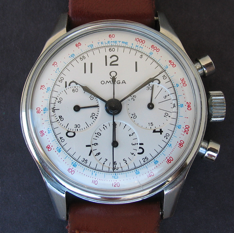

Tried two more and they turned out just OK - this 1943 chronograph

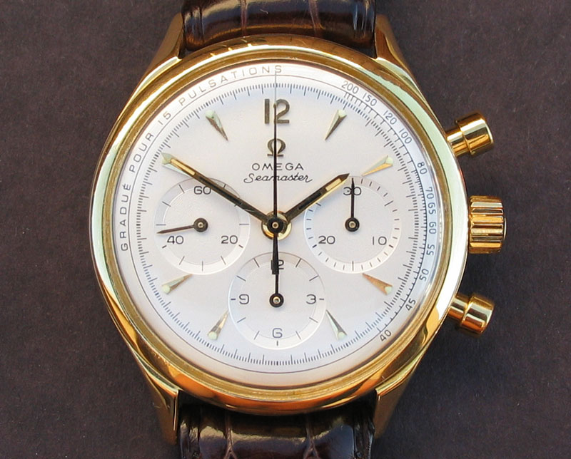

This was the best refinish job ever
Missing "Swiss Made" on the bottom of the dial left me wanting and I let it go - even though a really nice 18k yellow gold case with a Cal. 321.

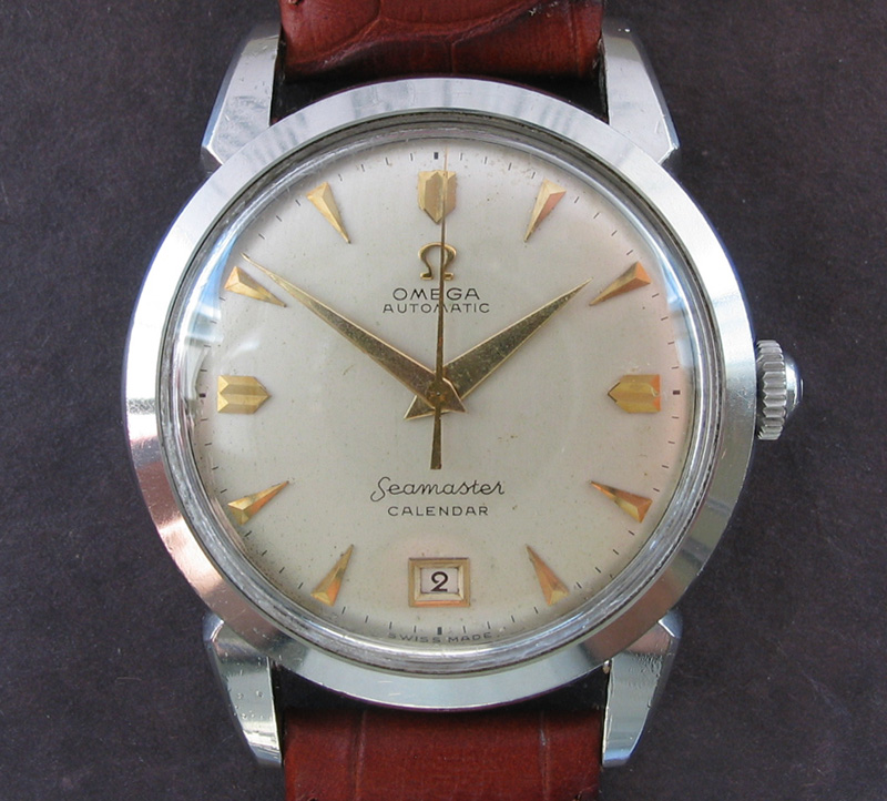

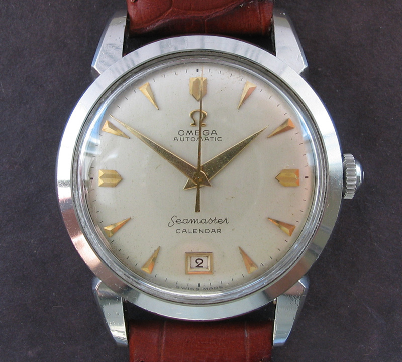

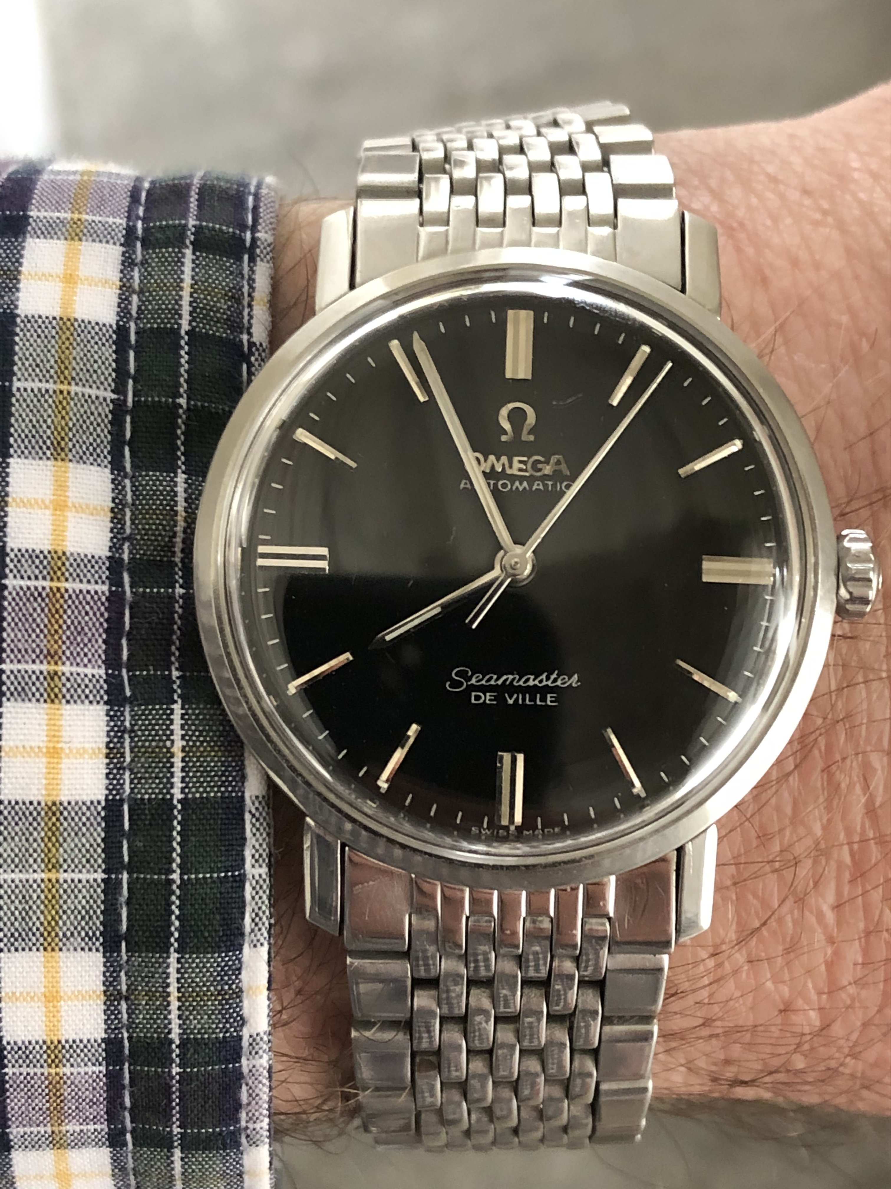

Look at this mid-1950's Seamaster Calendar I purchased a few years ago for about $400. It's not perfect, the case has a few dings, BUT - the dial is original. Yes it has some age, but I think it also gives it some character.

Thanks for the informative post and photos. Just curious -- I'd have a tough time accepting the misspelling. Did you ask if that one could be redone or for your money back?
Yes, I called to complain but did not get anywhere. If I wanted it redone I would have to send it back and then pay the full price again. I said forget it and moved on. Lesson learned - be very, very specific about what you want done and submit clear diagrams/pictures. Then there is a chance the dial refinisher could still screw up. It's a risk.

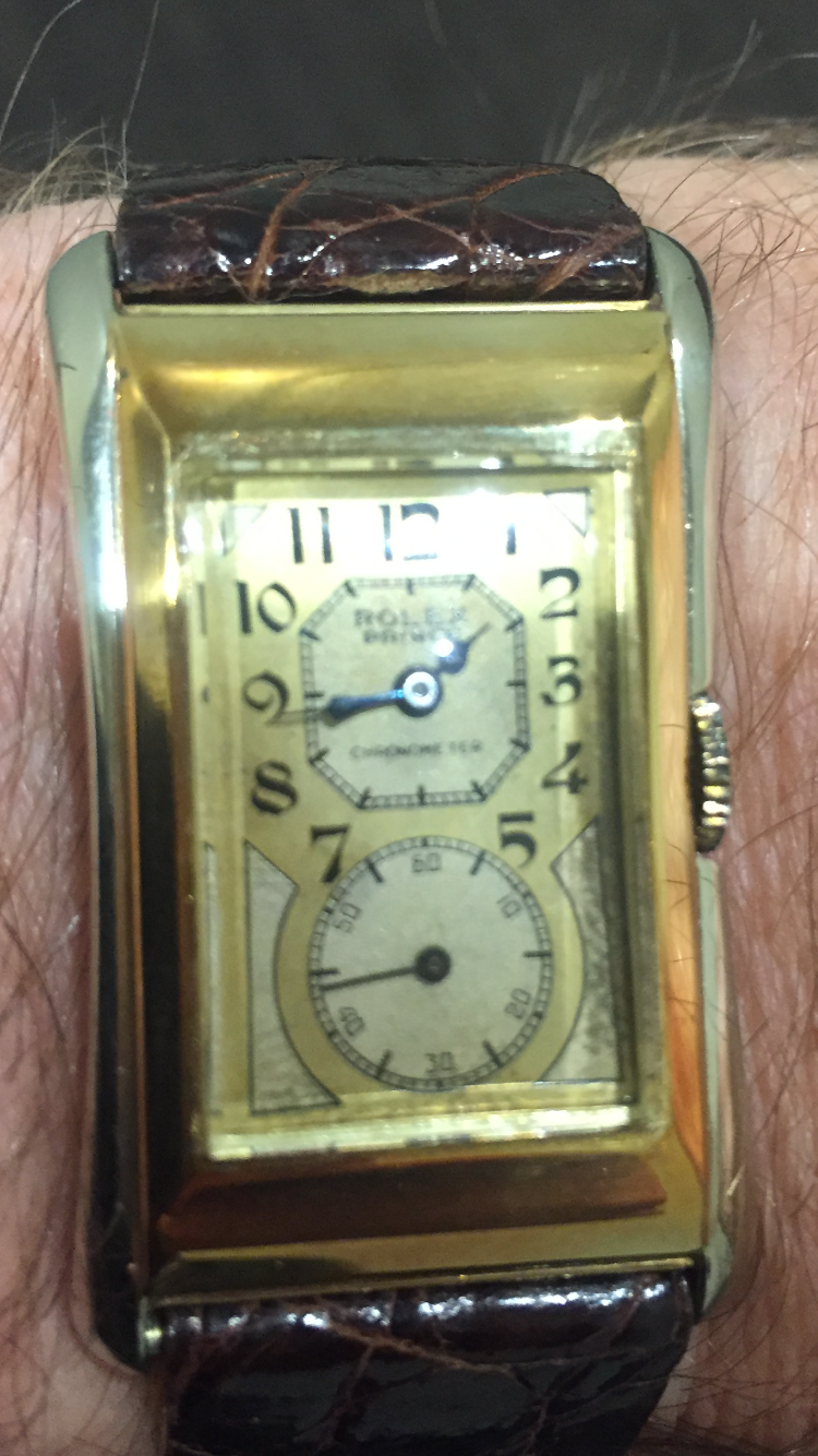

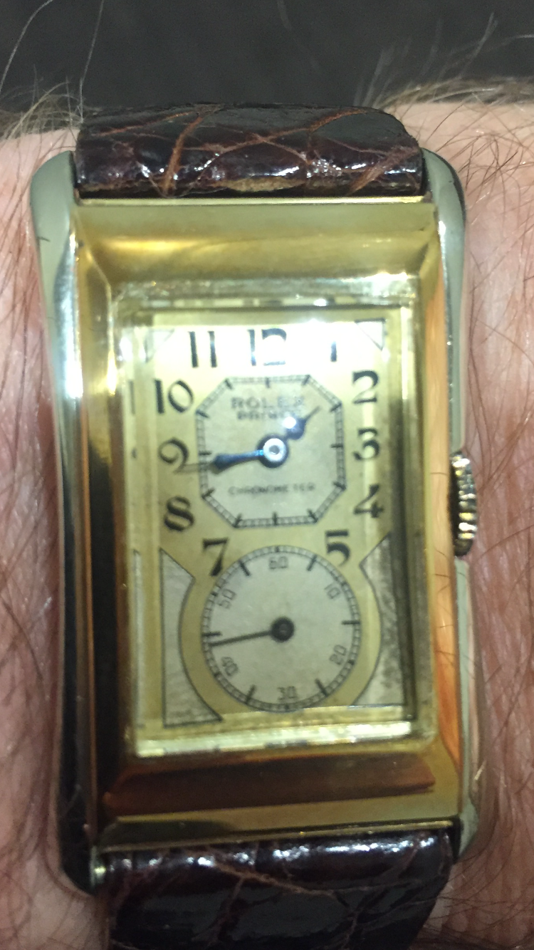

I only had one re-dial done in all my years of collecting, it was a Rolex Prince from the 1930s, the dial was not in the best of shape, but acceptable, and the dial did not have the word, "Prince" on the dial. I sent it off to be professionally re-dialed and it came back looking great, but, I later found out that all Rolex Princes did not have the word "Prince" on the dial, my OCD kicked in and I sold the watch and picked up another with a little better dial and the text I wanted, not perfect, but beautiful in its imperfection.
