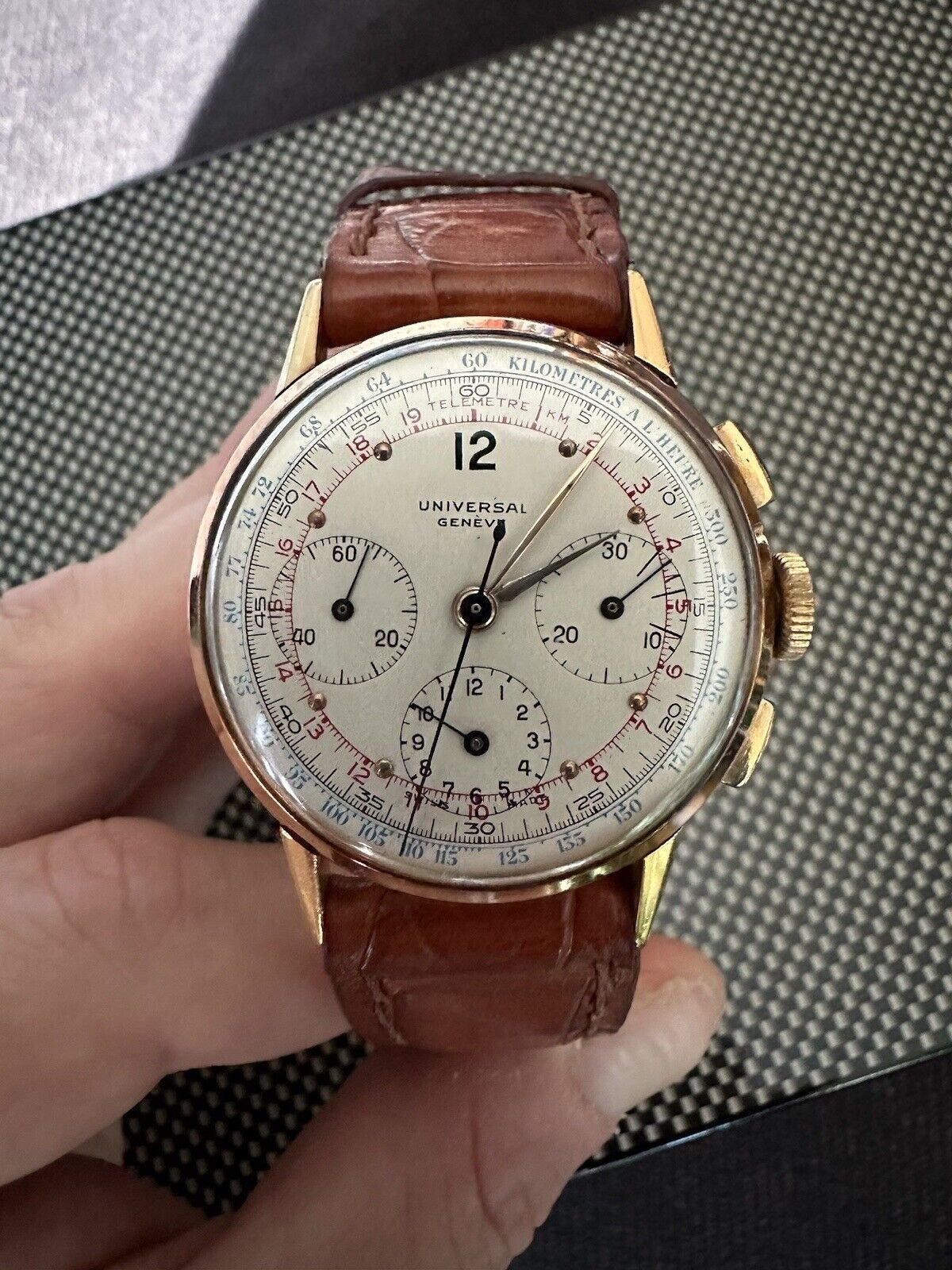

A Posts 7 Likes 3 AusPola ·Sep 20, 2023 Hey all, I'm hoping somebody will be able to point out any potential inaccuracies on this supposed original dial. Thanks!

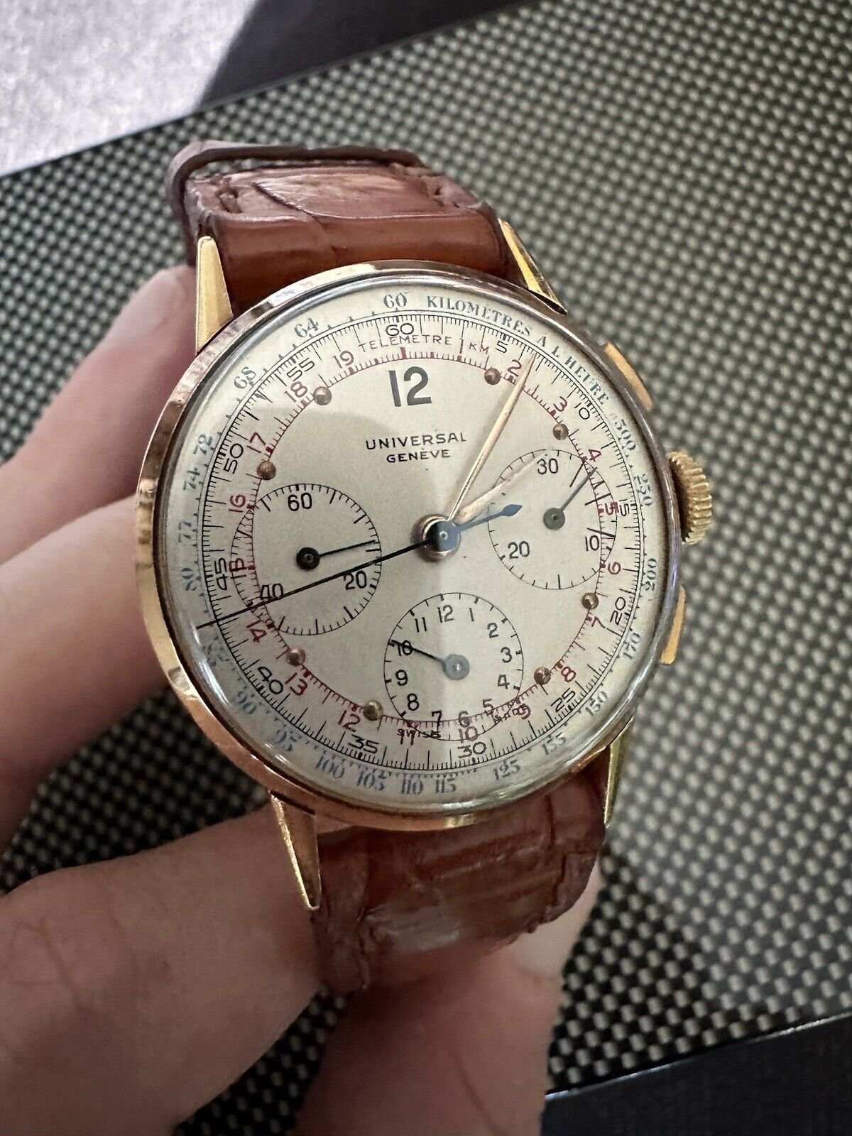

A Posts 7 Likes 3 AusPola ·Sep 20, 2023 Forgot the second pic :/ I'm feeling redial, but the spacing of the hour markers from the outer rim of the dial differs from the 12550 Sala has in his book. Curious now as to what this could have been in an earlier life?
Posts 3,677 Likes 8,482 bgrisso ·Sep 20, 2023 yes it's a redial, no point listing specifics, literally everything is wrong In terms of what it was originally, obviously it has applied numeral and hour markers but would help to know the case reference and serial
Posts 6,821 Likes 10,639 Mark020 ·Sep 20, 2023·not the sharpest pencil in the ΩF drawer Blatant redial

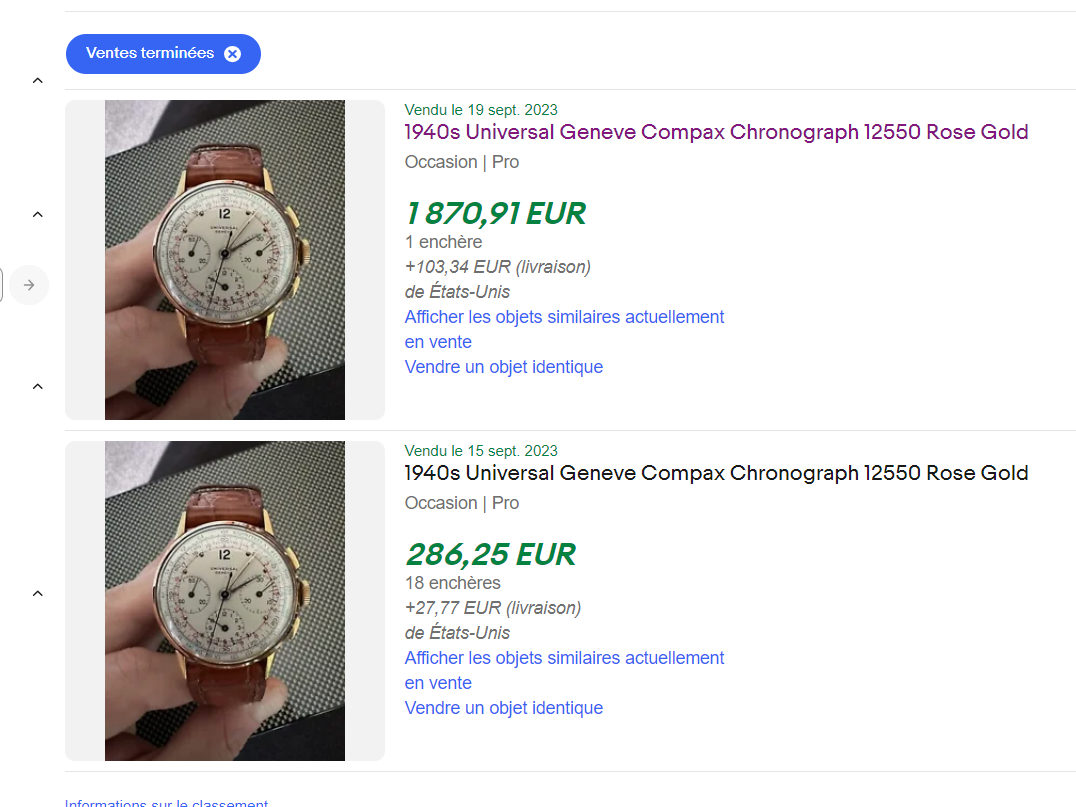

Posts 6,821 Likes 10,639 Mark020 ·Sep 20, 2023·not the sharpest pencil in the ΩF drawer It was on ebay (but for some reason the links are now kind of dead)
