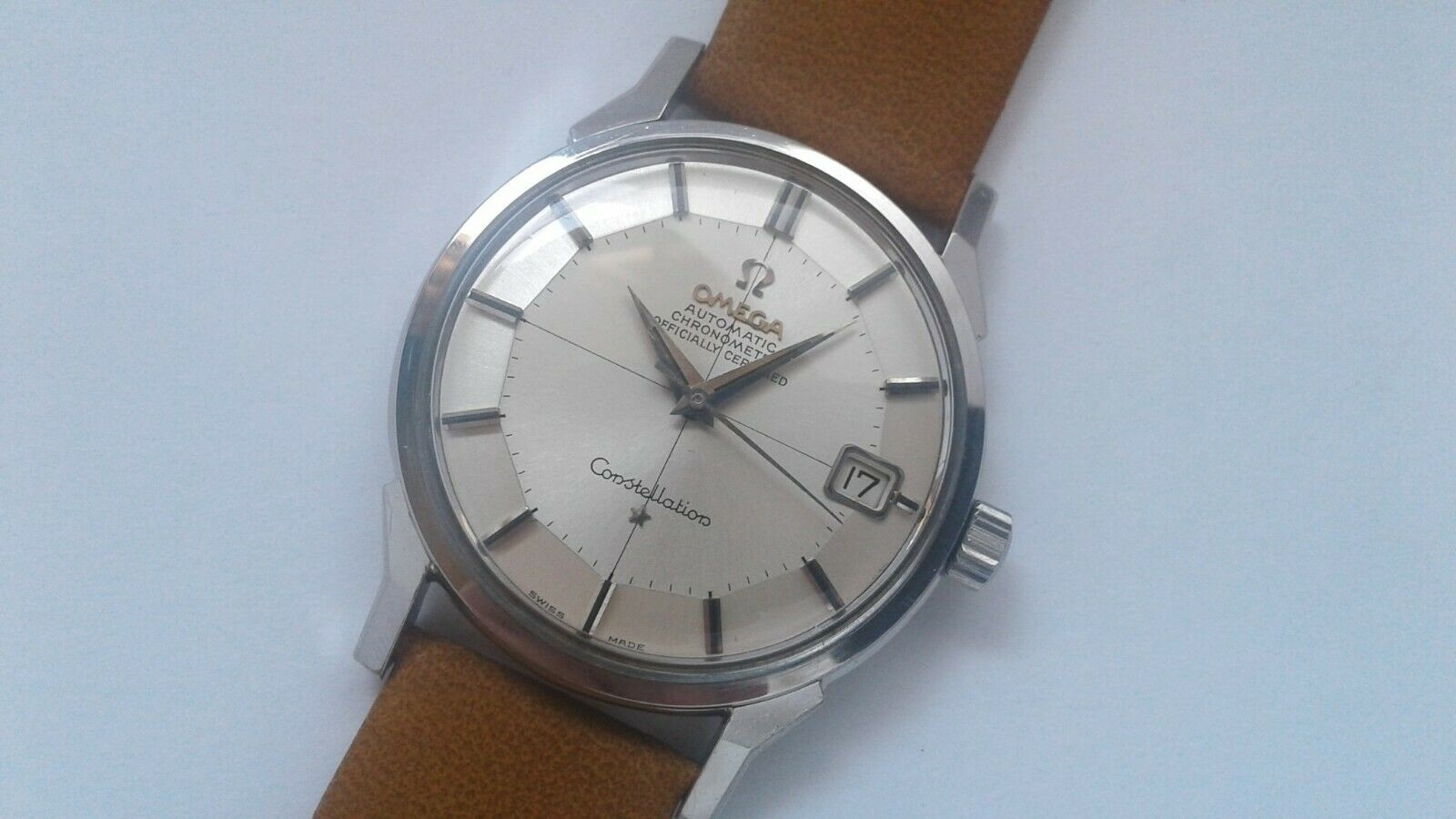

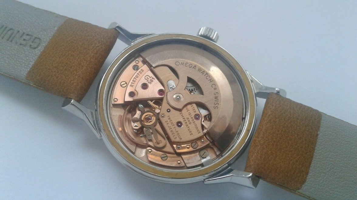

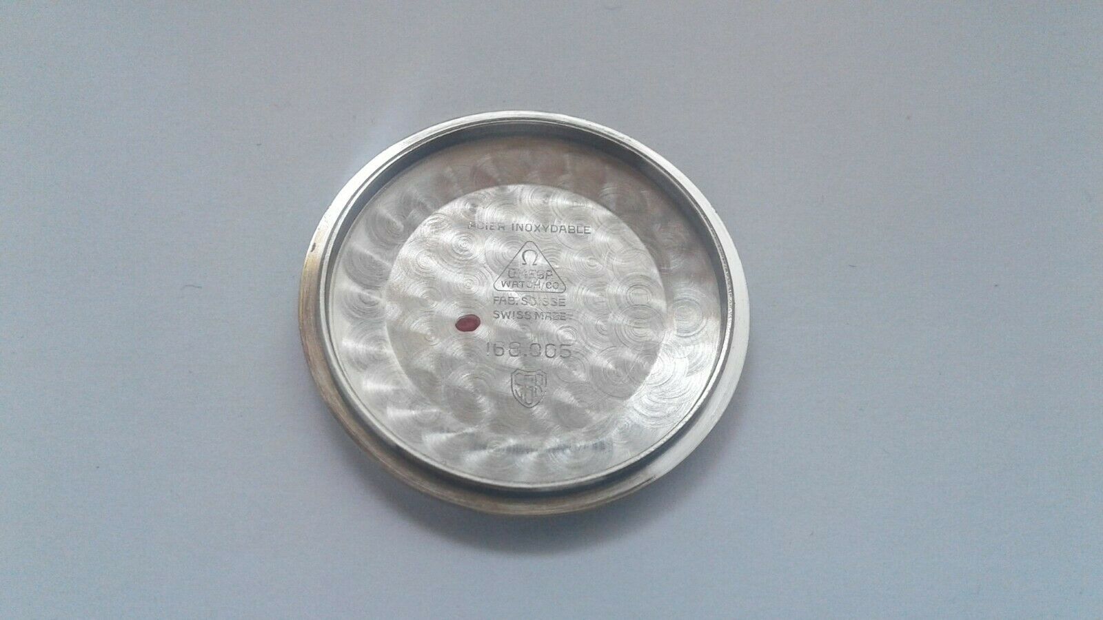

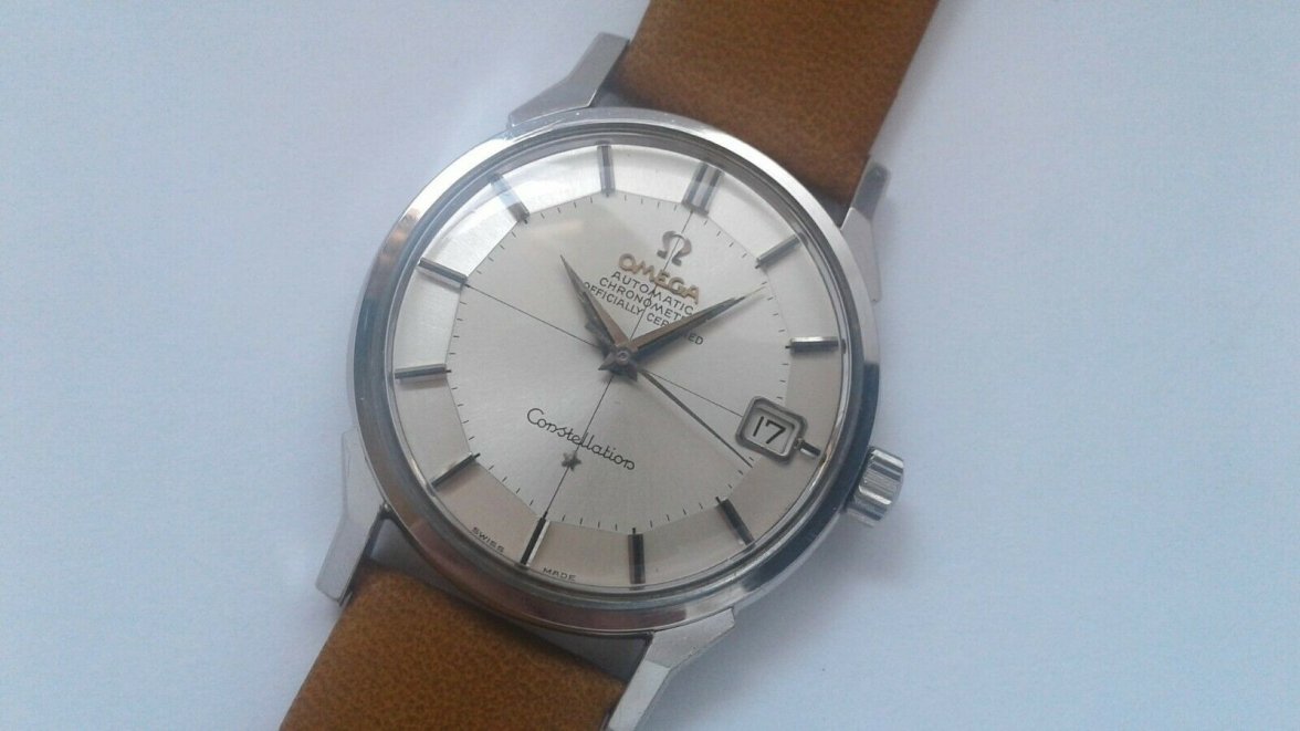

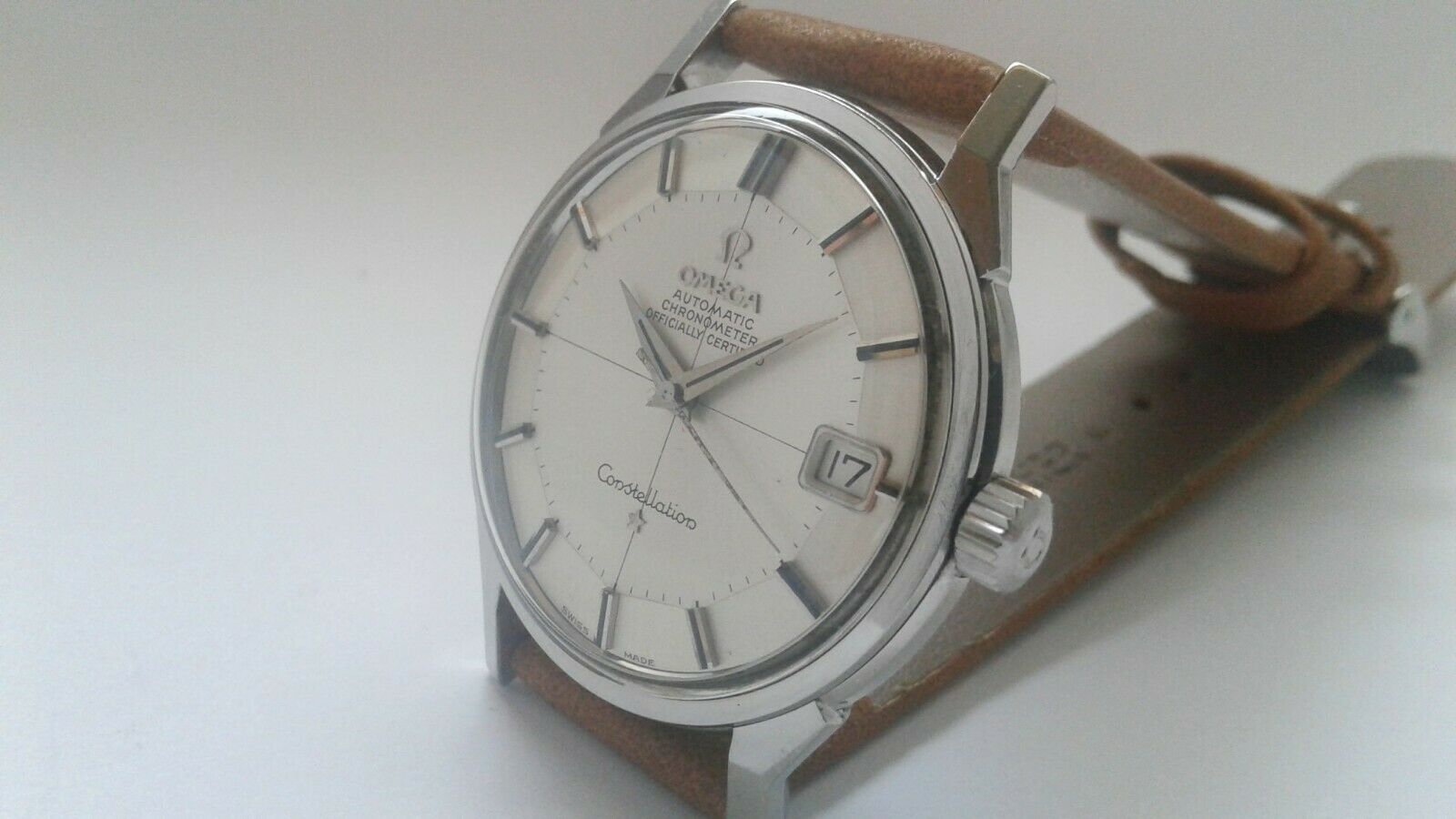

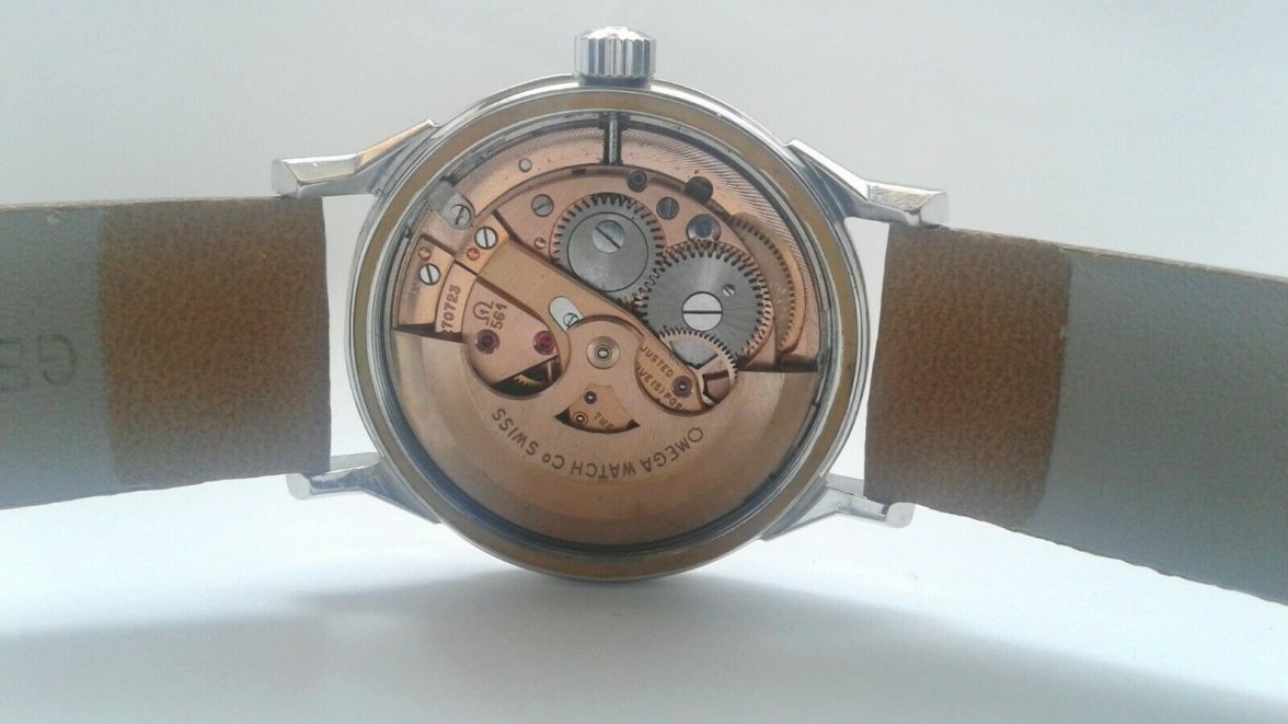

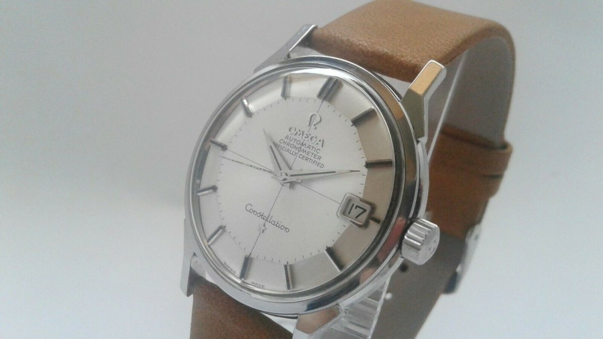

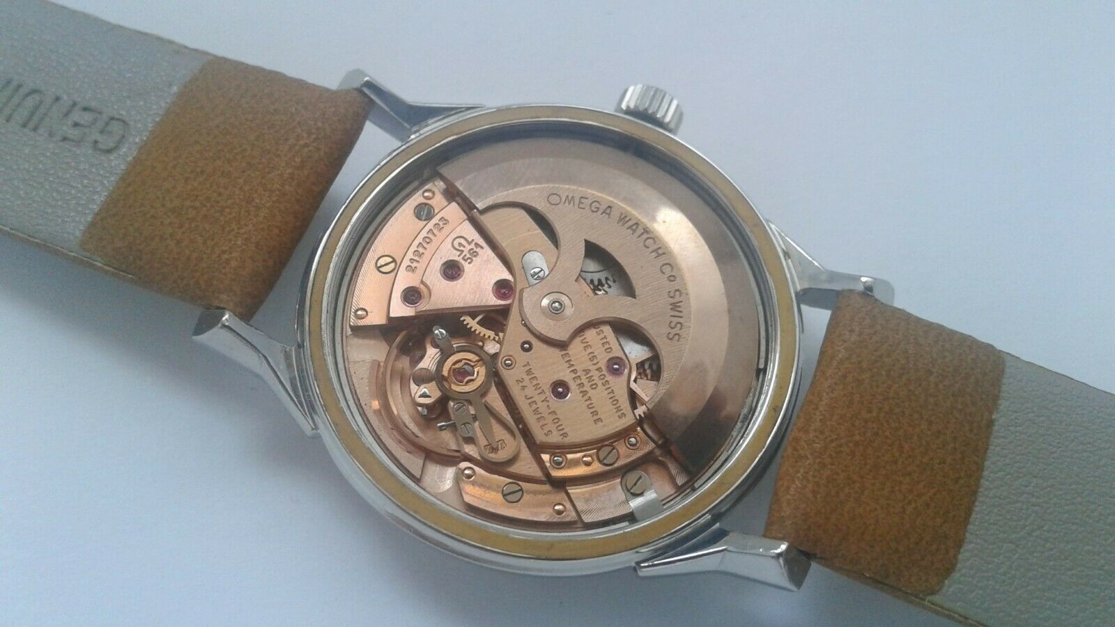

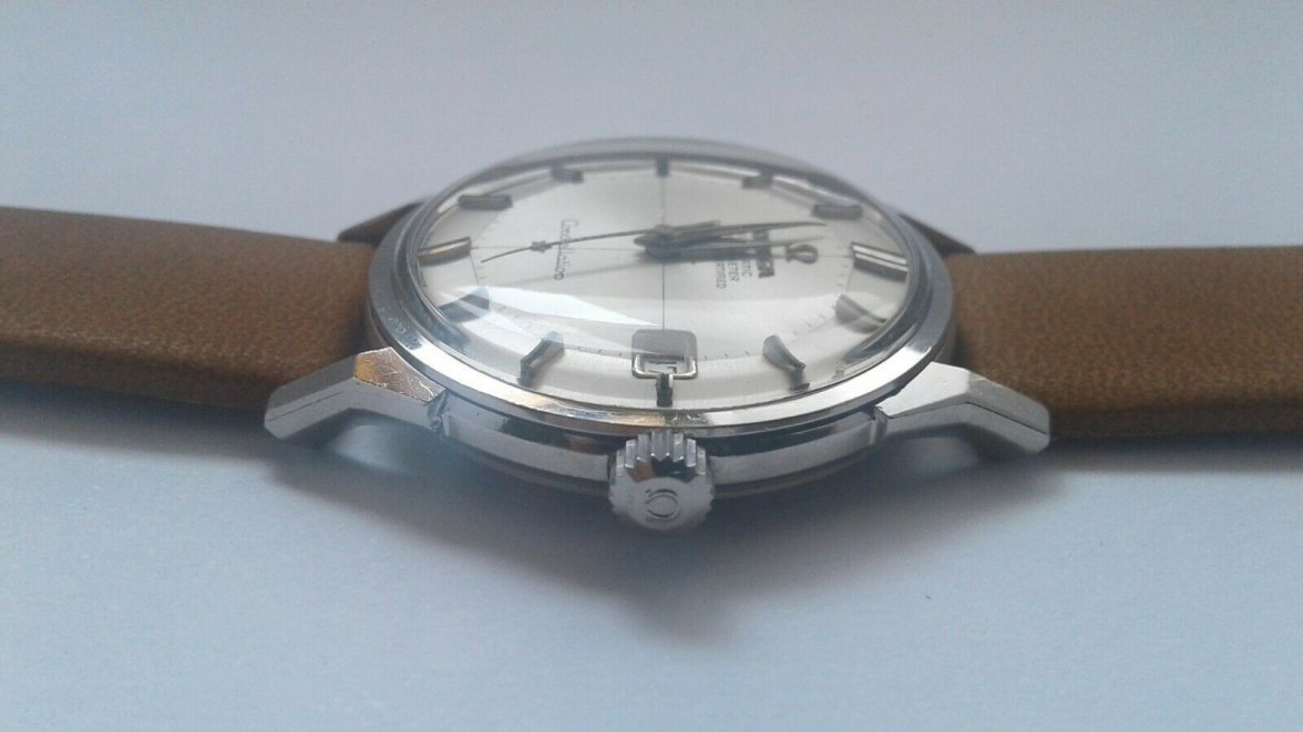

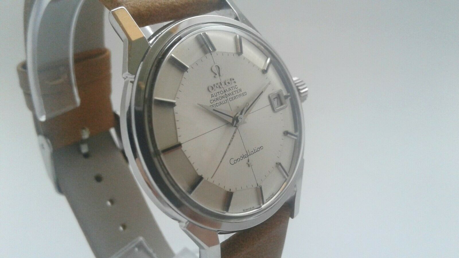

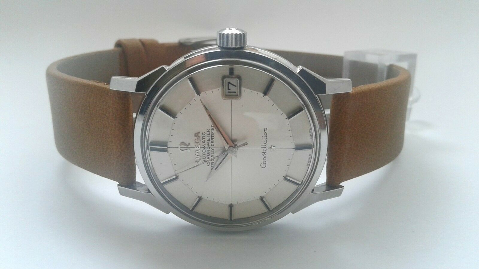

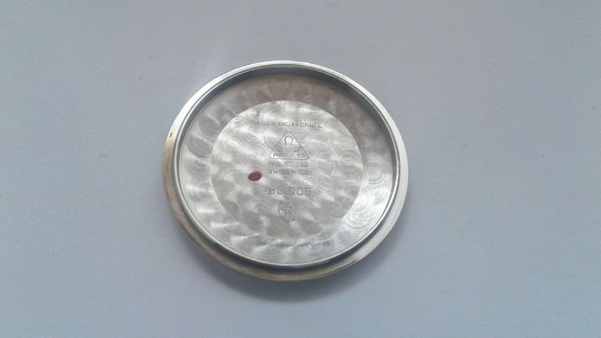

I am considering purchasing this constellation but I'm worried about its authenticity. I know there are fakes of 168.005 and the seller doesn't have that much of a reputation.
I'm pretty new to this whole thing so I'm slightly worried about getting scammed. I think the dial looks original, but I have no idea what that yellow stuff is in where the gasket is supposed to be.
What do you all think?
Hope everyone is doing well.
8,701
14,612
Who is the seller and how much is the seller asking? You also might want to do a little research on the "yellow stuff is in where the gasket is supposed to be".
32
9

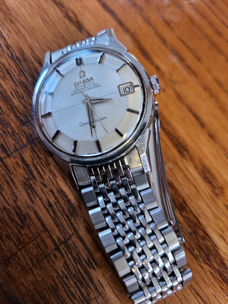

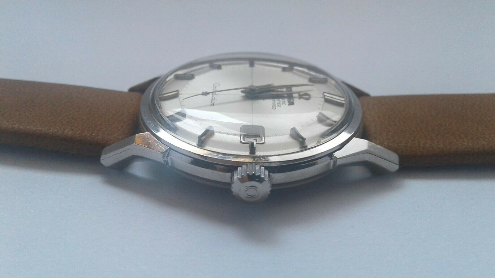

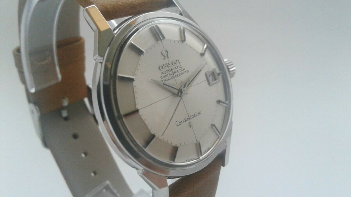

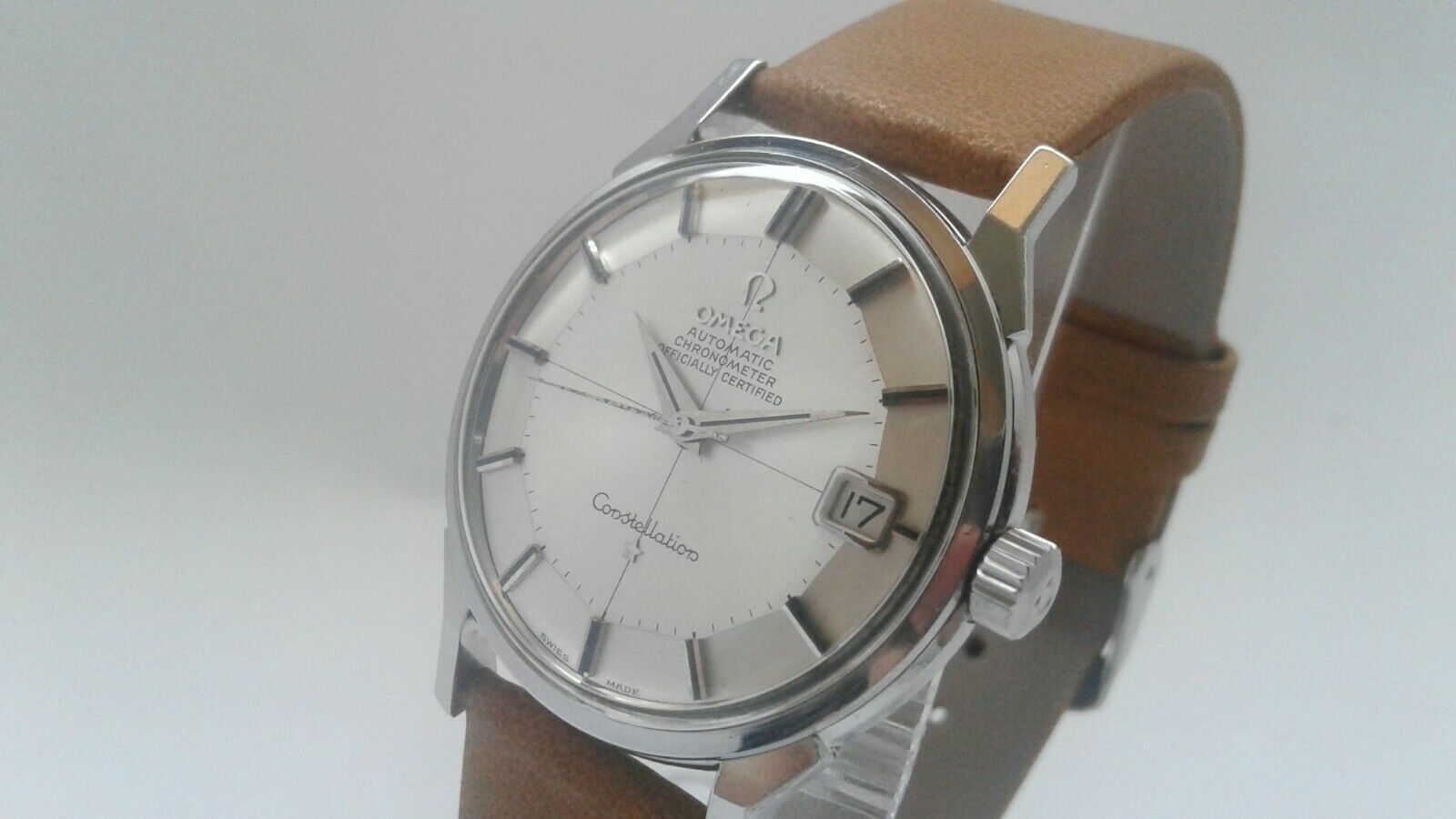

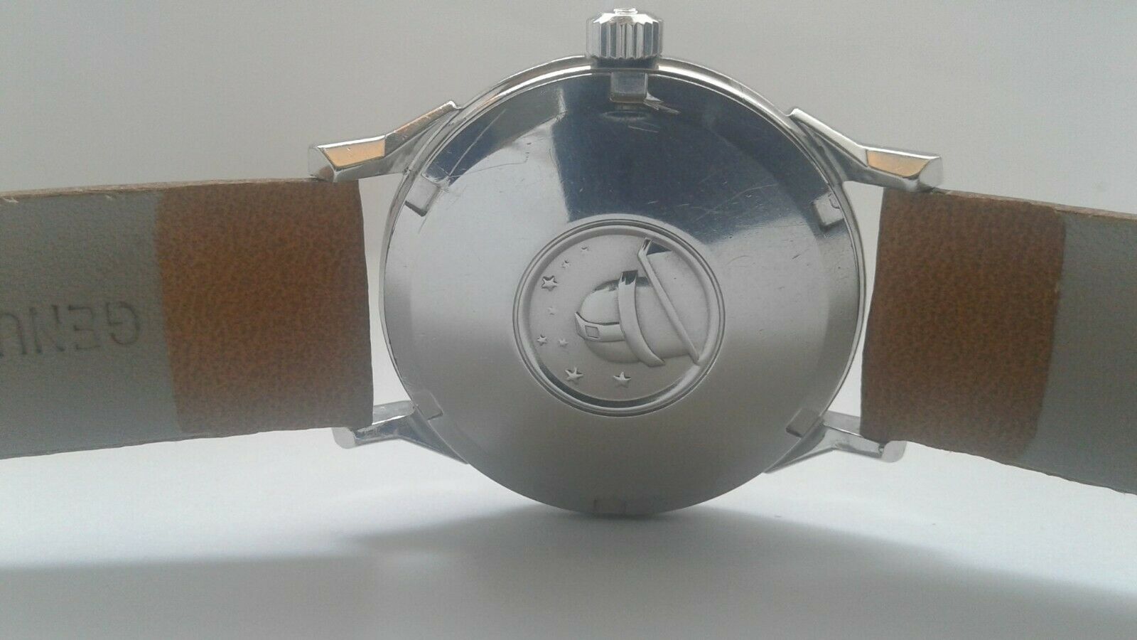

I'm not an expert, but I think the overall condition is good.

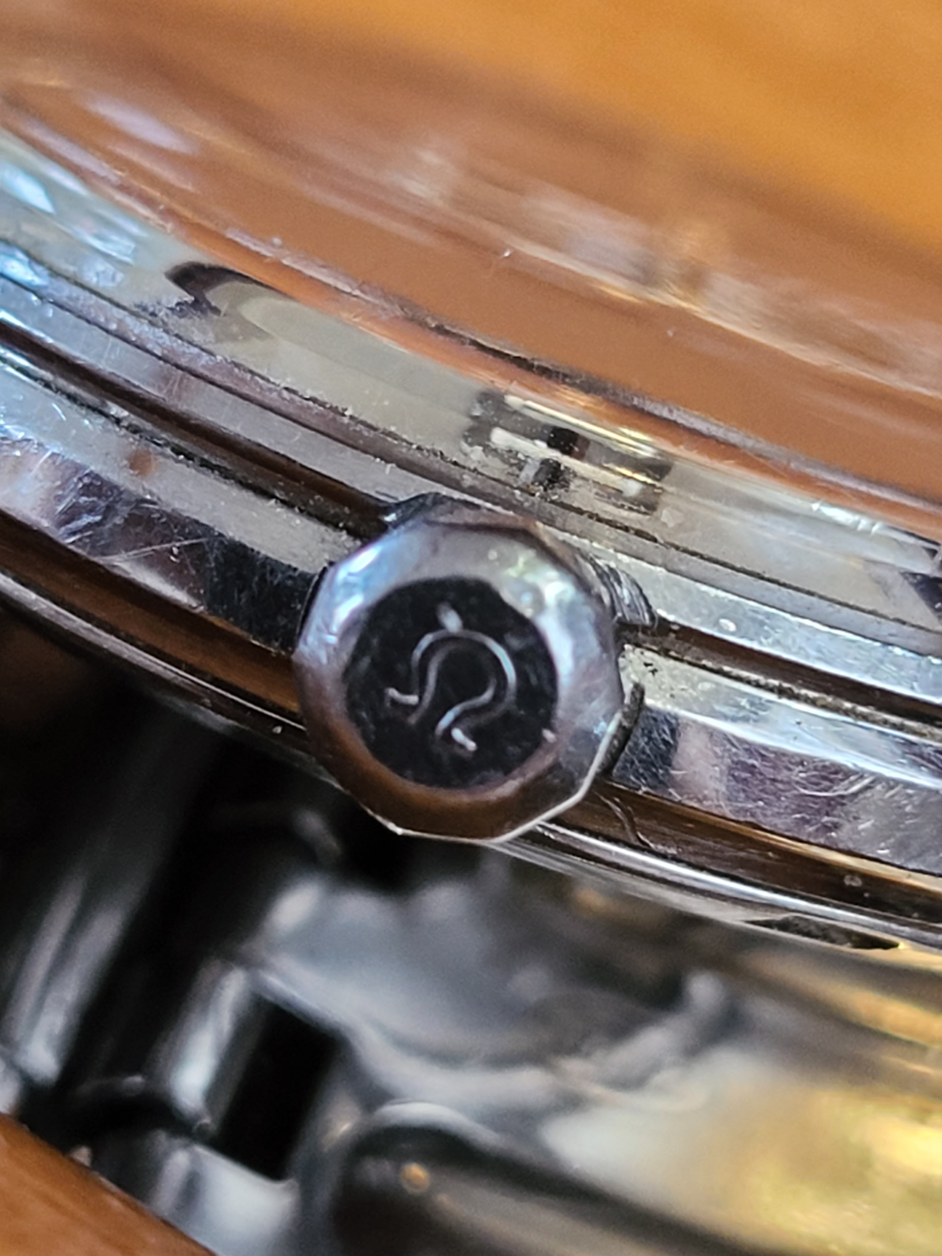

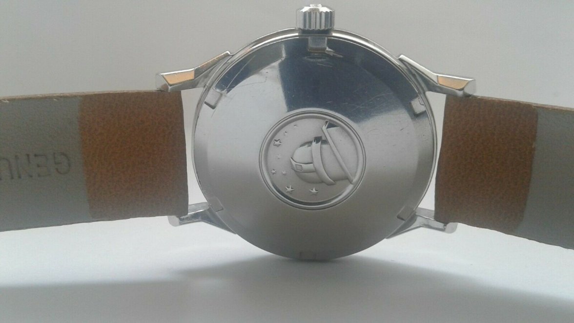

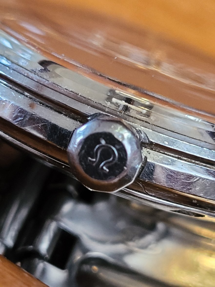

Dial seems original to me. Case/Case back have been polished (but not too much IMO). Crown is replacement.
The current price is good, but a service is probably needed... so you need to include that in your offer.
Let's have some other opinions...

@noname262
It’s a good looking watch.
Not super-crisp but pretty good for all that.
nice pie-pan dial.
At $860 it would be a bargain but expect it to go higher.
BTW the ‘yellow stuff’ is a period correct gasket - so it definitely will require a service.

@noname262
Did'nt knew this. I've always wondered about this type of gasket. Thnx!
377
2,950
Something I learned as well 😀 but it does say in the description 😀

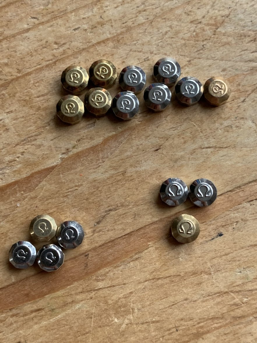

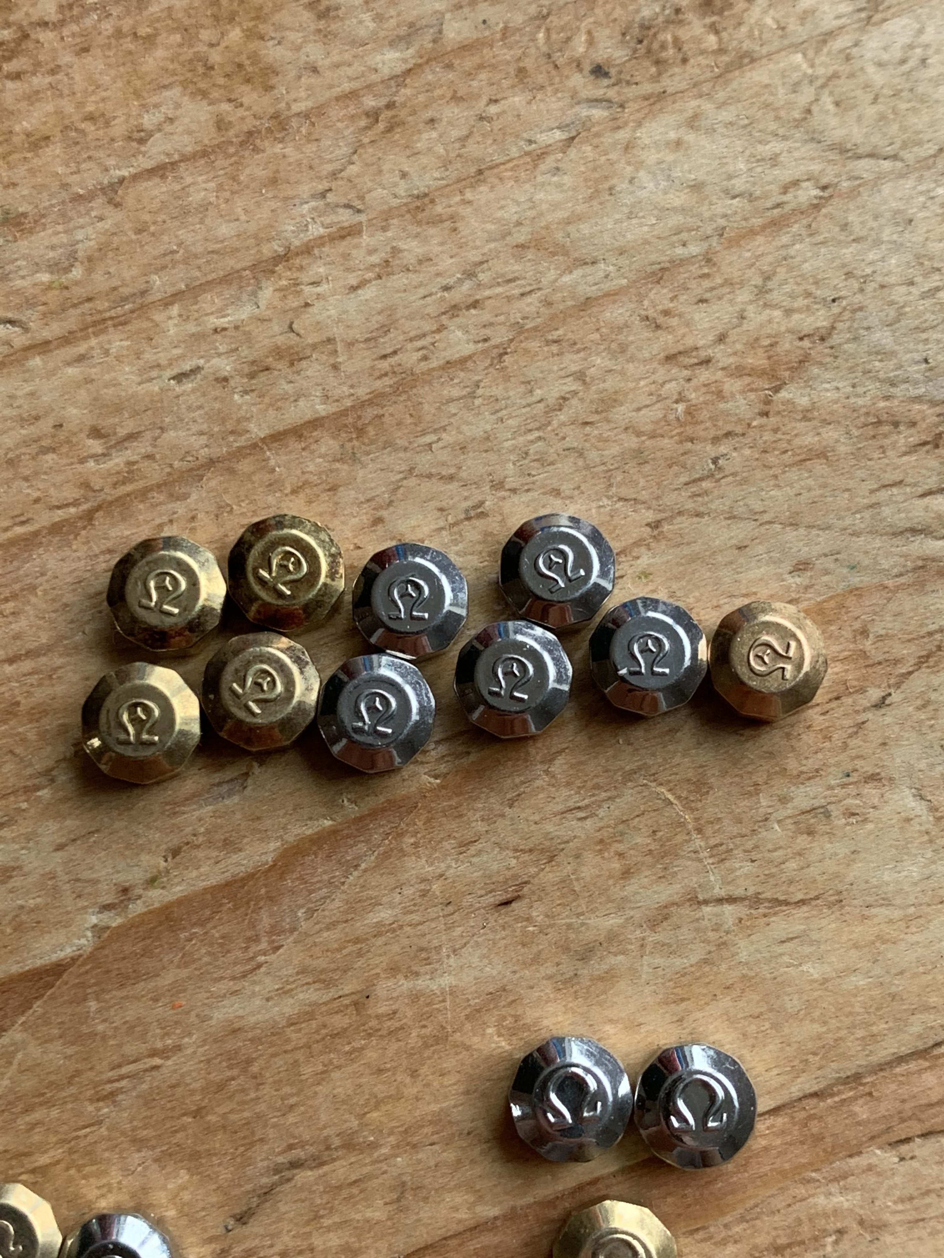

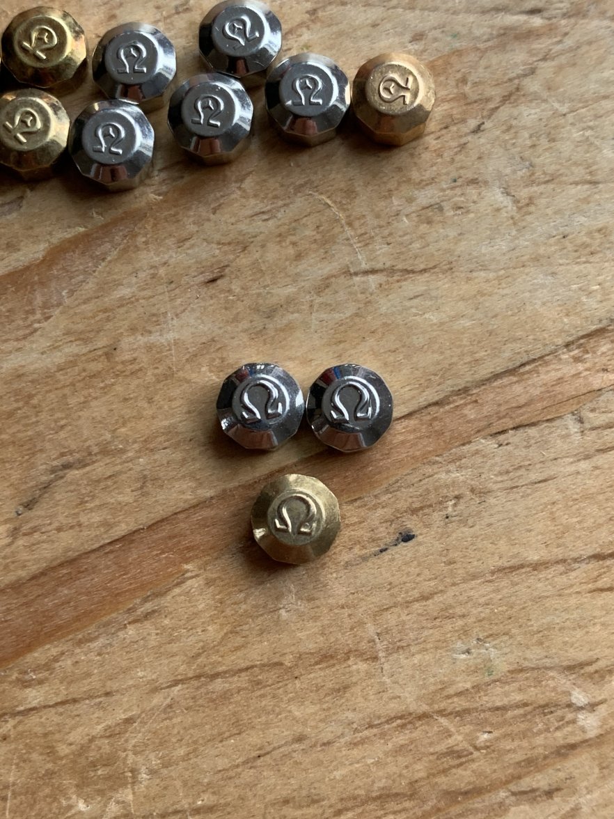

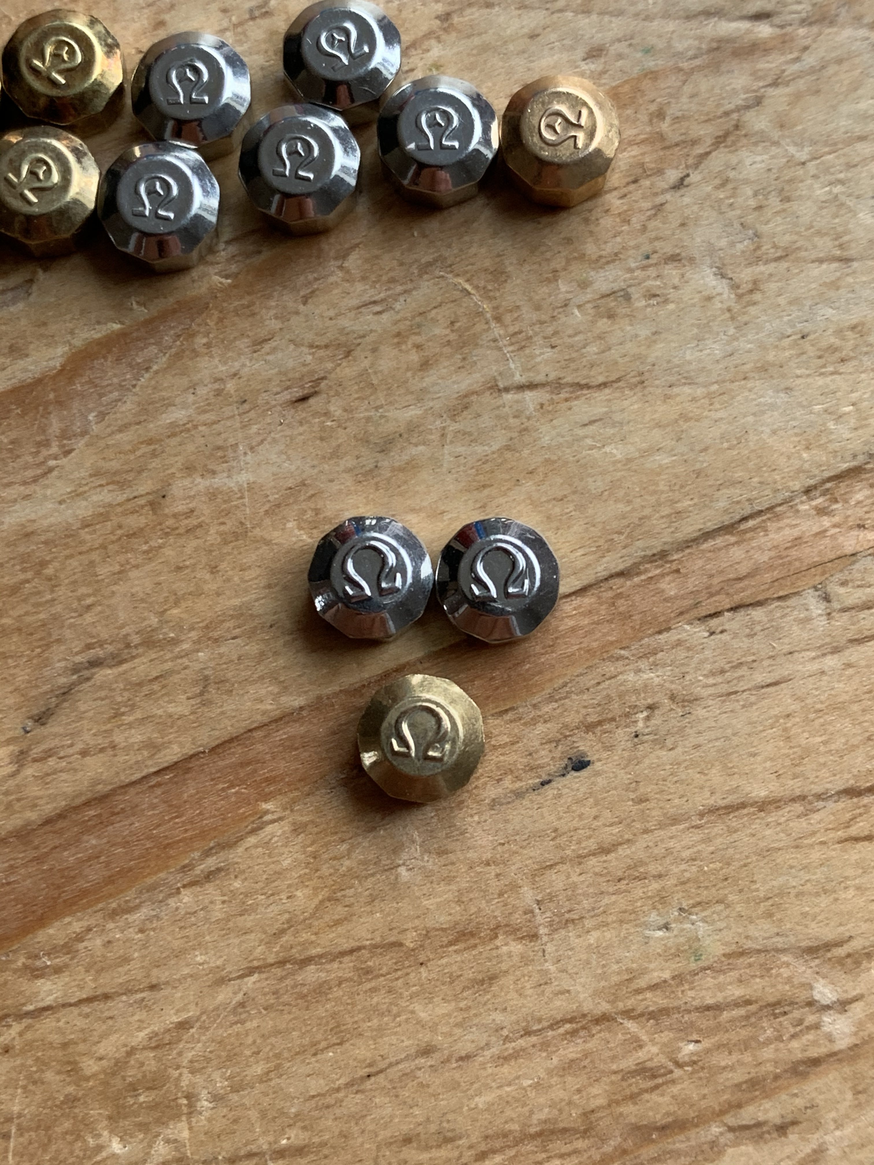

Is an original crown really $200? I have a dozen or so in my parts box
