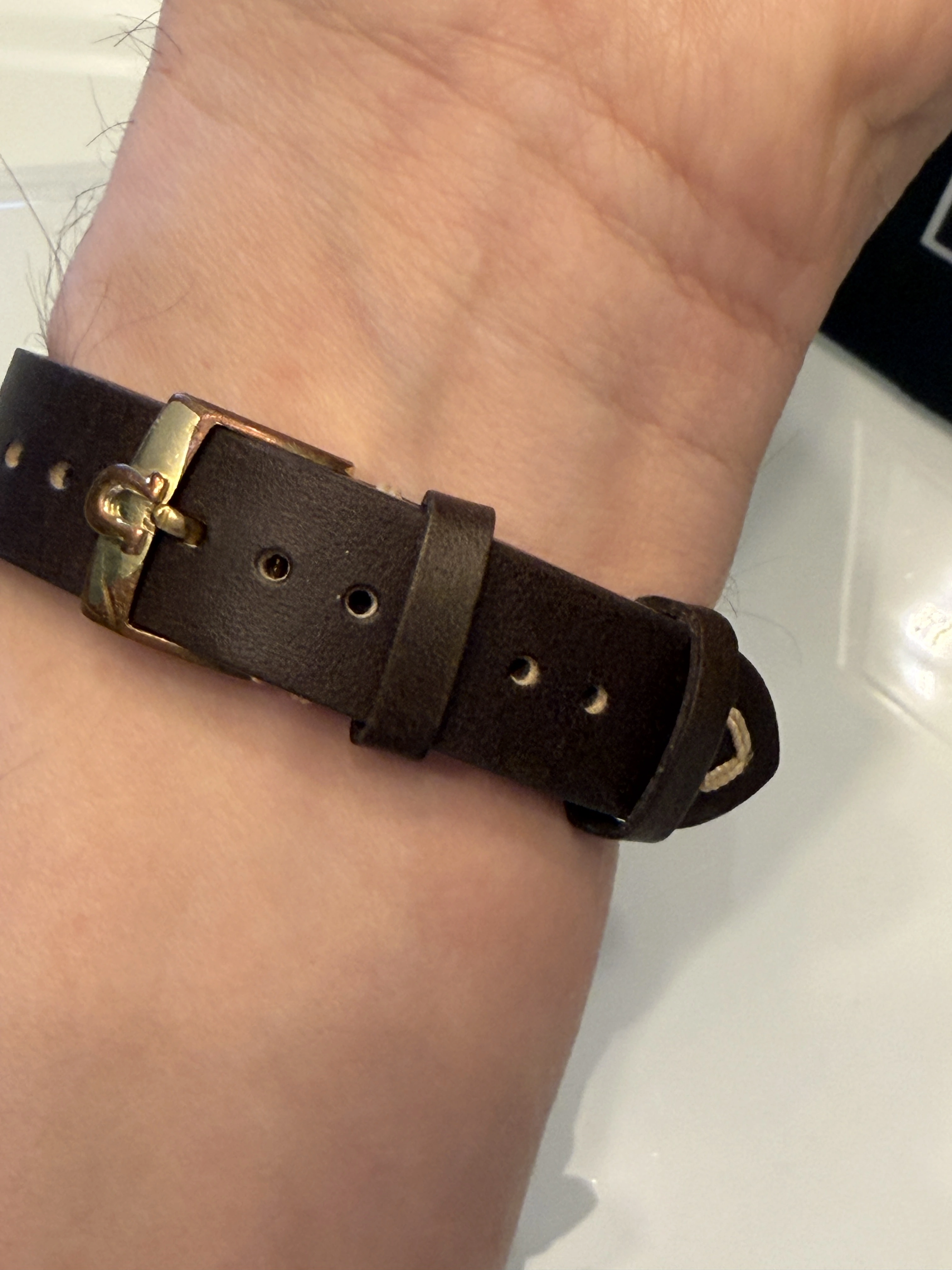

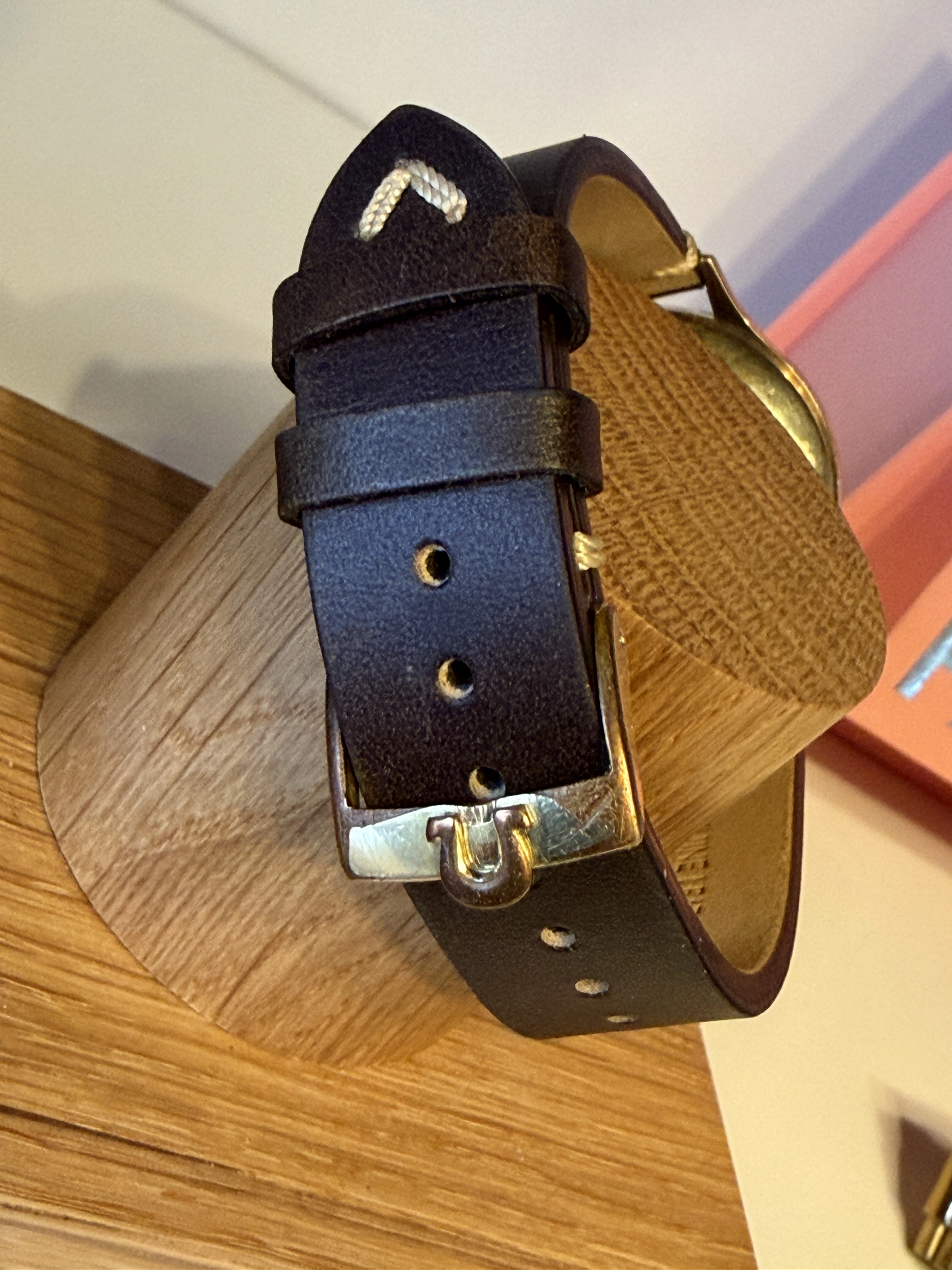

BTW the buckle has the somewhat worn sun mark it is original gold plated buckle from maker MG (not sure if we know his actual name) and will fit nicely on a new leather black or brown strap after bit of cleanup.
If you’re looking for some late night browsing you can find a lot of info on Omega buckles here:
17
11
I think it will clean up very nicely with service.
Thankyou for that - yes looks just like the ones in that thread marked MG. I have asked the watchmaker about putting the buckle on the new strap I am having put on it.

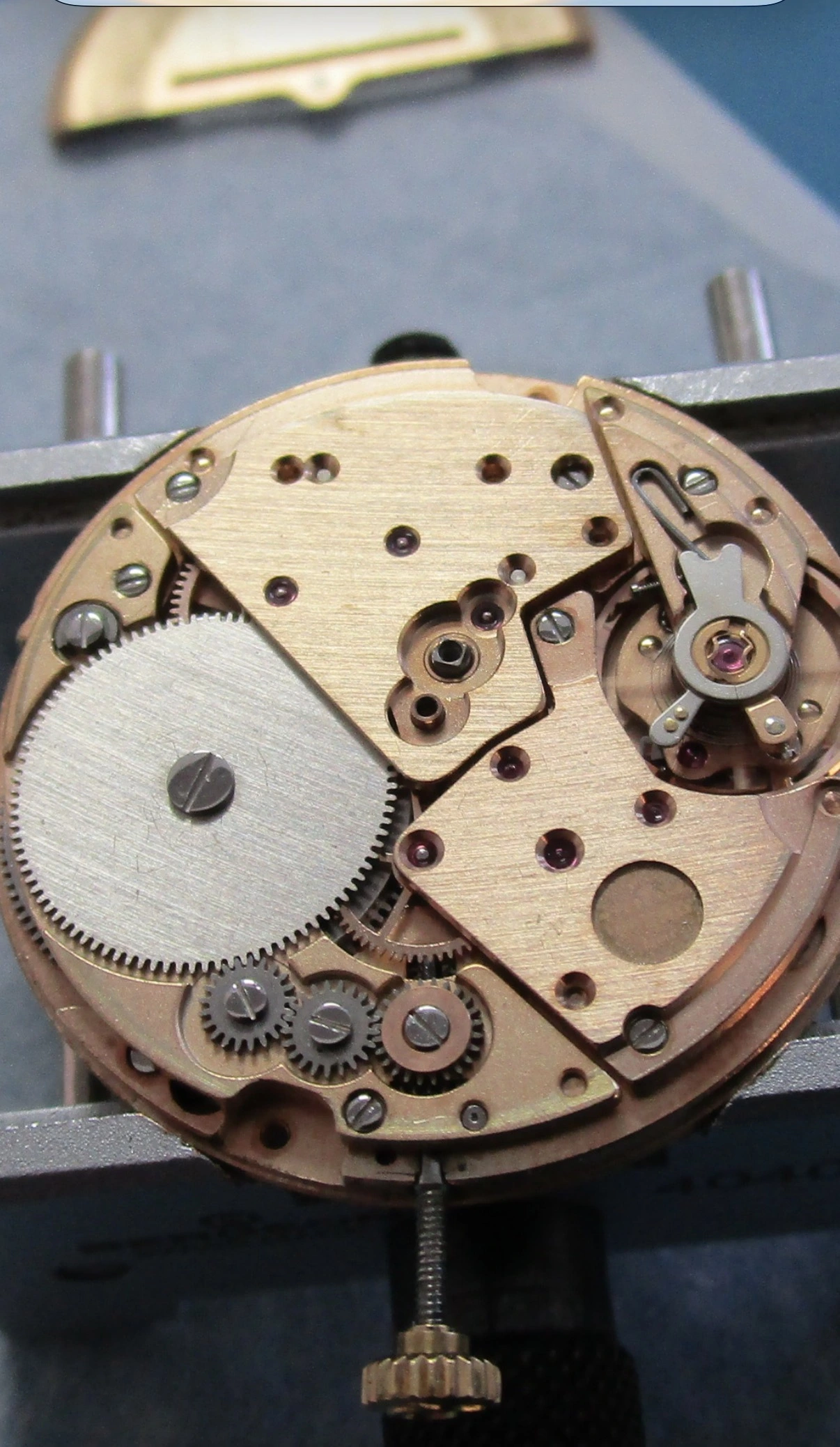

So the watch is nearly on its way back to me - it was a monocoque case when it was taken apart. One curious thing is the movement doesn’t have a serial number - is this usual? It seems to be missing the stamps?
17
11

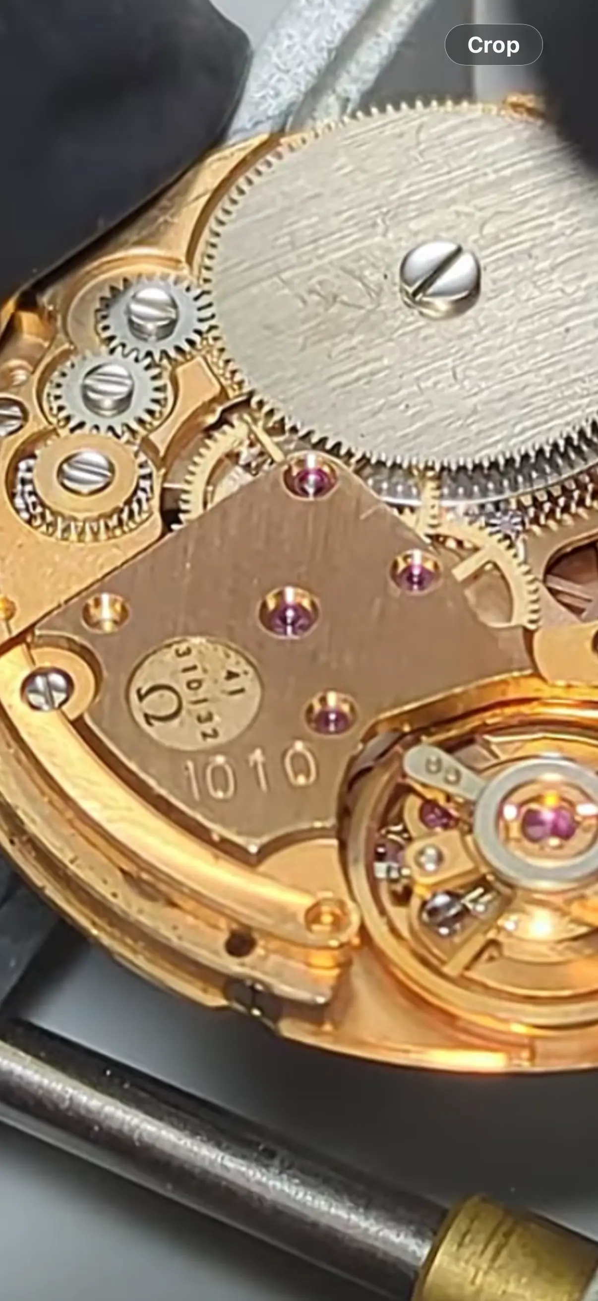

Ah - so were not all movements stamped? I had seen this online - another 1010 movement but this one stamped
24,327
54,150
That is also a sticker with the 41 million serial number. Yours fell out.

The movement number(1010) is stamped on the reference but not OPs. That said, thats not anything to be worried about. While many movements were stamped with the movement number on that plate, not all were, see: https://www.emmywatch.com/db/movement/omega--1010/
That said, definitely not a 565 movement there, so guessing the title ends up not being accurate 😀 Curious why OP thought it was a 565 in the first place, and if that is meaningful in any way.

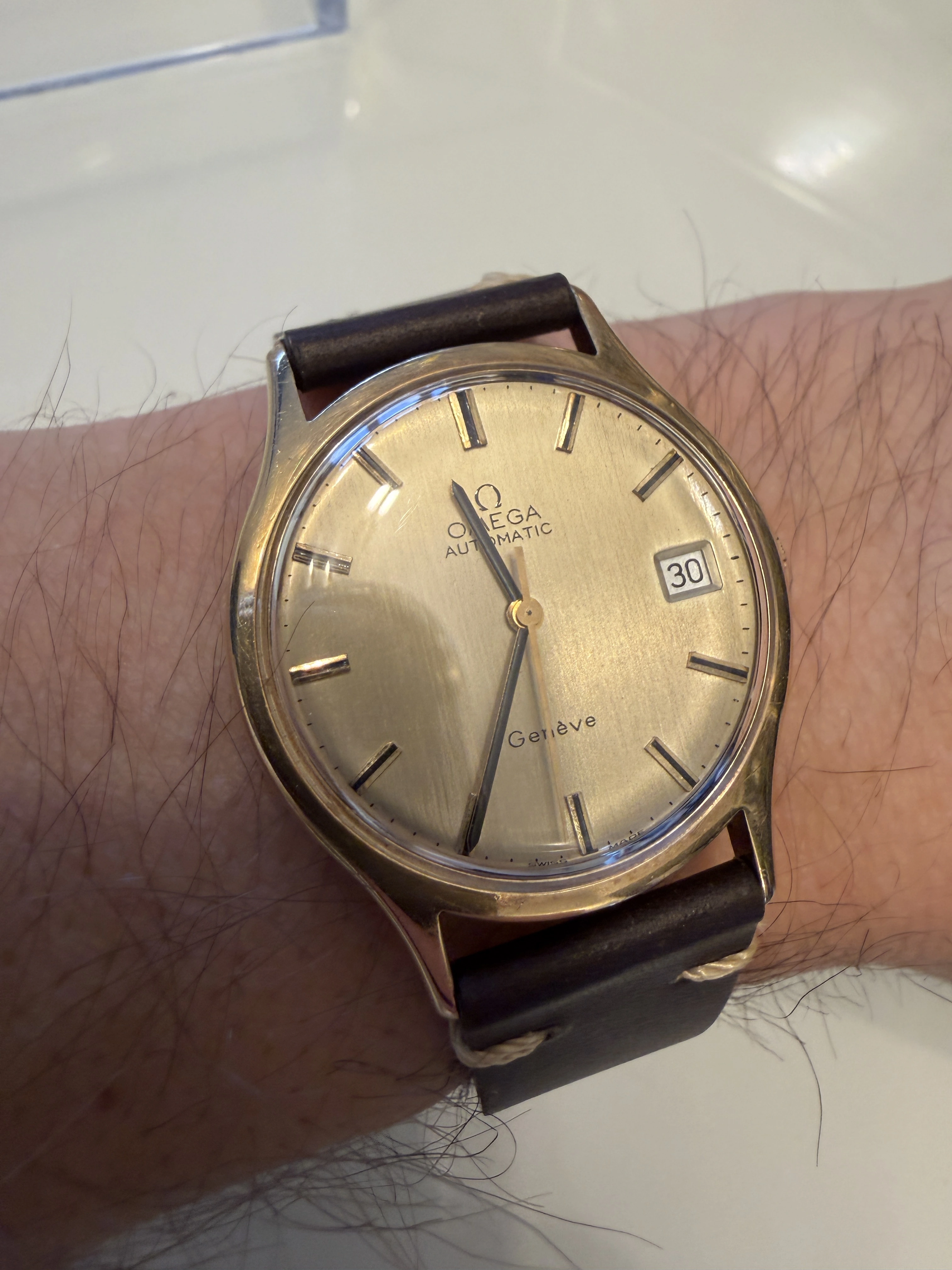

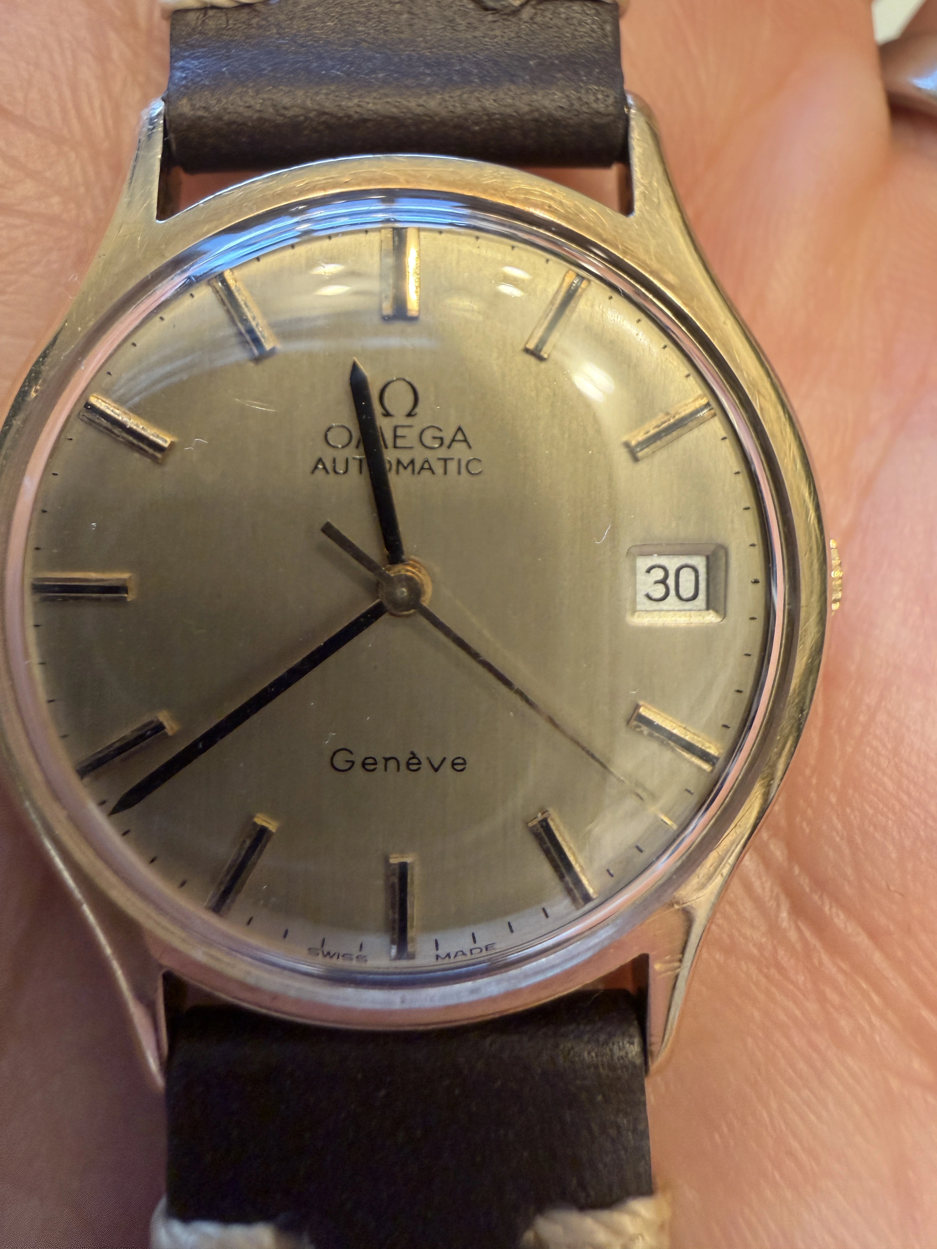

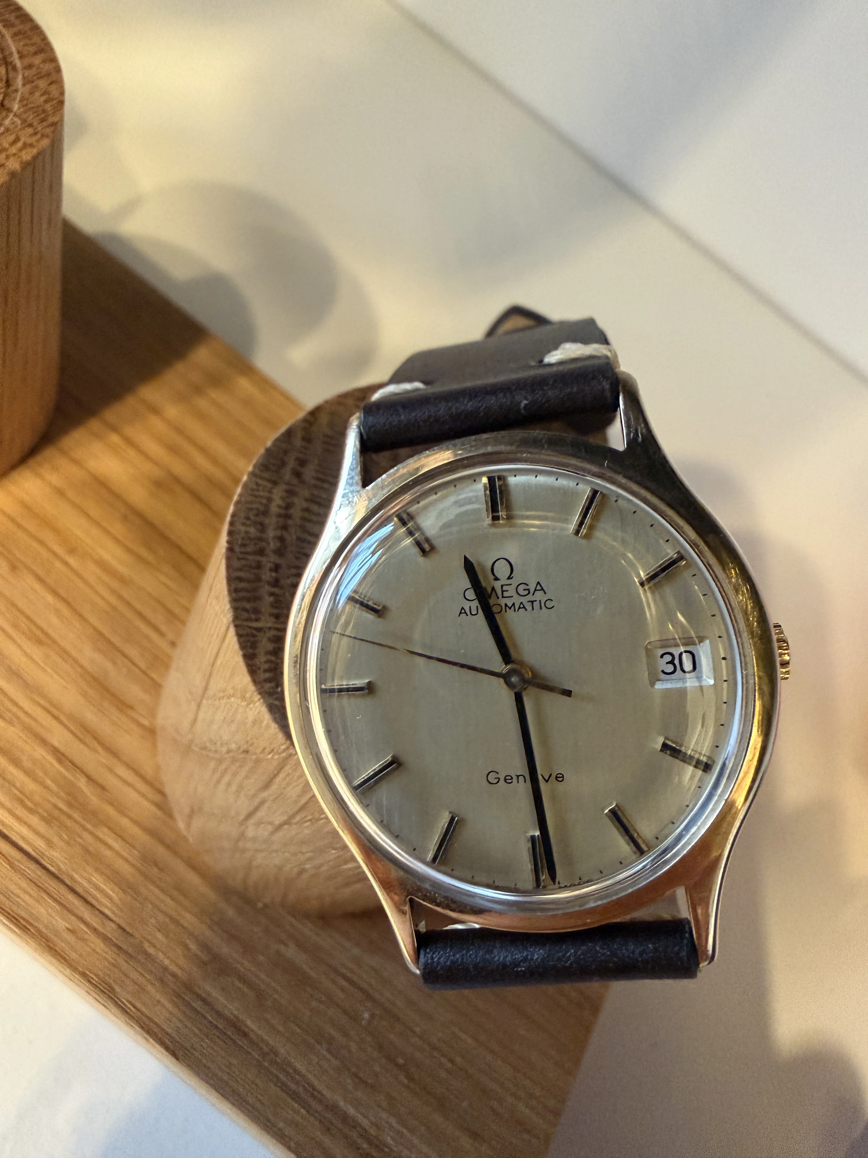

So the watch is back - and I’m really happy with it, great work by the watch guy - thanks for the advice and information on this thread.
10,451
16,344
This came up very well and is now fit to be treasured as an heirloom.
