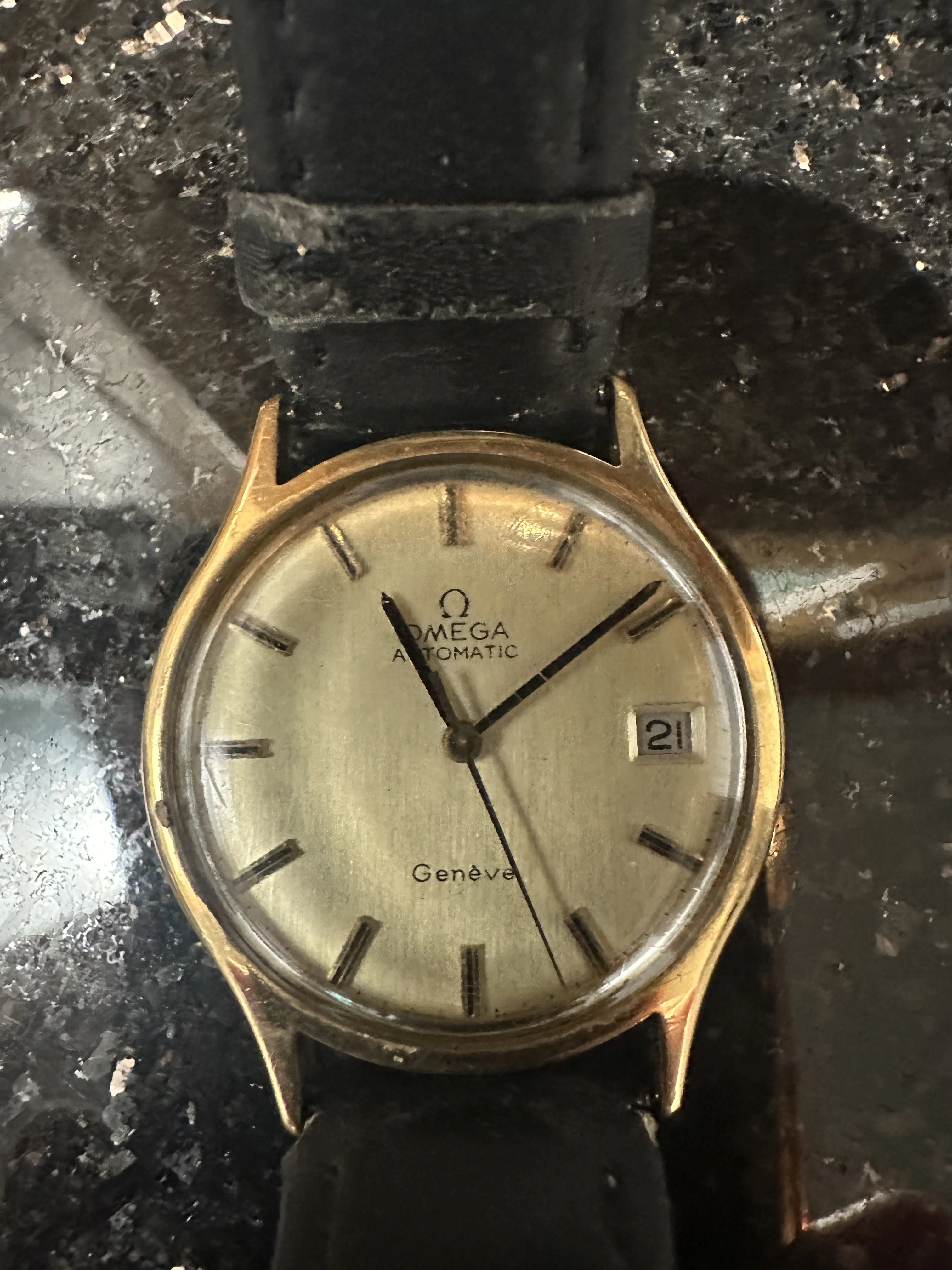

Hi all
I have my late dad’s Geneve, he was presented it in 1976 by the company he worked for.
It’s not worked for approximately 5-10 years as the crown has come off (I have it).
Been thinking about having it repaired and serviced, so I went into the local Omega AD and they said it would need sending off to Omega in Switzerland, and quoted a starting price of £1400, I Also took it to a watch repair ‘chain’ at the local shopping centre who said best estimate would be around £600.
I have been advised though to join this forum and see if there are any horologists local to me (Barnsley, UK) as this would be the best way to go for the care of the watch.
The watch was presented to my dad in 1976 but I’m unsure of the year of manufacture, I’m also unsure whether it’s gold plated or solid gold.
Any info / advice / suggestions of local watchmakers who would be good contacts is welcome.
Thanks in advance.
Shaun

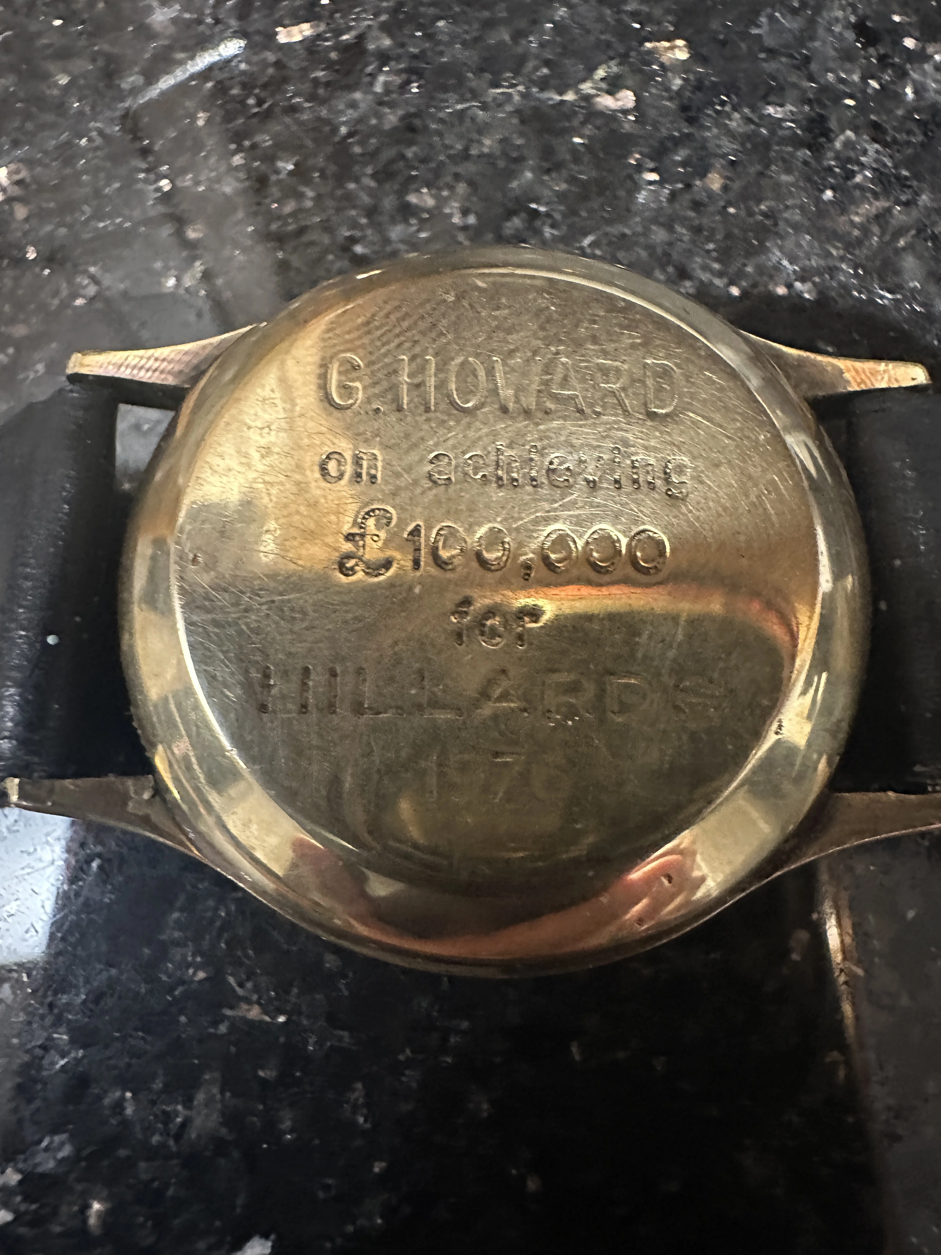

Welcome @barnsleyshaun

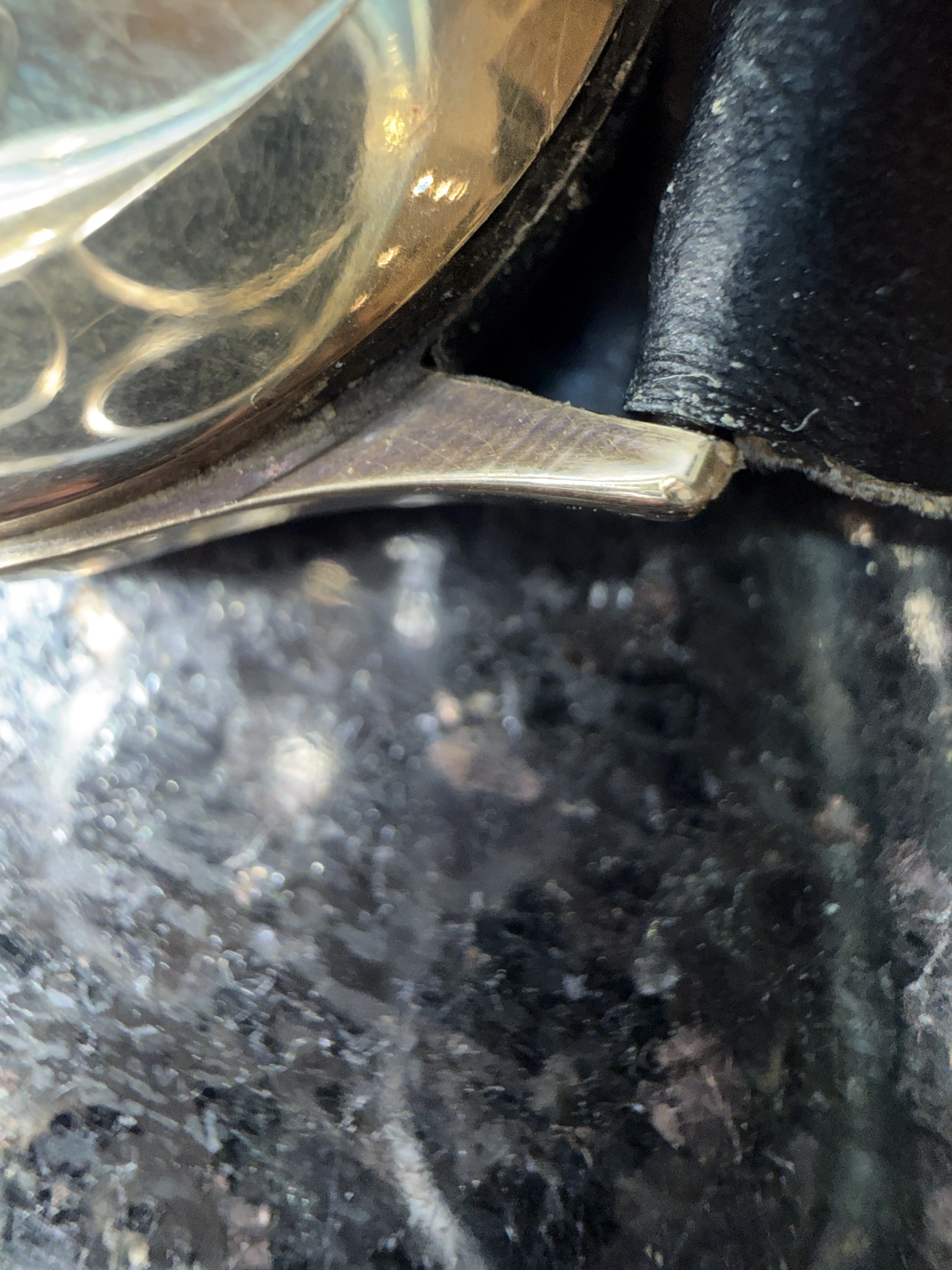

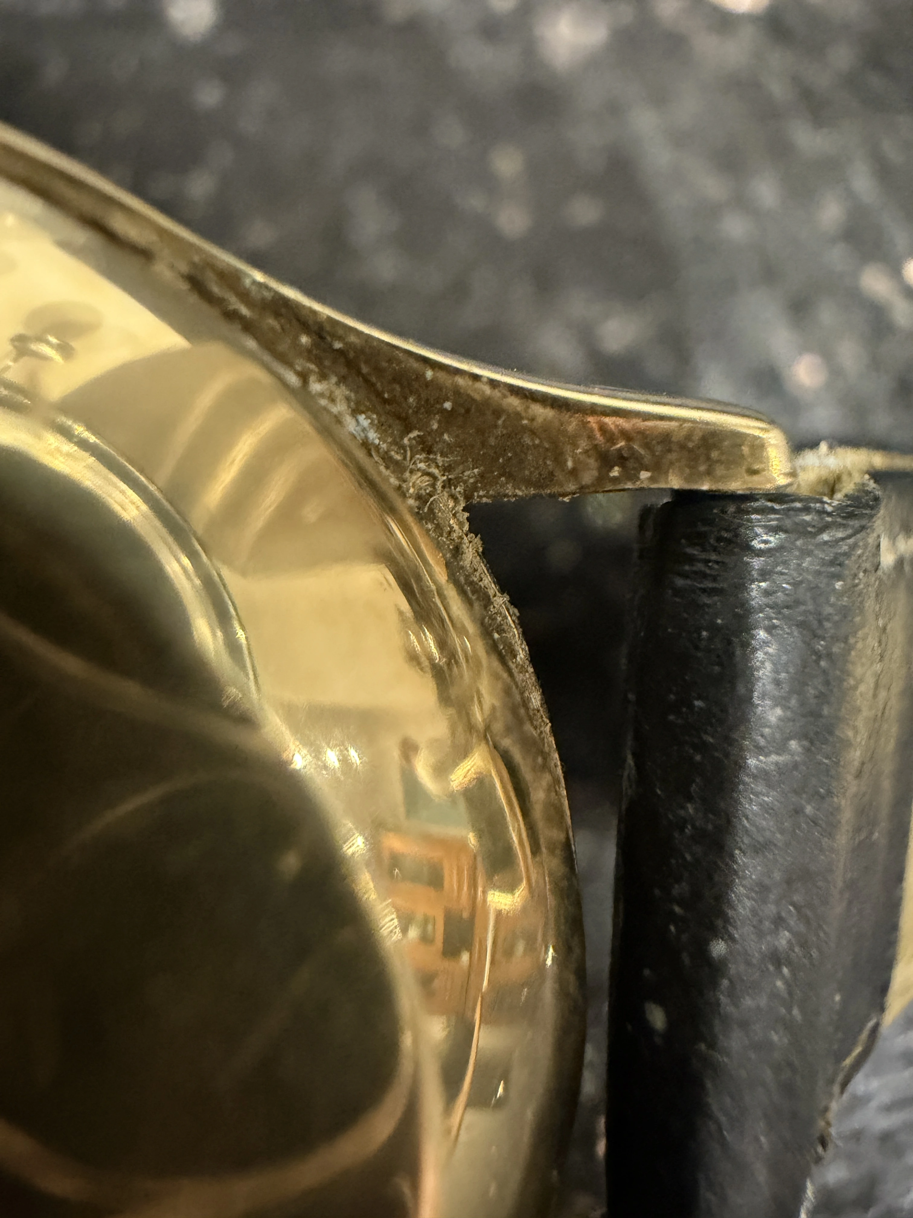

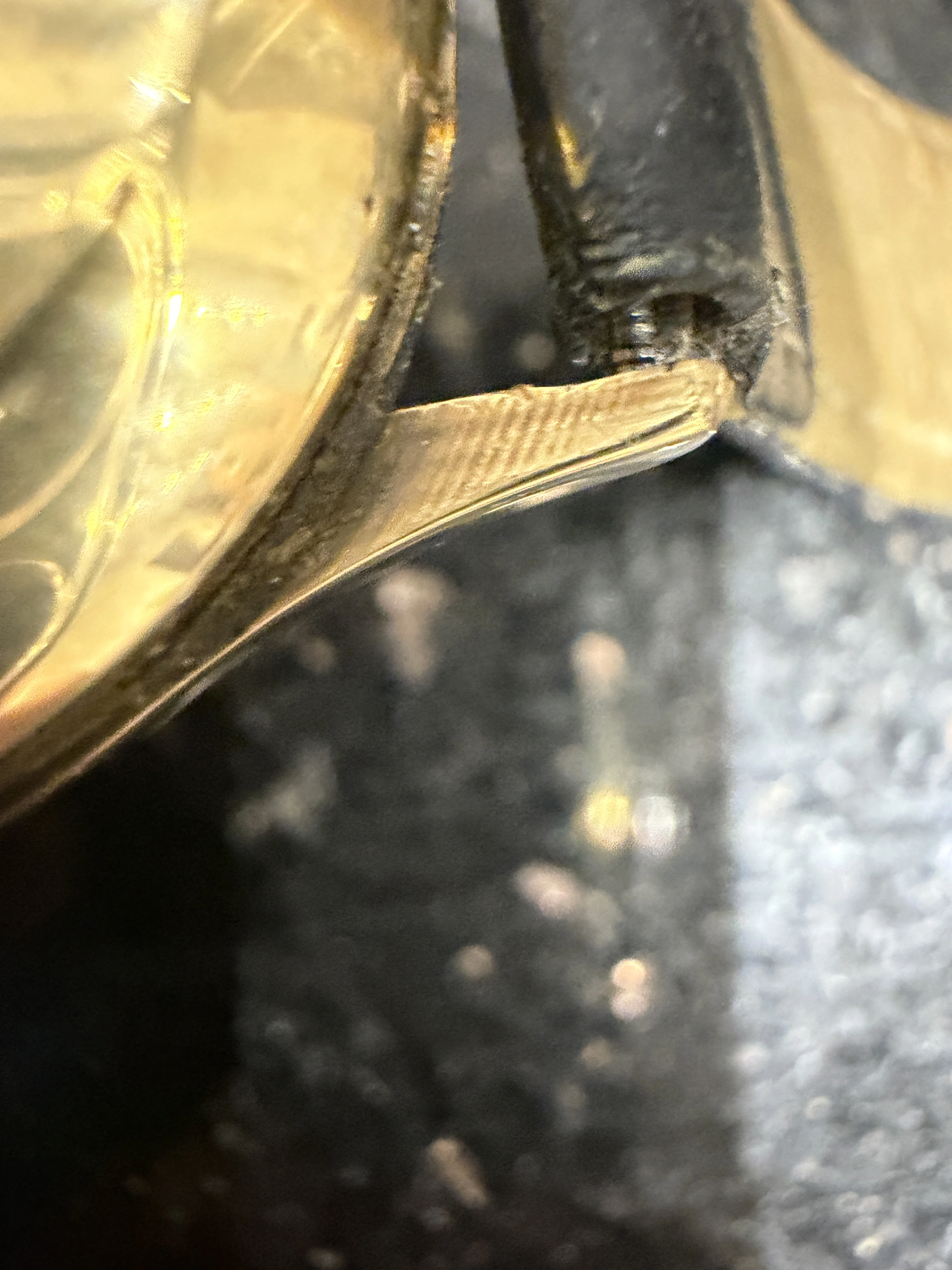

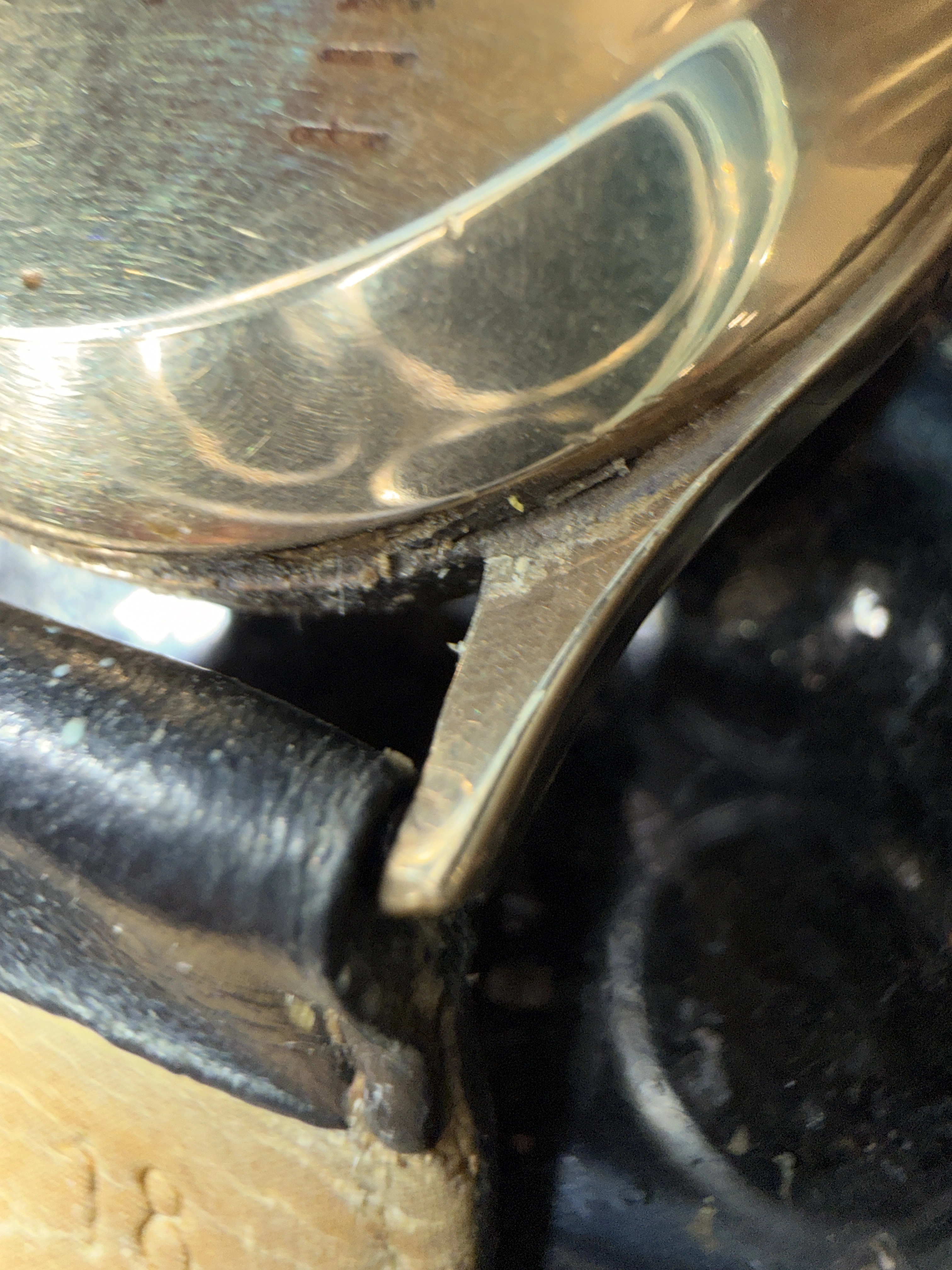

The lugs don’t have hallmarks, so it is unlikely to be a Swiss gold case.
However, the engravings on the back are quite deep, so it could be a UK cased gold watch.
(E.g. Shackman for Omega )
There does look to be some ‘peeling’ on the rear of the bottom left lug - so perhaps investigate that.
Only way to really tell would be to get the back off.
For mending/servicing try Mitka or the Watchguy.
Not local to you but both in the UK and both frequently recommended.
As long as there is nothing major wrong, a service should cost around £200.
Hope that helps.

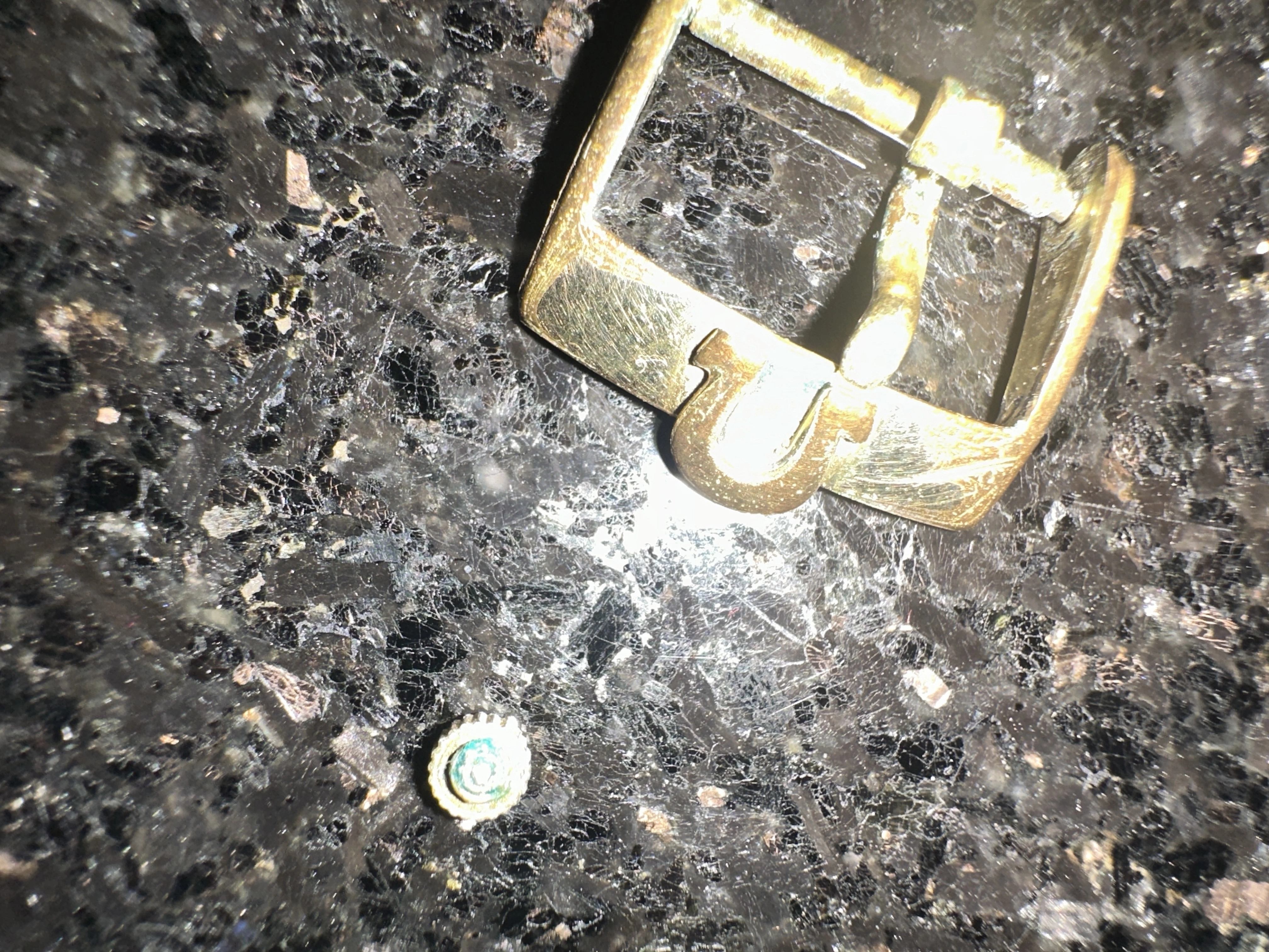

Nice old buckle too. Can you show photo of other side of buckle may have some info to ID the maker.

Thanks - I’ll take another photo of the buckle when I get home

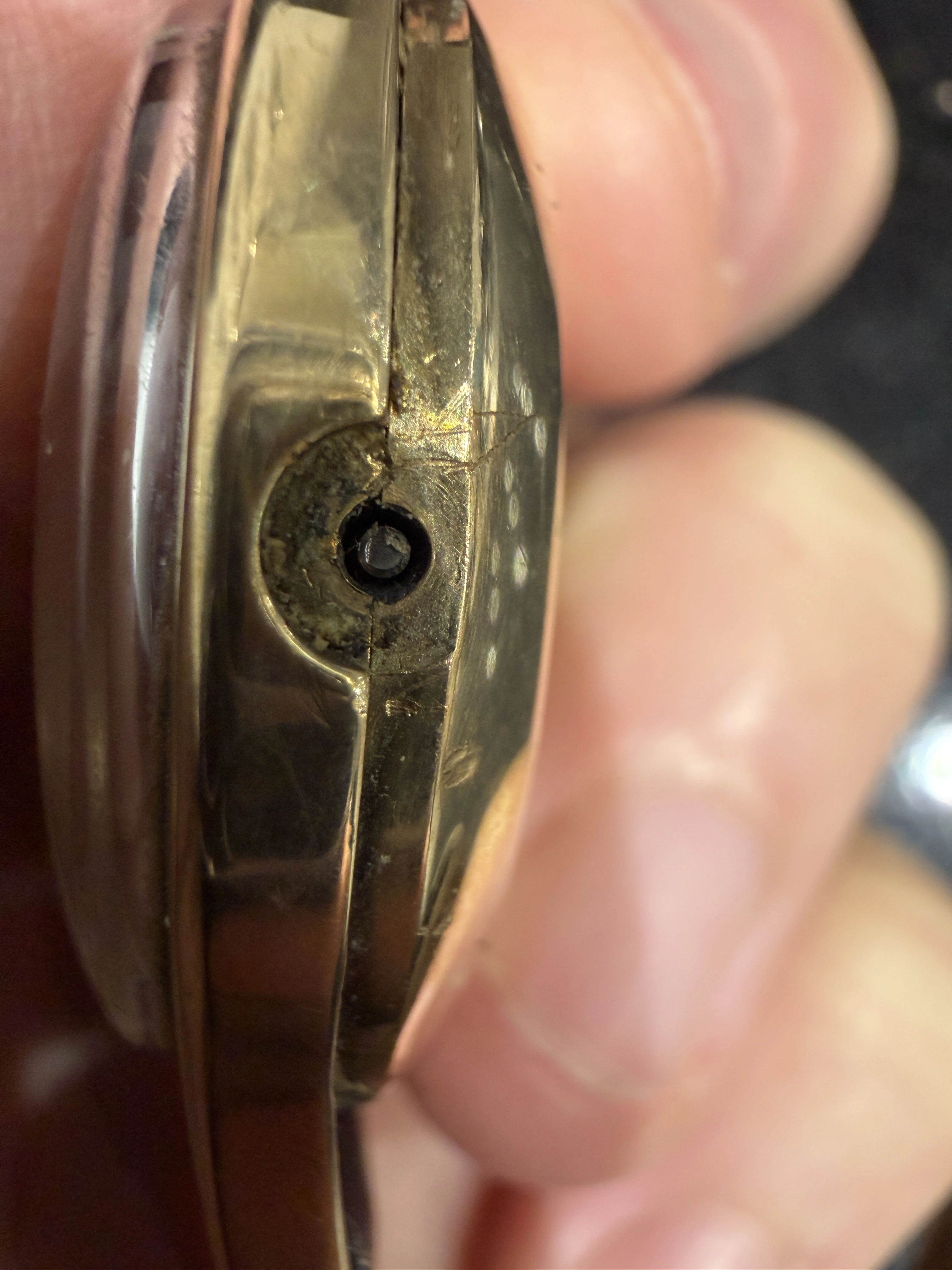

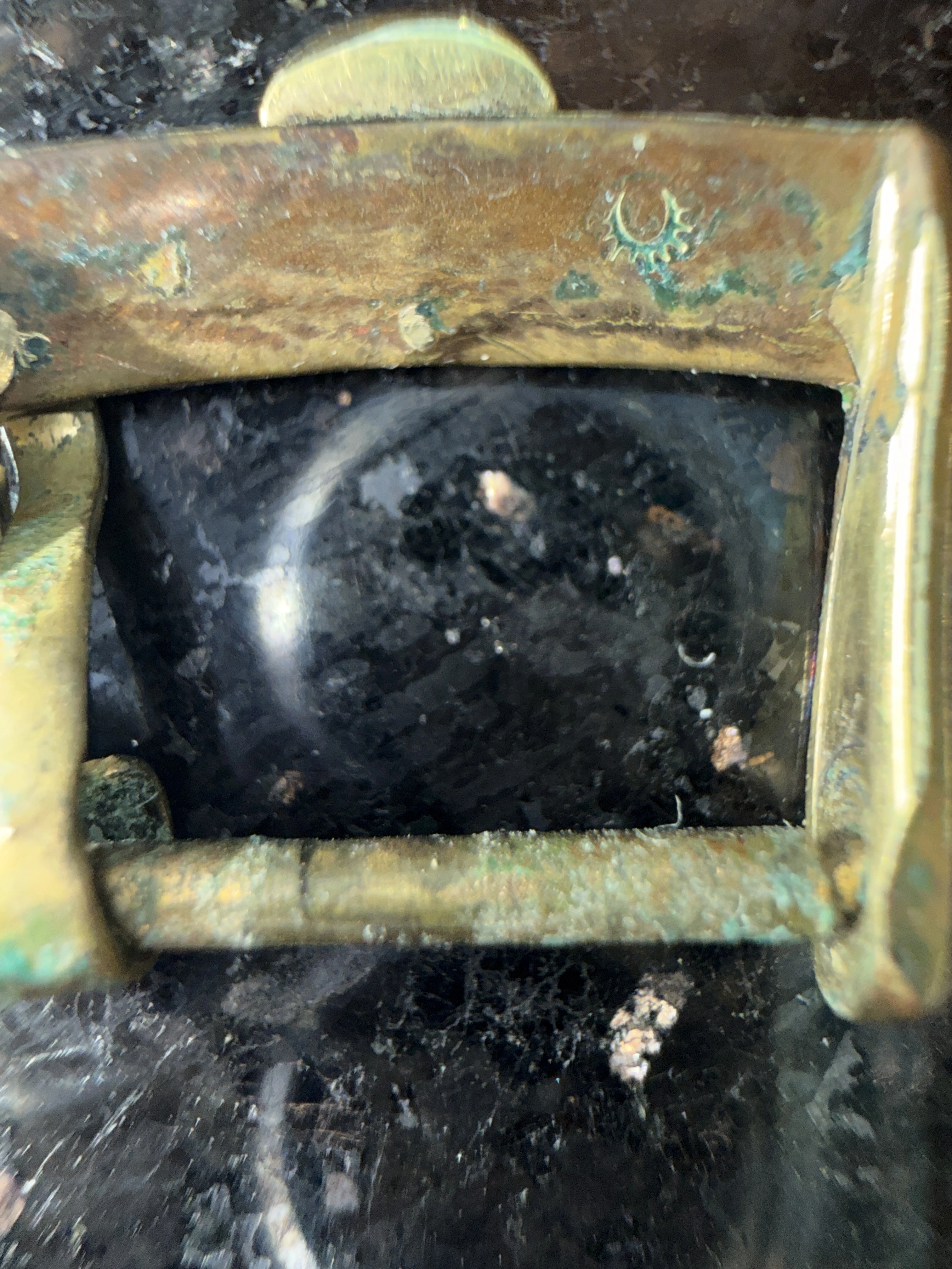

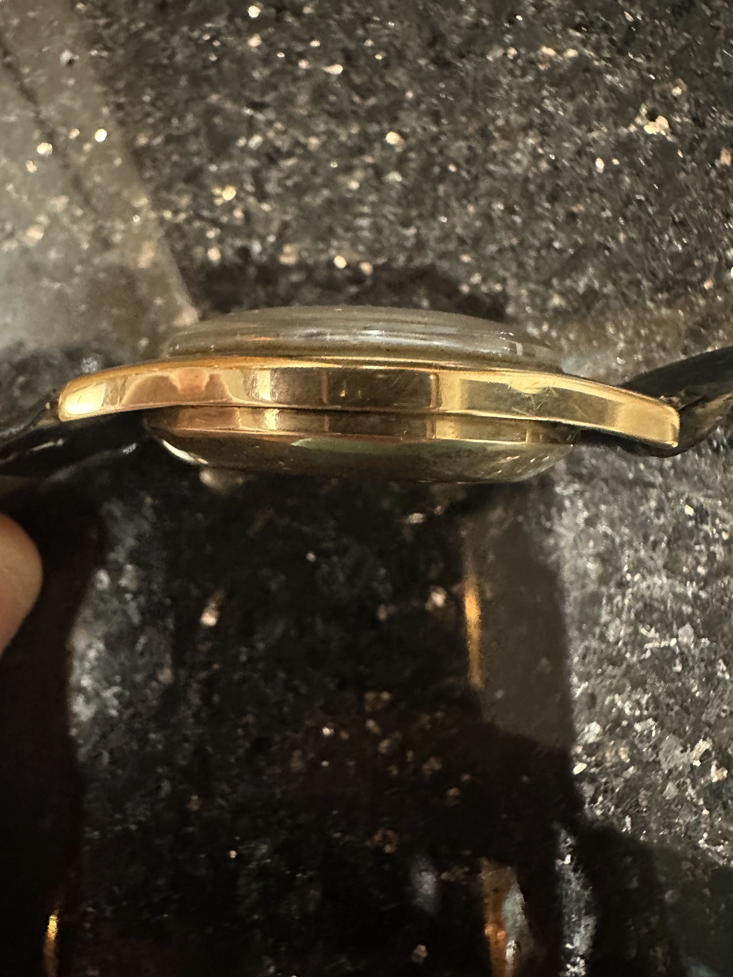

Here are some more photos, other side of buckle, crown side and each individual lug
2,165
1,351
I think it’s either gold filled or plated. Hard to tell, but looks like wear on the upper left lug on the side. Also some green corrosion on the bezel up and left of the crown area.
Is there any broken piece of the stem in the crown? Hard to tell
Could be a 50x movement or 55x movement. Should be ble to see this if the back is removed. Will also get the reference case number on the inside back
£600 is too much and mentioned £200 is fairer unless some parts need to be replaced

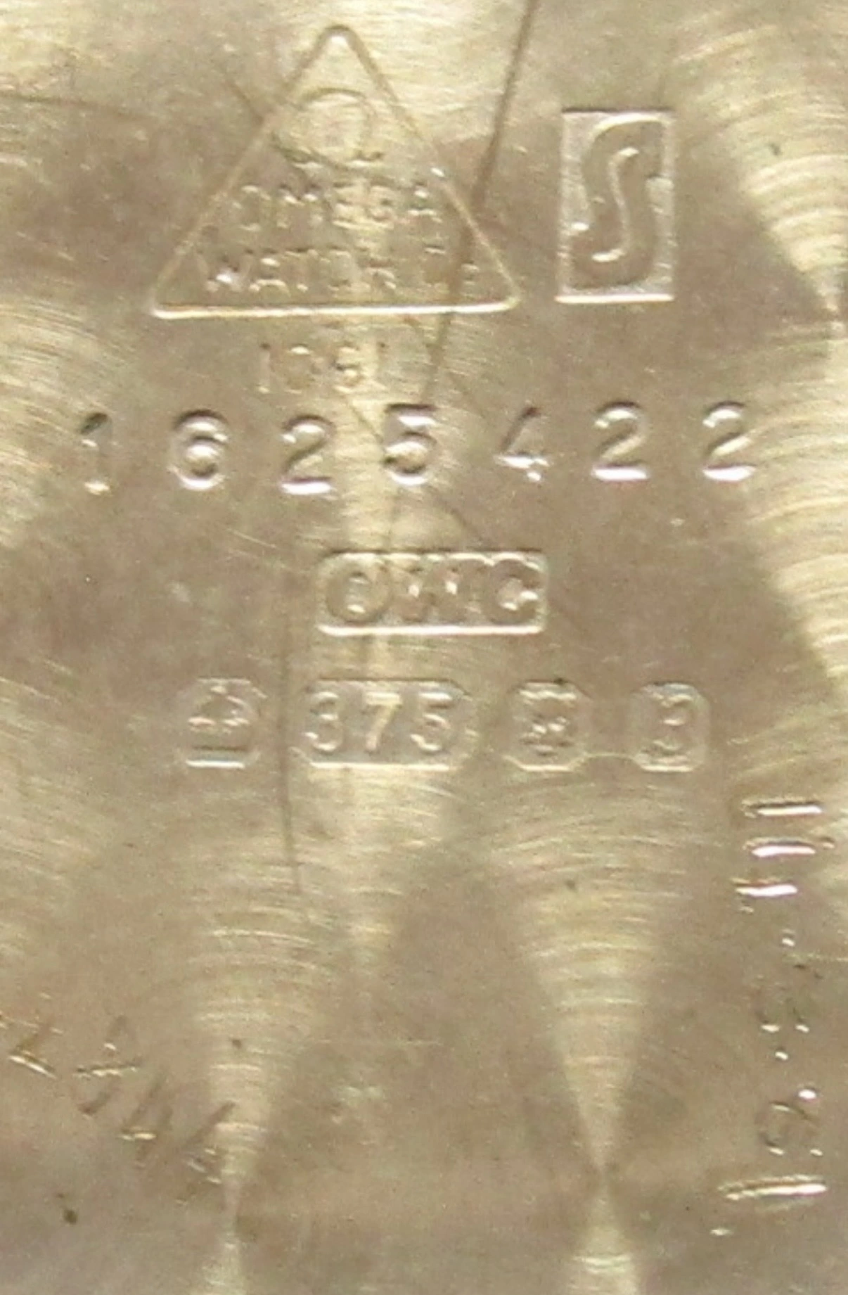

English made 9k case by Shackman.
London made with date letter for 1976.
These cases were made under licence for Omega.

Thanks again for the info - so is the case back and front /lugs 9k gold then or just the case back - out of interest which marking is the year of manufacture?
