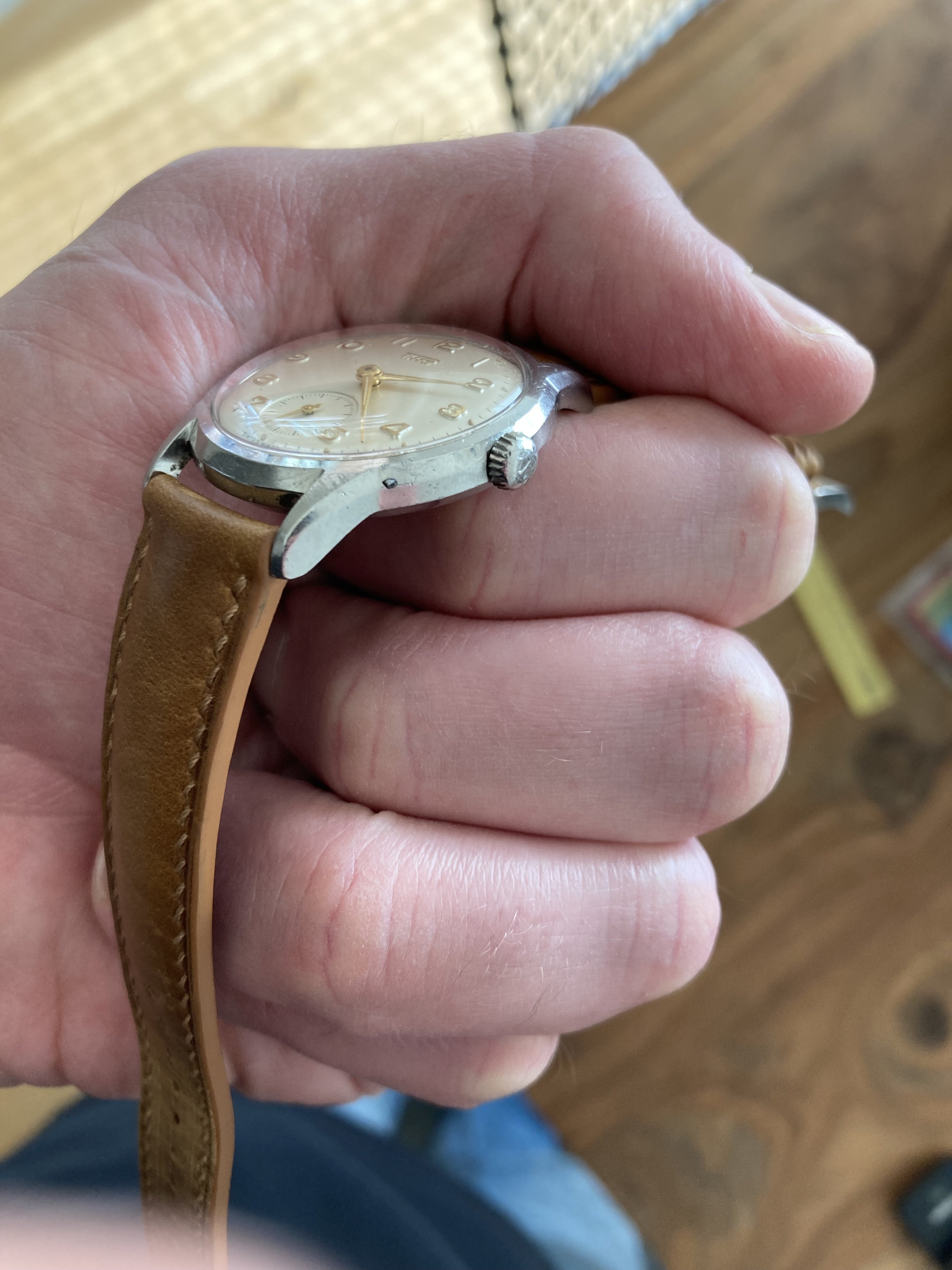

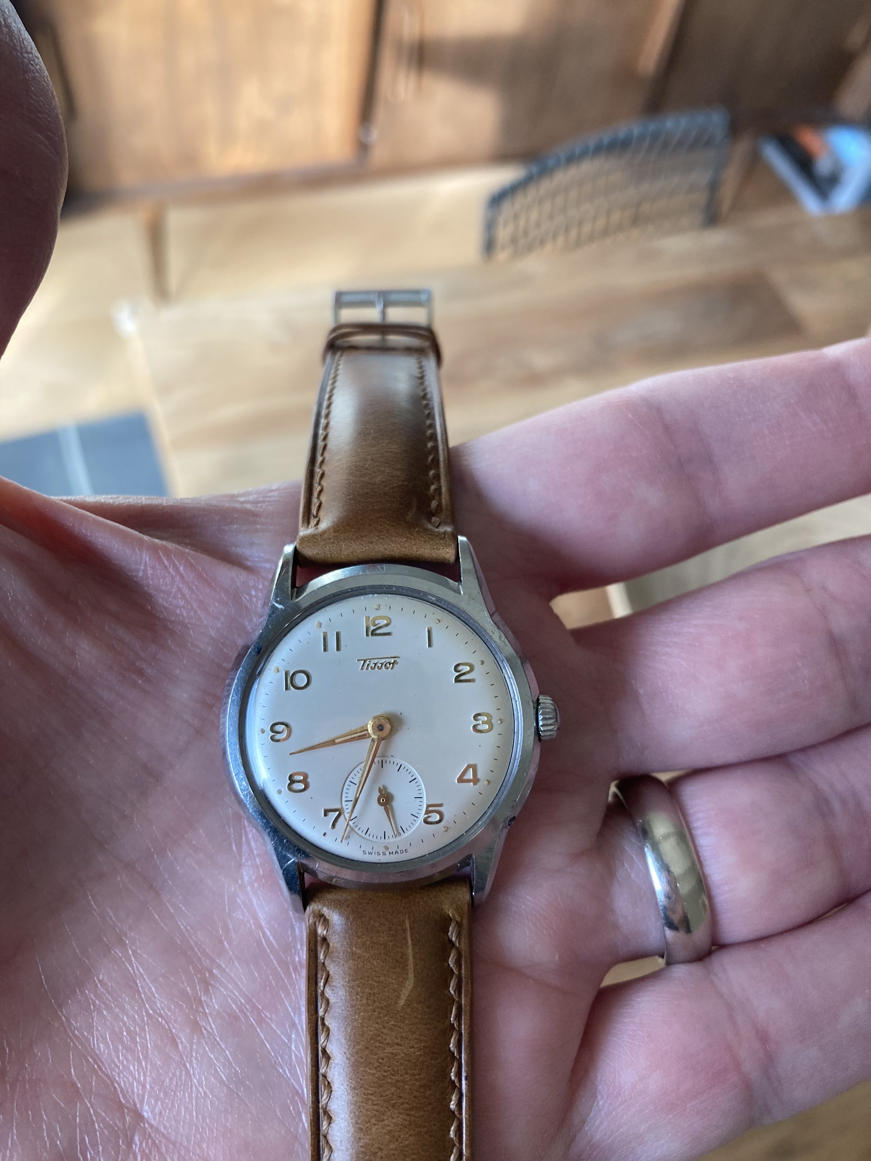

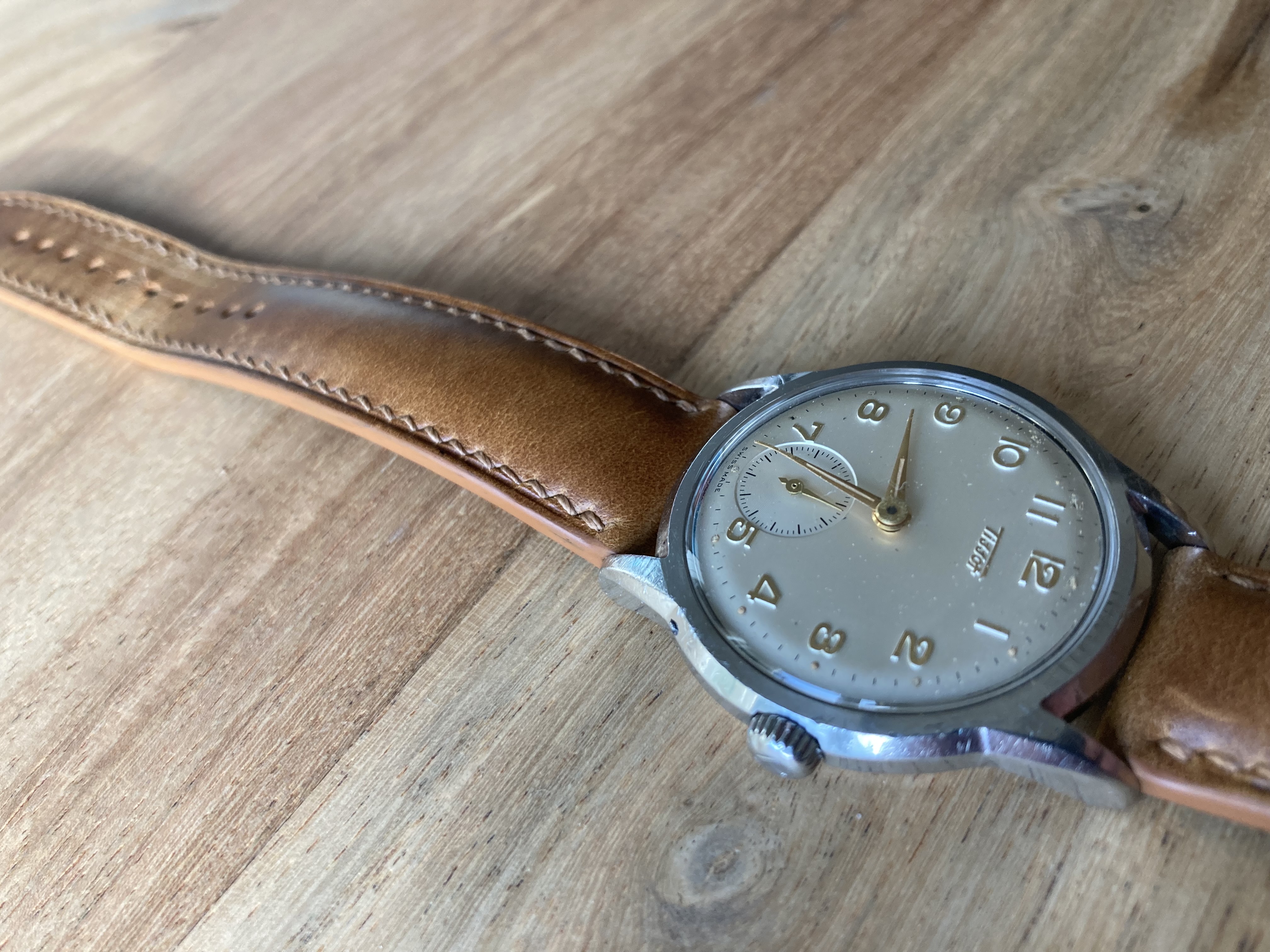

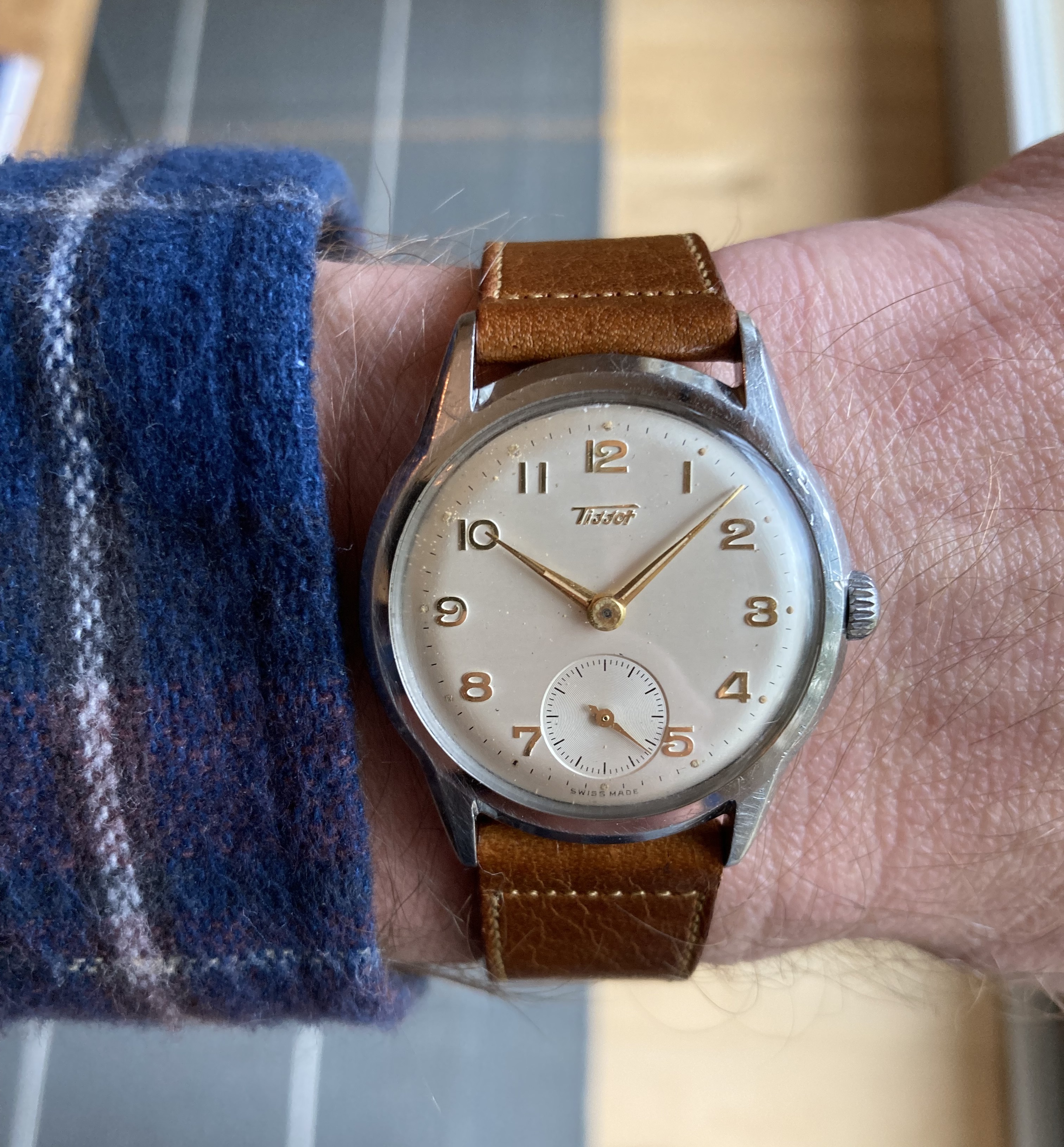

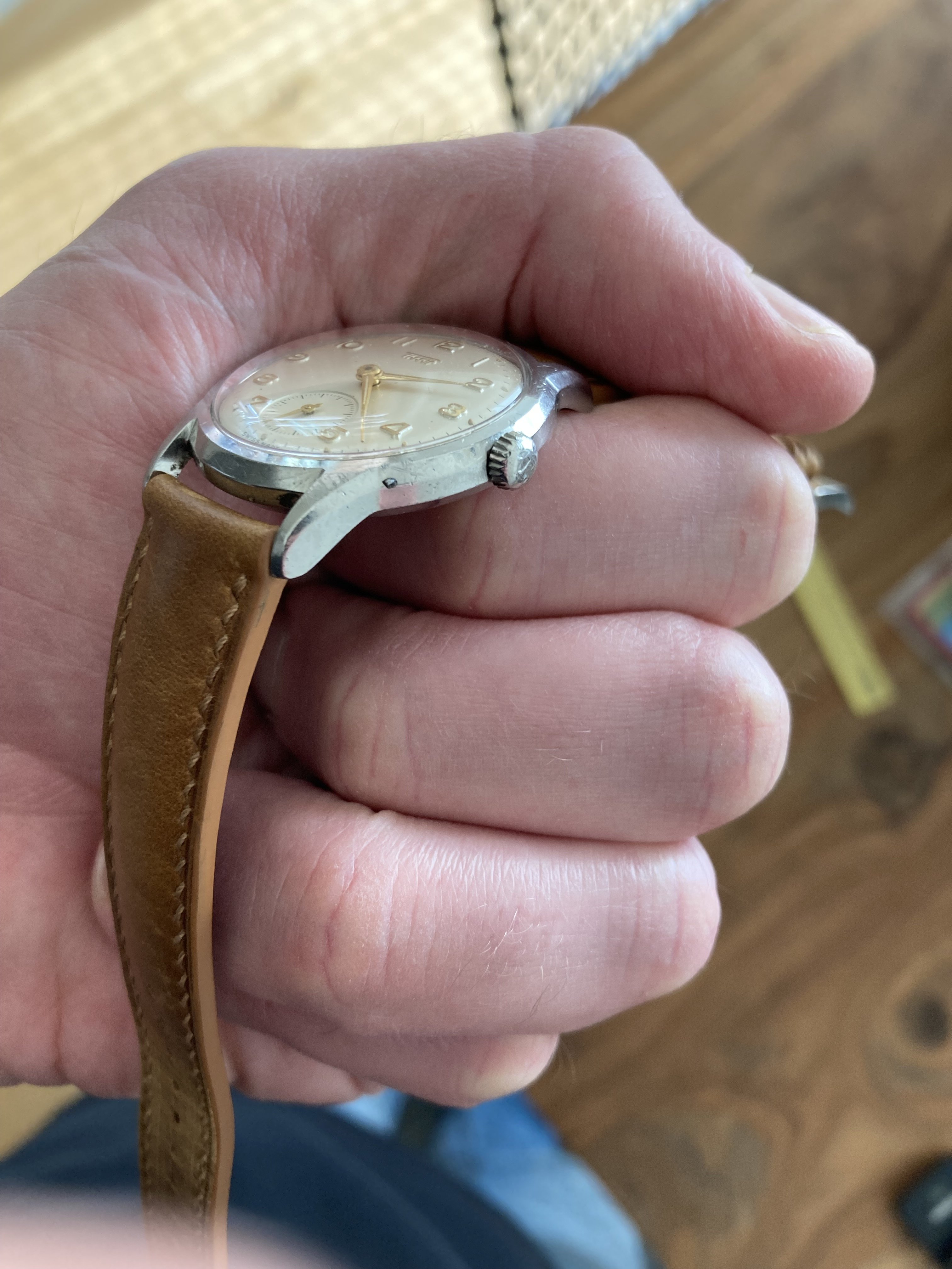

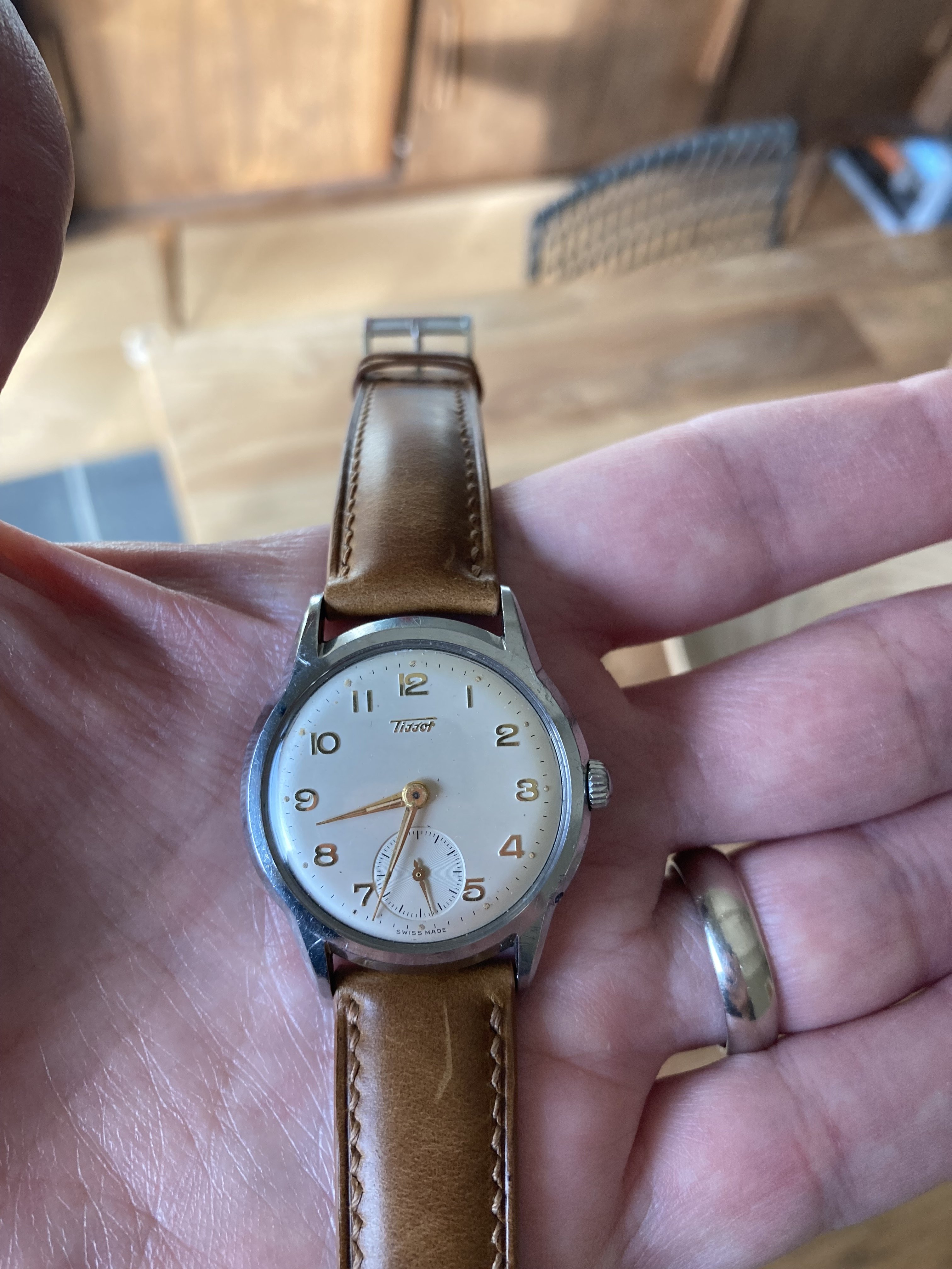

This Tissot arrived a few days ago. Unfortunately, it came with a small bead of metal near the bottom-right lug, which I assume is a solder repair. Seller did not illustrate it in the photos and when asked about the case (before purchasing), he indicated it was "untouched". Anyway...
I was wondering what would be involved to clean-up the raised spot. File it down a bit and polish? The case has its share of scratches and dings, so it need not be a perfect job. I'd be willing to have a go at it myself if it's not too difficult. Or I could bring it to a goldsmith if it's a relatively straightforward job. The watch was inexpensive (~250 usd) so I'm not looking to put a lot of money into repair.
On the other hand, I could just leave it alone and enjoy the watch for what it is. Especially if messing with it will likely just make it worse. Apart from that defect, I really do like the watch.

That's a dilemma for sure. My response would be to get the case professionally refinished, but choosing someone to do that isn't easy. Good luck with whatever you decide....

Melt it off?? Jk, no clue... Doing a refinish on the case could potentially fix it but... Then you're refinishing the case and it won't be untouched anymore. Plus refinishing it may be cost prohibitive considering what the watch cost you.
You could try to fix it yourself but it may end up worse... But how much worse?

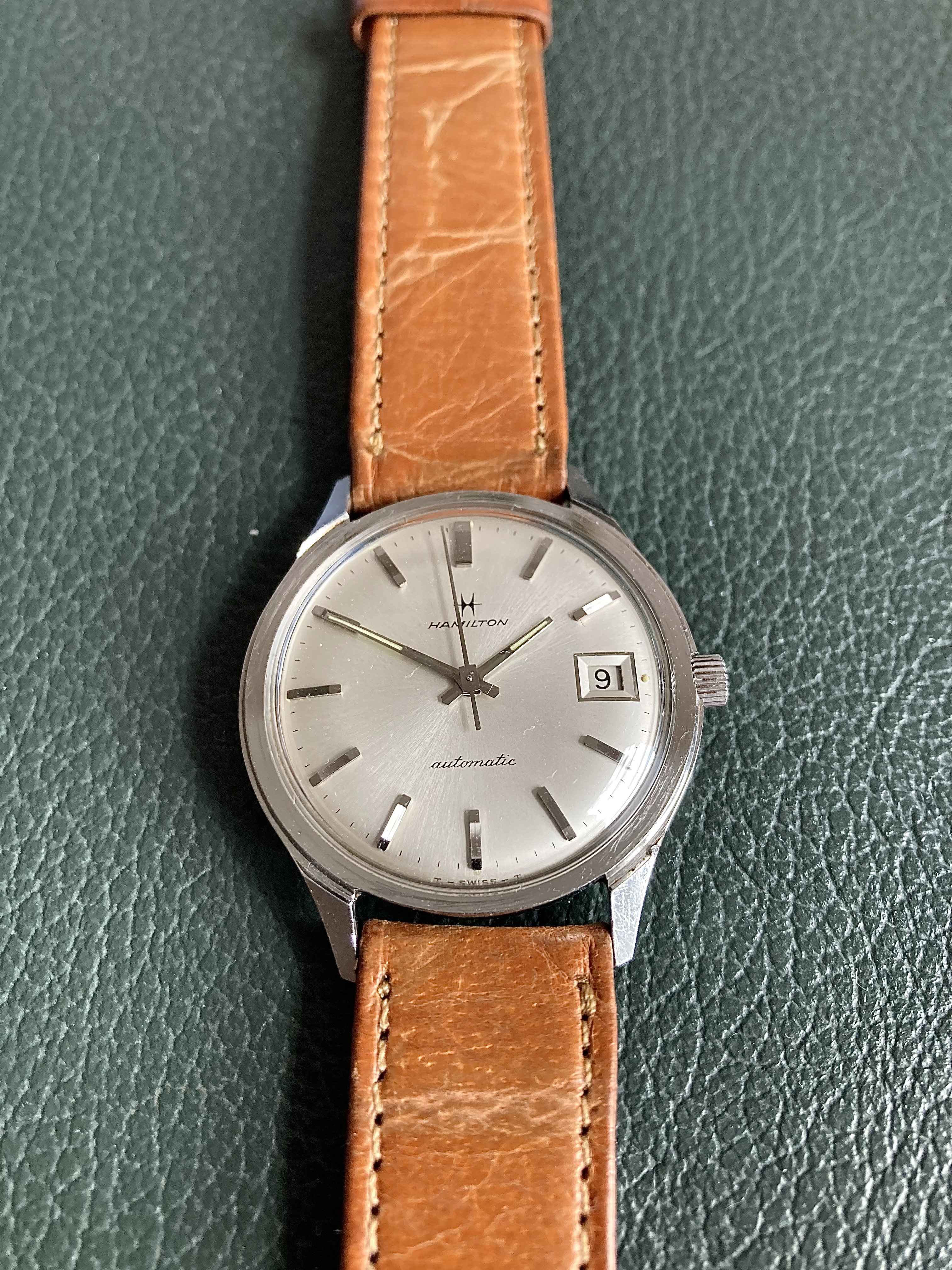

I had to scan your photos to spot the problem - it didn’t seem too obvious to me but I appreciate that these little blemishes can become a bugbear.

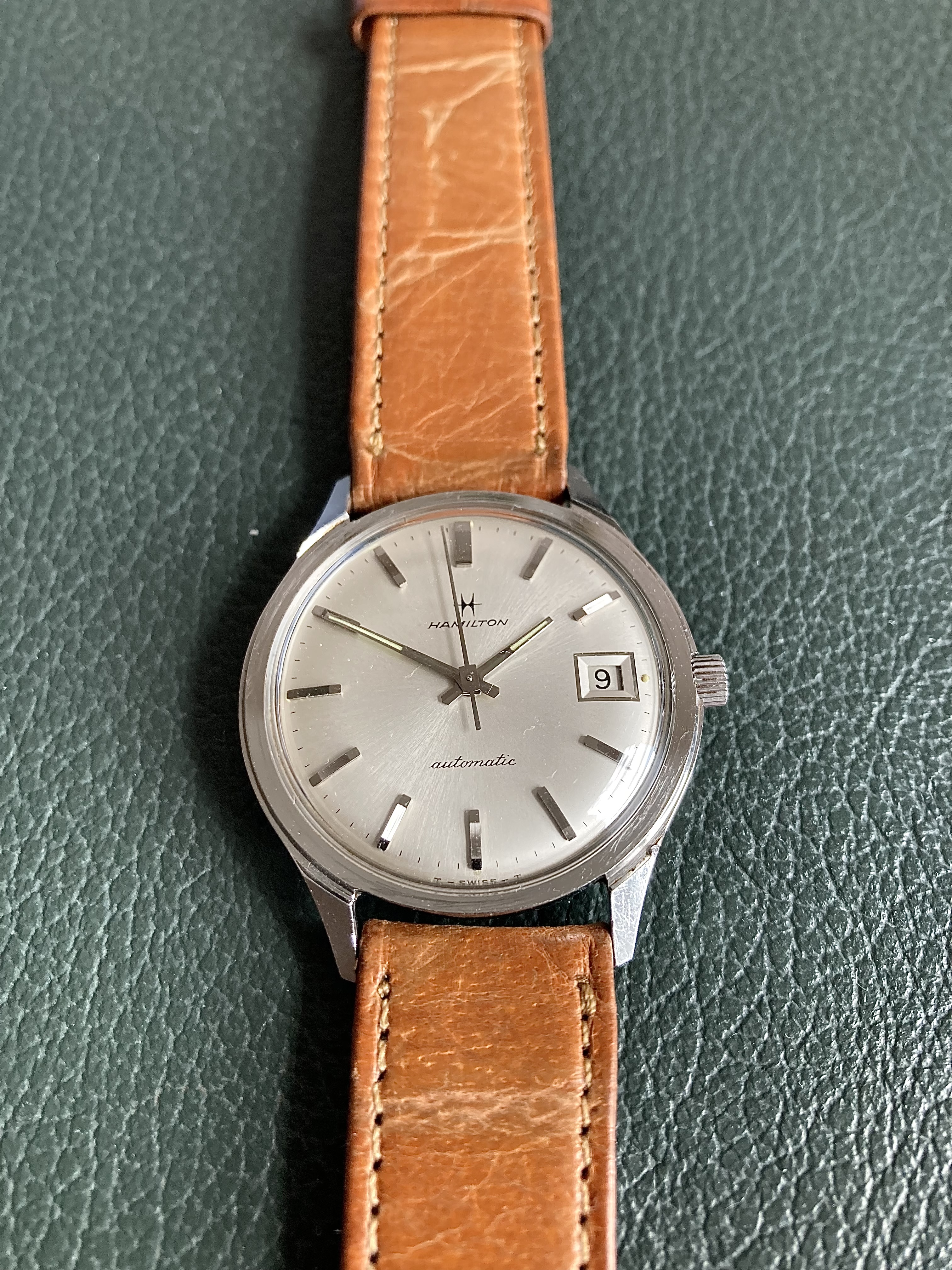

My Hamilton has a gouge in a similar place to the blemish on yours but I’ve learnt to live with it on mine.

Could be it is a welding “berry”. The watch may have been owned by a welder, although there would often be more than one of these. If this is a steel case, and if the “berry” is steel, with skillful hands and the correct equipment, it cold very possibly be removed with hardly a trace. But filing it of would not give the best results. Maybe live with it?

For a 70 year old watch, yours looks great. I'd leave the blemish alone. Think of it as a gentle reminder that your watch has had a long life of usefulness to its previous owners, and that it now stands ready to serve you in yours.

If that is actually solder that was used to fill a ding, then I don't know if there is really a great way to fix the problem. Even if you managed to refinish the surface so that the shape was restored, the color would not be the same. Personally, I would return the watch immediately and wait for a better one. If it was purchased on eBay, then it's an obvious return for "significantly not as described" reasons, so open a case ASAP. If the seller really thinks it's not an issue, then let him fix it.
Thanks -- I've been wearing it and I don't notice the blemish too much. I guess I just focus more on the dial, which I find to be attractive.
That's a lovely Hamilton, and I imagine it's not too difficult to ignore that gouge.
Thanks, this is good to know. The case is steel, but I'm unsure about the "berry".
This is helpful -- thanks. I was wondering about the potential for color match after reshaping. It does appear to be some sort of filler metal, but I'm not sure if its lead- or silver-based, or something else.

This looks like weld spatter. Inadvertent results of wearing a watch while welding.
Usually there will also be sign of this on the crystal also but it is hard to tell from these photos . ( Could be replaced crystal )
If the case is stainless steel you could just remove the blemish with light use of a fine file.

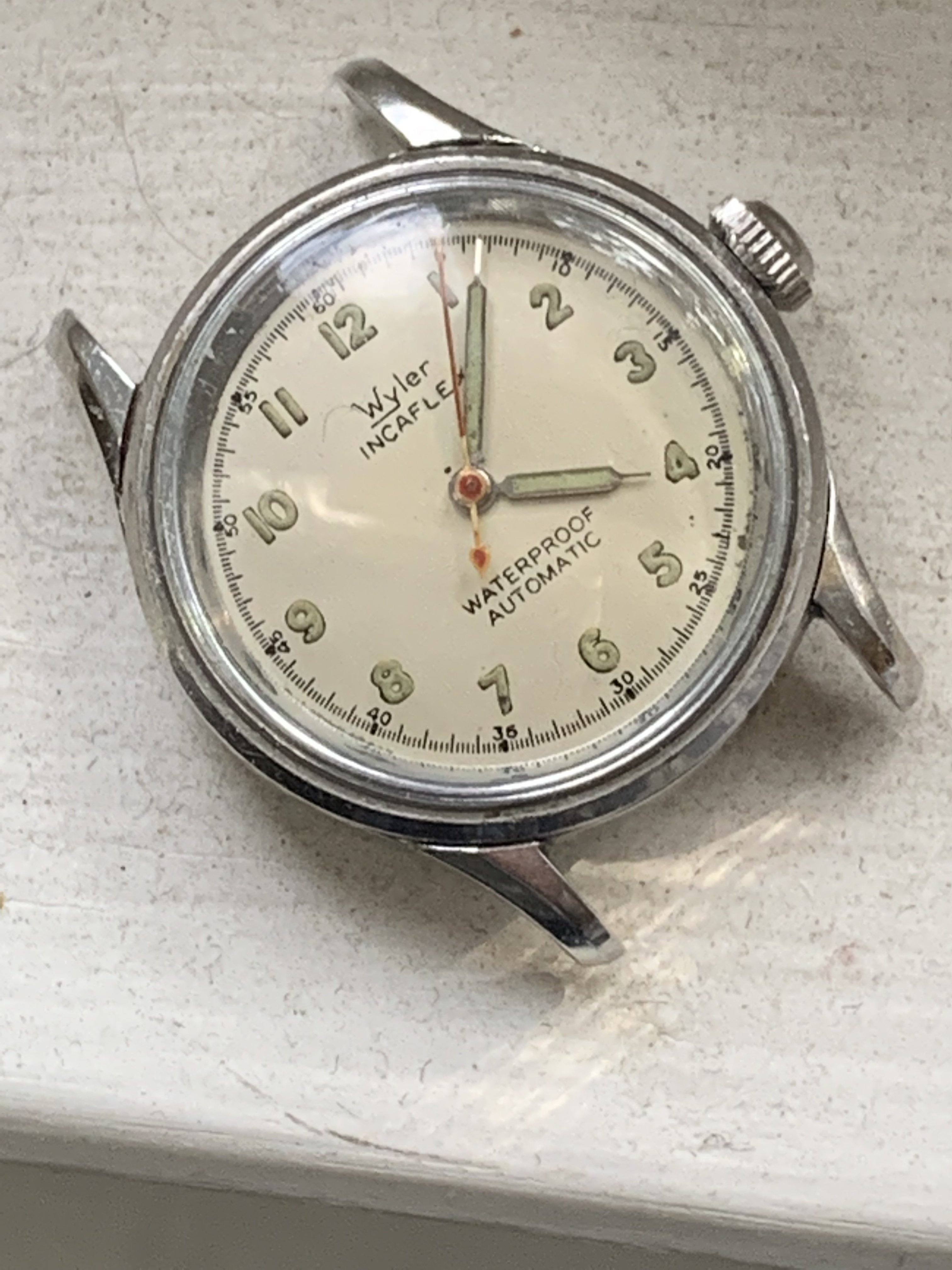

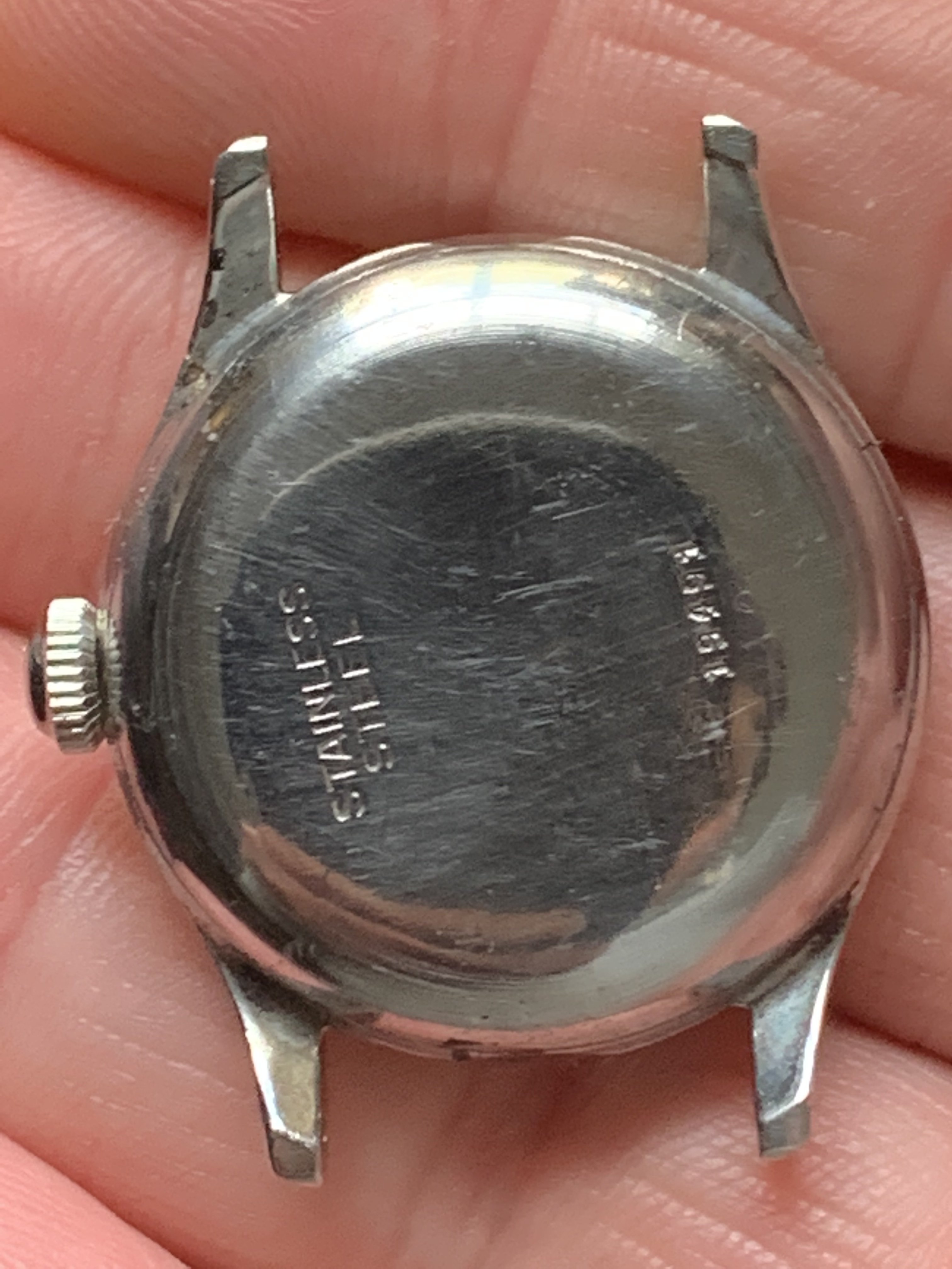

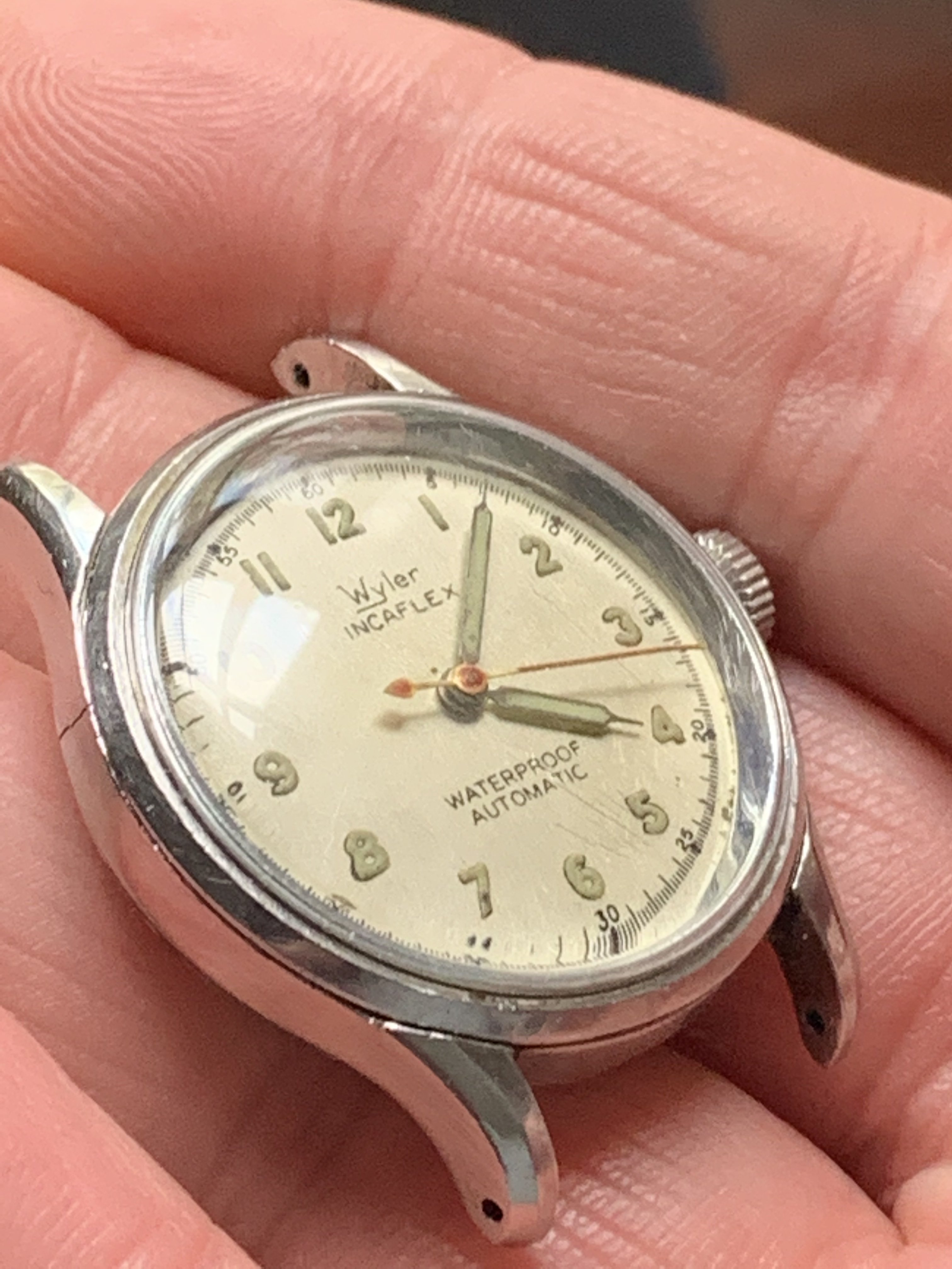

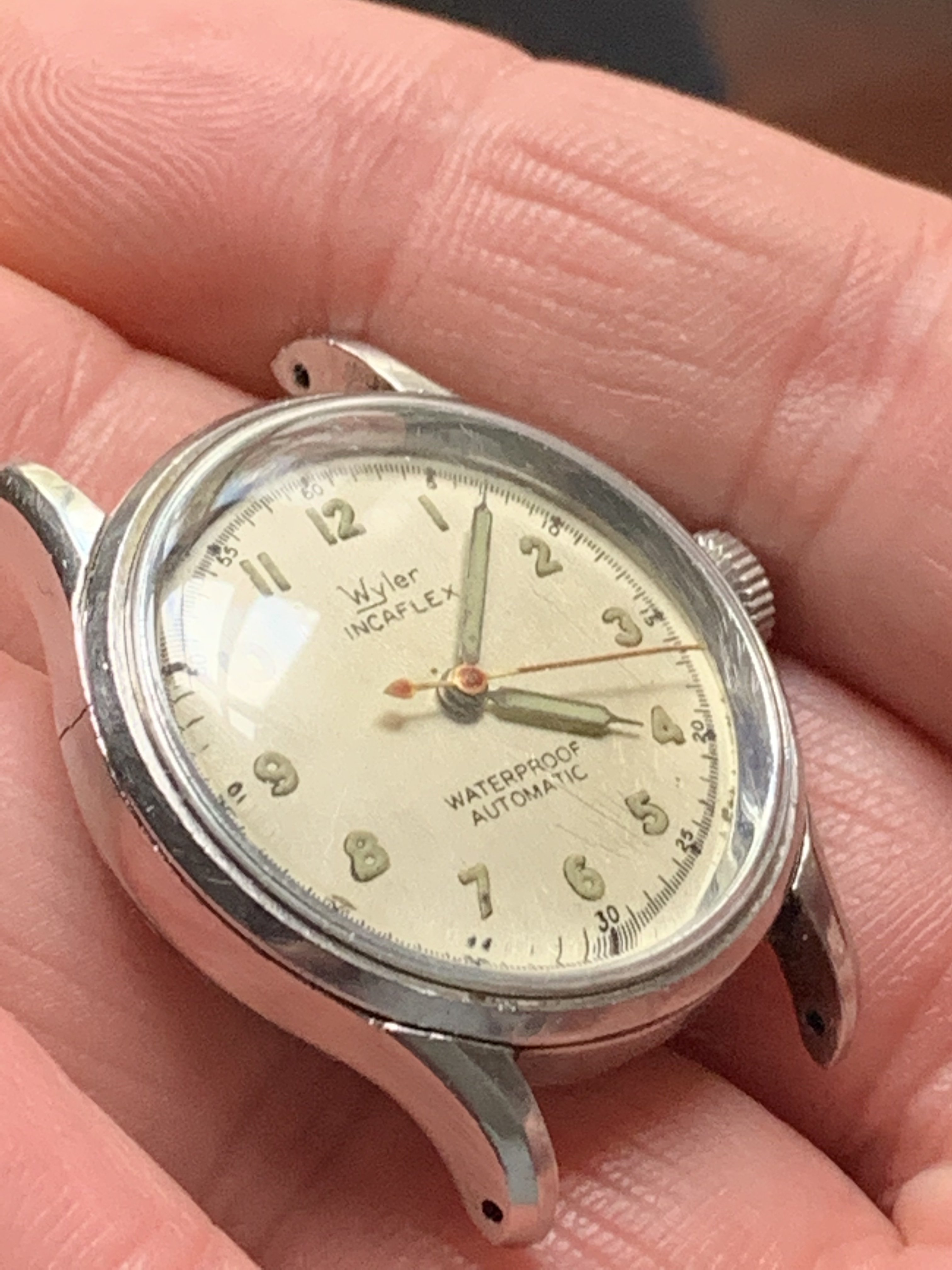

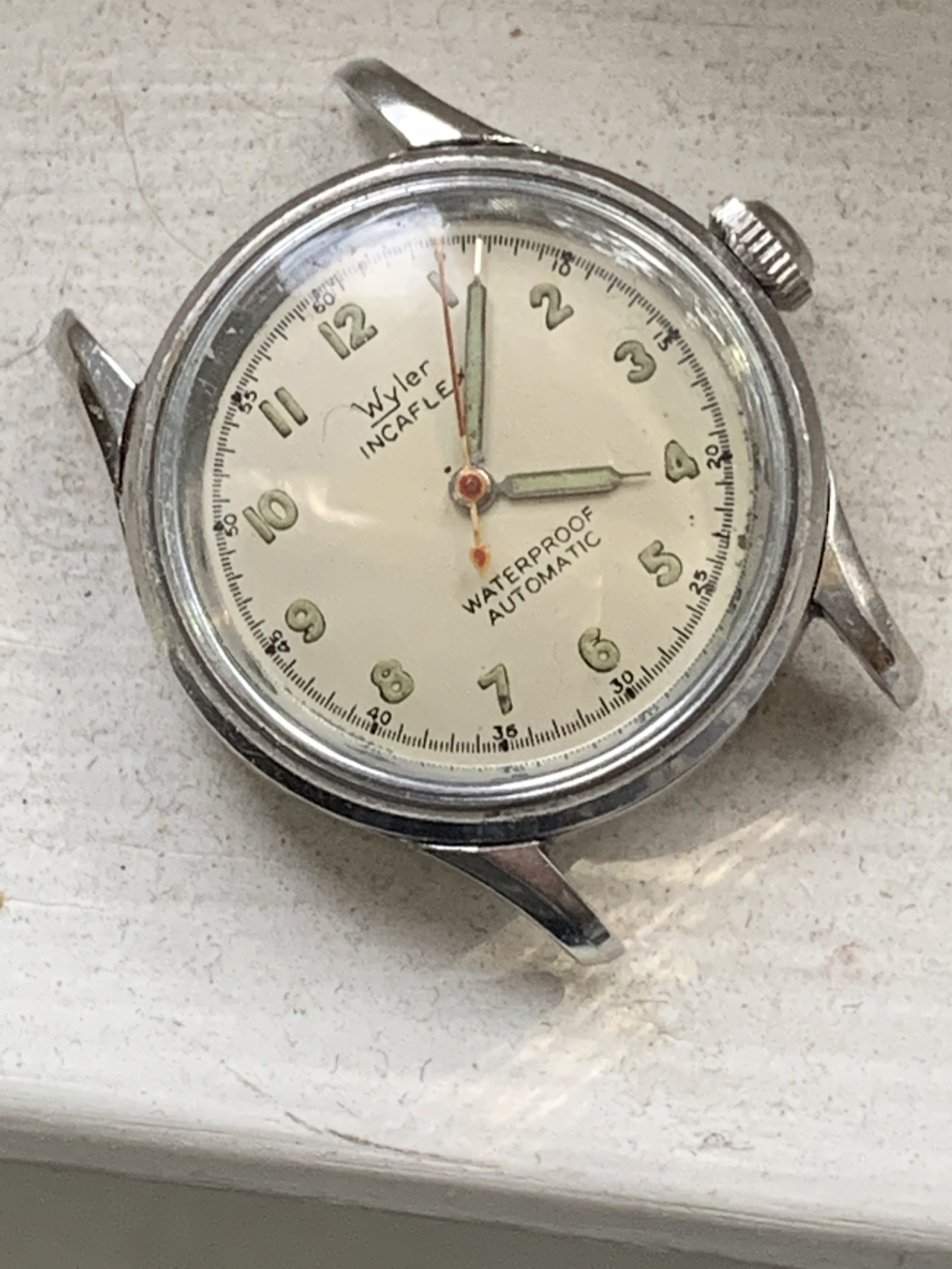

I have a lovely little Wyler that at some point in its life got a crack in the case.
Someone in their wisdom welded the case with the back on 🤦
It runs perfectly, but I don’t see this ever being serviced again without a can opener,
This would appear to make sense. The crystal was indeed replaced. Now I understand the welding "berries" mentioned above probably refer to this sort of spatter.

I recently purchased a Citizen in perfect new condition other than the addition of welding spatter (1) in the same place as yours and a crystal (glass) with a couple of small pin prick holes which I really scratched my head about till my WM pointed out the obvious ( welding spatter).
At the end of the day I just wear it and other than knowing it's there I never notice it.
Are you sure this is not a front loader . Most vintage Wylers I have seen are front loaders.

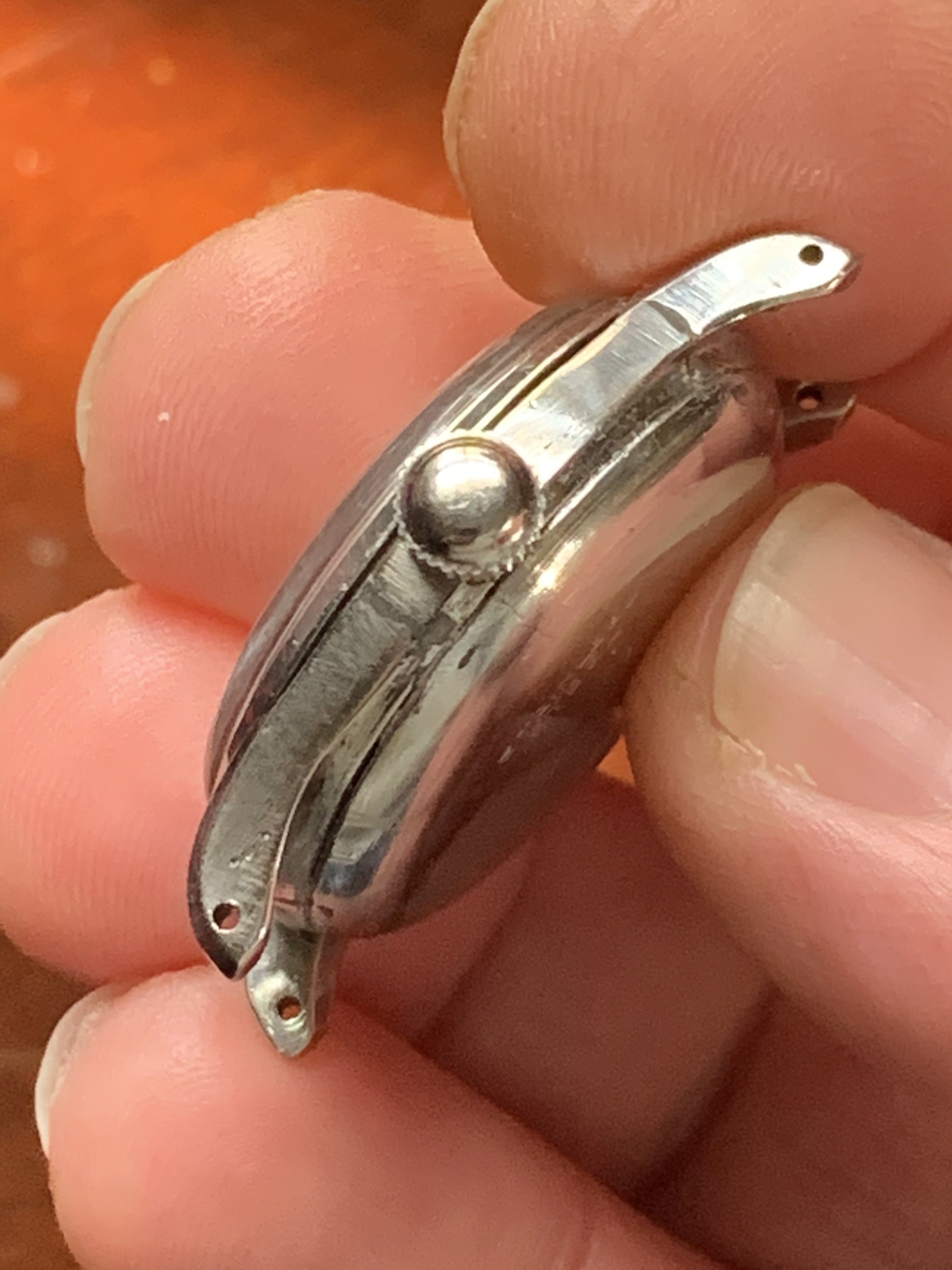

I figured I would dig up this old thread and close the loop.
As mentioned above, this watch arrived with a bead of metal on the case side -- thought to be welding spatter. I used a fine flat metal file to take it down most of the way. Then I switched to an emery board to finish it off. The case is stainless and already has its share of scratches and abrasions, so I was willing to give it a shot. I'm happy with the result and glad to keep this one running along.
