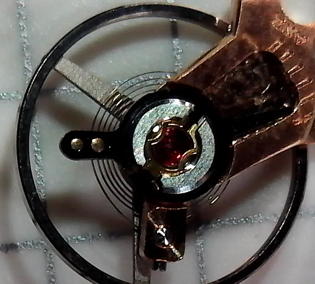

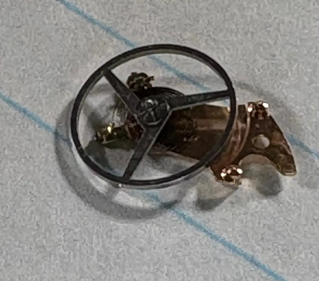

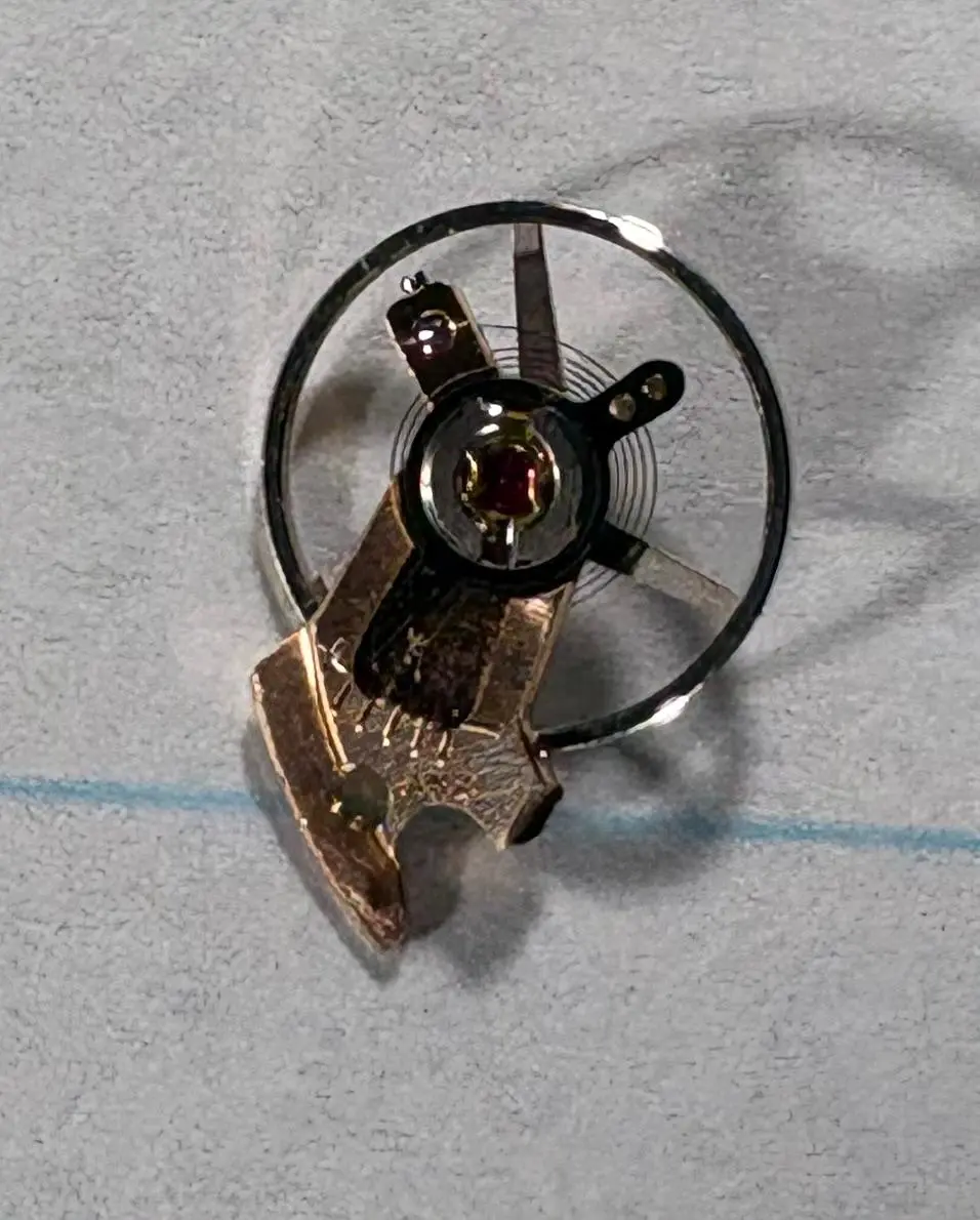

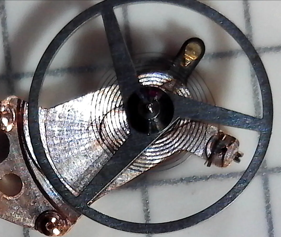

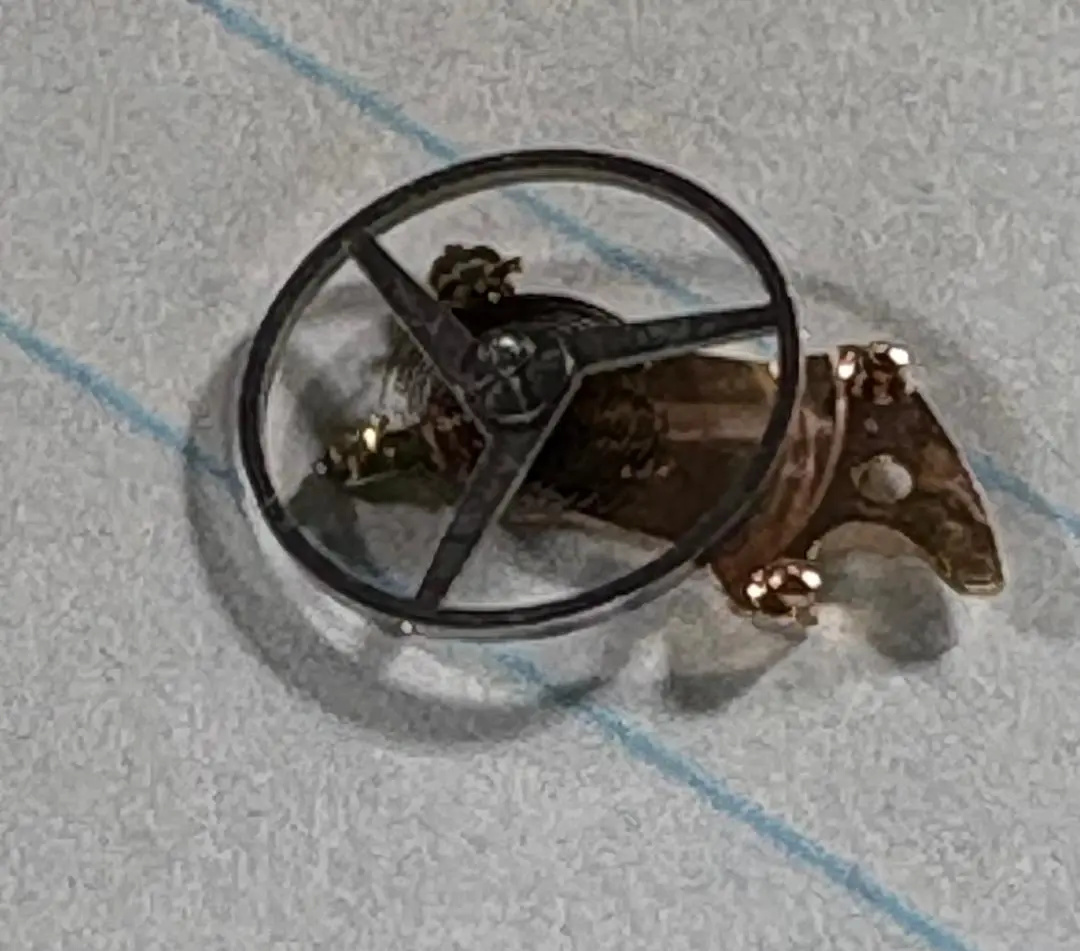

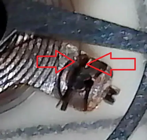

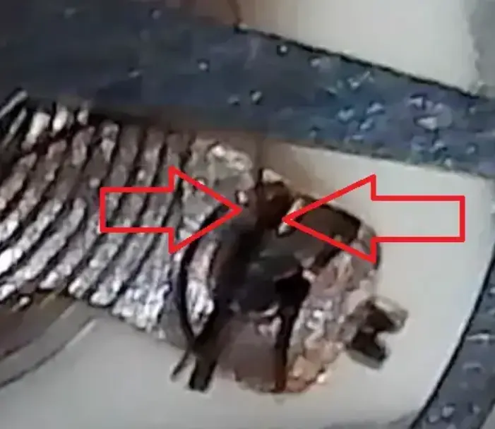

Here is the balance. Already have the watch back together. Possible that I simply needed to adjust the hairspring lug in a little to slightly shorten?
Crappy pics. I'll work on better.
Here's a better one
4,455
10,789

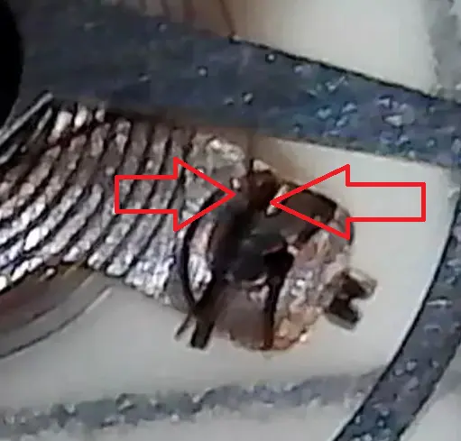

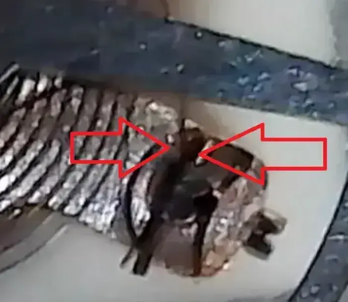

uh oh. Just saw the bent hairspring in the pics. This is the problem?

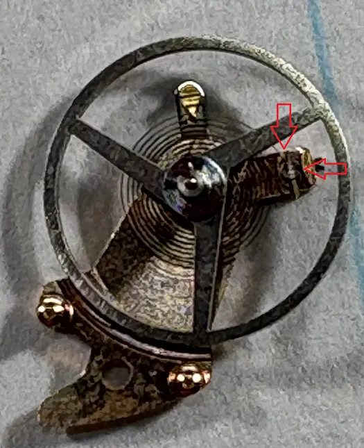

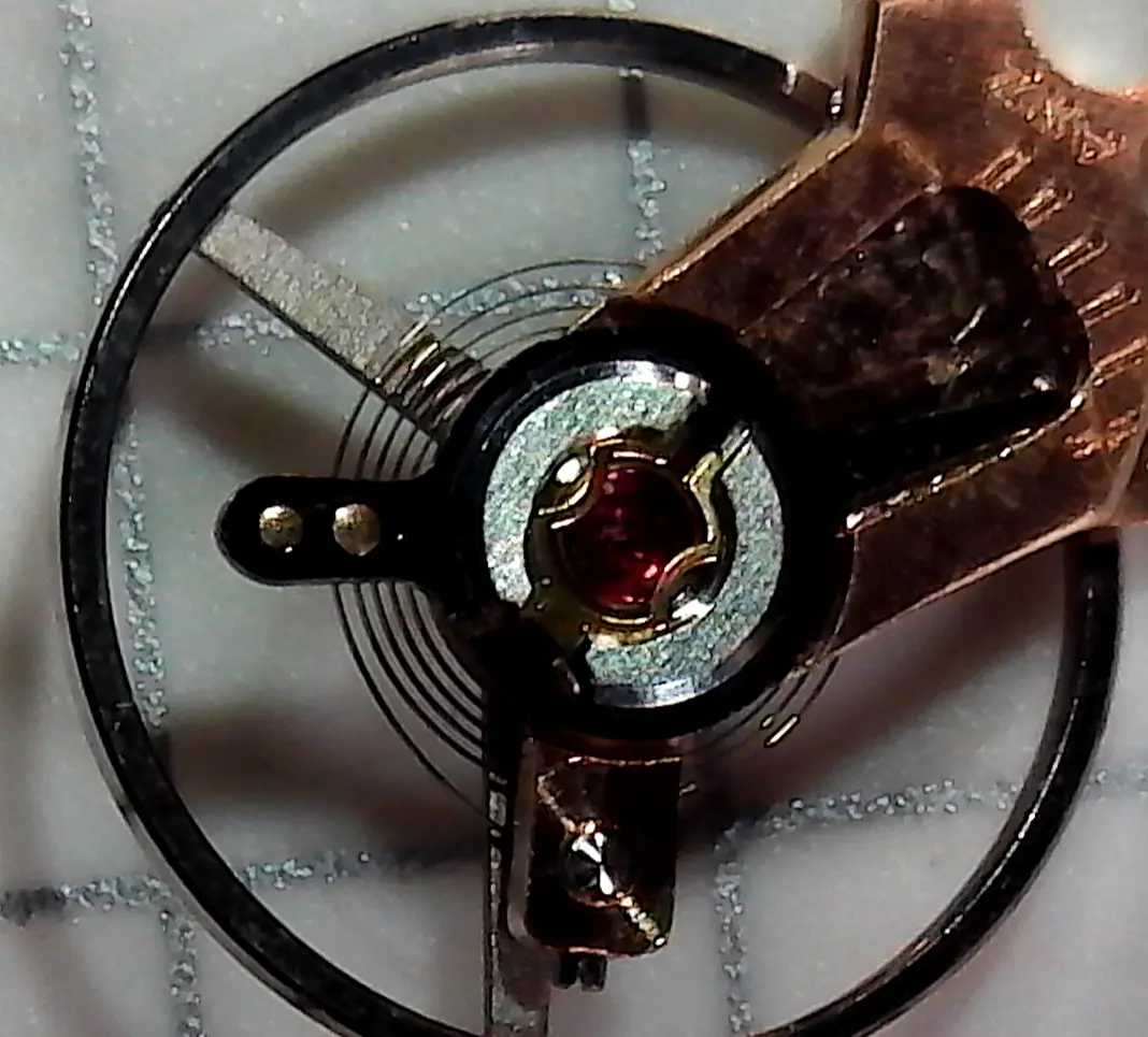

It was running beautiful is why my head hurt. When I swapped balances, the problem was solved. I'm convinced the issue was with the hairspring. You notice that it is slightly bent which would possibly advance the fulcrum forward (lengthen) out of the adjustment range. It still looked fine when static (from the top). I'll play with it a little bit more when I have more time.
281
456
A bend right at the stud is very common and usually one of the easier hairspring fixes. It's best analysed and even fixed when the balance is in place.
4,455
10,789
I've seen it and it usually disforms the overall shape. This one is still beautifully round. Simply didn't check. It happens.
