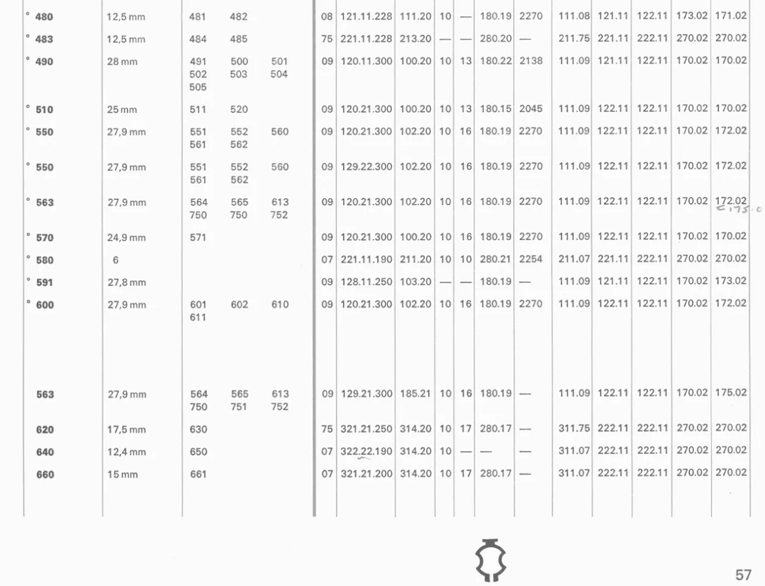

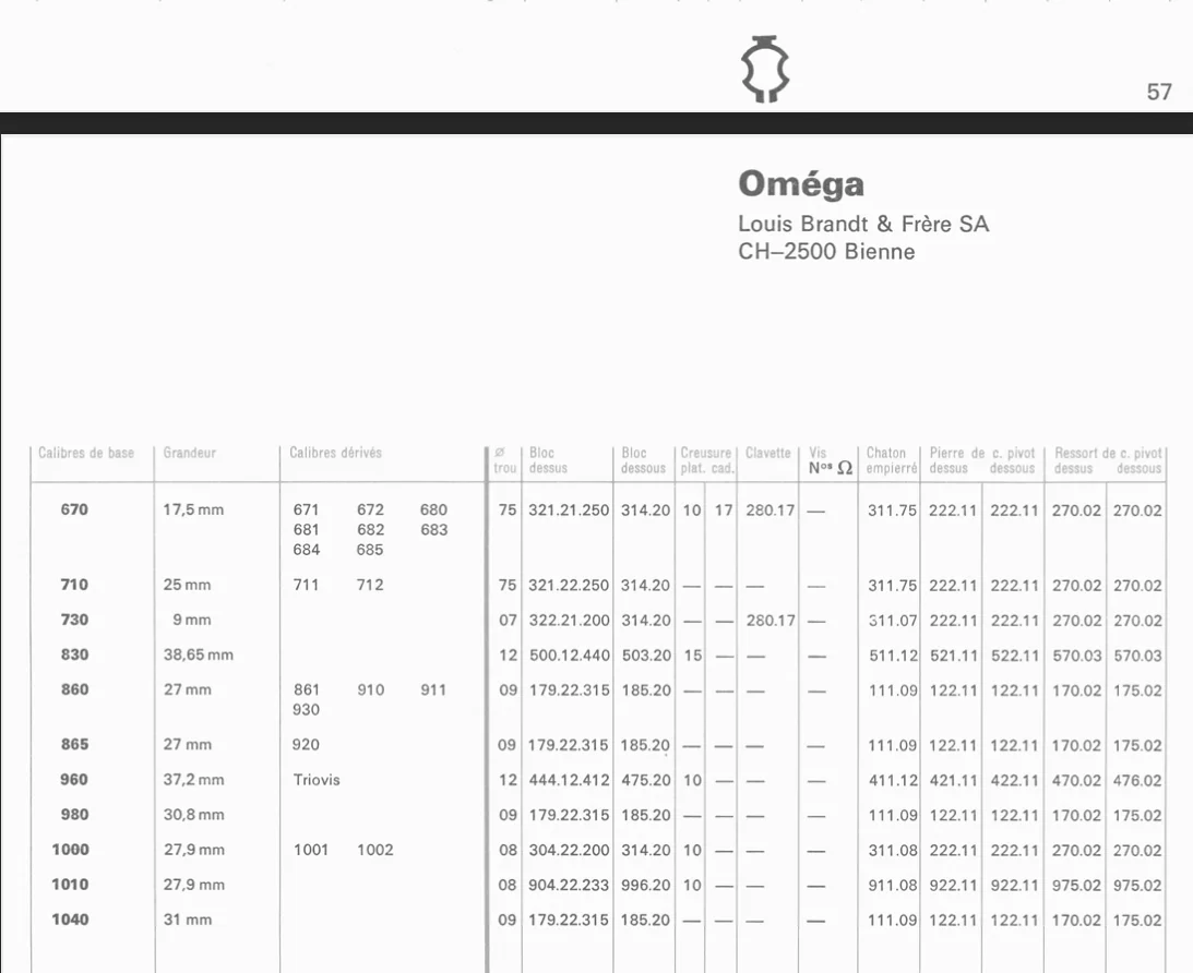

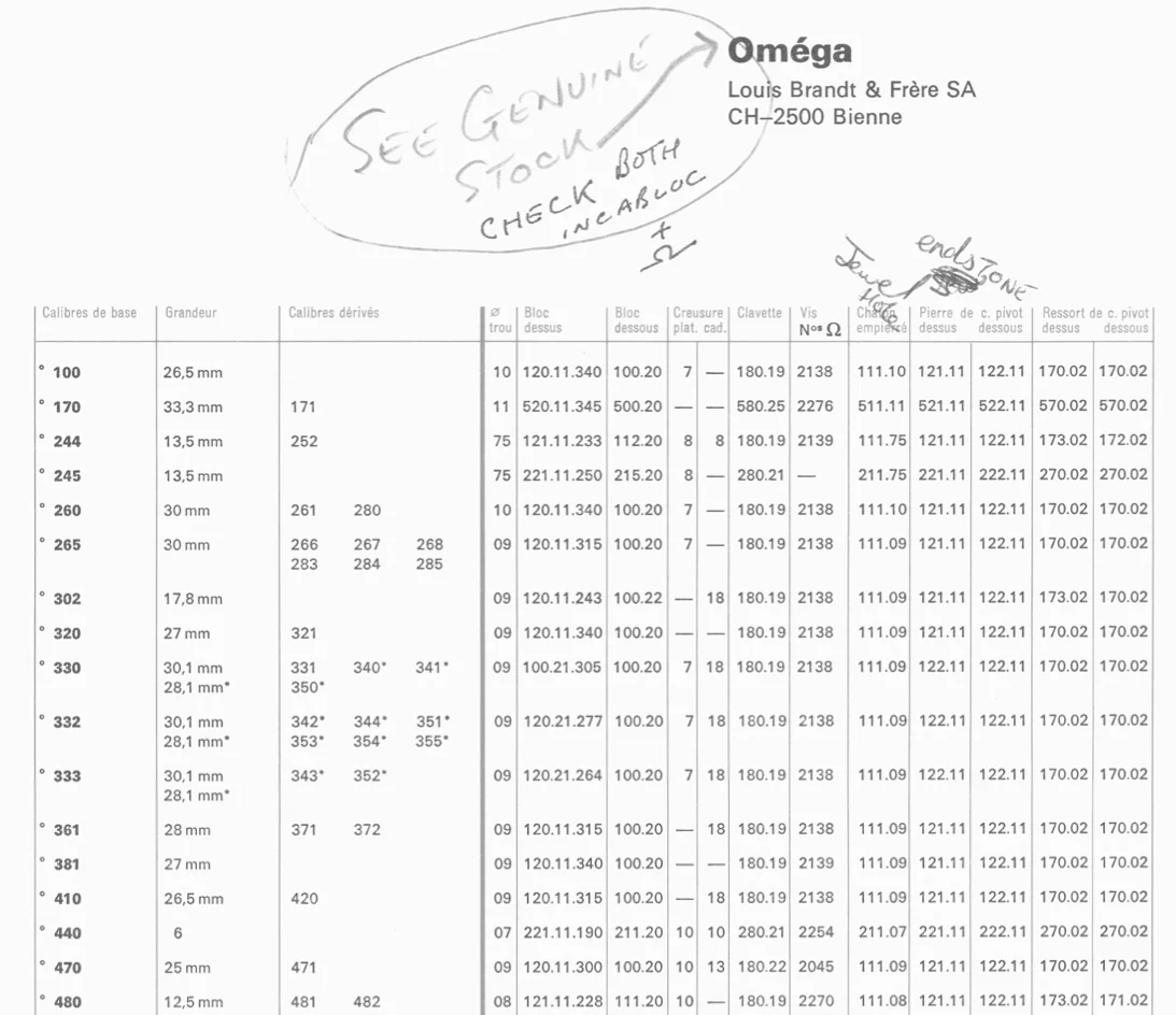

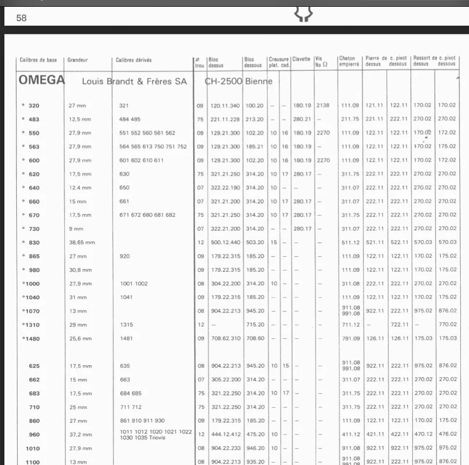

I found a chart here / posting it again as it can be hard to locate. Often the incabloc fittings are interchangeable. Most of the time I get odd assortments. Back in the day I found the parts often were impacted in the cork of the storage bottle. Most sellers split the packages and sell by the piece.
I have used the stocking trick on the vac. One has to be careful as too much suction such as a crevice tool rips holes in it. Magnets can also work on steel parts. Some of the incabloc stuff like the springs are steel or Iron alloy. The cups may also be plated. I have seen them rust in alum.
