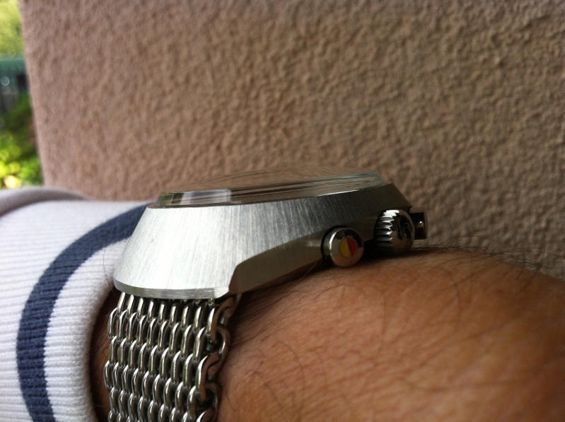

The 145.013 has the domed crystal and the later models have the flat crystal. The 5147 crystal is domed but possibly not as much as shown in that picture. Unfortunately I dont have a side on pic of my flightmaster but I think it has its original crystal still fitted
61
20
Exactly. The height of the 145.013 and the 145.026/146.036 are the same but the cases are taller for the 026 and 036 where the chystal is taller for the 013.
