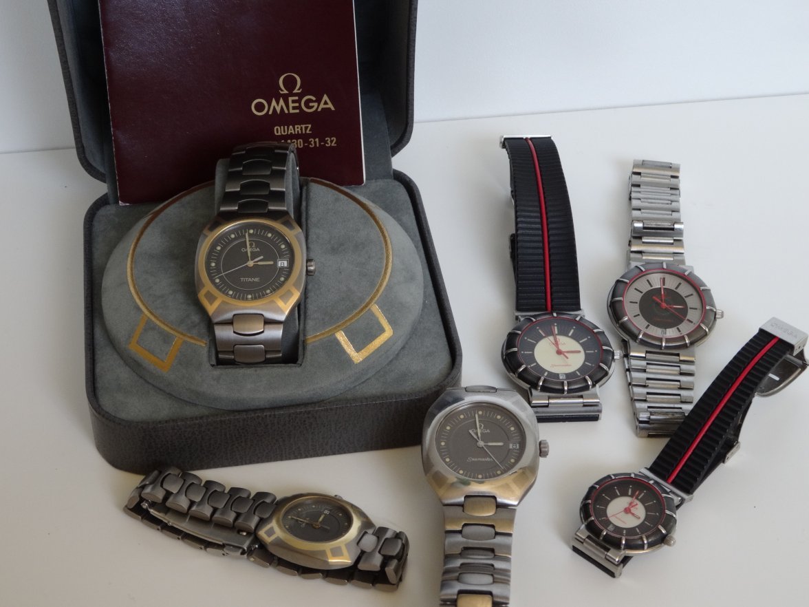

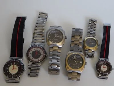

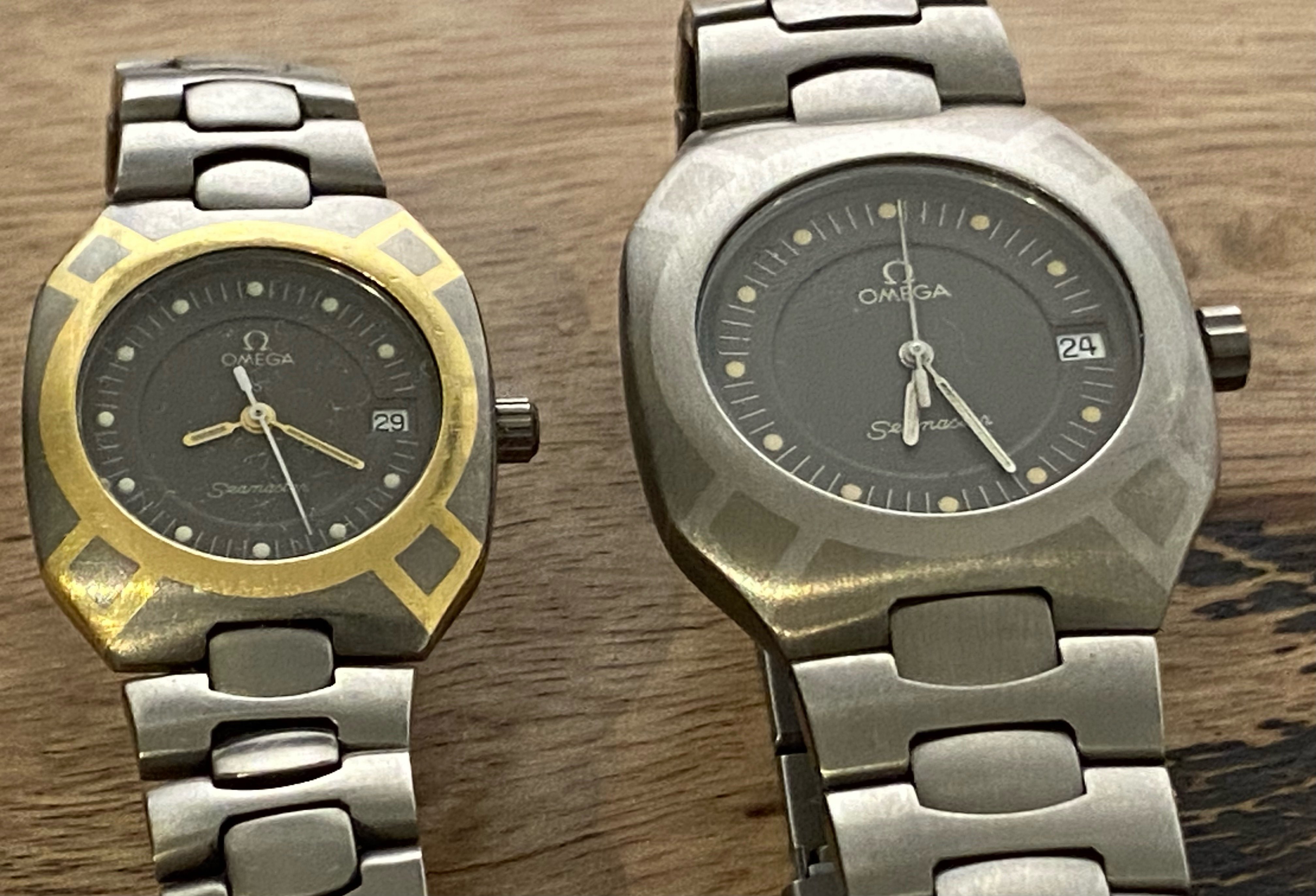

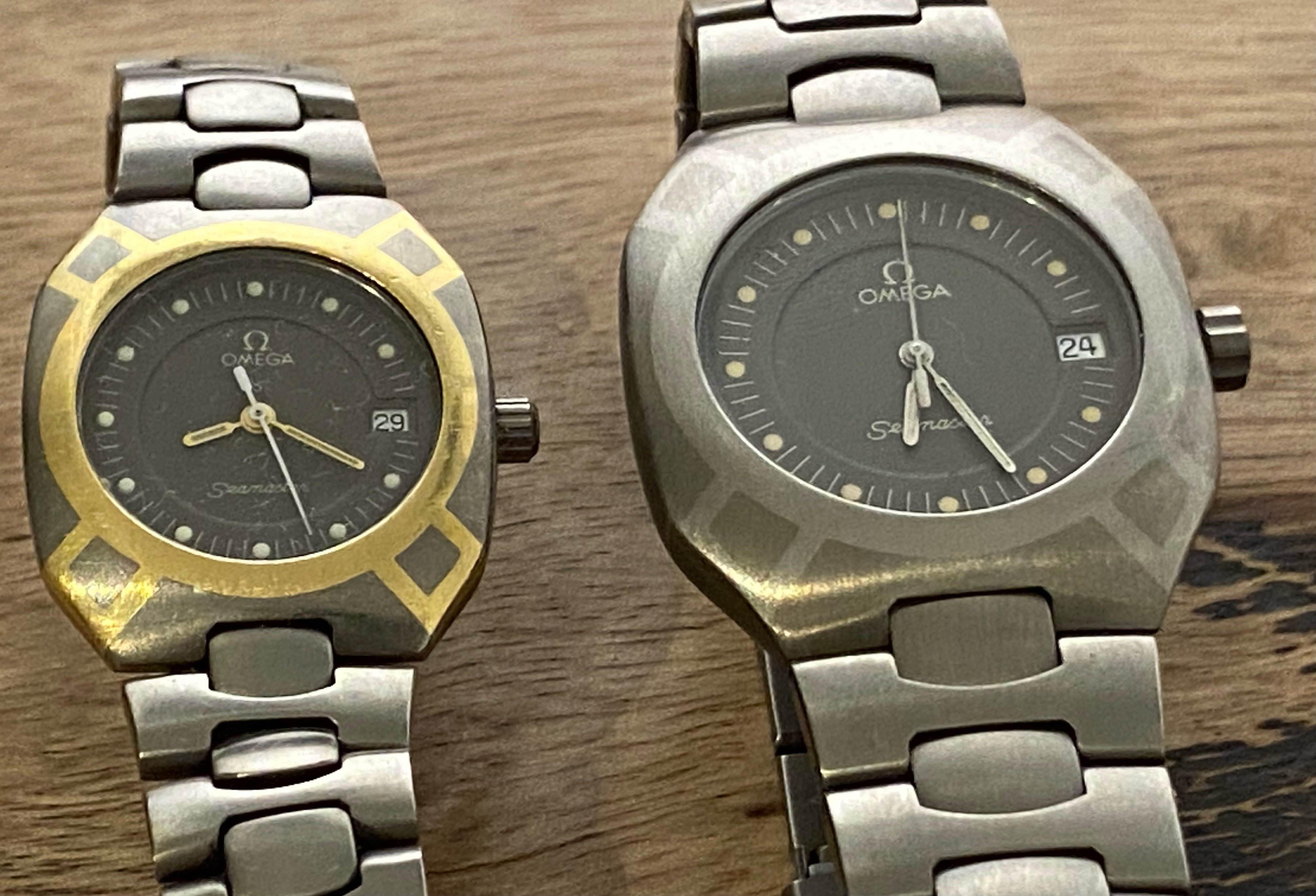

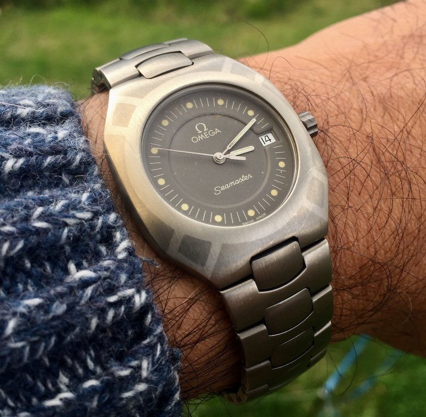

Hello Omega friends,
My wife and I have a pair of Omega Polaris Titane Seamasters which were given to us by our parents in the 80s. Hers is the version with gold inlay, mine has the palladium inlay. Both are quartz (yes I know, not very collectible) but despite this, they carry a lot of sentimental value for us and would like to keep them going (hers has stopped working, mine running a little fast).
My questions:
1) what is the ETA reference number for our watches?
2) any recommendations for sources of replacement ETA movements?
3) Are there any other Polaris Titane fans on this forum? Would love to connect with you.
Thanks in advance.
Maurice
Pics for attention 馃榾

Don鈥檛 know what would be the appropriate movement swap, but I鈥檓 sure a watchmaker with a parts account can look it up and do the work for you.
I also wanted to say I鈥檝e never seen the palladium version before. Very cool.

Hi Maurice,
These can still be serviced by omega or an omega authorised centre or watchmaker.
I have owned a few over the years, and when I last had once serviced for a family friend in 2021, movements, dials, hands, links, clasps, crowns and crystals were all still available.
Where in the world are you? We perhaps collectively could recommend someone to take care of these.
2,349
1,477
A check shows the men's movement is an ETA 955.411
Watchmaker was taking apart to clean and stated ETA caliber number stamped inside on main plate
Couldn't find anything on the womens model
Further check says the 955.412 replaces the 411

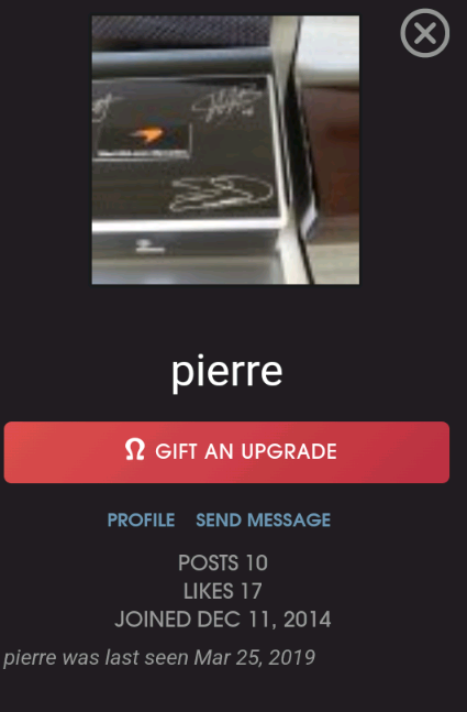

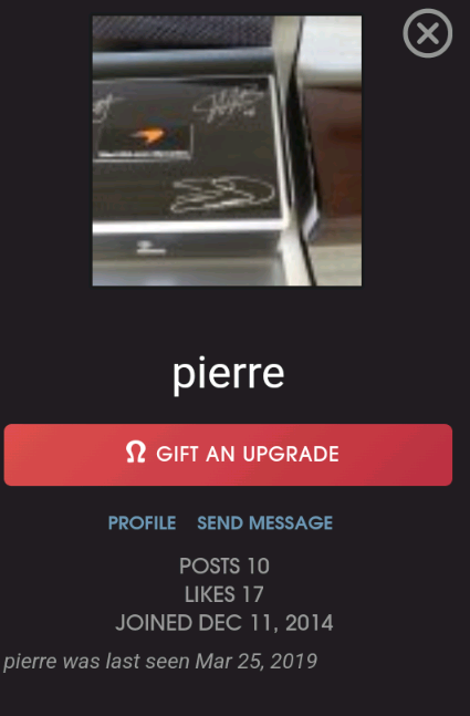

Thanks for checking. I was hoping to connect with him for Polaris info...
Over 4 years since he has been seen;

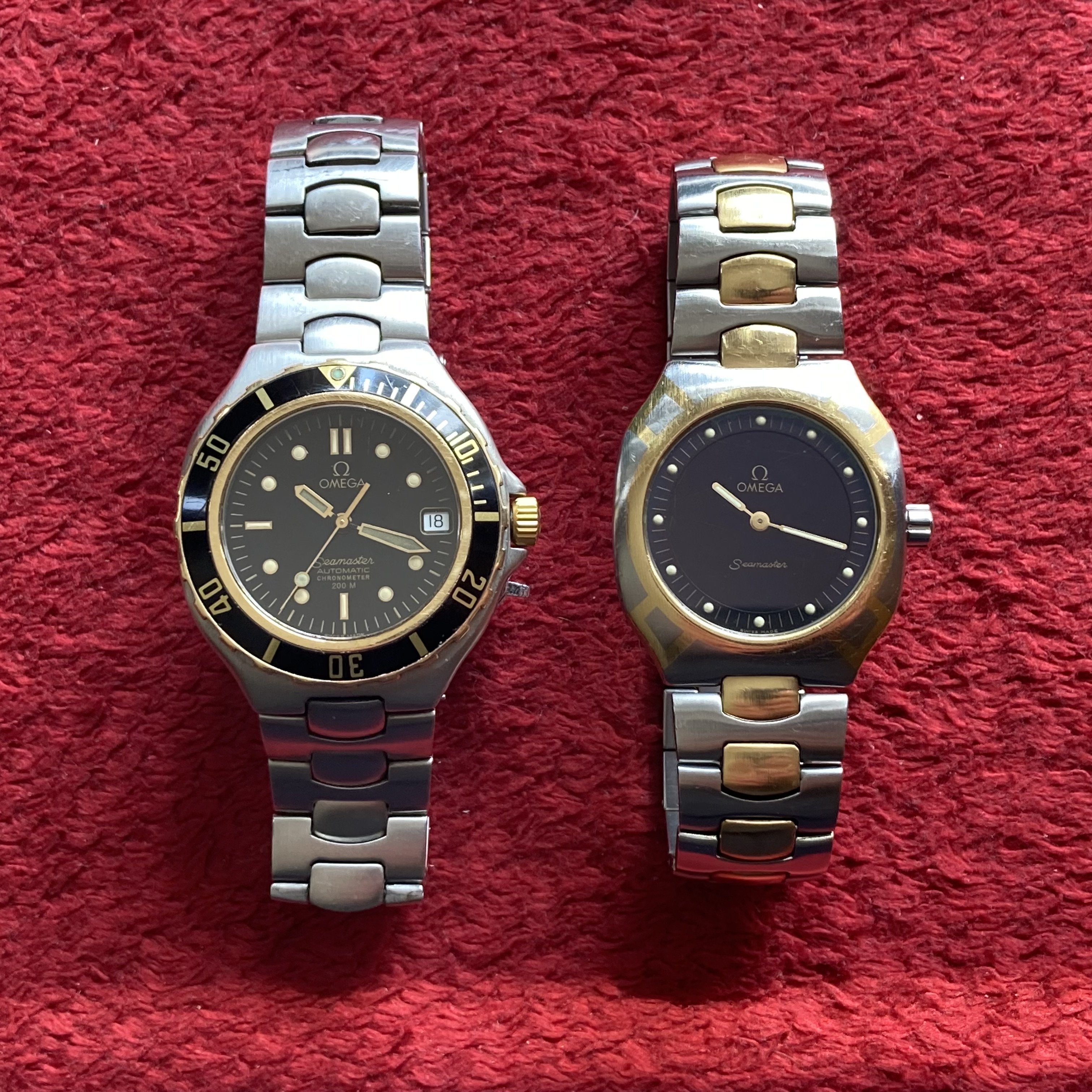

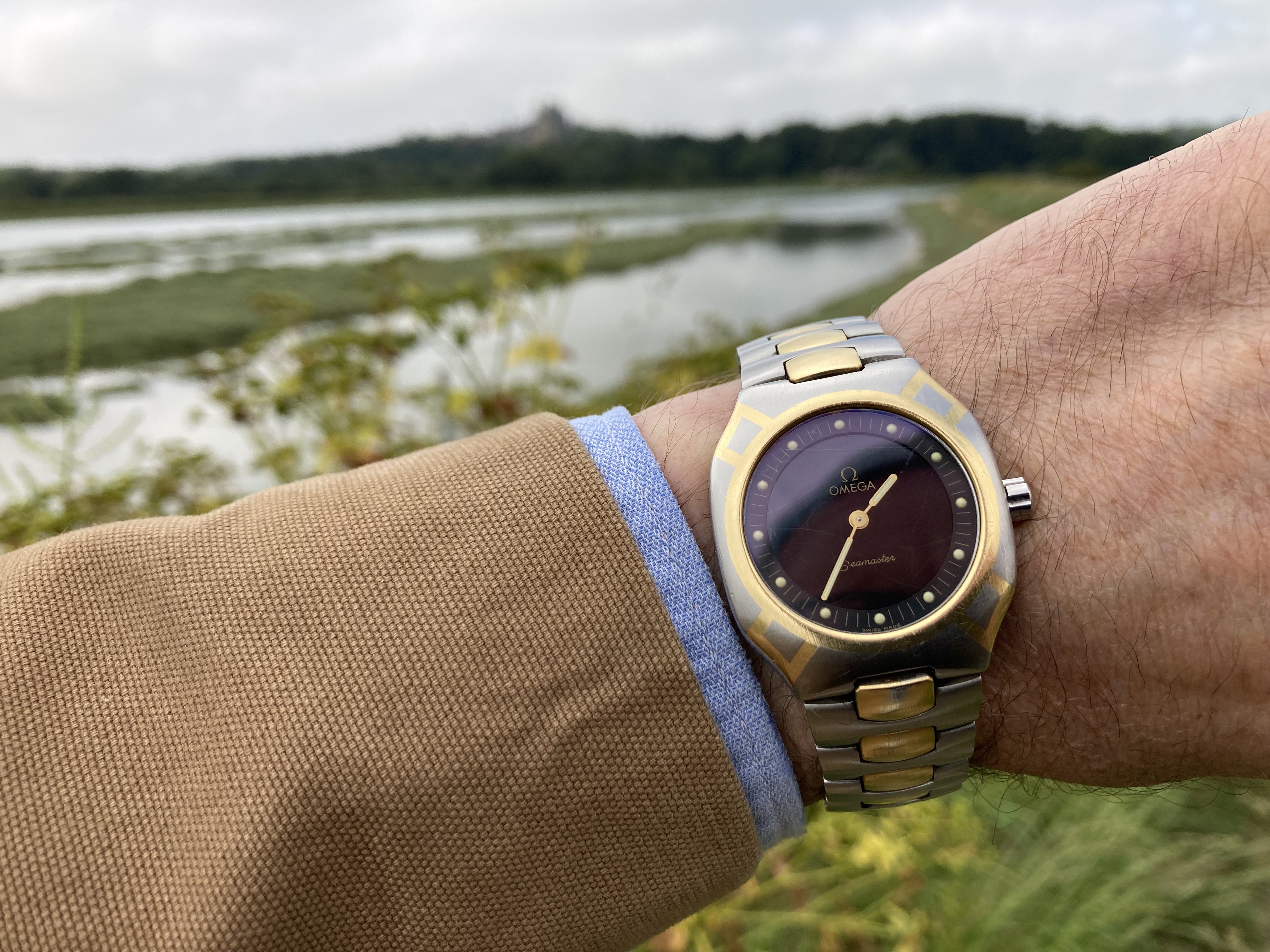

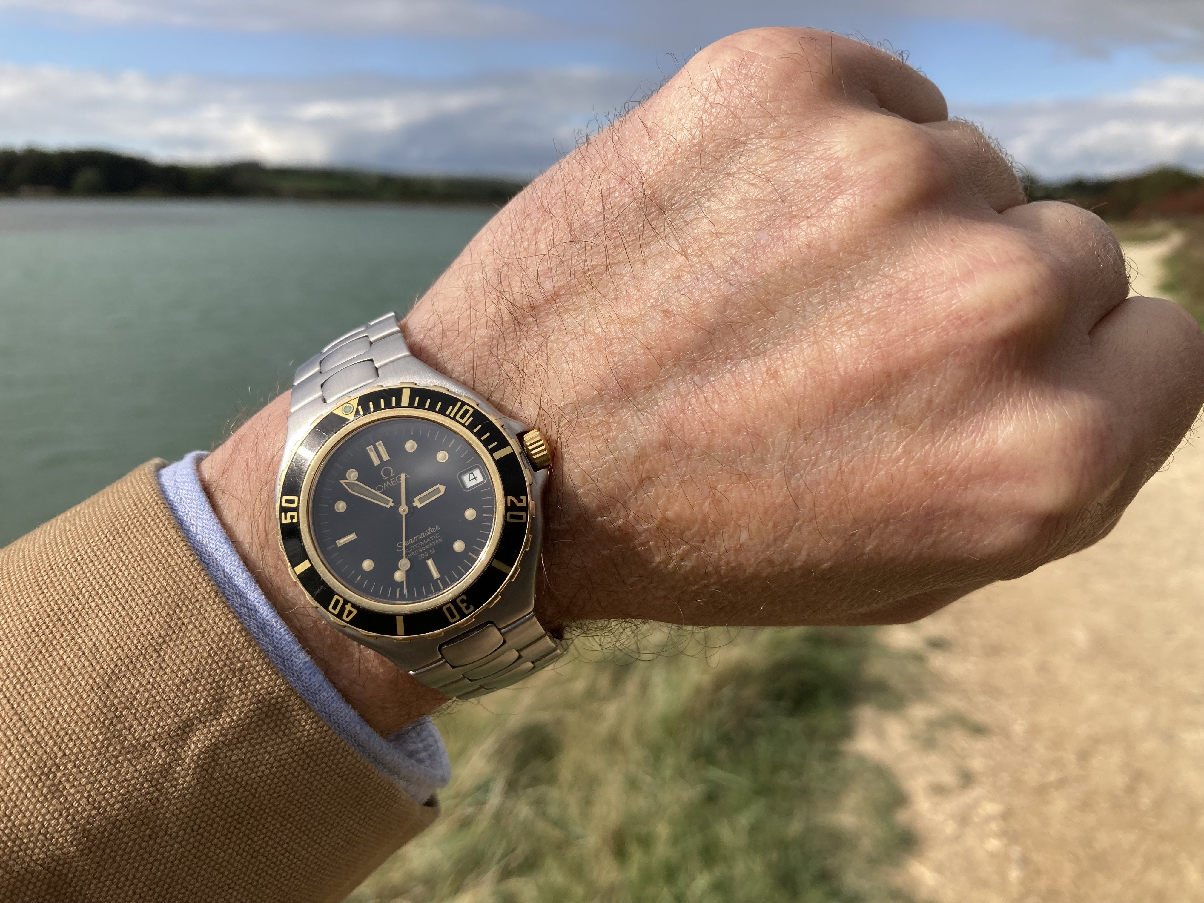

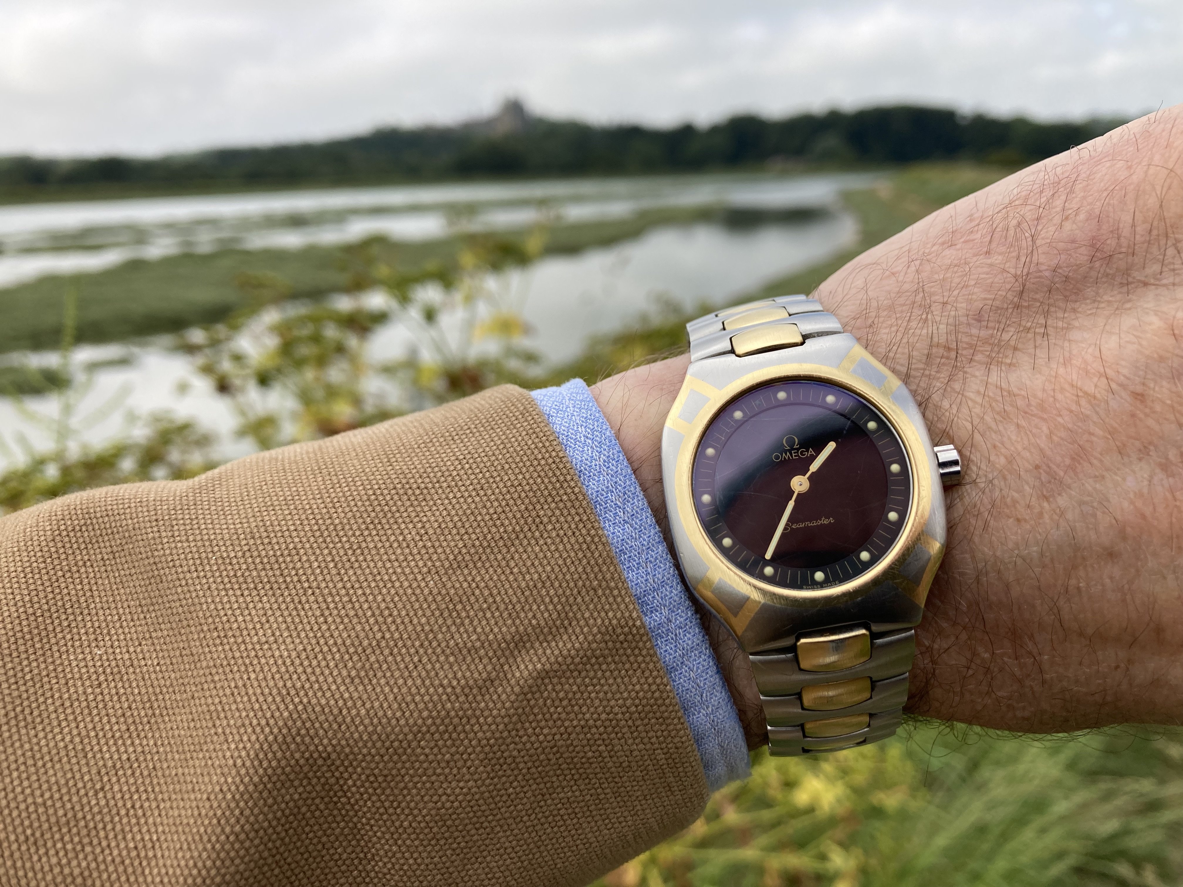

Greetings 365, My 1990 Polaris multi-function still gets plenty of wrist time since my Ma bought it for my 21st.
Recently bought a midi pre-Bond companion piece which is just as comfy to wear but has had a tough life.
I've always had a hankering for a Titane especially the mechanical chrono but sure it will sit well on my slim wrist
I only just discovered there was such a thing as the Palladium version a few months ago - very sweet. Congrats
269
1,064

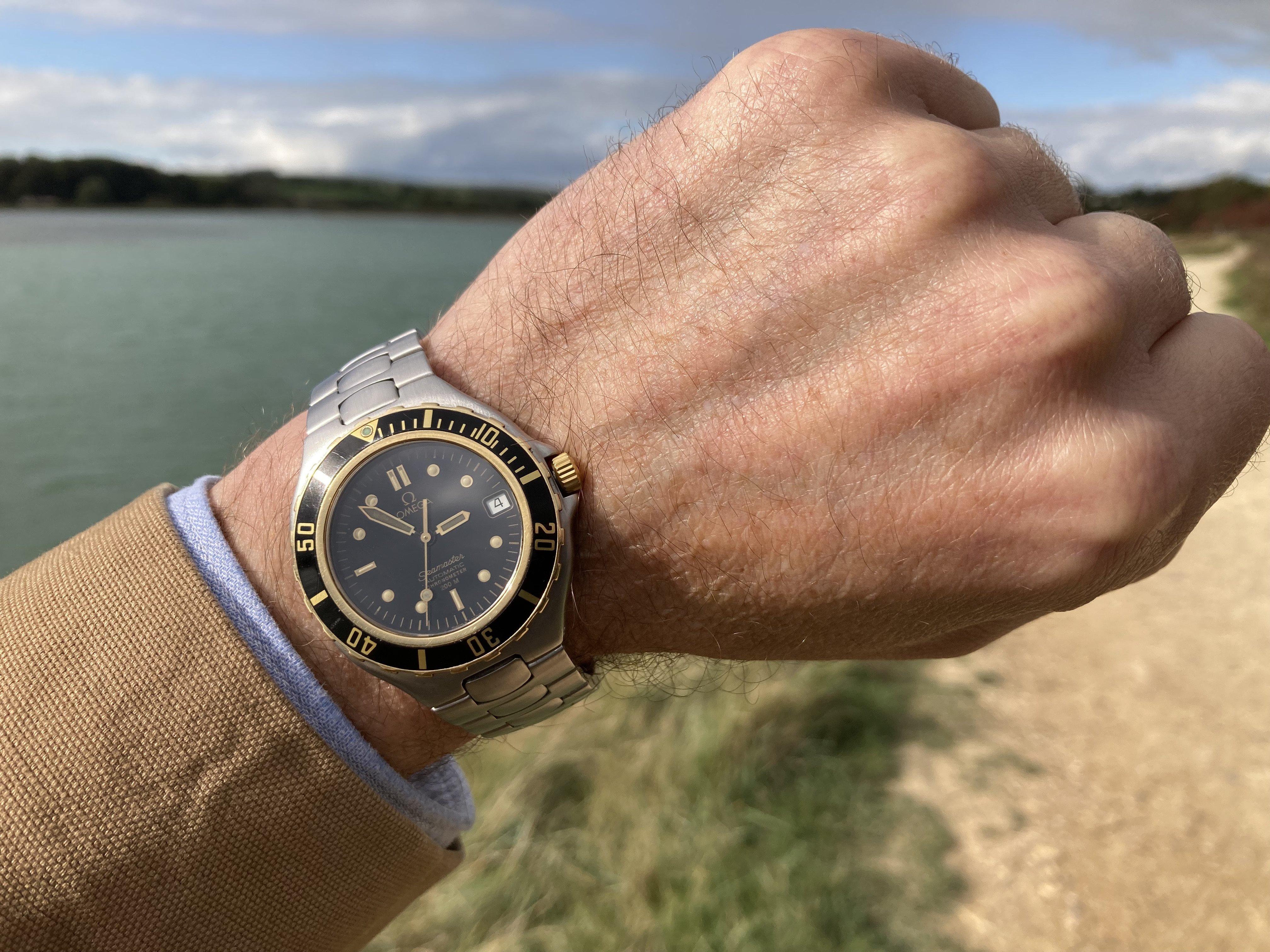

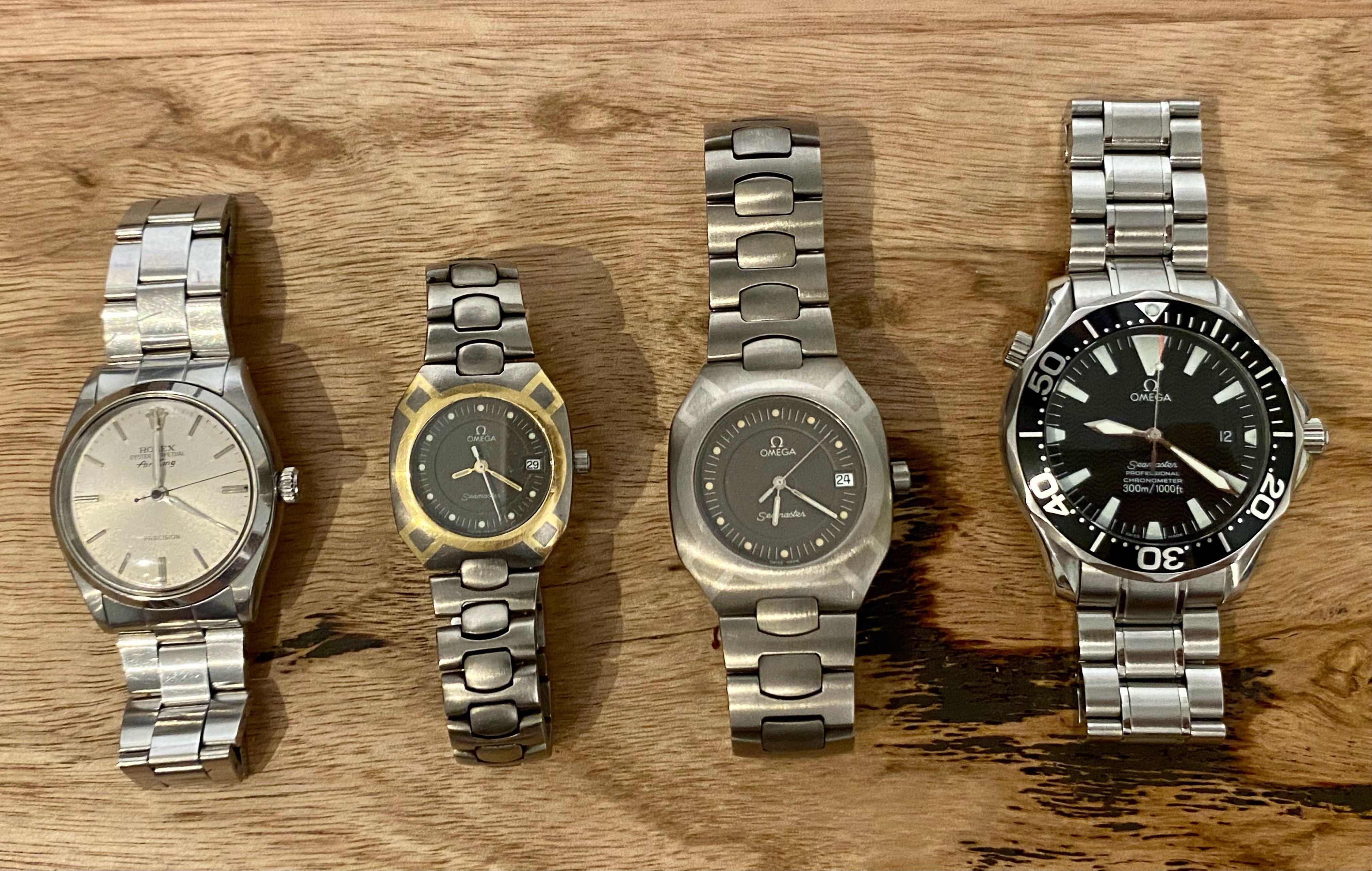

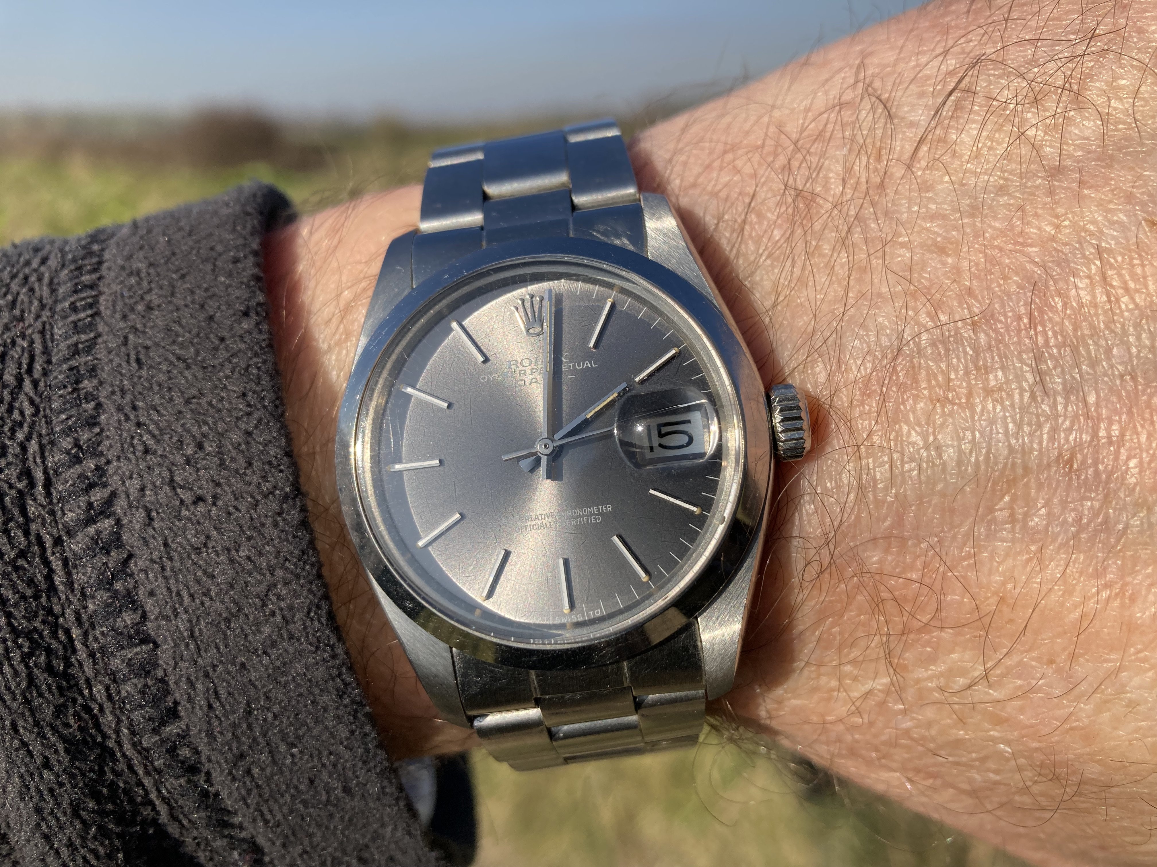

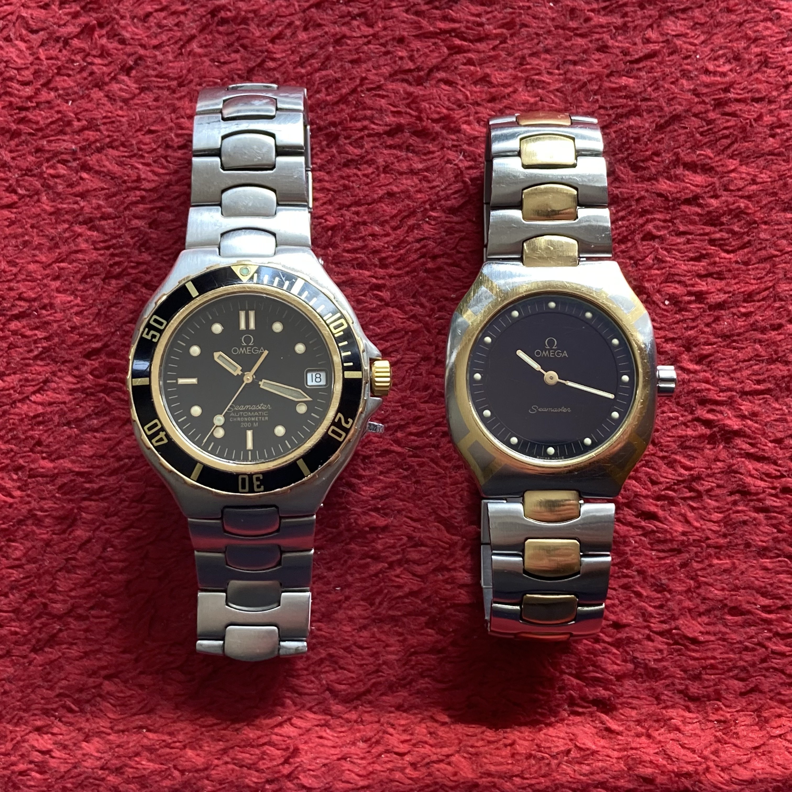

My OP date says hi too and wondering if the rest of your collection looks like?
9
3

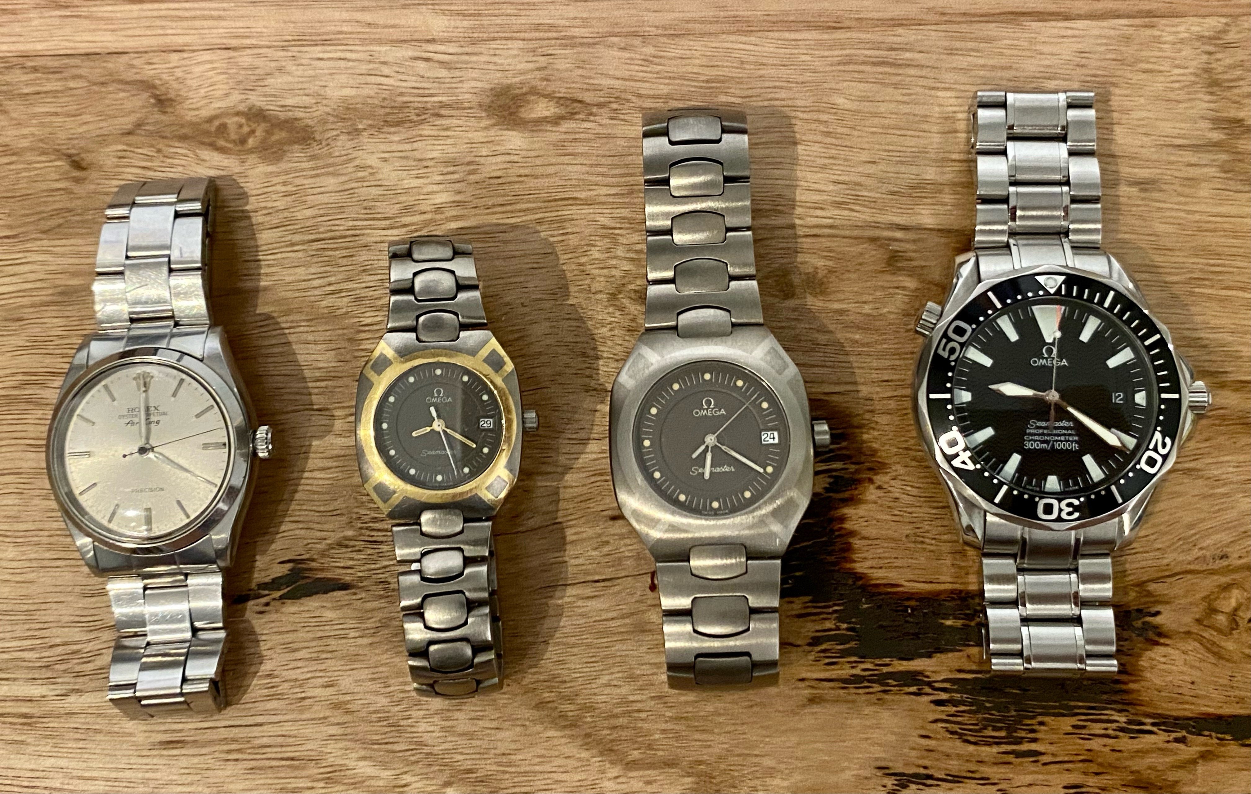

Greetings GarethS! From one Polaris Titane to another let me congratulate you on your fine taste!
The black/gold looks very striking in those pics. Thank you for appreciating the more subtle Palladium which tends to fly under the radar. Here's another pic below. My other Omega is a 2254 but I do have a hankering for a 1950s Seamaster...and a baby PloProf...oh where does it end!?
Enjoy your collection in good health 馃榾
