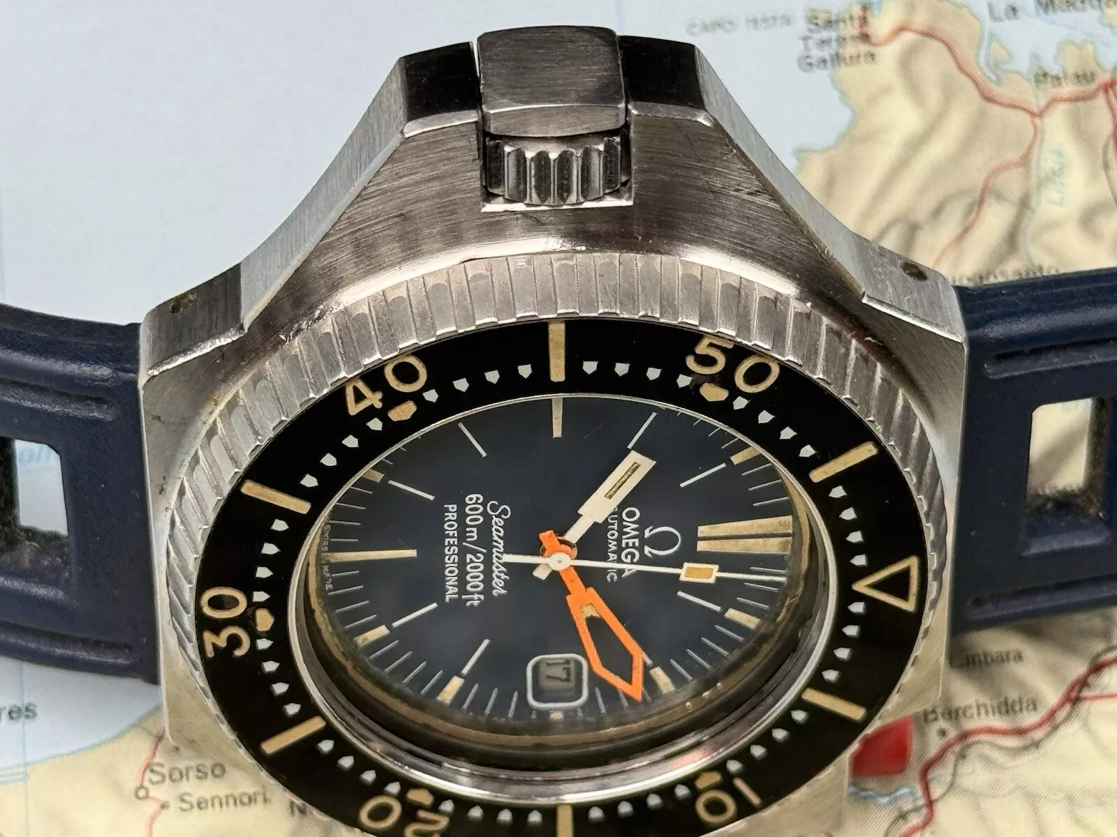

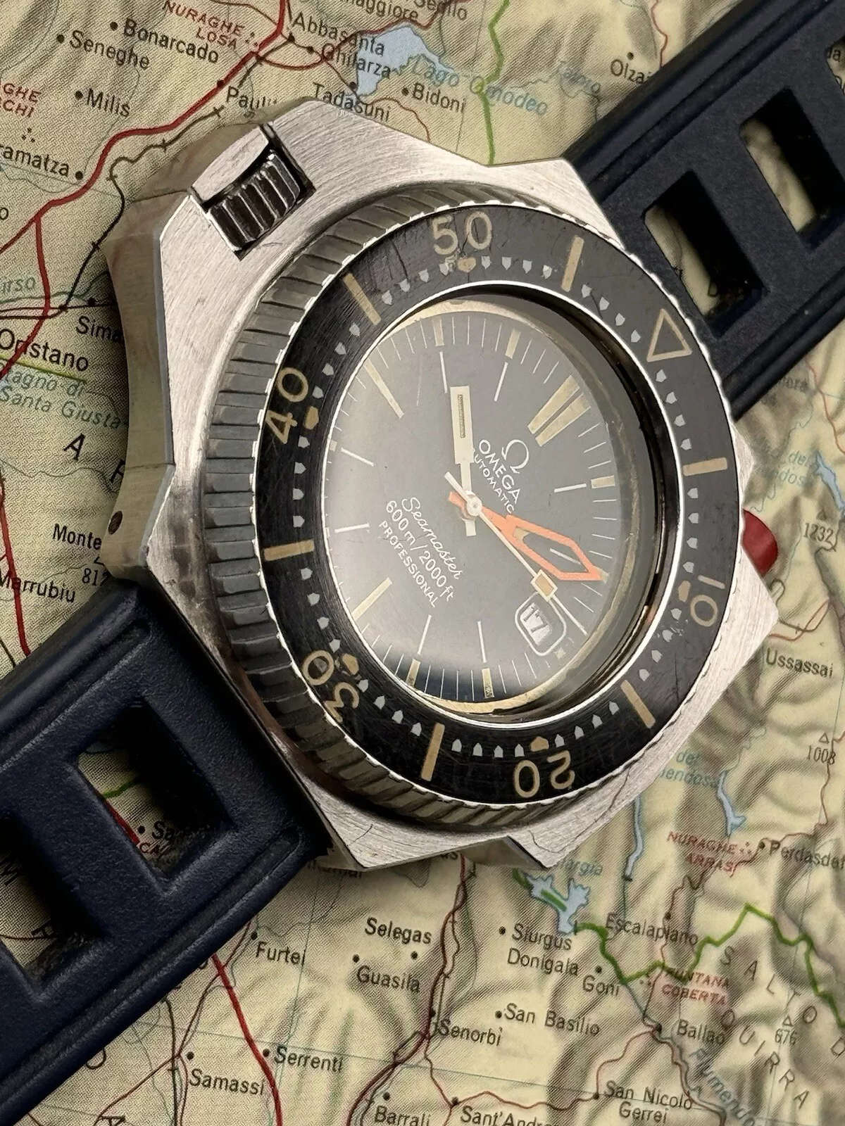

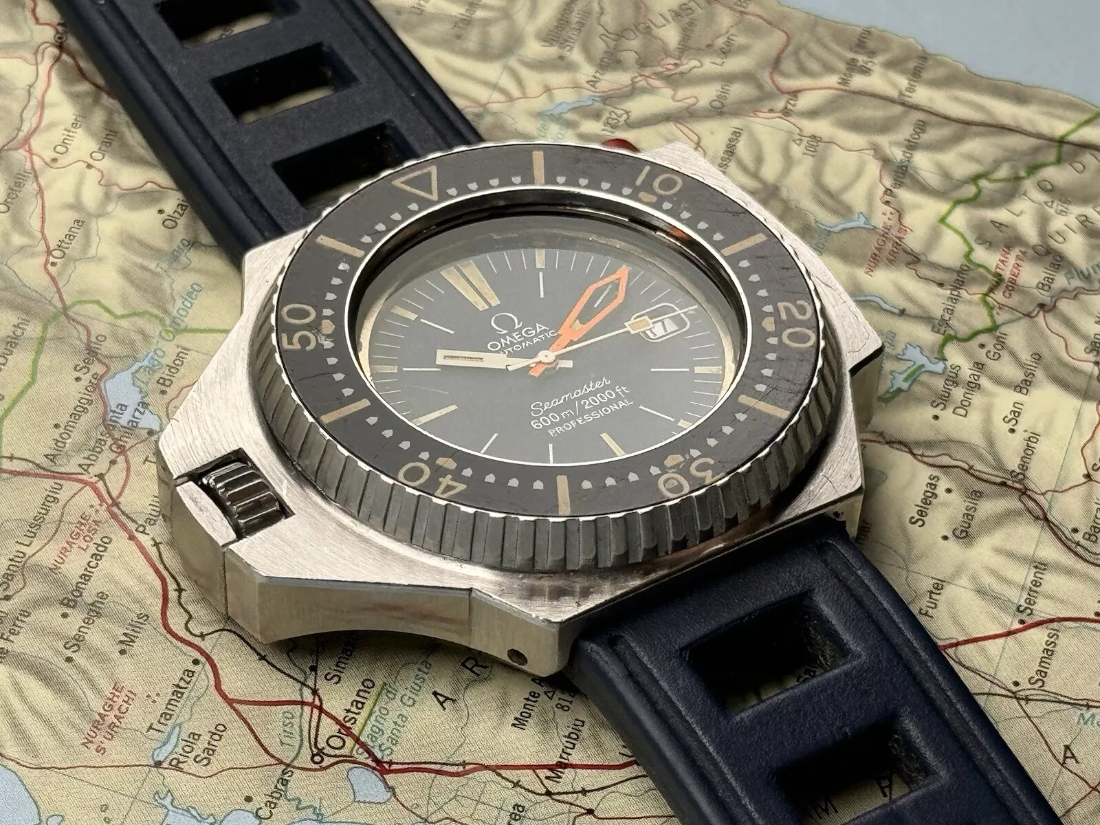

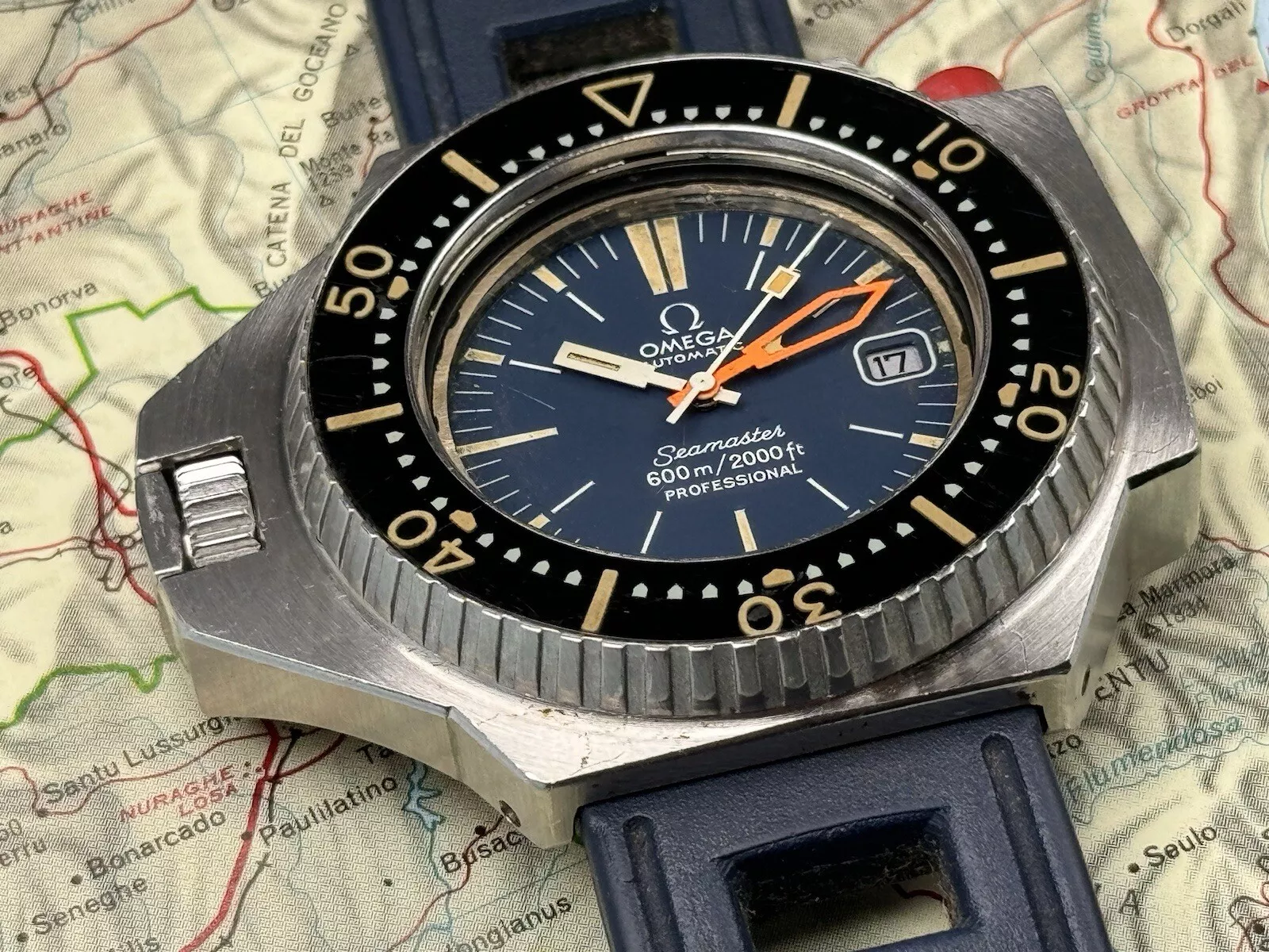

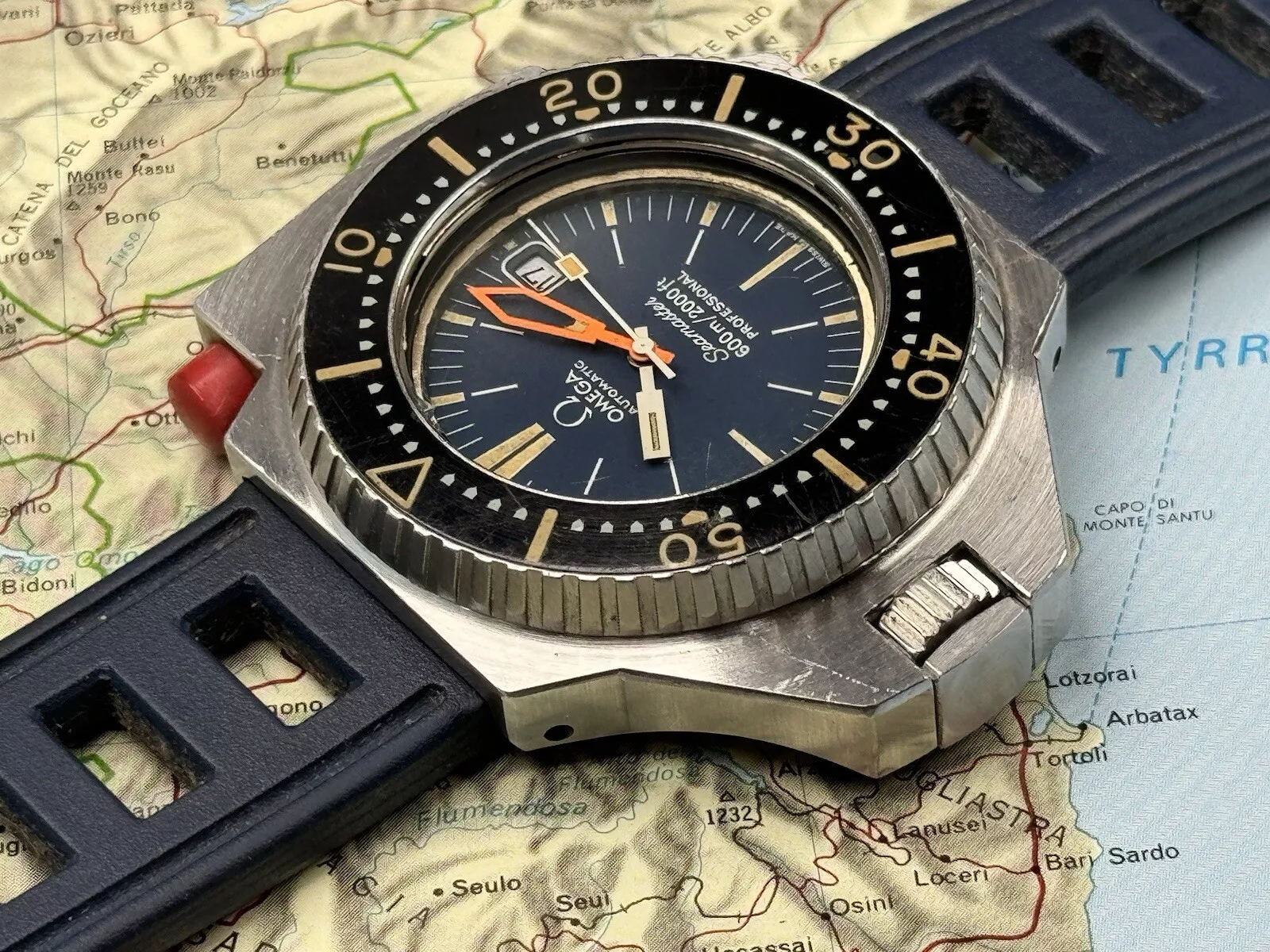

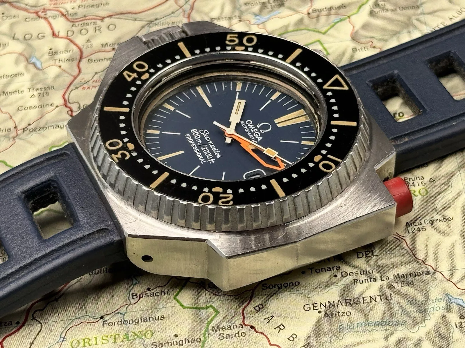

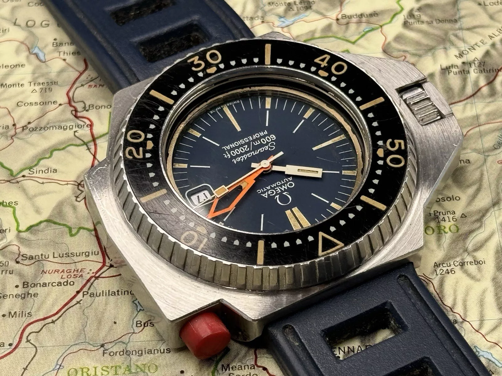

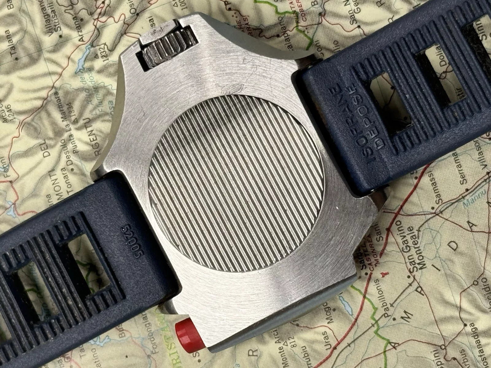

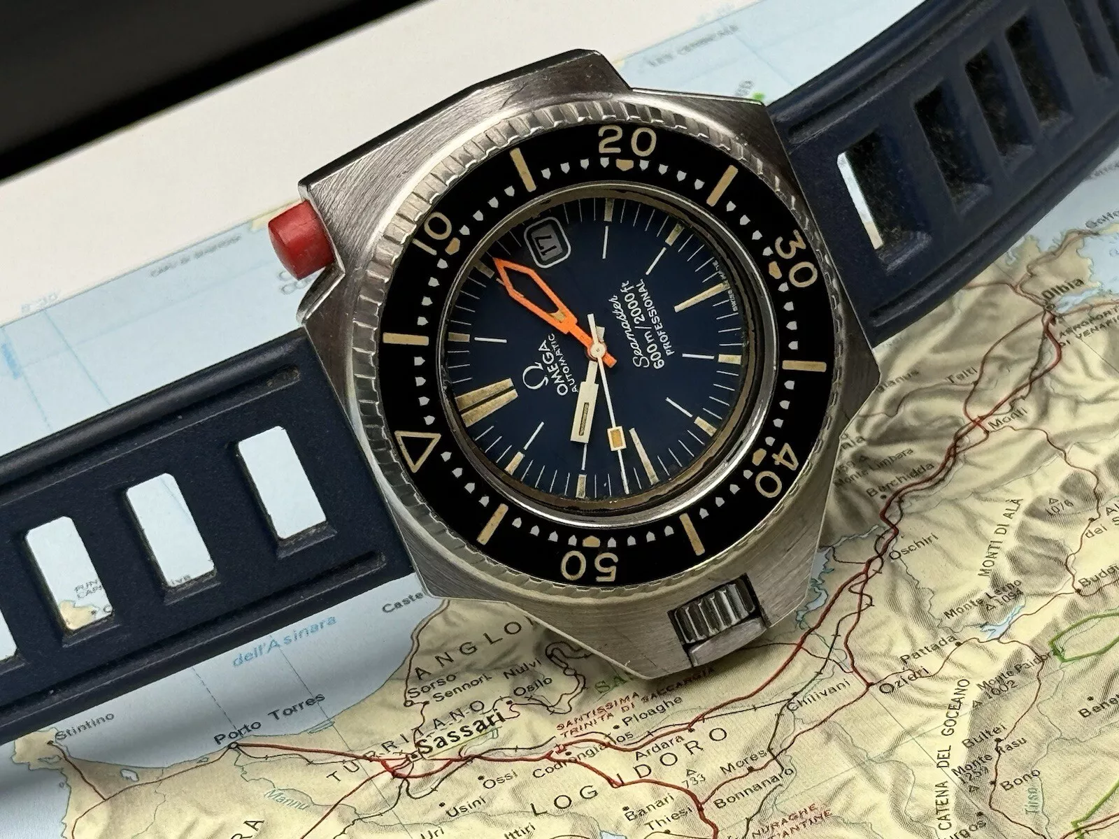

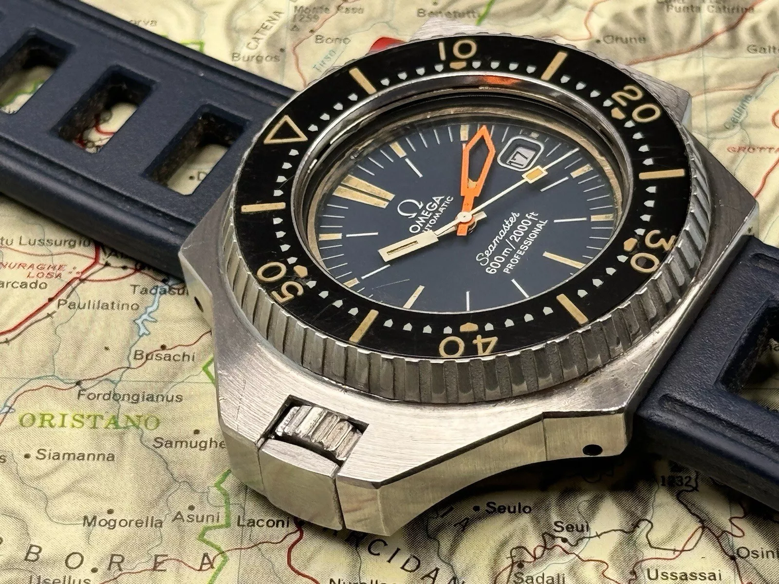

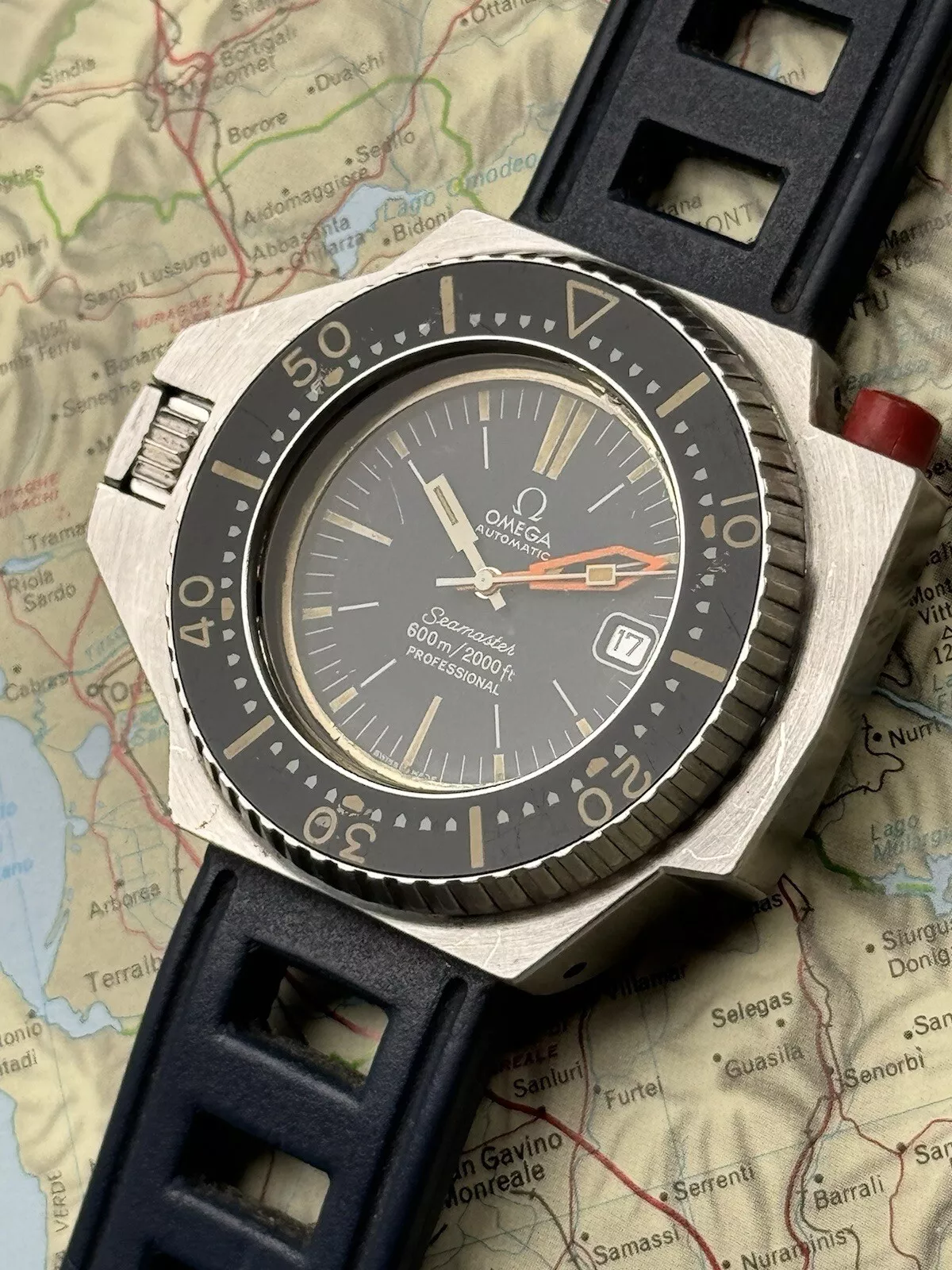

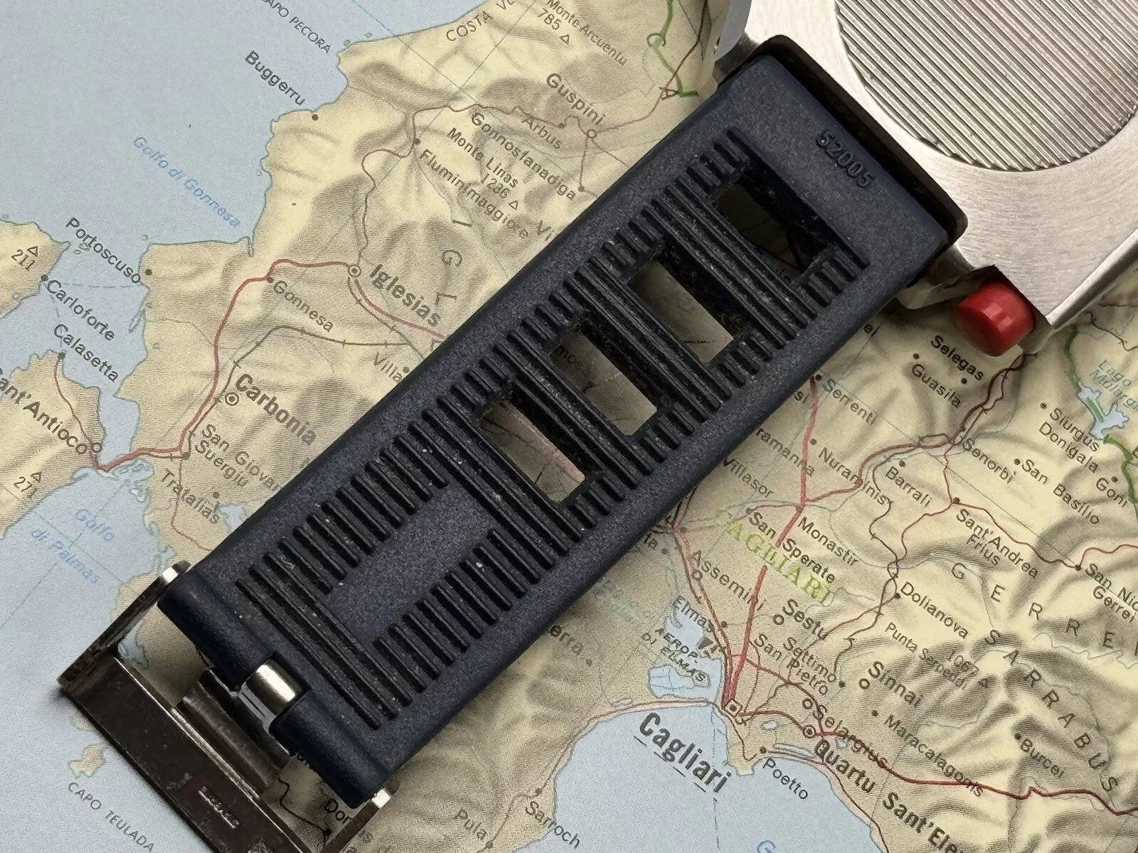

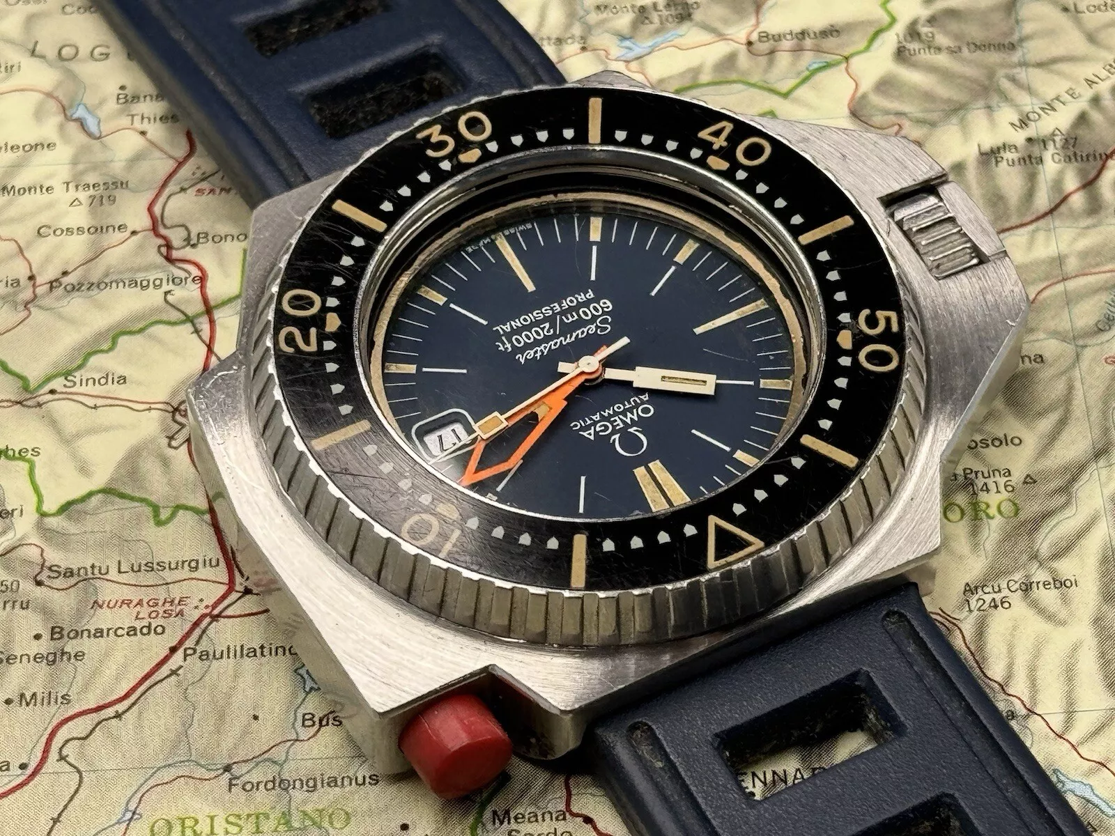

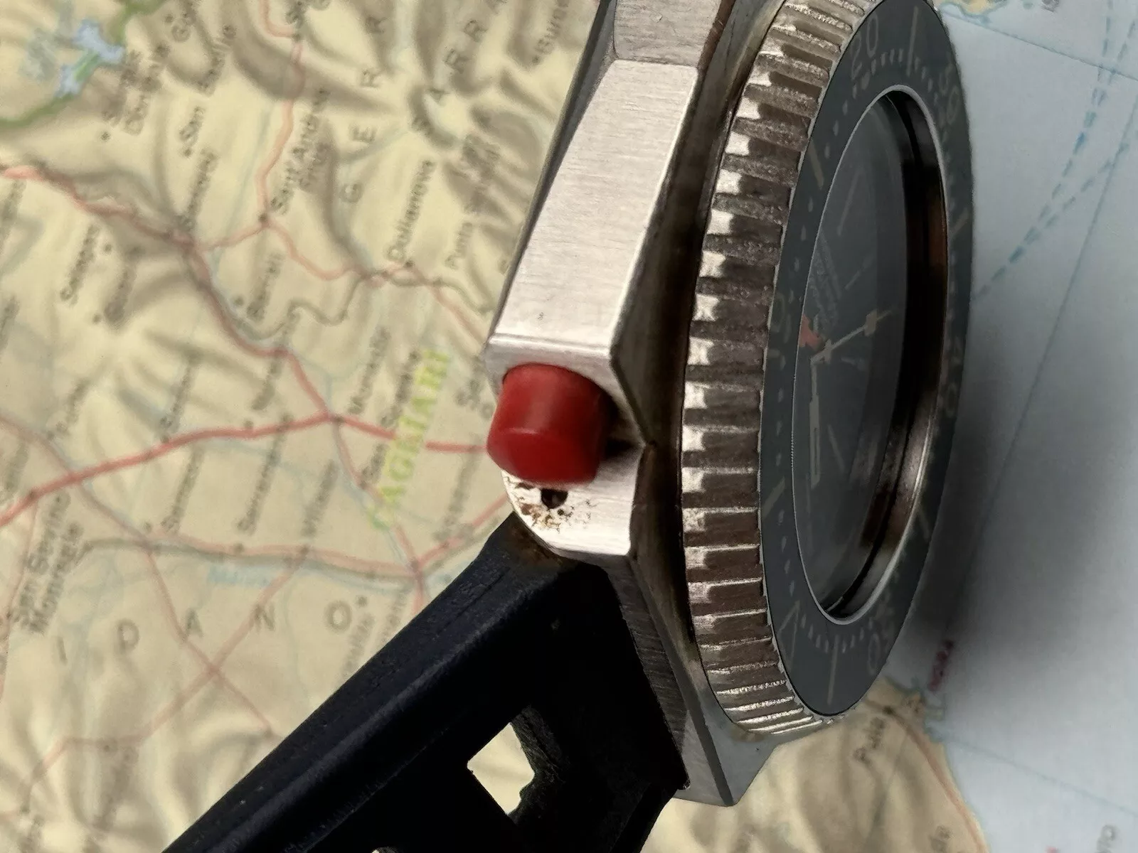

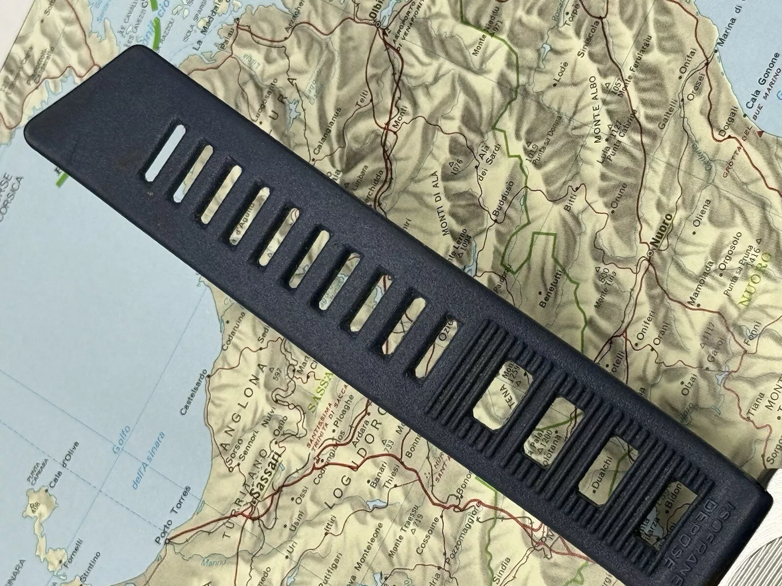

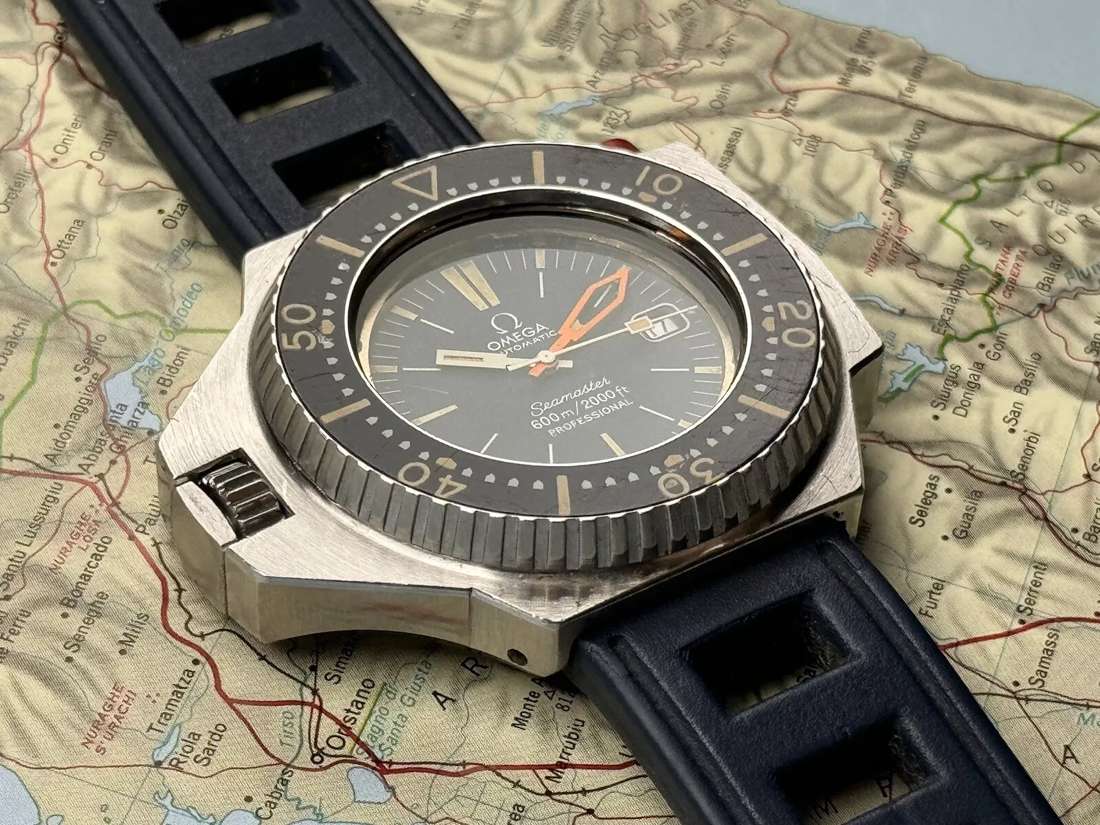

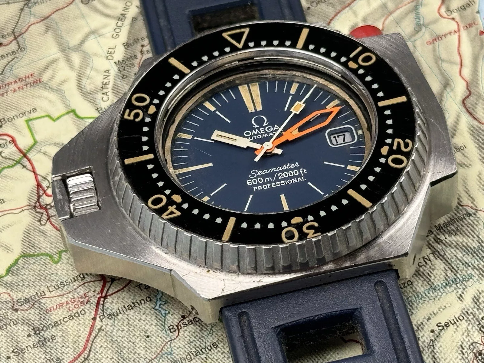

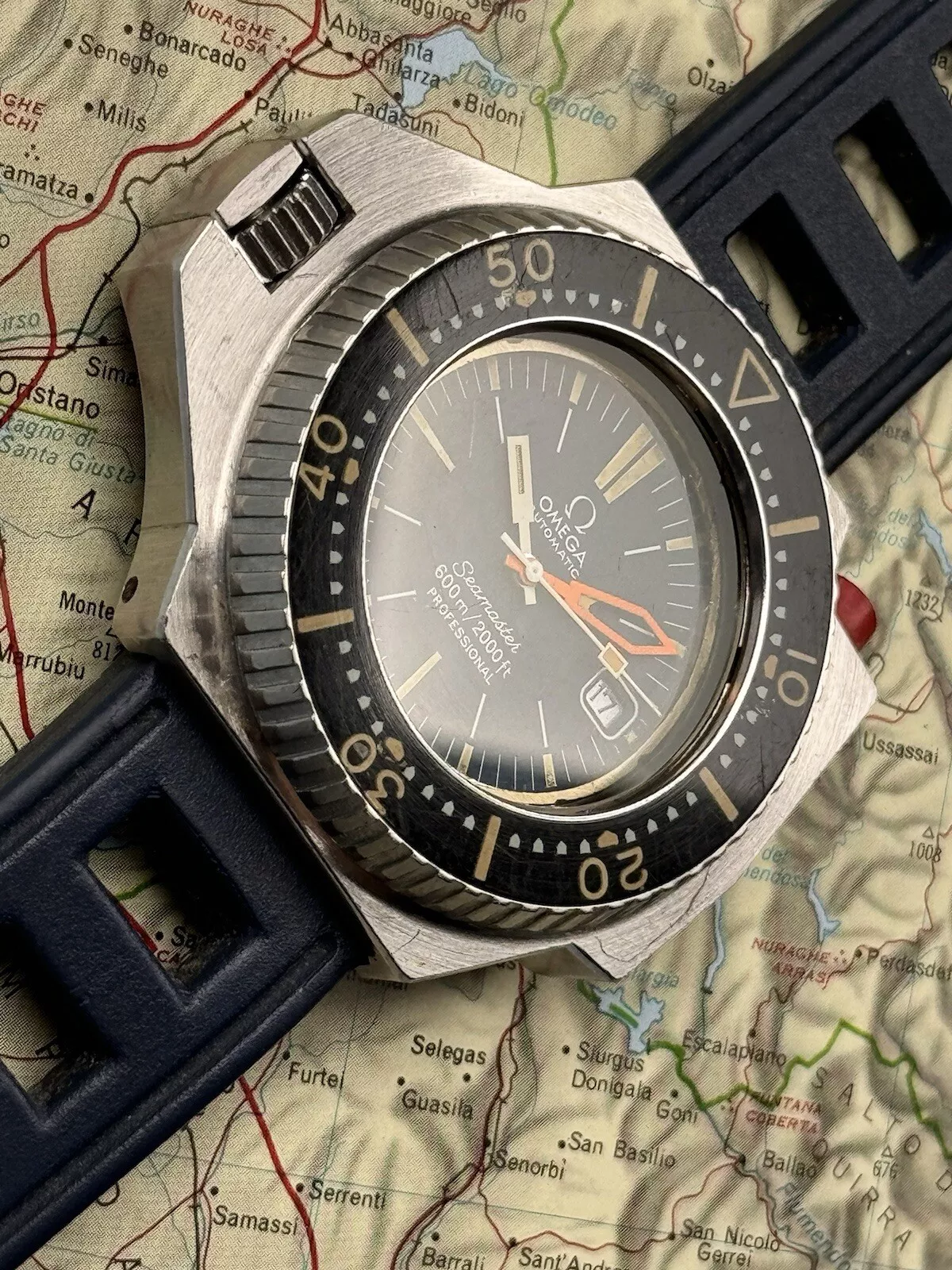

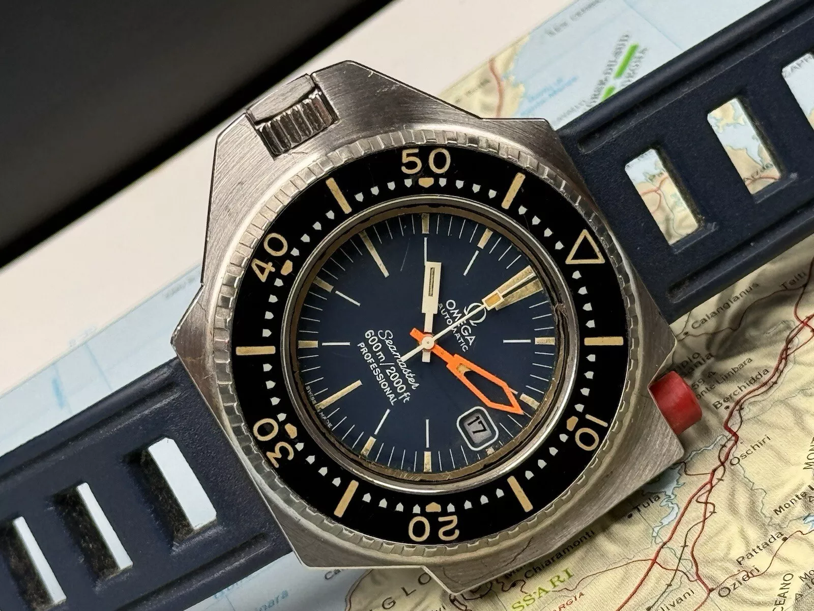

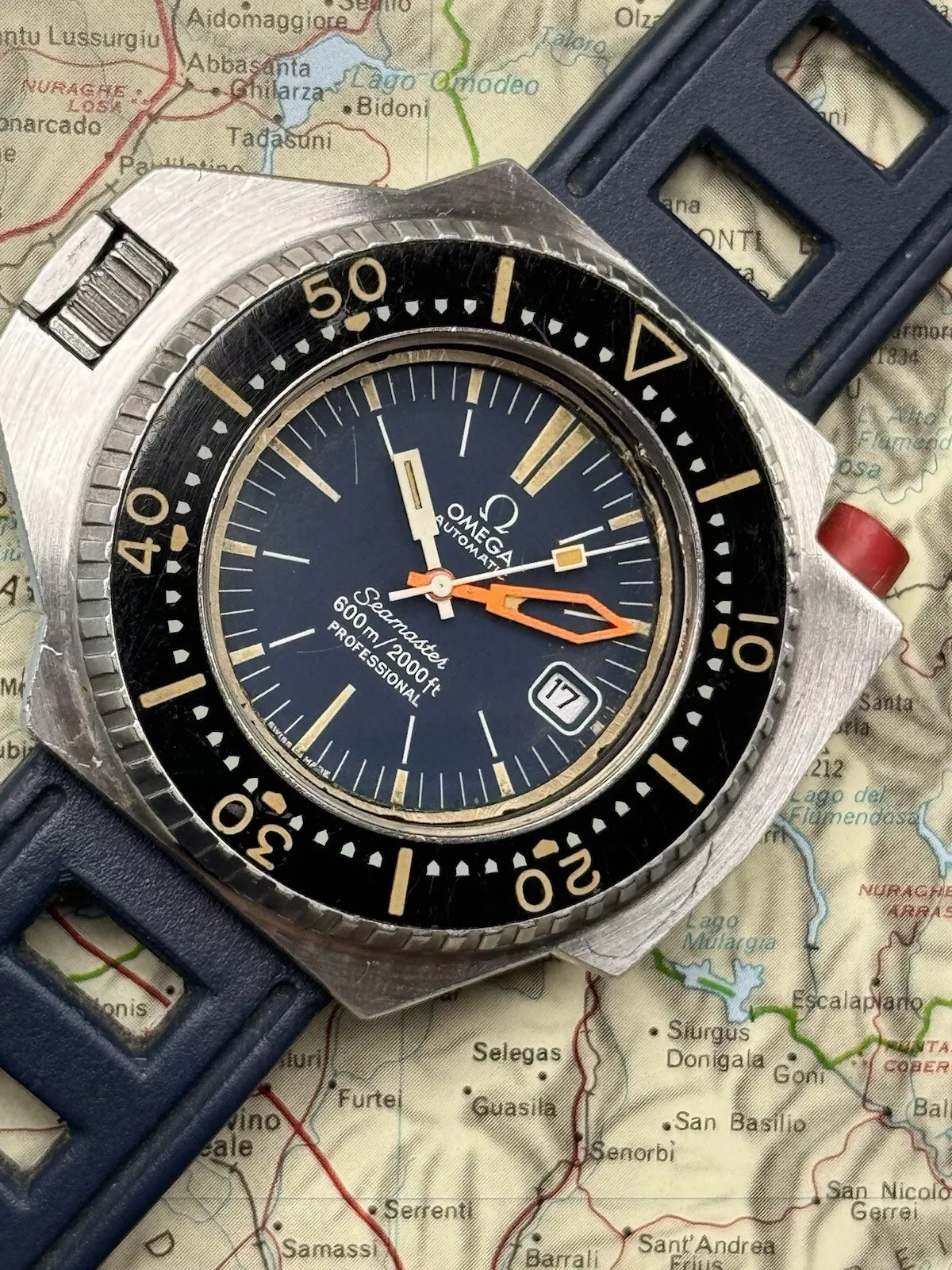

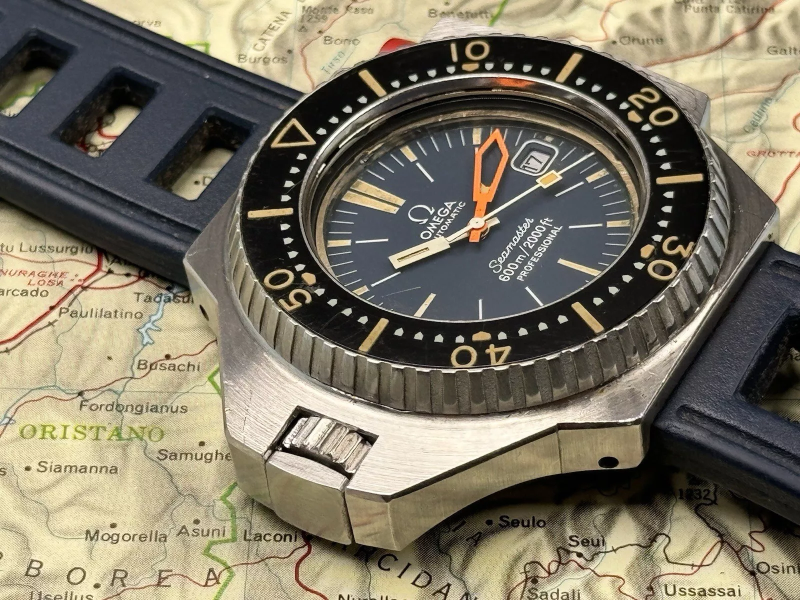

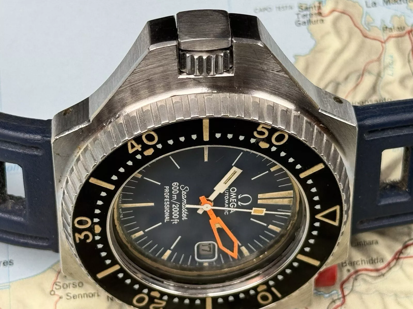

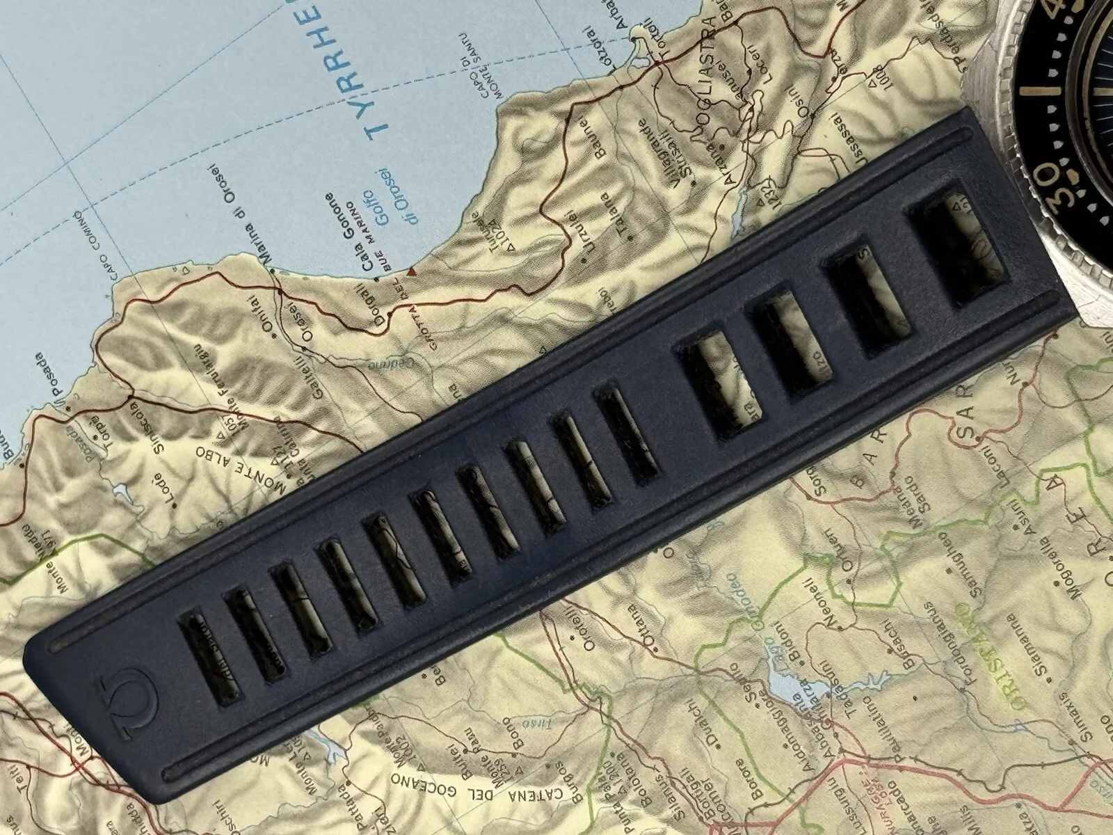

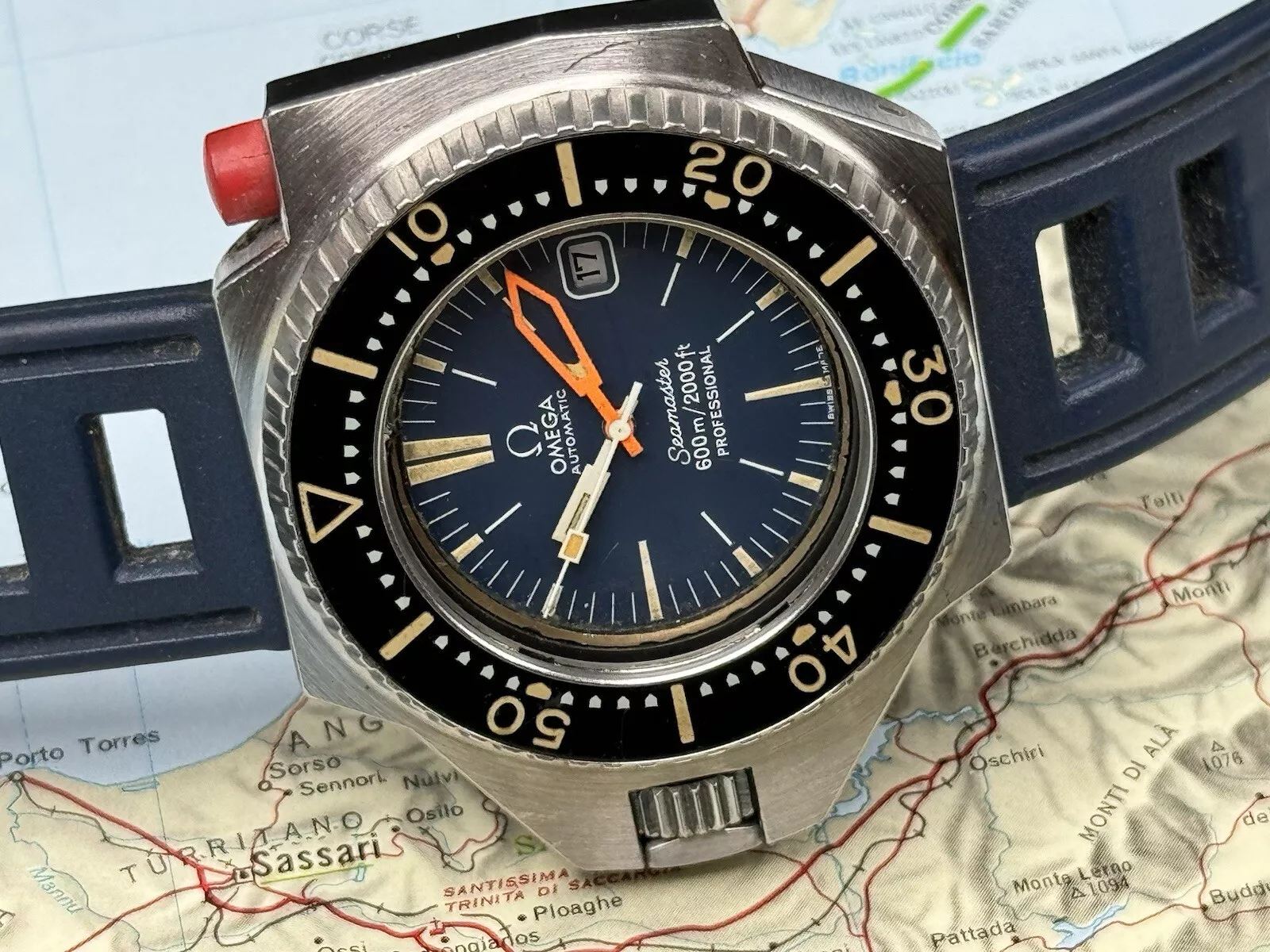

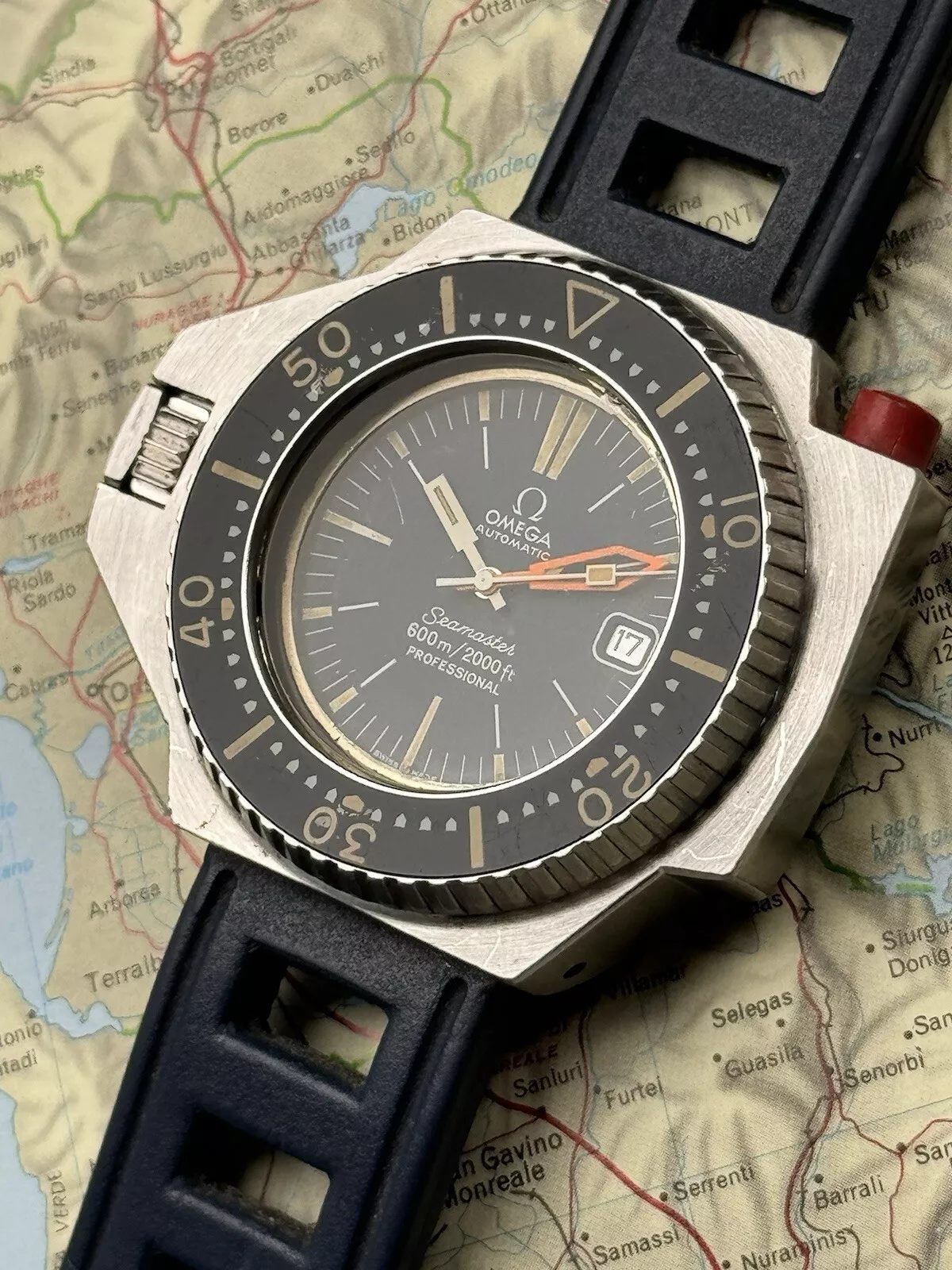

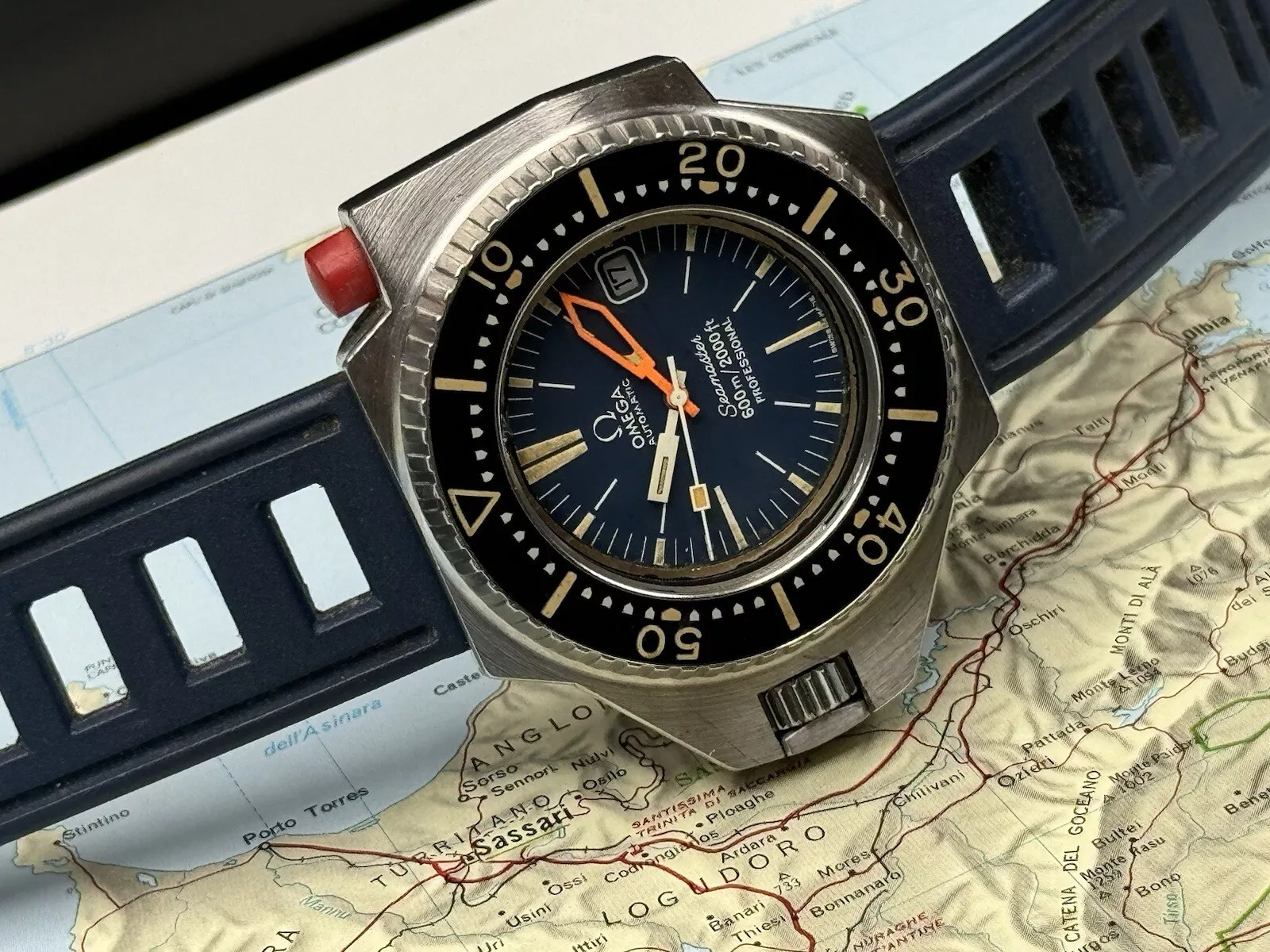

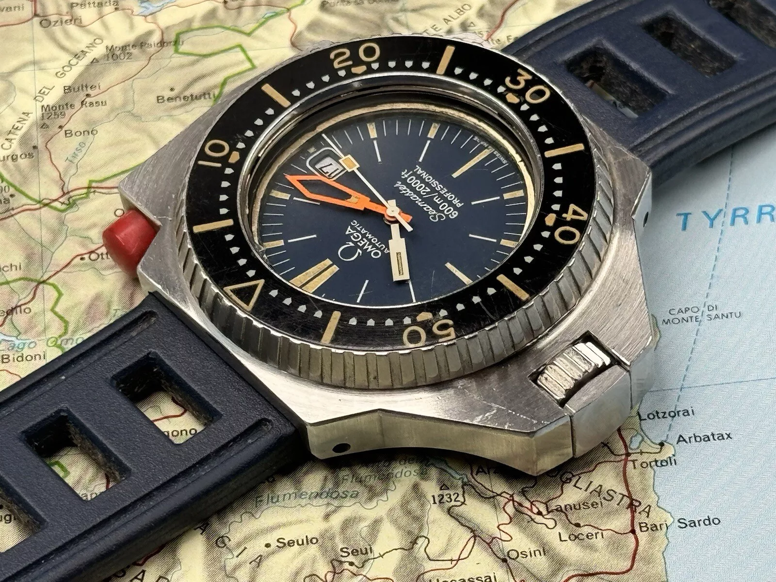

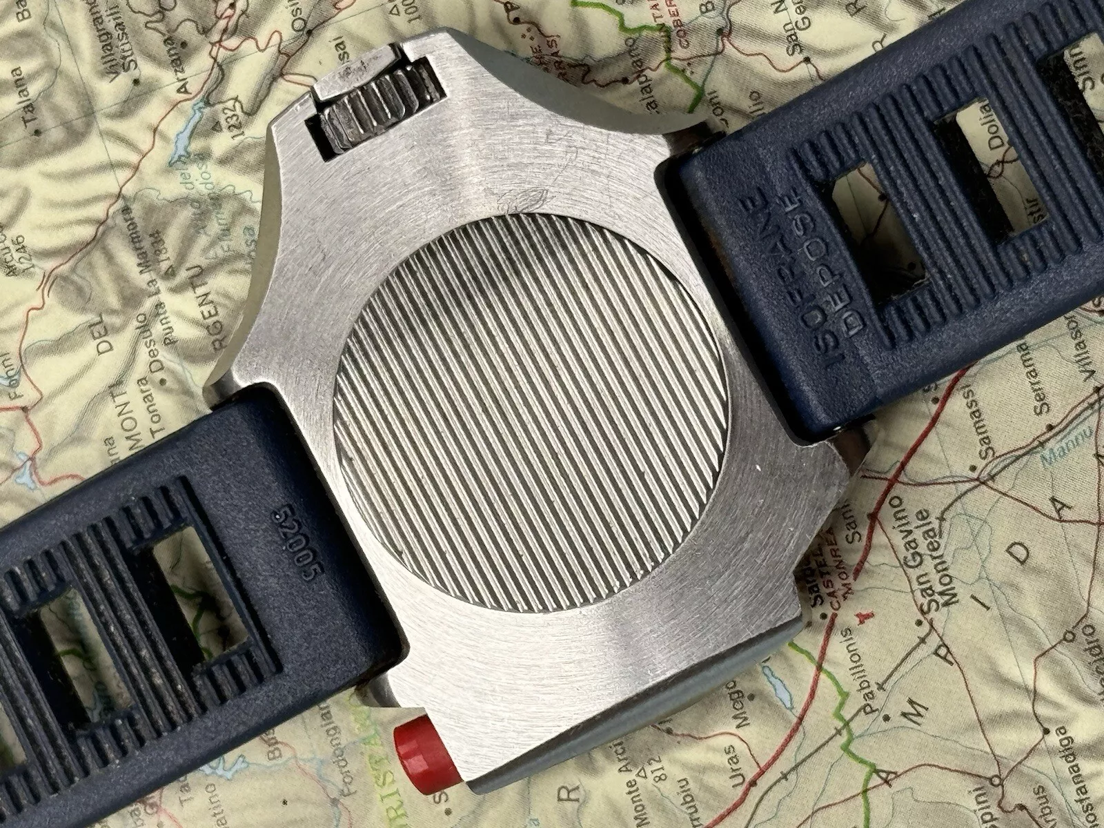

Hi Folks -

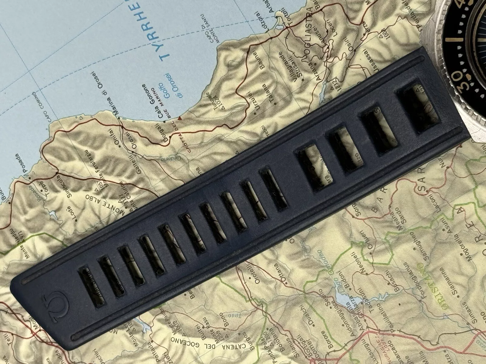

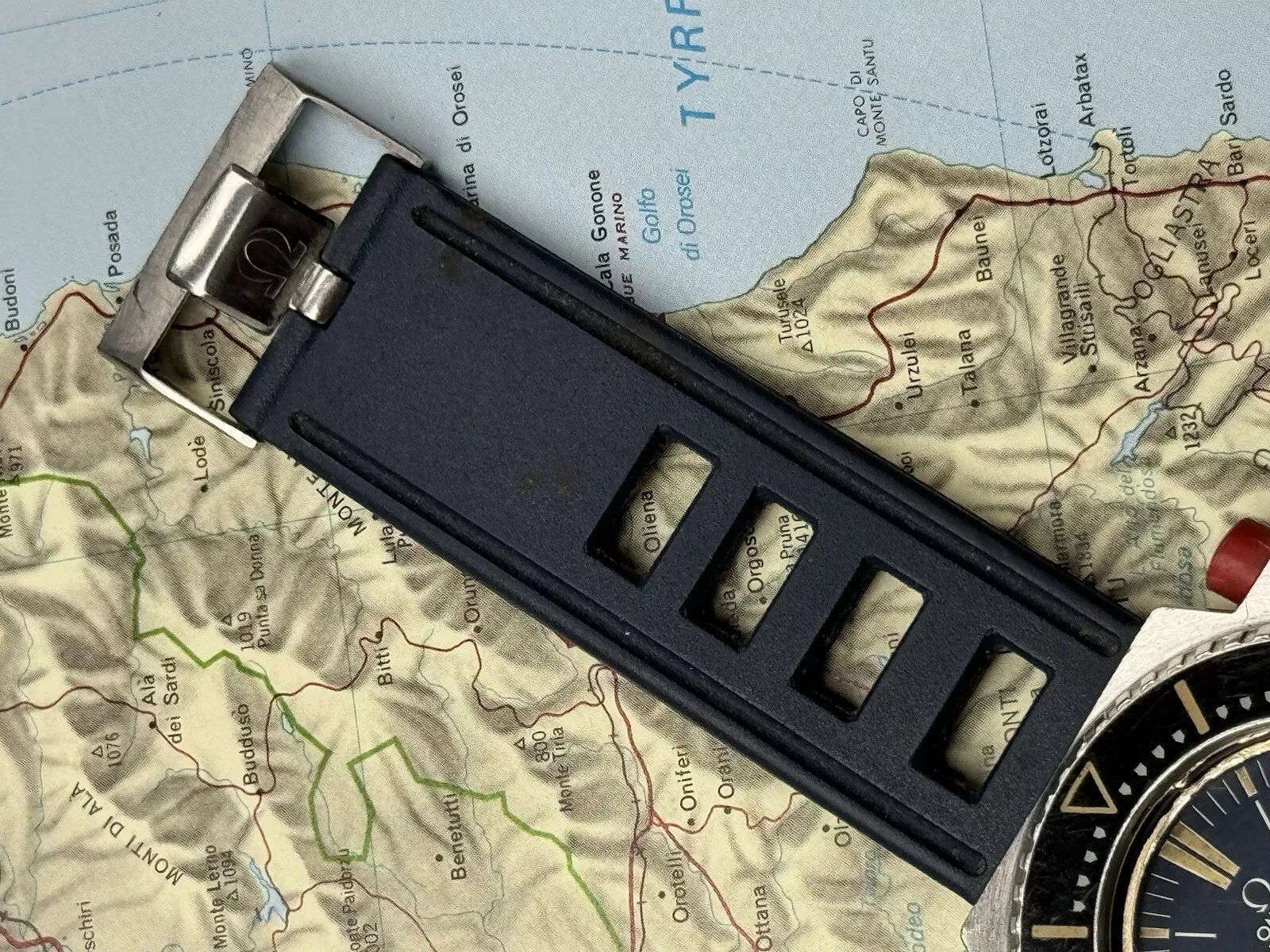

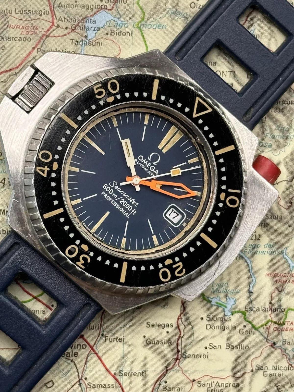

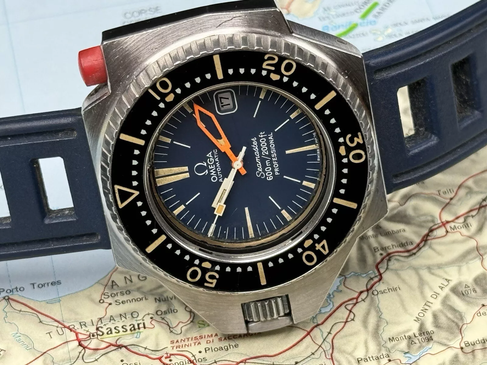

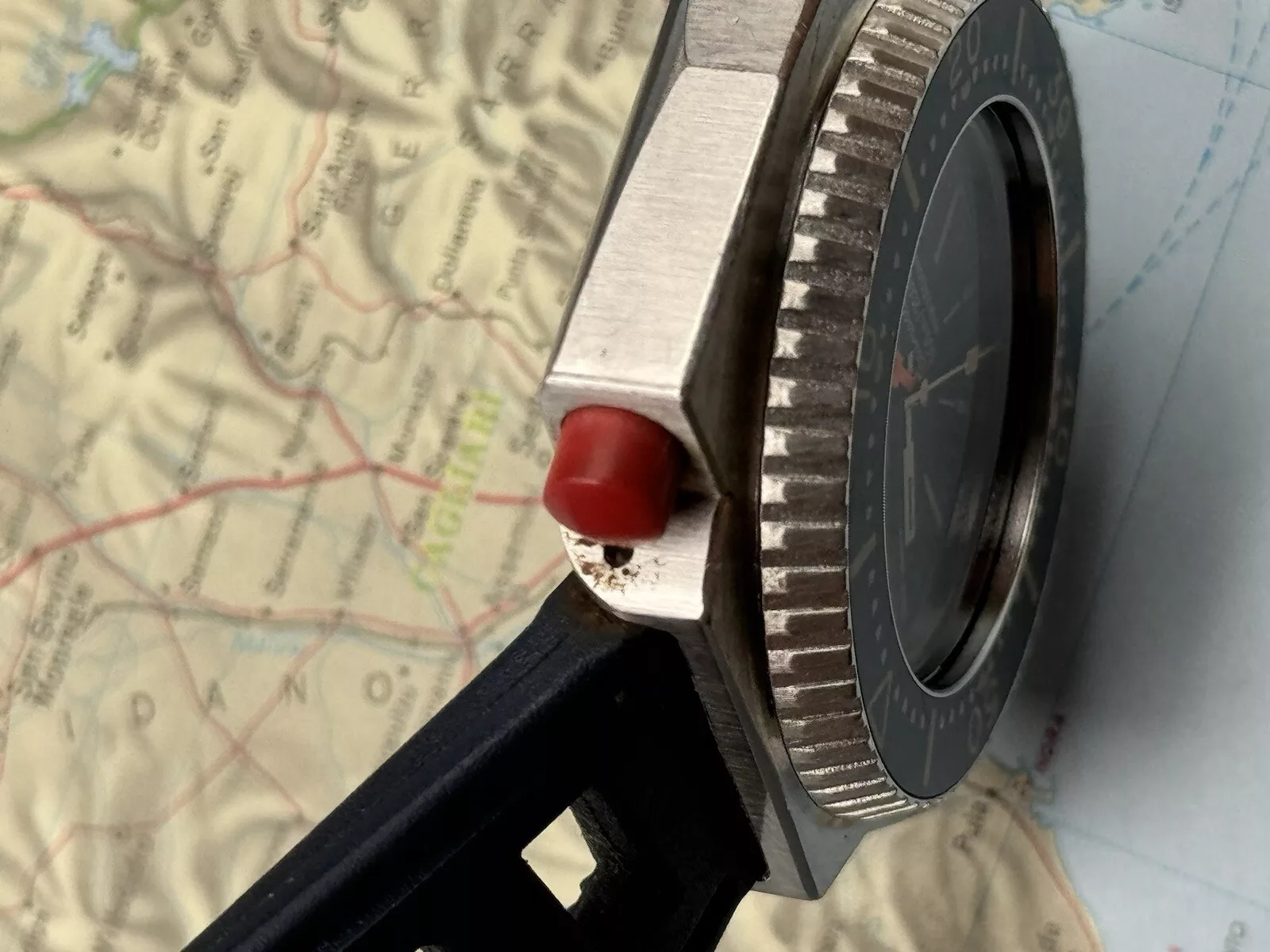

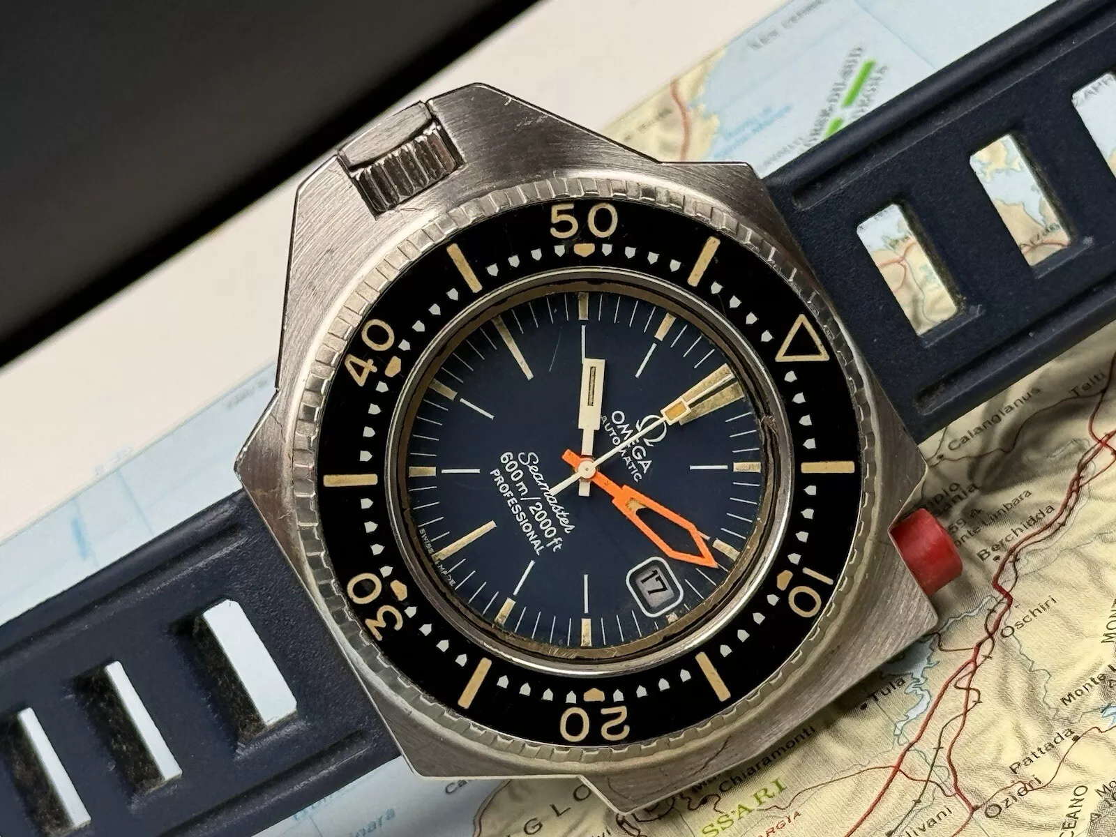

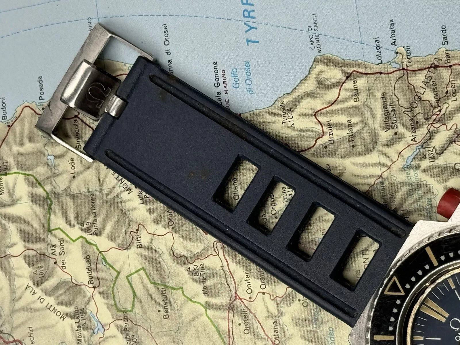

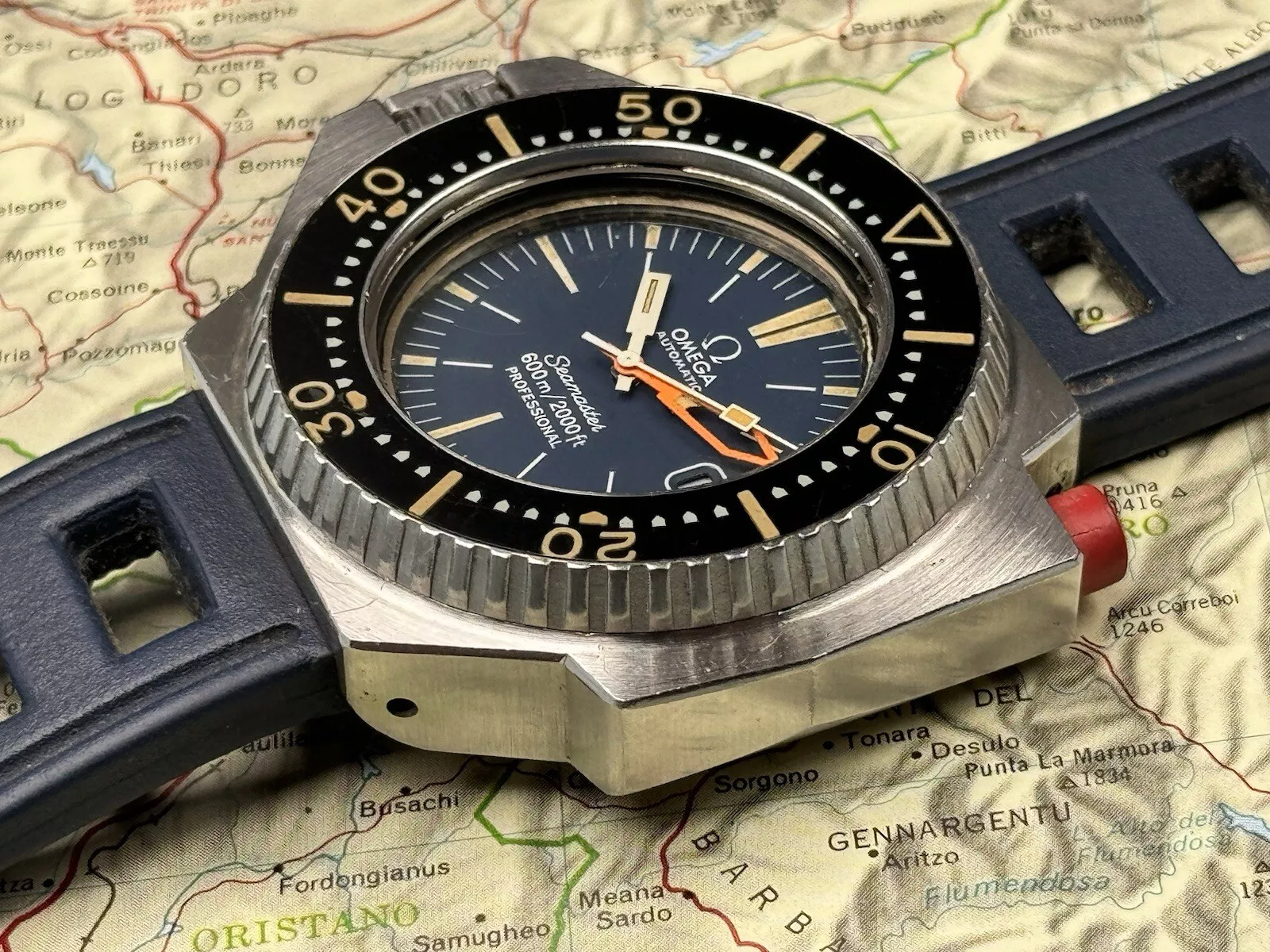

Looking at this vintage Ploprof. I know a limited amount about these specific models. And I'd love to get your expertise on the condition:
  • Does it look legit?
  • Any red flags?
  • Dial printing look correct to you guys?
  • Noticed a "ring" -- maybe gasket or metal -- around the dial
Been looking for a while for something exactly like this w/ patina. So figured I'd ask the group for their 2 cents. thanks!
303
226

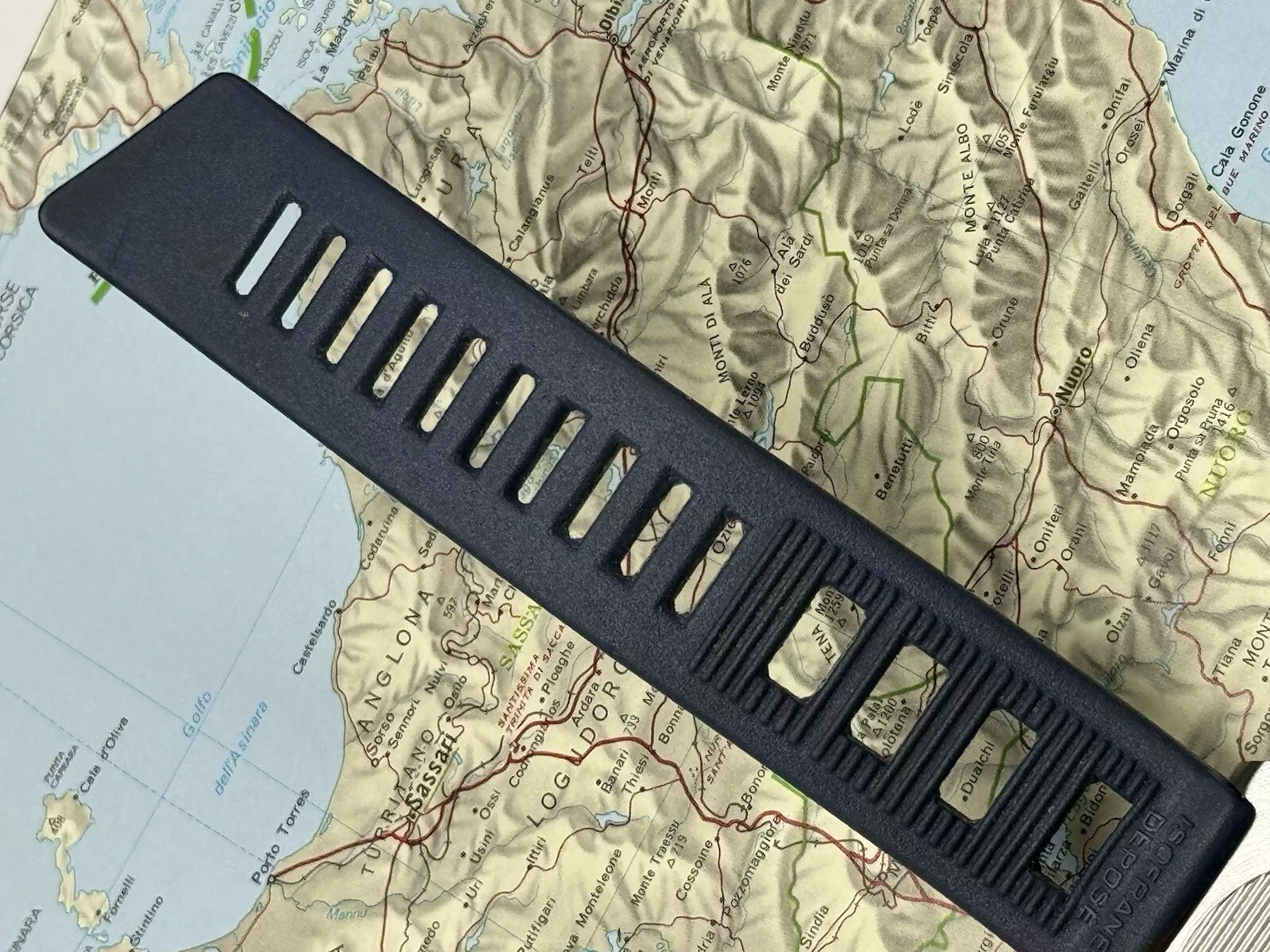

Looks 100% legit to me, including the vintage Isofrane strap. The watch suffers from glass edge chipping+ melted glass seal, which often leads to dial edge peel, when being serviced. As it seem like a time capsule, that was not being service for years, be very careful, while servicing the watch to keep the dial intact...
