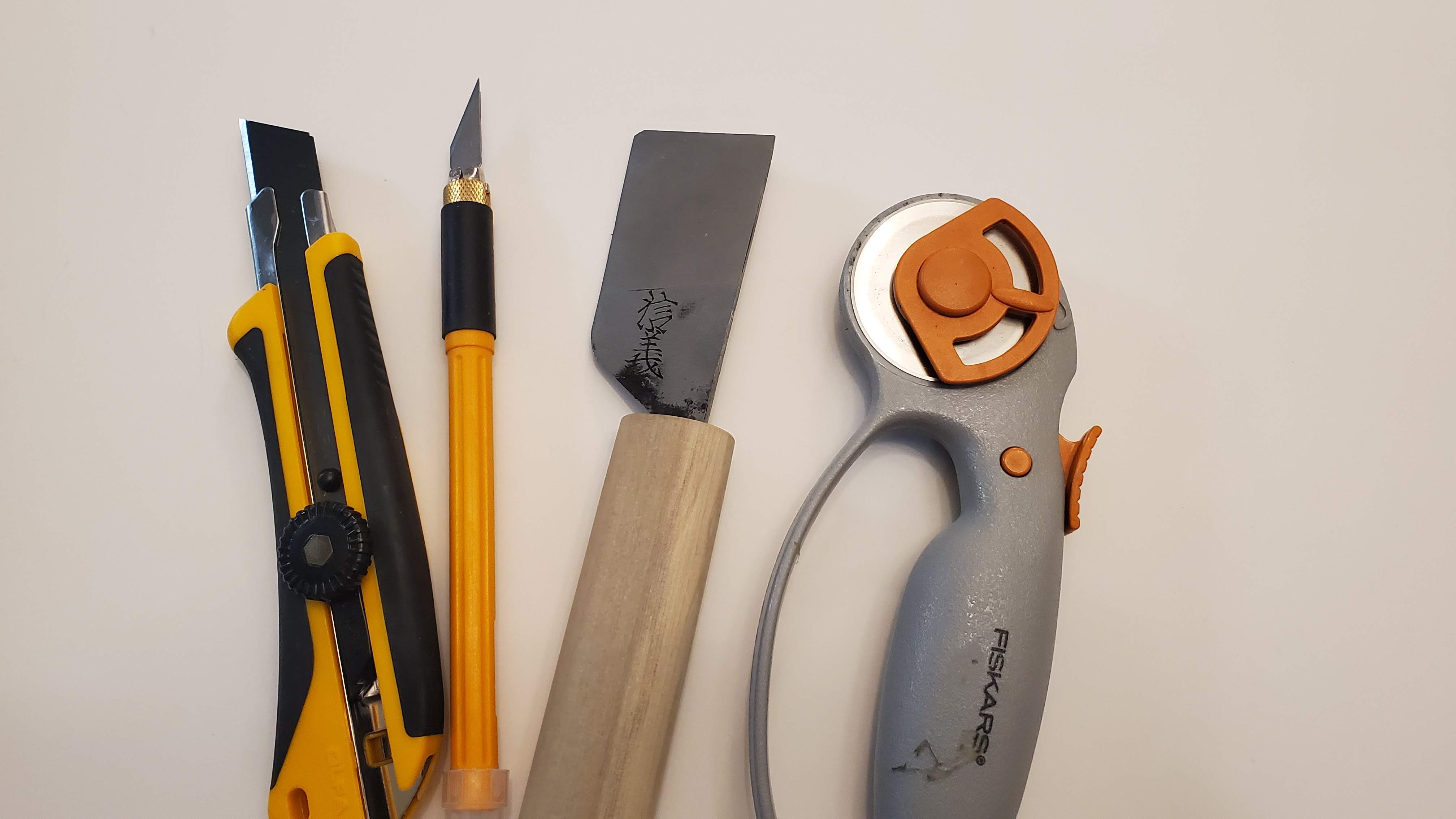

If you're asking me, I usually print a cardstock pattern, trace, and use a box cutter / Olfa Utility Knife 👍 - I've used a variety of different ones (see below) and find myself always coming back to the Olfa Knife since I can just break off a blade and start anew.
Left to right:
Olfa Utility Knife (most used)
Olfa Art Knife (seldomly used; lots of others love this for corners / curves)
Japanese Skiving Knife "Nobuyoshi" 36mm (planning on replacing this soon)
Fiskar Rotary Cutter (mainly used for straight line cuts)

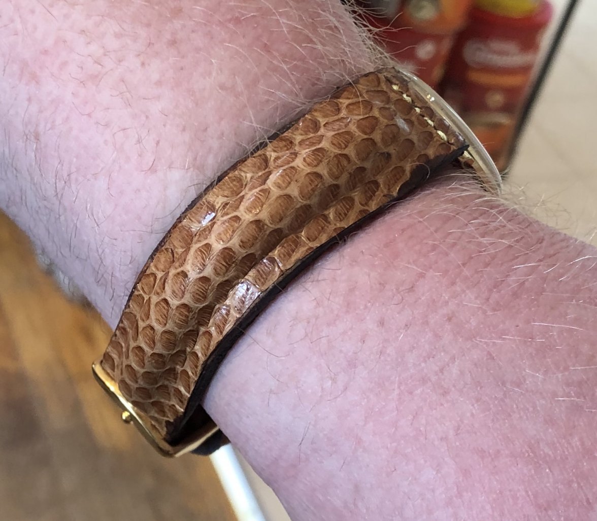

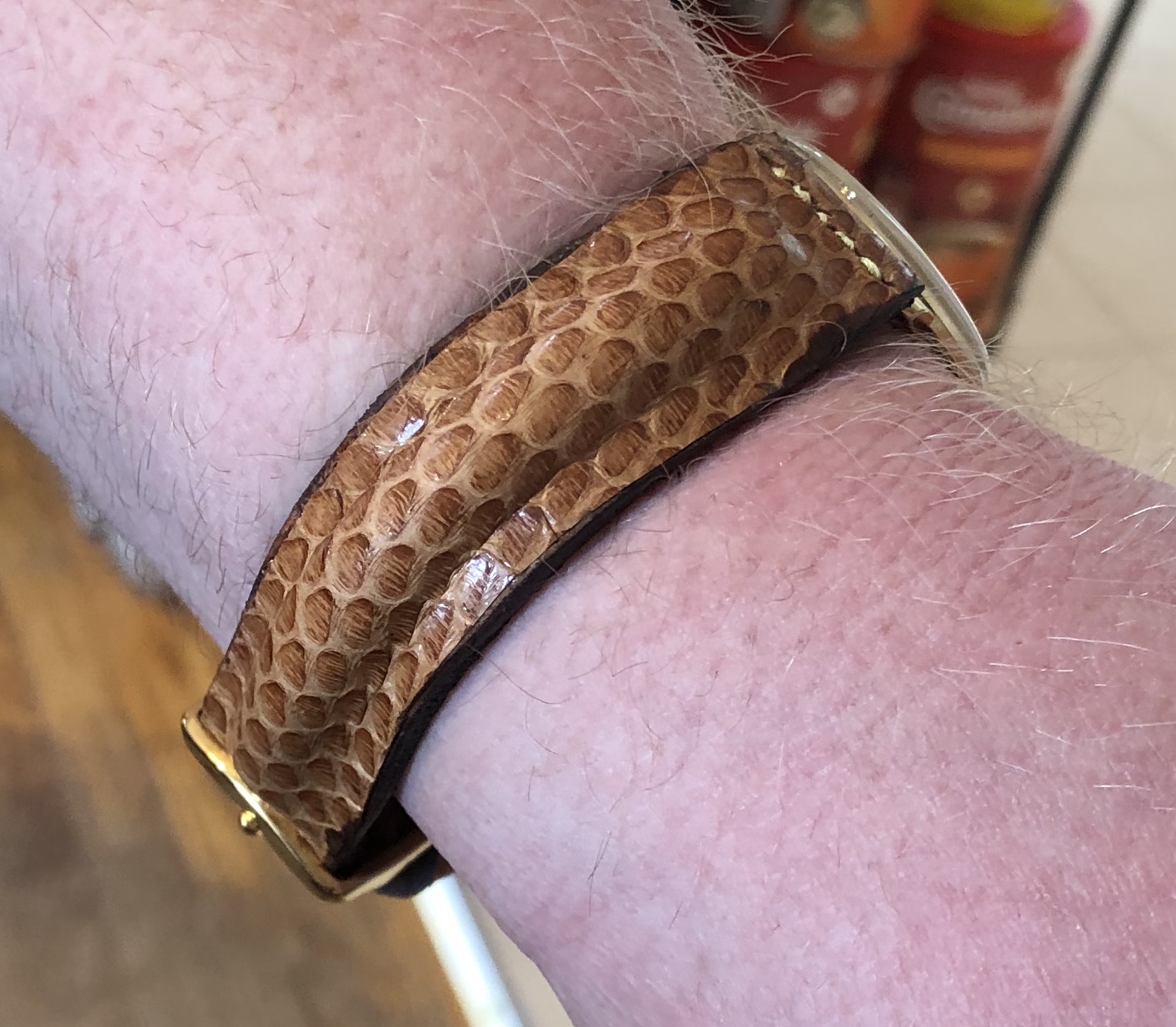

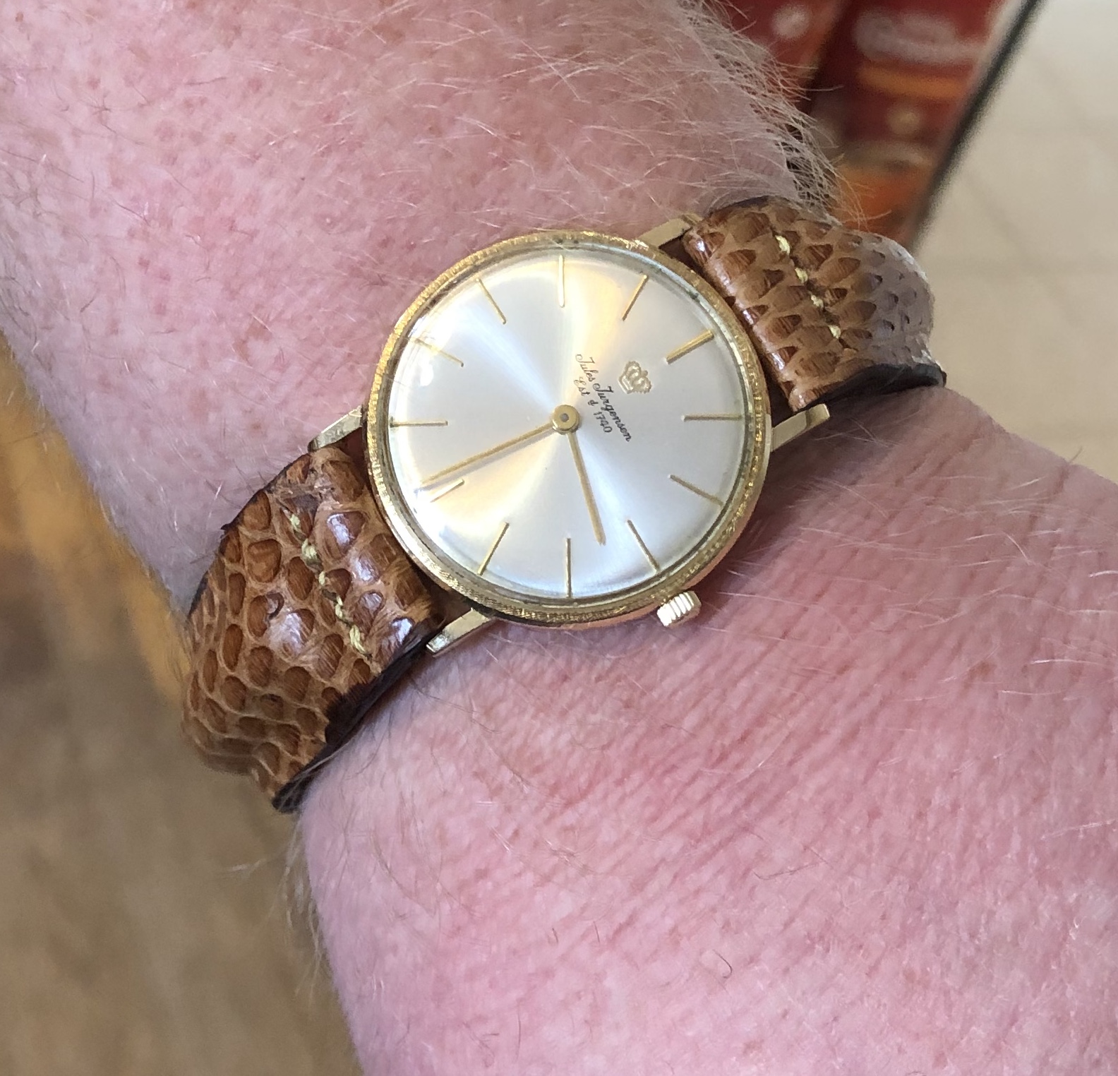

Very nice! I use some of the same tools, and buy some old ones whenever I find them. Old blades sharpen well with a barber’s strop or even with a piece of leather and polishing rouge. Great hobby! I finished the (above) speedy strap this morning and had fun with some experimenting. Trying to see how much I can pad an 18 mm snake strap!
64
40
Nice! That's a ton of padding - how thick did you go? Does it bend well around the wrist?

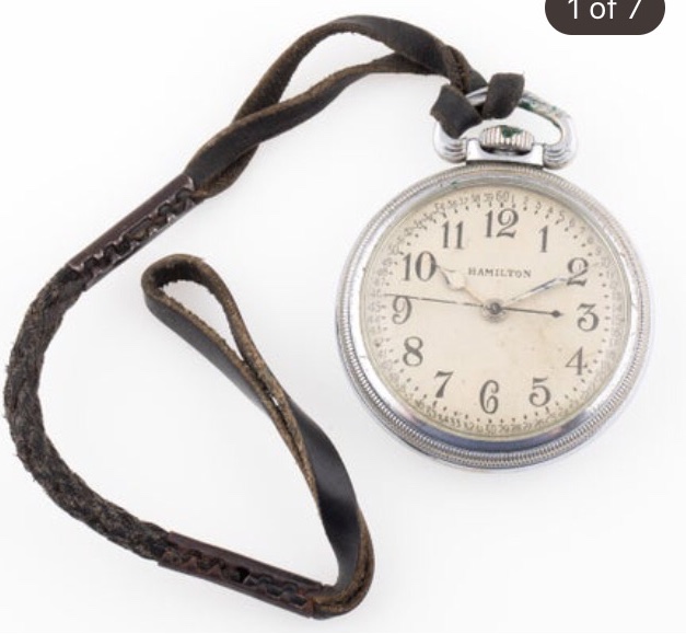

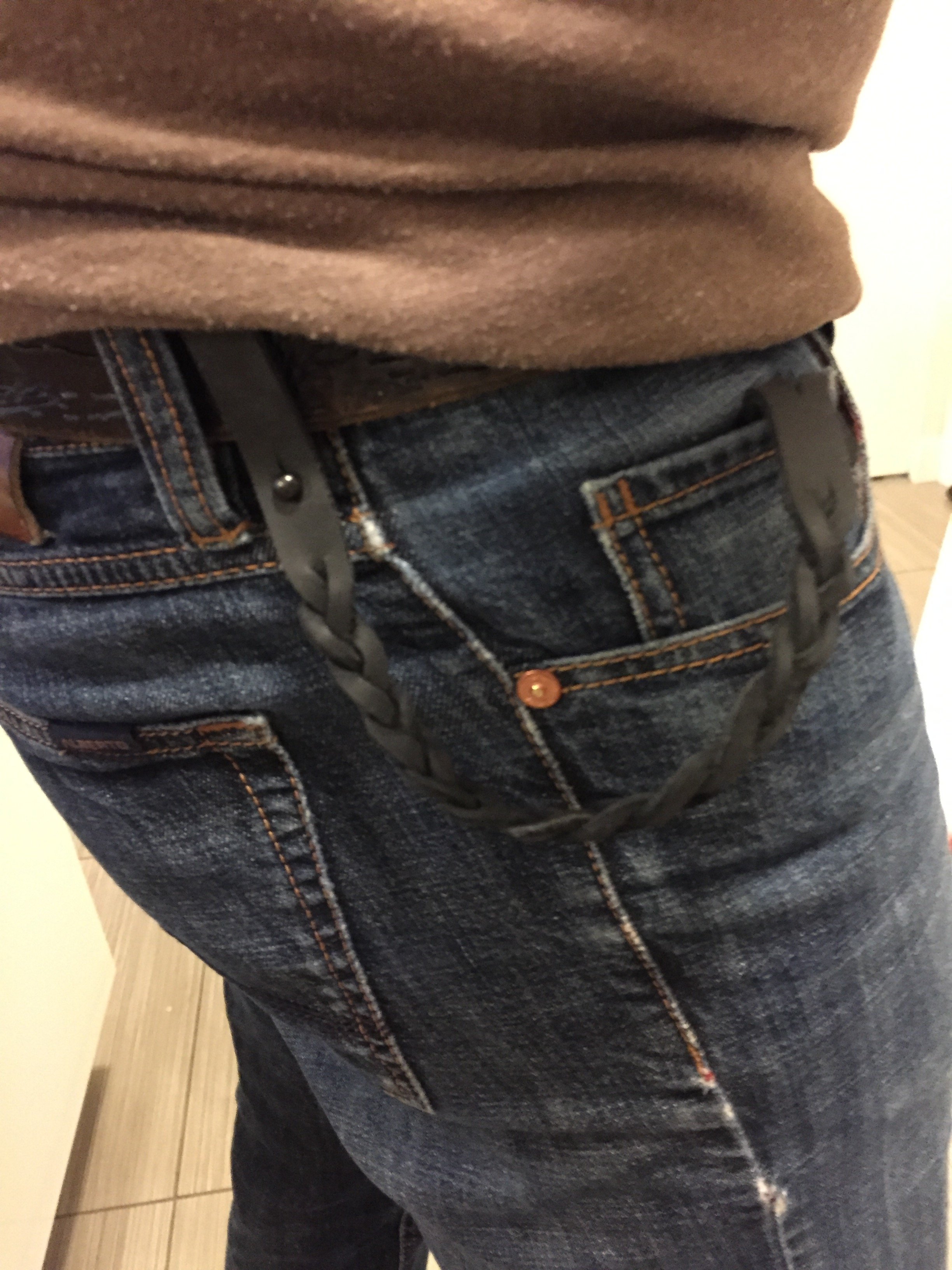

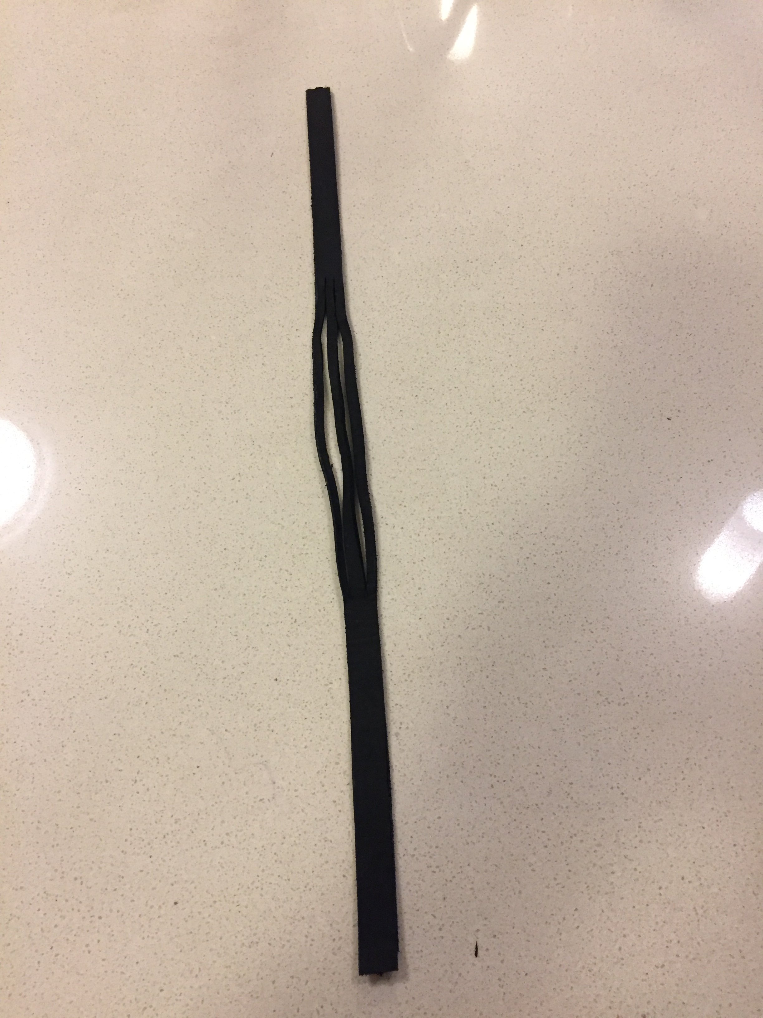

@Canuck, are you thinking of something along these lines, but with a mystery braid in the middle?
Do you have one of these around that you could provide me measurements for? I came across one in an antique shop, but it was mummified so who knows what it looked like in its functional days. The length and width and size of the loops would be valuable.
Just testing an assumption, this is worn with jeans and that one loop goes through a belt?
David,
That is the idea. The braid I have in mind is one piece of leather with a loop at each end, and braid in the middle. I think the one you are showing has a separate loop attached at the one end. I have had that type of braided pocket watch strap with braid in the middle, and a separate loop attached at each end. Useless. I’d even be happy with a braided center section and an integral tongue at each end with a dome fastener, to form the loops.. But it must be one piece of leather.

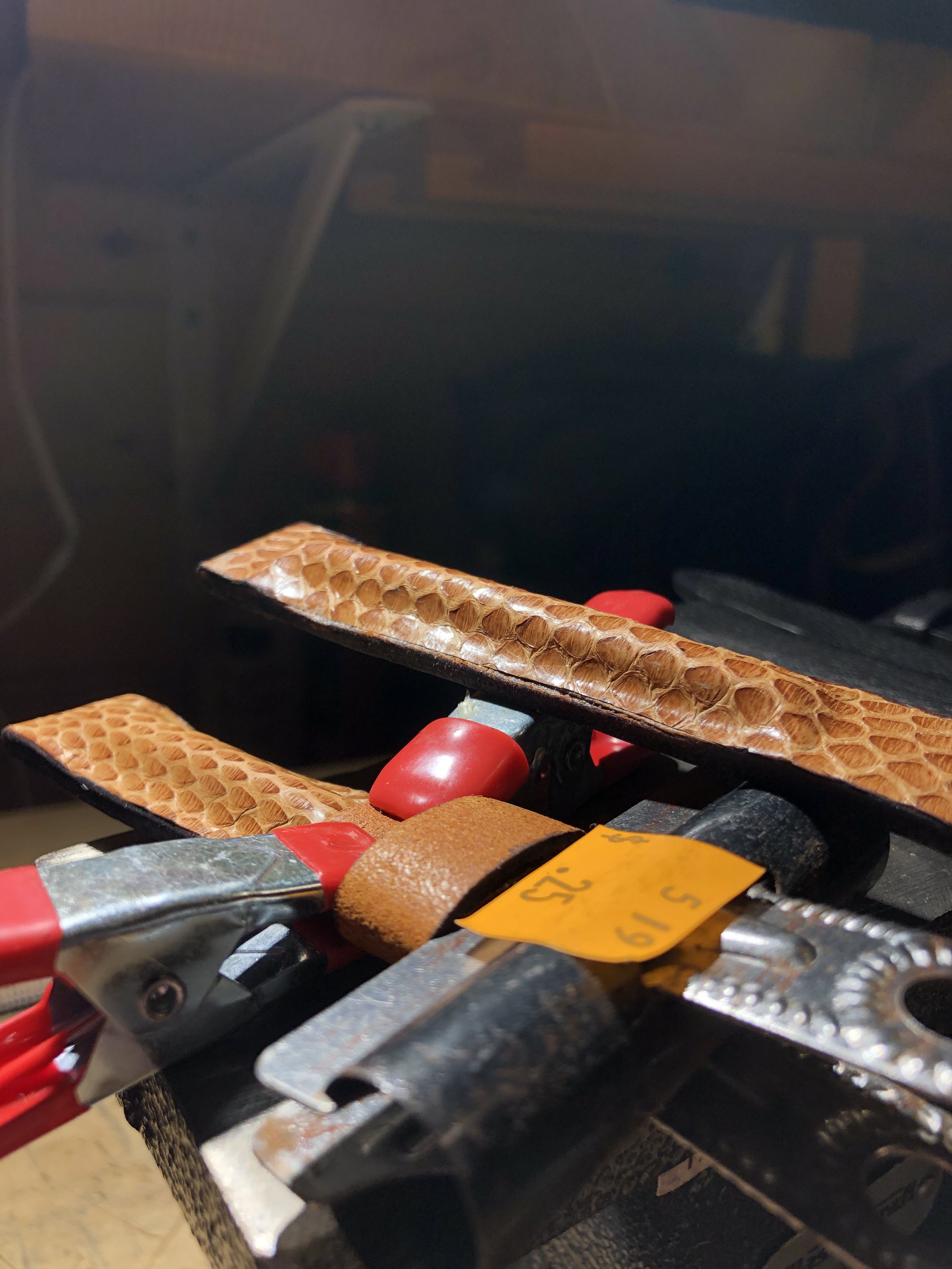

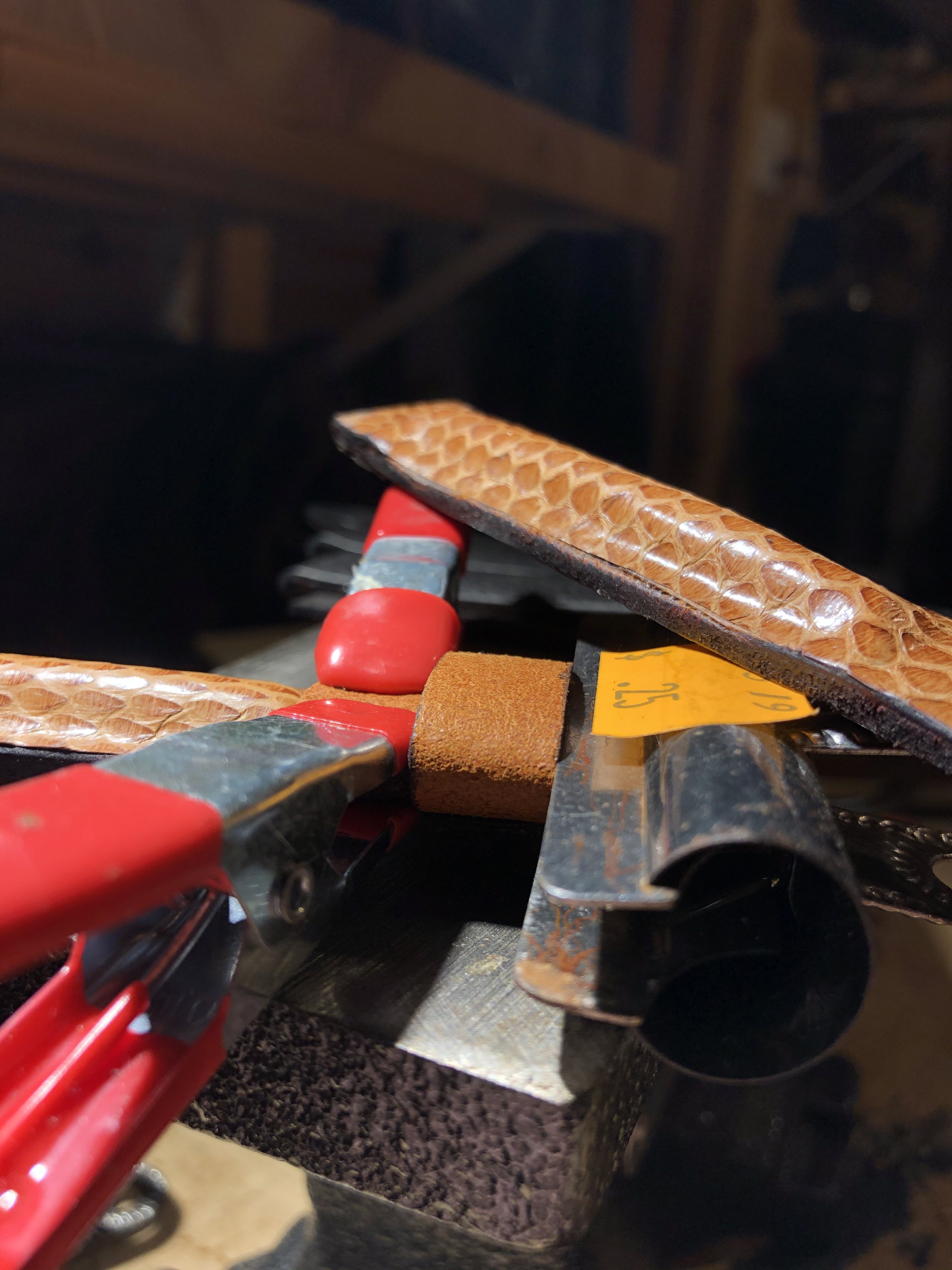

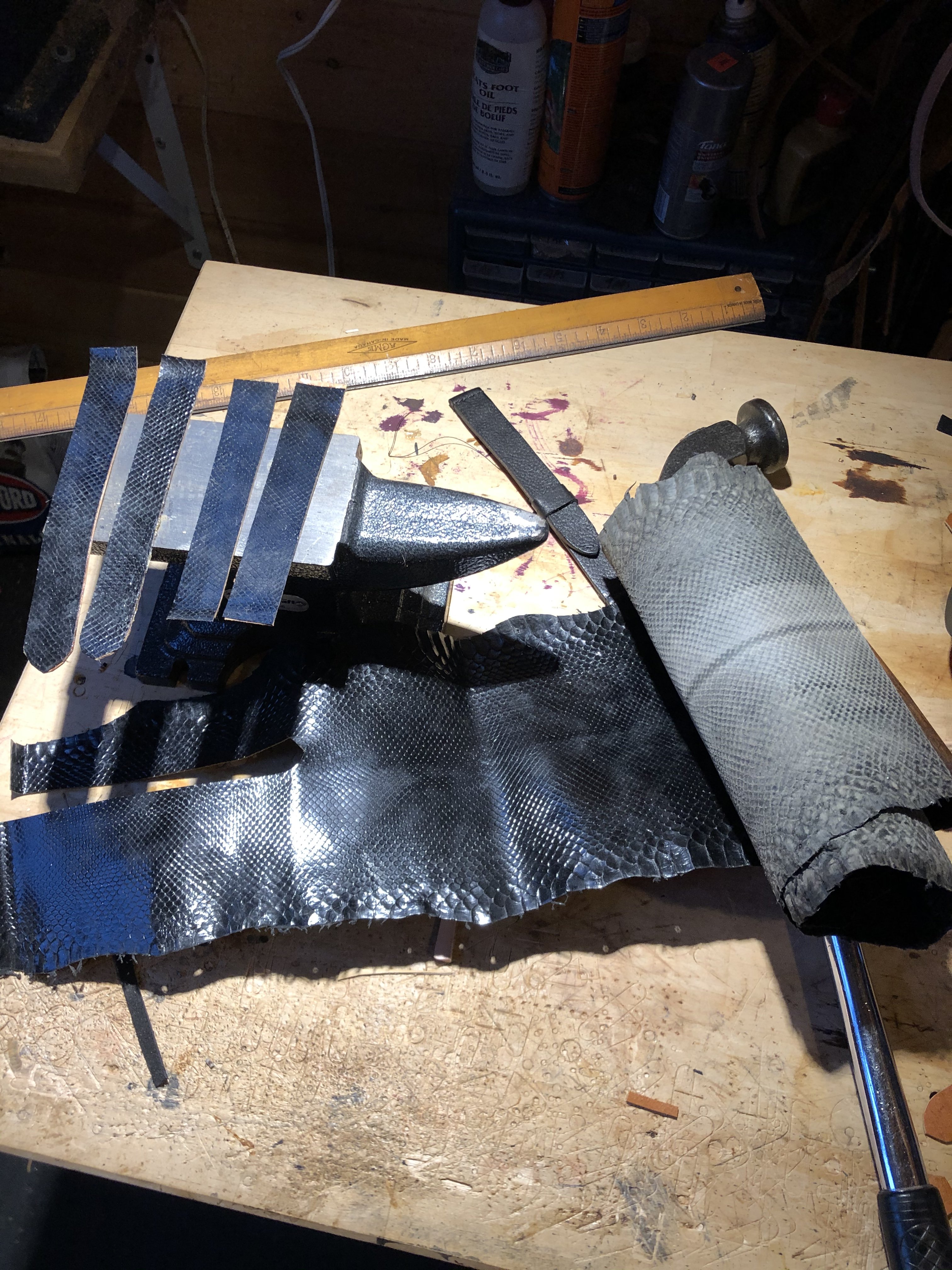

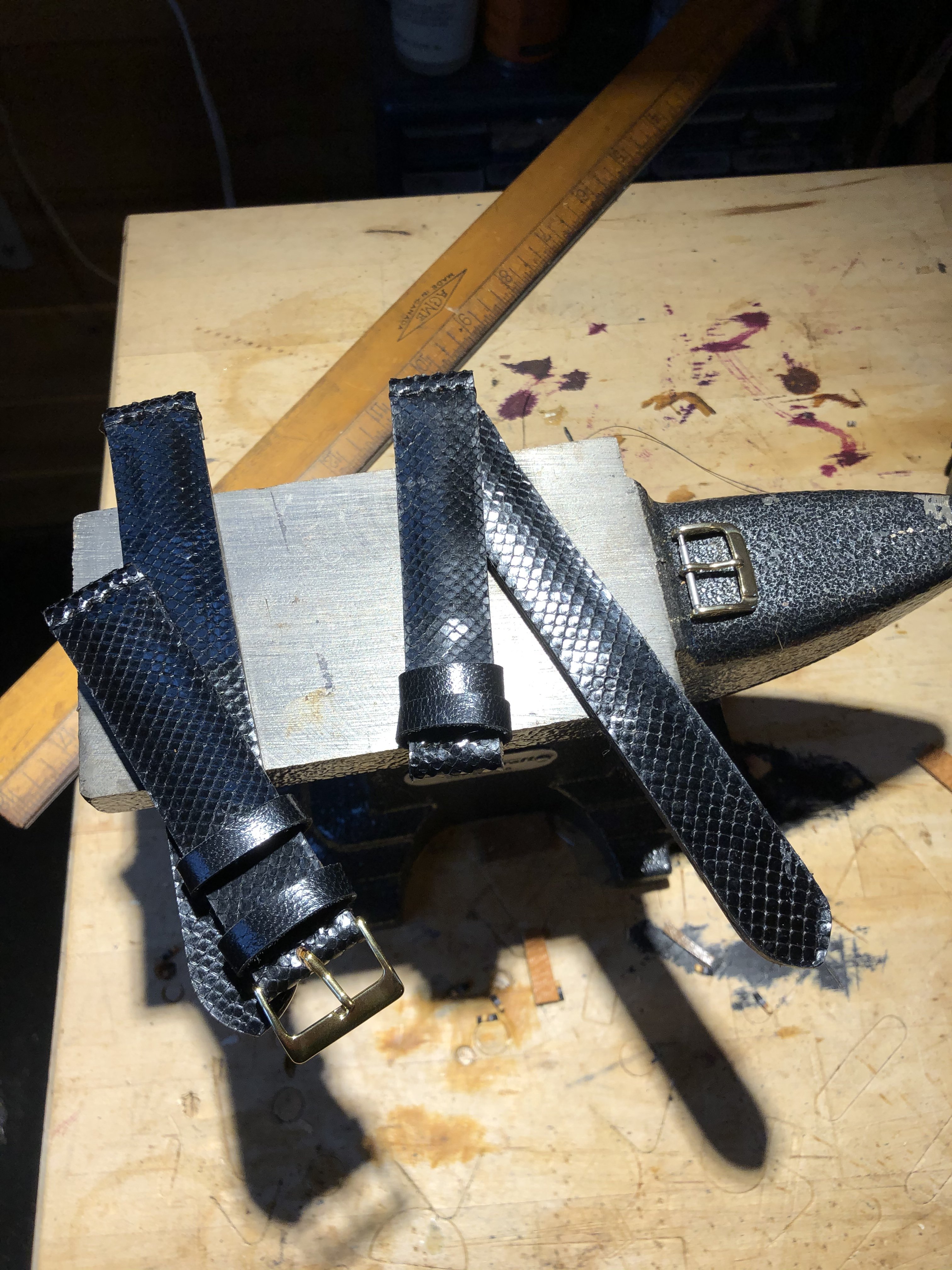

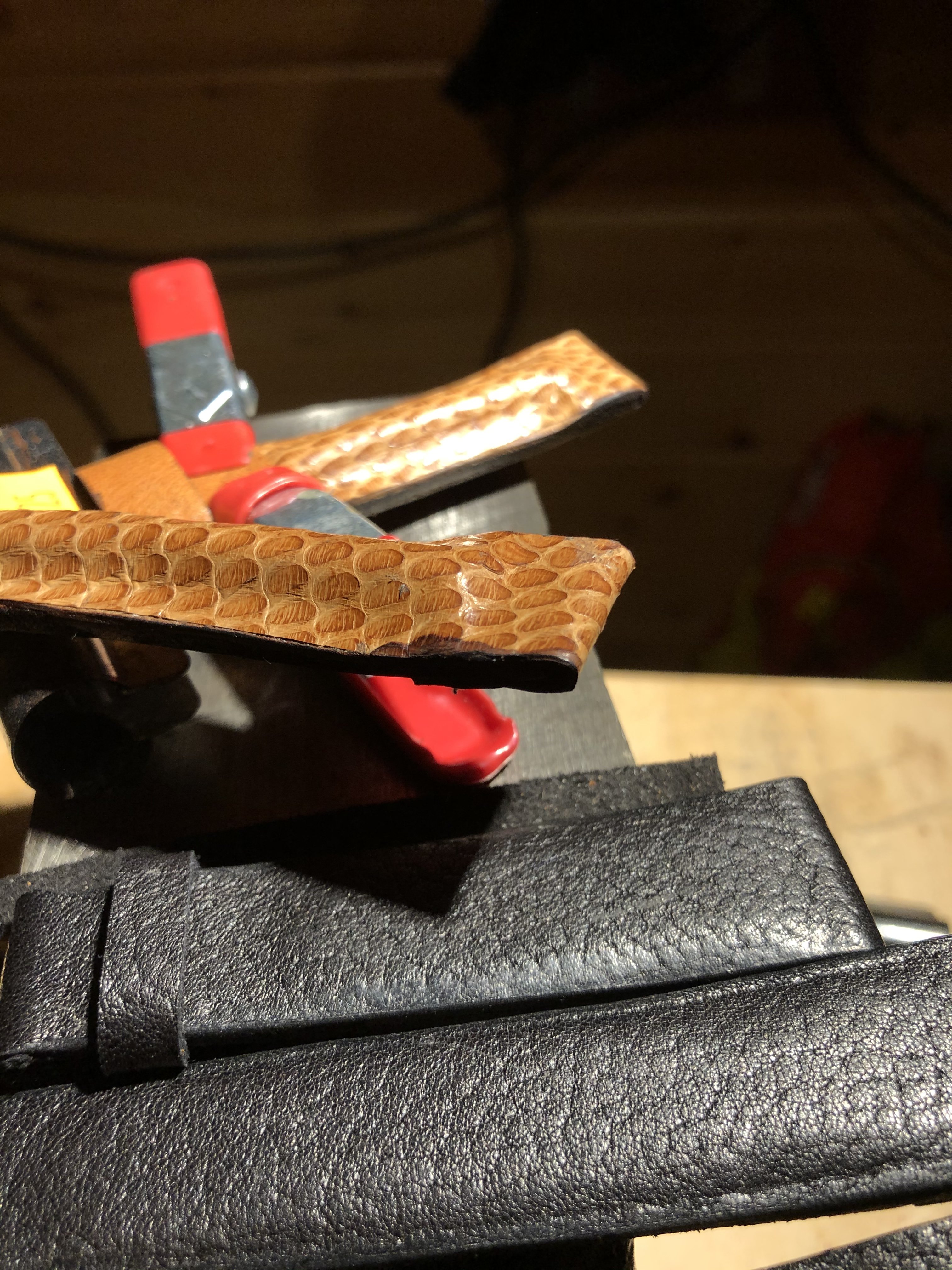

I found a six foot long snake skin at an antique store. It was black. A good excuse to make some black straps!!!
64
40
Cool find!! Those straps are looking real nice 👍

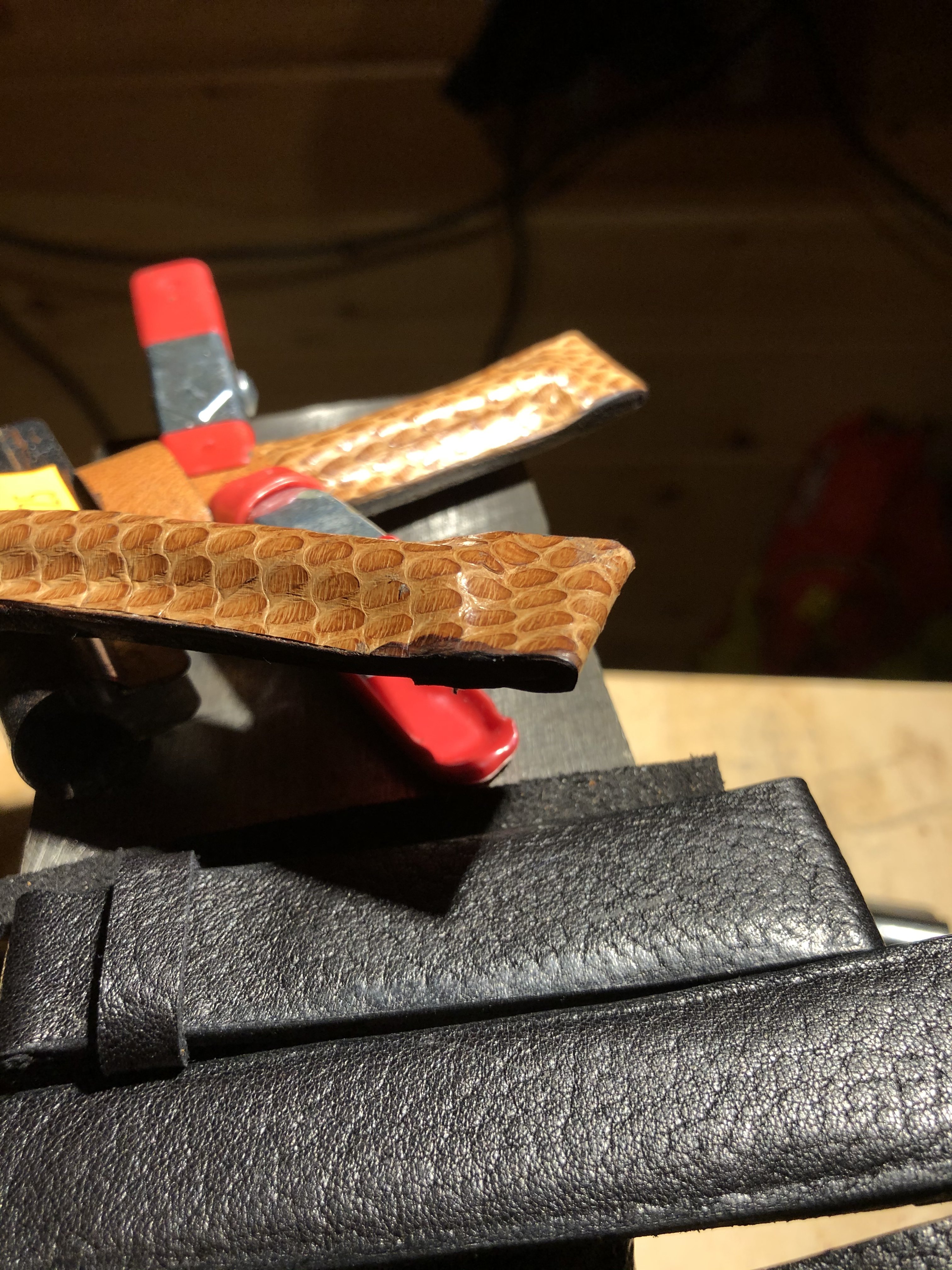

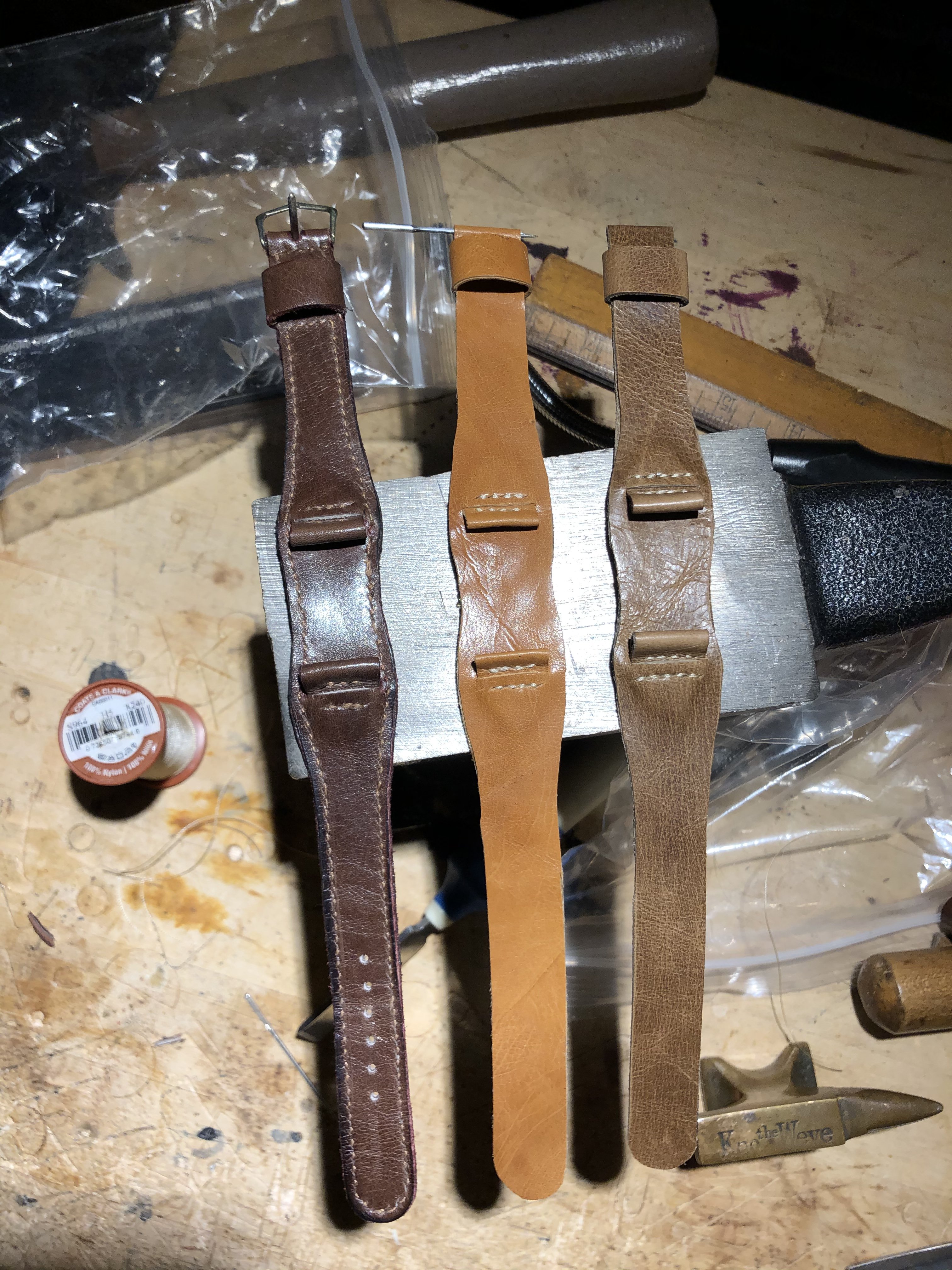

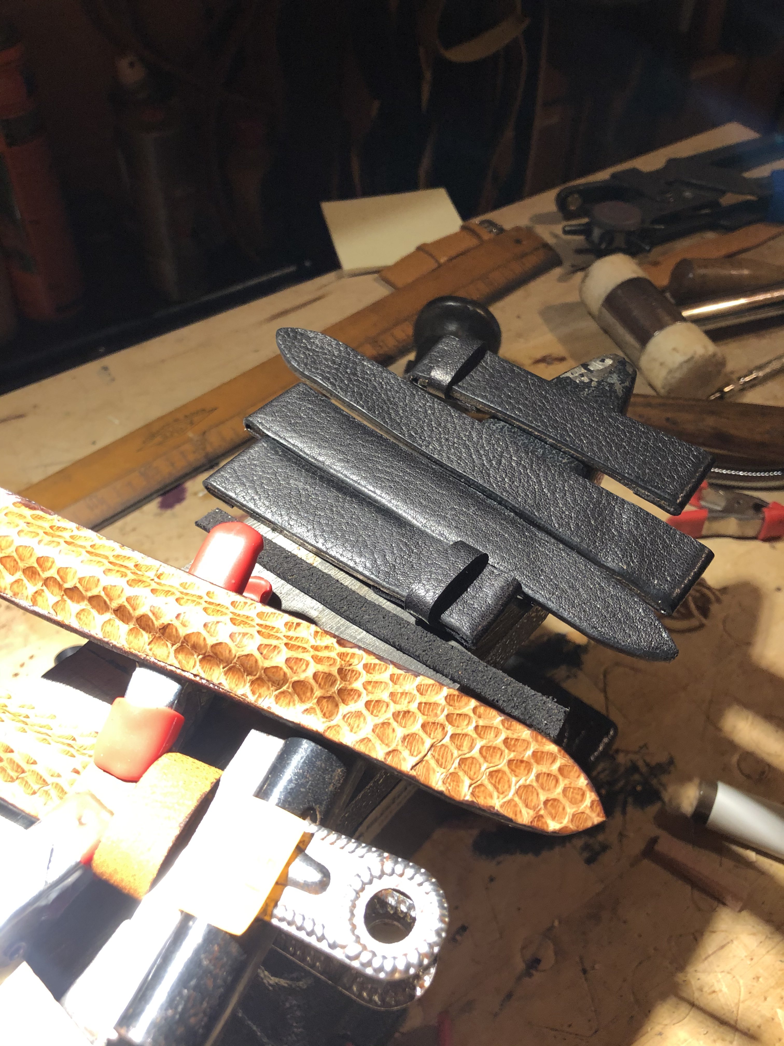

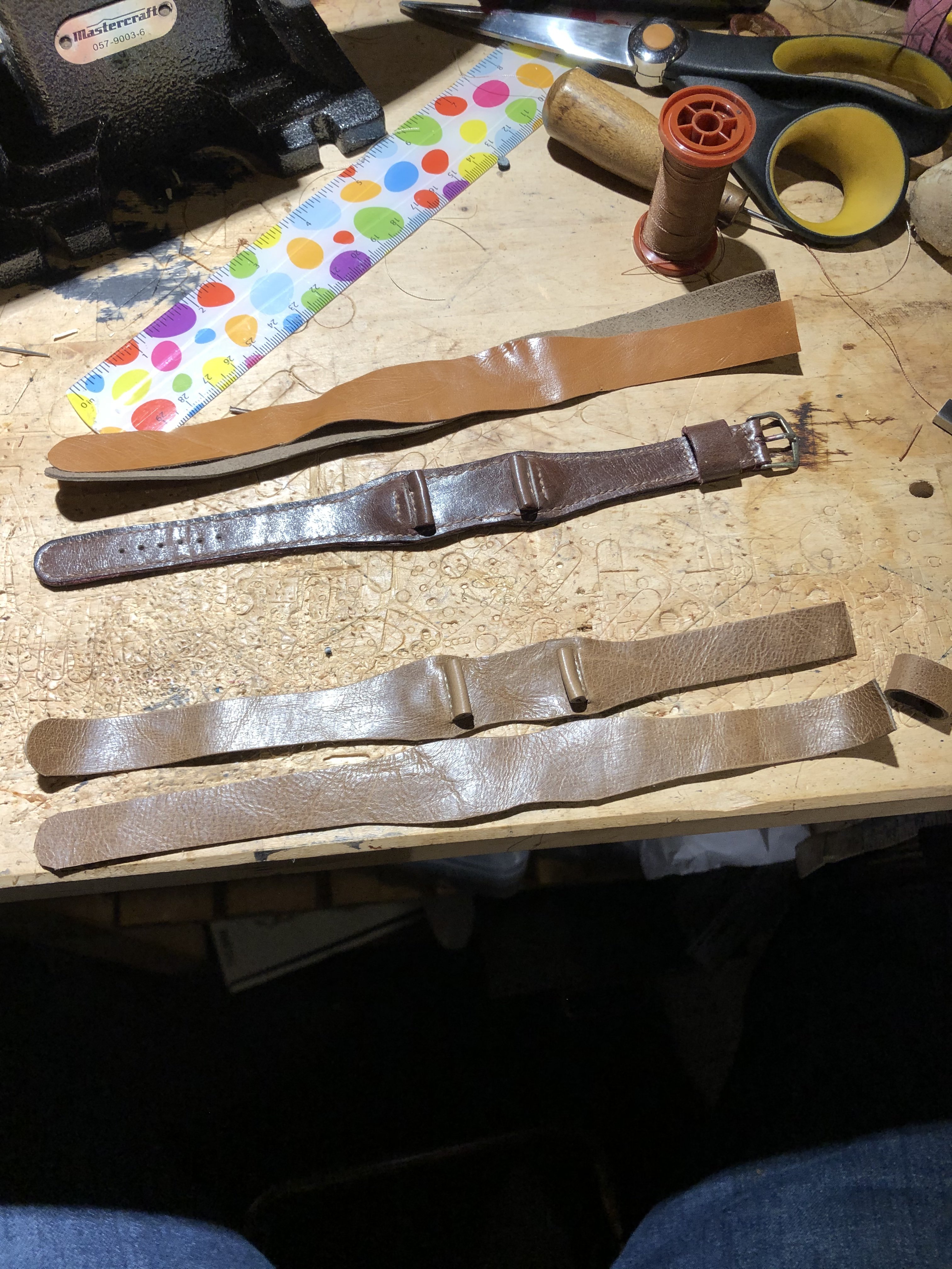

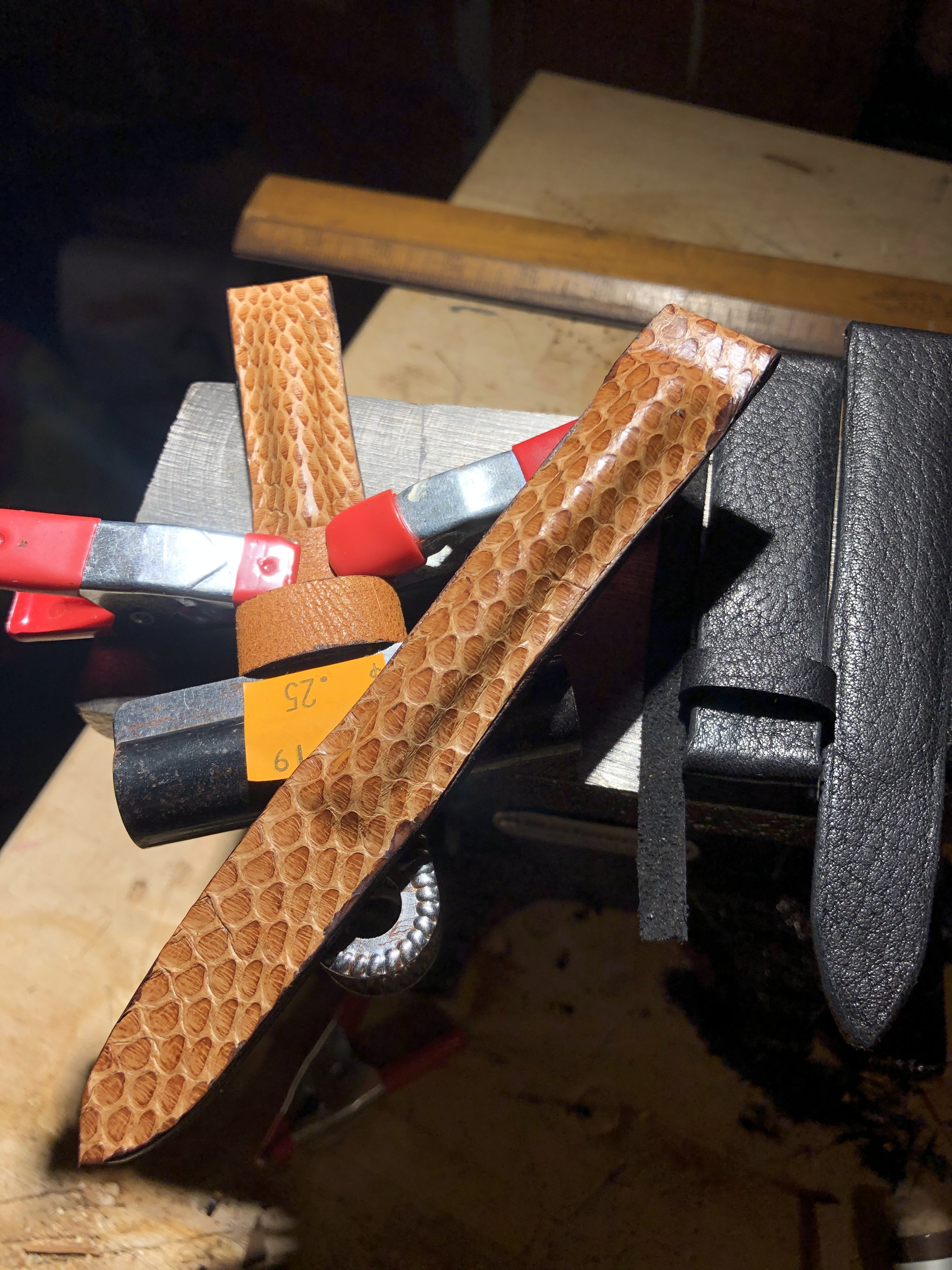

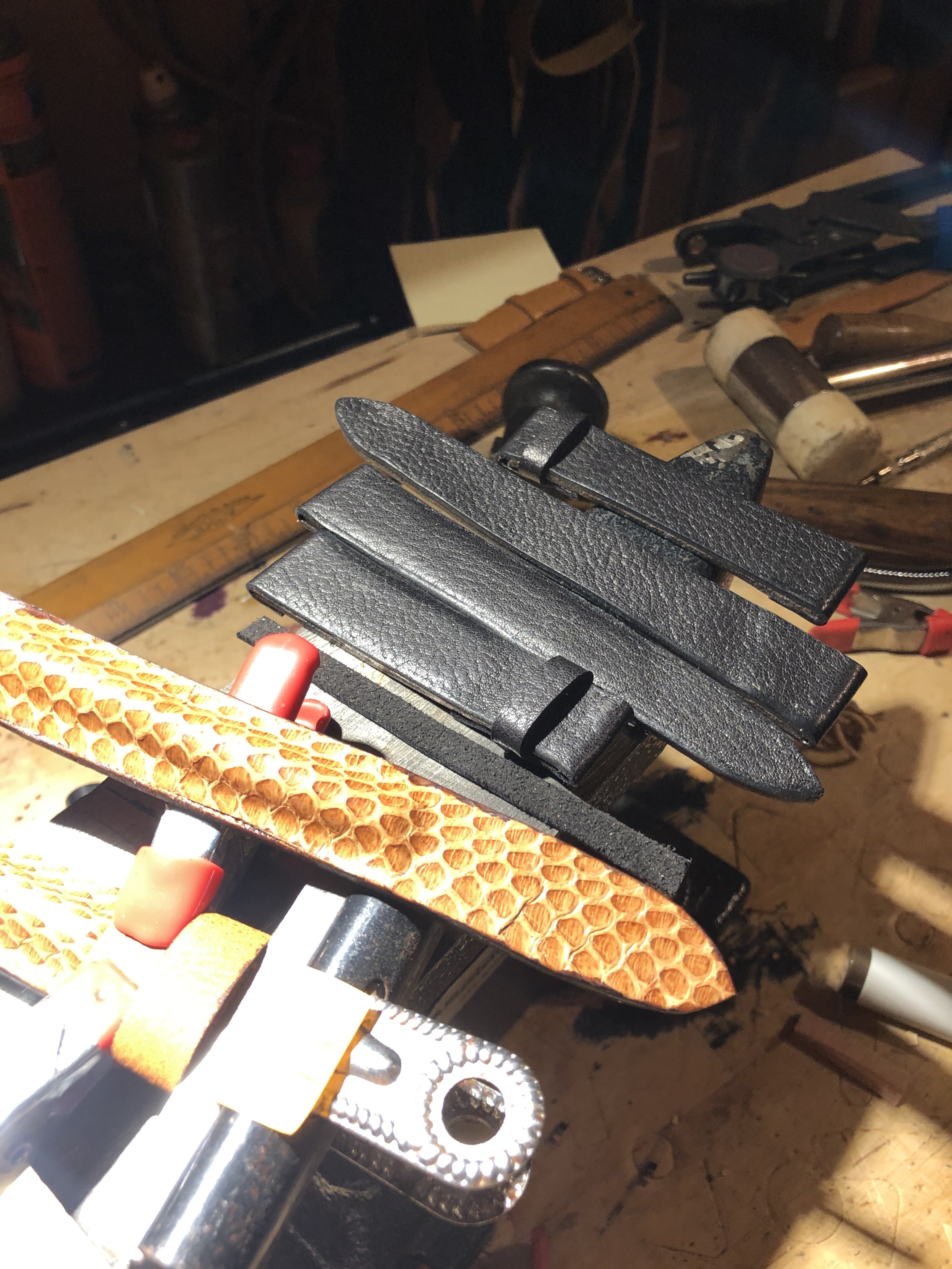

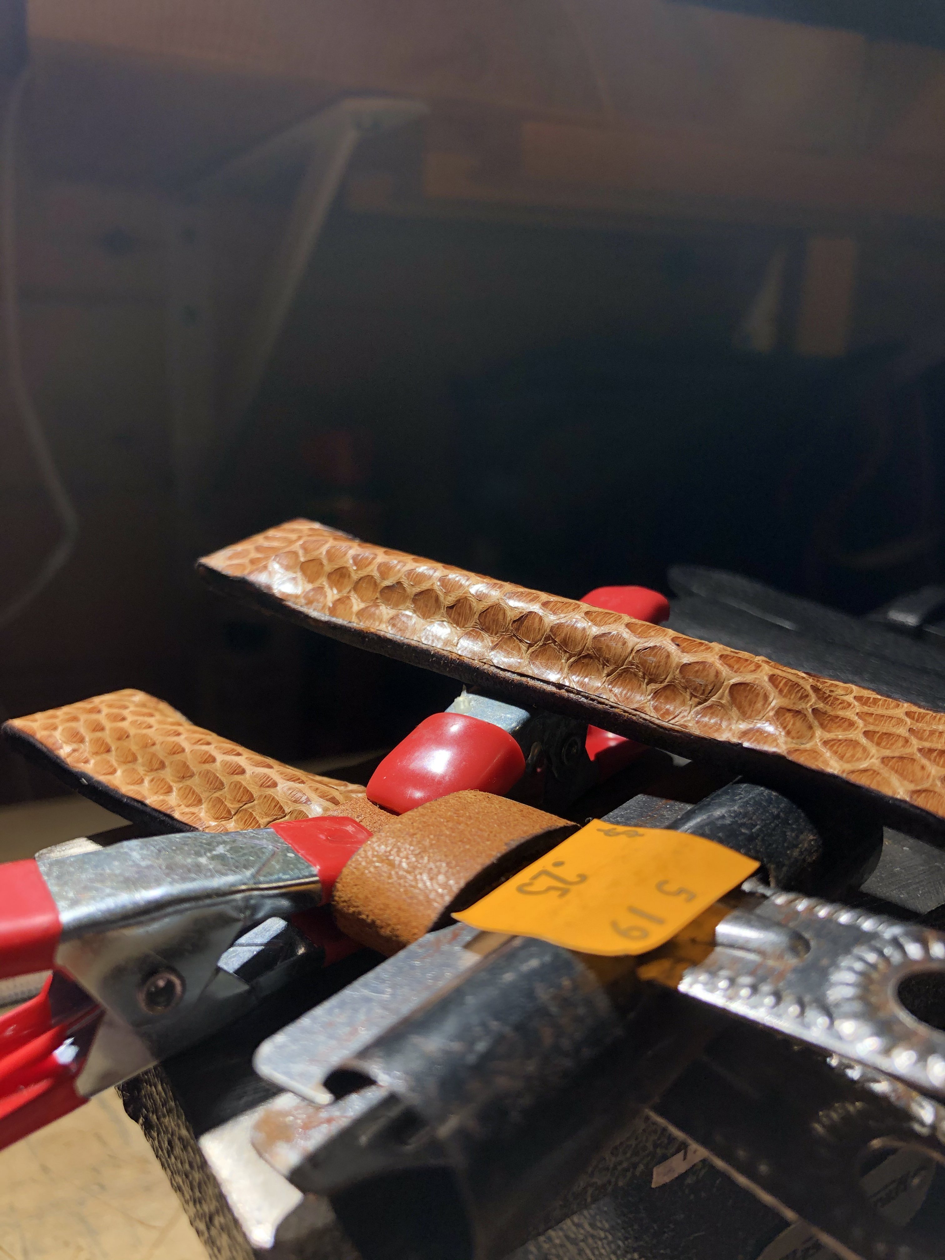

A couple more on the go. To be continued.

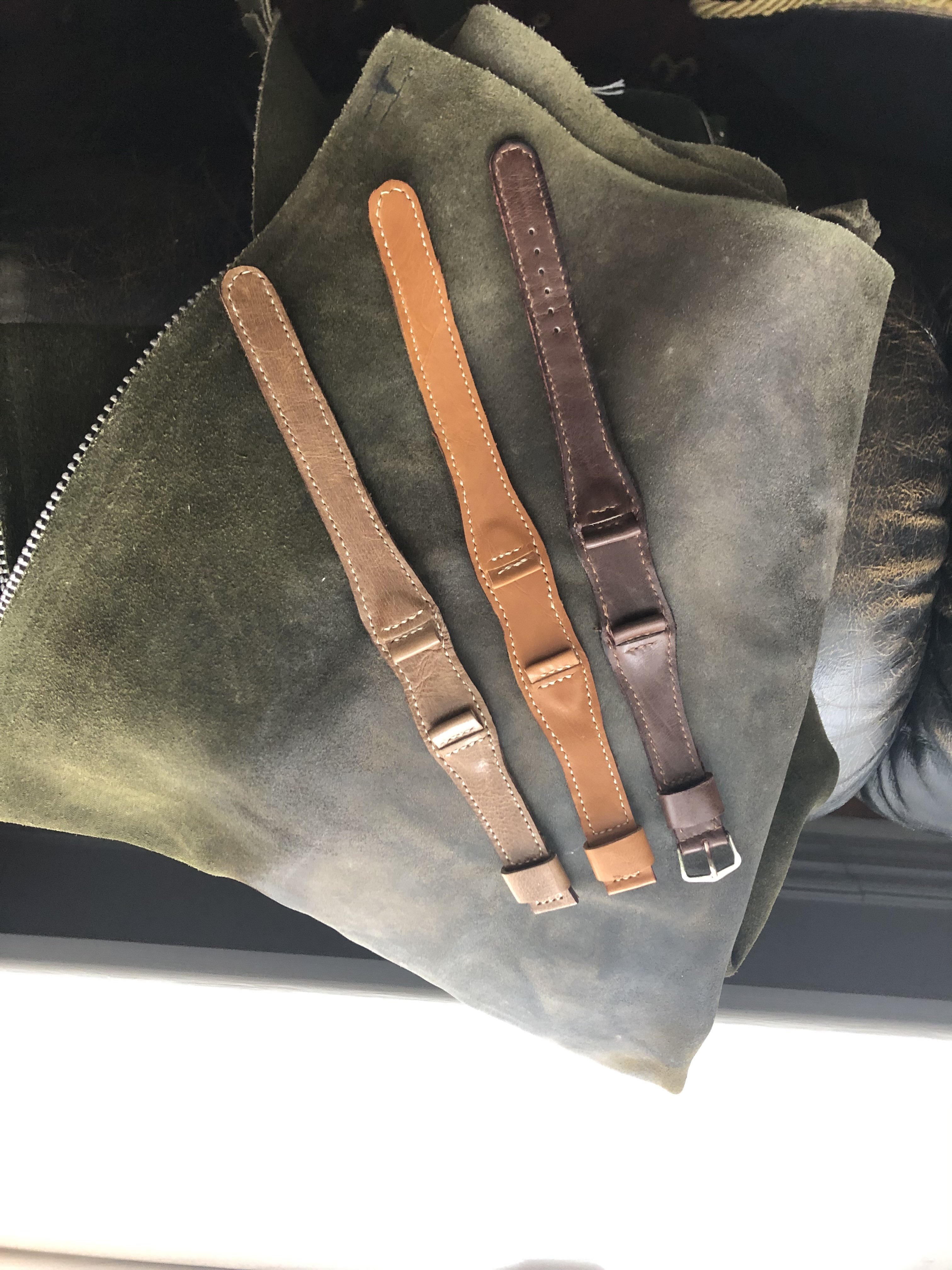

Complete. Once I decide on correct buckles I will add the hole(s). Underneath is an old pair of green suede chaps. Some of the leather is well worn, some is like new. It will make for some nice projects. Cost? $24!
16,305
45,025

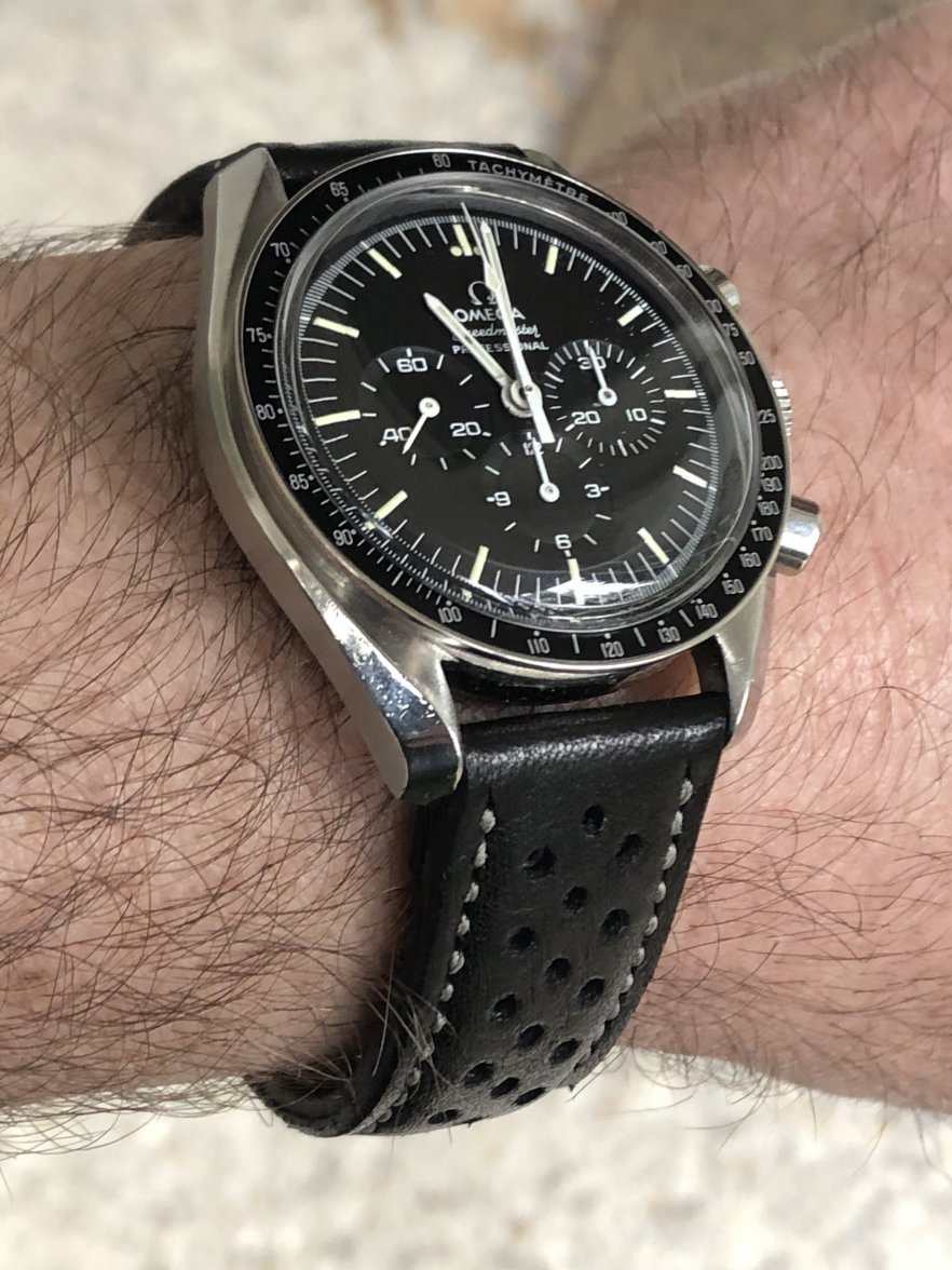

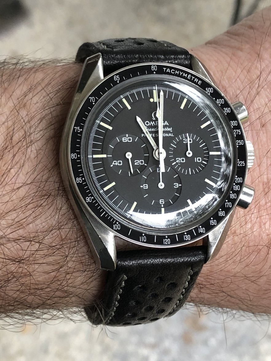

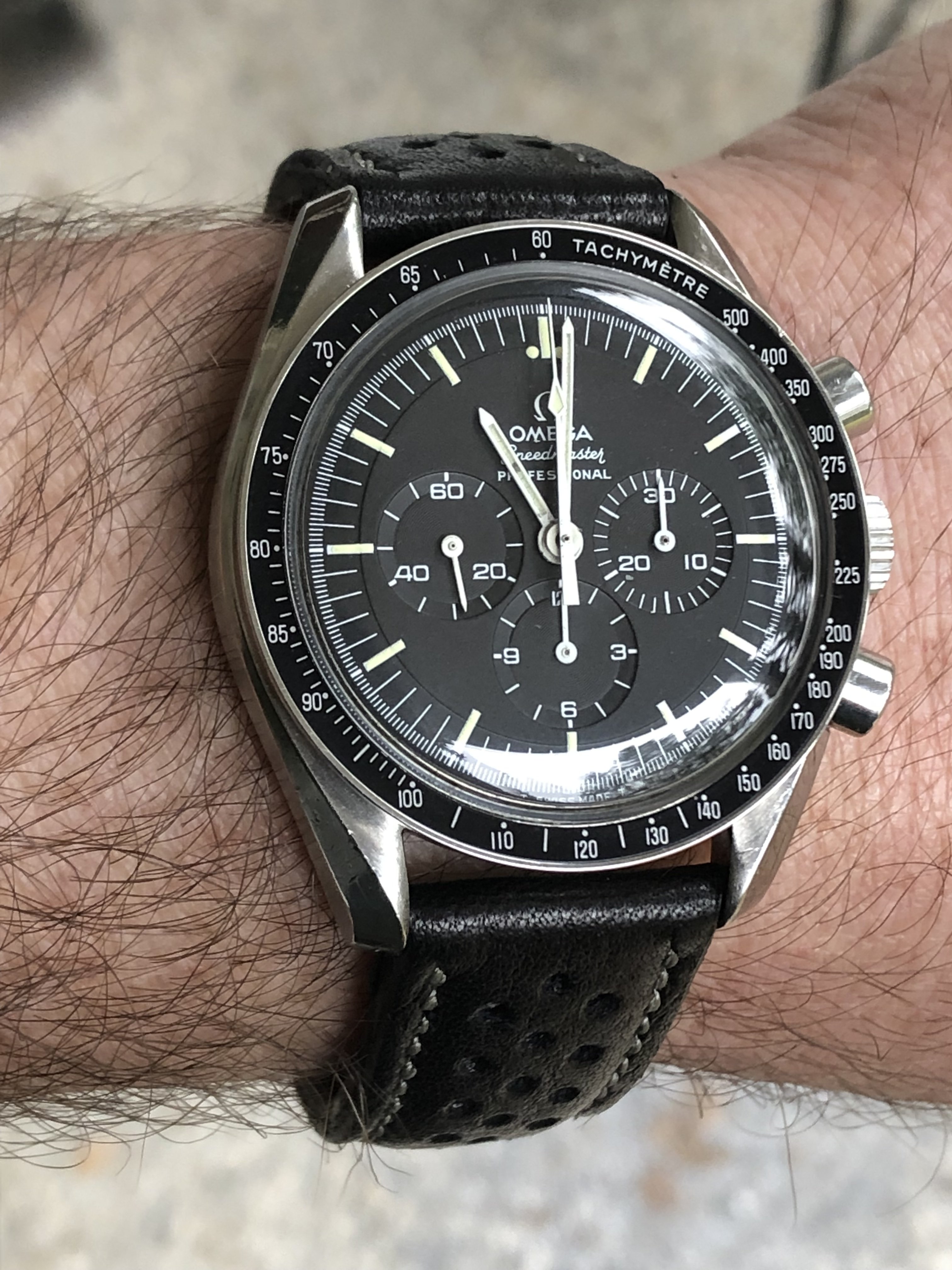

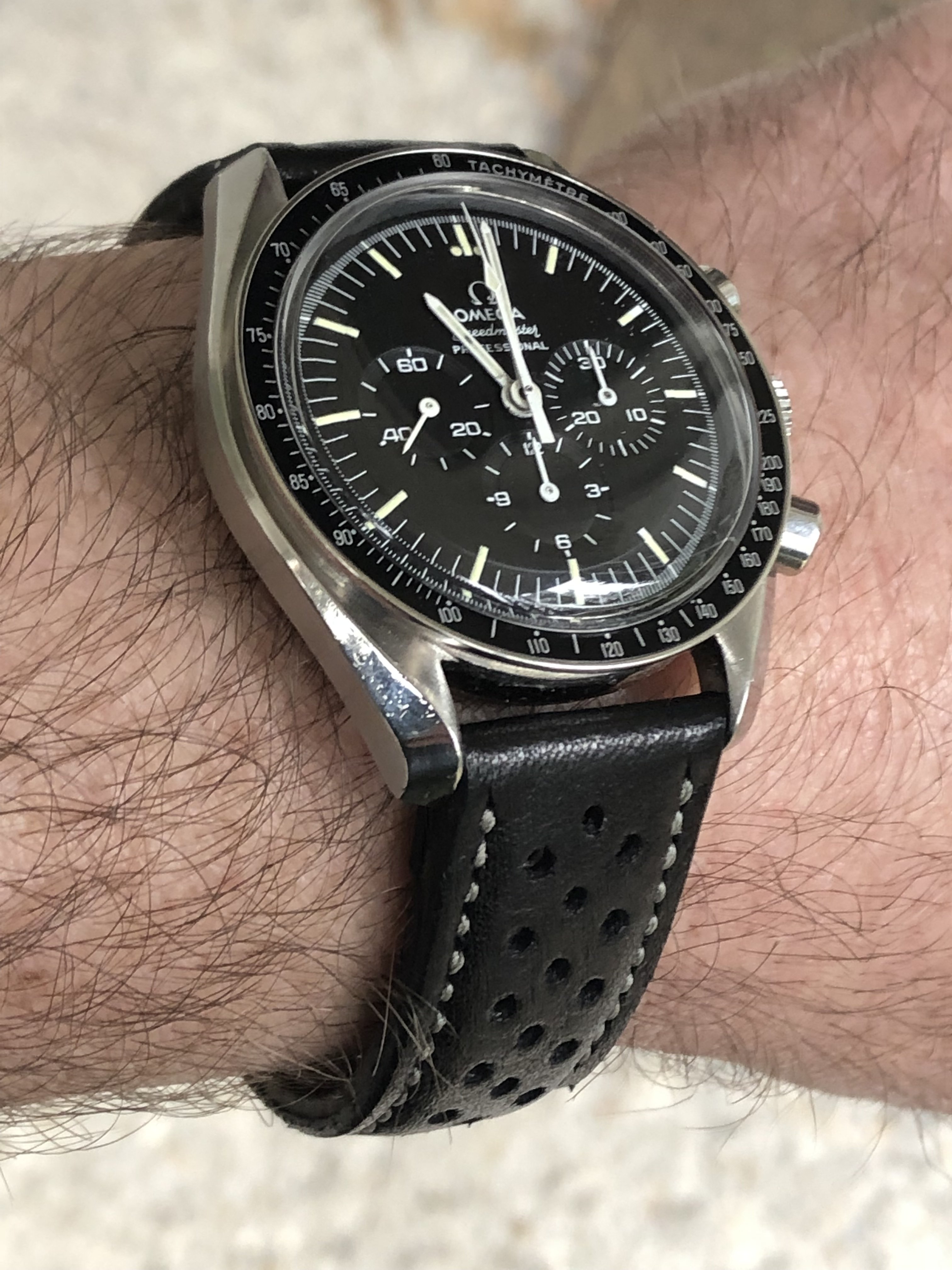

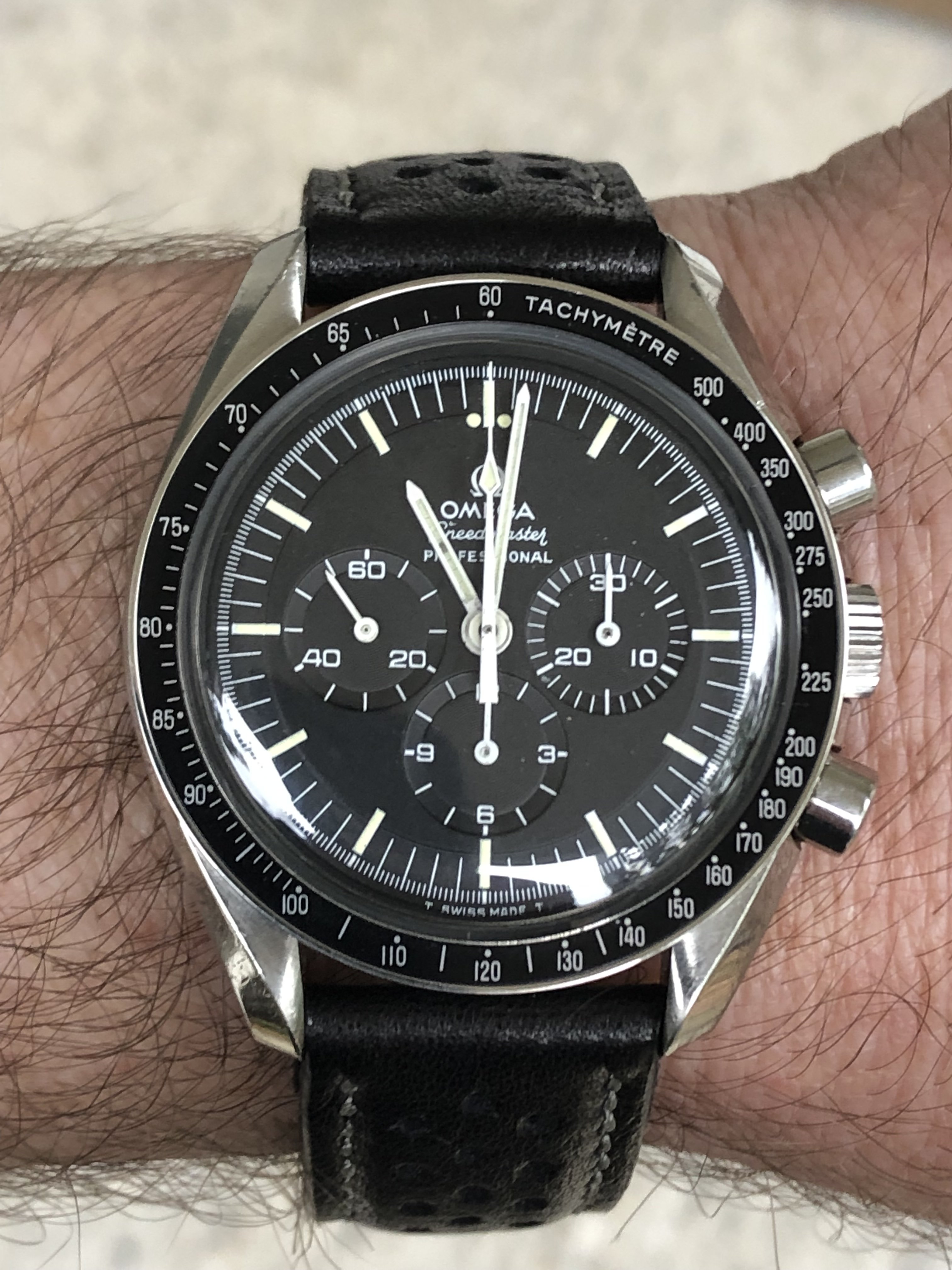

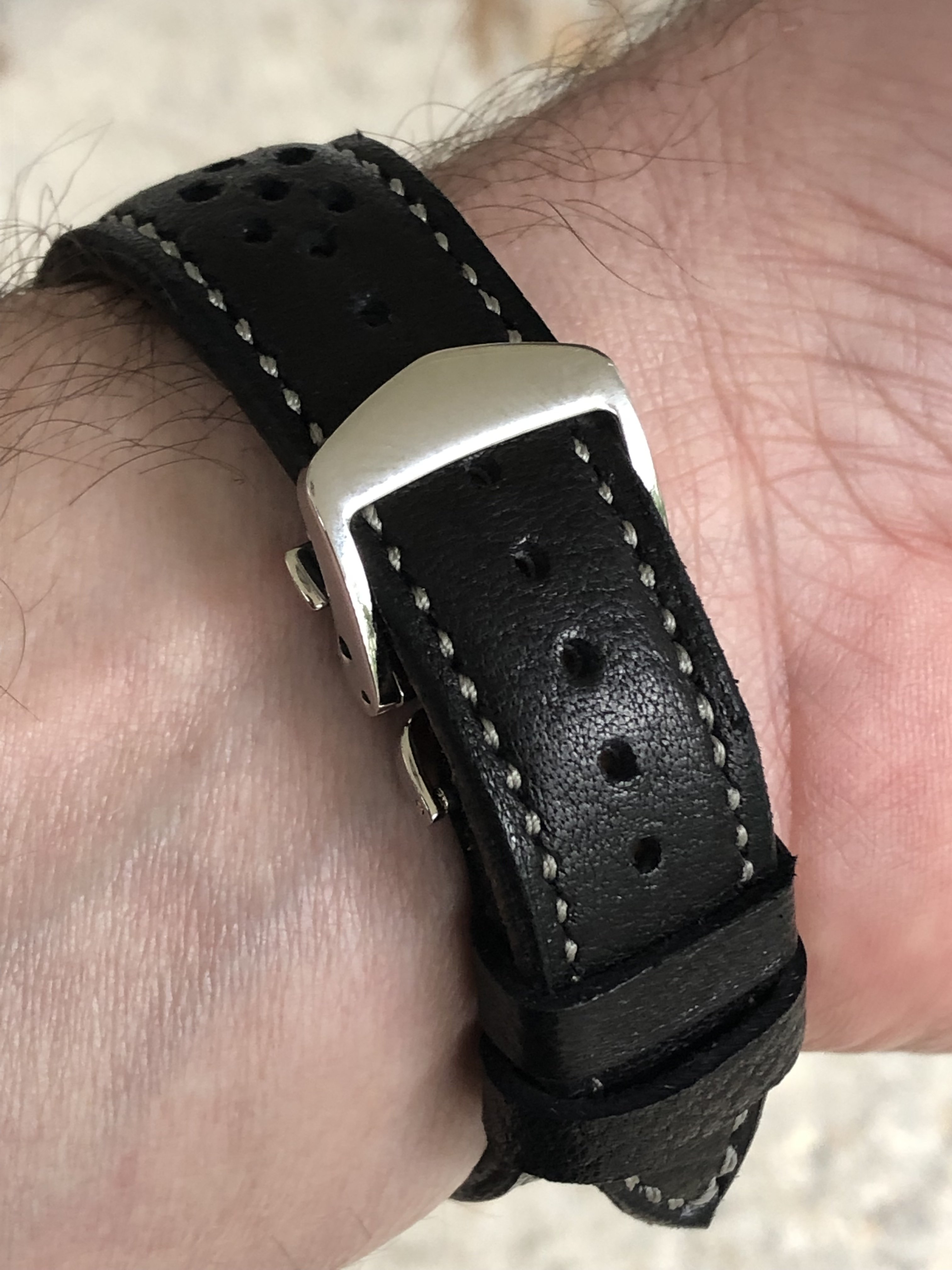

@Duracuir1 was kind enough to send me the Speedy strap- I had been looking for a good rally strap for my Speedmaster for some time- perfectly perforated and the grey stitch is a great match to the dial text & indices.

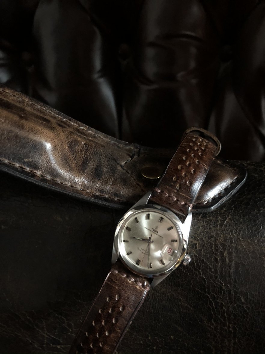

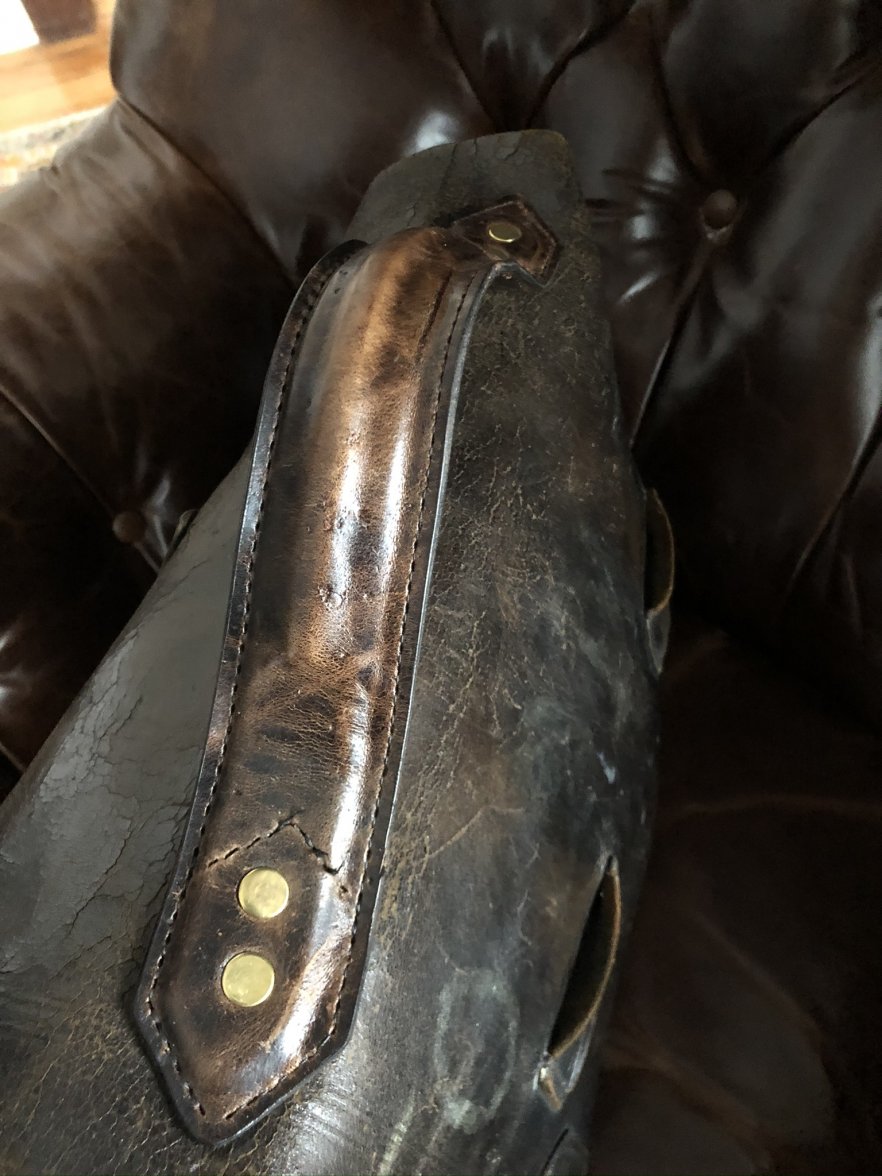

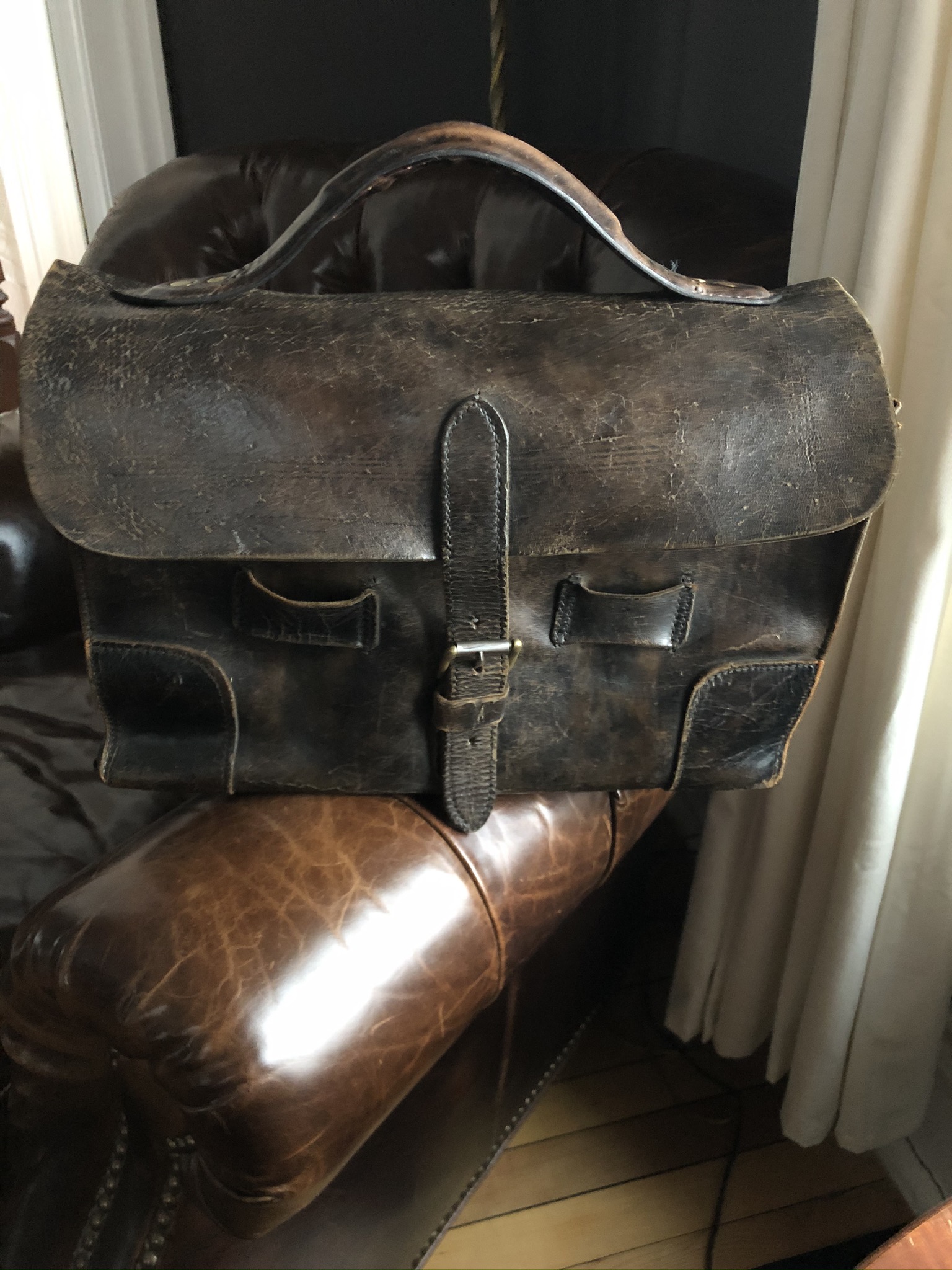

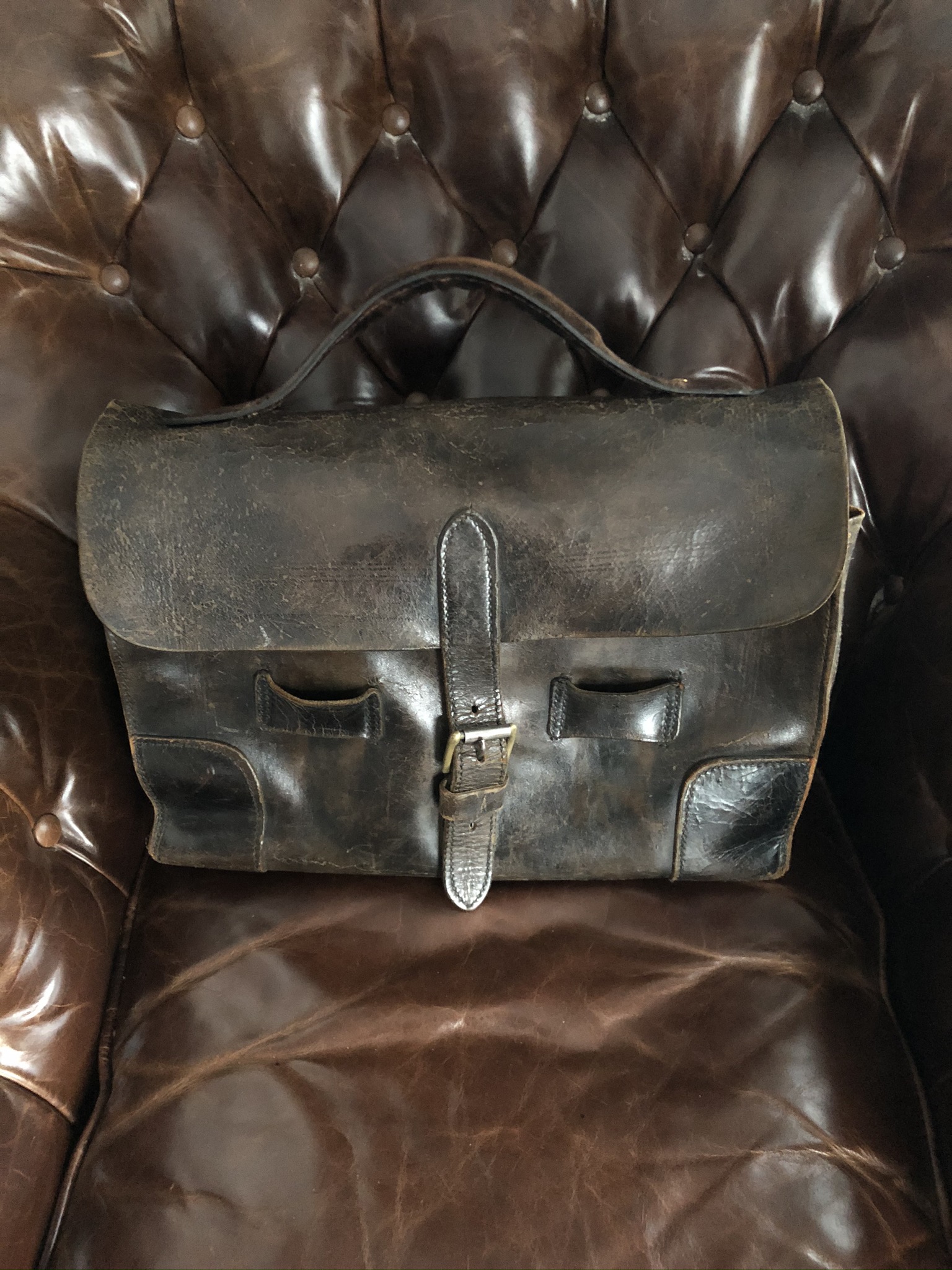

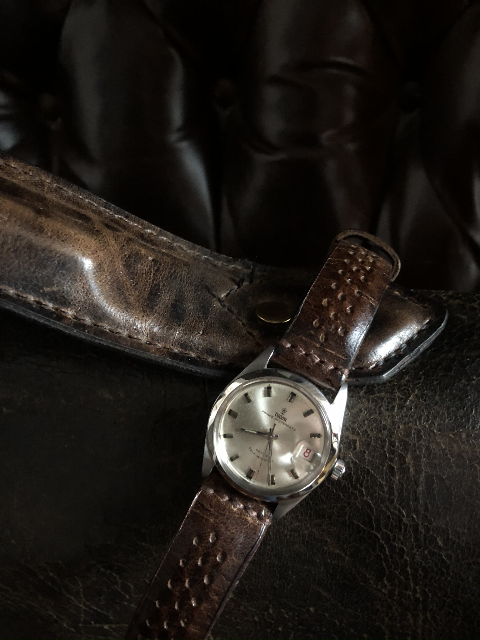

Lots of nice straps here and I’m a great fan of home made straps with vintage leather, but that was a nice purse... really a pity IMHO.

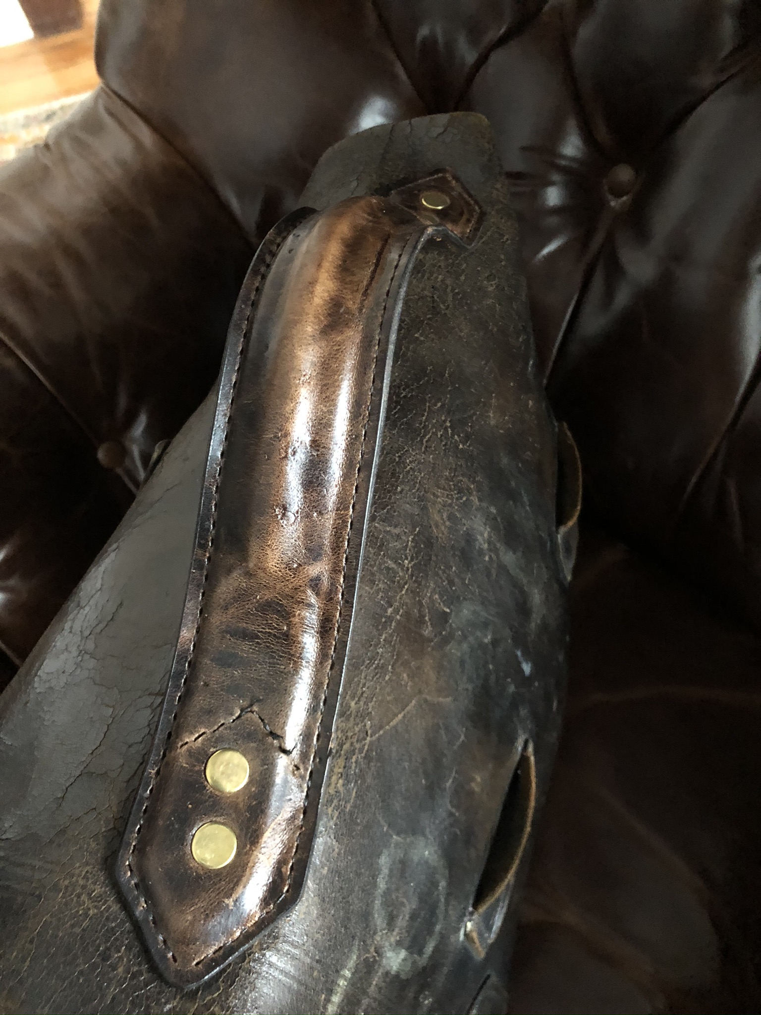

The last snake purse I bought was $3. They are not that desirable. But I recently picked up a leather bag for $15. It was in pieces. I restitched it. The only addition is the handle. I made the handle with the same leather that I used for my Tudor strap. Sometimes things are worth saving.

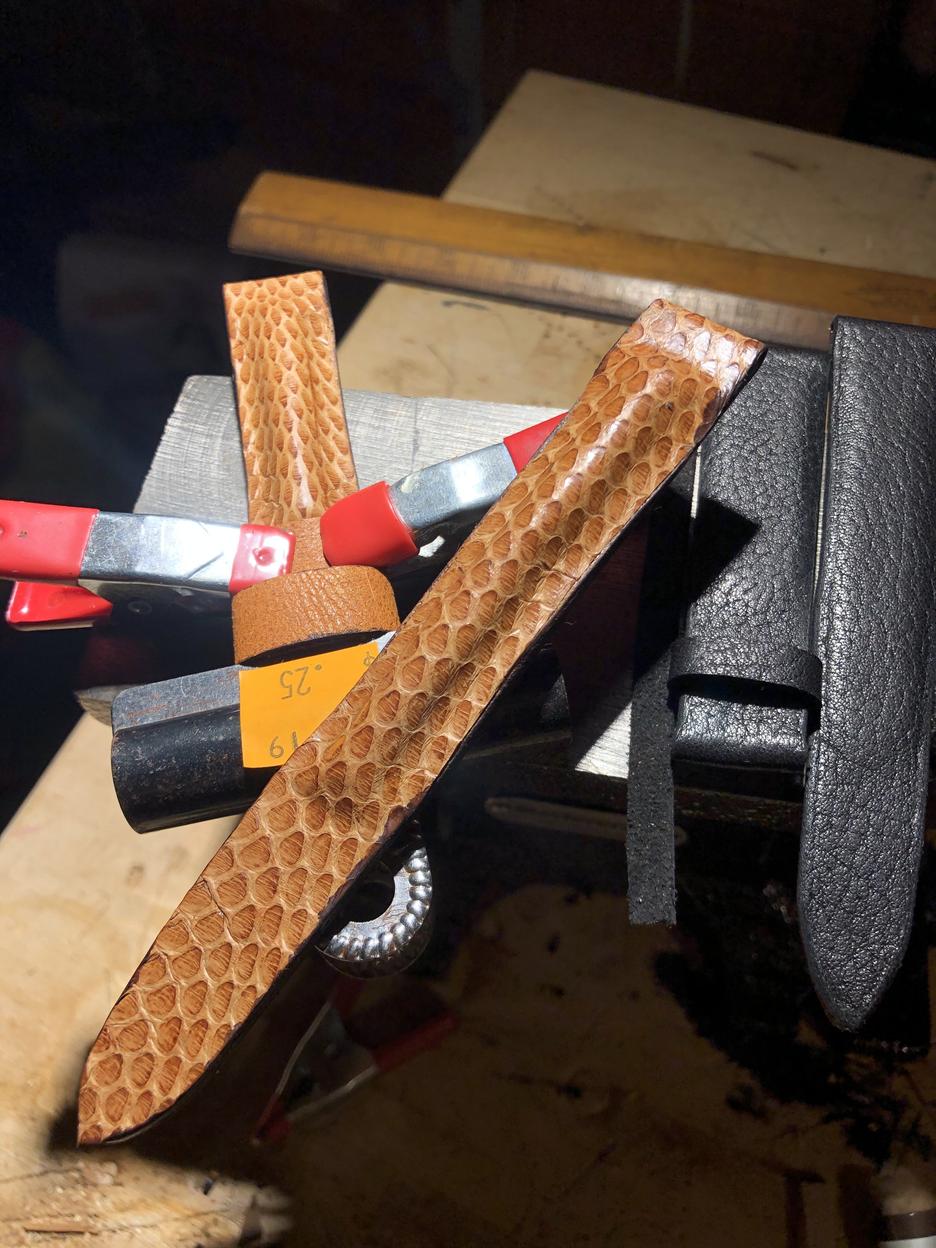

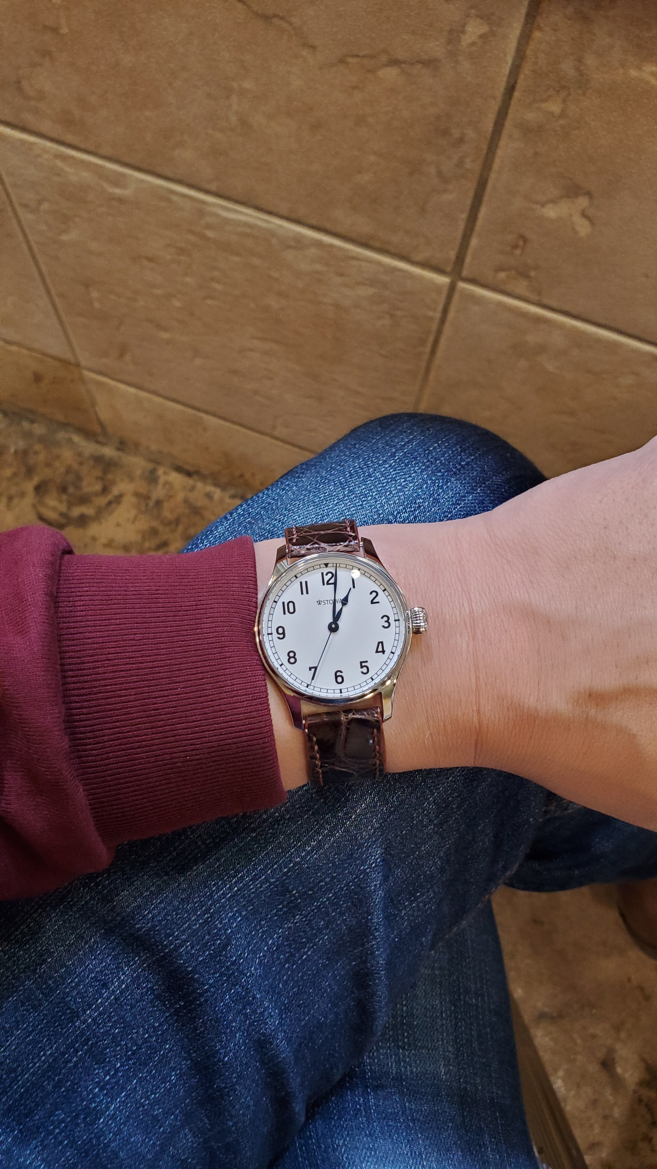

Not an Omega but made a new croc strap to accompany my Stowa.

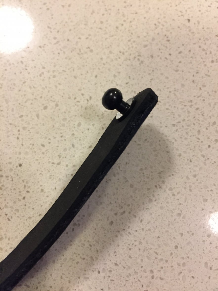

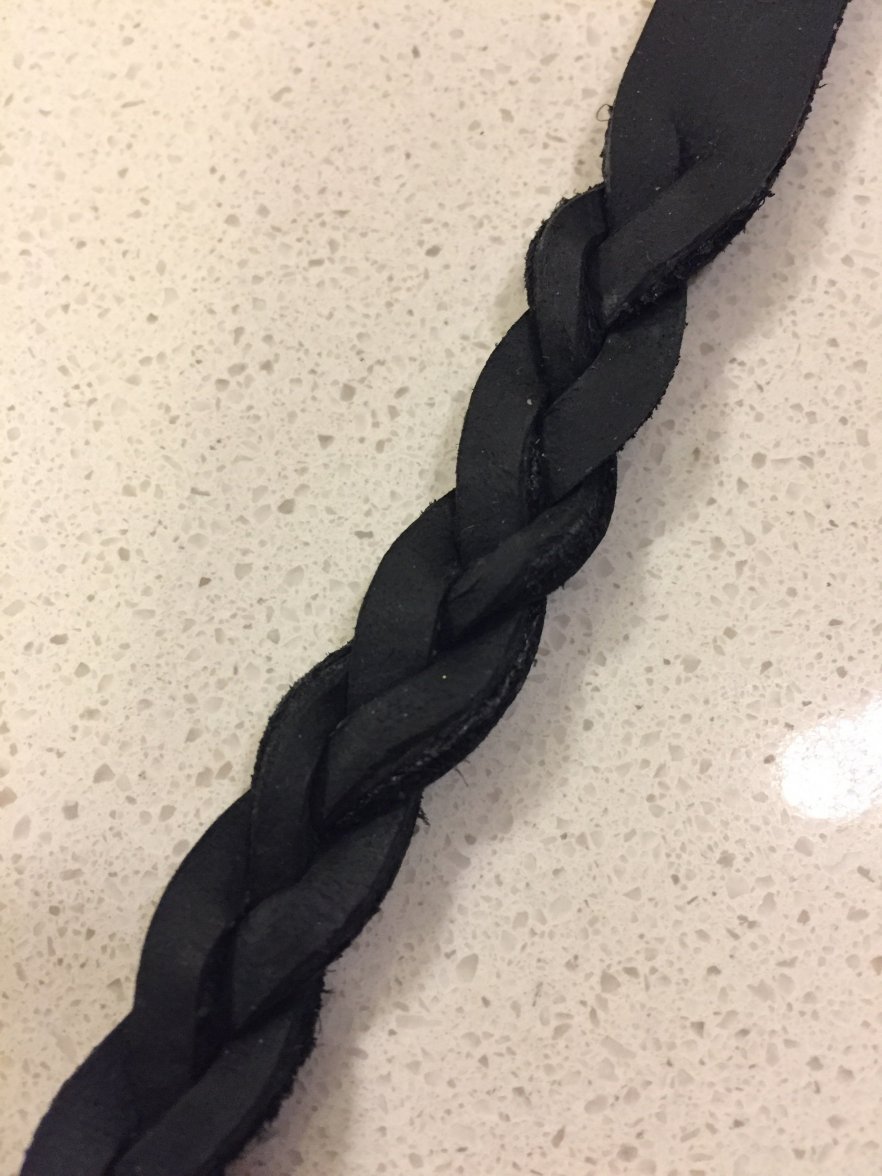

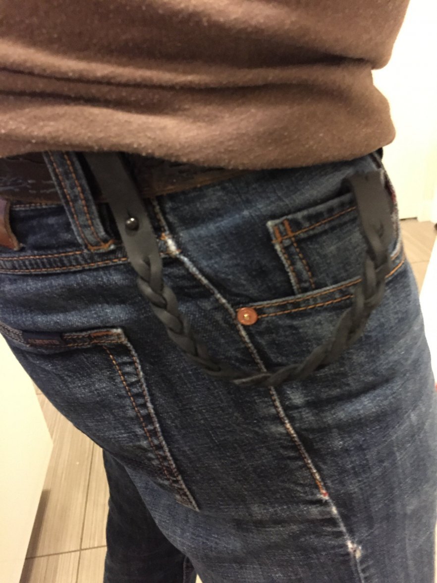

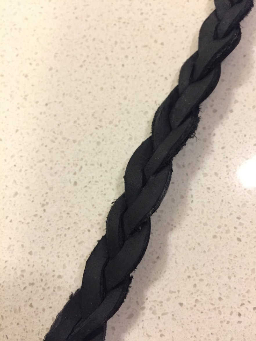

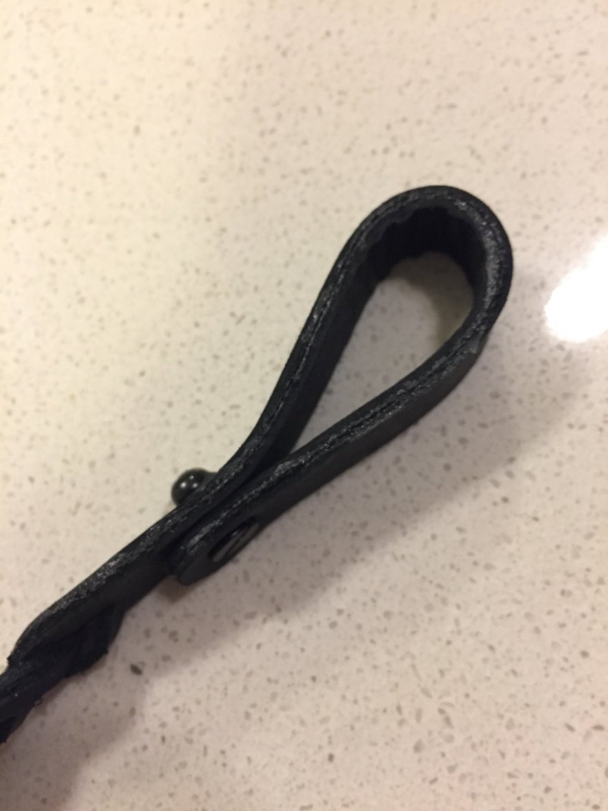

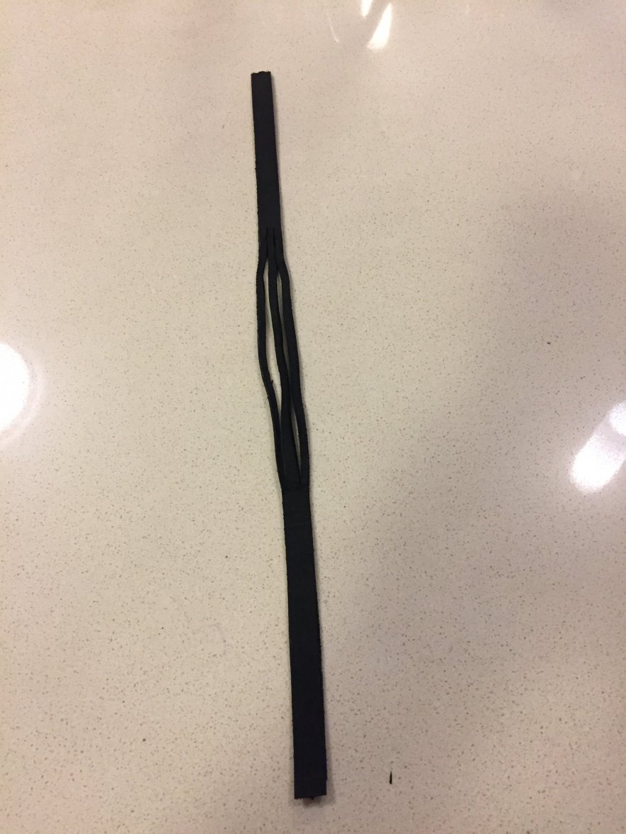

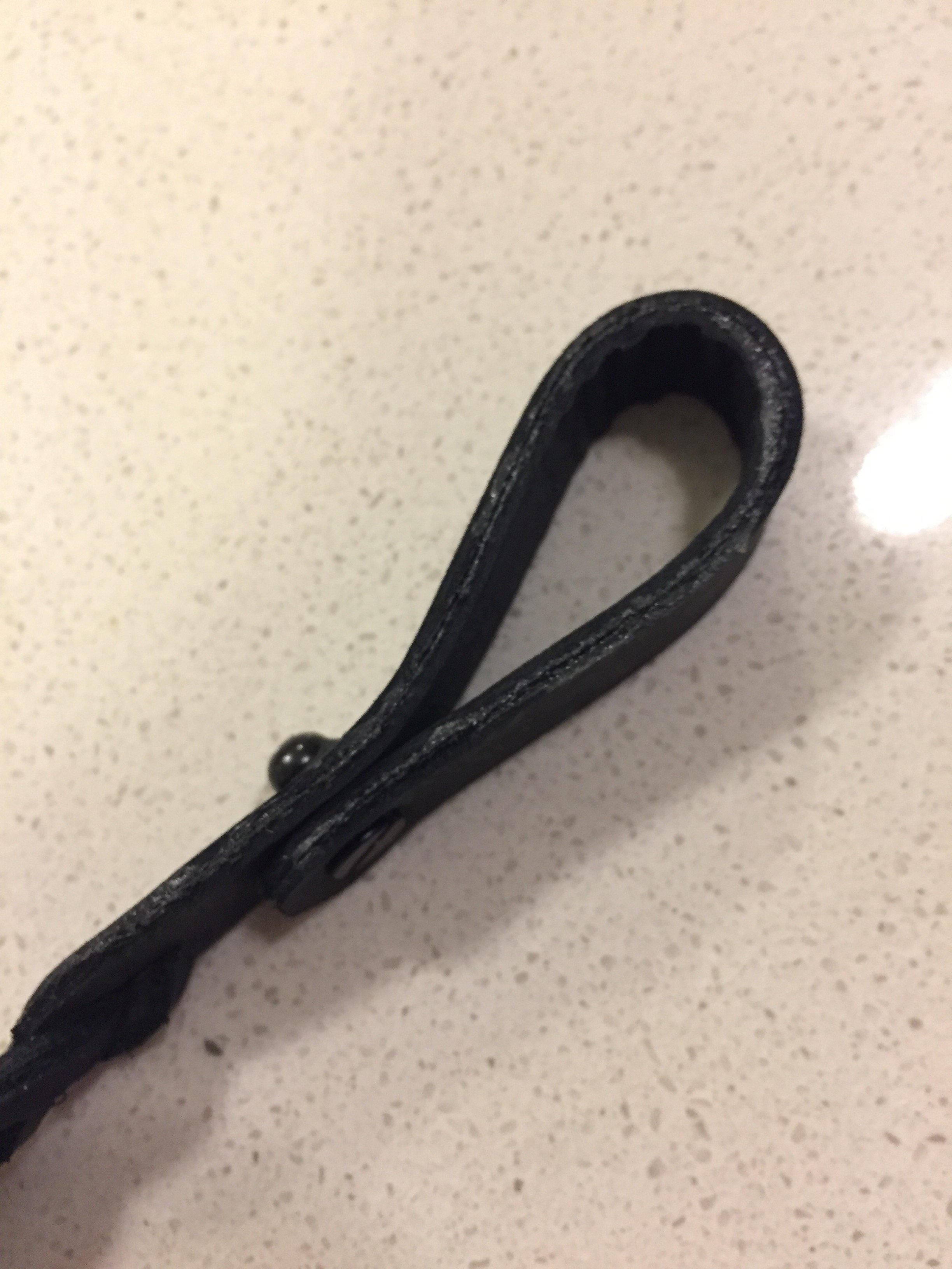

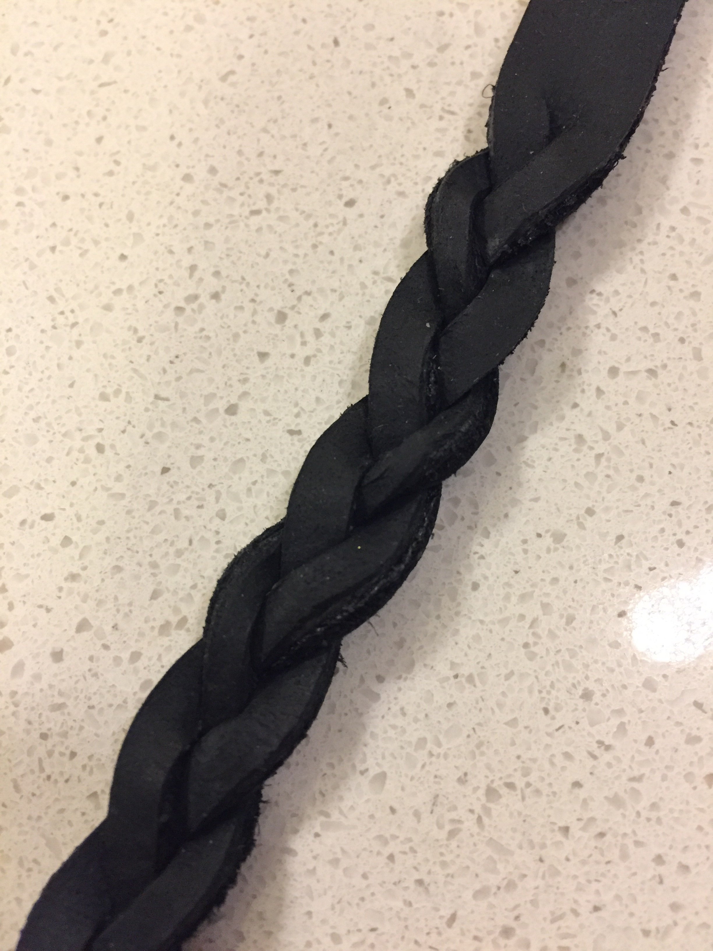

Hi folks! Well, here is my first leather project off of the bench. I surprised myself wanting to make a pocket watch lanyard first, vs a wrist strap. The heart wants what the heart wants, I guess.
Step 1: Look at a bunch of pictures of lanyards online then treat the project like I treat most recipes - get a general idea of how it should look and then say “Whatever, I can make this easier/better/quicker my own way”. Then, agonize/enjoy thinking through a prototype

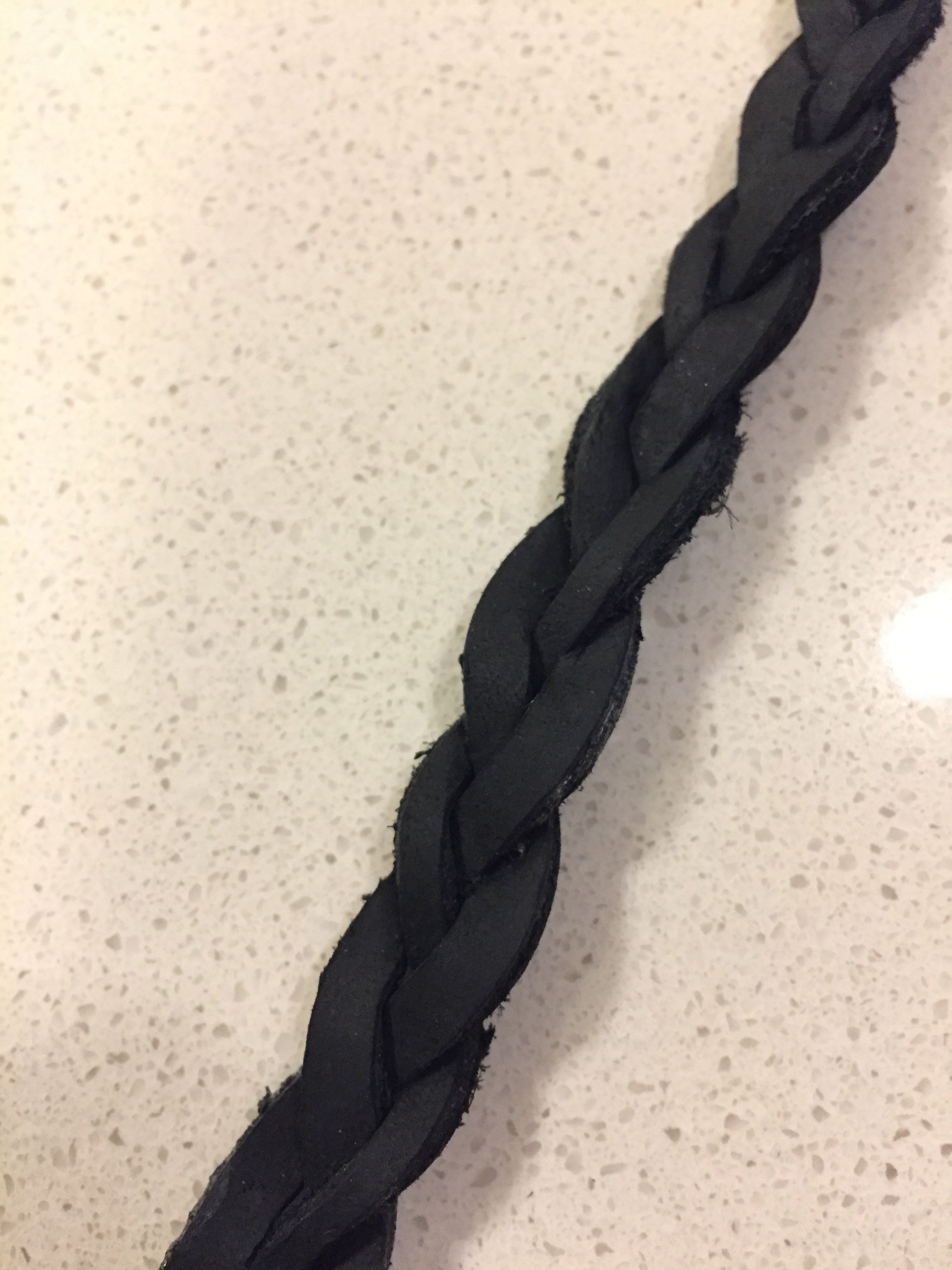

Step 2: I start with some lacing, skive it down half width and glue two pieces back to back, so I had two finished sides, instead of one rough one. Then, make cuts for a mystery braid.
Step 3: Watch this mystery braid video 20 times (
), scream, then watch this one twice (
), finally figuring out the process relatively easily

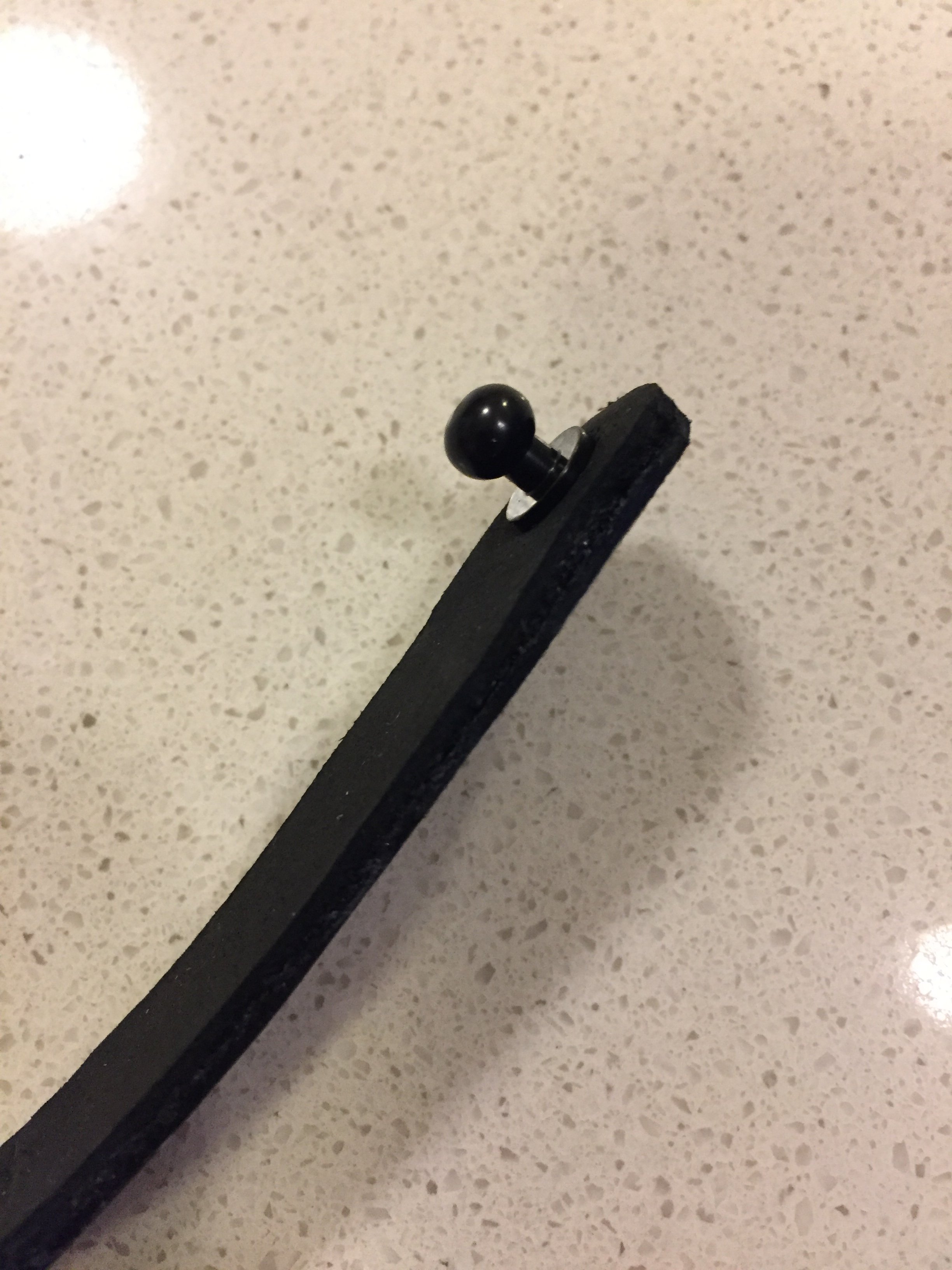

Step 4: install a button stud for the first time - pause to feel accomplished 😀
For attaching the lanyard to your belt
Step 5: realize I haven’t fully thought through the watch end yet, and decide I’d like to install a snap to finish that end, but I can’t get to the supply store until next Saturday 😬
Apologies for those of you who are eating dinner and didn’t expect to see my butt. 😉
Making these lanyards with pre-fab braids would be thinner and faster/easier, but I think I’ll like the heft of this in the long run.
Thanks to @Duracuir1 for the inspiration from this thread 👍
I hear you on the strop and jewellers rouge - I find that one hobby (leathercrafting) then leads to another (knife sharpening) and then leads to another and another.... 😀
I finally gave the snake band with extreme padding to my jeweller. It bends nicely and the big man loves it!

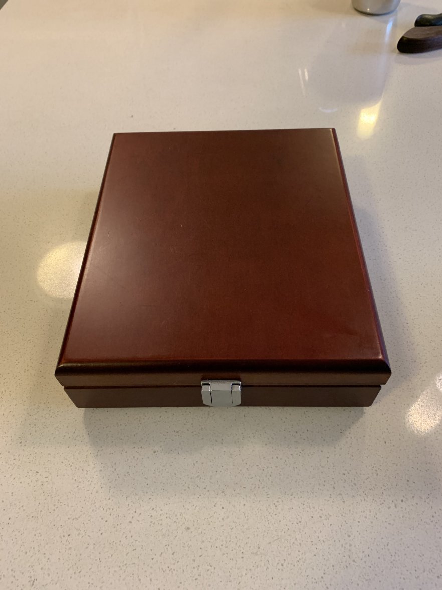

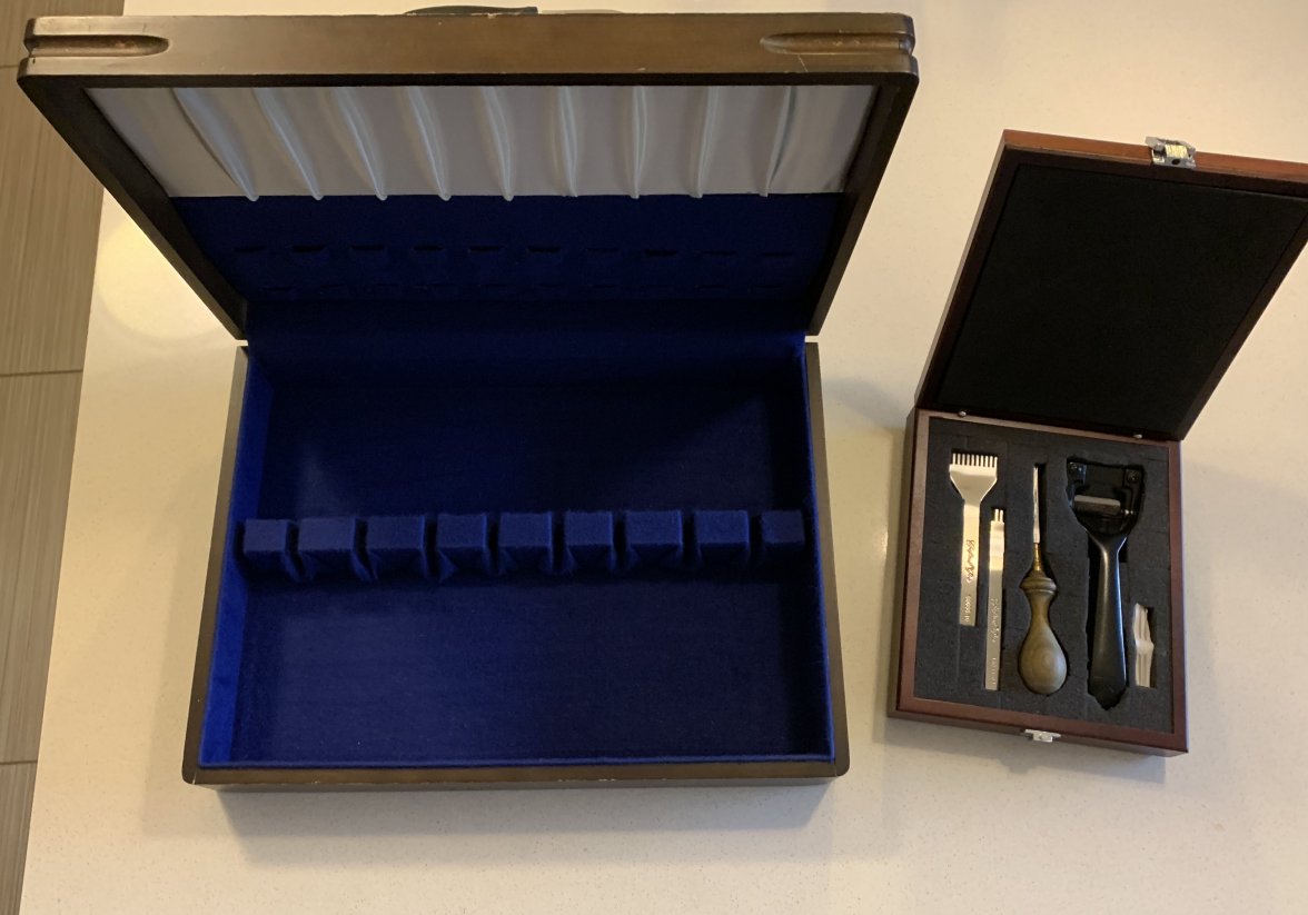

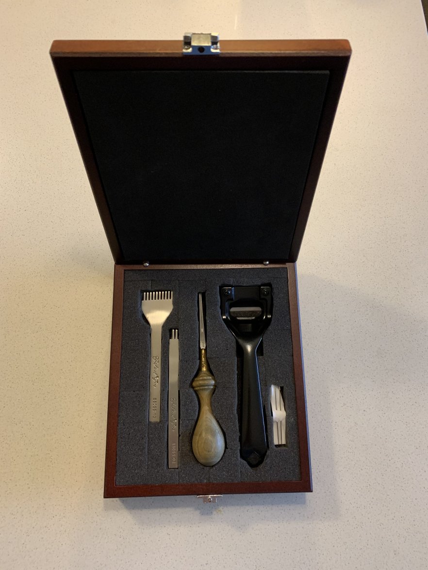

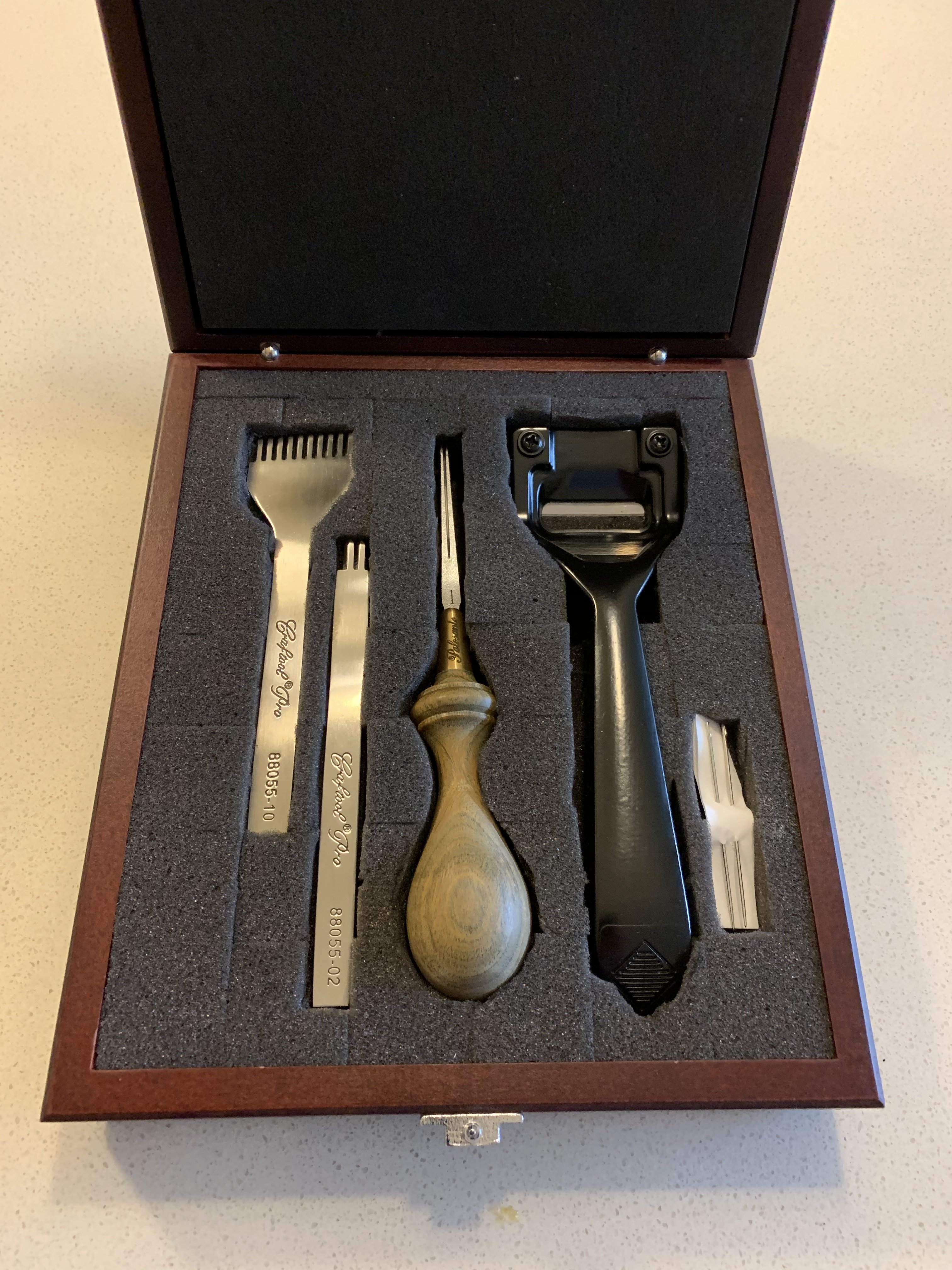

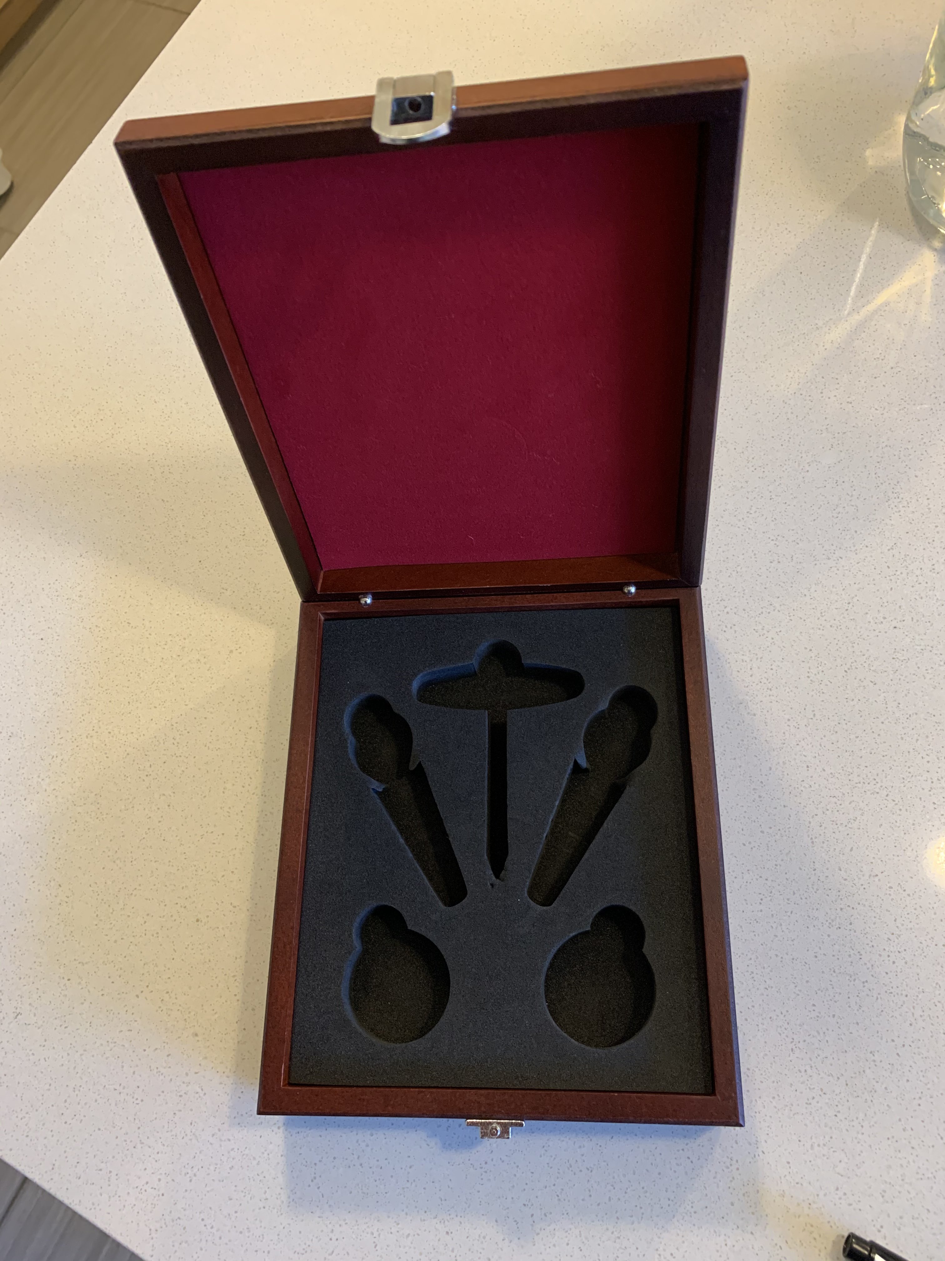

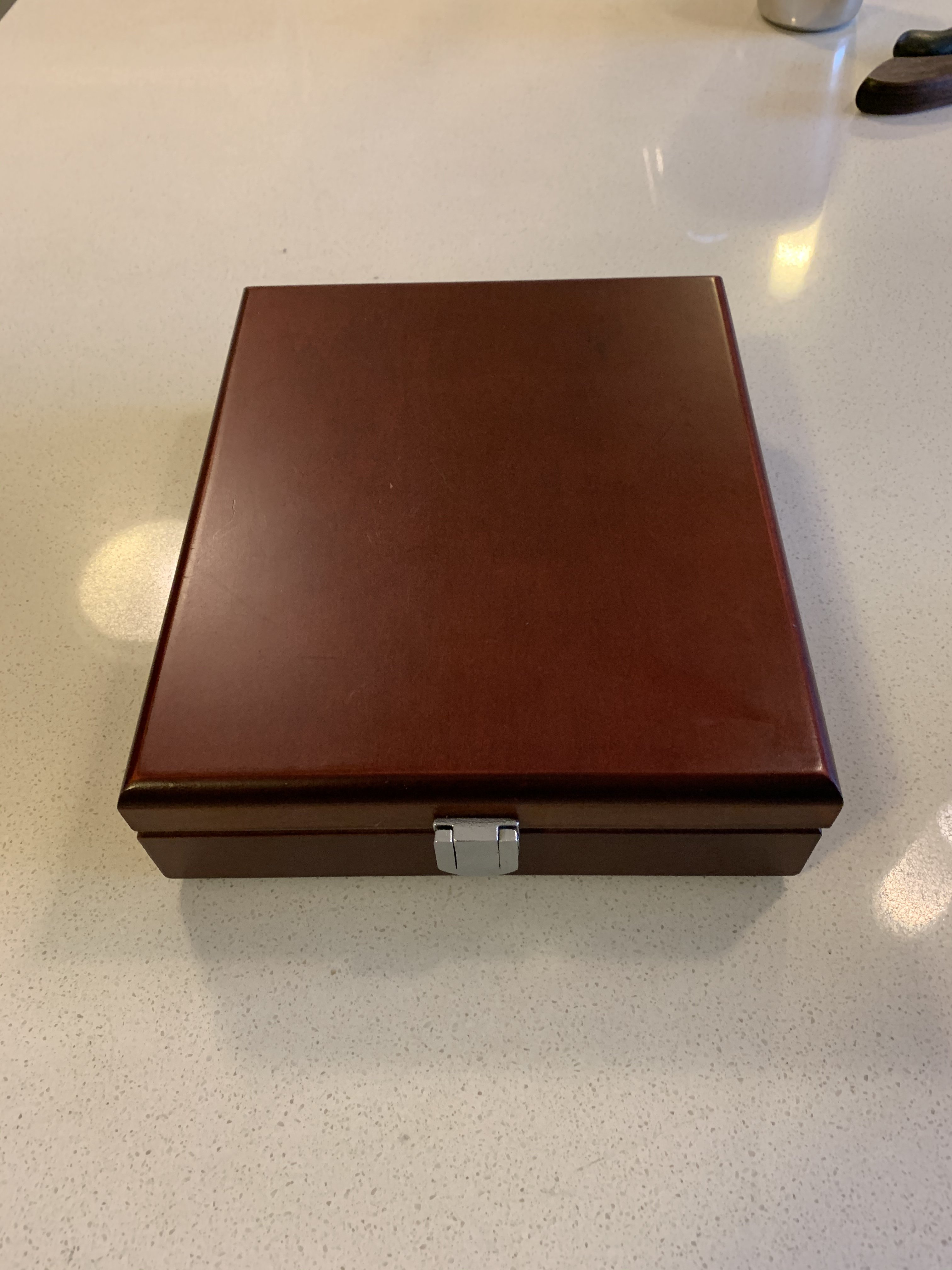

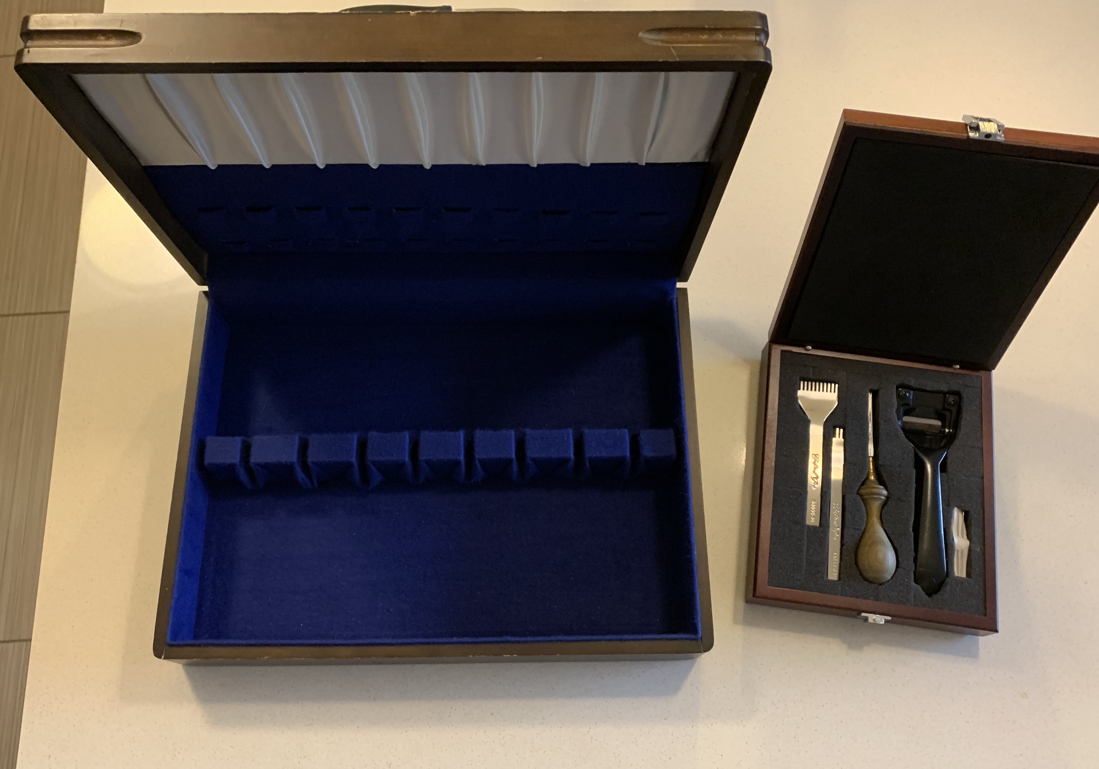

A while back I was at a thrift shop and picked up this nice wood display case for a corkscrew & wine-stopper kit for $3.99. The corkscrew and wine-stoppers were of surprisingly crap quality, and went in the trash. The case though, this is what I was after, and it was easily 10x superior in quality to the contents. And this is weird, who sells a crap product but puts it in a nice box? Anyway, I’m glad they did. I got home and put the case in the freezer for a few weeks, as I do with anything else that I drag home from a thrift shop.
Wait... what 🤨
A bit of backstory. Vancouver is a lovely place, and so many people want to live here. Unfortunately, bed bugs also love it here, in vast numbers. They come for the sunsets, lattes and yoga pants, I suppose. With that, all 2nd-hand acquisitions get the deep freeze, just to be safe. 👍

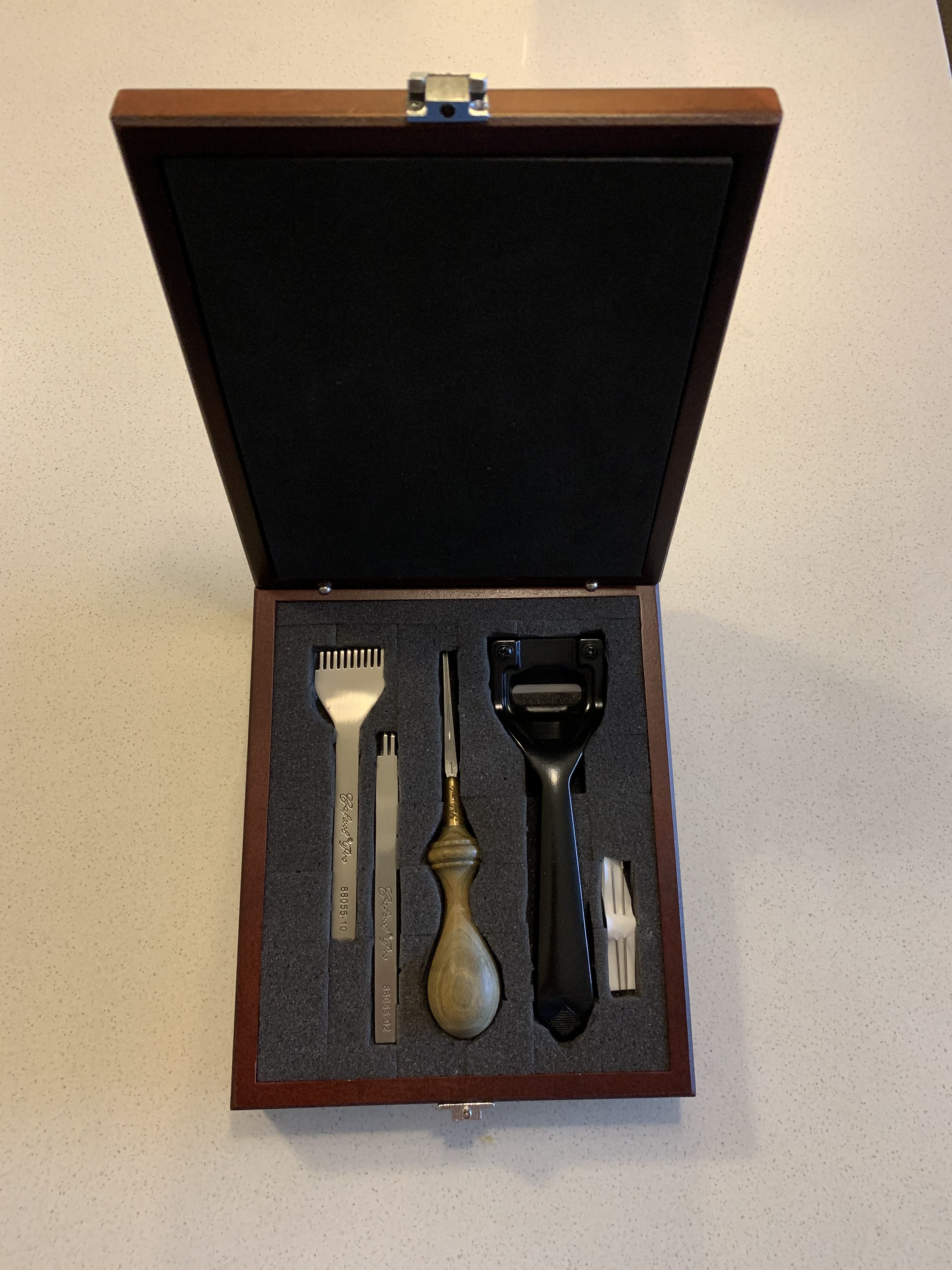

Anywho, with much more spare time on my hands lately, I pulled the case out of the freezer and set to repurposing it to house my small, sharp, and pricey leather working tools. With a bit of time, a razor and some pluck-foam, I was very happy with the results 😀
Before
After
And next, a silverwear box will become home to other bits and tools
