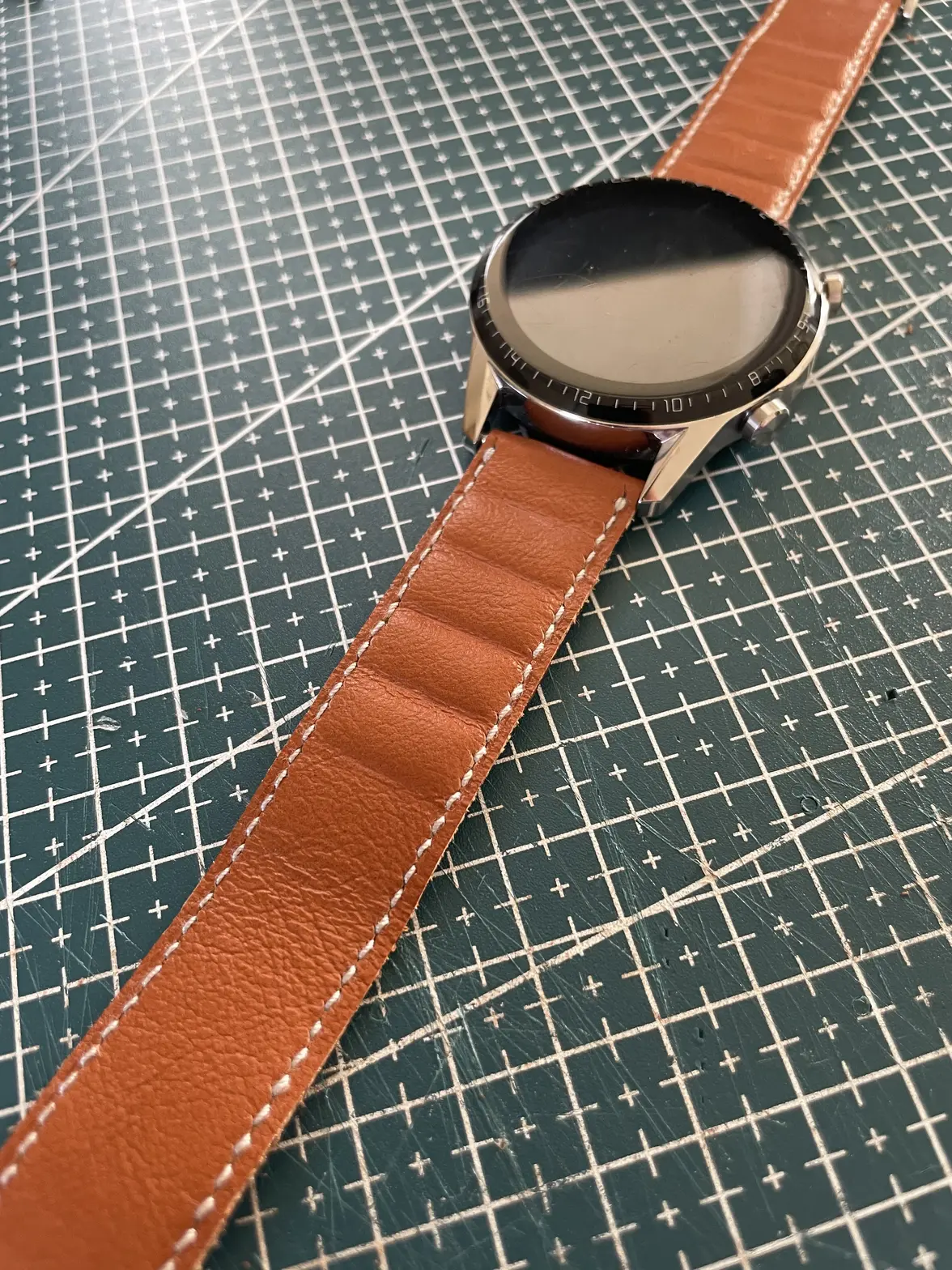

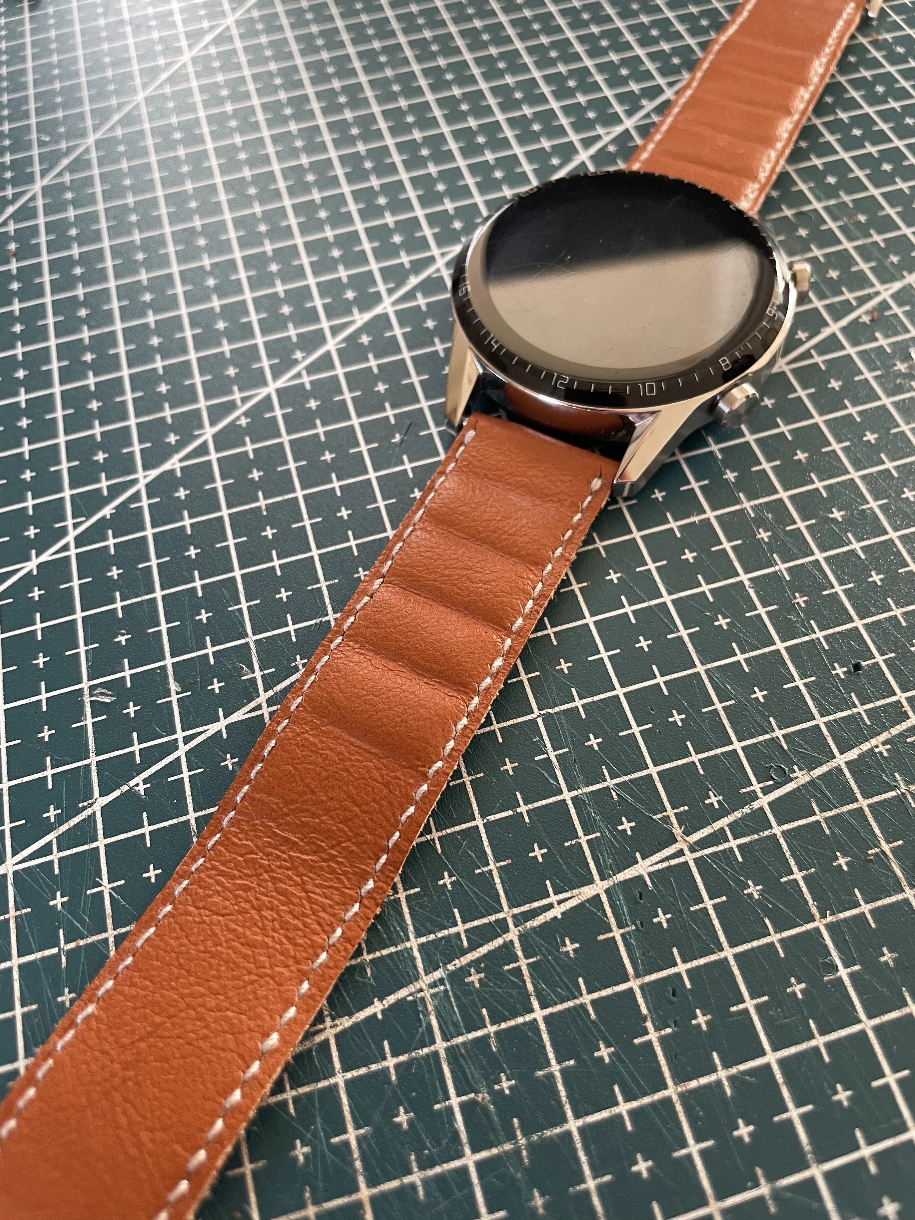

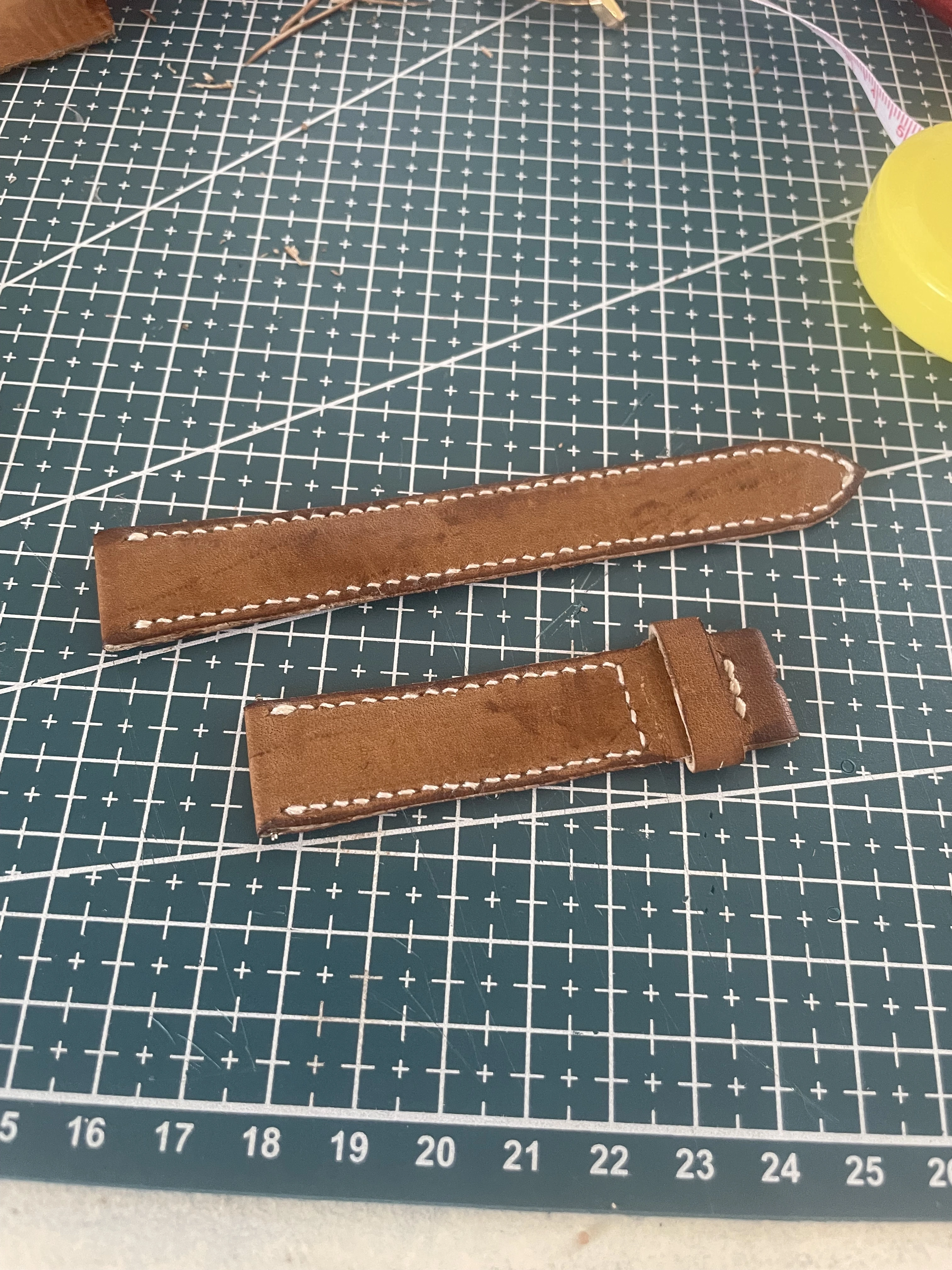

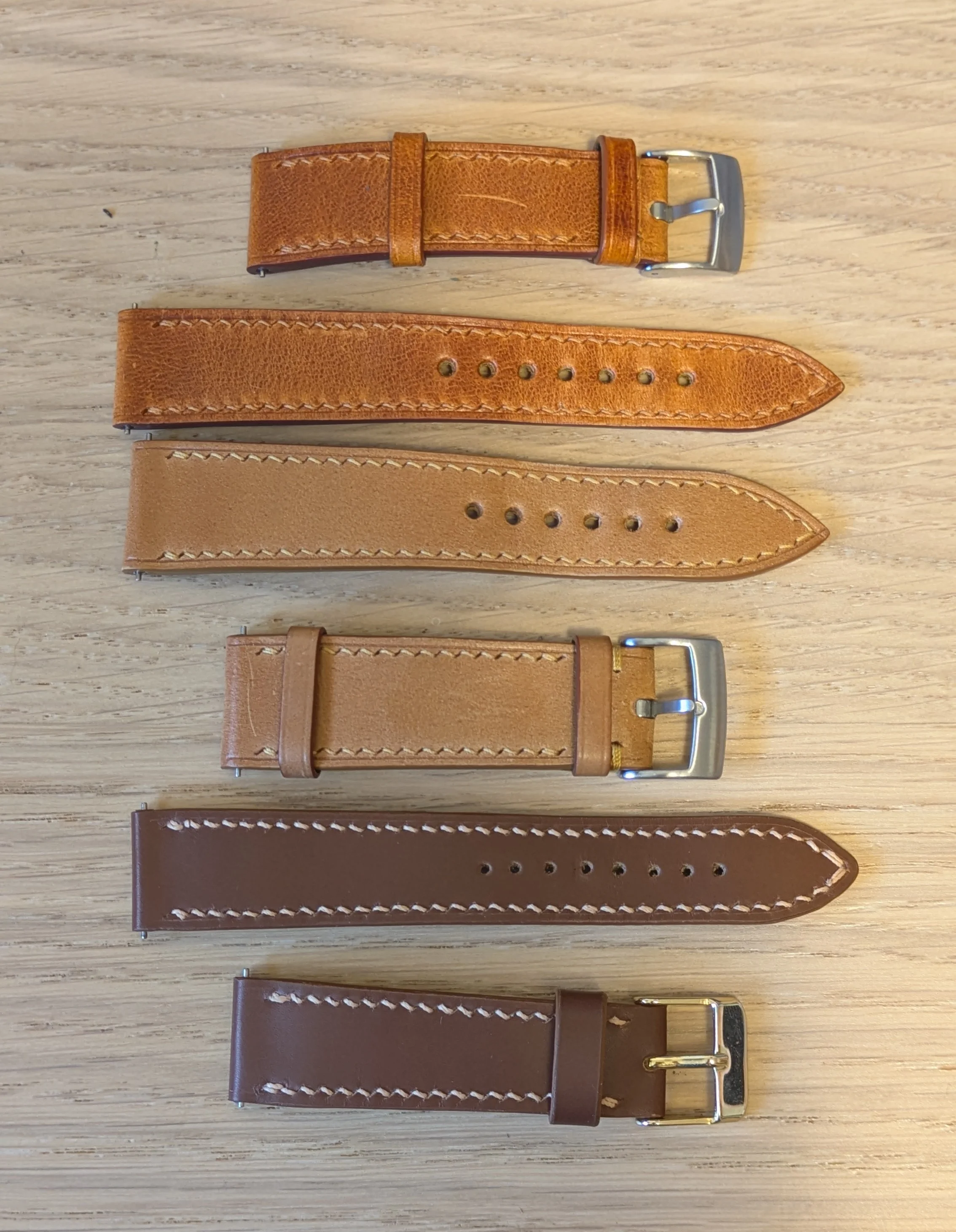

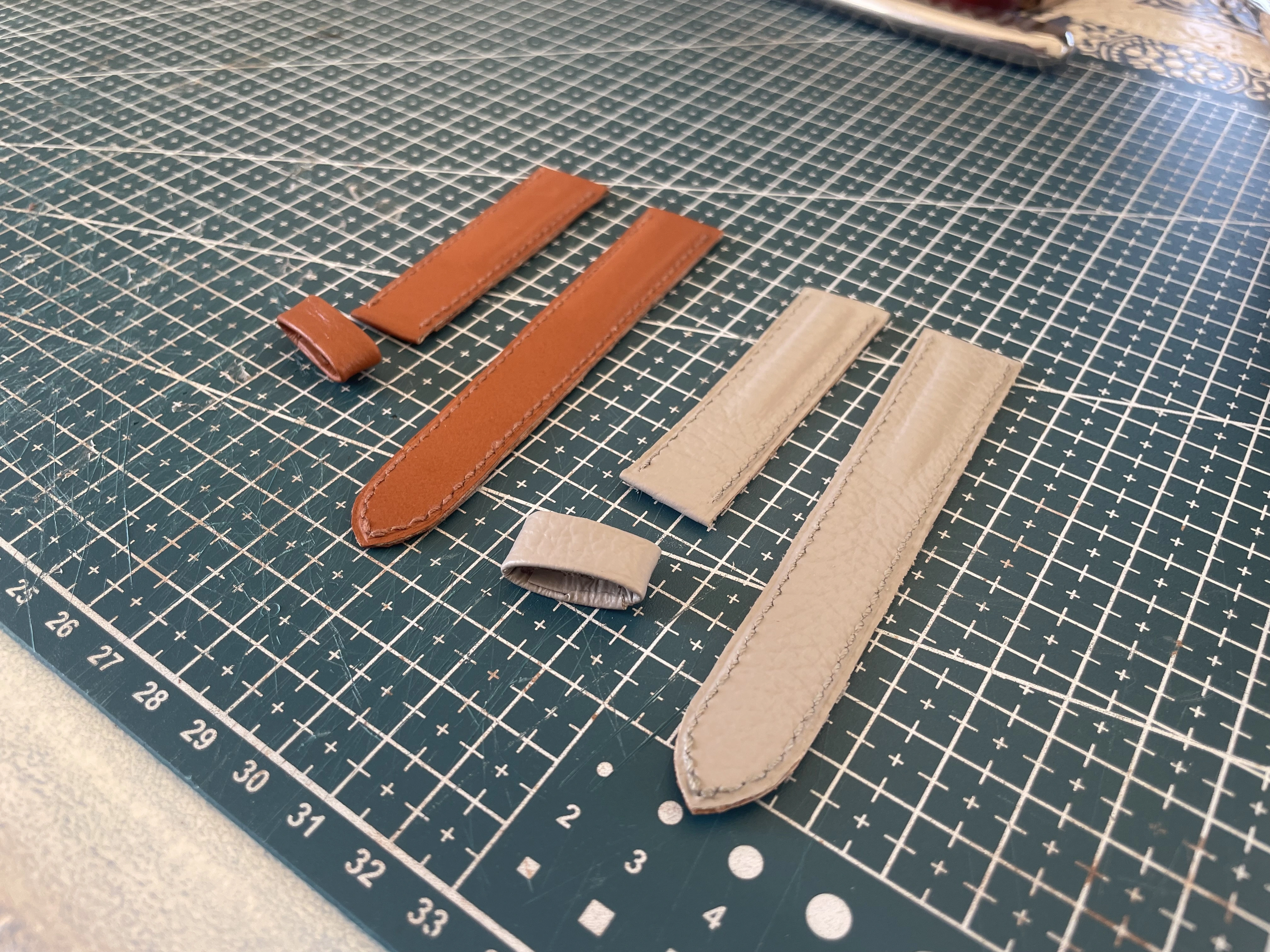

I have to admit that I found inspiration in this thread and started a new hobby after I purchased some cheap tools from Temu.
I really like the part that it is recycled leather from old purses I found in the thrifties.
I have not painted the edges (but not sure if I want to tbh).
If those straps were your first try, you are a natural born strap maker. Exelent work!

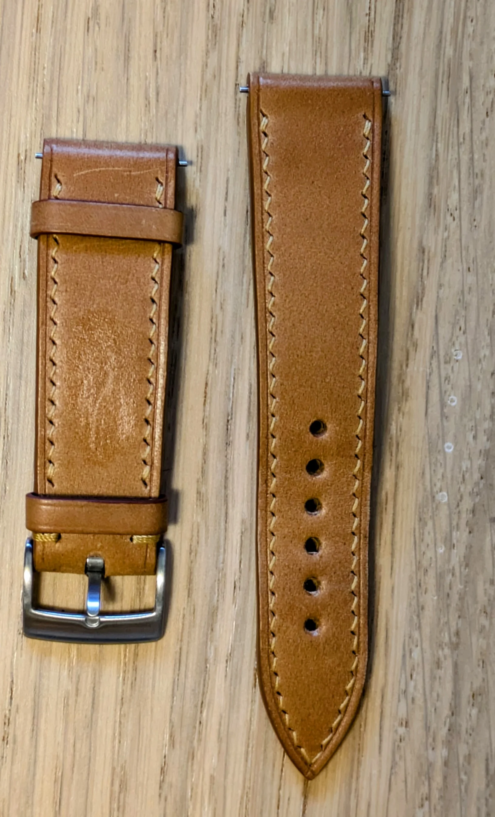

My first, the stiching was all over the place and the holes were of the center line. I have been making knife sheats for 10-15 years.

How long ago did you start because these are quite good for a beginner.
It doesn't look like you've tapped down the stitching, I'd suggest that you do so. Looks better and feels smoother.
Did you make your own padding?
117
61
The strap on the third picture is my very first one (you can see the stitching is a bit off). These straps (plus one I gave to my brother) are the only ones I have made so far.
Thanks for the advice - I have not tapped down the stitching (actually wasn’t aware it was desirable).
I do make the padding myself using other pieces of leather.
I have not invested in the best quality materials (have not used velodone yet). But once I advance my skills a bit further, may buy some better materials.
Do you guys think that painting the edges makes them more durable or is it just more pleasant for the eye?
I was also thinking about discolouring the leather with some rubbing alcohol to achieve some interesting effect. Has anyone tried that?

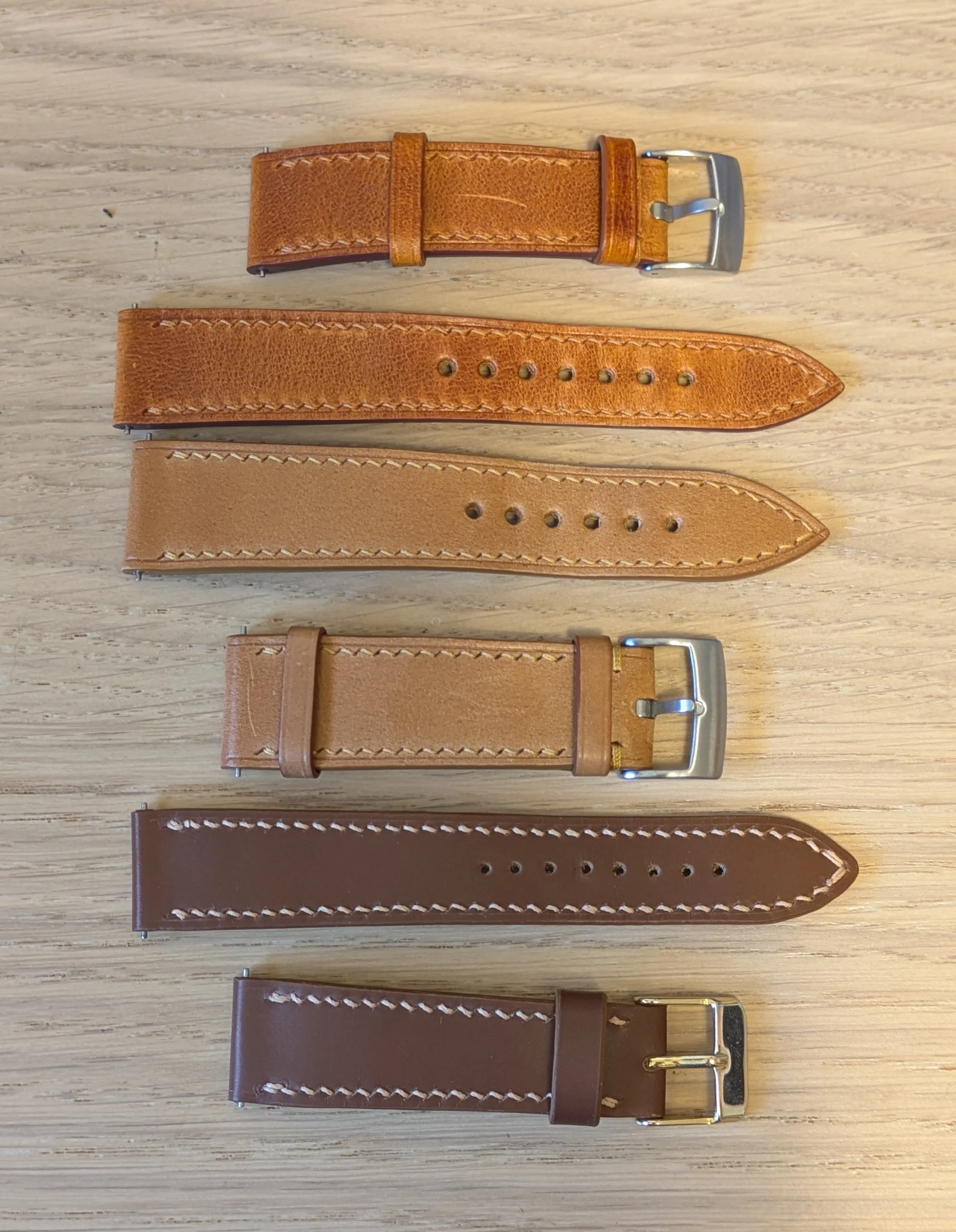

What size of the thread you are using for 18mm straps? I think the thread I have is around 0.6mm, but was wondering if bigger would not look better. I am trying to do the stitching 1.5mm from the edge.

I’m doing my stitching line the same, at 1.5mm from the edge.
I’ve used 0.6mm Julius Koch Tiger thread, it looks way too thick on 18mm dress straps. I’m using RMLS’s Masterfil/Twistmade.com branded 0.45mm waxed linen thread with holes marked by pricking irons spaced 2.7mm apart.
I recently bought some 0.35mm thread sold by Since because I have some straps from Tuns Store that look awesome with really thin thread. I have a set of 3.38mm pricking irons on order to help make the thread look even thinner. Will see if that was the right call.

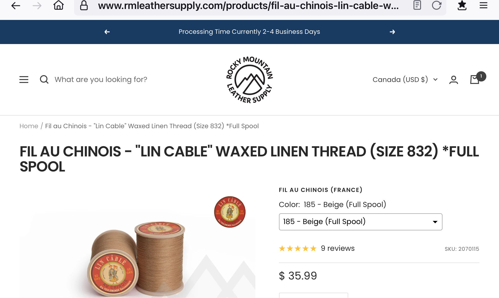

I also just received more Fil au Chinois #832 (0.43mm) linen thread because it looks thinner than RMLS’s Masterfil 0.45mm thickness. I’m pretty sure the latter is made by MeiSi by the way. The FaC is much harder to stitch with though for me as it’s more fragile than the MeiSi thread. It’s expensive too!

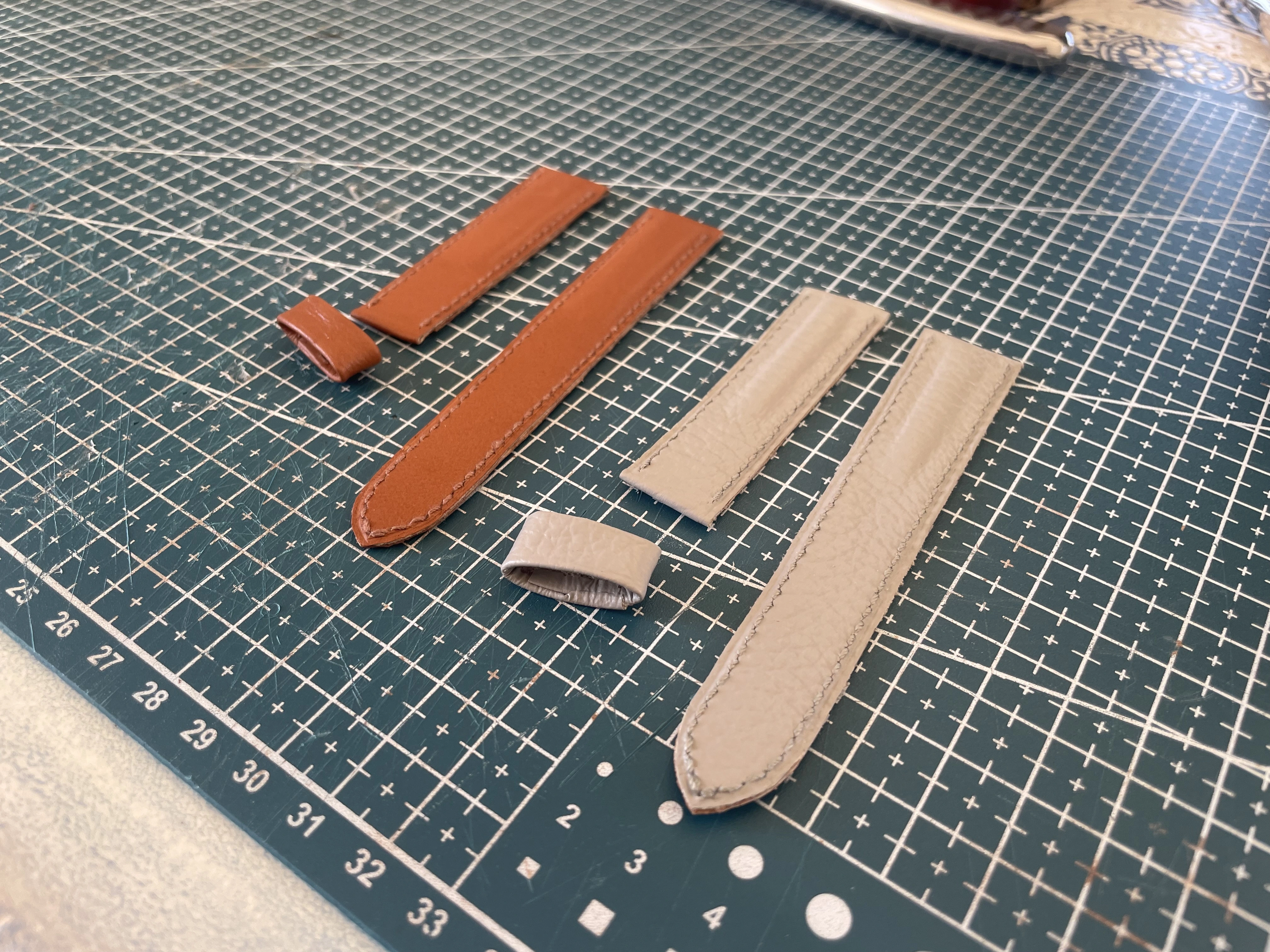

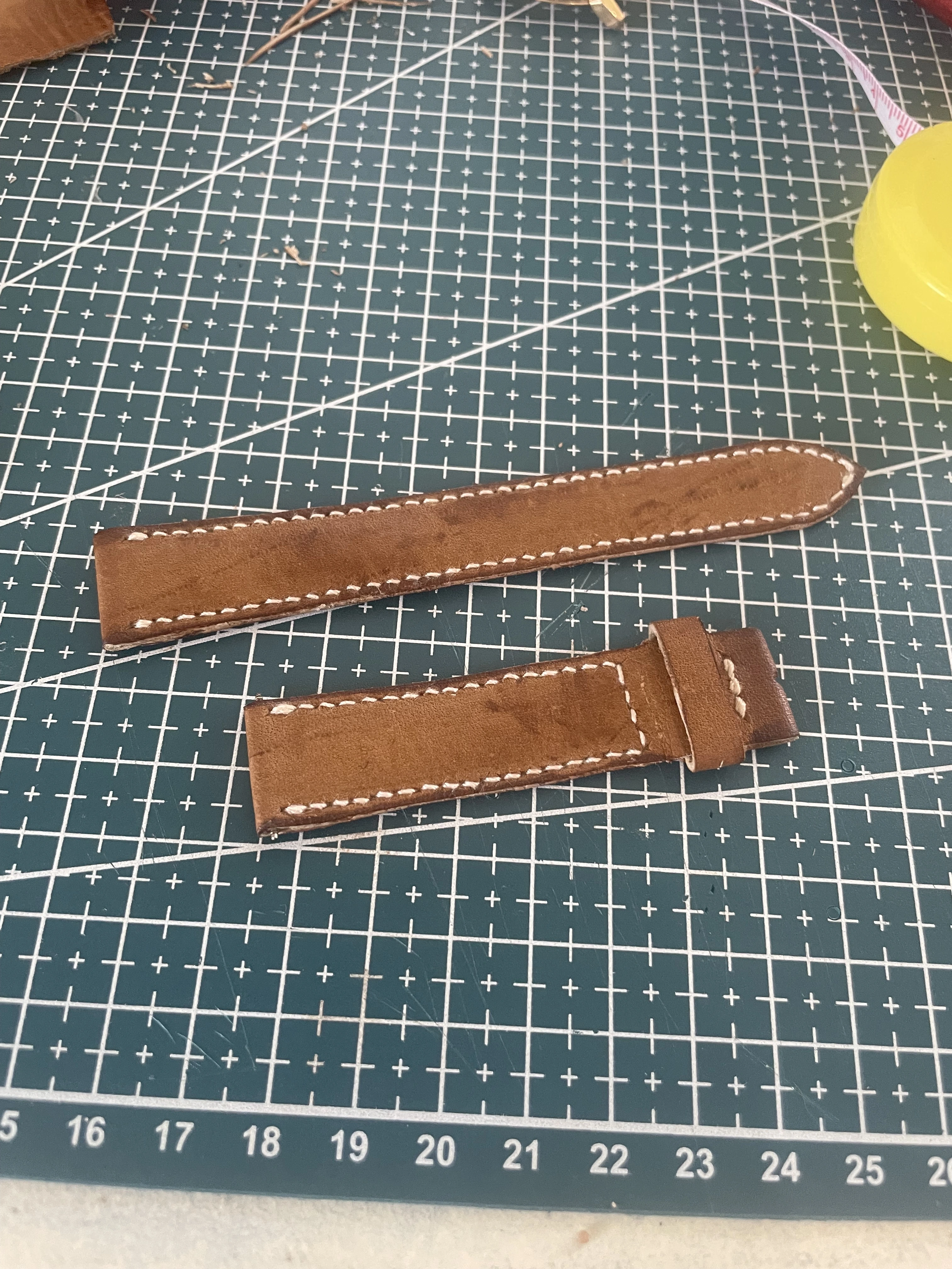

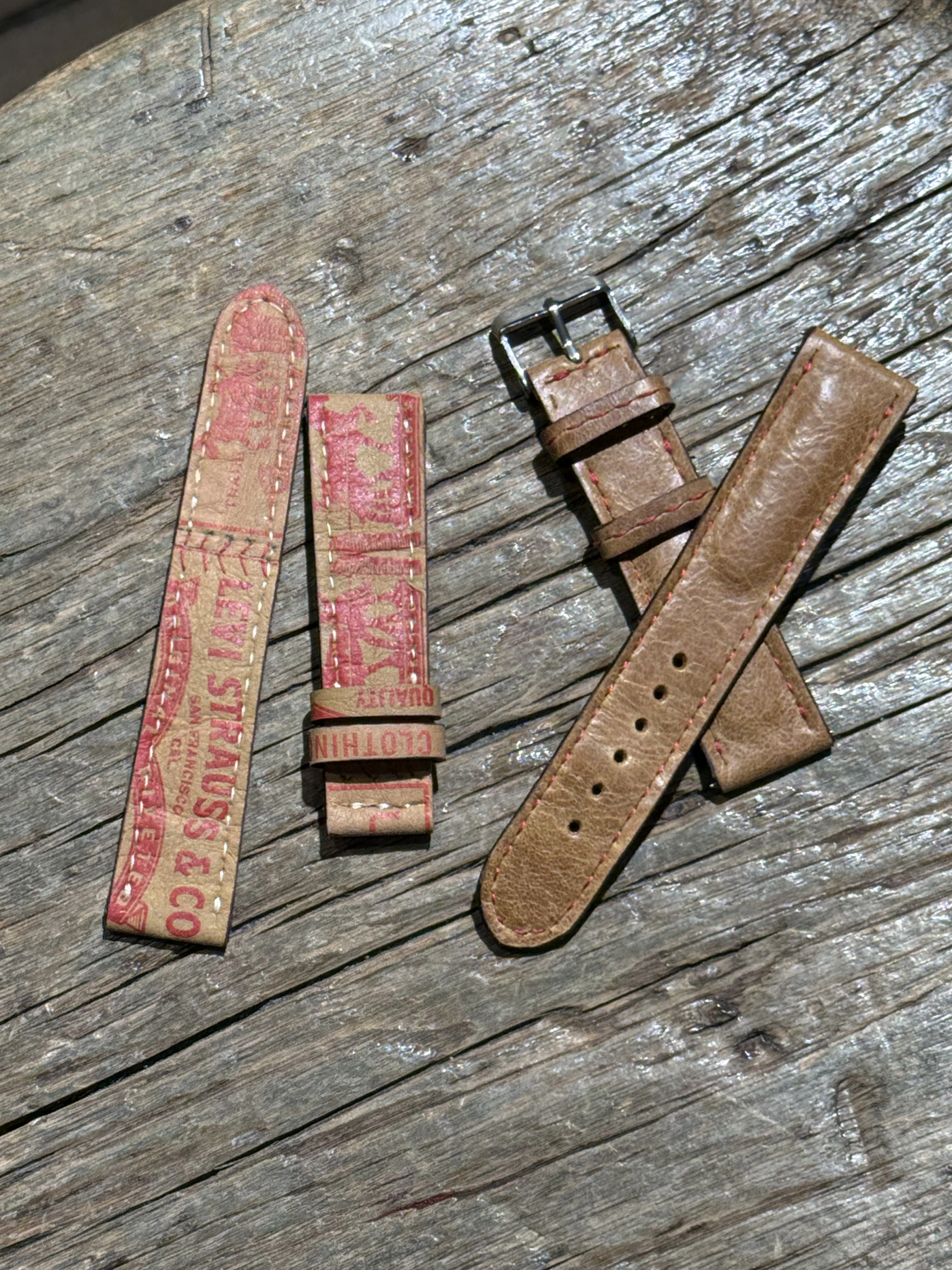

No problem. The tan colour Tuns straps shows a thin thread, very like 0.35mm. I really like the look.
Here it is in the middle with another Tuns straps to the left and my straps with 0.45mm thread to the right. The Tuns holes have a nicer shape to them too, very rectangular compared to the holes I make with my RMLS branded 2.7mm ones which are more oval in shape.

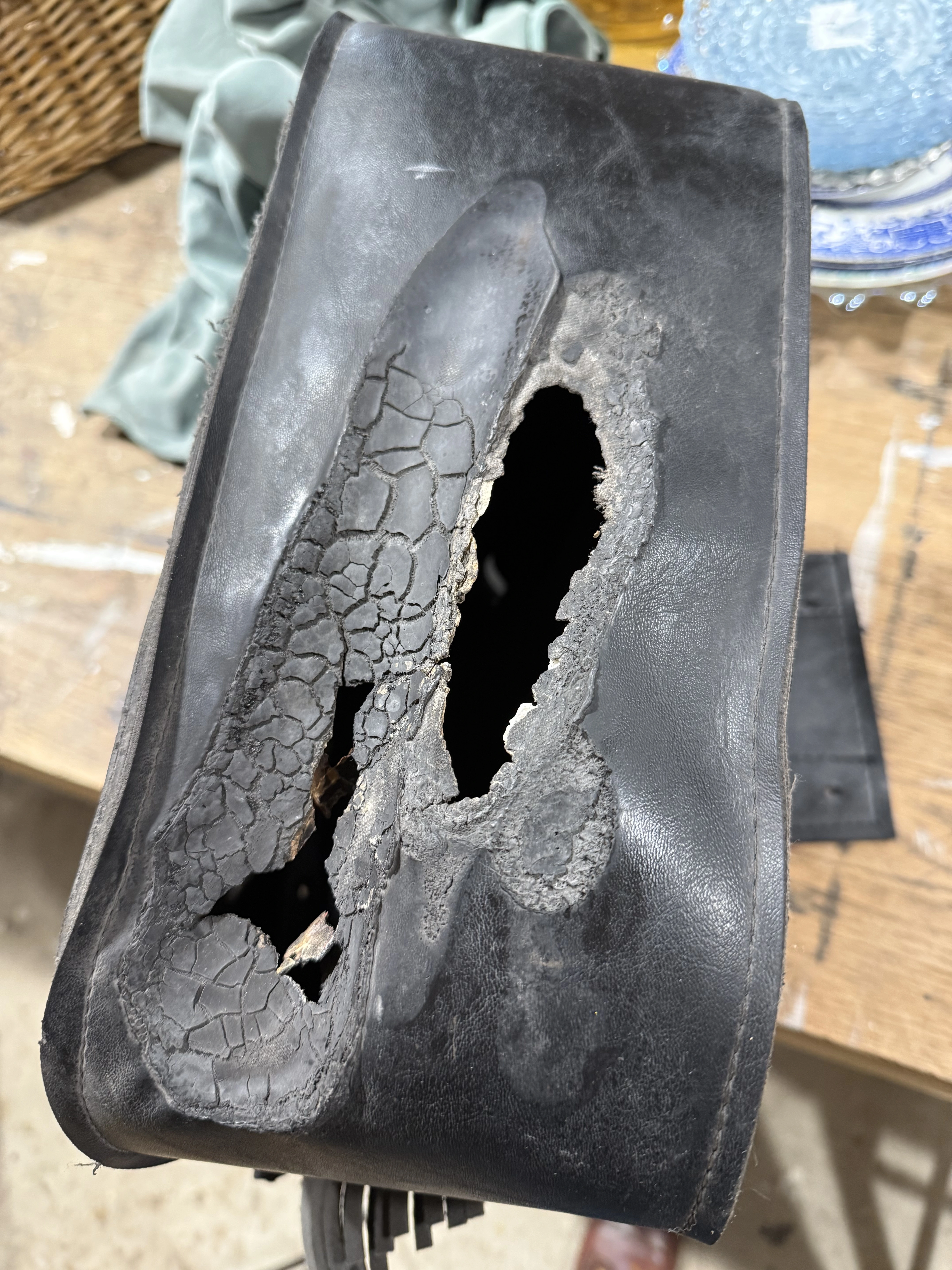

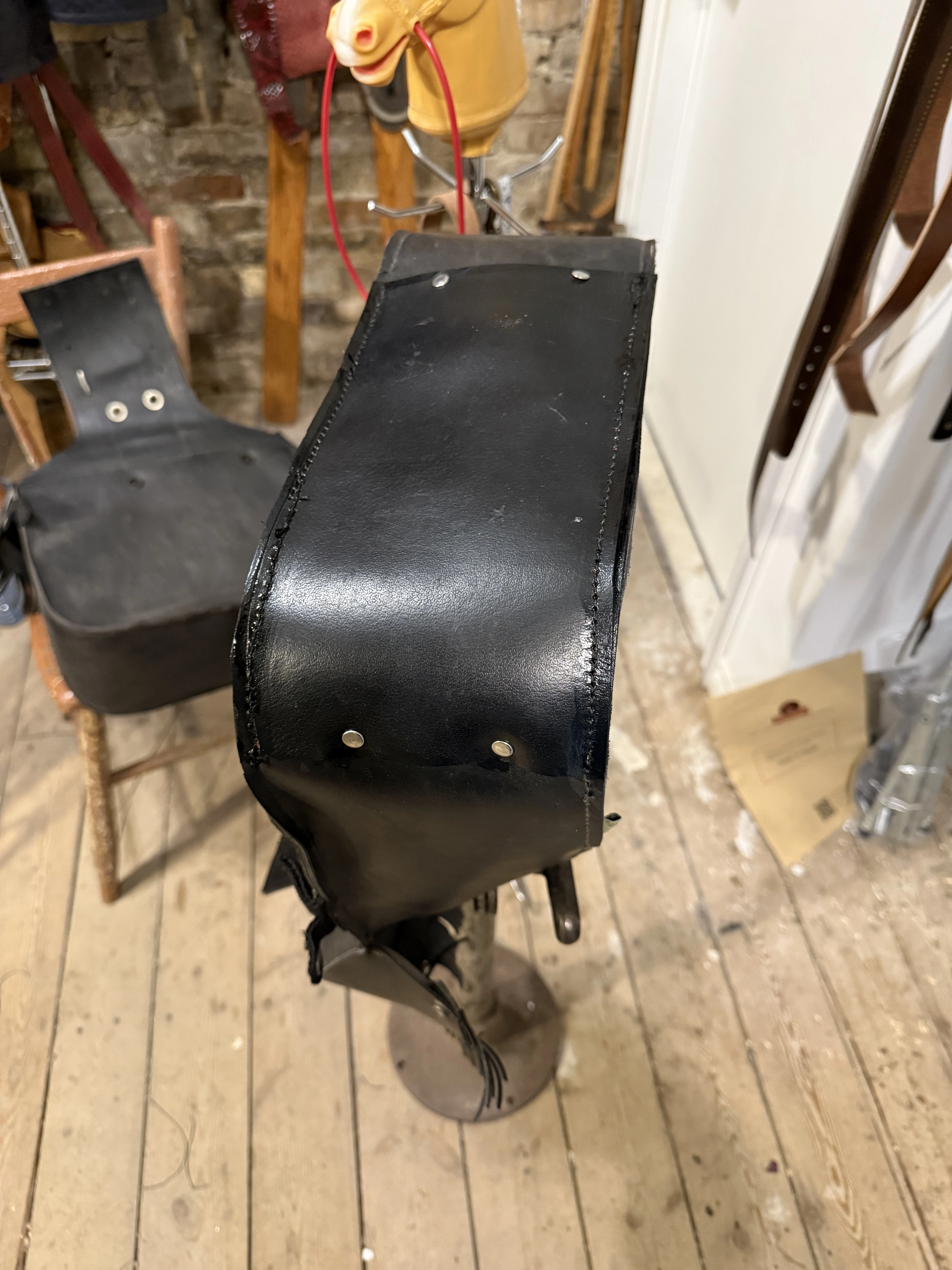

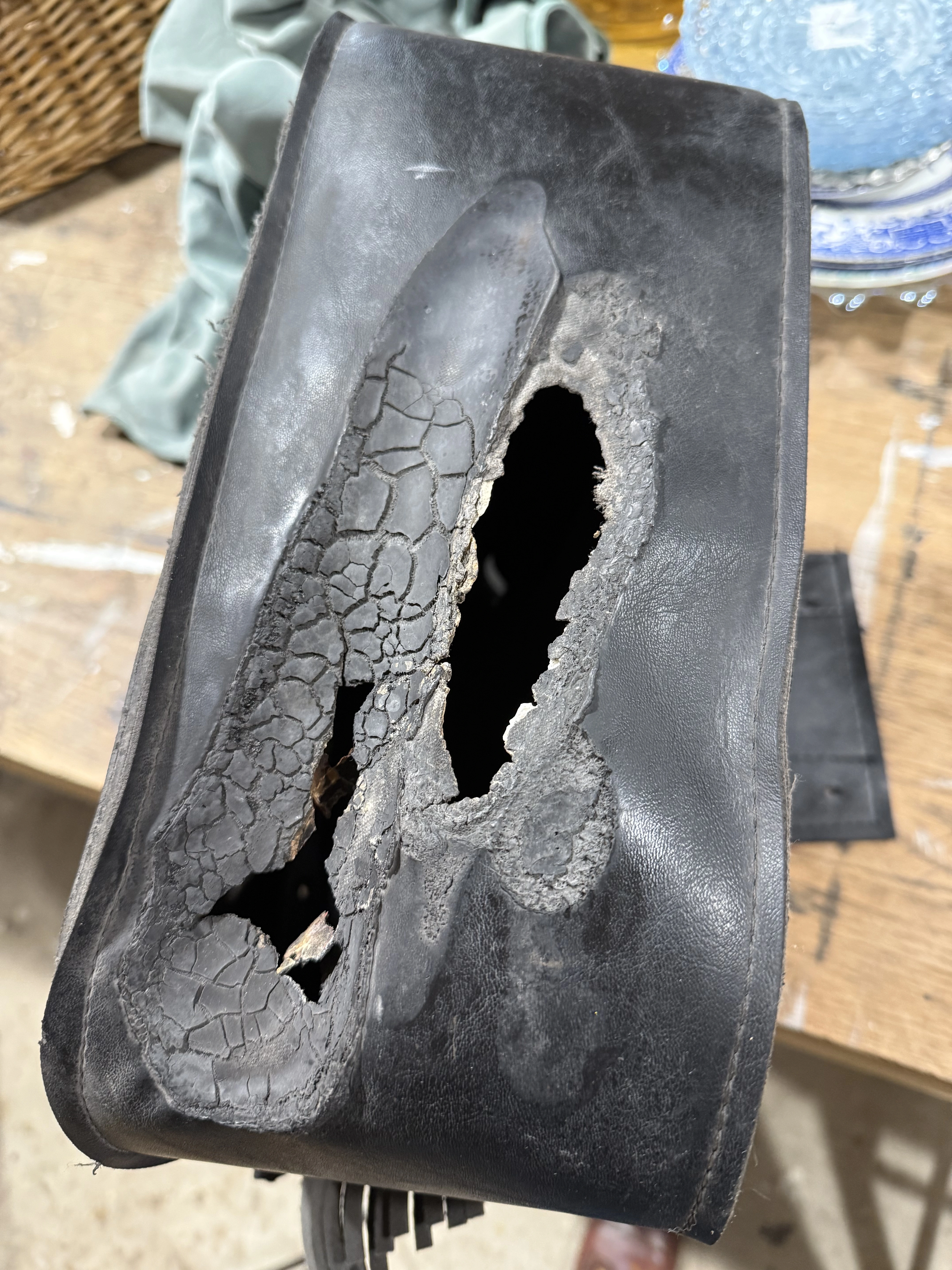

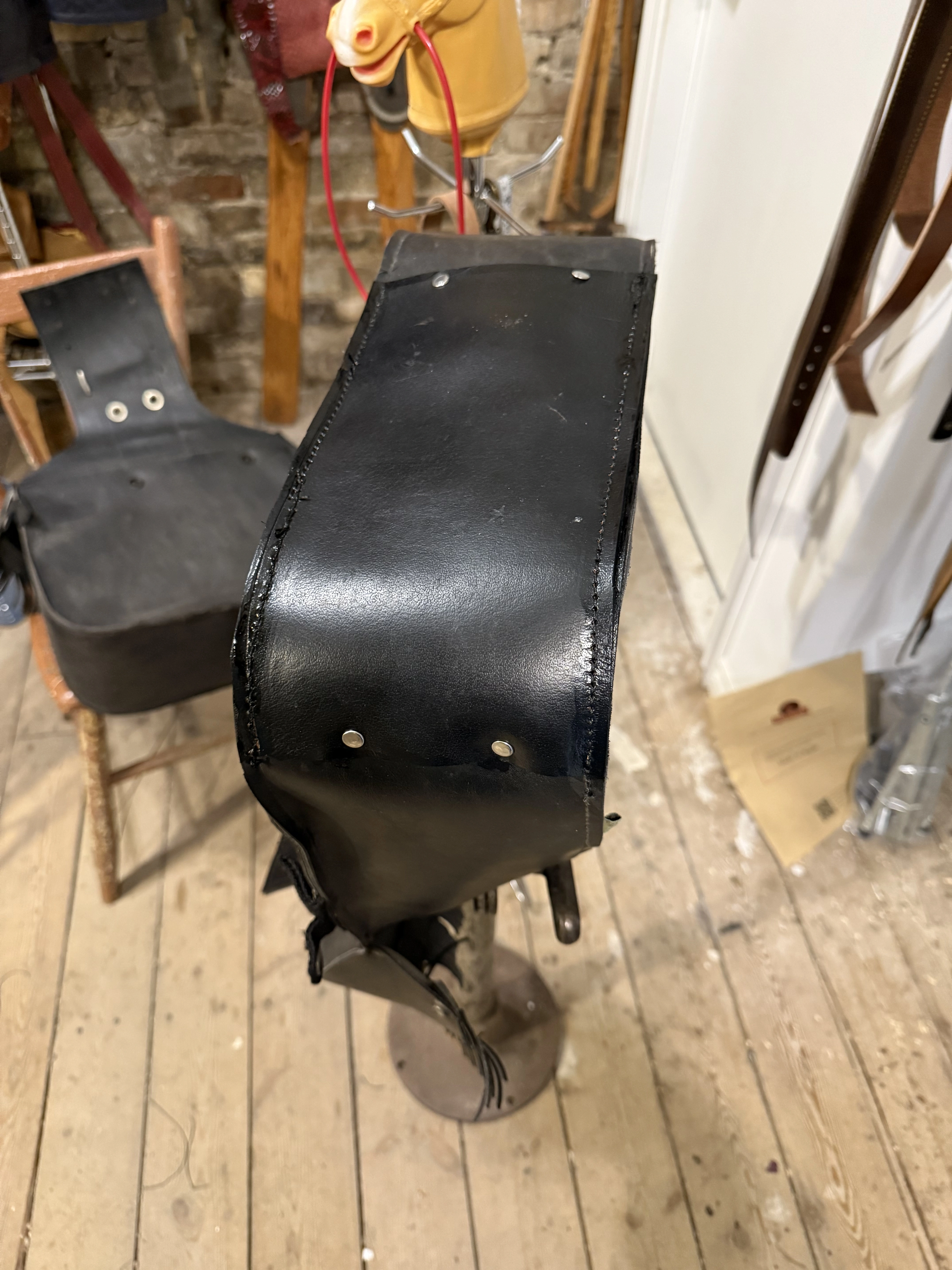

I was repairing some motorcycle saddle bags this morning.
Before…
And after…

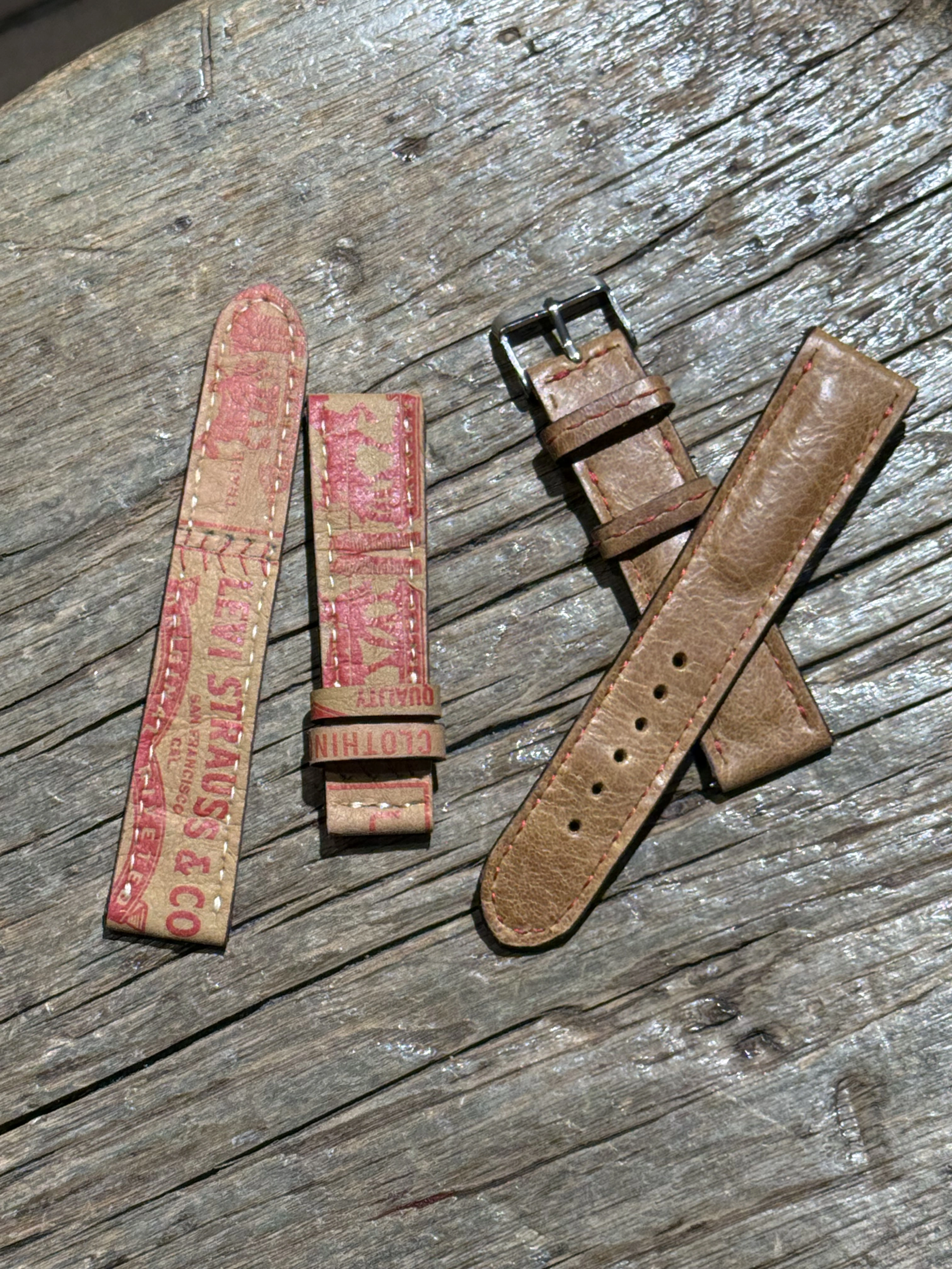

I still make the occasional strap. The one on the right is for a customer’s Ernst Benz GMT watch. And the Levi’s, well, just because I can. On display in my shop.
Before…
And after…
Love the Levi’s strap! The saddle bag transformation is quite stunning.
I hope I can do stuff like that when I grow up😀

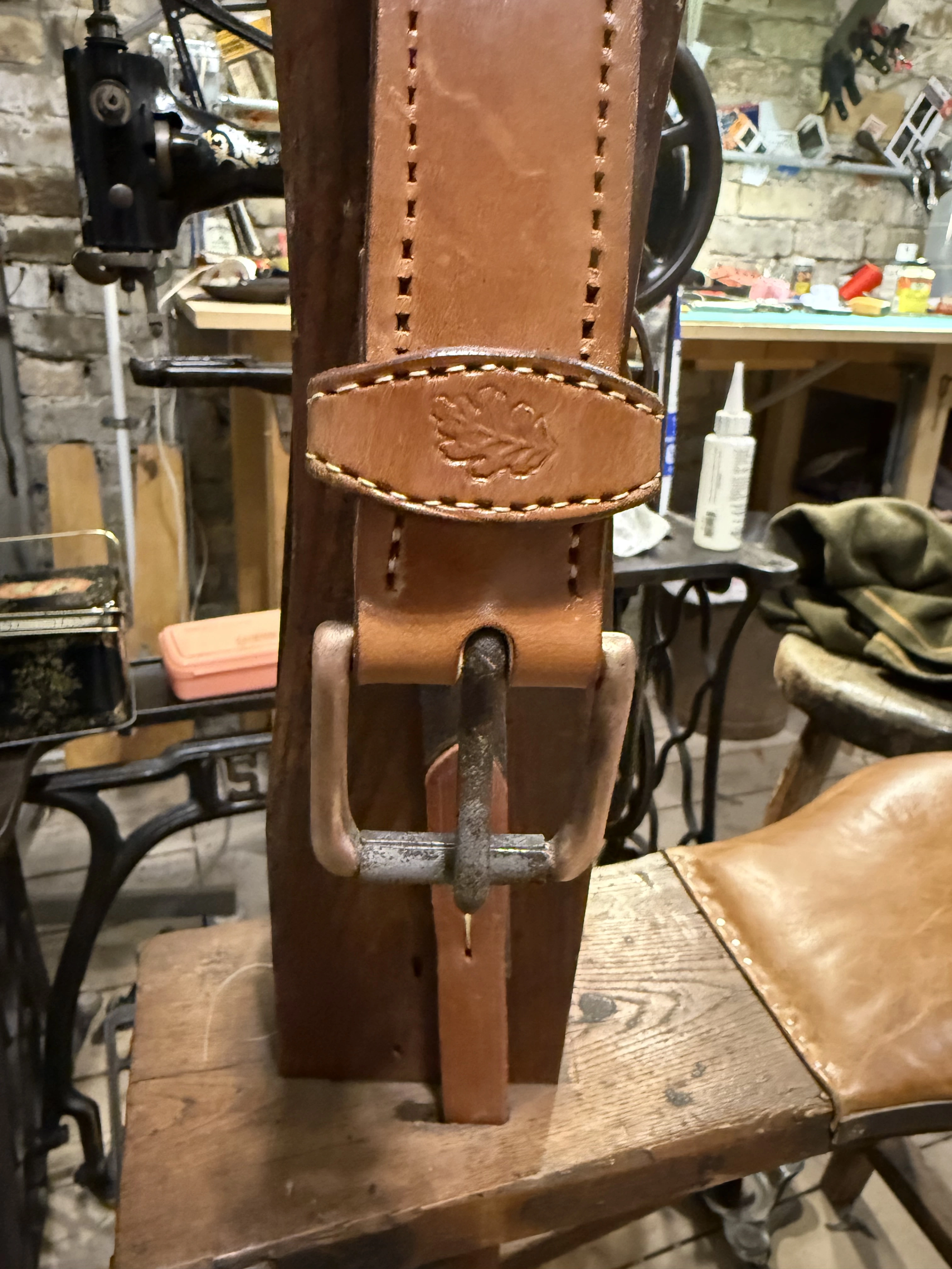

Syrte. You were missed by two of the nicest fellows in Dan and Larry.

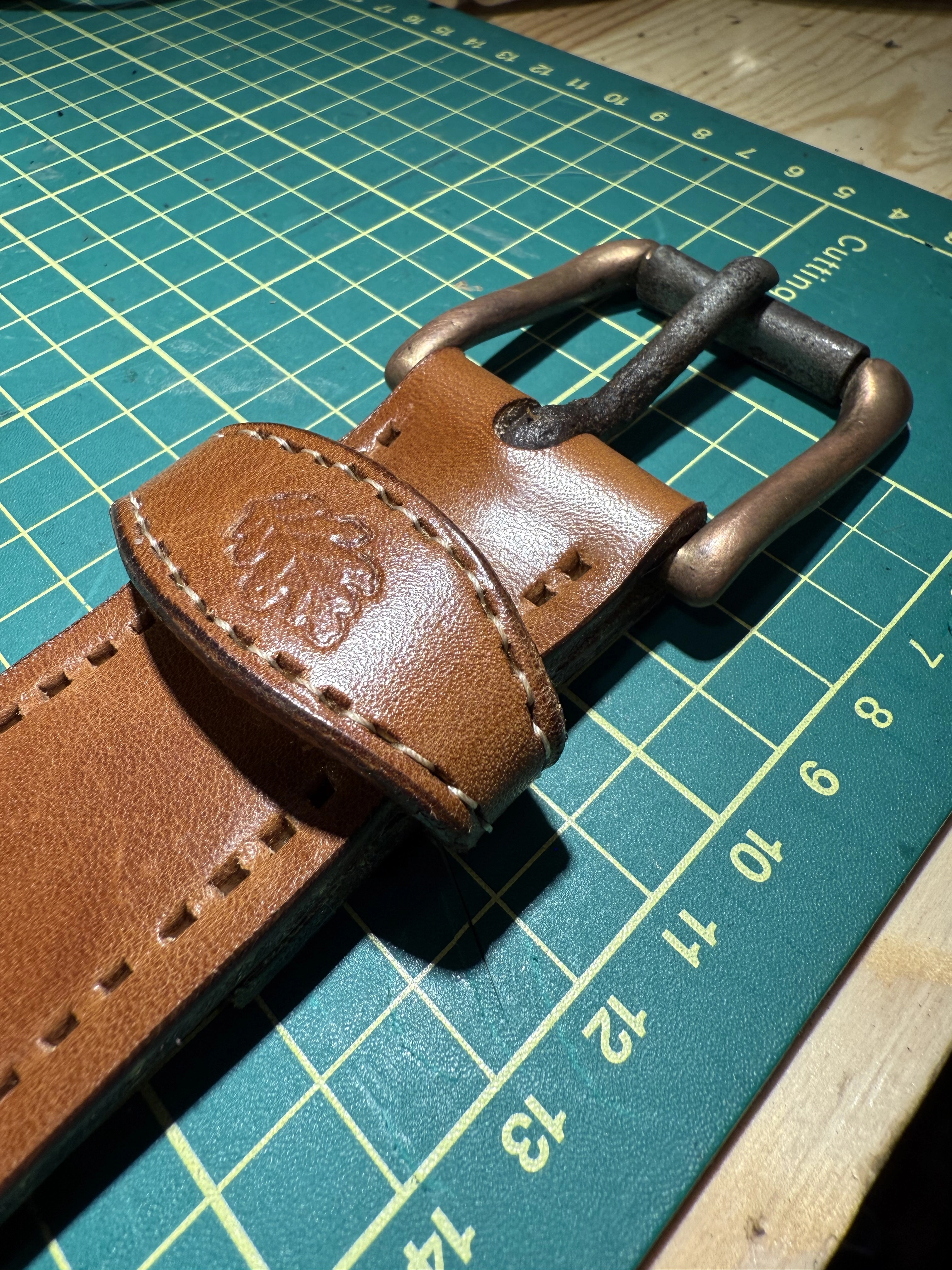

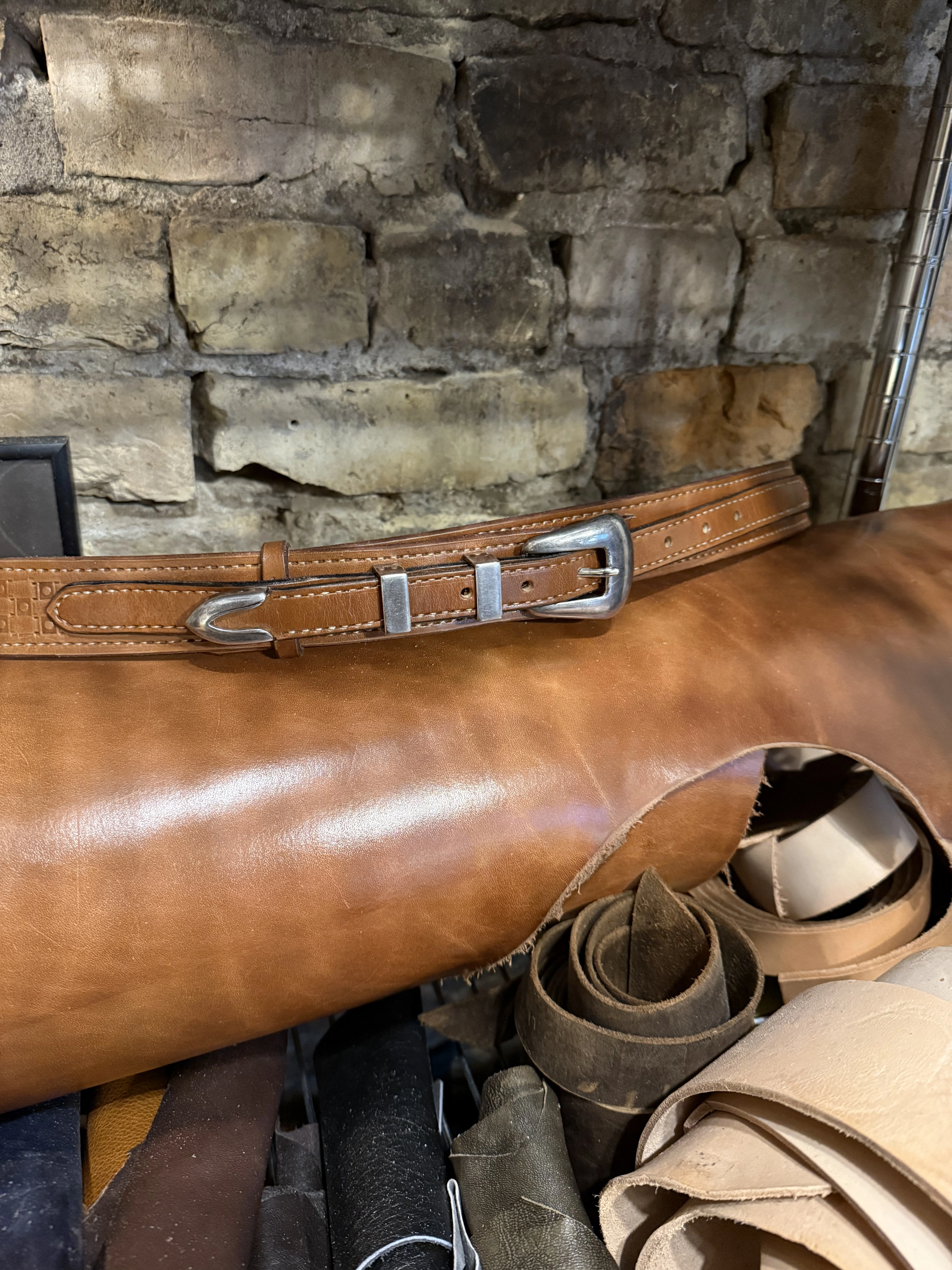

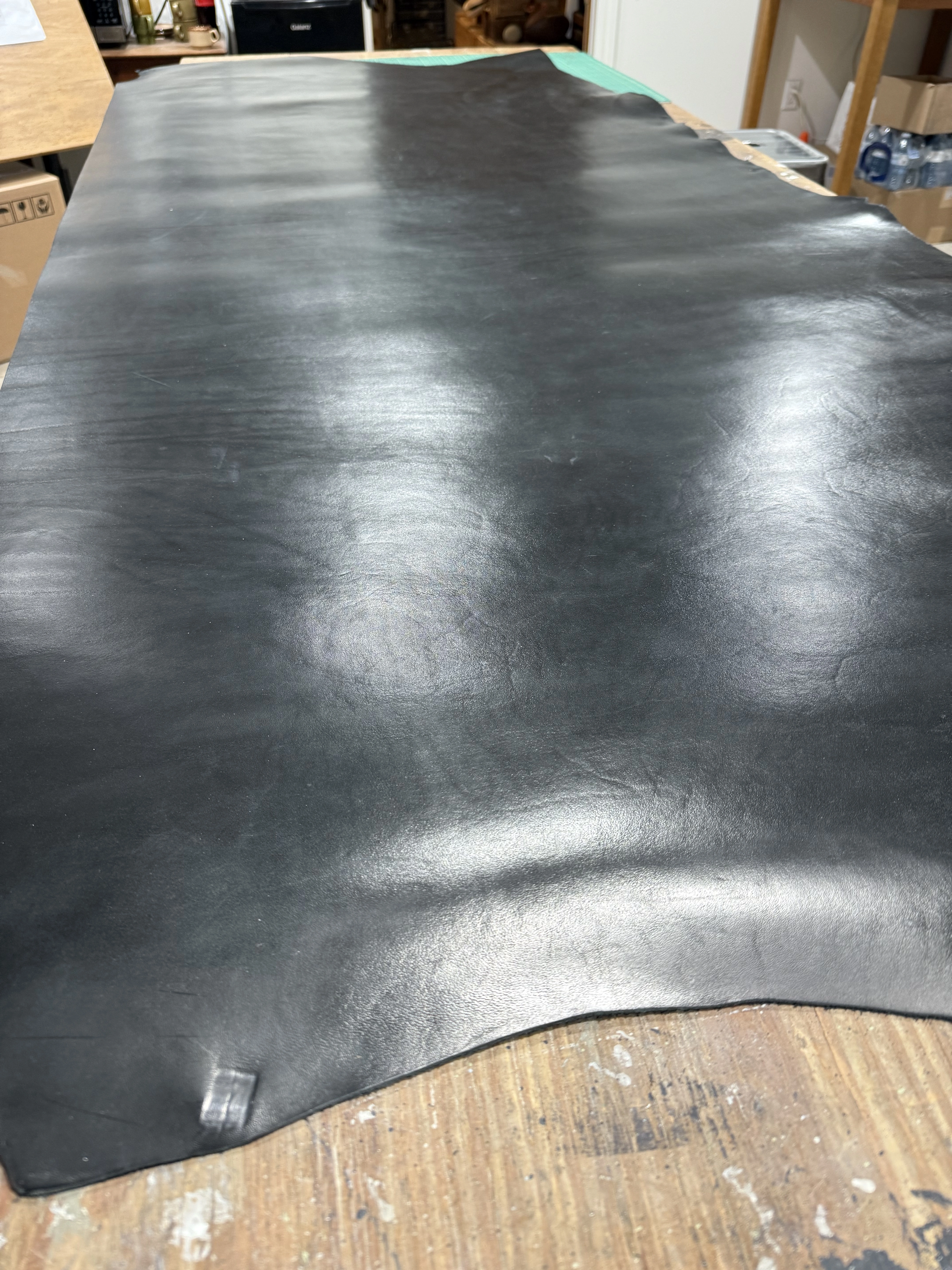

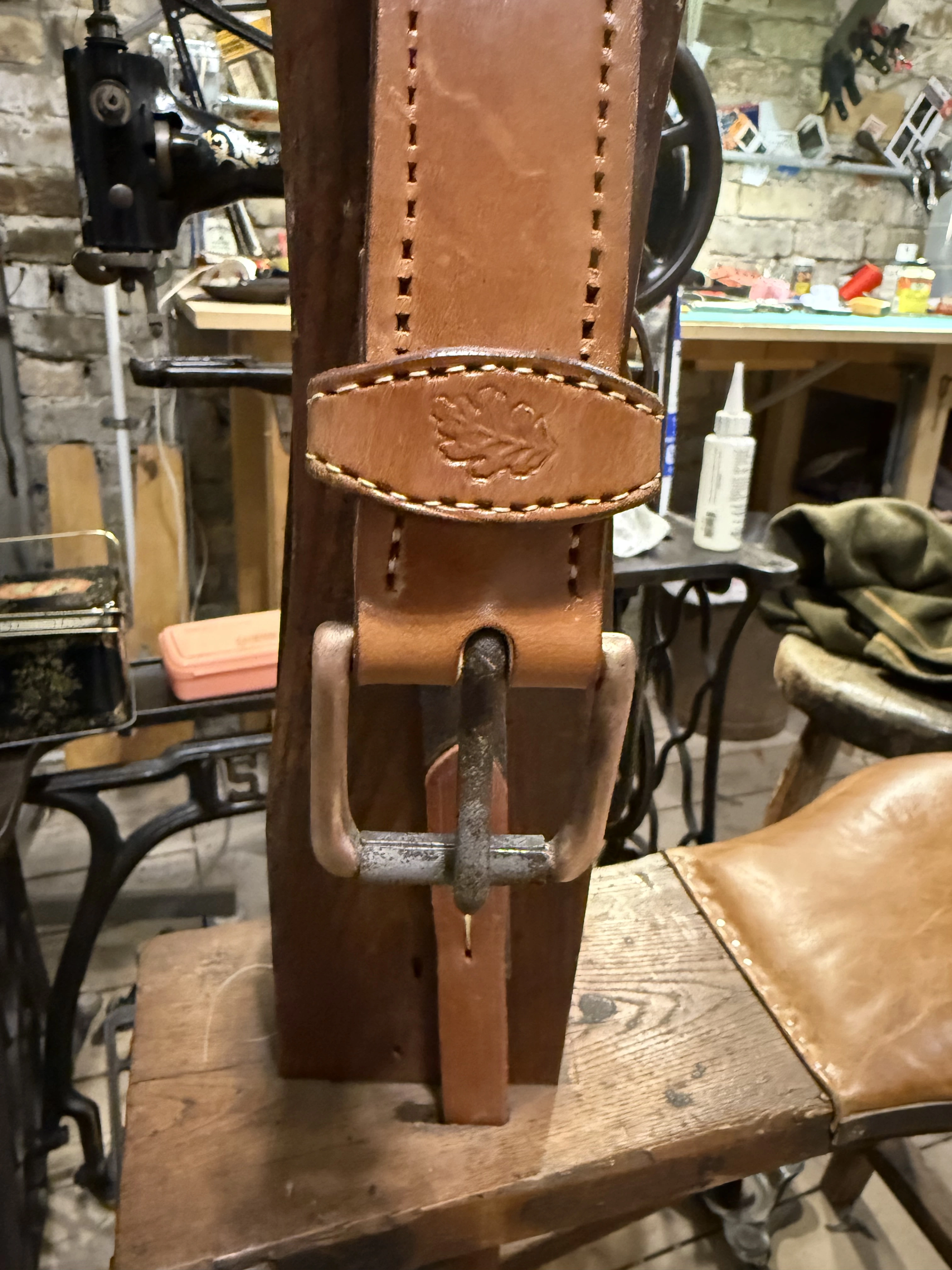

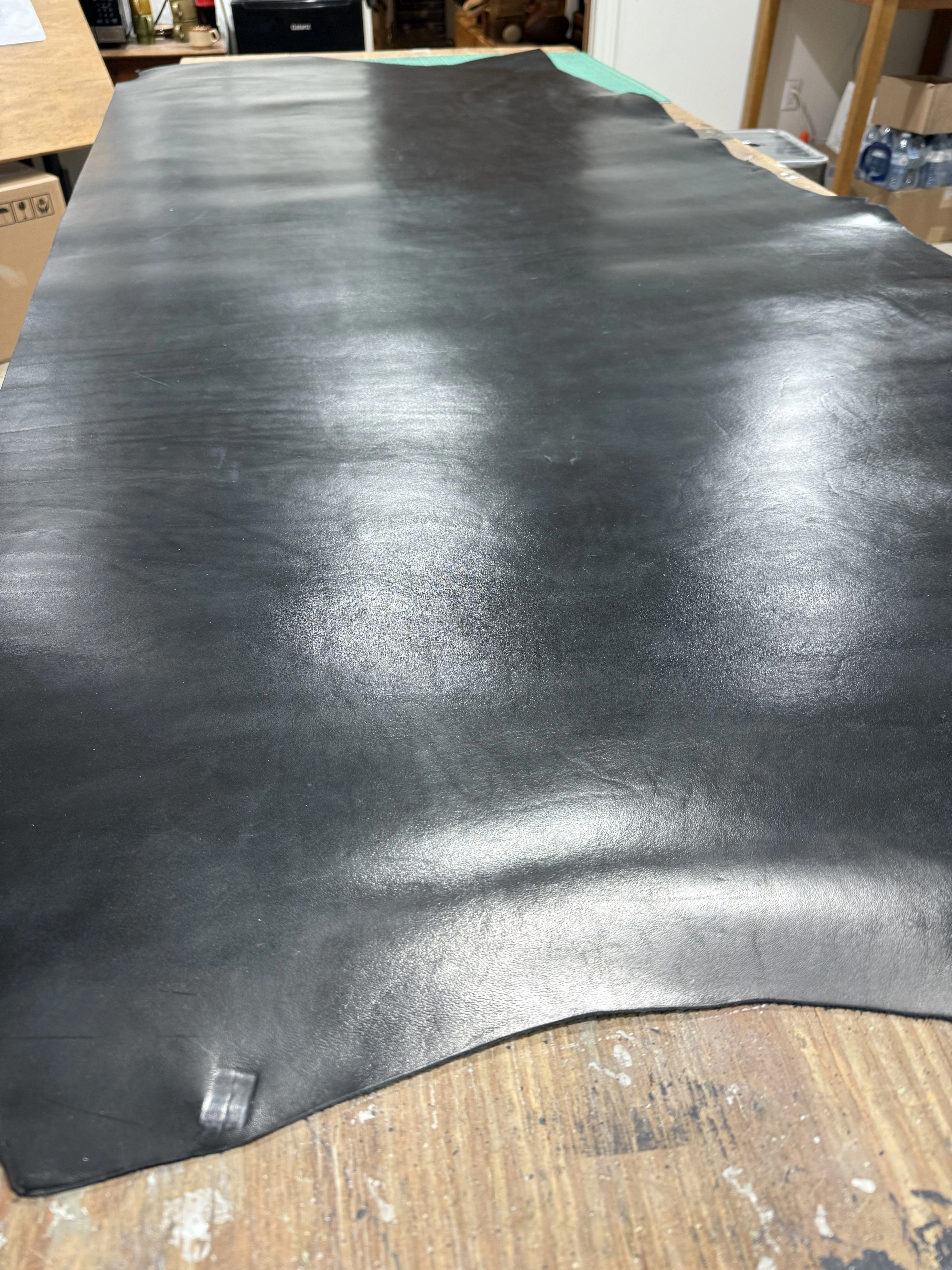

Since you kind of own this thread, here is today’s project and a giant piece of leather that came in yesterday.
I pre-punched the holes and will hand stitch this belt.

Thank you dear Steve, agree on Dan and Larry being such fine representatives of this forum!
Such an honor to be dubbed a part owner of this thread, we’re all just admirers of your craft!
442
2,082
I’m sure there’s some history to that buckle Steve.

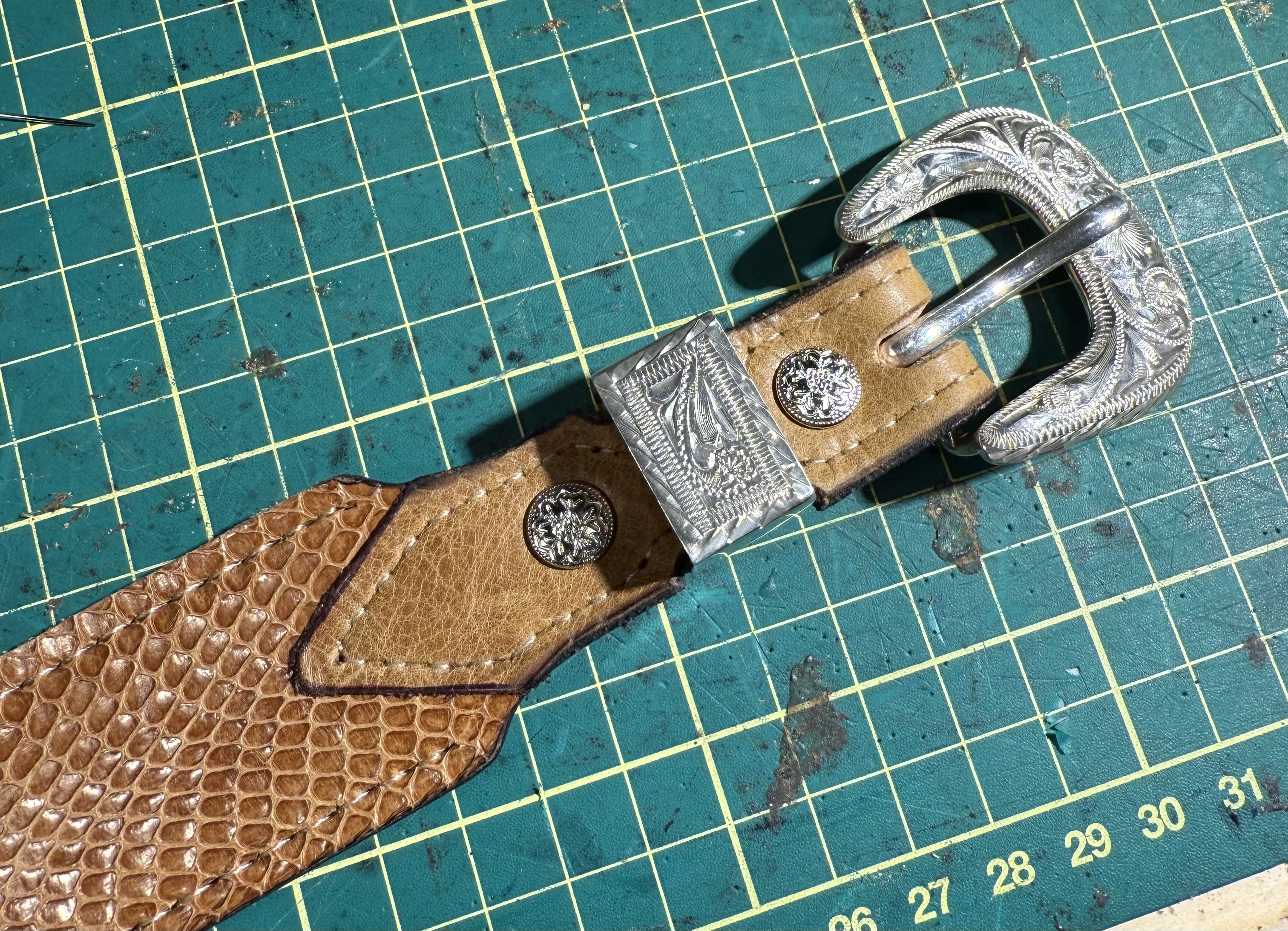

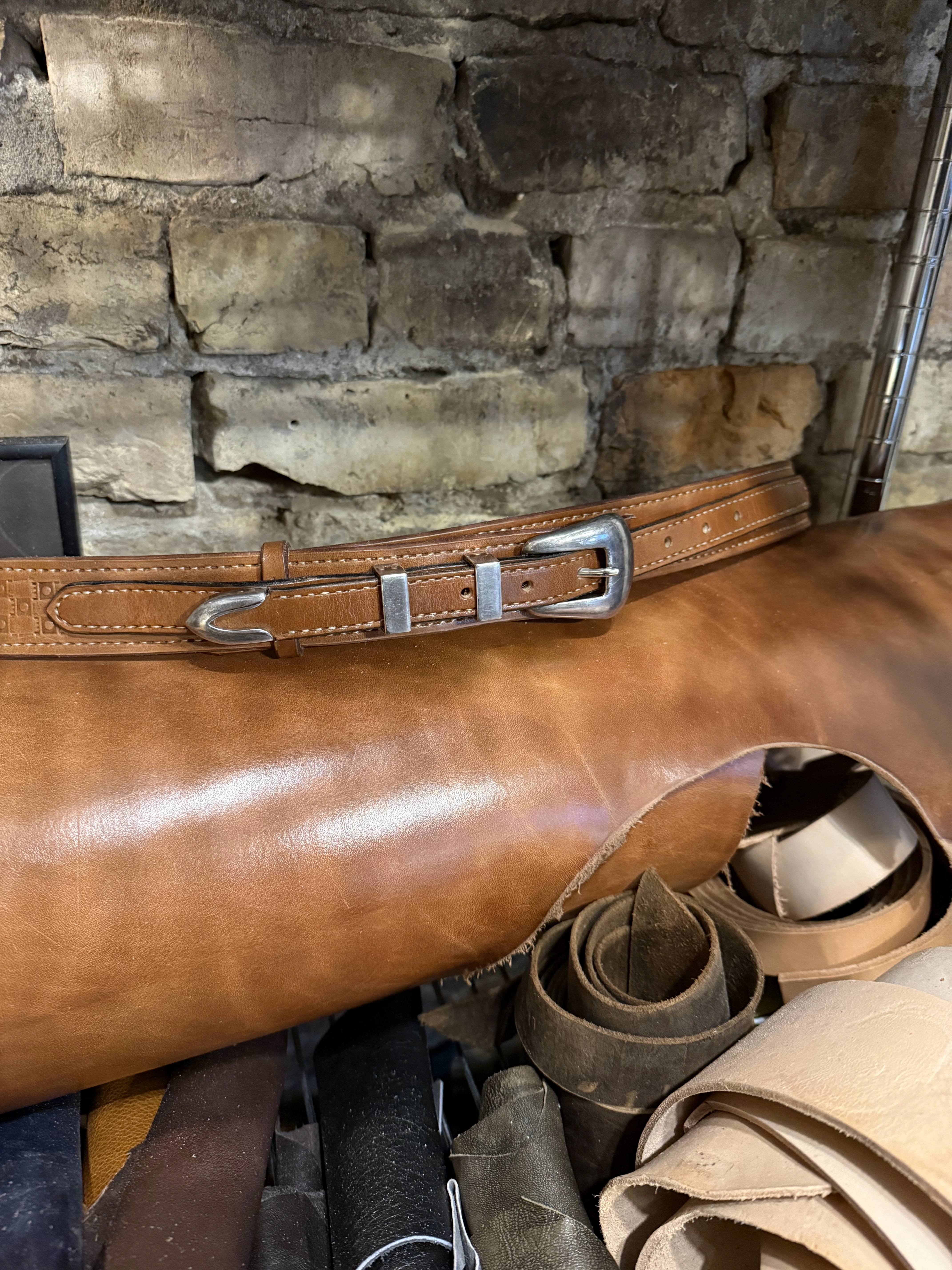

Ranger belt completed today.
And one that sold a couple weeks ago.
