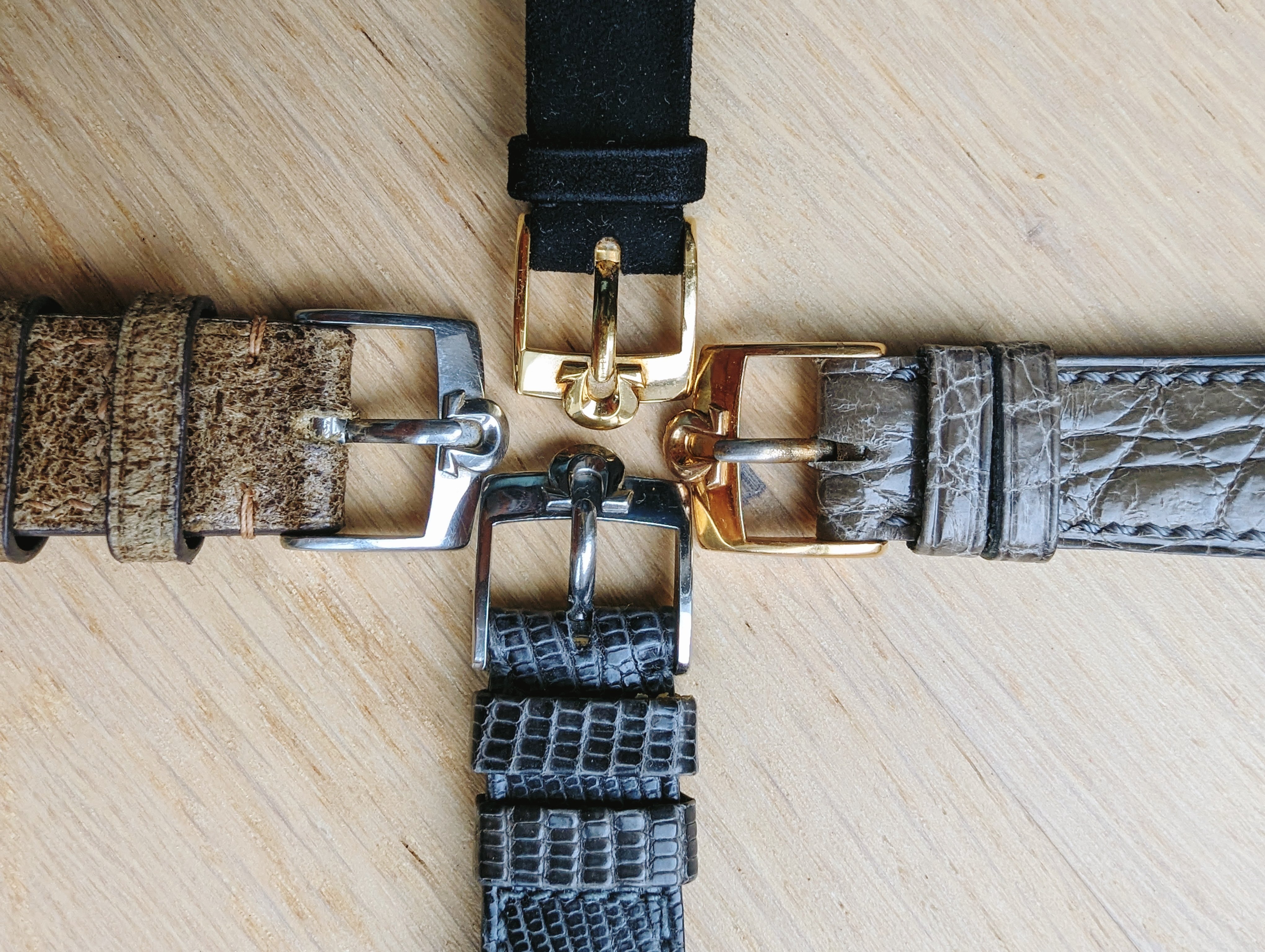

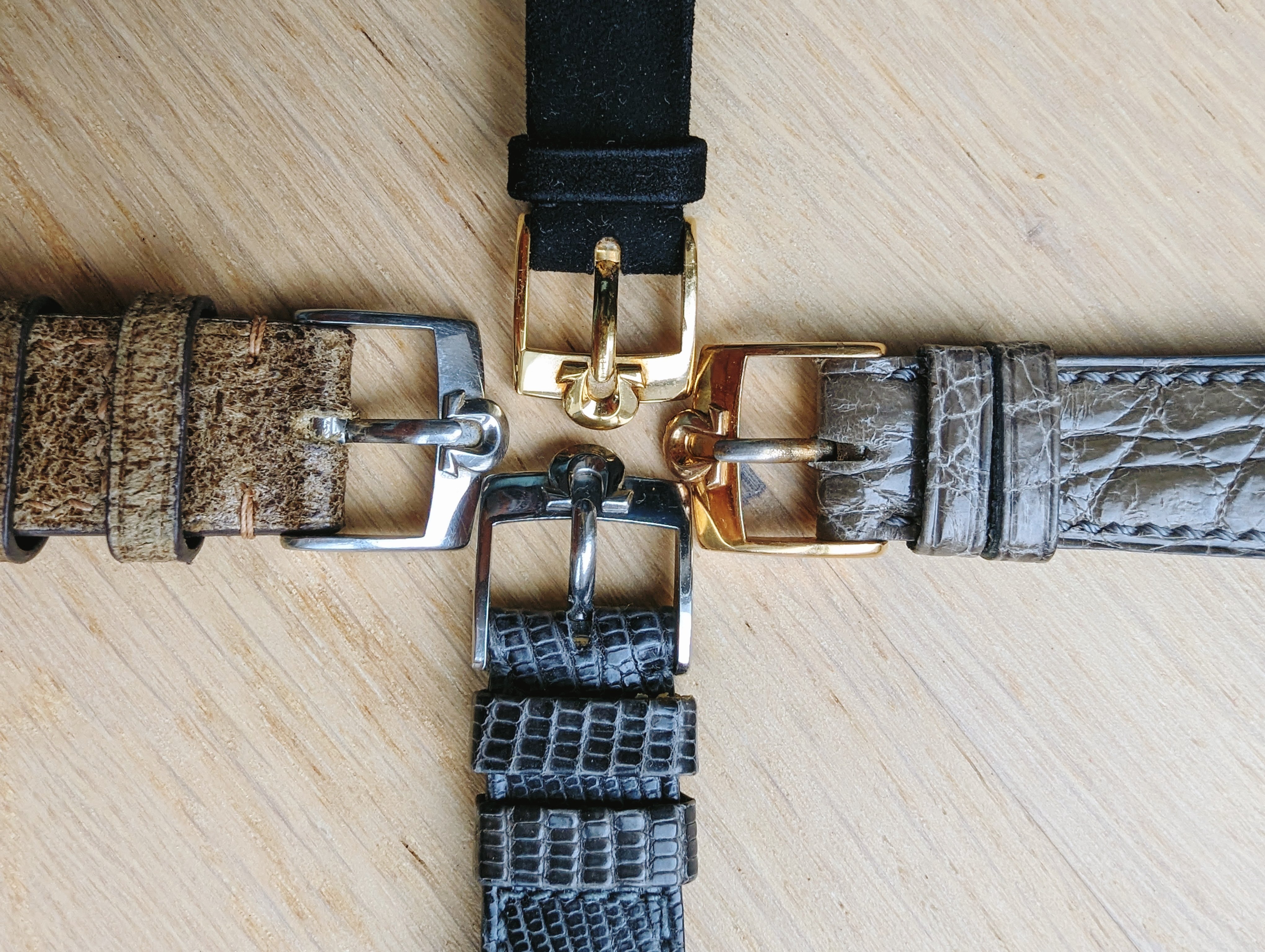

Size matters.
When I refer to a size, I refer to the size inside the buckle, which is the size of the strap that fits in. All the buckles pictured in this thread are 16 mm. except when mentioned otherwise.
In vintage Omega buckles, there are 3 sizes for men’s straps, 14;16 and 18 mm. 14 mm is a bit small and requires a strap arched from 18 to 14 mm. It is not a very modern strap and is very difficult to find. If you have a big wrist it will give you a boyish look.
16 mm is the most desirable because it will fit modern straps 18-16 mm.
18mm is so rare that you can forget about it and use your energy to find an Ed White speedy.
A very rare 18 mm gold-plated buckle by AW. (Below the 16 mm GM. )

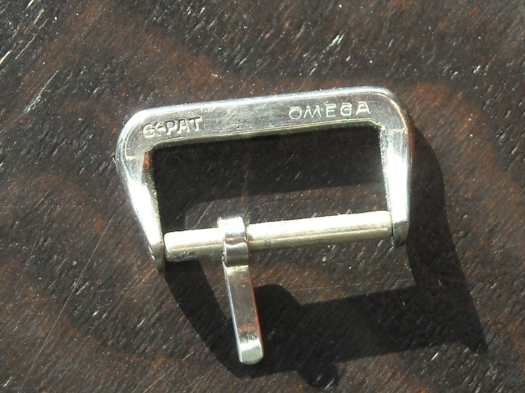

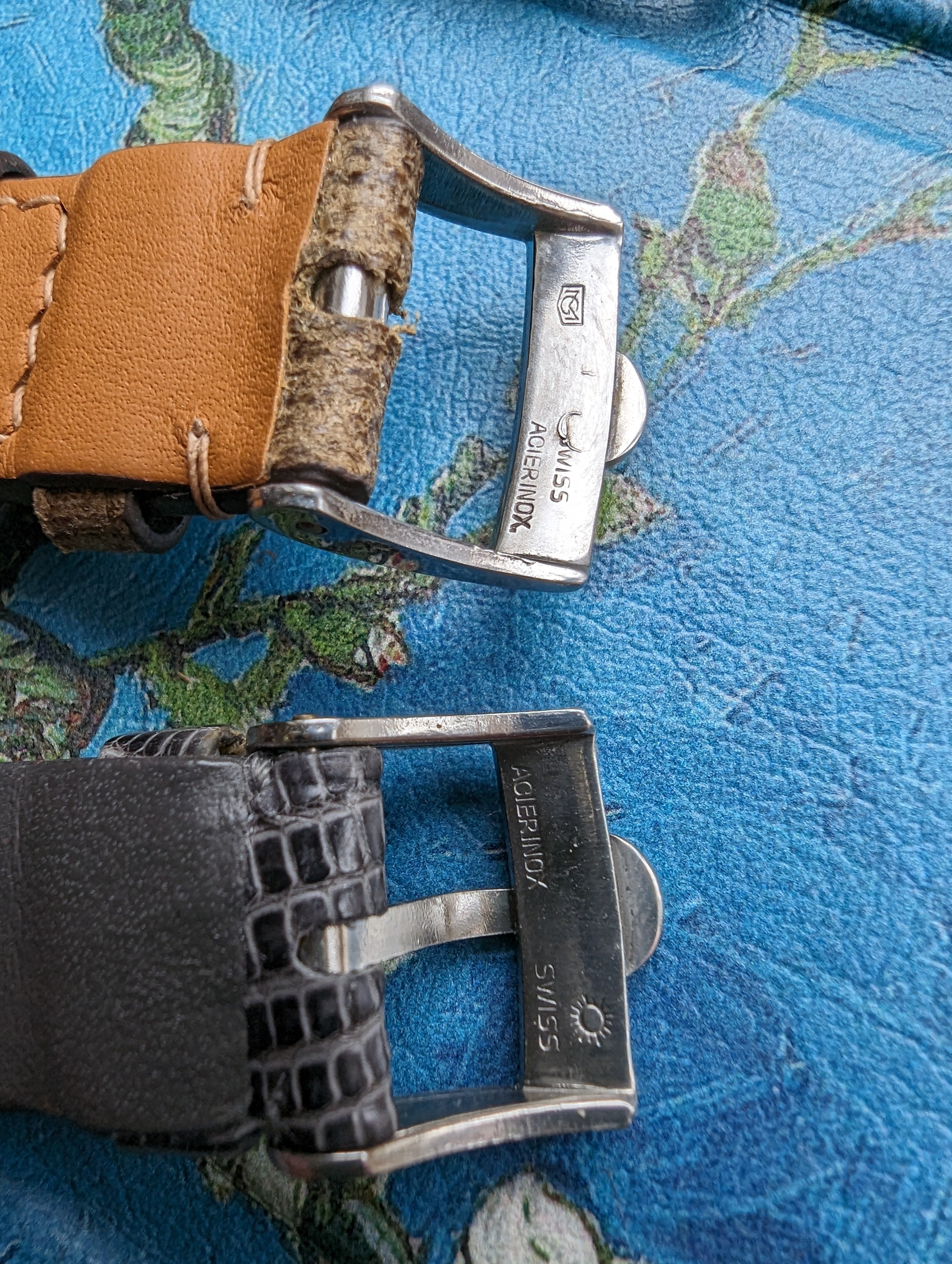

The rule
The rule would be that there are no rules. You can find genuine buckles with any combination of marking. But there is a general trend towards two markings.
Swiss for where it was made.
Acier inox., plaque G, 0,750 for the metal used.
This trend does not disqualify any buckle and one has to learn how to recognise genuine buckles from fakes that you see 99,9 % of the time on sale on Ebay.
There are so many exceptions and that EK. buckle that annoyed me a lot because it broke all my theories, but you always need exception. I believe that early buckles were not signed properly or nobody cared.
The same with different markings

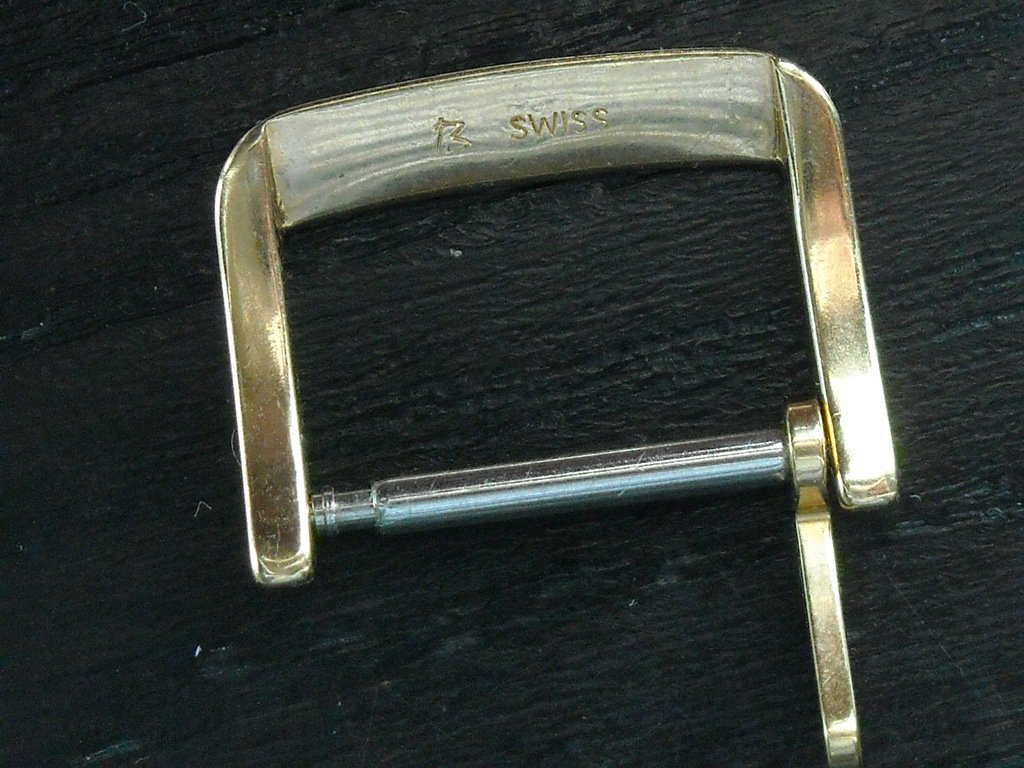

18k or 750 gold buckles
As far as I know they exist in 14 mm and 16 mm.
As you can see, when it is an 18k gold buckle it is always fully signed with Swiss, 750 and the manufacturer’s mark. So in that case it is easy to disqualify fakes.
Most are made by AW. And those should have an 18k gold spring bar.
The one made by GM. Has a gold-plated spring bar, but the buckle is heavier in gold

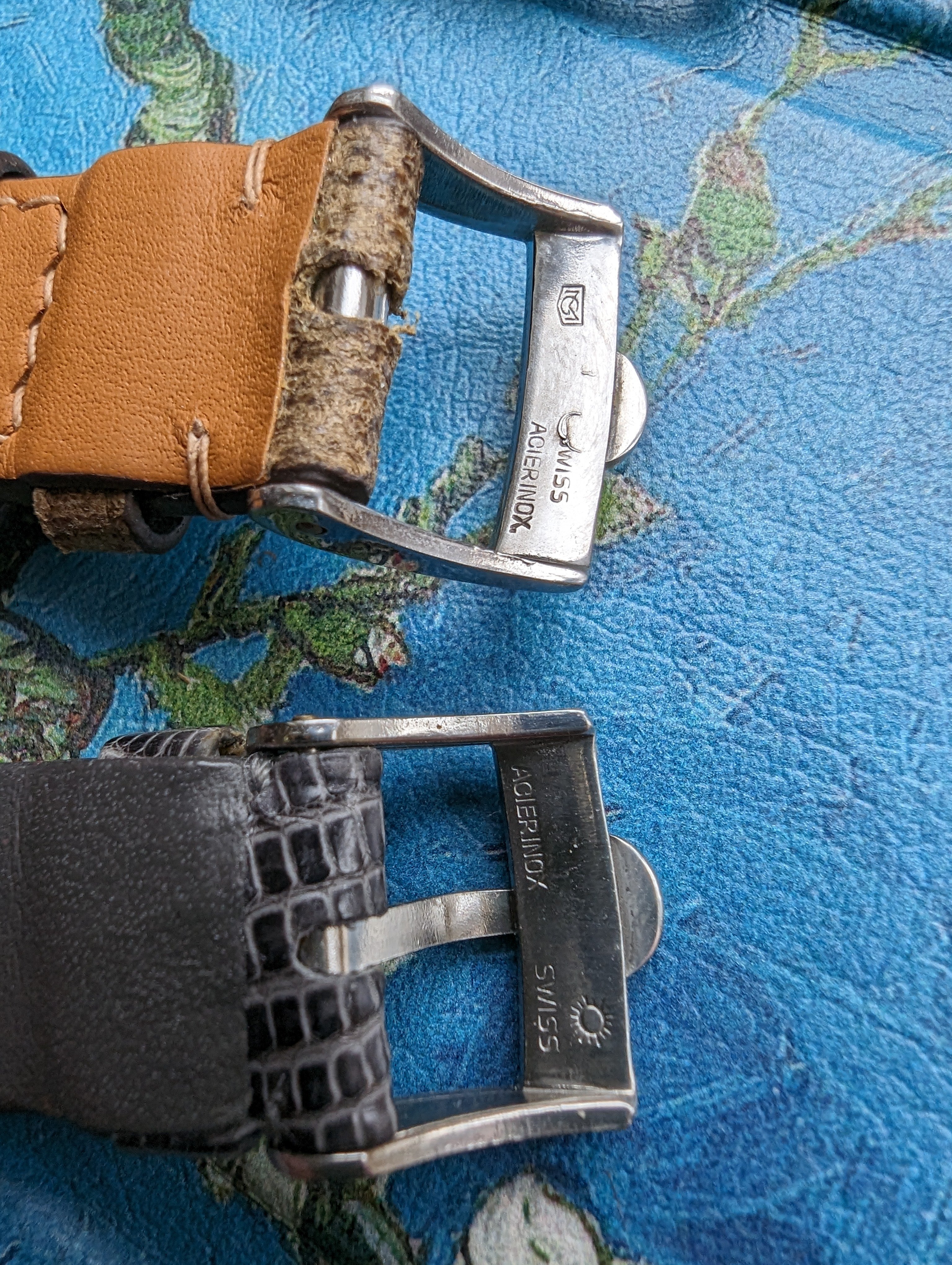

Evolution in time or chronology
This is a proposition I make out of observation. I have no proof and I am open to suggestions. I think it will be very difficult to date those buckle, but maybe if we make a survey we will come to something.

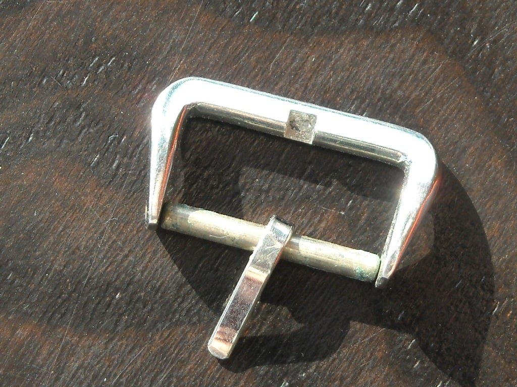

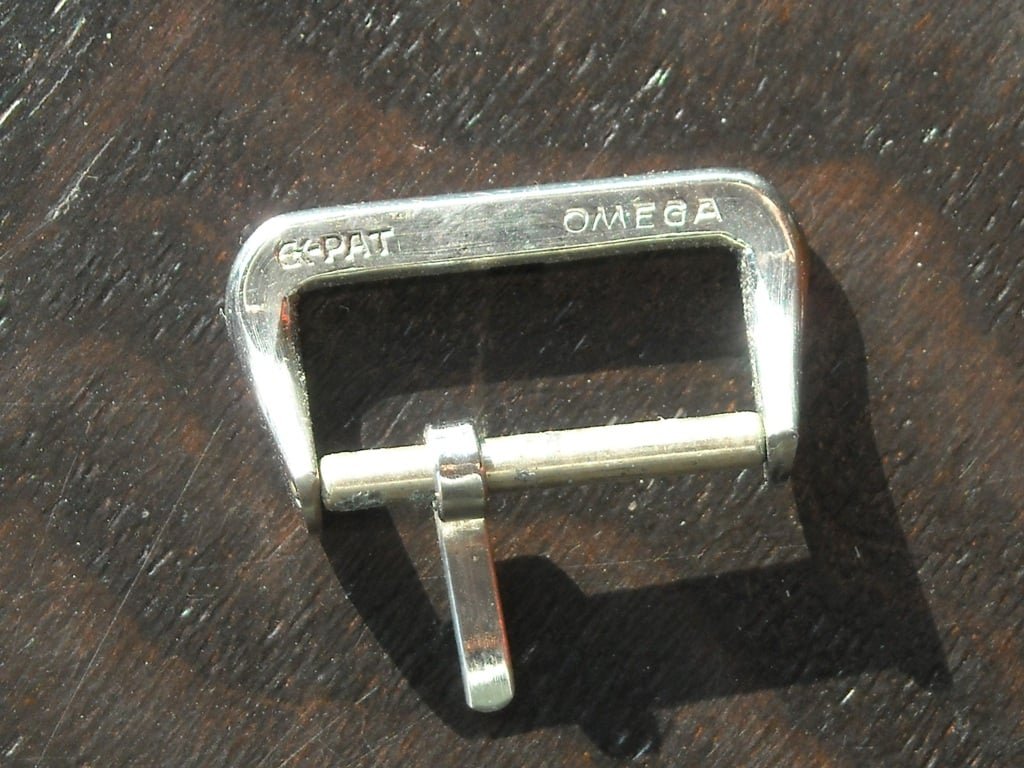

1.Early EK.
2.Later oblong EK.

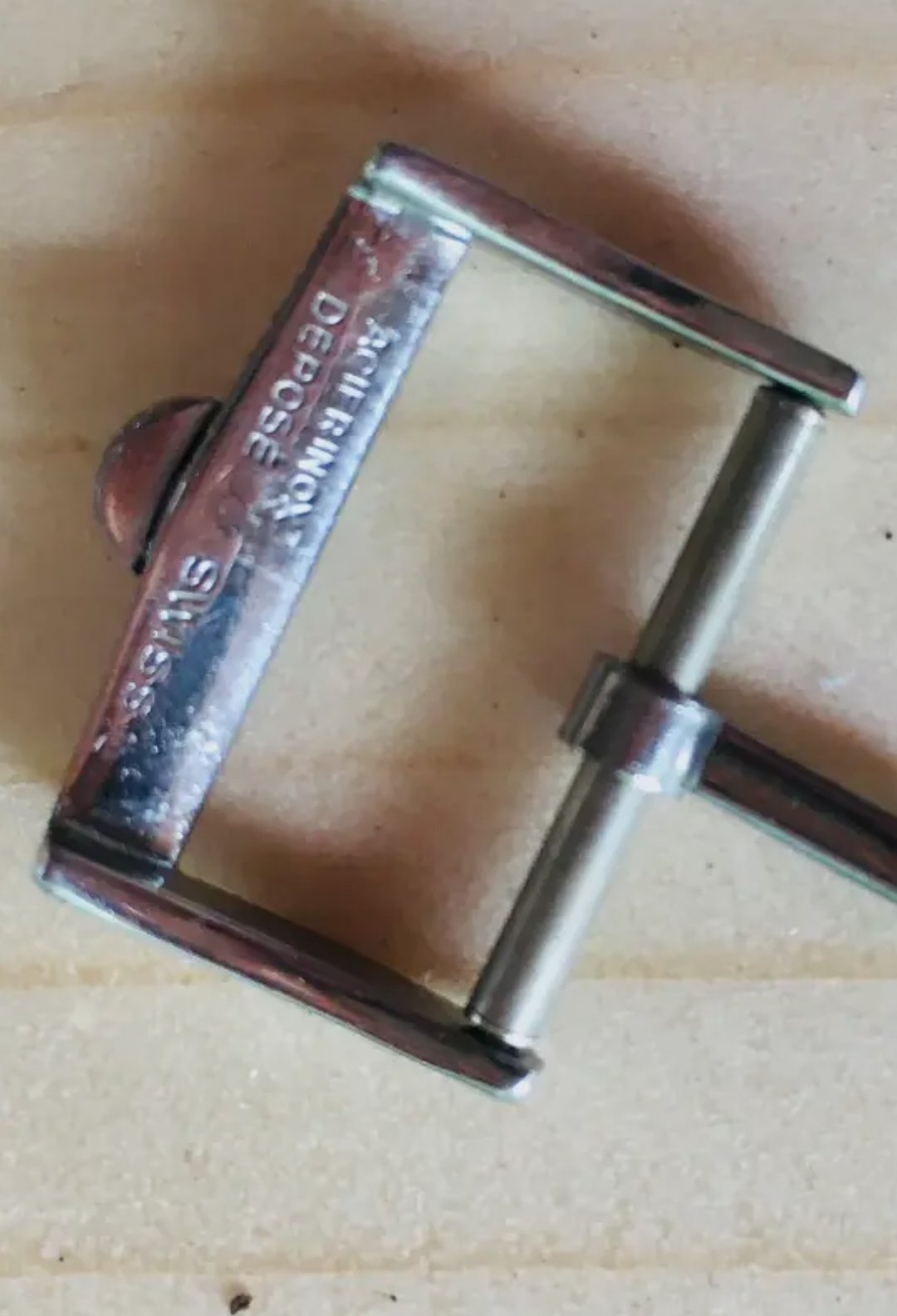

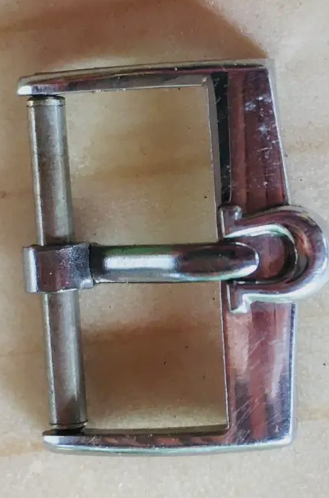

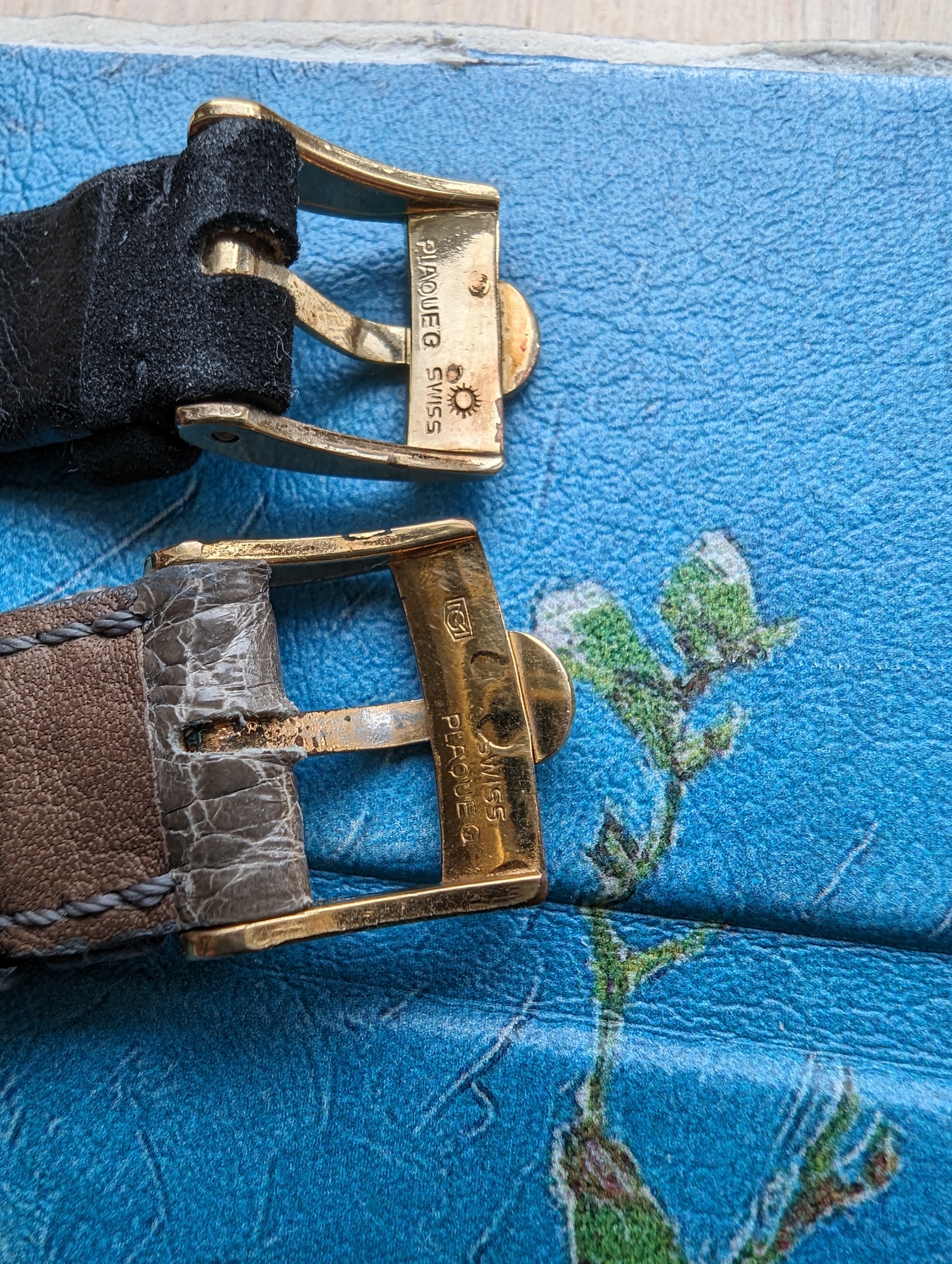

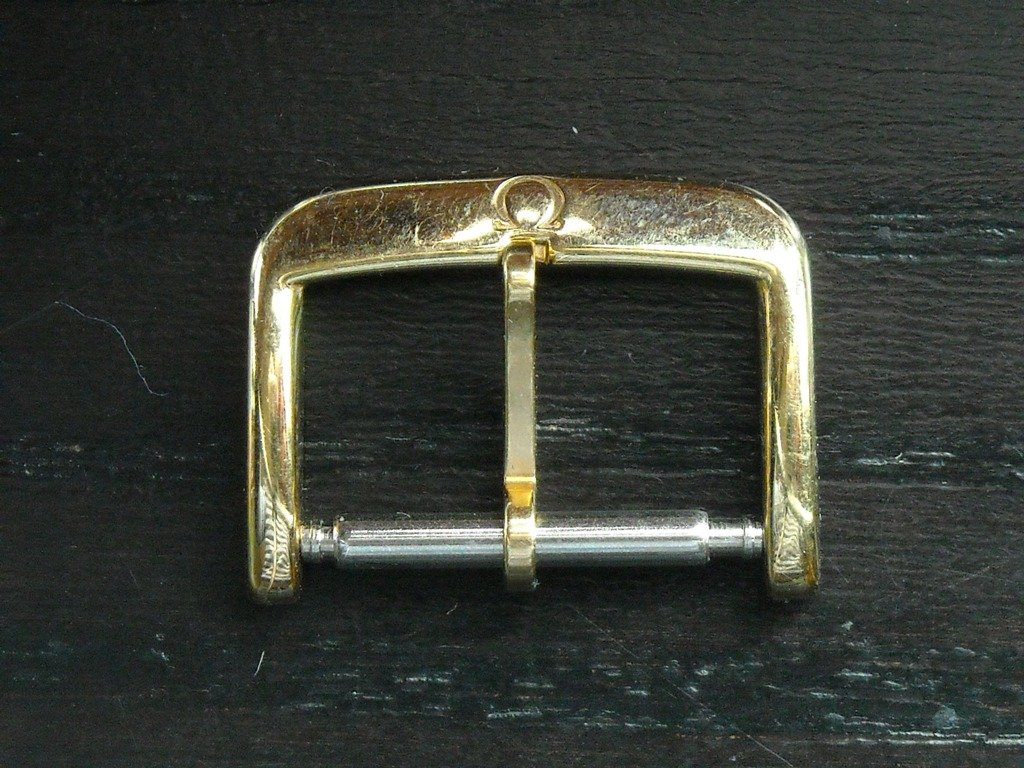

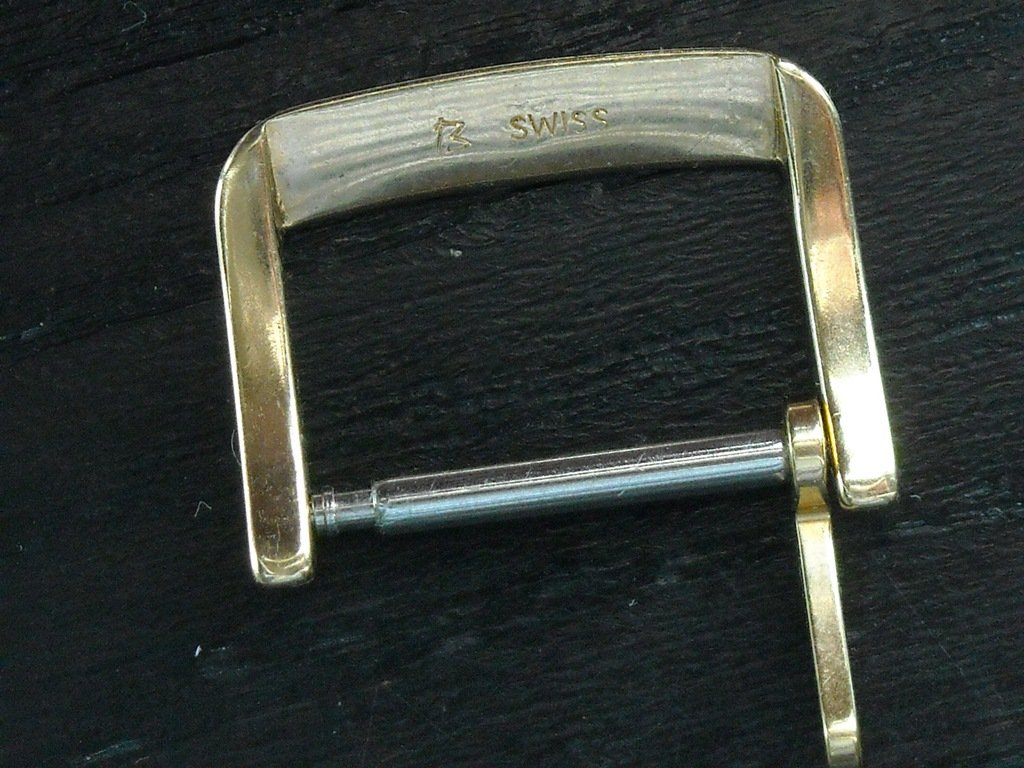

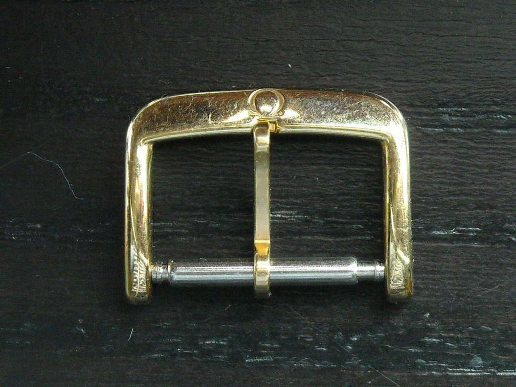

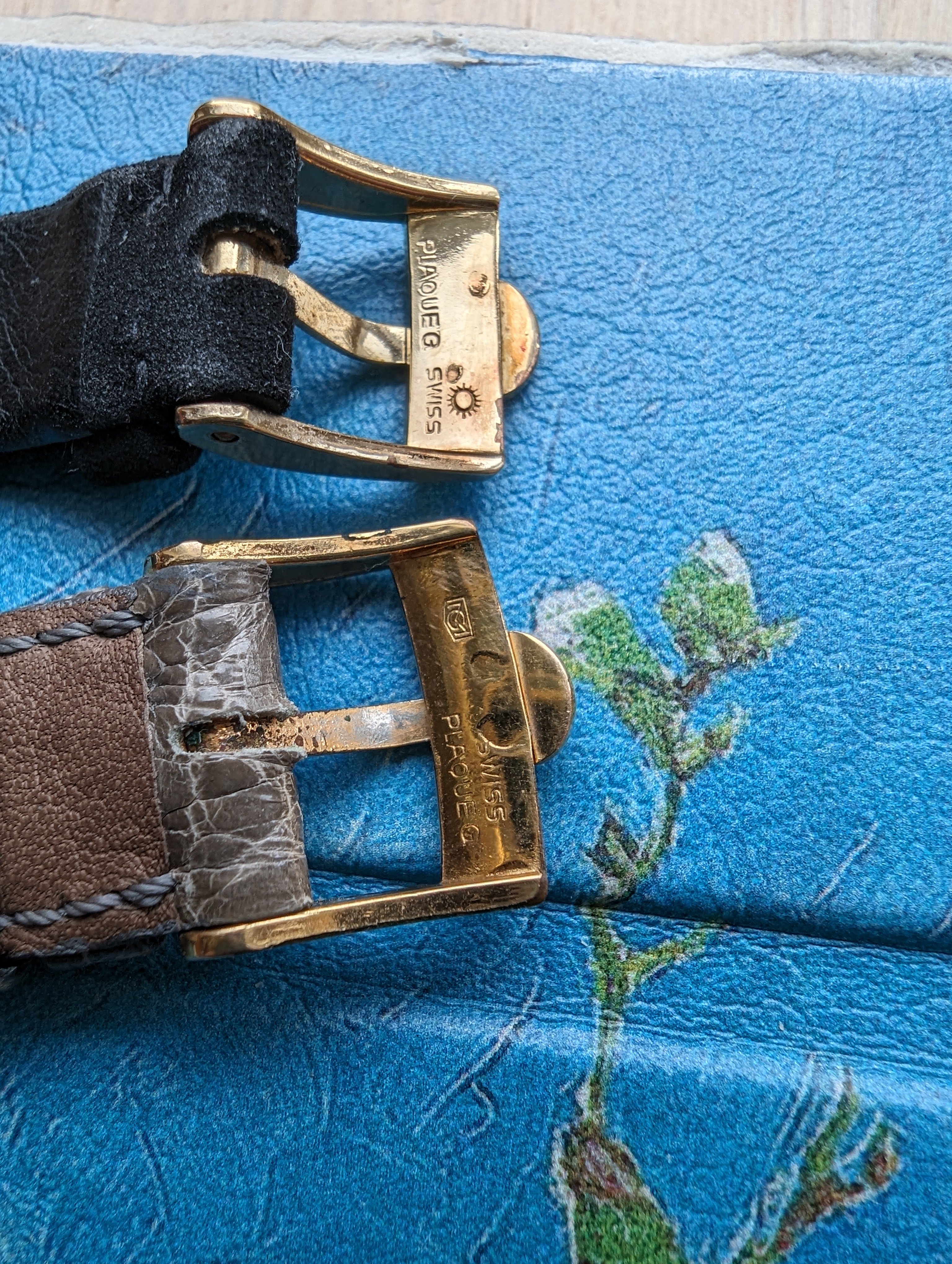

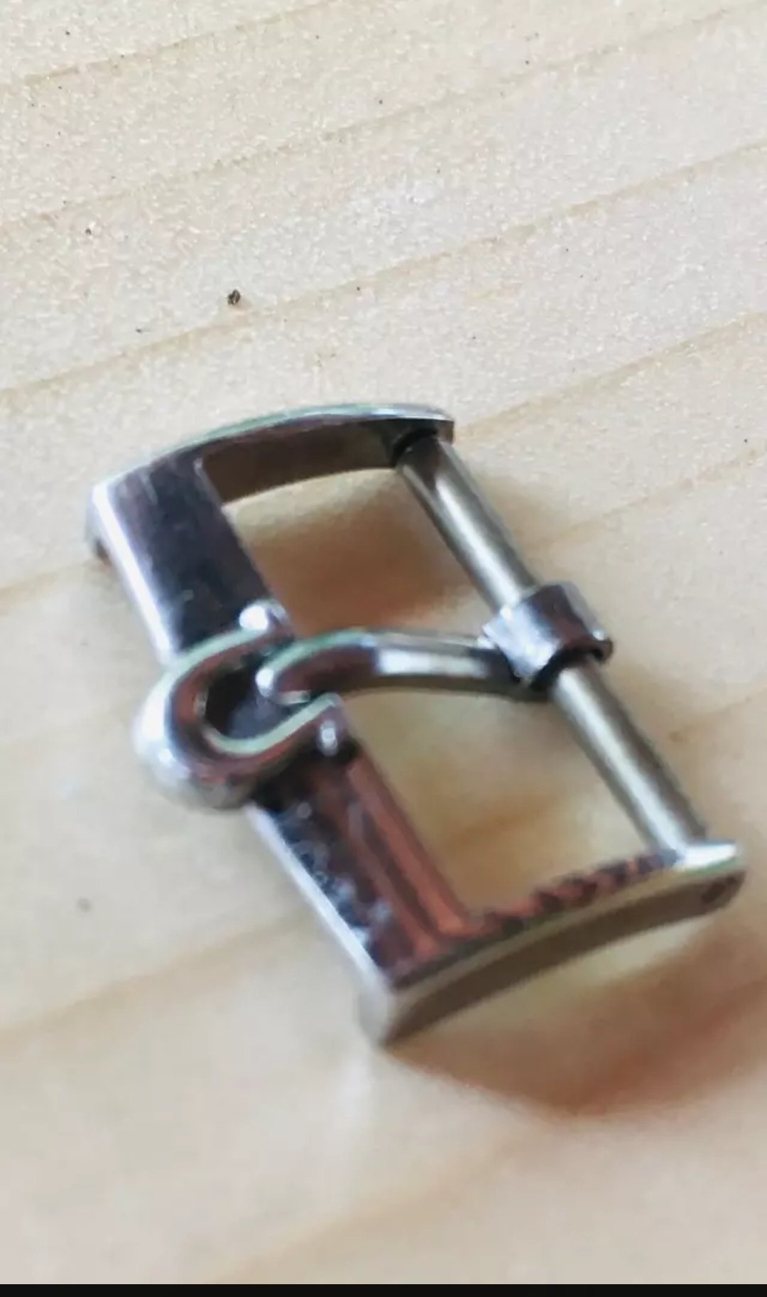

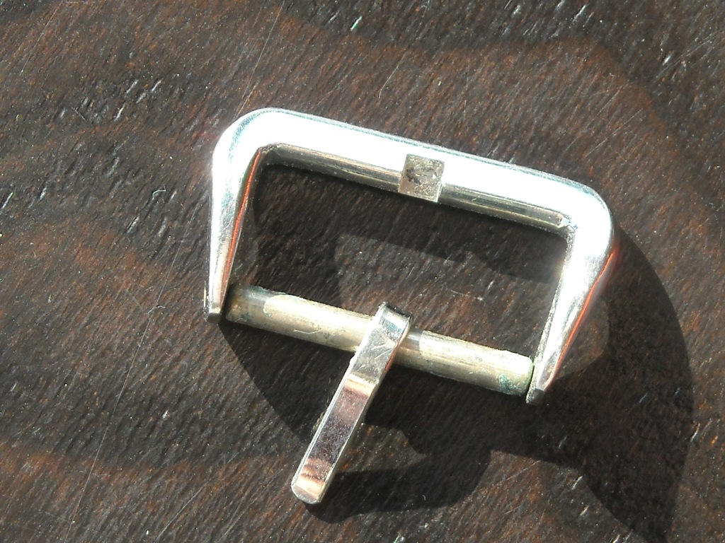

Good evening , is this genuine?
Don’t recognize the markings But it looks original. And Fat springbar looks old. See what others think.
13,672
19,041
Look OK to me. The last one may have had the logo re-soldered.

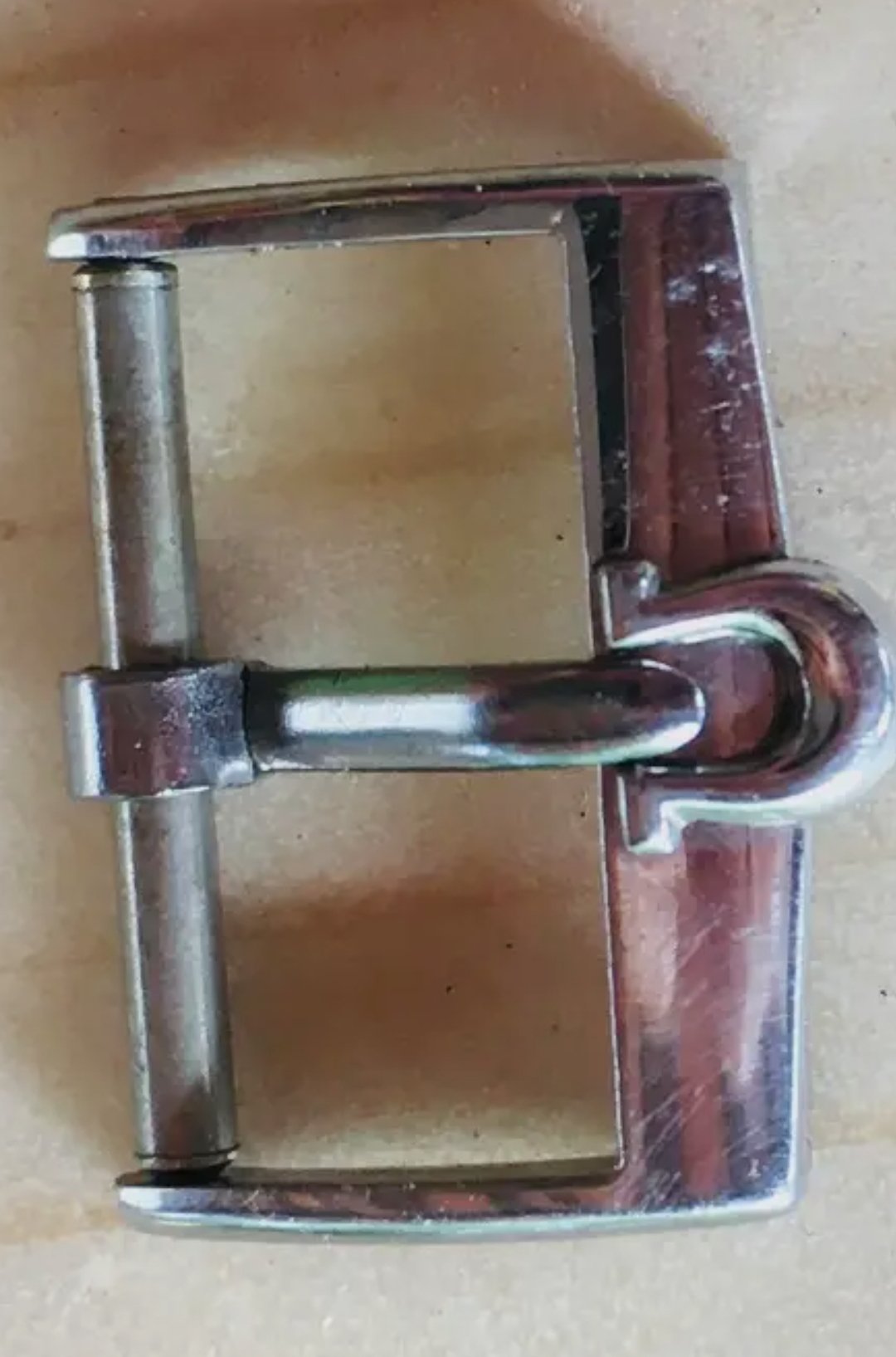

Compare to these photos taken from earlier part of this thread. “Later B”
Yours looks quite similar but not signed. I think legit see if others agree

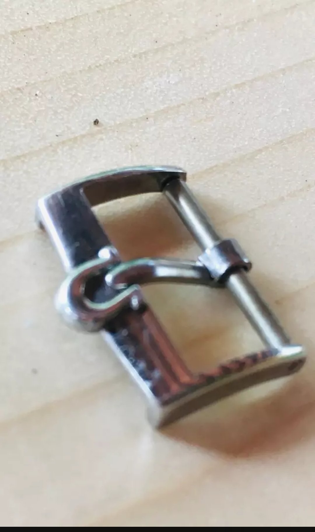

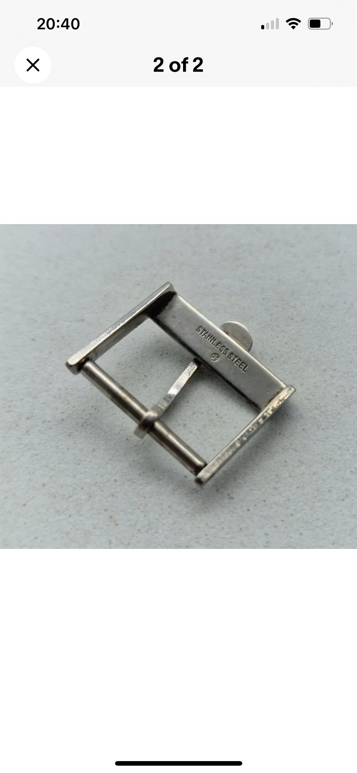

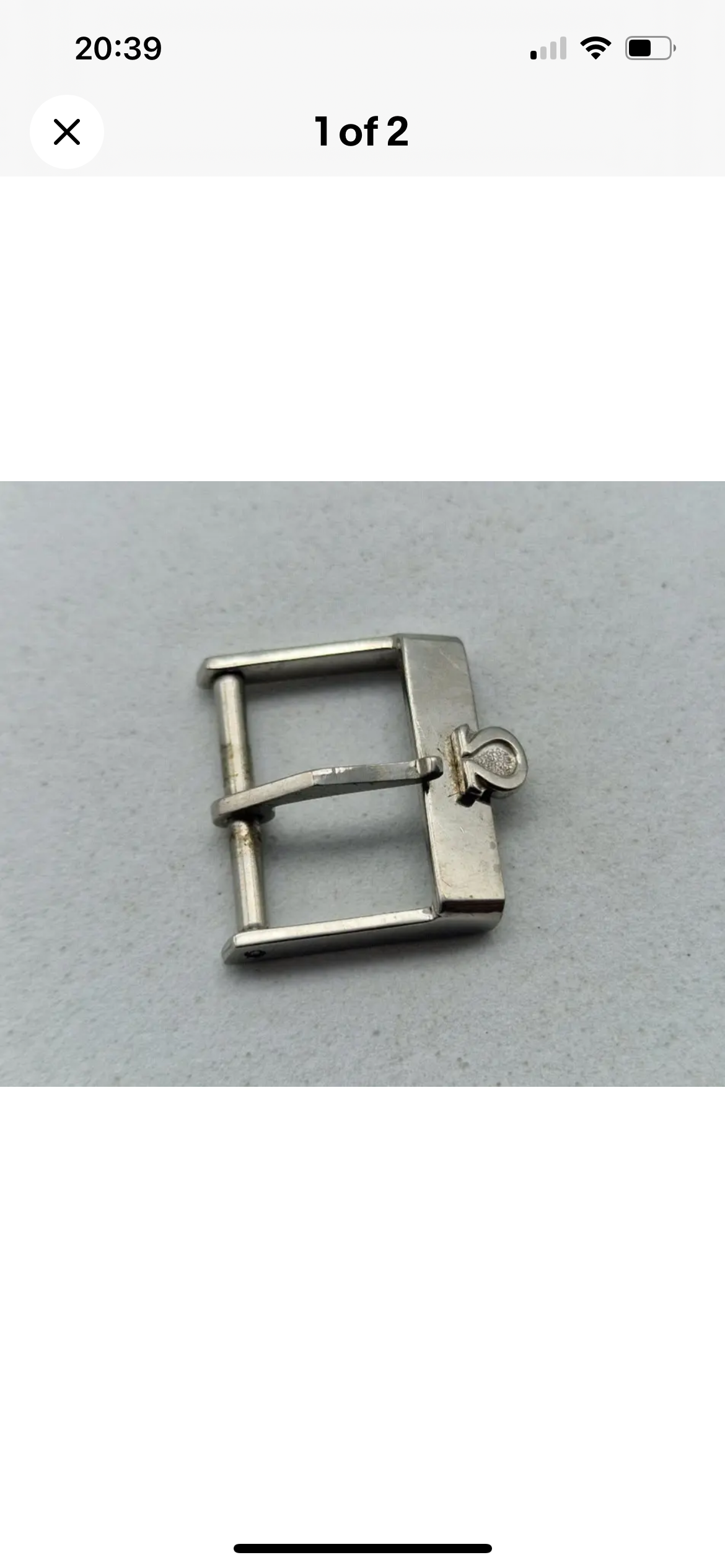

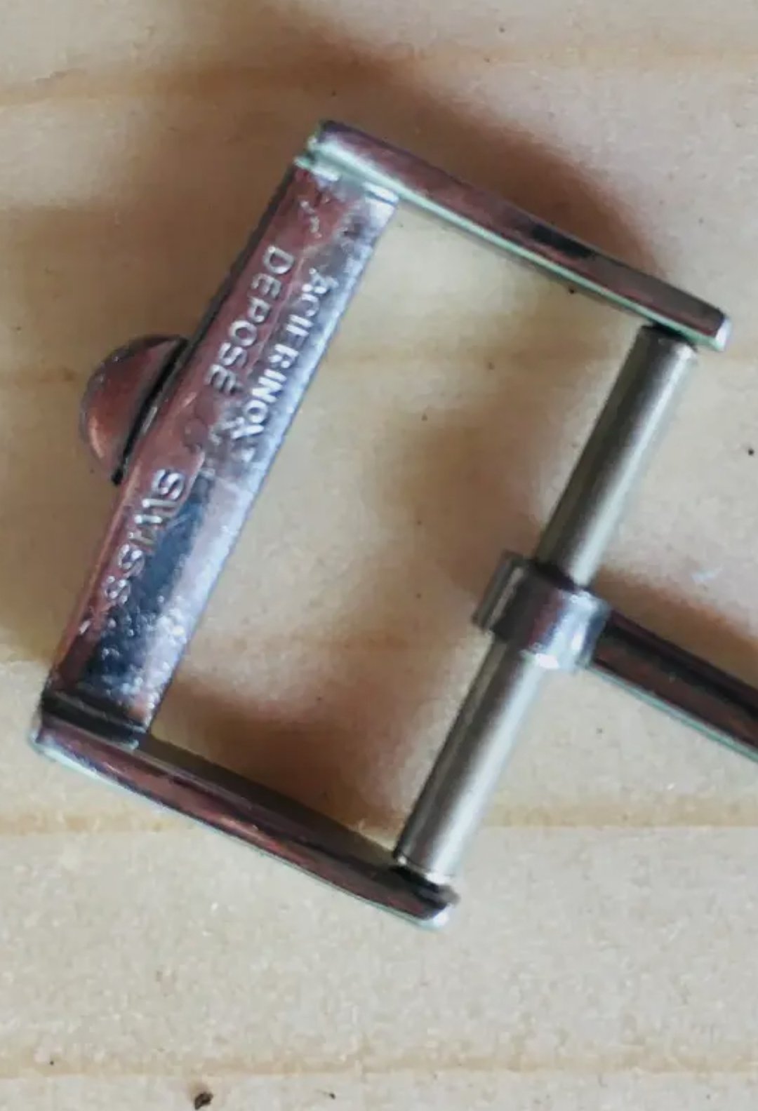

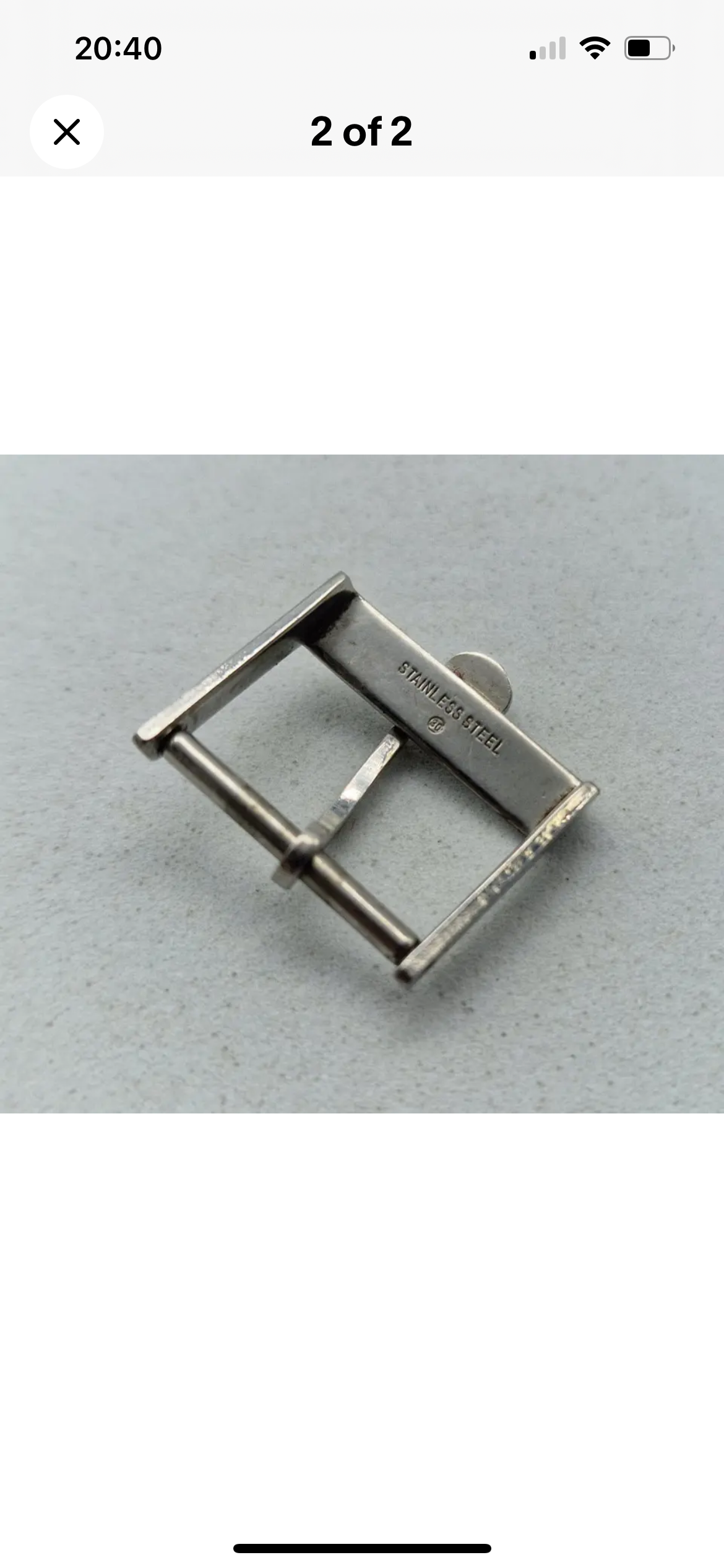

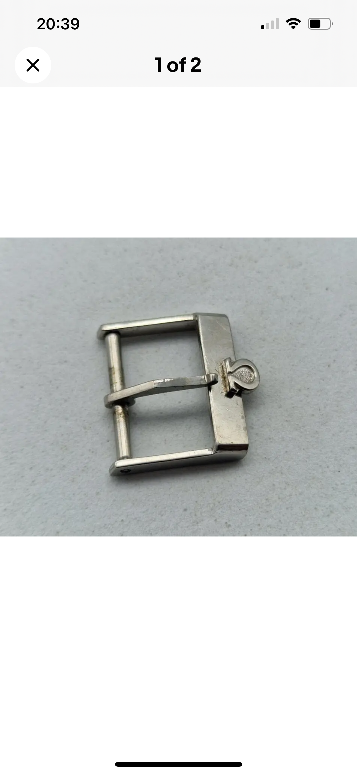

Good Day! According your experience, would this buckle fit nicely my Omega 2639-5 from 1951?
What do you think about it?
Thank you very much for your help!
3,672
7,996

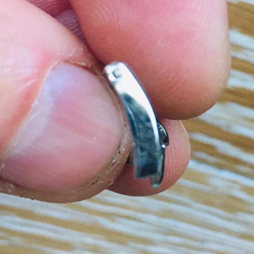

looks like earlier AW like one on left- does side profile look squarish like the second photo? Looks legit- however i think the early 1950 buckles were simpler I would guess this one is from early 60's. But not sure. Anyway it will look good IMO. These photos are copied from earlier part of this thread.

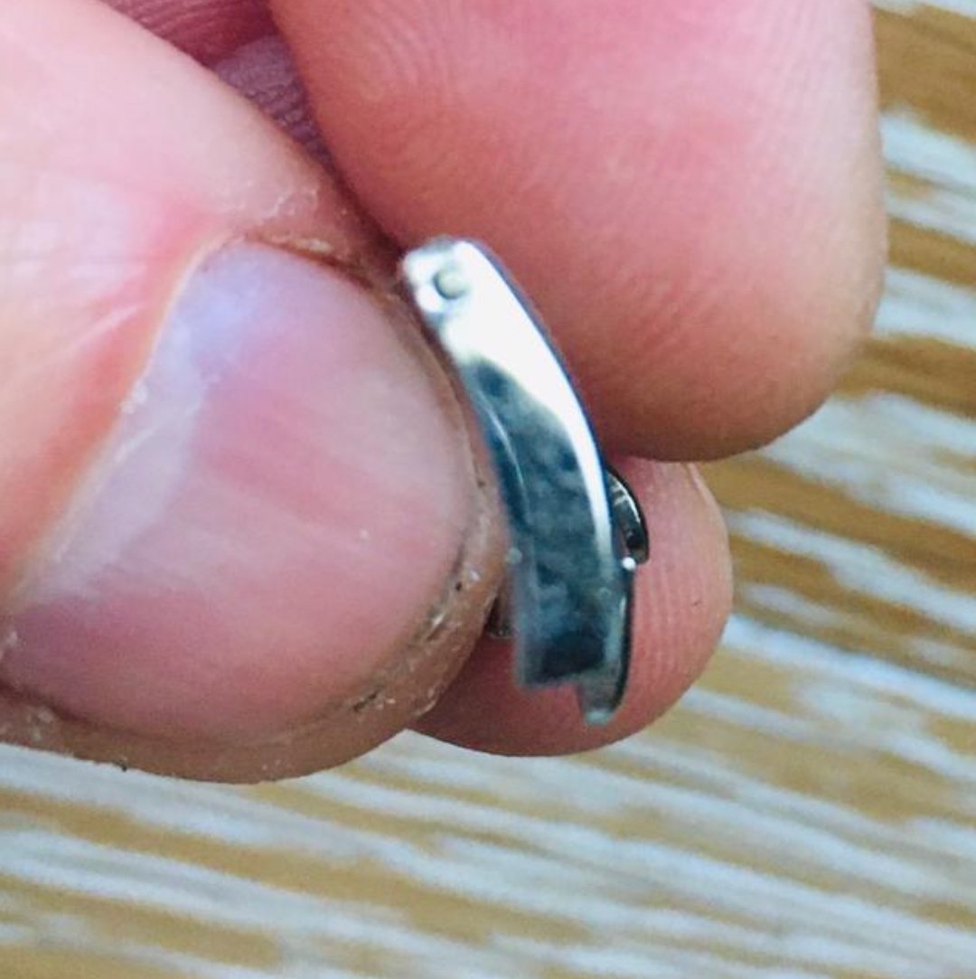

Thank you for your reply ! Yeah seems legit also to me. But would be very important to understand if its from 50s or 60s (would be two differents era buckles). This is the profile, like you said seems definetely squarish. Thank you again 😀
3,672
7,996

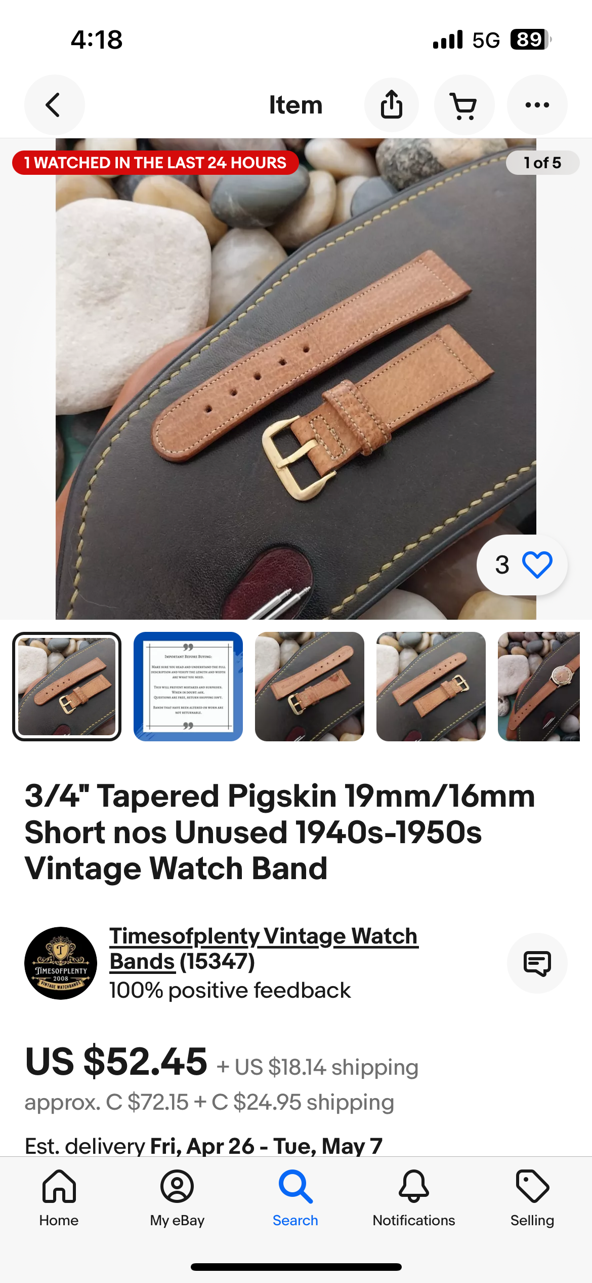

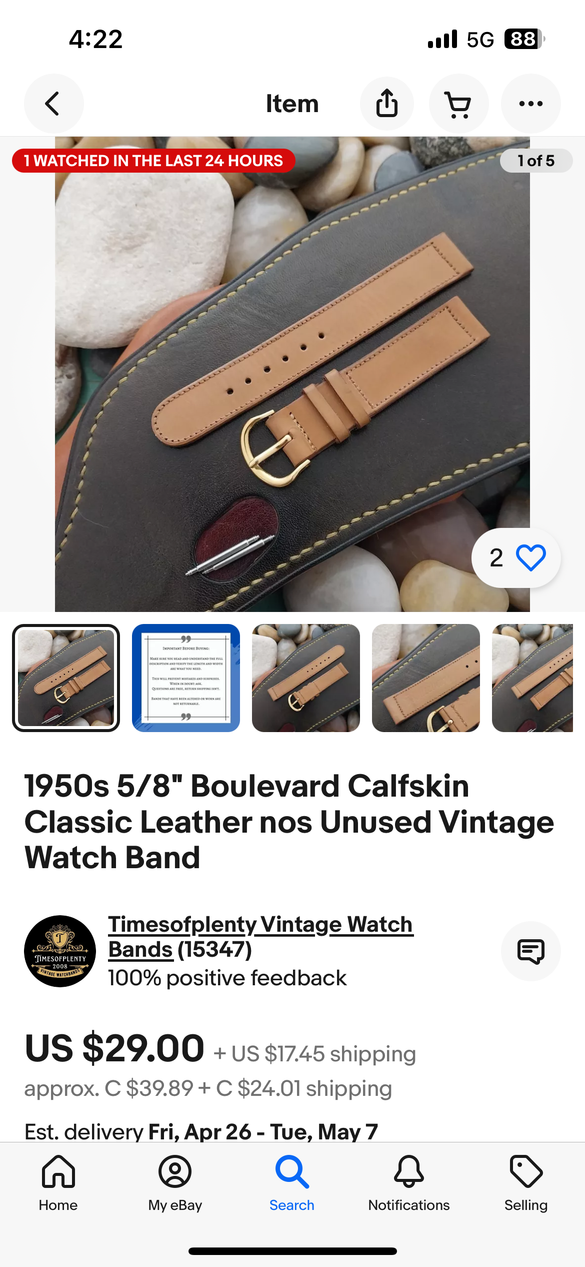

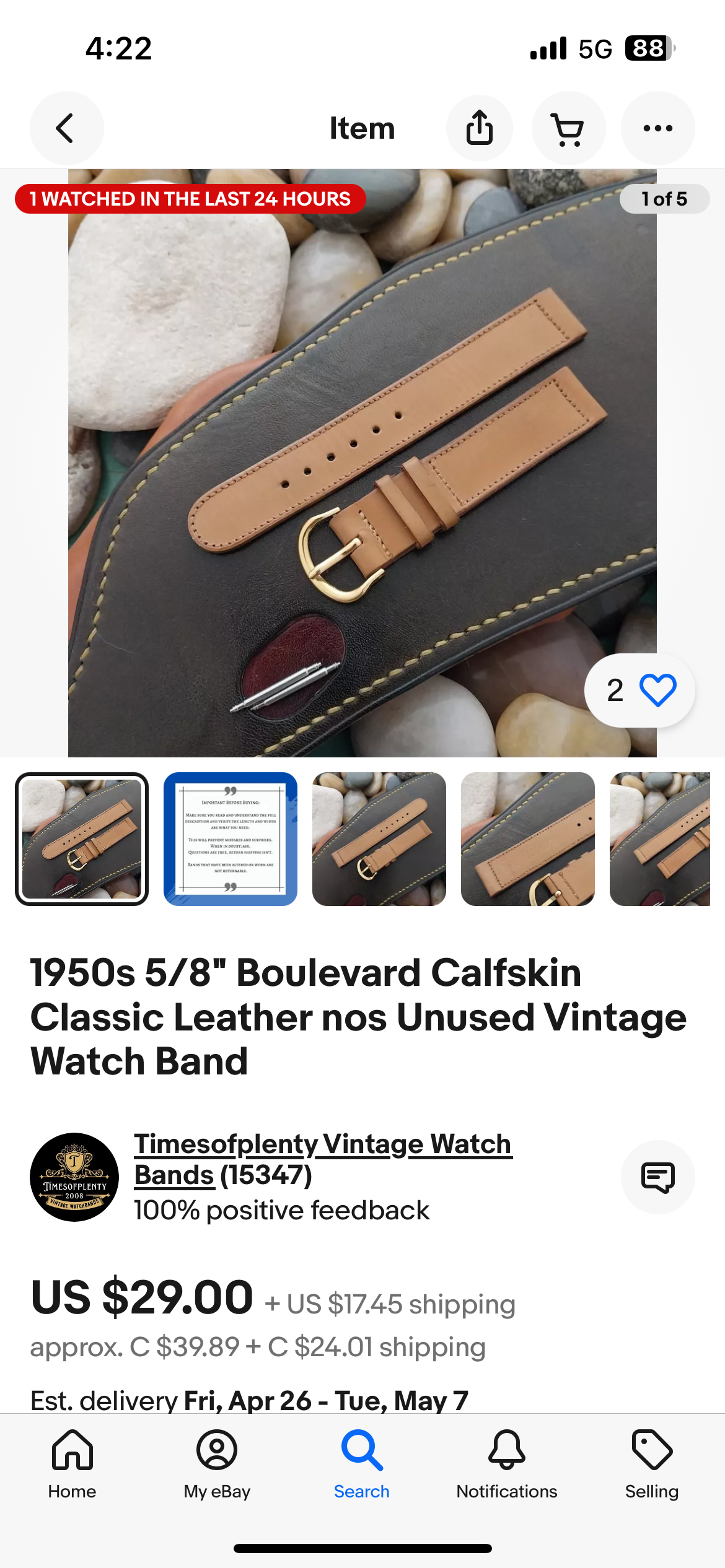

Your buckle is legit I would keep it and I might wear it as close enough. But if you want to be more period correct then check out TimesofPlenty on EB he had great selection of vintage straps and buckles
I think something like pigskin with box stitch and simple buckle is more early 50s.
Couple examples you could ask him is he has Omega buckle
Some early omega buckles in this thread at beginning. Good luck!

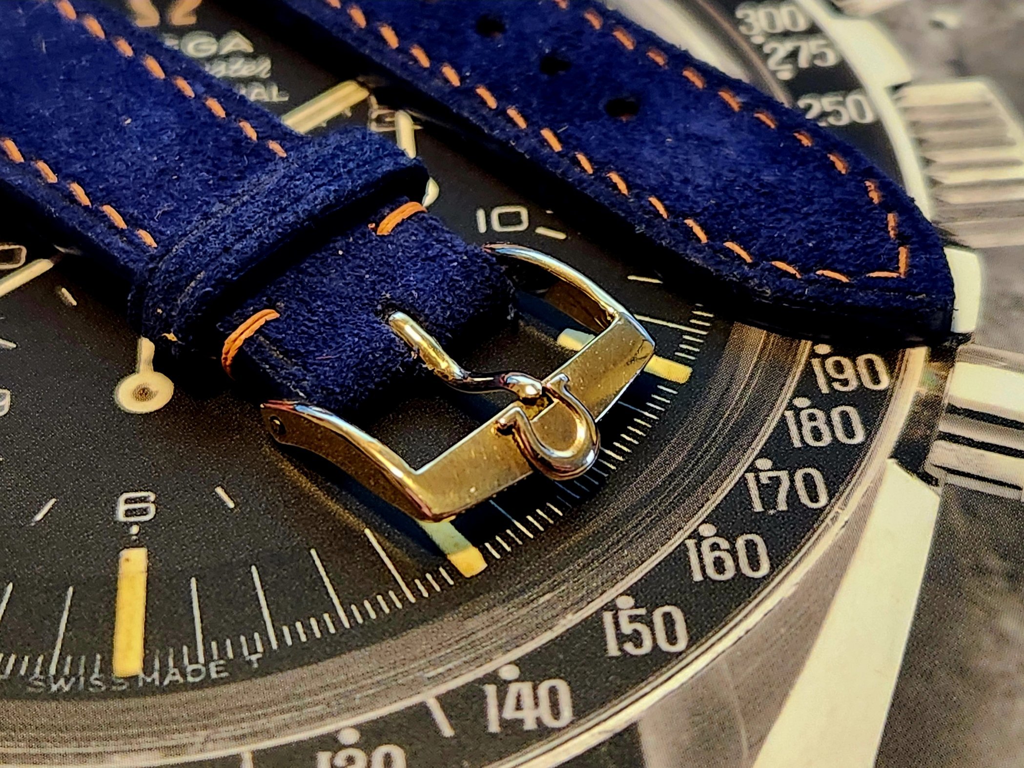

Like this. Photos from earlier in this thread. If you can’t find vintage strap you can get Torrestraps to make you one he’s specialist in these vintage styles.

Yeah Considering we are talking about 1951, this One could be closer to that time I guess. The One with big Omega logo(the one that I posted) seems more like... End 50s start 60s ? Most likely?
345
3,378
Also the One I posted isnt my buckle. Is one from a friend on eBay. So If I have to buy one buckle, I would like to buy the closer one possible. I will look around. By the way thank you a lot for your advices!
