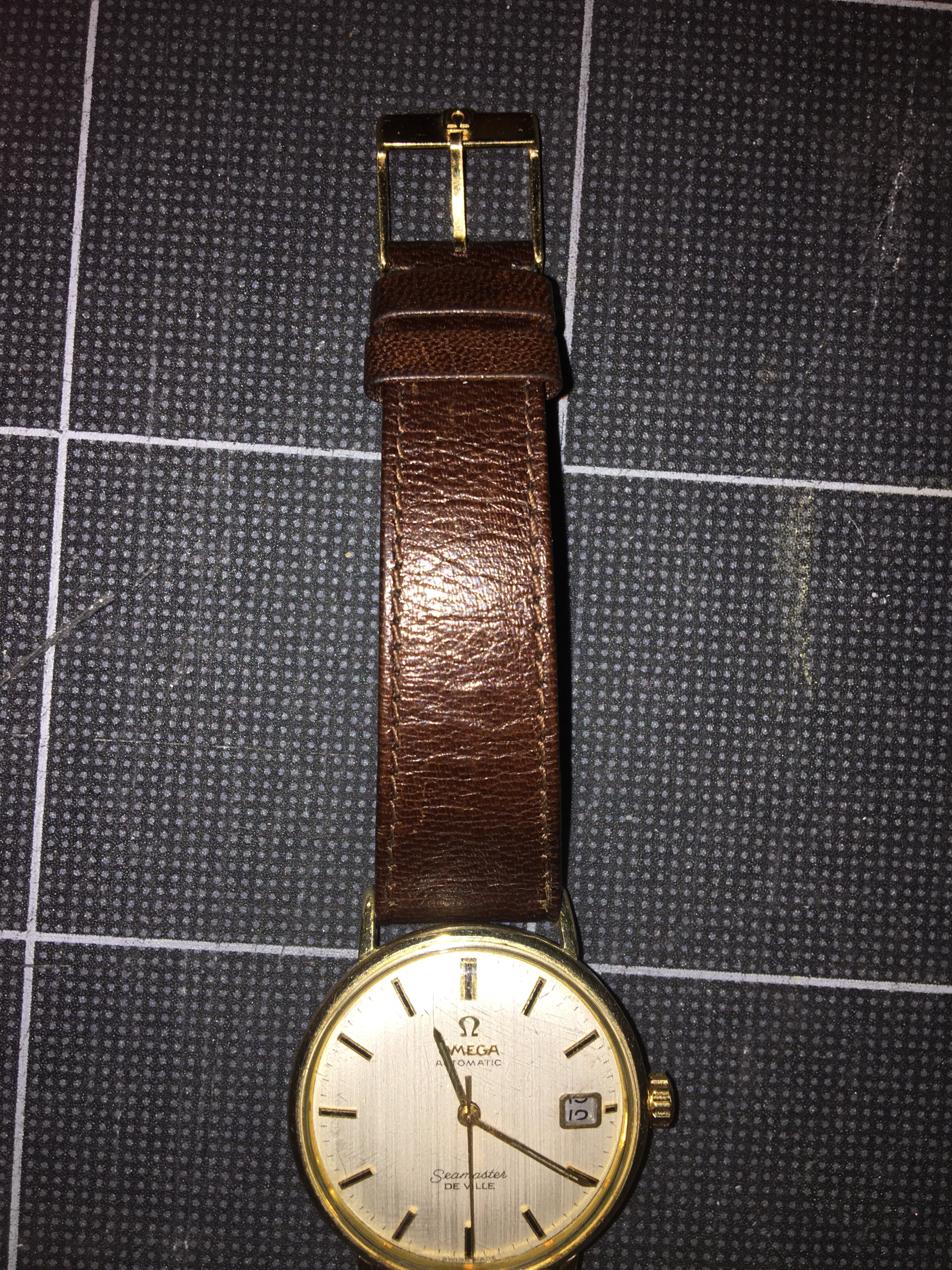

Hello, New member in the group. Thank you for the wealth of information particularly now that I'm looking to buy a 18K gold buckle for my 1969 Omega De Ville. Very useful information, I appreciate it!!! Thank you. Julio
1,306
5,825
On a vintage watch with 19mm lug width, the buckle size should be 16mm or 14mm. You'll not find the exact info about the buckle size on a catalog, even tody they do not advert it... The only chance you have is to find someone that was in the business 50 years ago, and who remember which buckle size it cames with.

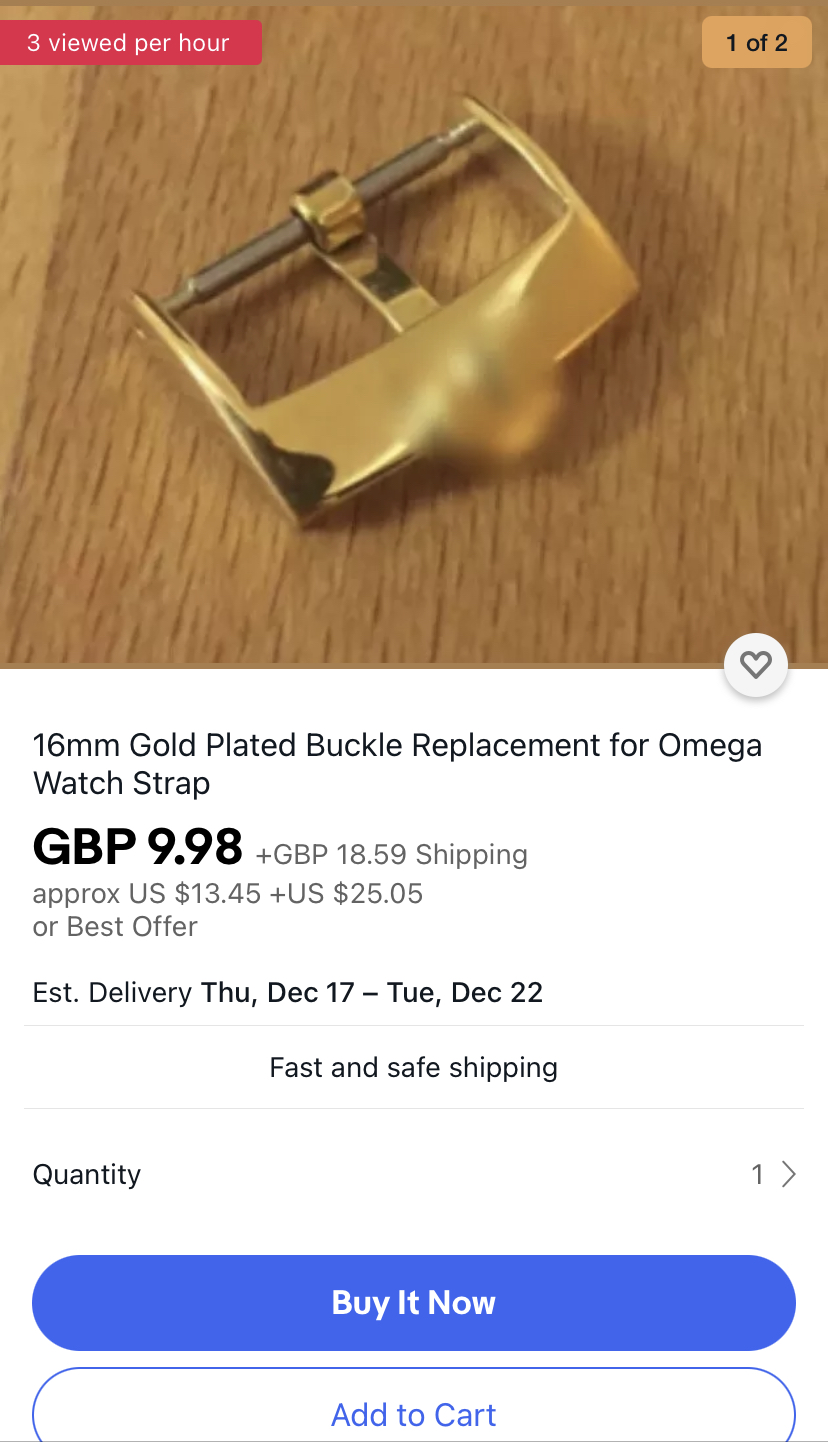

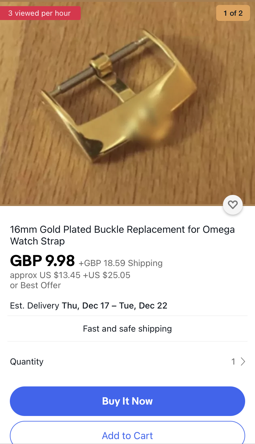

Always a good sign when the buckle is SO fake they’re worried about copyright infringement and blur the photo...

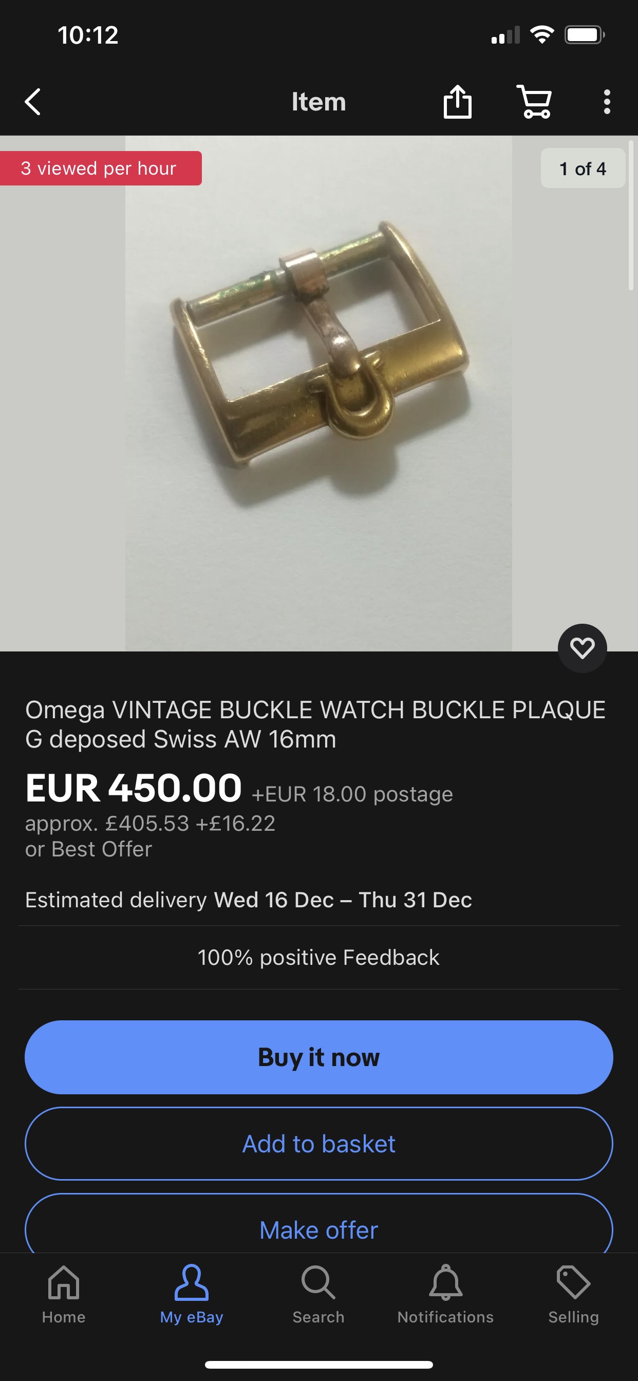

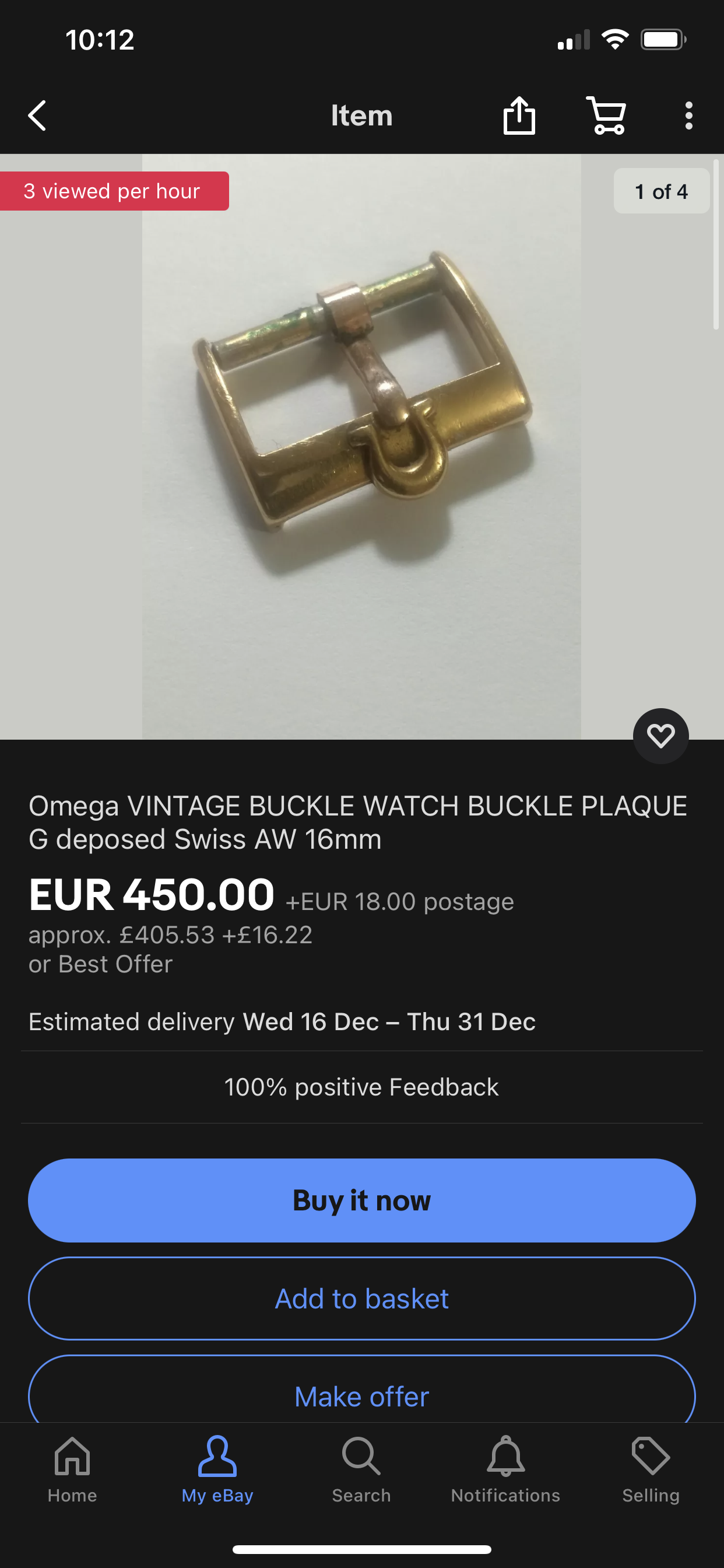

I’ve noticed lately, incredible prices from various Italian sellers on buckles. I just picked up this same buckle in an auction elsewhere for £22 as a spare. Do they expect to ever sell them at these prices? If they do I’ll sell all of my buckles in my collection. Haha
13,671
19,041
Like PT Barnum once said, “There’s a sucker born every minute.”

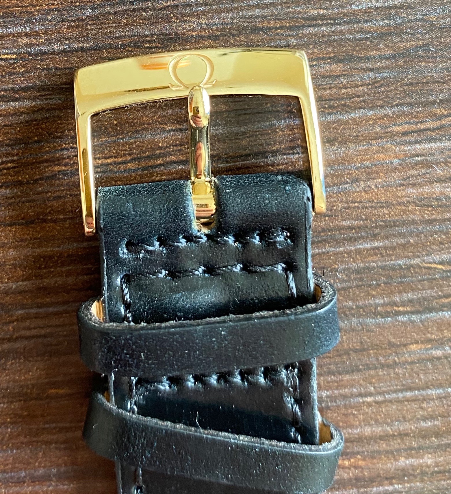

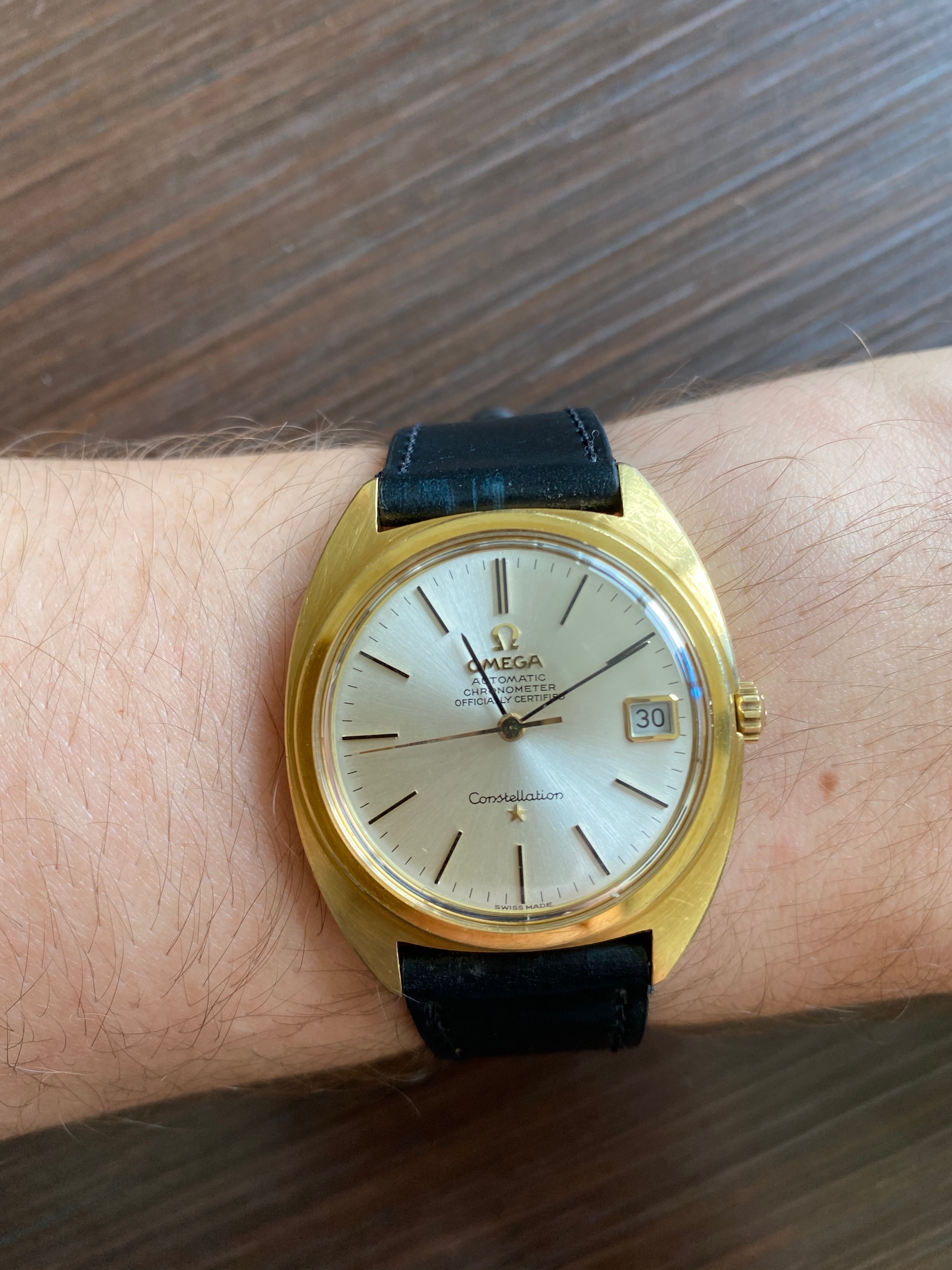

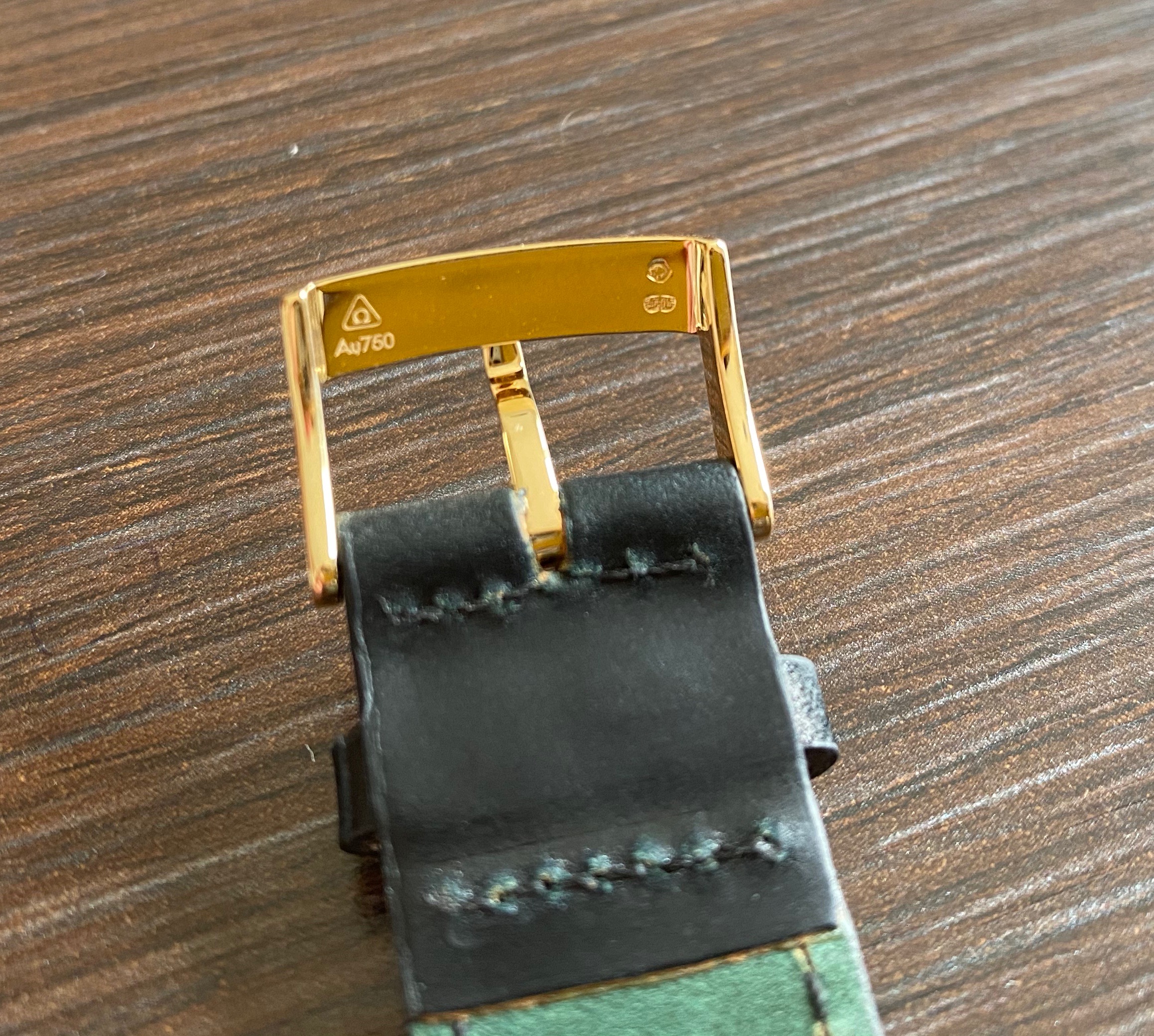

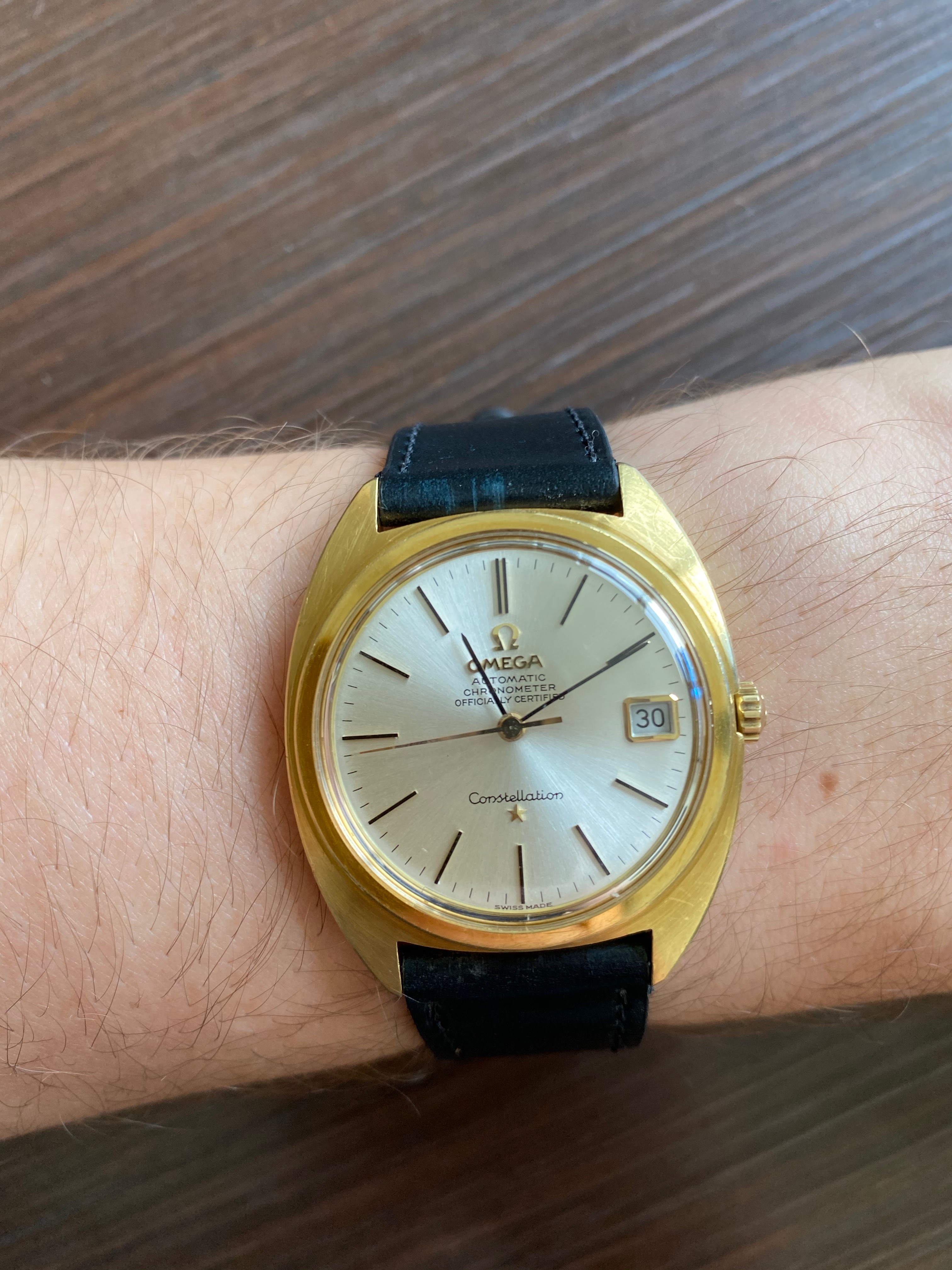

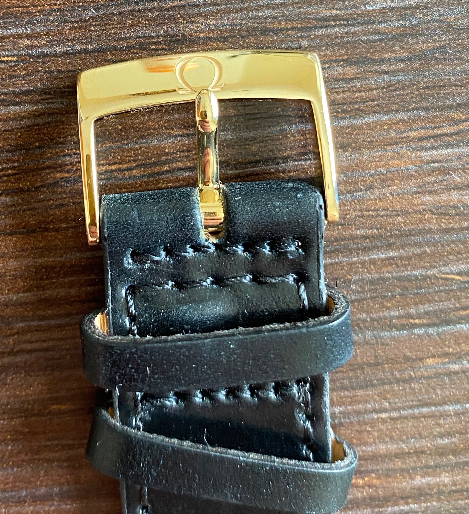

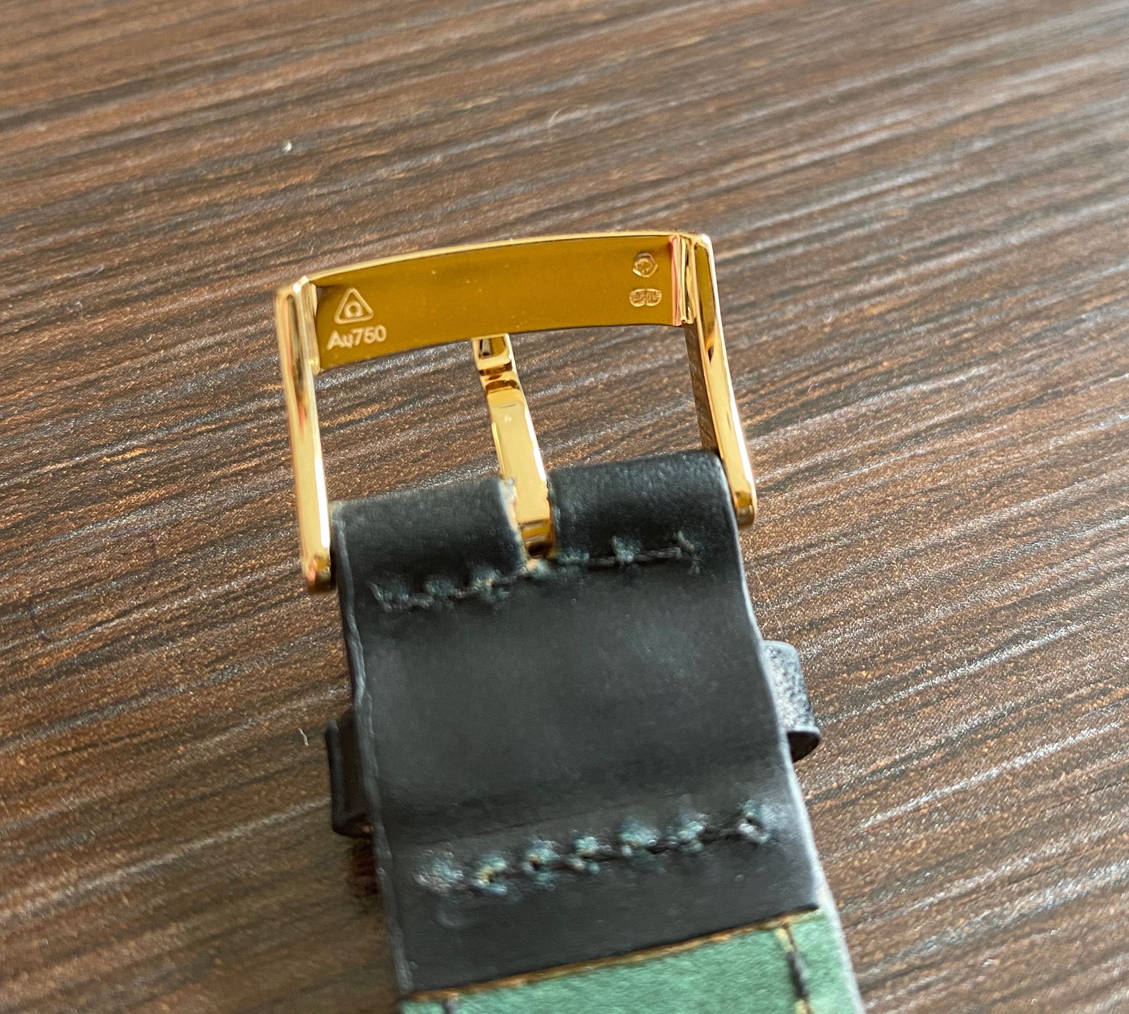

Went to my local Omega boutique today. Apparently you can order an 18k solid gold buckle. It was expensive (which is to be expected) but I went ahead and ordered an 18mm one anyway. Will update the thread again with a picture when I get it if anyone is interested.
35
19
"Got the call" yesterday. Here's the buckle on my connie. I think it's a great alternative if you don't want to wait and hunt around for a vintage one.
1,193
6,193
Great watch, great buckle. Enjoy!

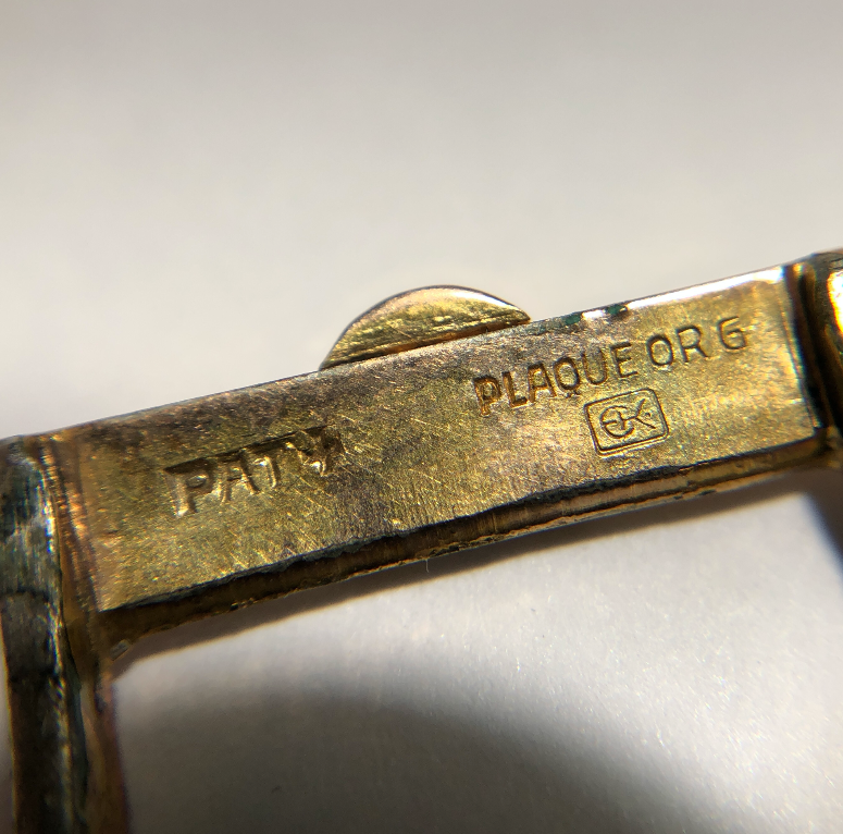

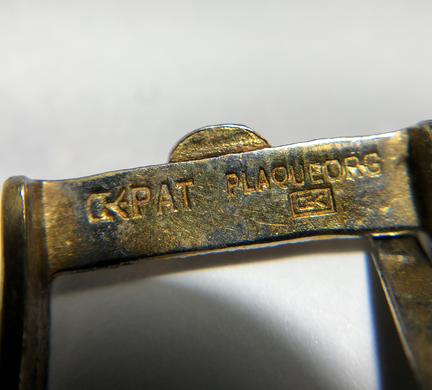

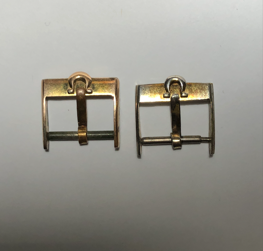

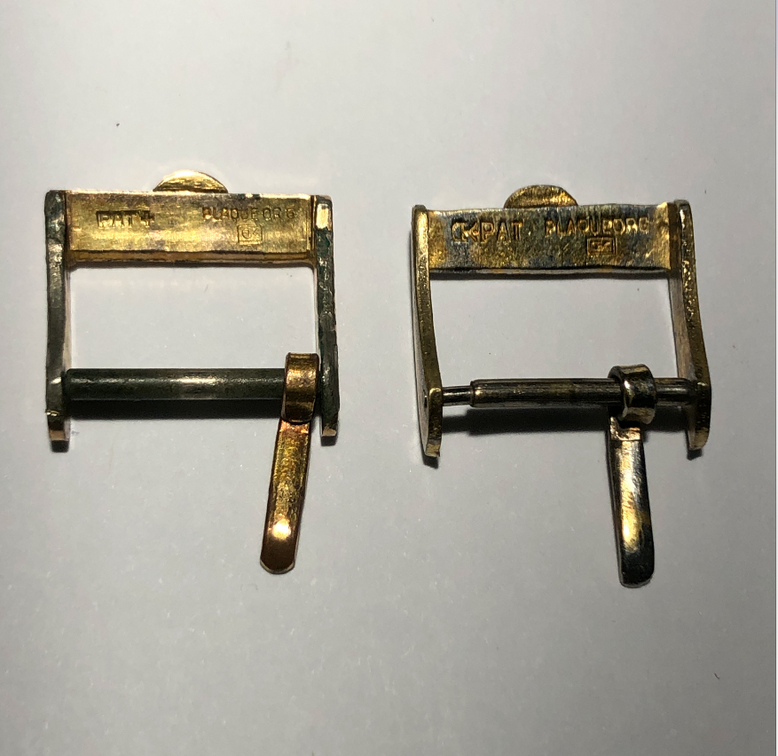

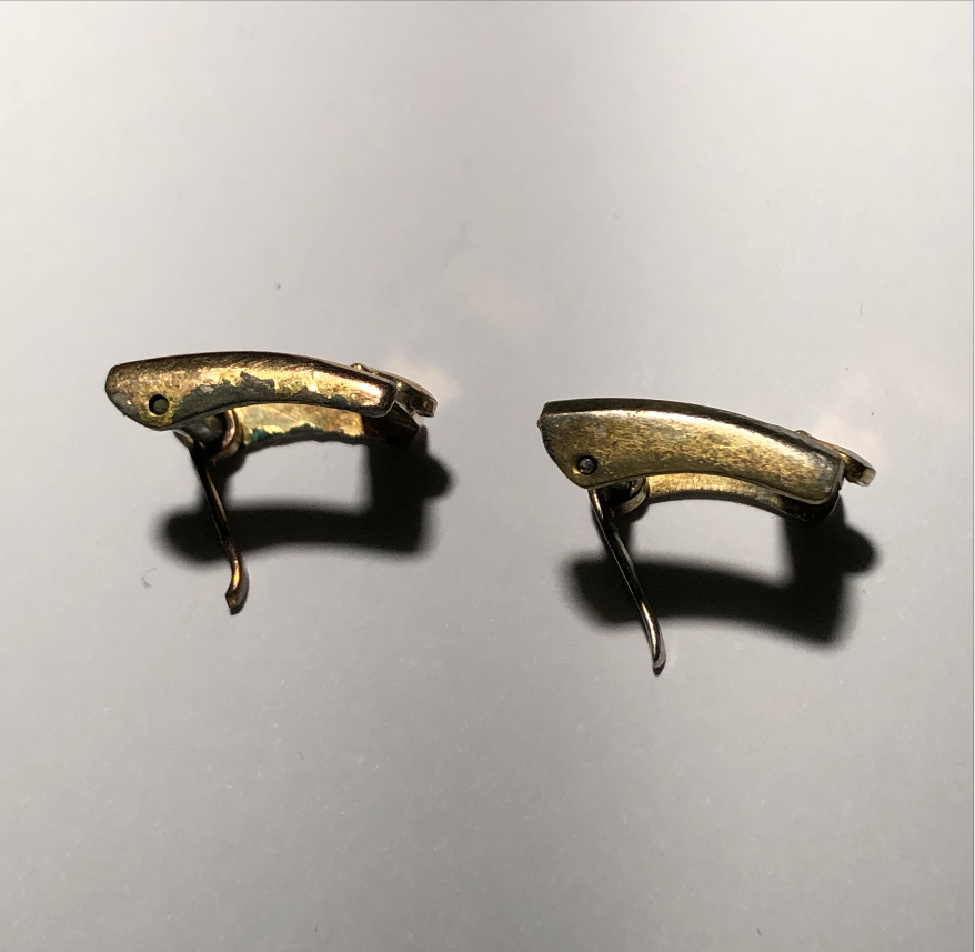

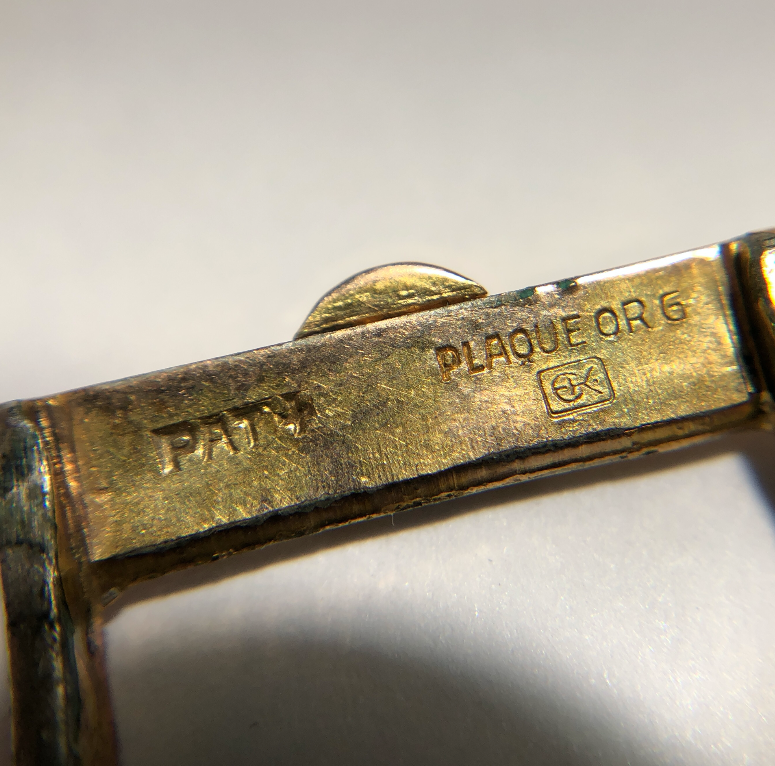

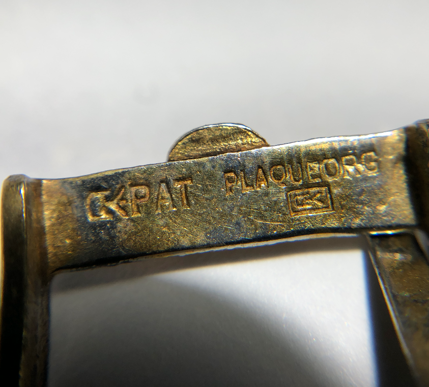

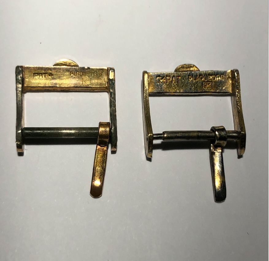

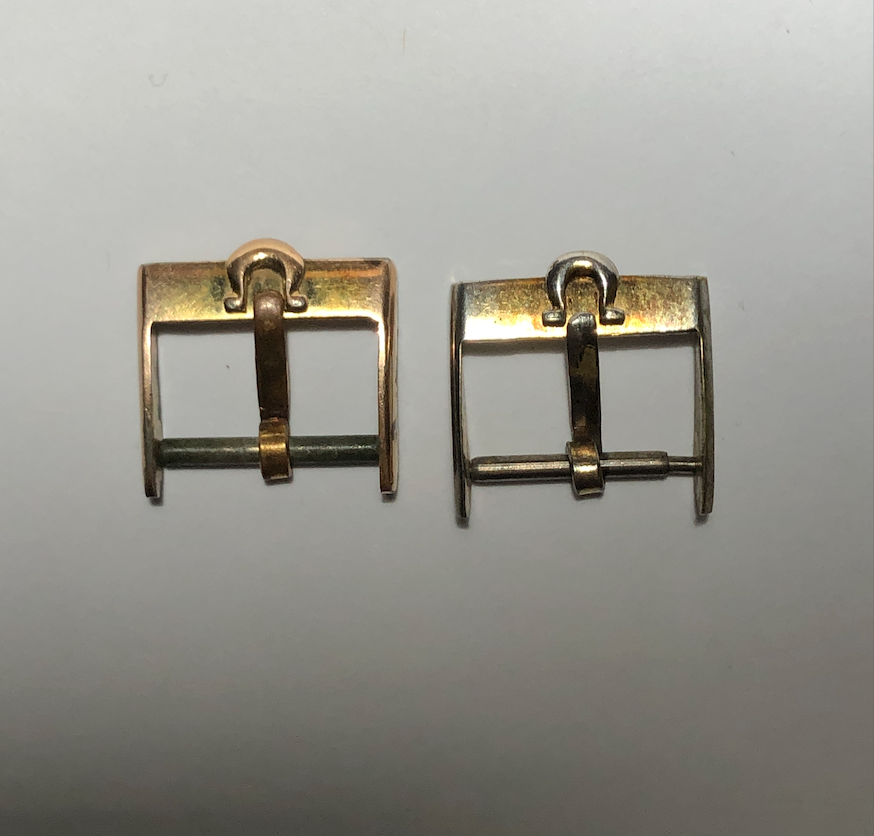

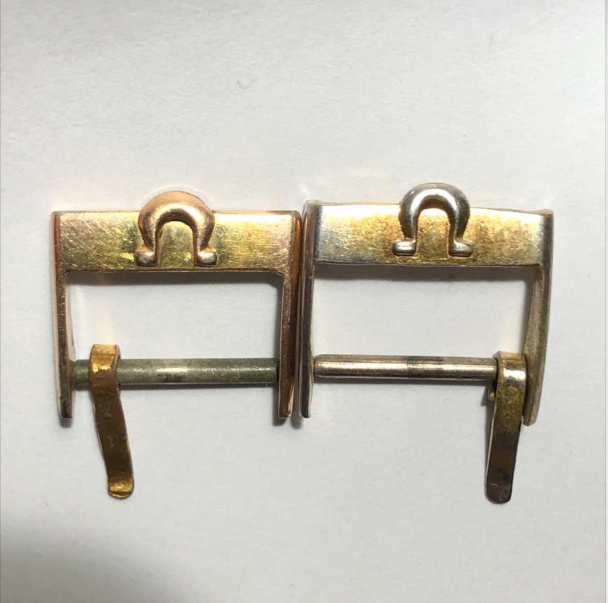

Went through the whole thread to find anything similar to these EK buckles I have. But quoting the above in case this is a sign these are incorrect or just odd examples.
EK "Plaque OR G" buckles.
Few weird things:
1. They both have different marks, "EK Pat" version seems to have wrong EK logo, and no spacing between words.
2. Slightly different profiles
3. Slightly Different Omega logos
4. "Pat +" version has flaking plating, while "EK Pat" version has fading "plating"
The "Pat +" version seems legit. The "EK Pat" version seems less so.
Haven't seen any fake EK buckles in this thread (Or I missed it) so maybe this is an example of what to look for.
Any thoughts?
Few weird things:
Any thoughts?
Thank you for this post.
I must acknowledge I cannot answer these questions. There are obvious fakes, there are also dubious items, but there are also the strange or particular ones that can be genuine. By the way, I can spot the fake solid gold more easily!
I would say the main issue concerning gold plated buckles is that it is hard to spot when a difference is the sign of a fake, or just a regular variation.

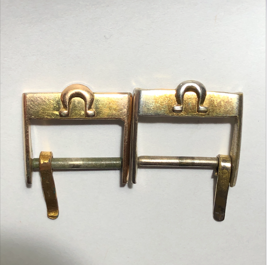

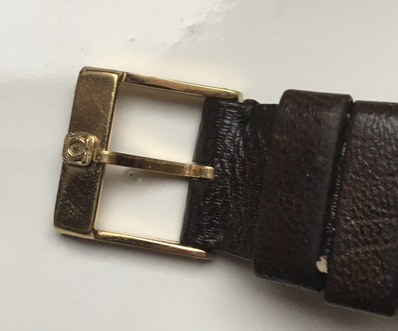

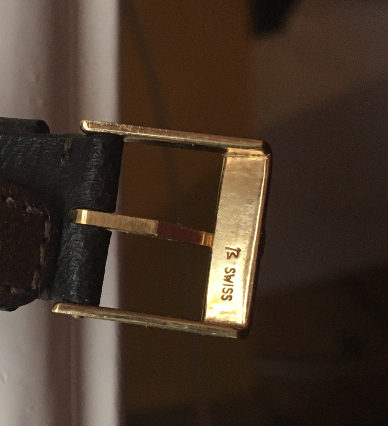

It is an original Omega buckle, not to worry! I think I may have made a post with my one somewhere within this thread. Nonetheless, here it is again.
Just lovely... I wish I could come across one like this 😀

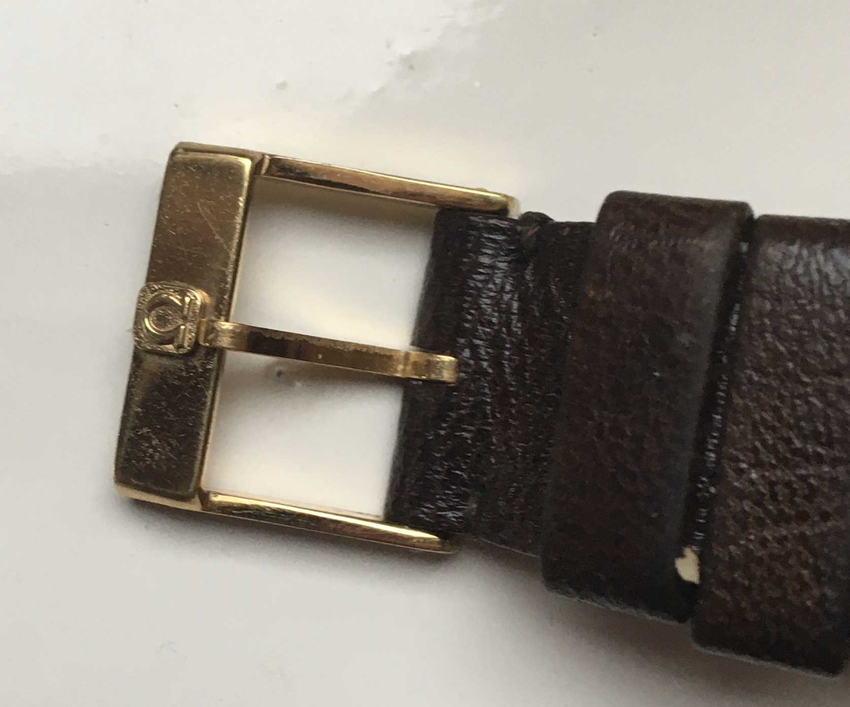

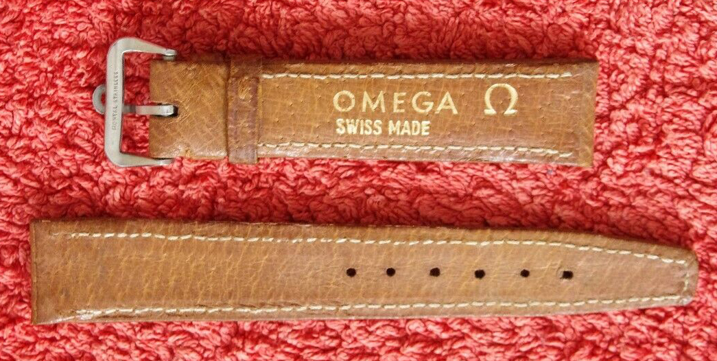

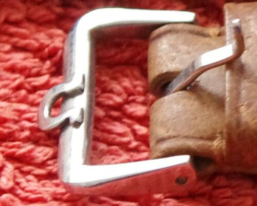

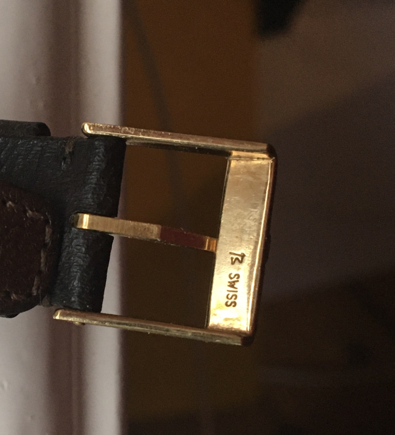

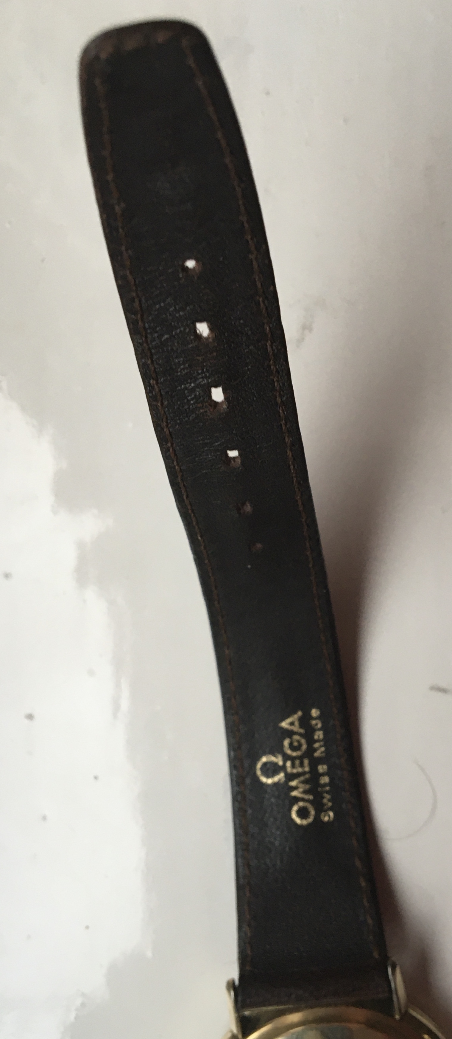

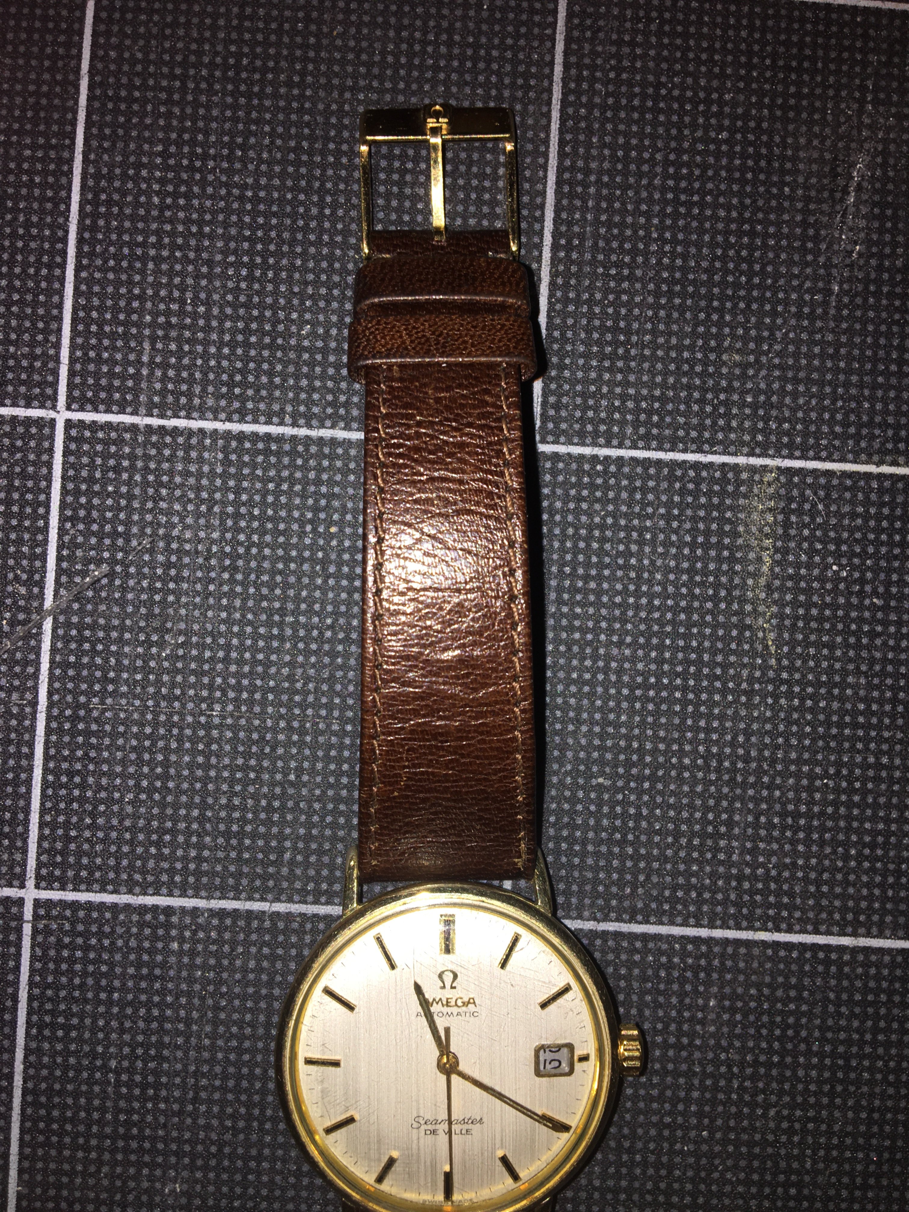

Here's mine. It came to me on a watch I inherited, but it wasn't an Omega. While it's a "B" it doesn't resemble any of the buckles on the OP. The strap is 18mm at the lugs tapering down to 14mm at the buckle. It doesn't look particularly vintage, but I really have no idea how old it is - any suggestions as to its age?
5,631
5,815
OEM is Banda, not uncommon, and late 60s to early 70s like the watch. Wouldn't be surprised if that's its original strap.
