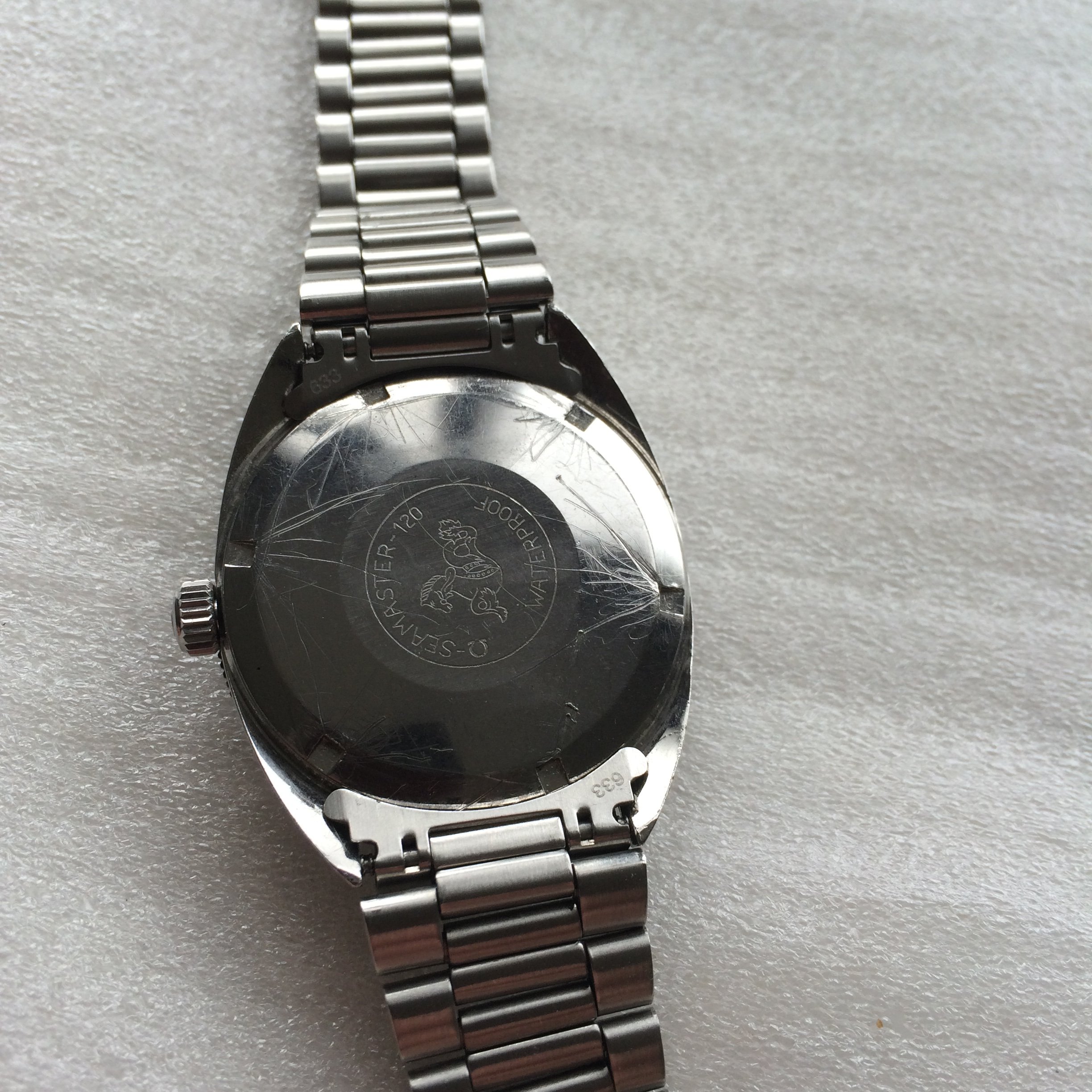

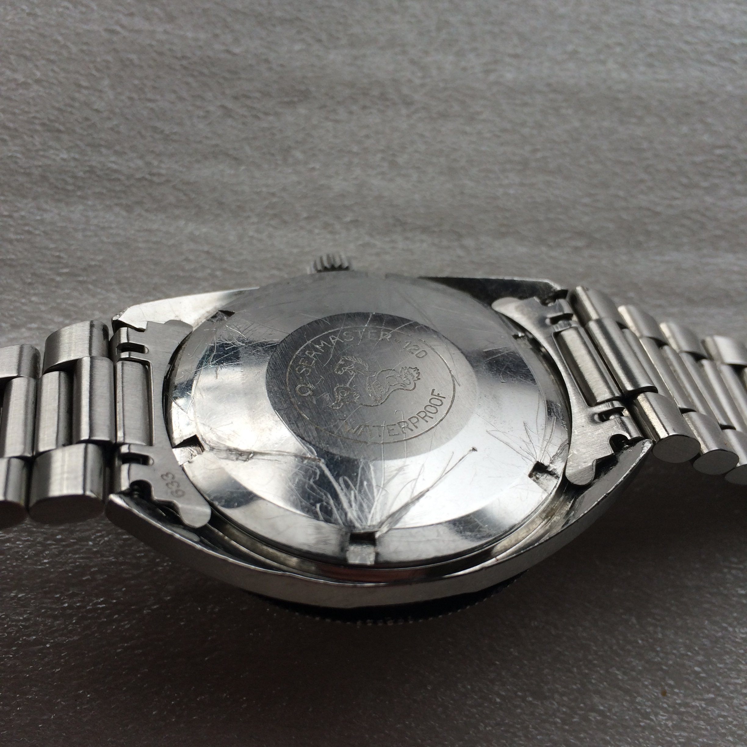

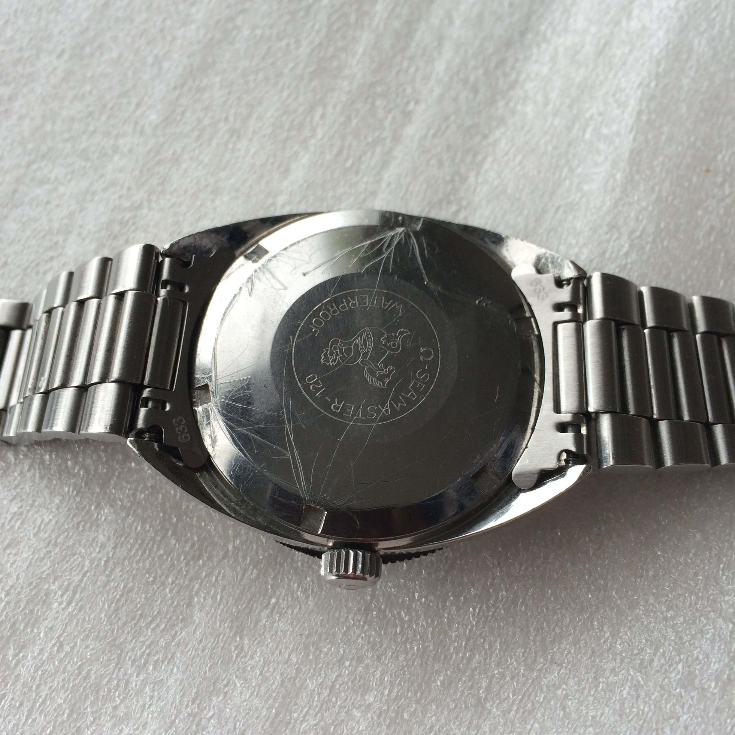

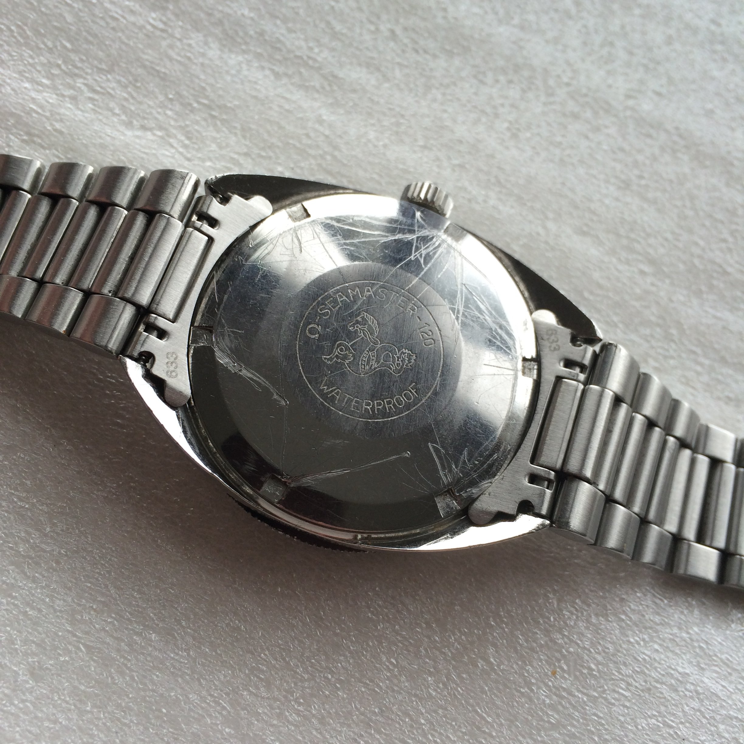

And when they are done scratching it, they add their signature to make it perfect:
(Damn Crooks')
