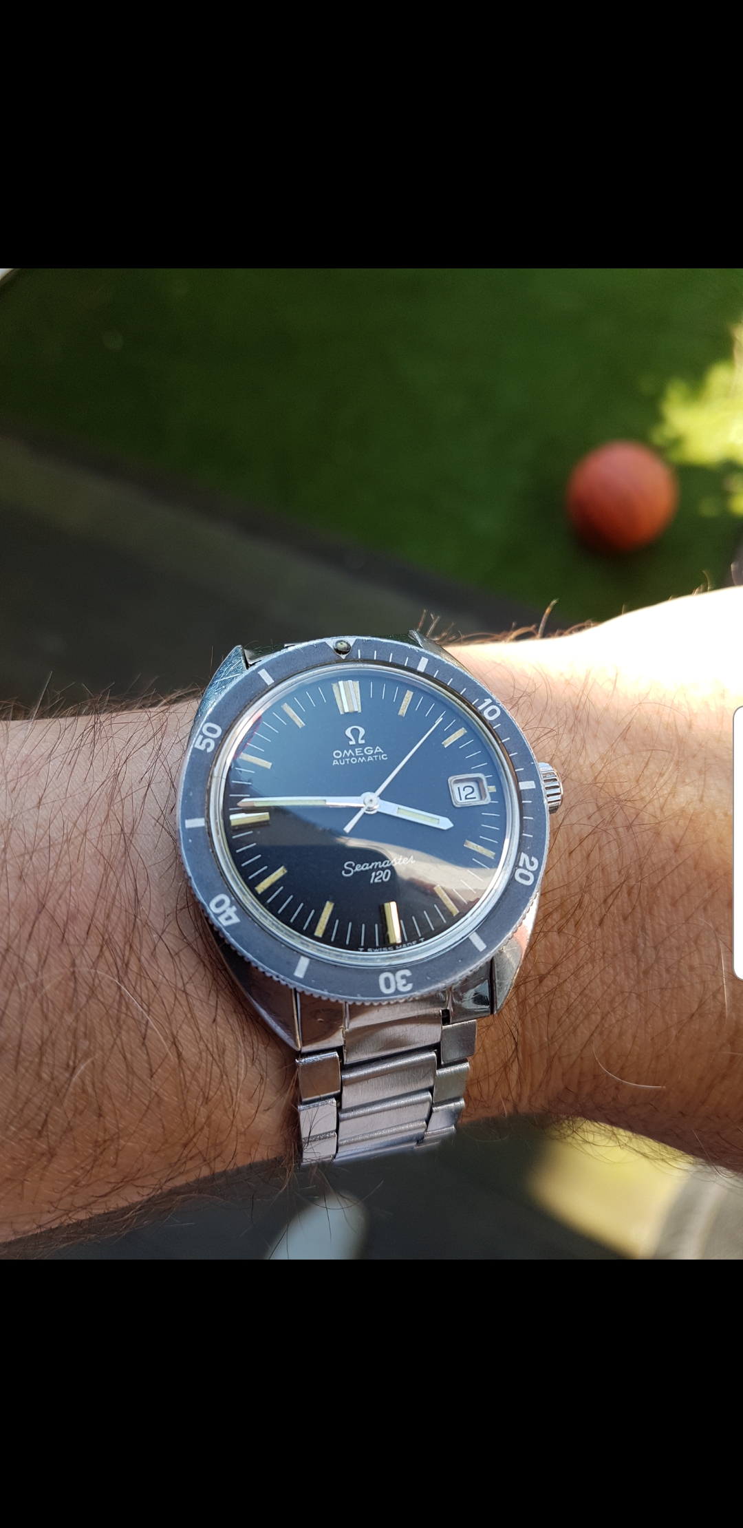

A typical fake Seamaster 120 135.027 cal. 601 serviced by OMEGA ?!

You guys think the service guys know every watch? You think they pull an extract on every watch sent in?
I see no reason for a non expert in this model to think it鈥檚 fake.
1,501
5,694
Bla bla bla, i know the guy who sells the watch. He send me this sheet from Omega. So, what is now fake? Who knows it better? Your bookworms or whatchmaker by Omega? Every Number is correct (sheet and card)
I find it bit weird that someone that never posted on the OF finds so much interest in defending the seller. Maybe you are the seller?馃槜 I think that I trust more the expertise of Collectors on this forum that Watchmakers at Omega that often have no clue about the vintage model they are dealing with.

Nope sorry, i'm not the seller. But i'm looking to buy the Watch and i'm in contact with the seller. I was yesterday look the watch in real and its looks great!

I think, when the watch serviced by Omega himself, there is originsl and not fake. Omega know the own watch at the best. Thats my opinion....
You give Omega far too much credit. The watchmakers at the service centers (larger service centers at least) don't typically even see the case, because they only work on the movements. It's people who are hired off the street and trained how to take the movement out of the case, remove the hands and dial, and they send the case off to the refinishing department. The movement is the only part the actual watchmaker touches.
The case is refinished, again by people hired off the street and given on the job training, and when they are done the movement, case, etc. go back to the same people who initially took it all apart to put it all back together. If you think any of these people, who are under time pressures just to meet their quotas, and to get the job done and out the door, are taking the time to carefully analyze case parts for authenticity, you are dreaming. No one is pulling extracts on the vintage watches that are coming in...
So in fact it's very possible for Omega to service a watch like this, and no one would have any clue that the case, dial, etc. is all fake.
If you believe the story and want to buy this watch, that's completely up to you, but now that the serial number is out there if you ever try to resell it, you will likely have a hard time, at least with any collector that knows better.
Cheers, Al - watchmaker and fan of the SM120's

So you know the seller personally? You're looking to buy it?

Yes i know him. I'm write with him in a chat. I don't know cause the buying. Its finisht on sunday. Why do you mean?

That everything that is being written in this thread is in your interest as a potential buyer to take notice of. I simply don't understand your defensiveness.

I take notice of this thread, sure. Its also in my intrest to buy a nice watch. For me its special because Omega does a Service and you say fake. Its a fake or its a replacement...for me two different things.
But ok, close this thread and will see for buying

LoL鈥unny that you are a willing buyer and just ignore all the advises given by well educated collectors. ::facepalm1::

True. Just buy the watch, but dont say we havn't warned you! Unbelievable....

The same seller is selling a banana version and also a SM 120 with a blue bezel all of them legit ?

I'm still wondering where that bezel is coming from. Was it replaced during service and is it a original omega replacement? I thought they did'nt make these anymore. Just curious

It didn't come from Omega...

To @Speedimaster, when @Archer is saying the bezel is 100% not omega (and if somebody knows, @Archer is the one) you also know you're buying something that is (at least partly) non omega authentic (fake). Of course you still can buy it if you like the watch, but you will have problems if you decide to sell it later. A collector wont touch it. General public wont know (if you decide to not disclose this crucial fact) but you have the obligation to tell them. And if you do, most of them wont buy it also. And even if it was a original omega replacement, you still have the problem It's not a original 60's bezel. Not to mention the rest of the watch (case, dial, movement, hands).
Other thing, nowadays you get a extract really fast. This way you can check if that movement belongs to a 120. It will cost you EUR 110 but than you have a bit of security. At least regarding the movement.
If it where me, I would run away from this one.
