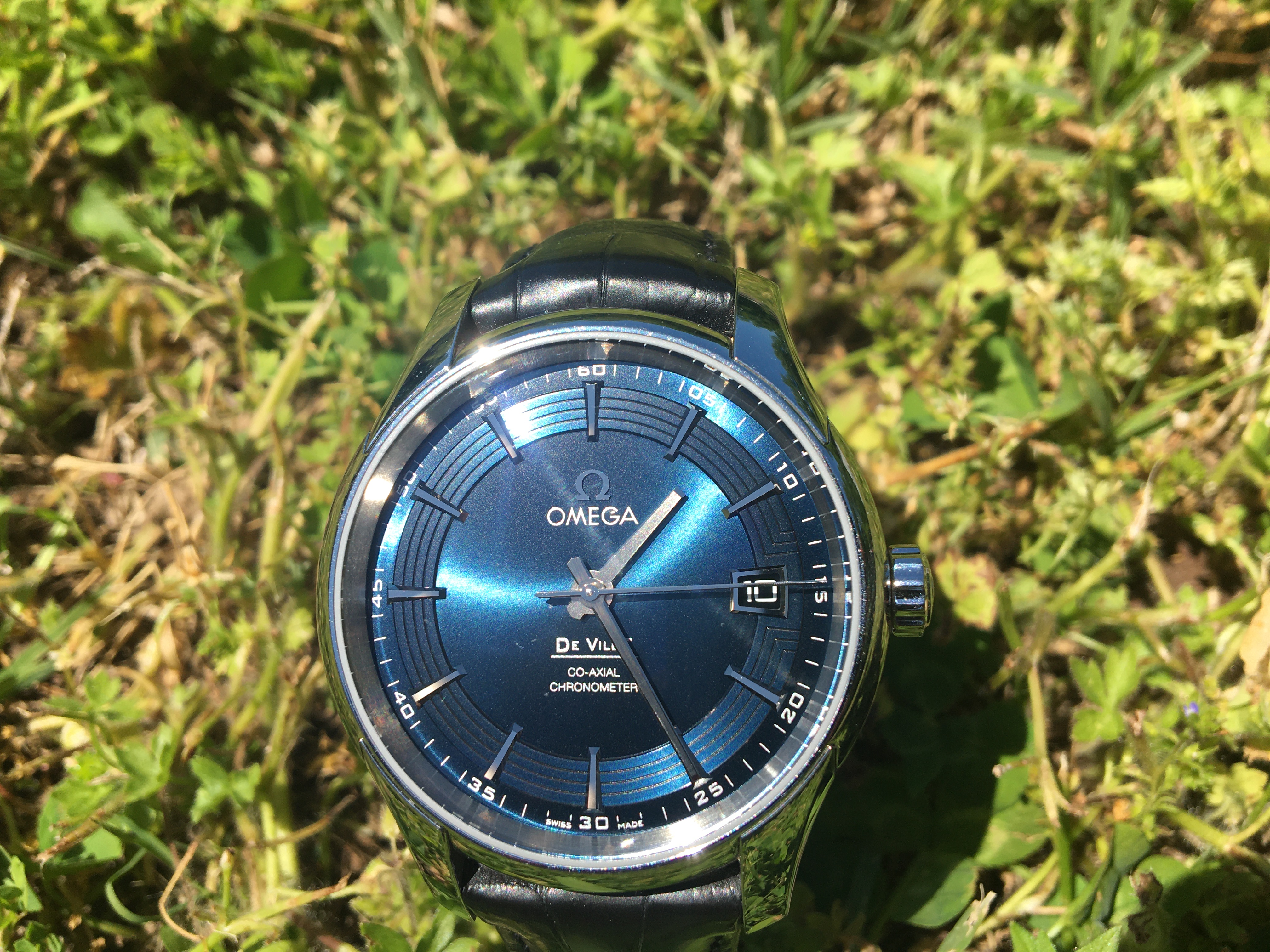

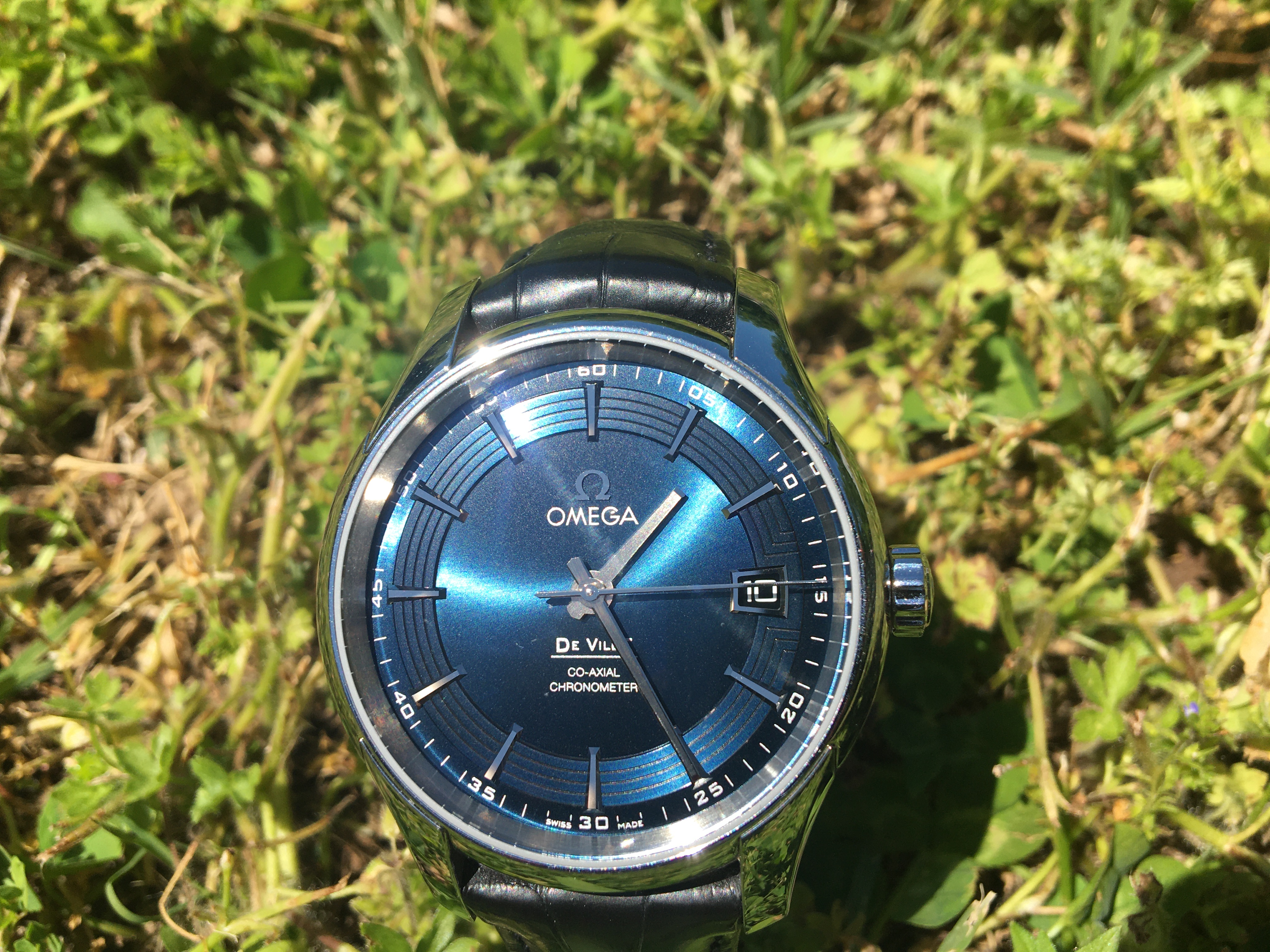

I've purchased this DeVille with the 8500 new in 2012. It's still working fine today.

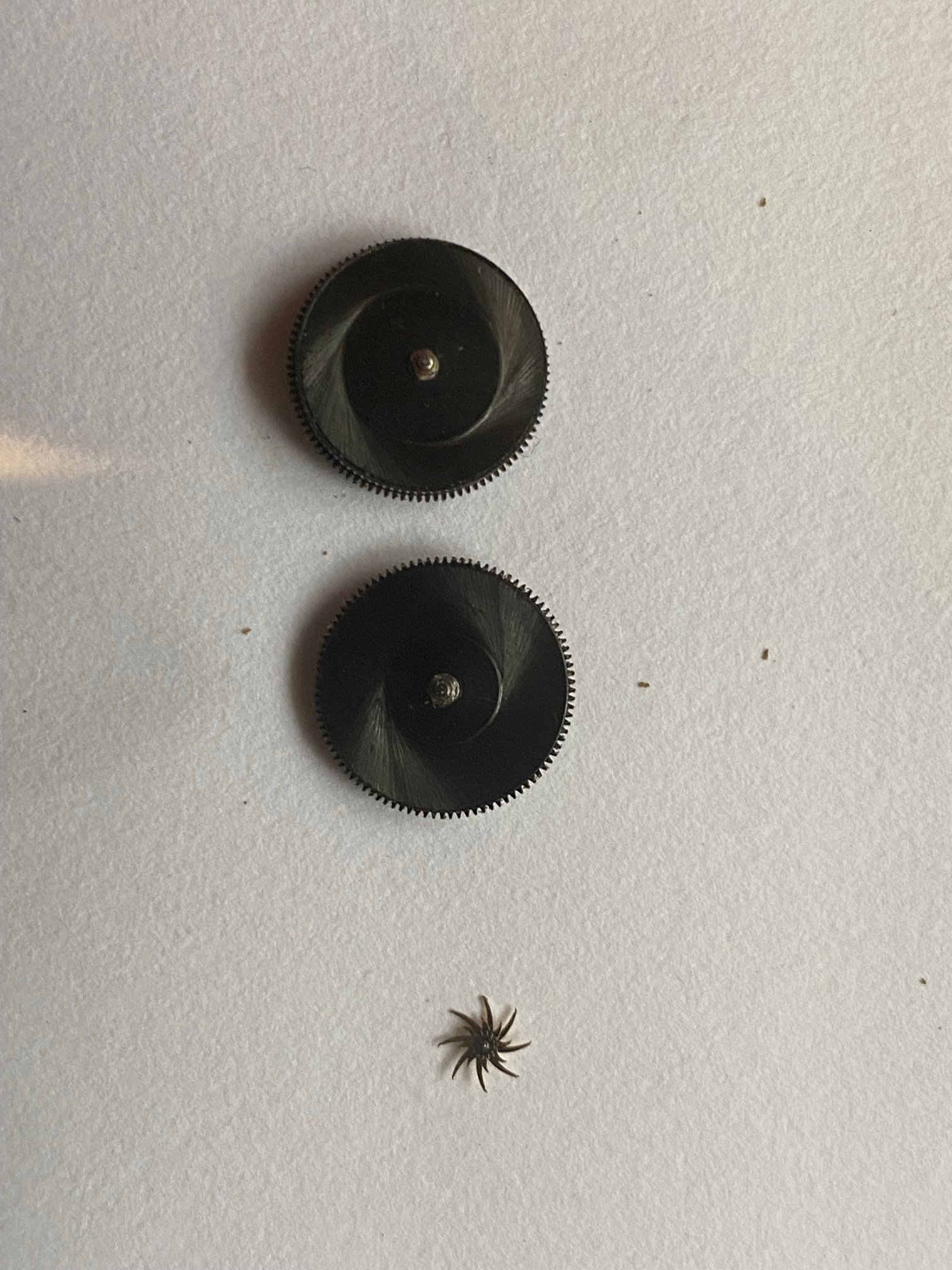

Purchased new in Aug 2017, worn every minute since... until 26th Dec 2021 when I dropped in for a service.......
P/C two days ago quoted $1700 to put back into spec, requires new main spring, new barrel and some other parts. I will update once I get it back and can more closely look at what was replaced.
Kinda smarts that after 4 1/2 years I am required to spend nearly 20% of my initial outlay on it.

Be interesting to know what the other parts are. From my understanding, any parts of the movement that need wear and tear replacement are included. Crown and any pushers are usually included as well in a full service (were on my X-33). So that leaves, case, crystal, bezel and any non-wear and tear. Barrel and mainspring have been well documented to be included in the fixed base price.

Tell us what the other parts are. There shouldn’t be anything extra charged for normal wear parts, so there has to be something unusual that is being replaced.

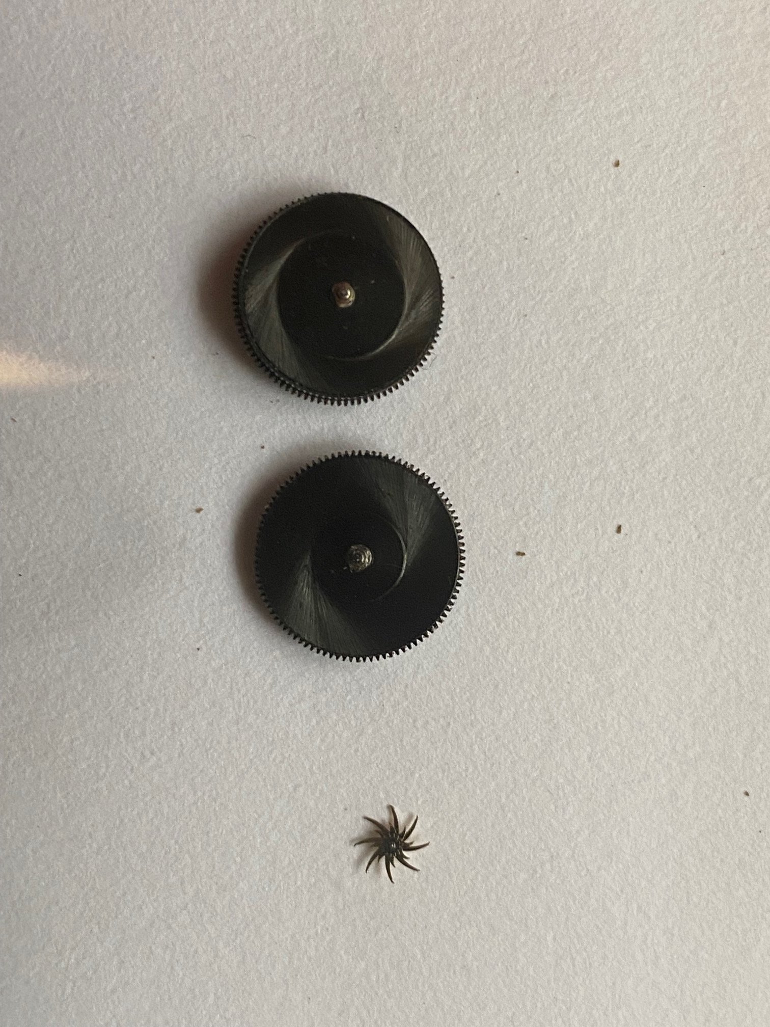

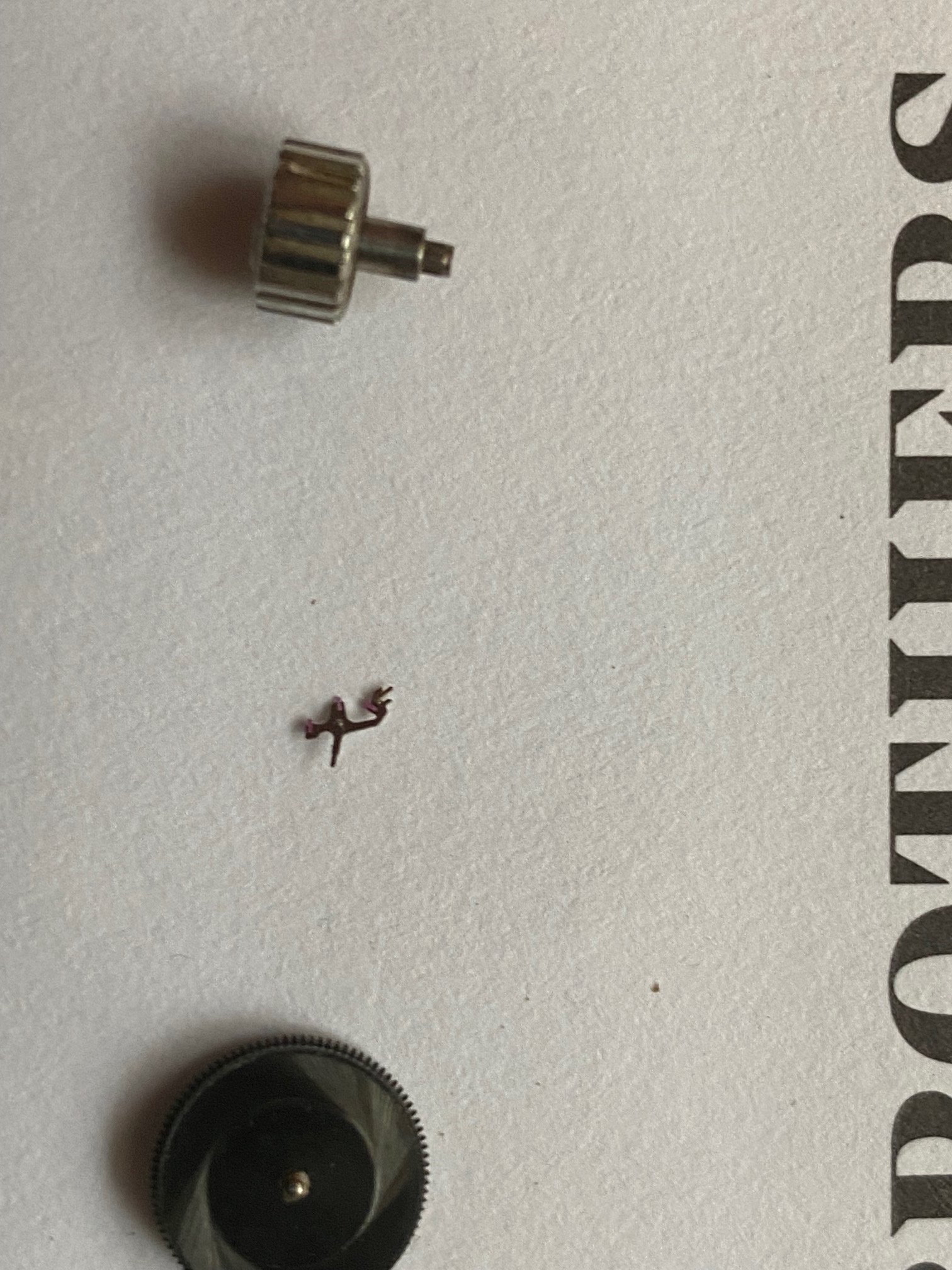

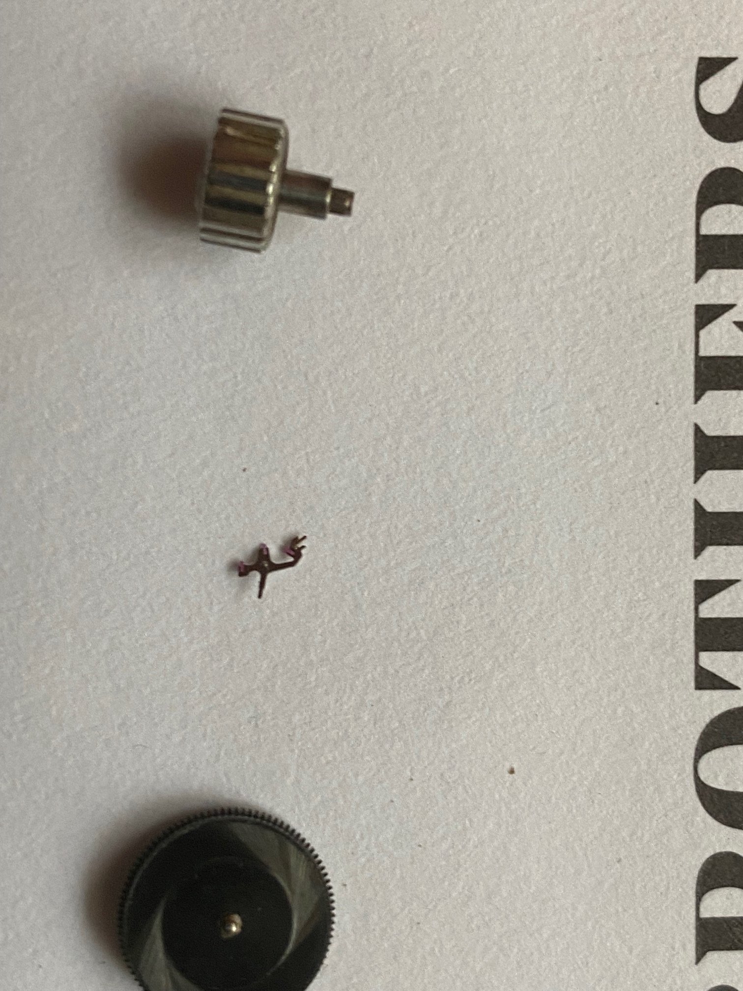

Service done, these are the parts returned with the watch...
There's nothing shown that would be outside of the ordinary replacement parts. This should have cost you what a standard service costs.
You should have received an itemized breakdown of the costs, so post that if you can.
