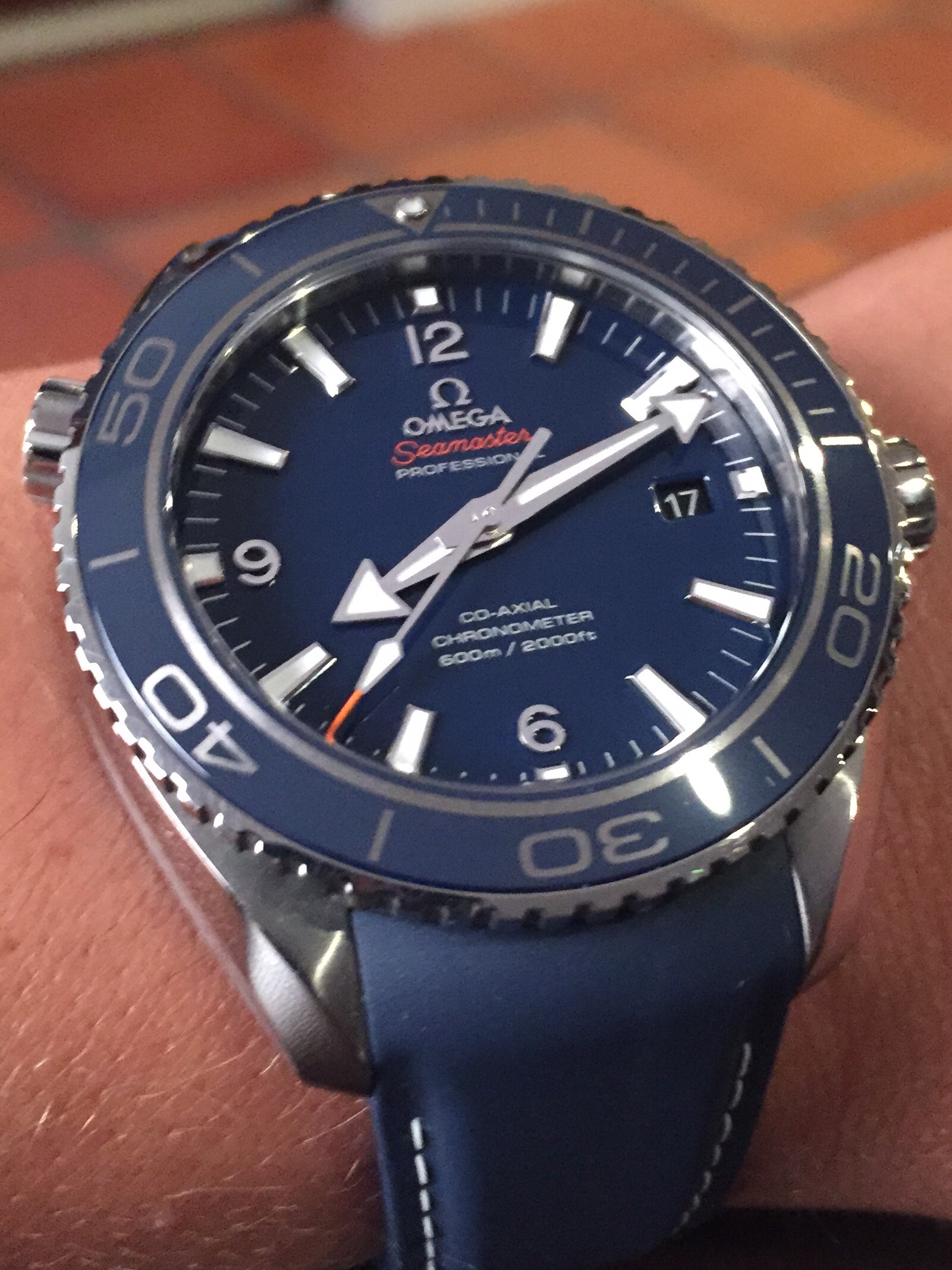

That is a sweet AT. Love the verts best. Love that date window.

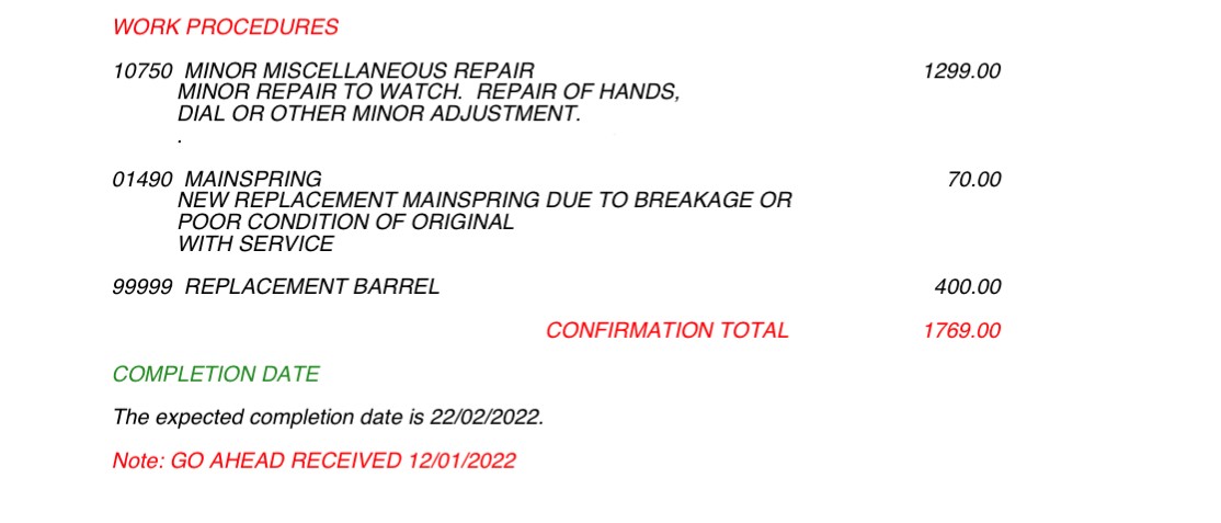

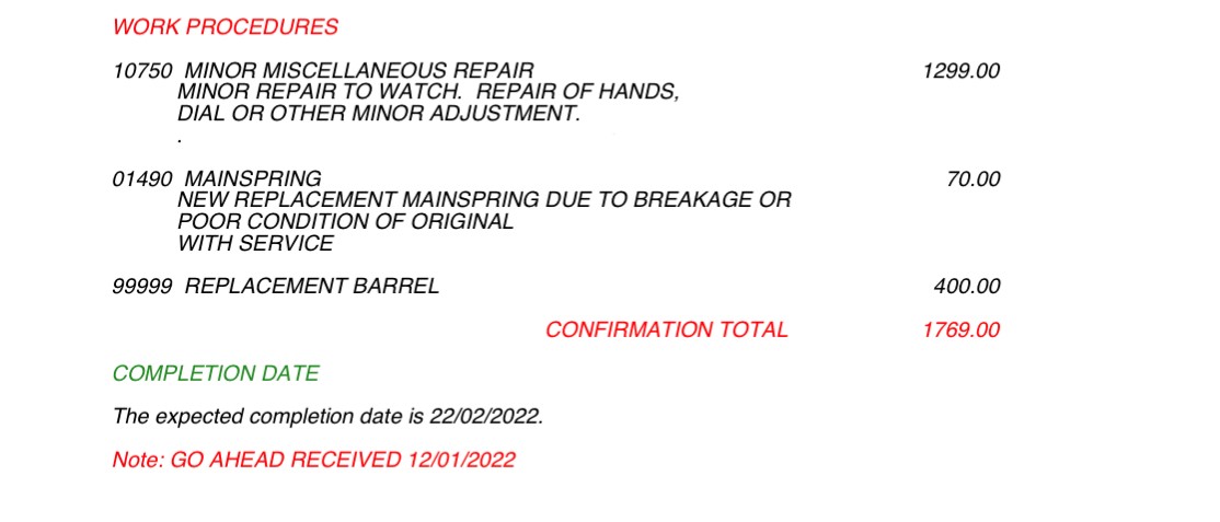

Ive cropped it to remove personal and dealer details
Doesn't look like an Omega invoice.
And why the charge for a mainspring and another for a barrel (x2?)?
I suspect it went to an AD who added some additional overhead.
Did this go to Omega, and what is the currency?
I think it's Aussie dollars Al.

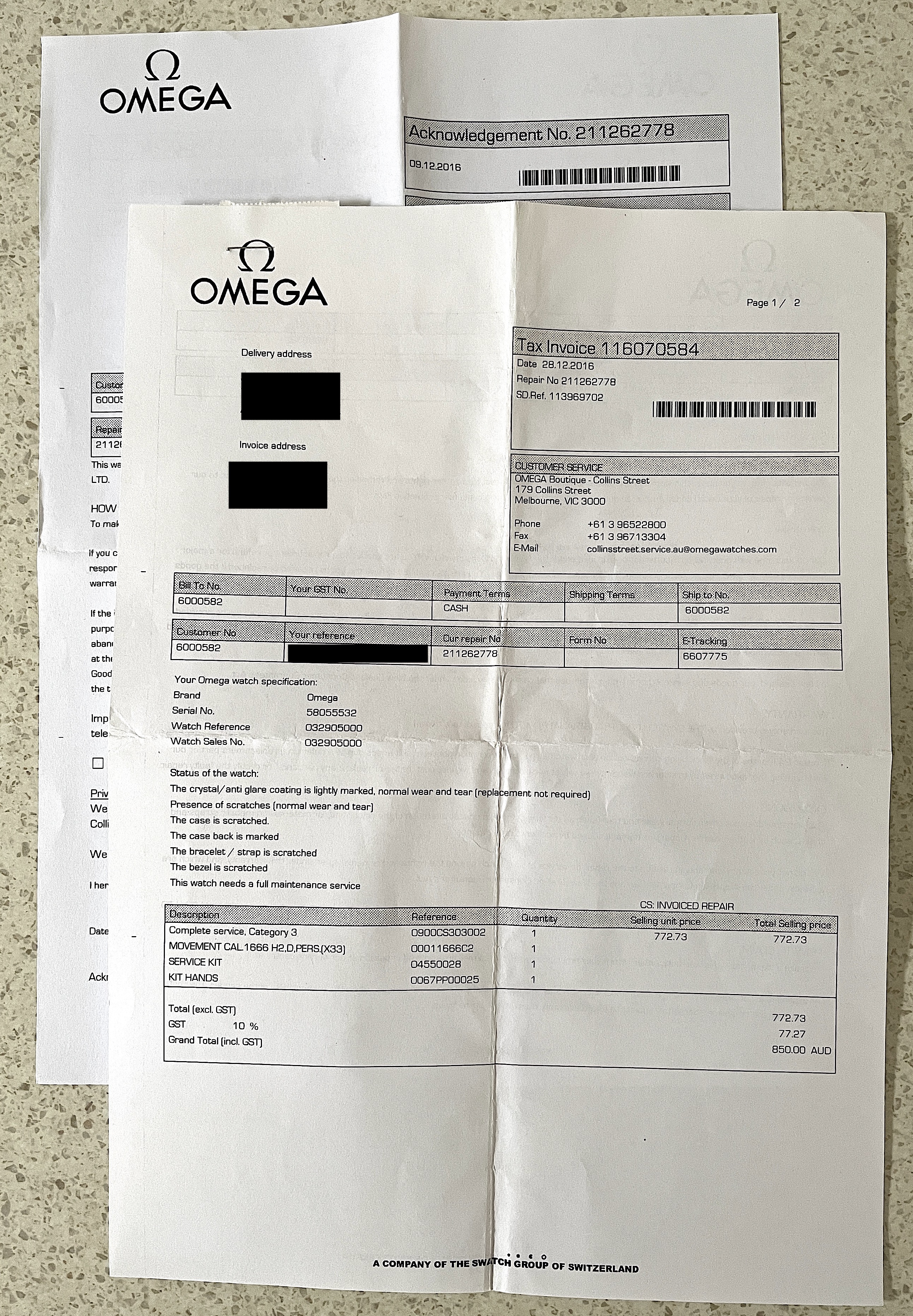

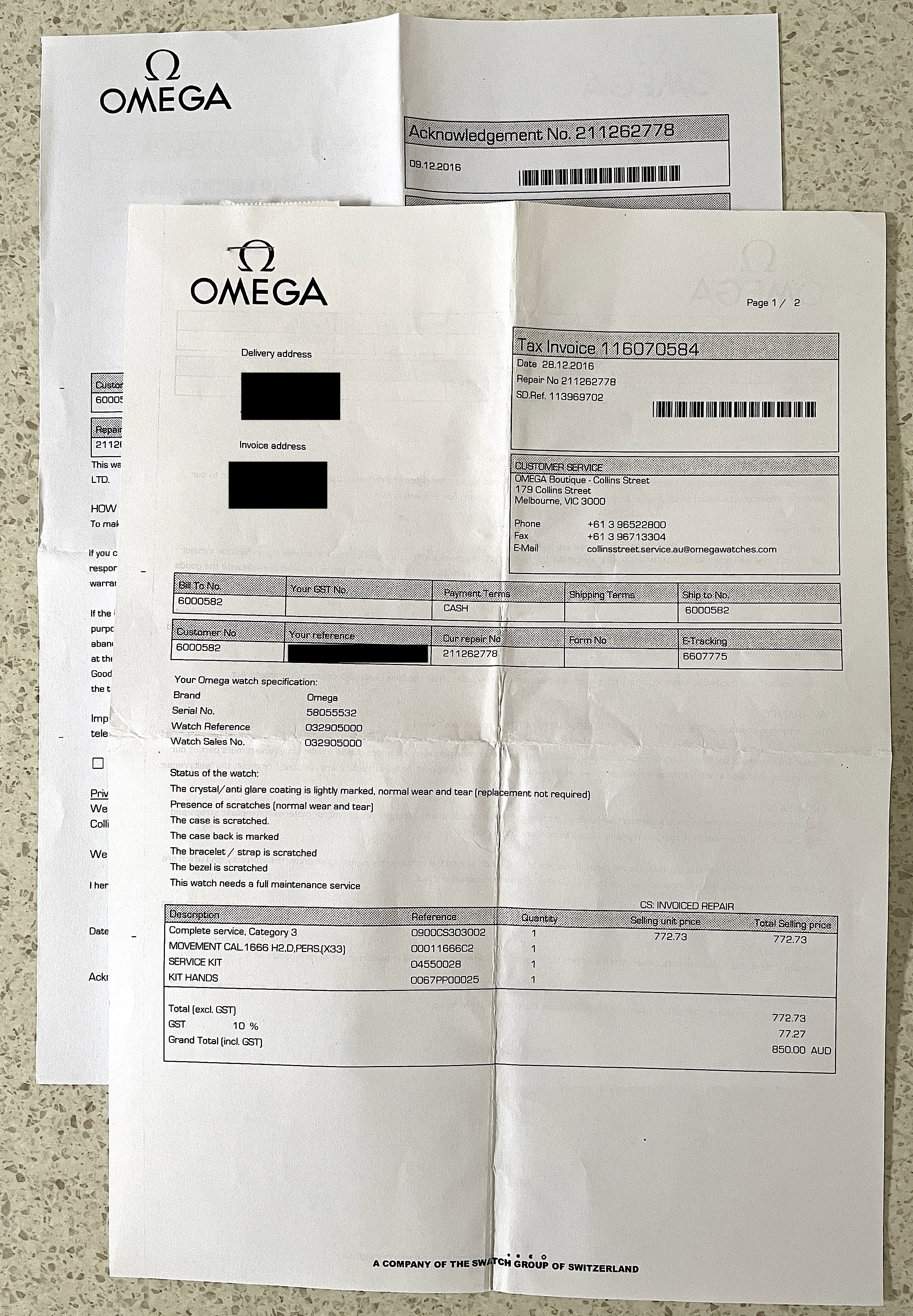

Unless Omega has changed their documentation, this is what you should receive from a Service Centre.
Note: Not all of the boutiques and dealers listed on the Omega website are actual "Service Centres" where the watch is actually serviced.

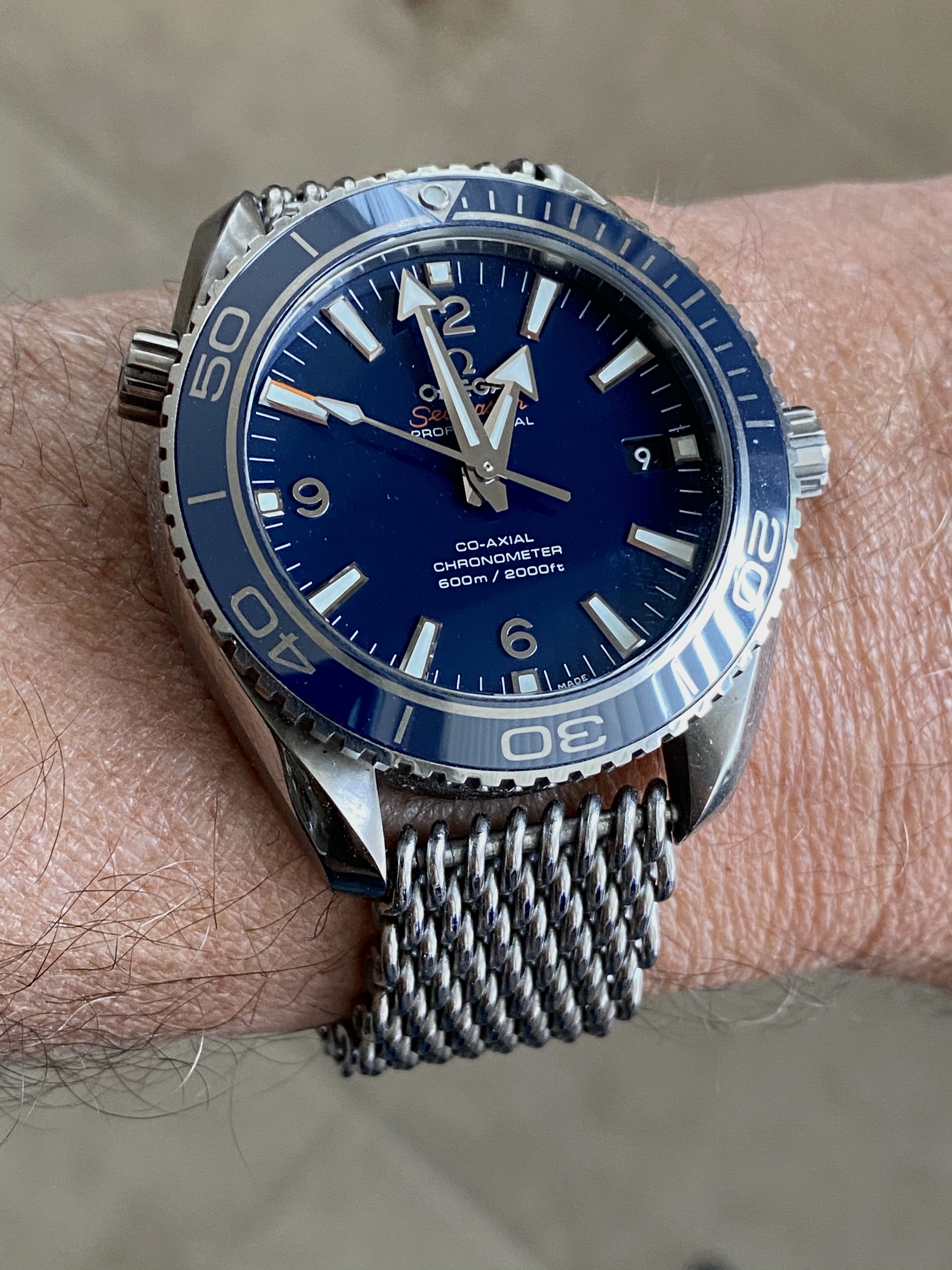

My 2nd gen Titanium PO which has the 8500 has had zero issues so far and still runs 1-2spd. It's one of my most accurate pieces.
Just like mine.

So on the mainspring and barrel...
There are two mainspring barrels in this watch, so it's possible that it could need both a mainspring and a complete barrel. However, even with taking Aussie dollars and possible market differences in pricing into account, both are very expensive compared to the prices I see. If I convert the cost of the prices I see for these items to Australian, the mainspring is about $49 Australian, and the mainspring barrel complete would be around $191 Australian. So on the second one in particular, they have marked it up by approx. 100%
