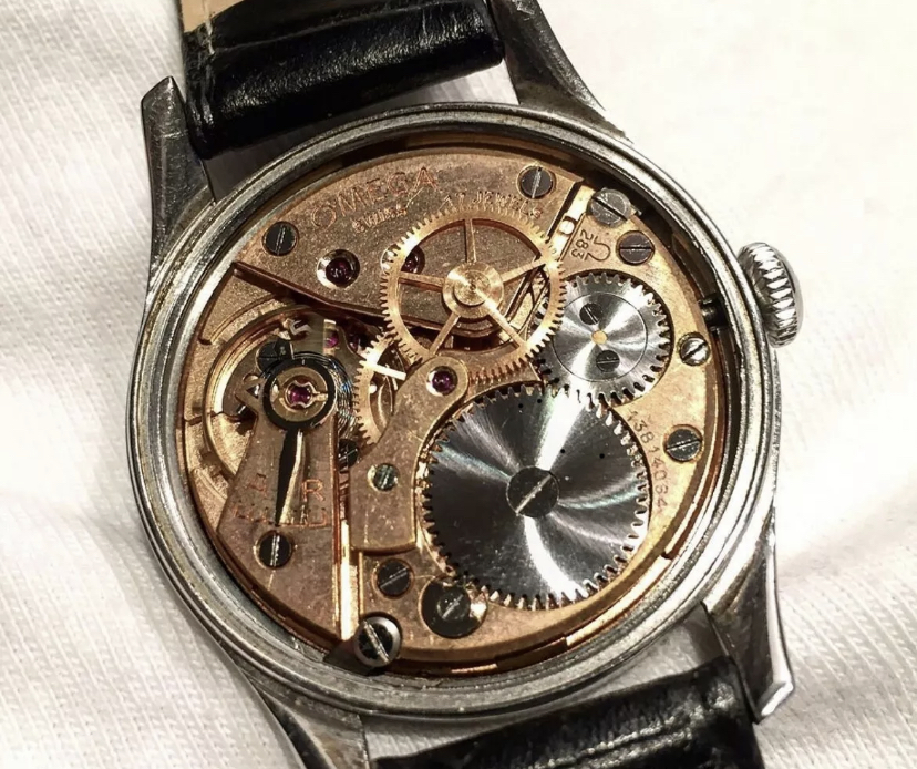

Hi Folks
I’m new to this, so can anyone help please.
What do does the number 1384084 mean with number 283 on an early Seamaster and can I pin this down to a specific year. Thanks for your help

Where is the number? The movement? Photos are your friend if you want information.

That serial number is from 1953
Not unless there’s a digit missing. 1953 is 13milion, not 1.3 million.

283 is the movement number. Pics would sure help.

Post good photos, it will avoid a lot of confusion.
Since I doubt the watch is from 1894, I think the most likely scenario is that he forgot a digit.

Oooops. As you say….missed a digit. its 13814084. (It’s an age thing. I was born 1948, so am looking for a watch the same age. No logic there, just think it would be fun to see who goes on the longest

If you are looking for something from 1948 then you need something with a circa 11.25 - 11.5m serial. Another way would be to get a UK cased gold watch and date it from the hallmark but be aware that many of the assay offices changed date letter in the middle not end of the year so a given letter actually spans the end of one year and the beginning of the next.
