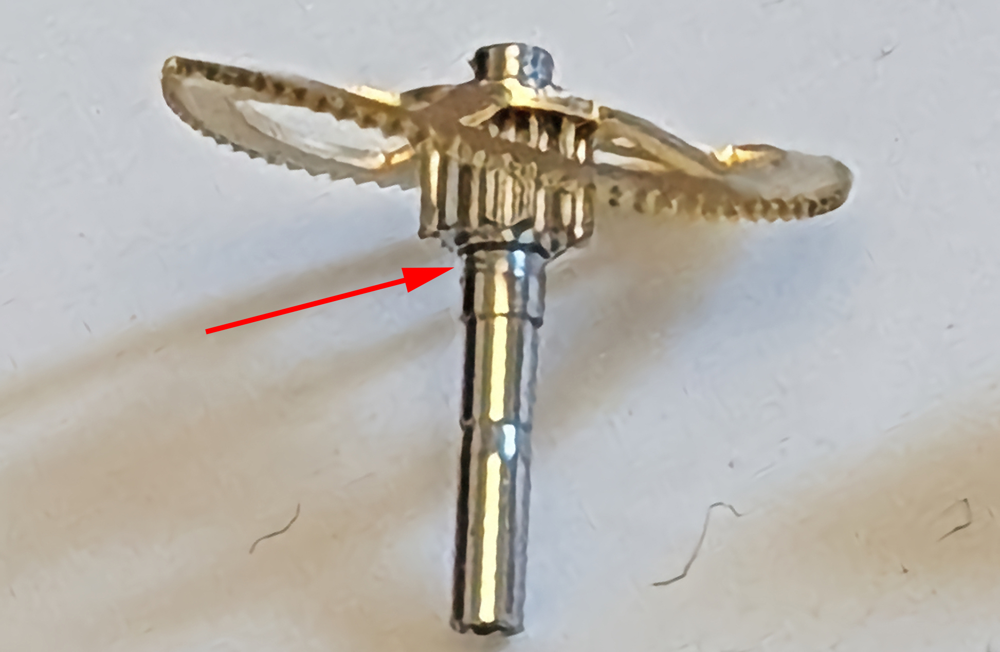

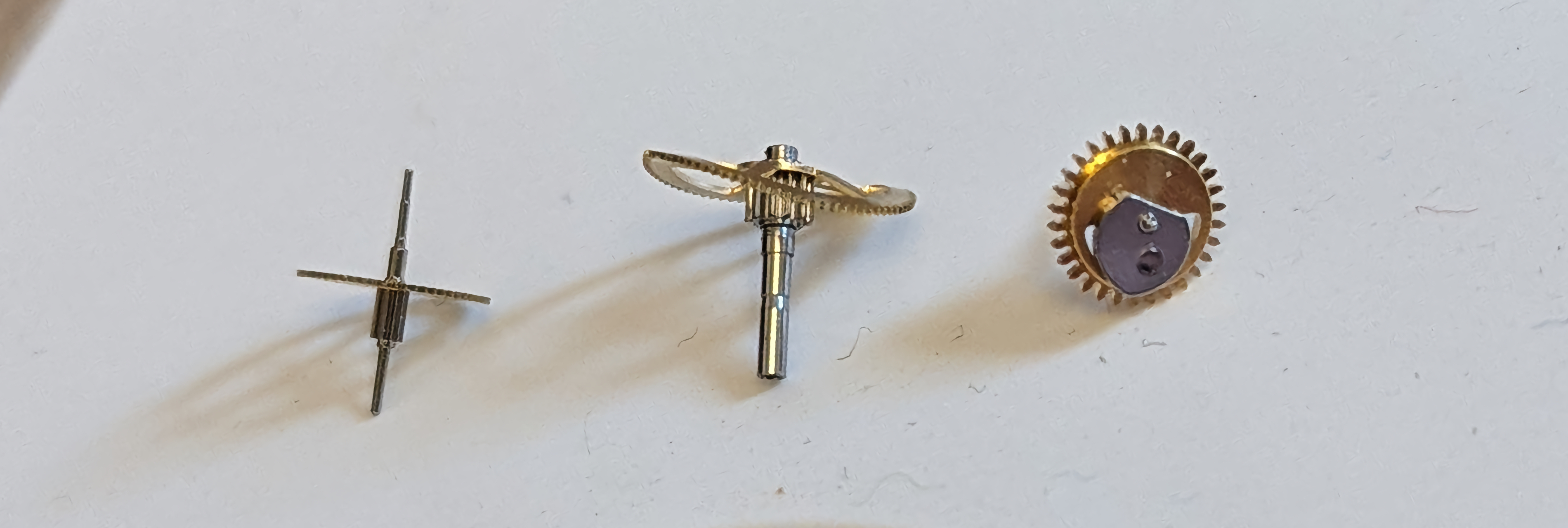

Hi all, this is my first post here, and I would like to thank you all for discussing the " center wheel" issue here. I've worn my new Speedmaster for about 4 months (daily) and then it stopped, and it seems it was caused by this issue. It took almost 4 months but Omega has now returned the watch to me, including the replaced parts. I was a little bit shocked when I saw the center wheel, either something strange happened inside the watch, or the wheel was removed with a lot of force. Any ideas what could have happened? And why not only the center wheel was replaced but also two others wheels (and also the mainspring by the way..).
These get put into bags, right? IMO it's possible the wheel could've just gotten stuck at an angle, and maybe someone accidentally put something on top. Not like these parts are supposed to be reused anyway.
The bent wheel is damage done after it was removed, and not the problem that caused your watch to stop. No watch would run at all with a wheel that looked like that. Possible it was dropped on the floor and stepped on or something.
The real issue here in this cropped photo I've made from yours:
You can see where the red arrow is, that a section of the wheel has worn and is quite a bit smaller than the section directly below the arrow. This whole section should be the same diameter, and should be a polished cylindrical shape. The wear here is obvious, so this is the problem that is addressed during the service, not the bent portion of the wheel.
This is a large amount of wear for just 4 months. I would typically see this sort of wear only after many years of service, running in a watch where the oils have long dried up. I suspect there is some wear on the upper part of the picot as well, above the bent wheel, but the angle of the wheel prevents me from seeing it.
Cheers, Al
