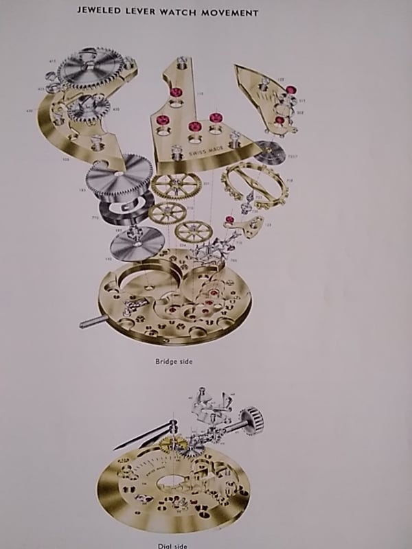

I am reading back through this thread, I need to educate myself on what the issue is with this movement. So far I have not experienced issues, and the time keeping has been well under 1 second per day, under .5 seconds actually last time I checked. I do wind mine fully every day, even if I don't wear it that day.
184
83
2nd wheel, it takes the power from the mainspring barrel.
This wheel transfers the power to the dial side, is hollow for the sweep seconds chrono hand in this case. There is all that torque fom the main sping barrel [ 1st Wheel] putting a lot of pressure on the axel of that wheel. #201 in ie.also called a center wheel.
If you want some basic information & illustrations on watches, pick up even an outdated watch collectors book. They packed a lot of basic info. into there books, plus you see which watches are considerd rare.
Cheers ! MIKE
