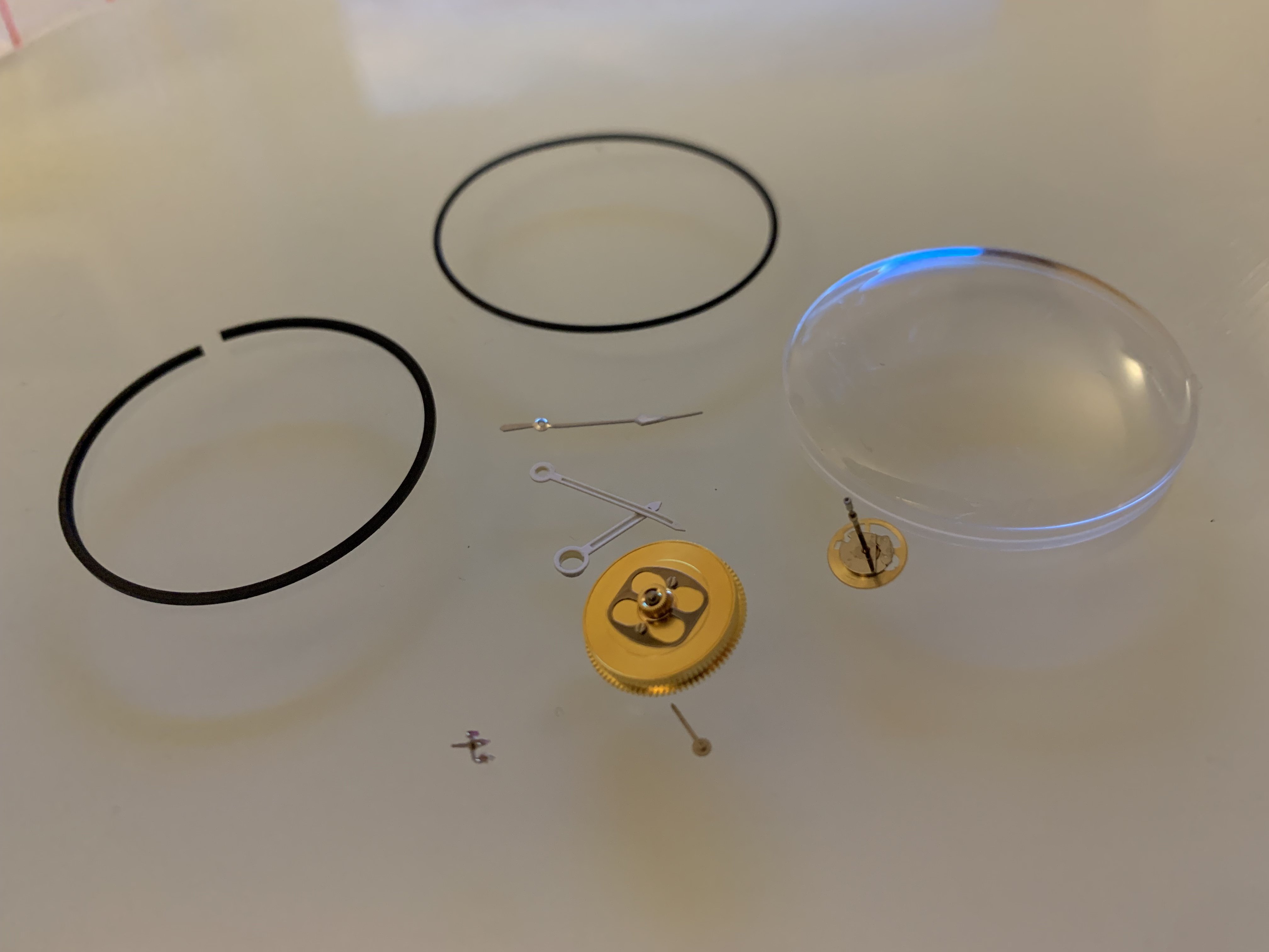

Watch is at Omega SC now. They haven't called my yet, but I can track the progress online and the only thing they've reported is that the watch is not functioning within the tolerances. They have ordered some parts, though the description is very cryptic, unless someone can make any sense of these numbers: O065Z013161, O066Z013160, O066Z013169

Those are hands for the watch...

I bought the 3861 hesalite beginning of August and after one month it became suddenly very very hard to wind. I gave it back to my AD and 2 month later it came back with a full service, replaced parts (including crystal, hands, …) and a transport case. Of course it was all taken under warranty. Now winding is smooth as butter, even smoother than when it was new.
Even if it took quite a long time, I am happy with the Omega service and don’t regret my purchase.
Wait, what?!! So I gave them a full description of the issue, even provided a link to this thread, and they’re replacing the hands!? 🍿

Hands are routinely replaced at servicing...

My new 3861 that I sent in for Power Reserve issues was returned last week with the original bad part they replaced along with the original hands that they also replaced. Go figure?

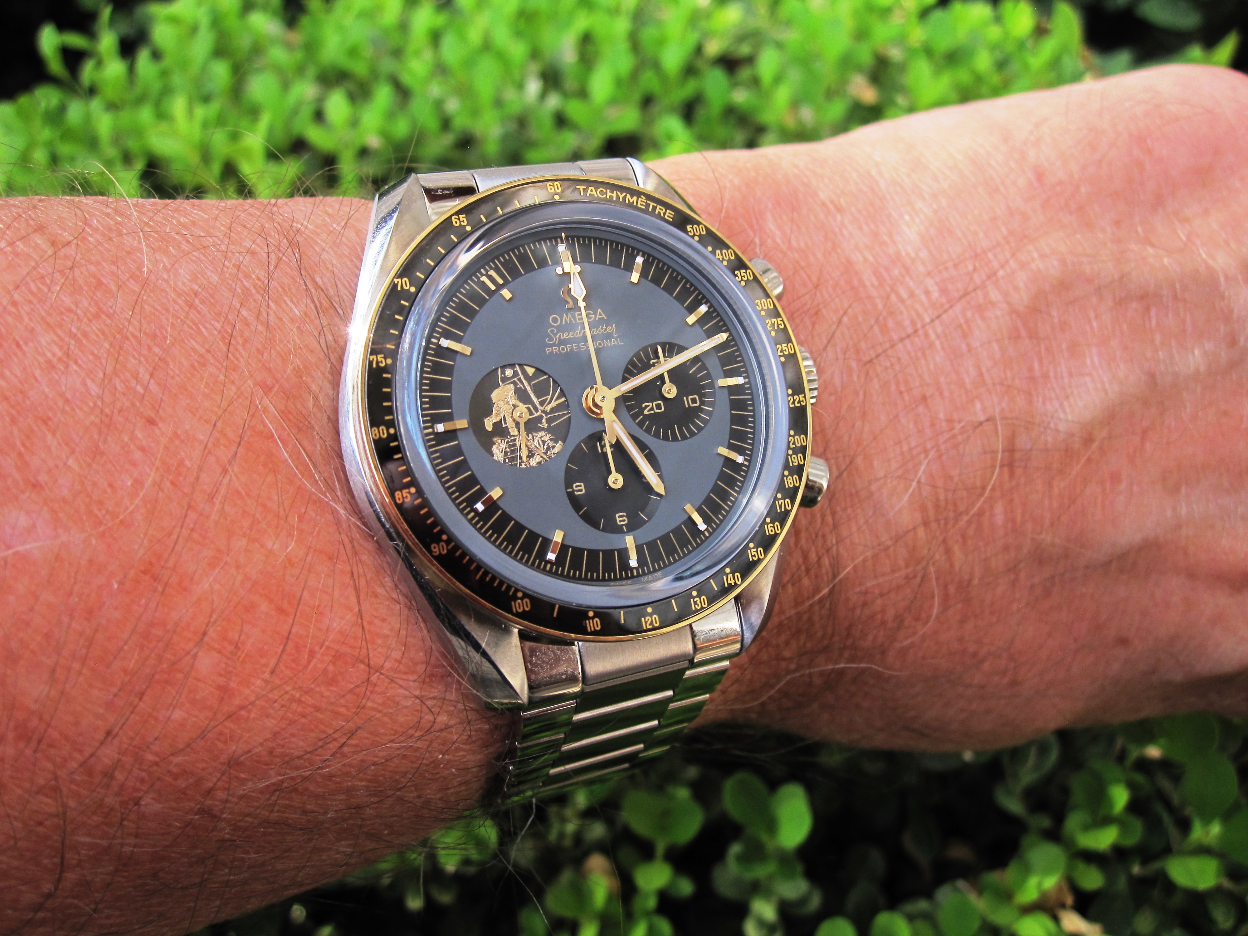

Chalk up one more issue with 3861. Got mine earlier this year. Wear it gently and it just stopped working this week. Off for service
7,792
14,391
My two year old Apollo 11 50th is still running fine, no issues whatsoever. If it craps out I hope it does before August 2024 when the 5 yr warranty runs out.
