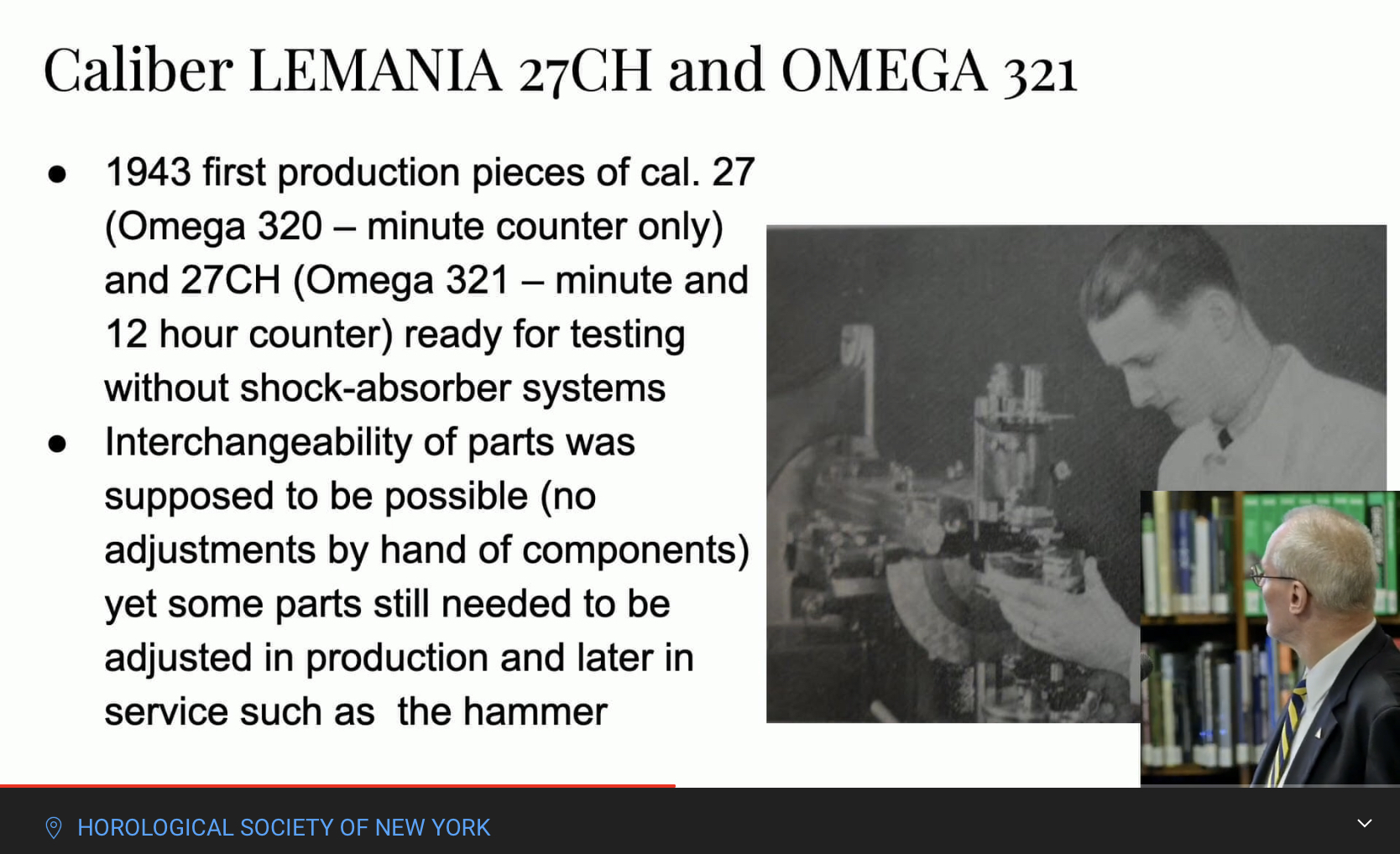

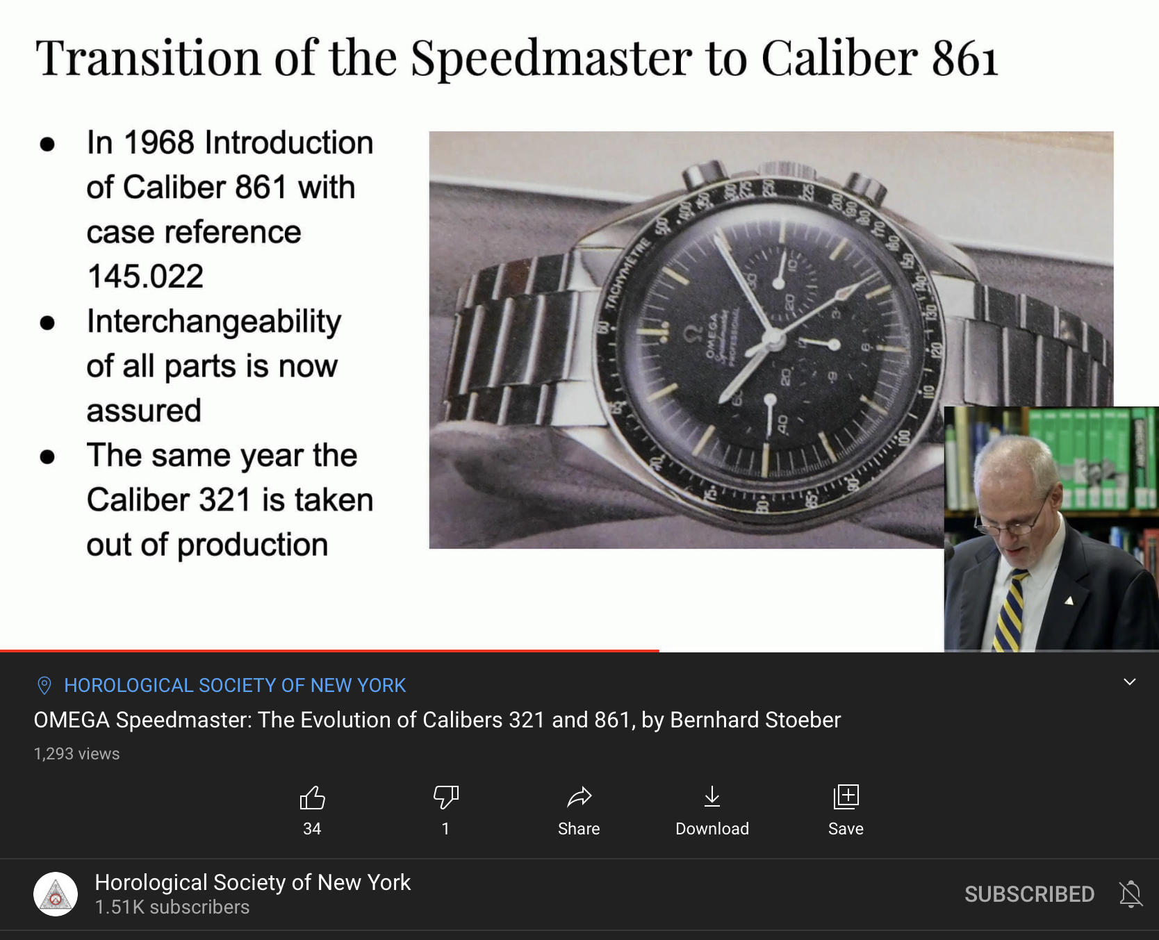

@Archer : I’ve read that one of Lemania’s problems with the 321 were certain parts had to be modified by hand when fitting them, either on assembly or when a replacement was fitted during service, like some of the hammers - which were left a little long so they could be trimmed upon fitting. According to this, Lemania had not achieved full parts interchangeability with the 321.
There’s also these screen shots of the below video lecture. The discussion in question starts around 48 minutes in.
Thanks.
He mentions the hammer as the lone example of a part that requires fitting. This is true that hammers require fitting, so yes he is correct. The fact is you can't buy a new hammer for a 321 from Omega, because the part is discontinued, so if you are buying a spare it has likely already been fitted. Thankfully I've not had to replace one on a 321 as I imagine they are not cheap.
The claim though that this was "solved" by the introduction of the 861, is strange.

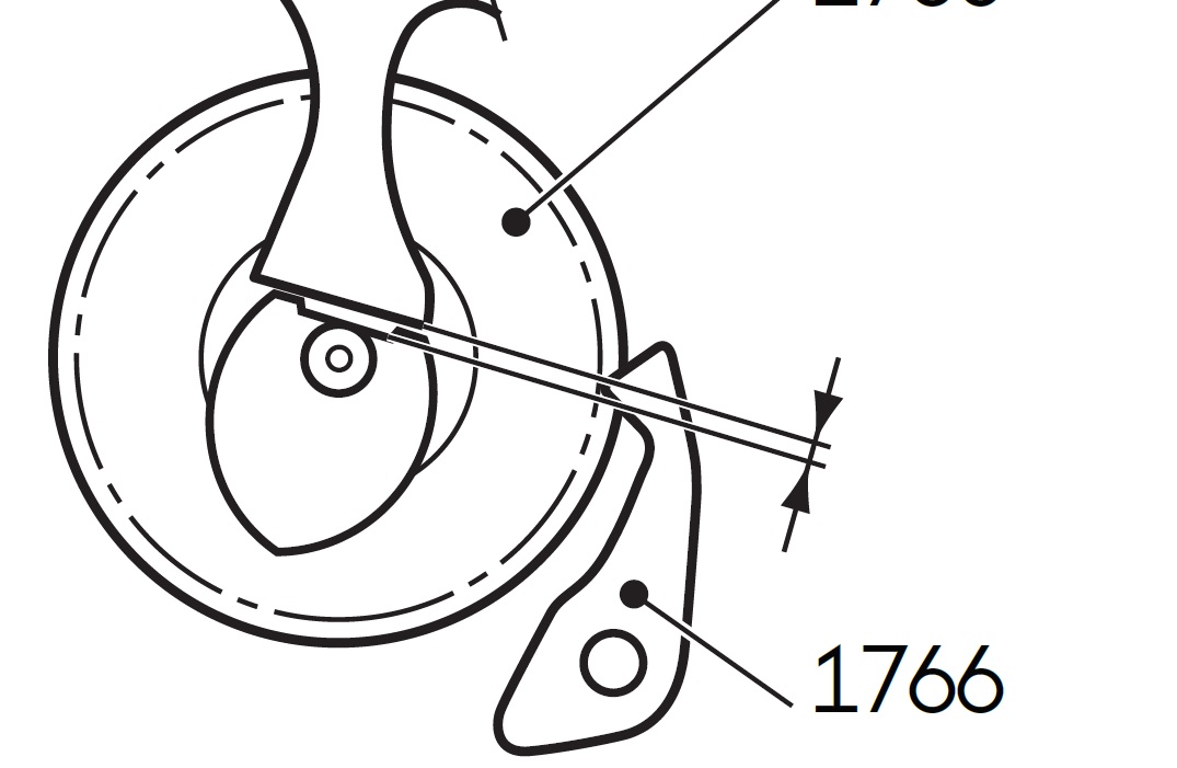

Let's look at the description of the hammer for the 861 - taken just now from the Omega Extranet:
72208601728 | HAMMER MOUNTED WITHOUT GRINDING MIN.FUNC
"Without grinding min, function" - this means...you guessed it, that this requires hand fitting by the watchmaker in situ. This is because when the hammer is fully on the cam for the chronograph wheel, there is a very slight gap between the hammer and the cam on the minute counting wheel. They leave the minute counting part of the hammer long, and you have to file it to the correct length to get that clearance. The minute counter is not located by the cam at rest - it's located by the minute counter jumper, so this play allows for proper locating using that jumper.
So yes, you are correct that one part in a 321 required fitting by hand, but the same part requires the same fitting by hand on an 861, and also on an 1861. Omega still has all the procedures listed in the technical documents for the 861/1861. This part is rarely replaced to be honest, so it's something I've done on an 861/1861 maybe once or twice off the top of my head. So this had slipped my mind on the previous reply as it's not a typical issue that one would come across.

@Archer : Just explaining the basis for my comments. I know better than to try to be right over you. You have decades of direct experience and first hand knowledge and I am dependent on my own limited observations and the insight of people like you and Mr. Stoeber.
He also talks, without being specific, about the general, laborious hand fitting process Lemania engaged in during initial assembly. It doesn’t sound like true interchangeability of parts.
Great lecture, I’m just surprised they let the typo of referring to ref 145.012 as 145.015 slip by.

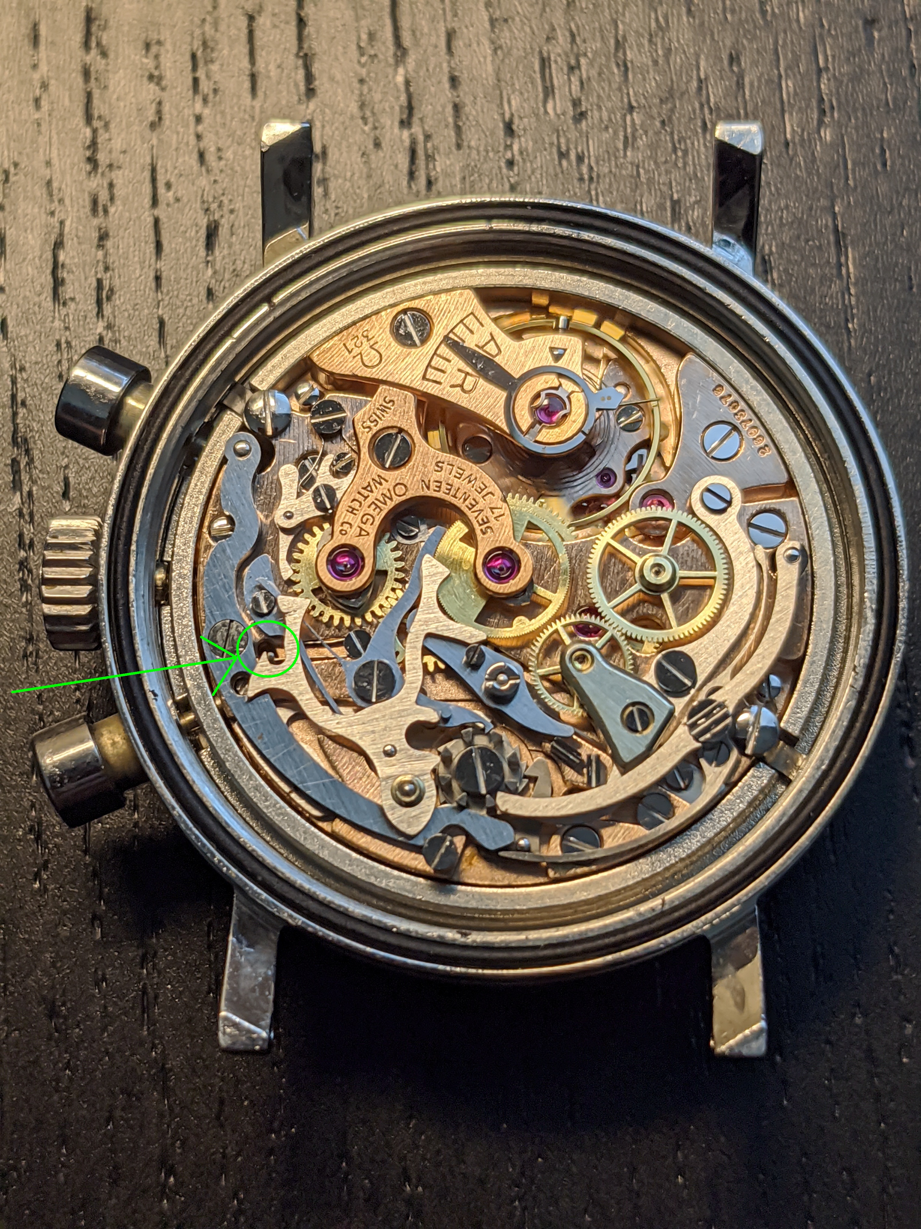

So upon closer inspection, it seems that my reset problem is being caused by the stem bolt not fully releasing the hammer. I can't tell what is causing this, but the problem lies from either the pusher, hour hammer operating lever, or stem bolt???
I'd really appreciate the thoughts of the pros (and @Archer ) as to what is causing this or some insight/pics into the connection mechanism underneath? Could it be dirty internal pusher issues?

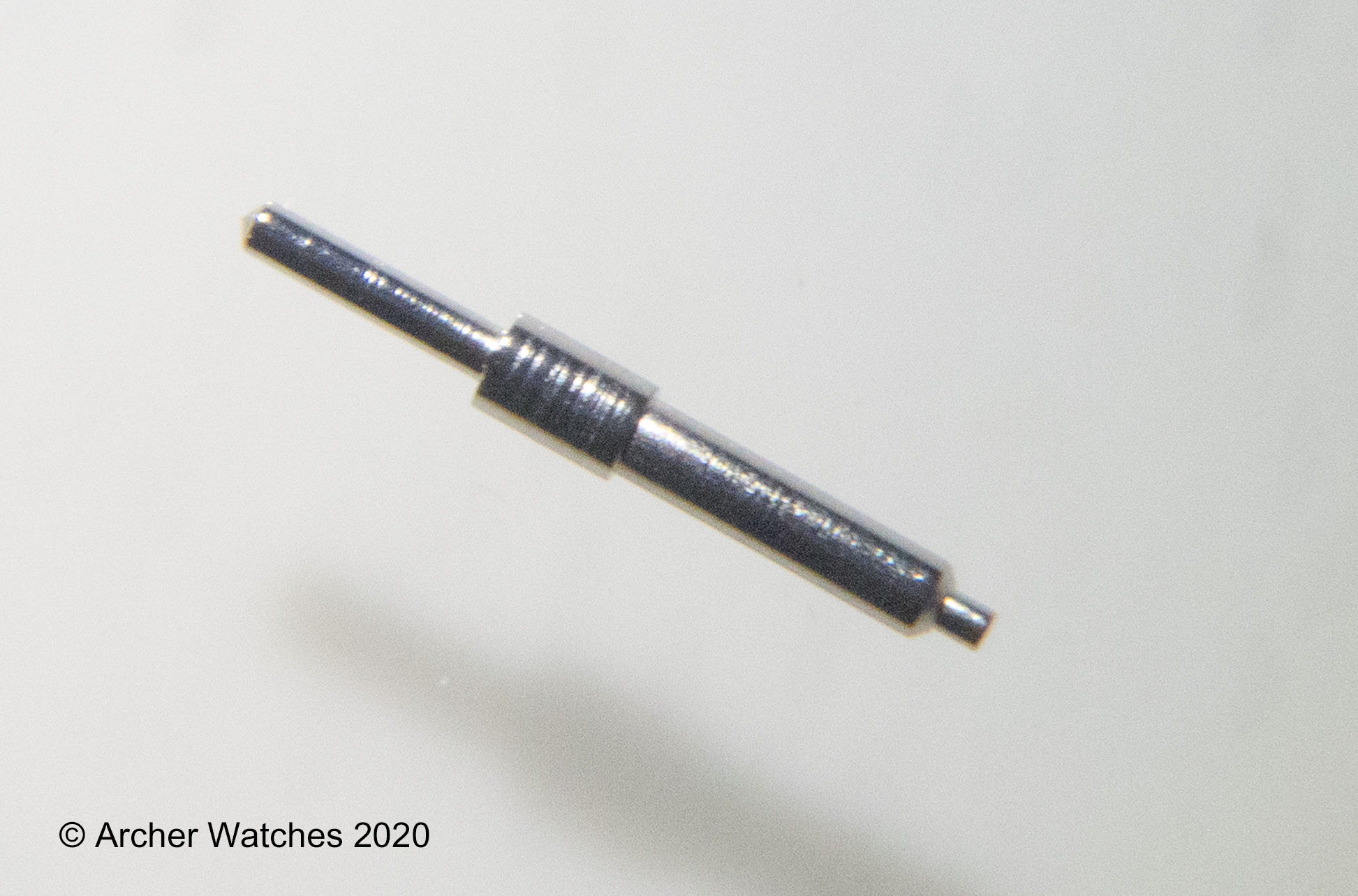

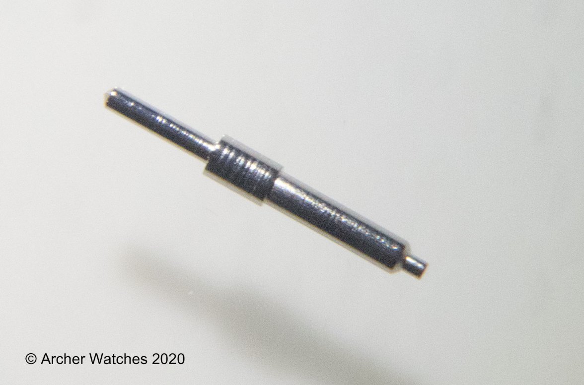

As for how this works, it's very simple. When you press the pusher, it moves a part called the "pusher stem for zero action" and in a Speedmaster it looks like this - top one is for a 321 and bottom one is for an 861:
For other cases it can look a little different, but the key thing is that one end of it is tapered. This is the end that contacts the stem bolt for hammer. The tapered end of the pusher stem contacts the body of the stem bolt for hammer, and simply pushes it aside, releasing the hammer to fall and reset the hands.
As for why yours won't move, without being able to see it, who knows. I've seen some horribly messed up watches that were "serviced" by someone, but had such poor work it's clear whoever did the work was not exactly competent. Not just on 321's, so I have an 861 in the shop now that has been butchered by someone...related to this issue here is what the stem bolt for hammer should look like:

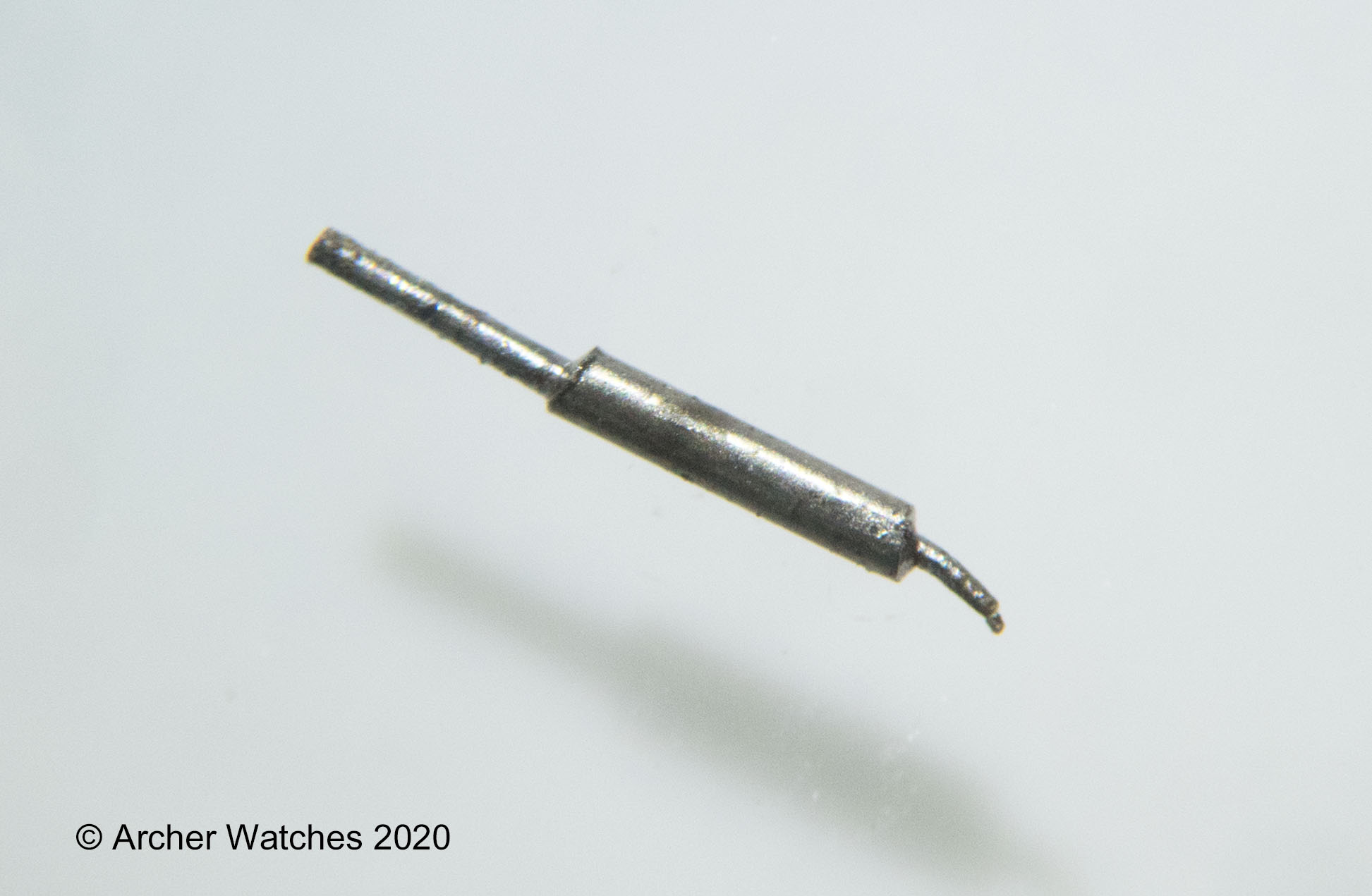

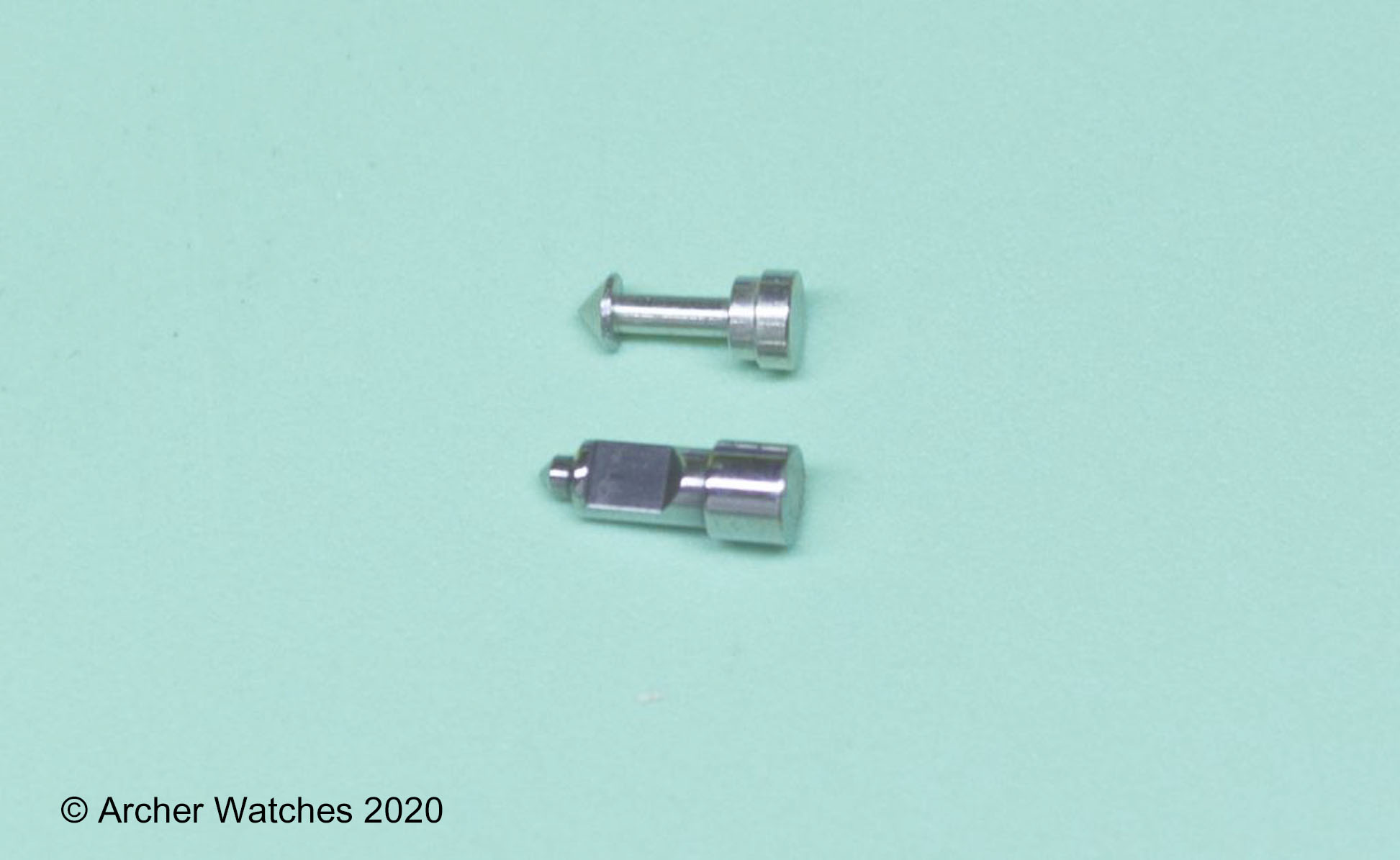

And this is what I found in the watch:
Someone's clearly home made and quite ineffective version of a stem bolt for hammer...
You need to take this to someone who knows what they are doing to get it repaired. Pressing "really hard" on the reset button is not a good idea. The stem bolt small stubby end sits in a hole machined in the brass main plate. If you press "really hard" enough times and the stem bolt isn't moving, you can distort that hole and now you have bigger problems.
