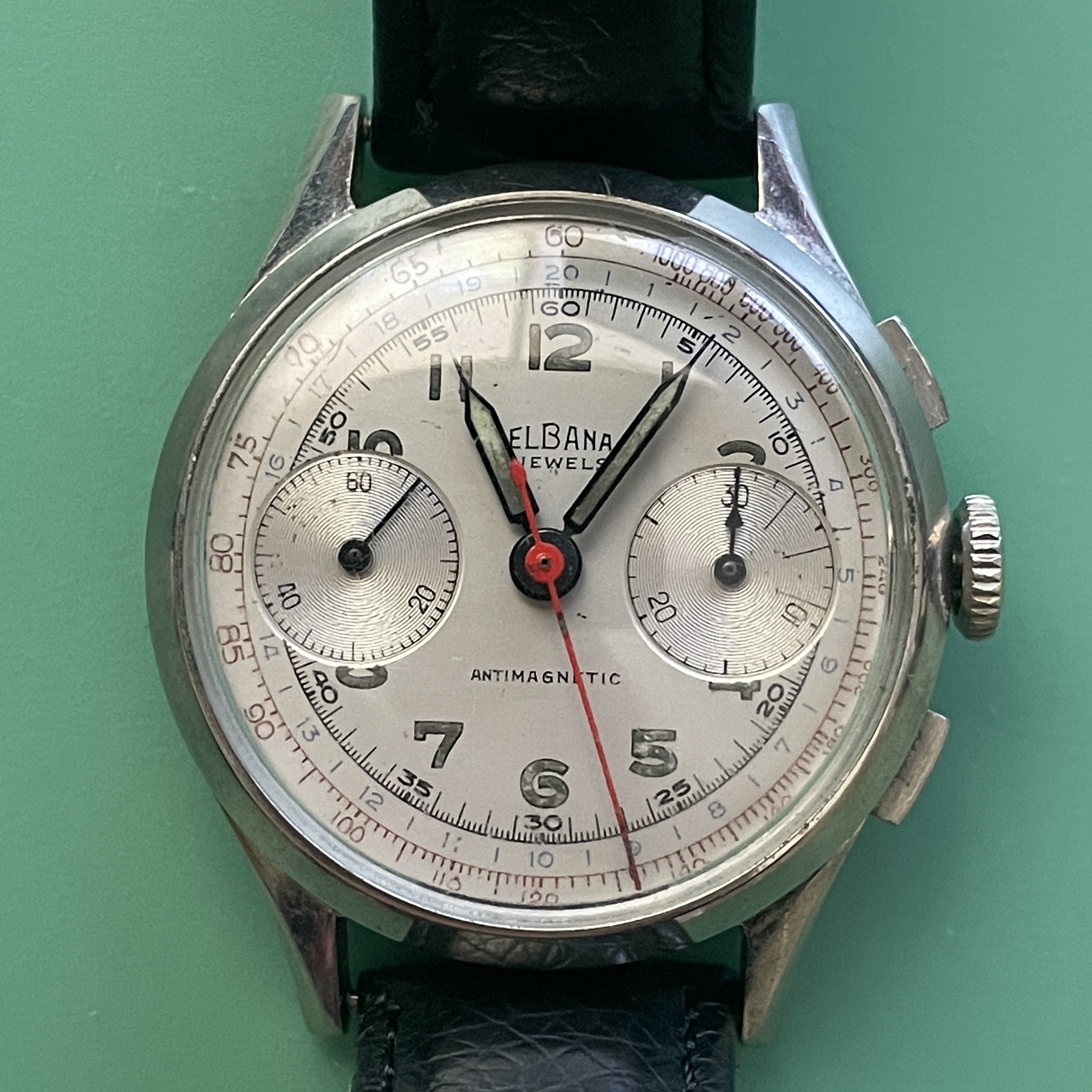

Meanwhile, given the my watch used to start this thread, if there are any generous German speakers who might like to translate this portion of the brochure I’d be much appreciative - especially as may relate to any explanation of the 15 rather than 30 minute totalizer (which I can see is discussed):

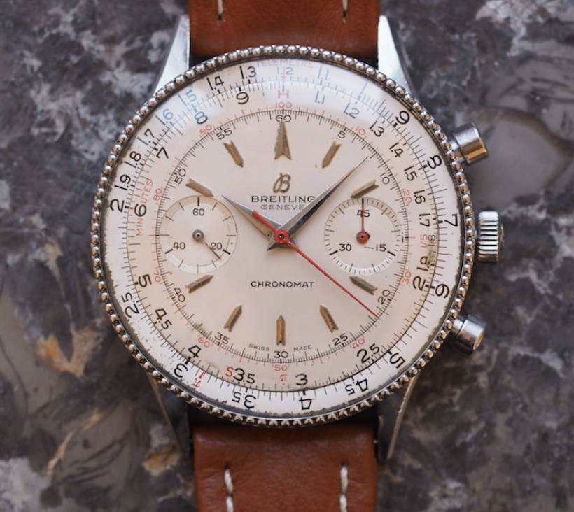

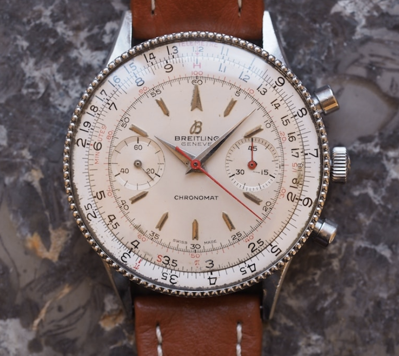

Continuing the collection of primary materials, this one being the most [interesting/ironic] to date wrt the topic of this thread:
Below is a Breitling catalogue that is:
(A) from 1946
(B) marketed to multiple languages/countries
The entire catalogue can be found here, though unfortunately the photos provide very poor legibility - if anyone knows where to find the full catalogue in clearer texts, please let me know.
Meanwhile, it’s that - while legibility is poor - I can find no discussion of telephone call timing, but instead a discussion of using the chronograph for the “rule of three”…
Amy best attempt at a “translation” of the poor legibility:
“The only chronograph with slide rule for calculating which permits in addition to the TACHYMETER - PULSOMETER - TELEMETER - PRODUCTION - METEROLOGY - CALCULATIONS also the MULTIPLICATIONS and DIVISIONS. Mathematical problems such as the RULE OF THREE, COST PRICES, EXCHANGE and [INT]ERESTS are easily executable with the CHRONOMAT[.] in one word, a chronograph for SPORT and WORK….”
Now, the chronomat was not strictly a pilot’s watch so much as a slide rule watch geared toward, say, workers such as engineers, mechanics, and the like, but also “sport.” And, the literature’s framing places this “rule of three” in a category of mathematical problems seemingly dealing as a category with money/accounting related questions. And of course, the literature does not attribute this “rule of three” or any other functions with the dial’s 3/6/9 emphasis (found on most/all? chronomats). The language appears to be focused toward the functions of the slide rule in performing “in addition to” the tachy’s function other mathematical calculations - but not entirely discounting the possibility of pumping together other dial features, such as the 3/6/9 emphasis.
If anything, this framing of “the rule of three” in connection with (possibly) the slide rule adds a new flare to the 3/6/9 mystery, but meanwhile worth noting that this period, multi-lingual, brochure makes no apparent mention of telephone call timing (though a more legible copy would be welcome), but does in talking about chronograph’s helpful functions reference a “rule of three” which references a watch with the 3/6/9 emphasis but also the slide rule functionality.

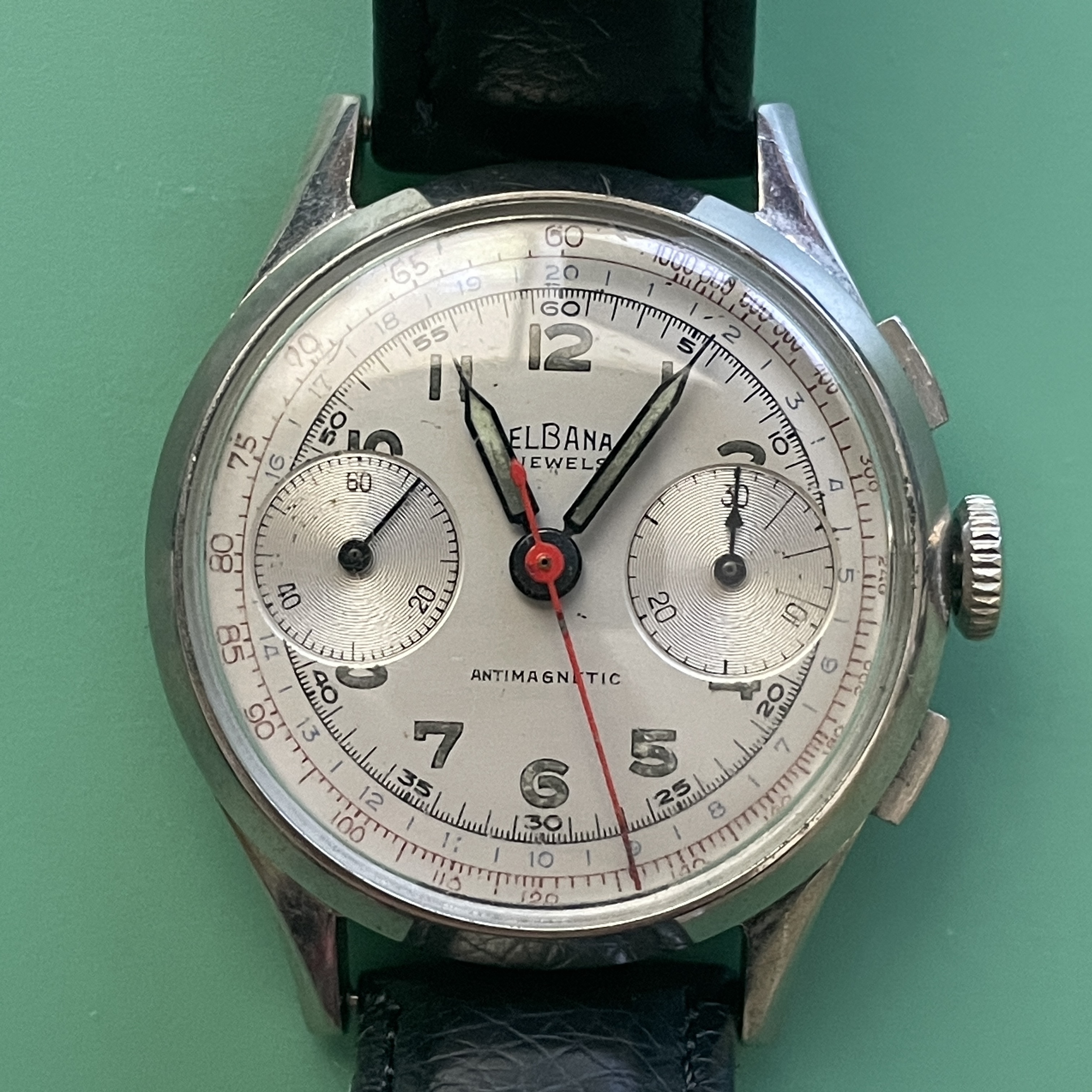

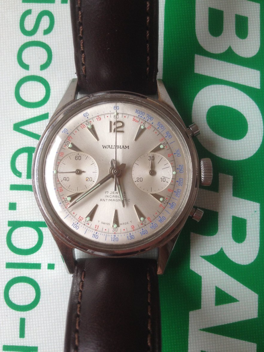

And these couldn't truly be considered "pilot watches", but they have the essential markers for phone calls 😉.

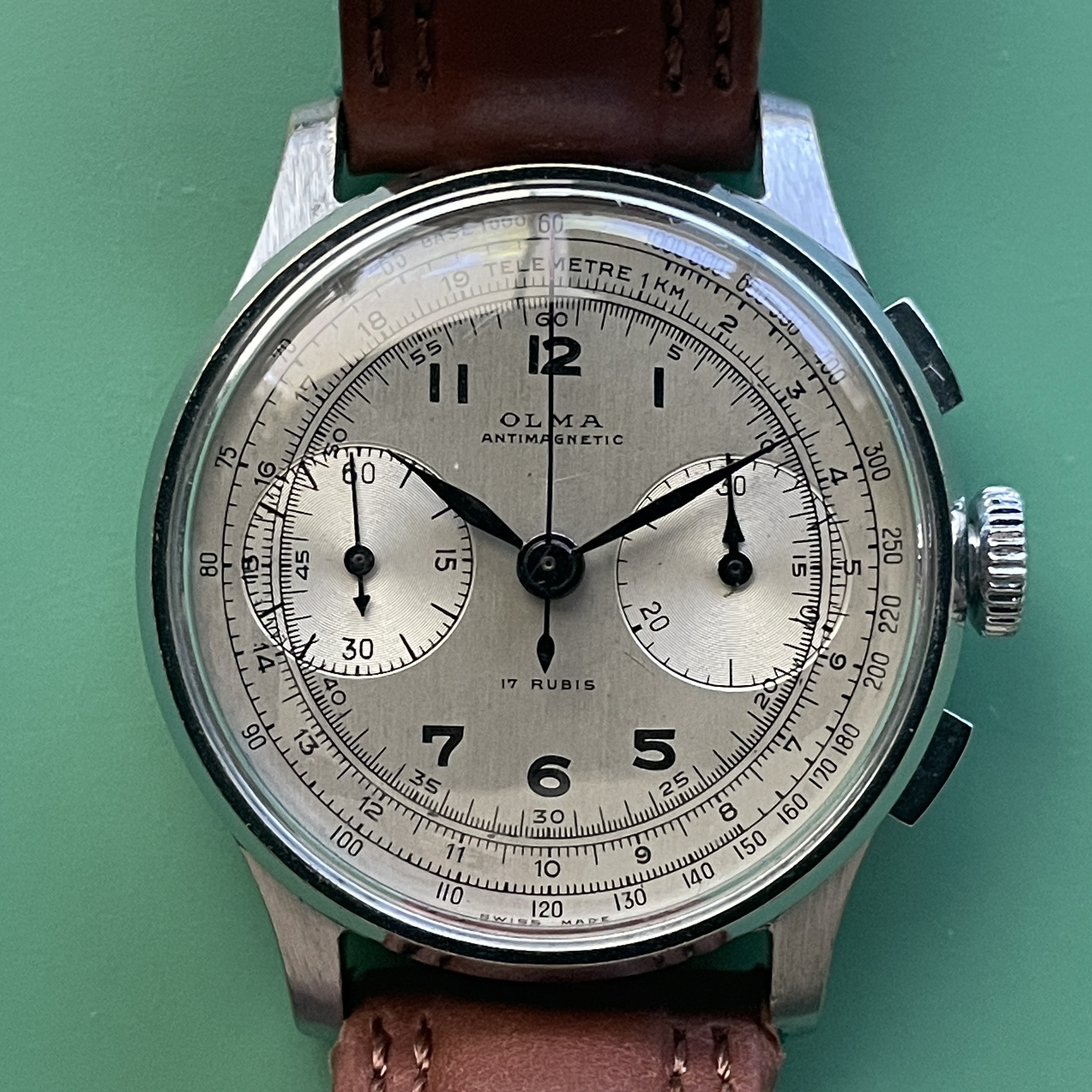

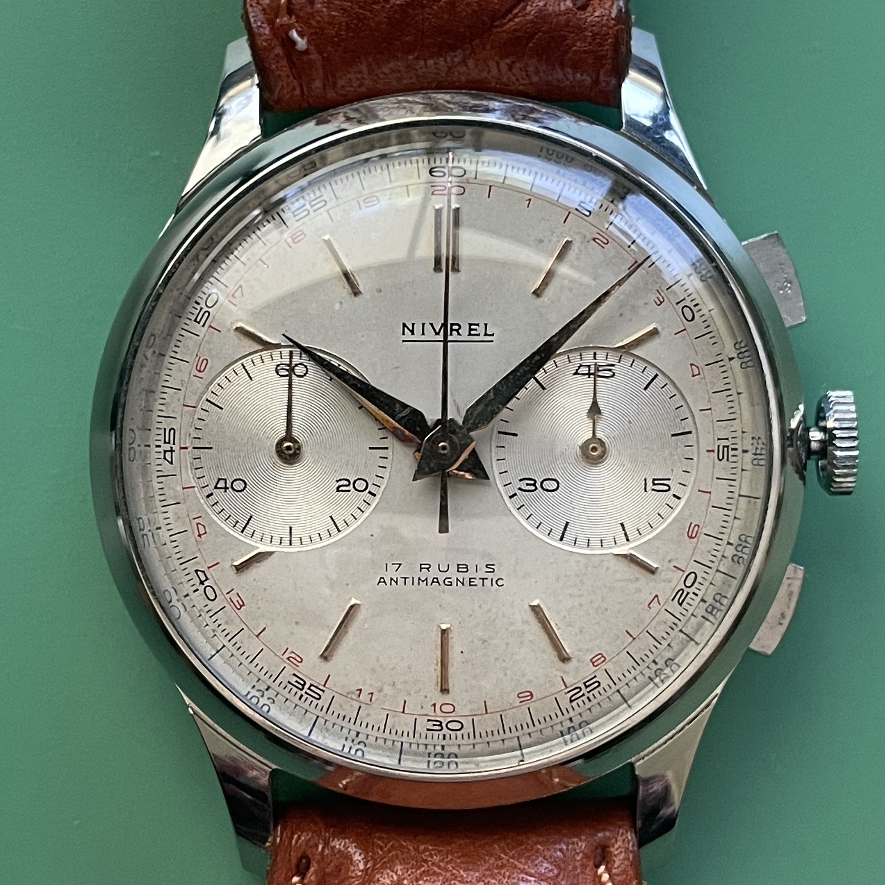

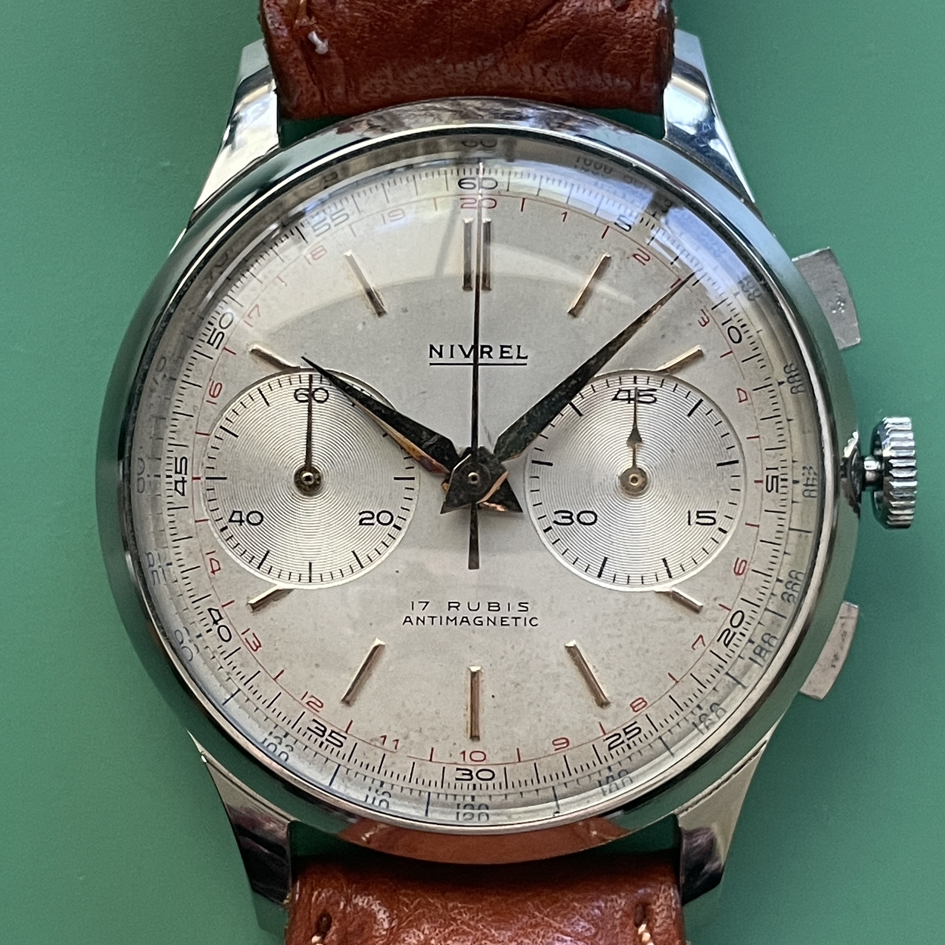

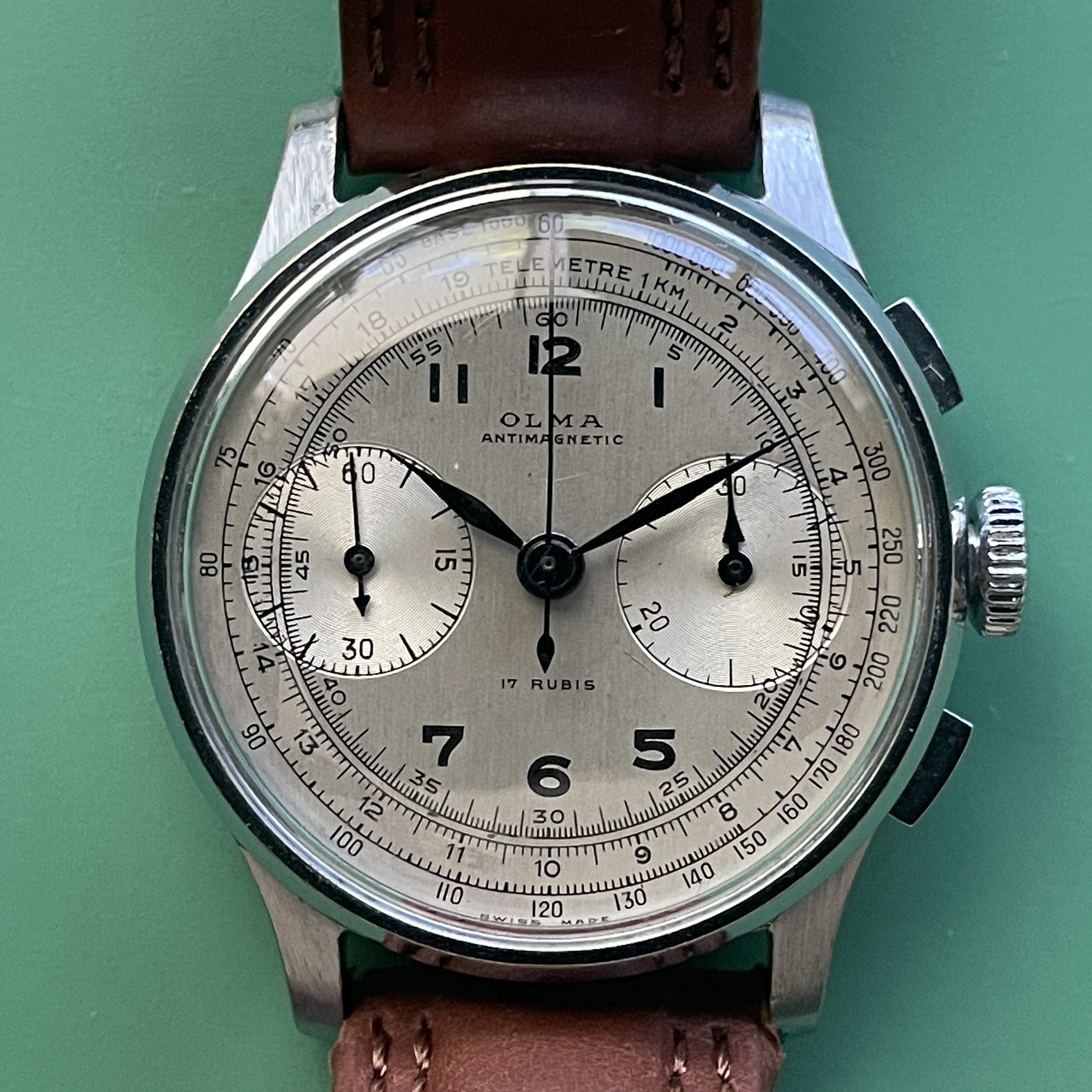

And this Olma is too confusing to be a pilot's tool, even timing phone calls would be a challenge.
and Nivrel figured that their owners still wrote letters and sent telegrams so a telephone timer was superfluous.
