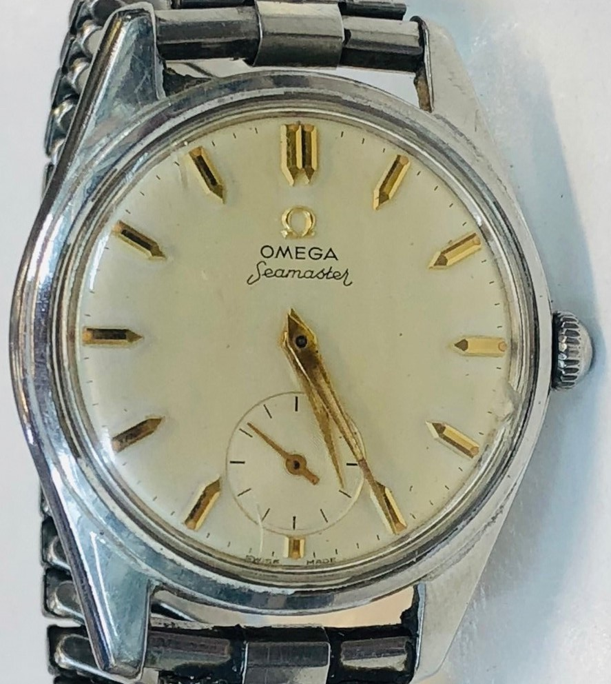

Hi!
What you guys think of this one?
Movement looks clean and in very good condition.
Can you give me an estimate for a price?
Thank you very much!

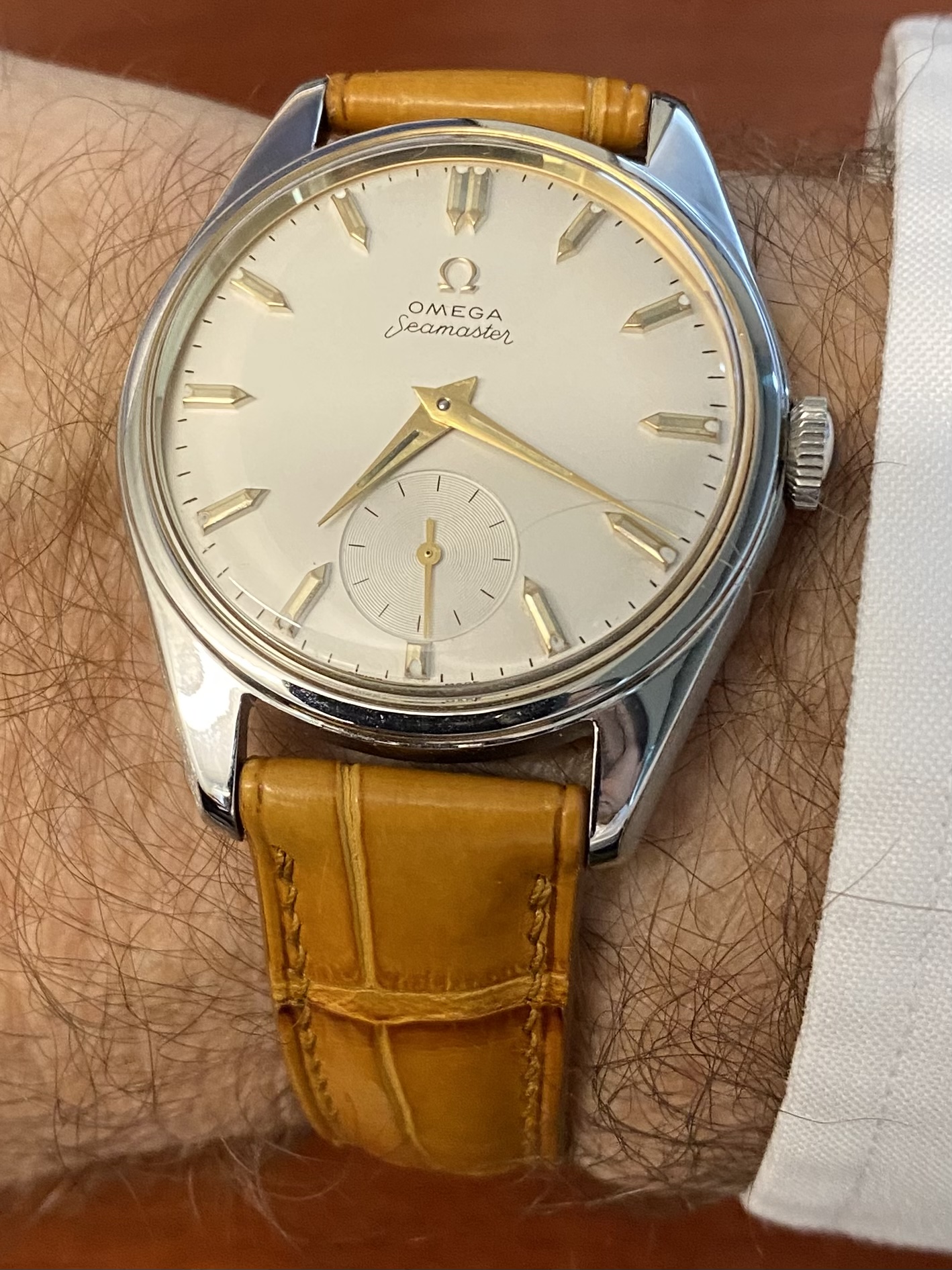

Not a good example. There is deterioration around several of the hour markers, significant dial damage between the 3 and 4 markers (look at the edge of the dial), the hands and some of the markers show significant oxidation, and the case is heavily polished. Compare to mine:
I would pass on that one and continue to look for a better example.

I wouldn’t say it looks great. The case seems quite polished and the crown is also wrong.

Actually, the crown is correct. It should be a bowler hat style crown and that appears to be what it is. As I noted in my prior post, however, the dial and case have significant issues that would make it a hard pass for me.
