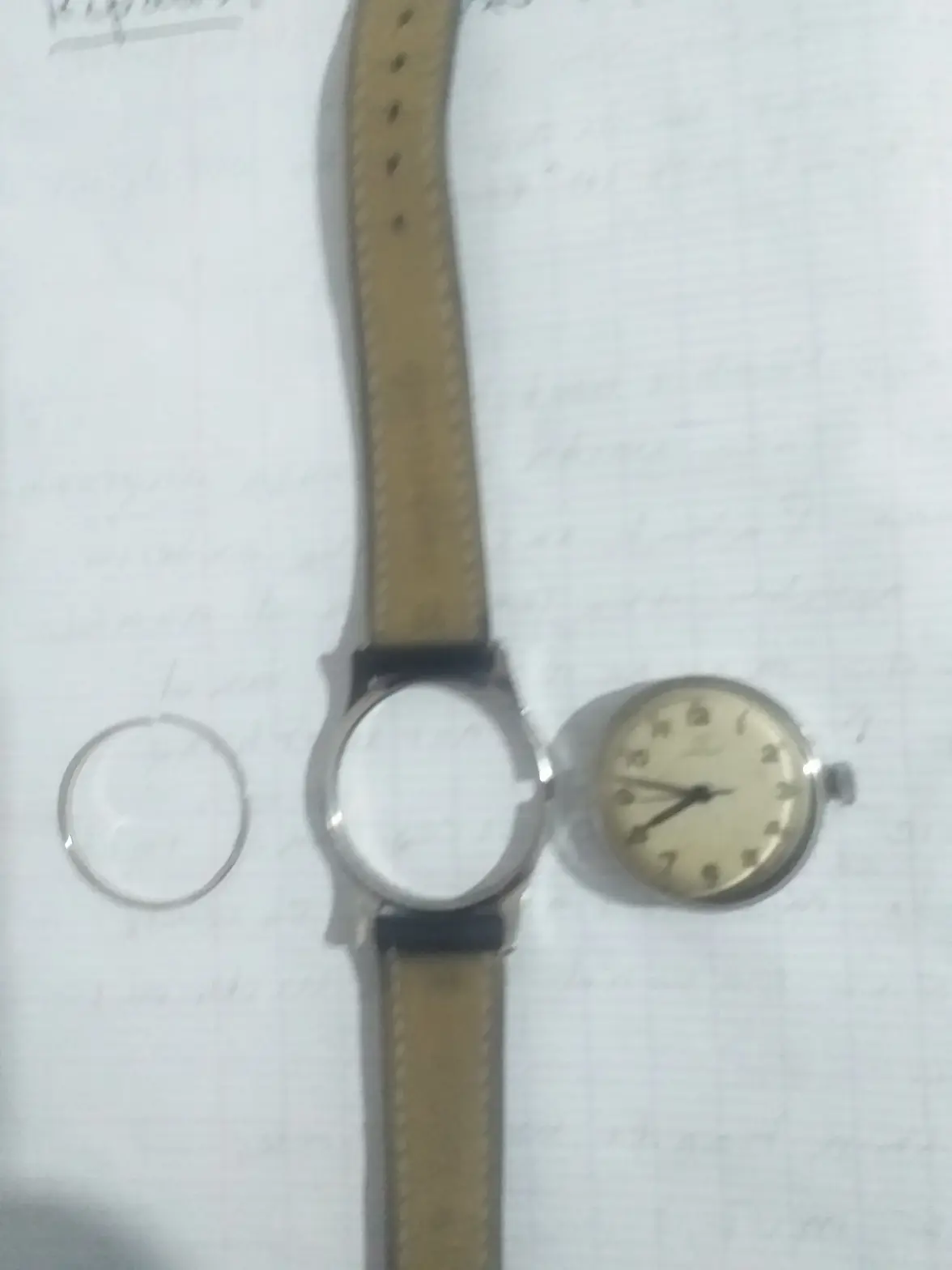

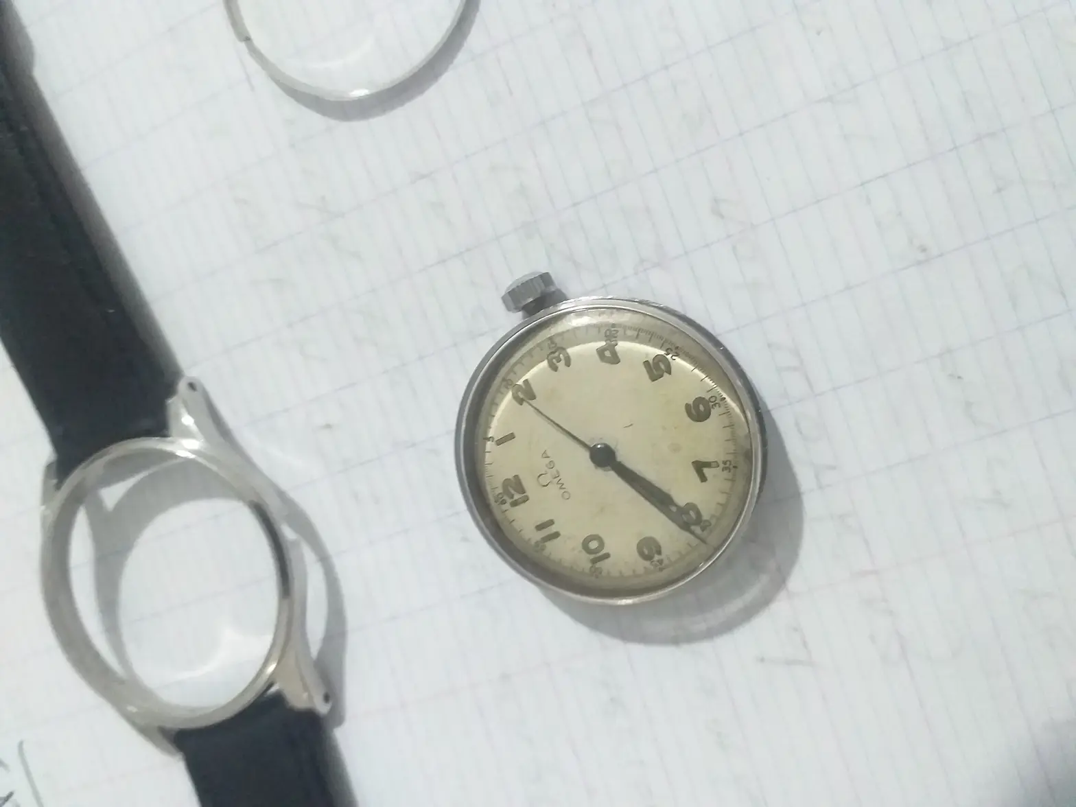

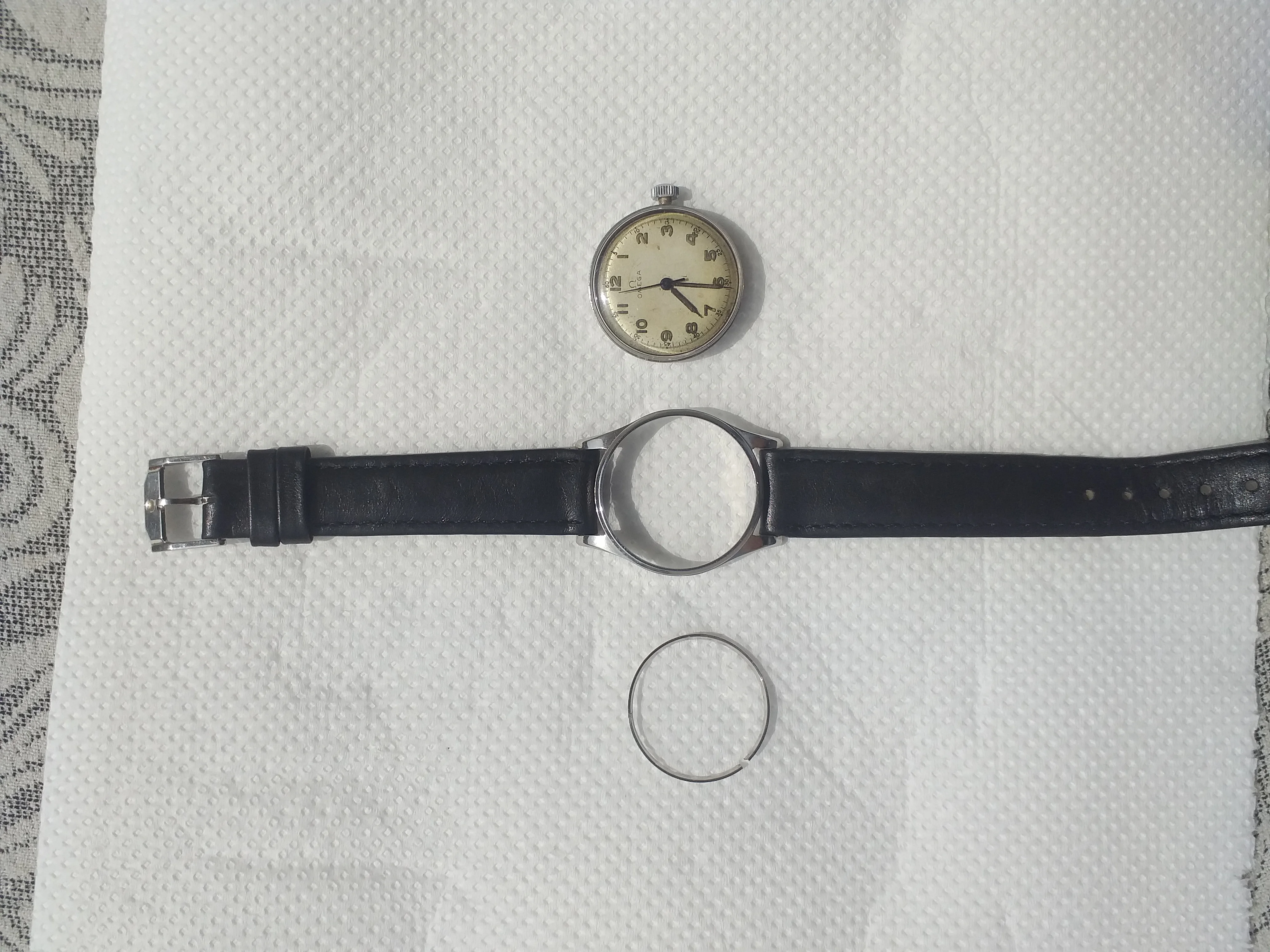

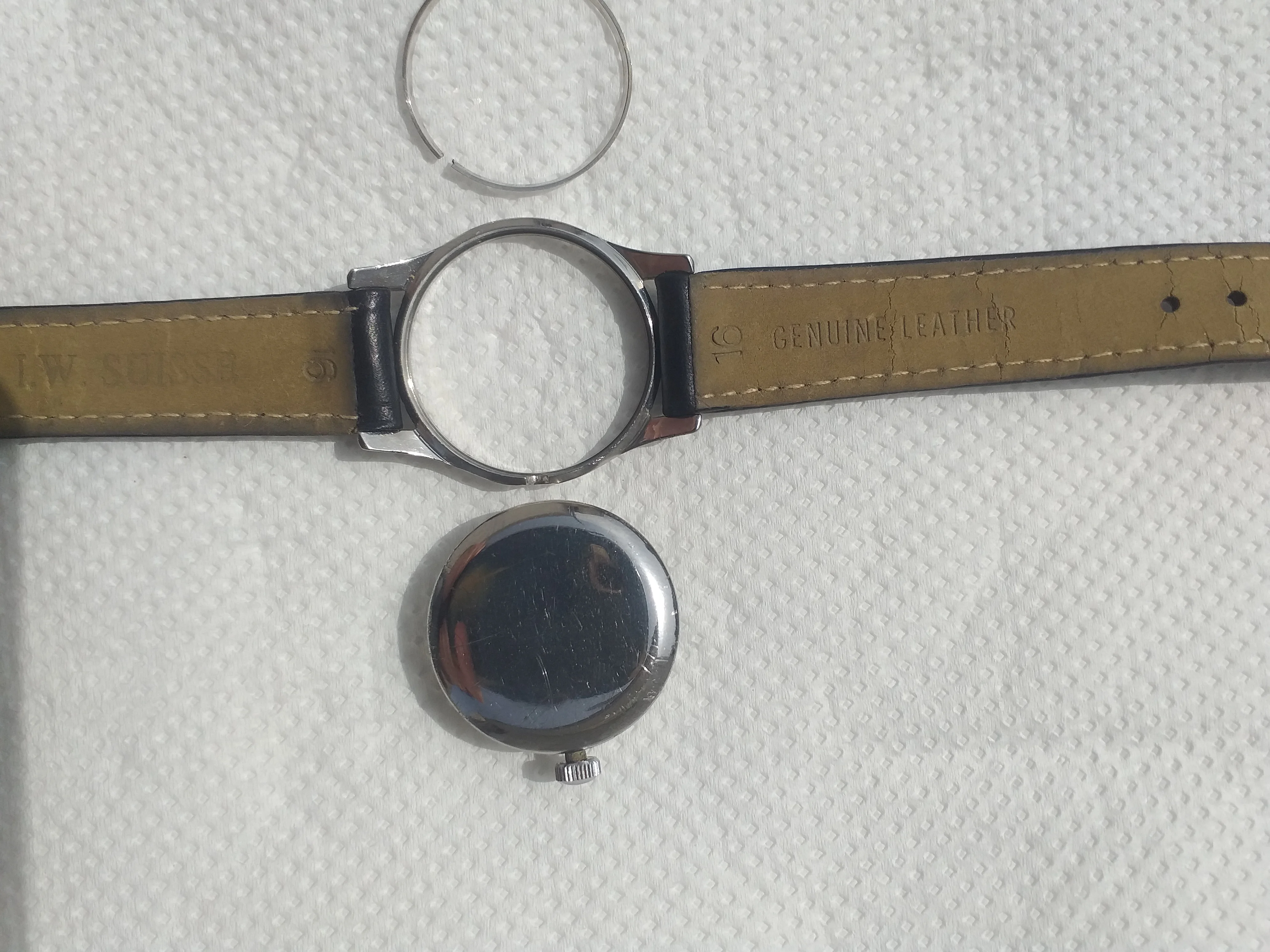

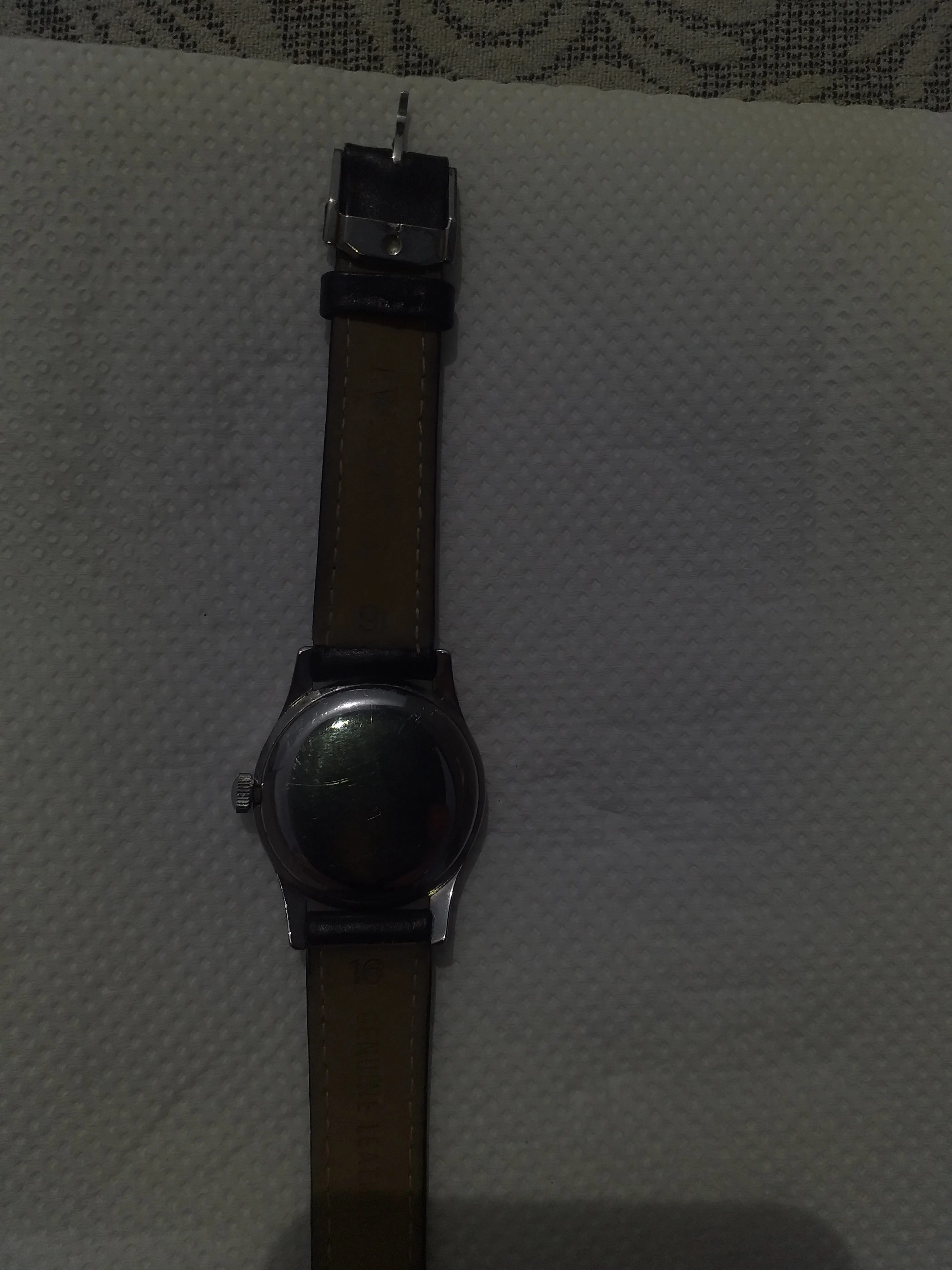

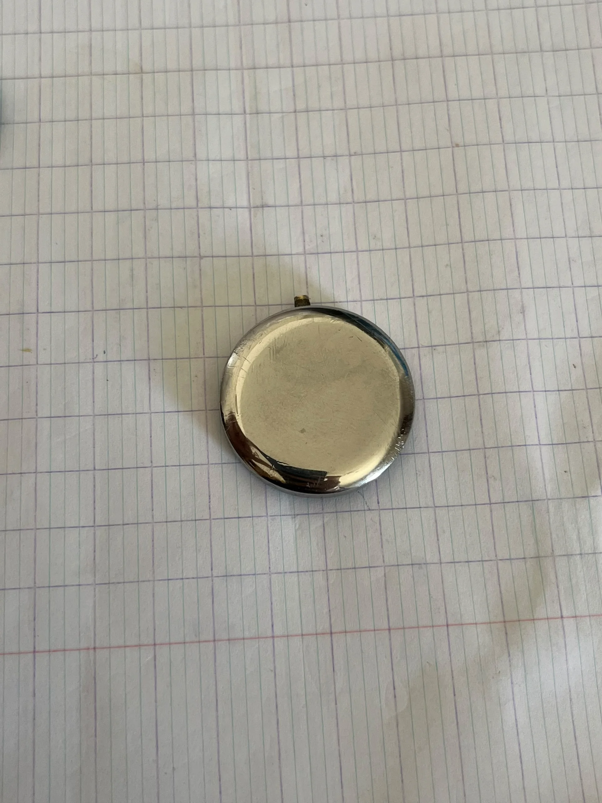

The watch I believe is a front loader ,the diameter is about 29 to 30 mm without the crown, it's about 9 to 10 mm thick.

The photos that you've attached are rather blurry, so it is difficult to make an identification for certain. Do you happen to have any clearer pictures of the dial or, ideally, of the watch opened up?

Hi there, I thank you for your feedback, I agree the pictures are indeed awful , I will post better ones soon, once again thanks.

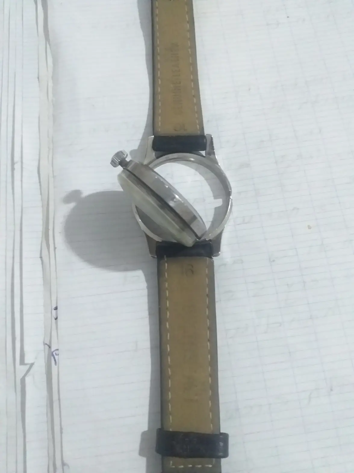

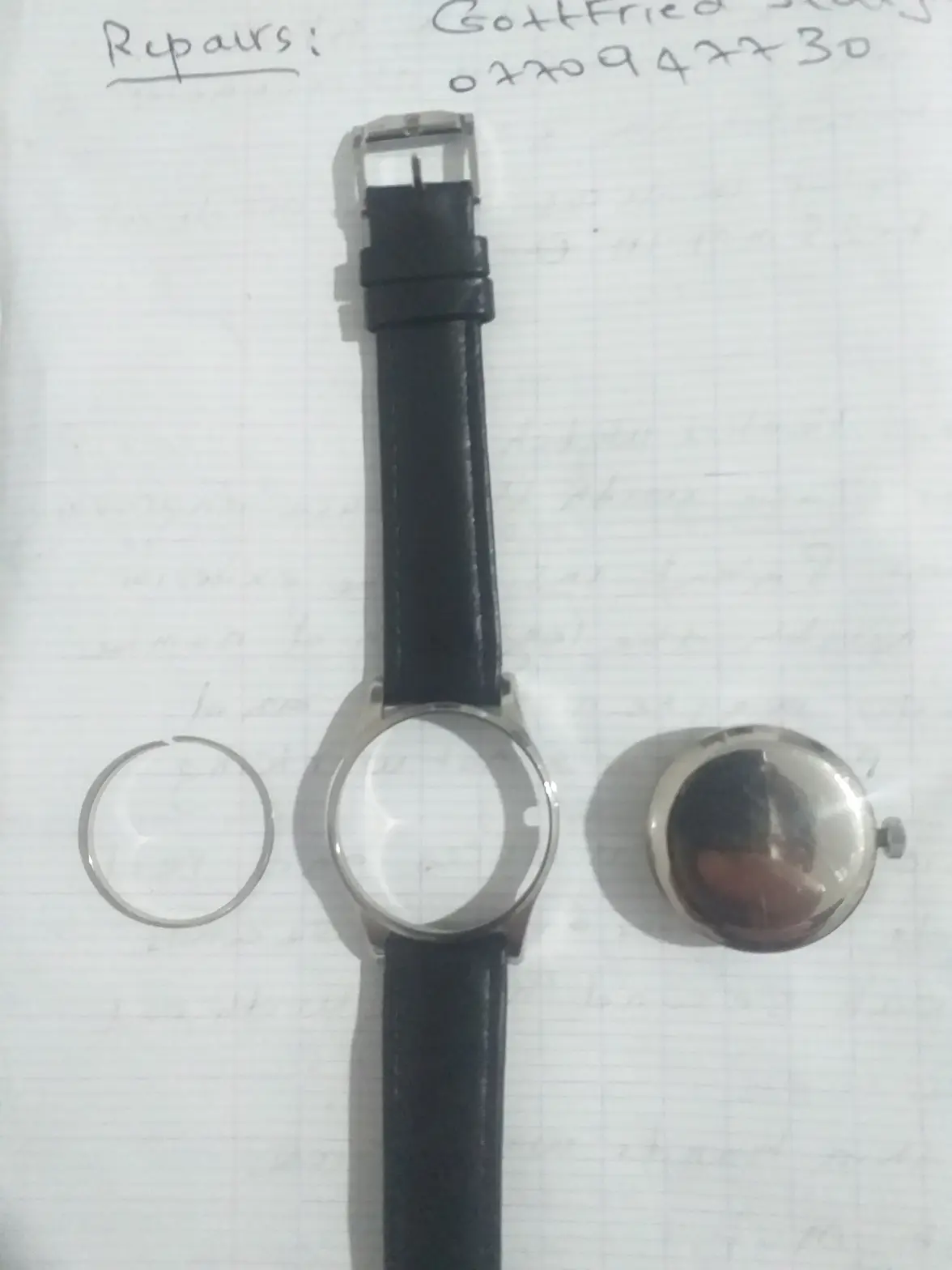

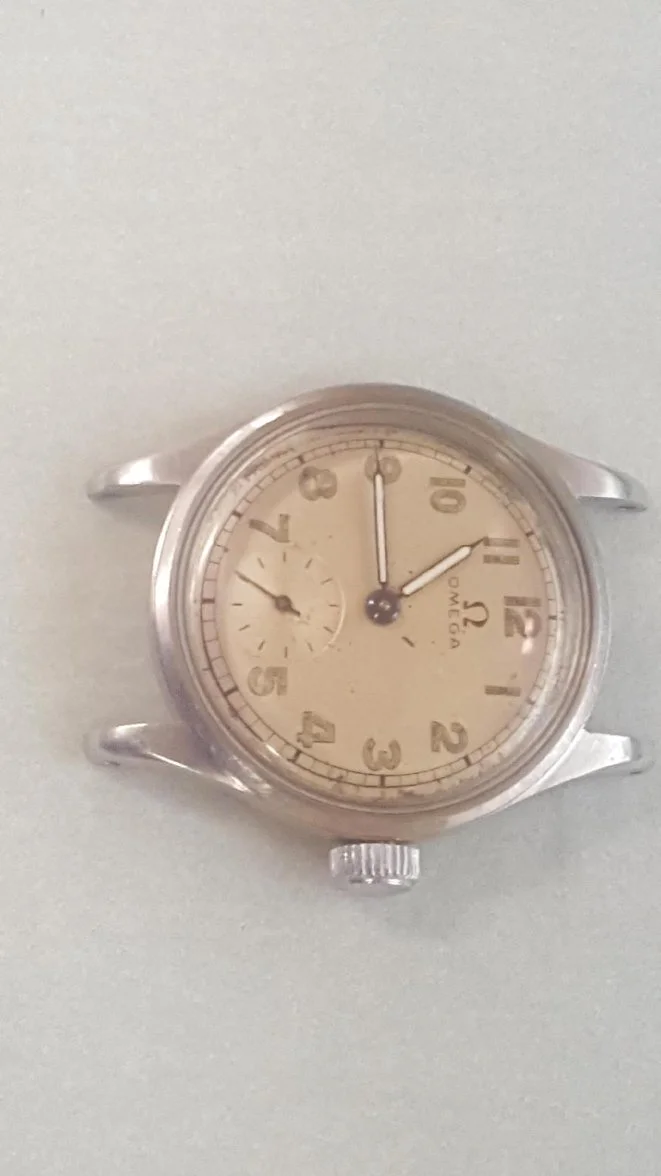

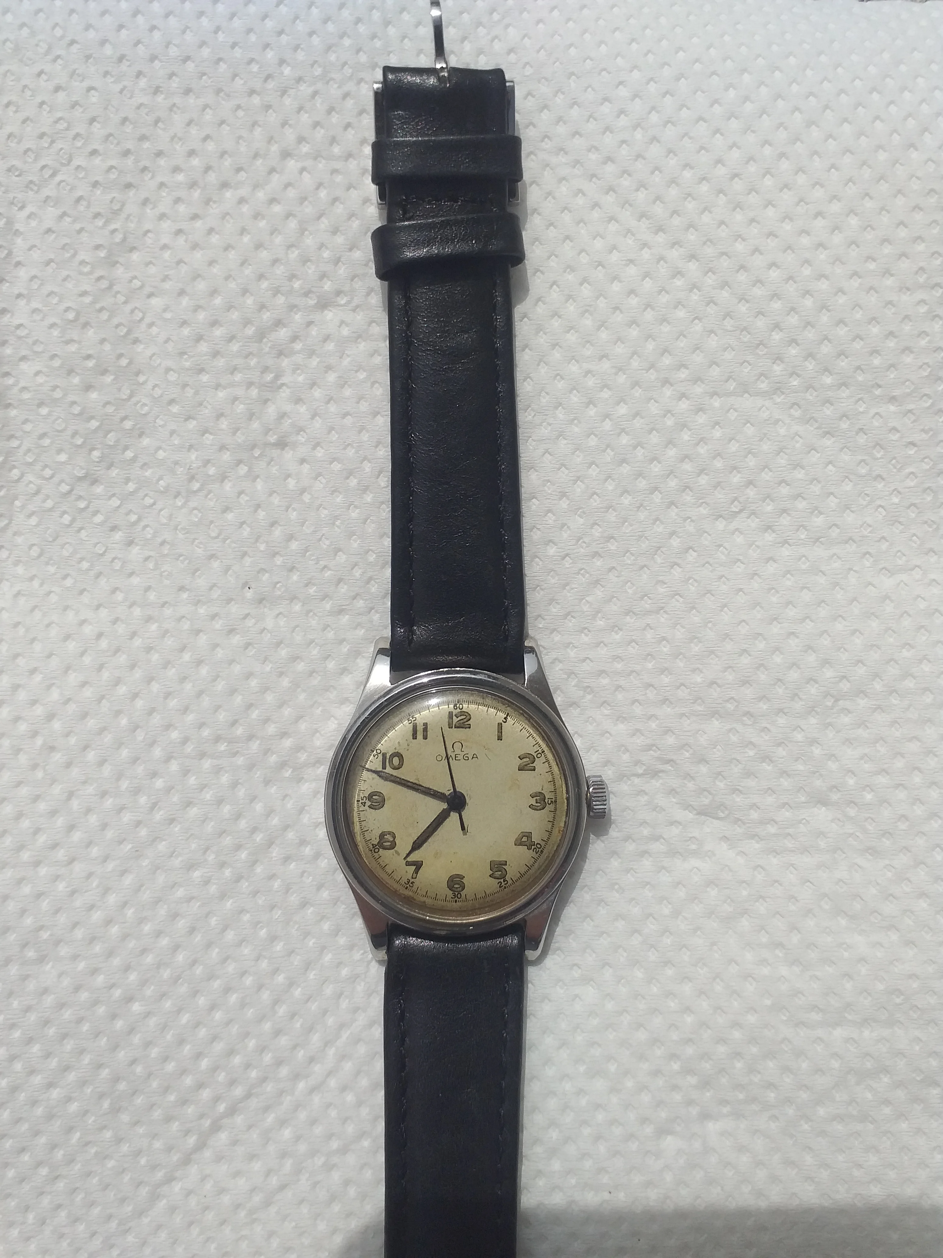

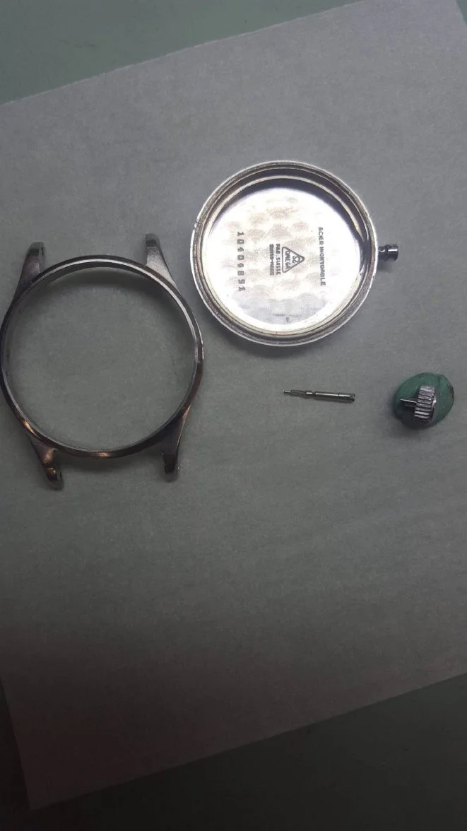

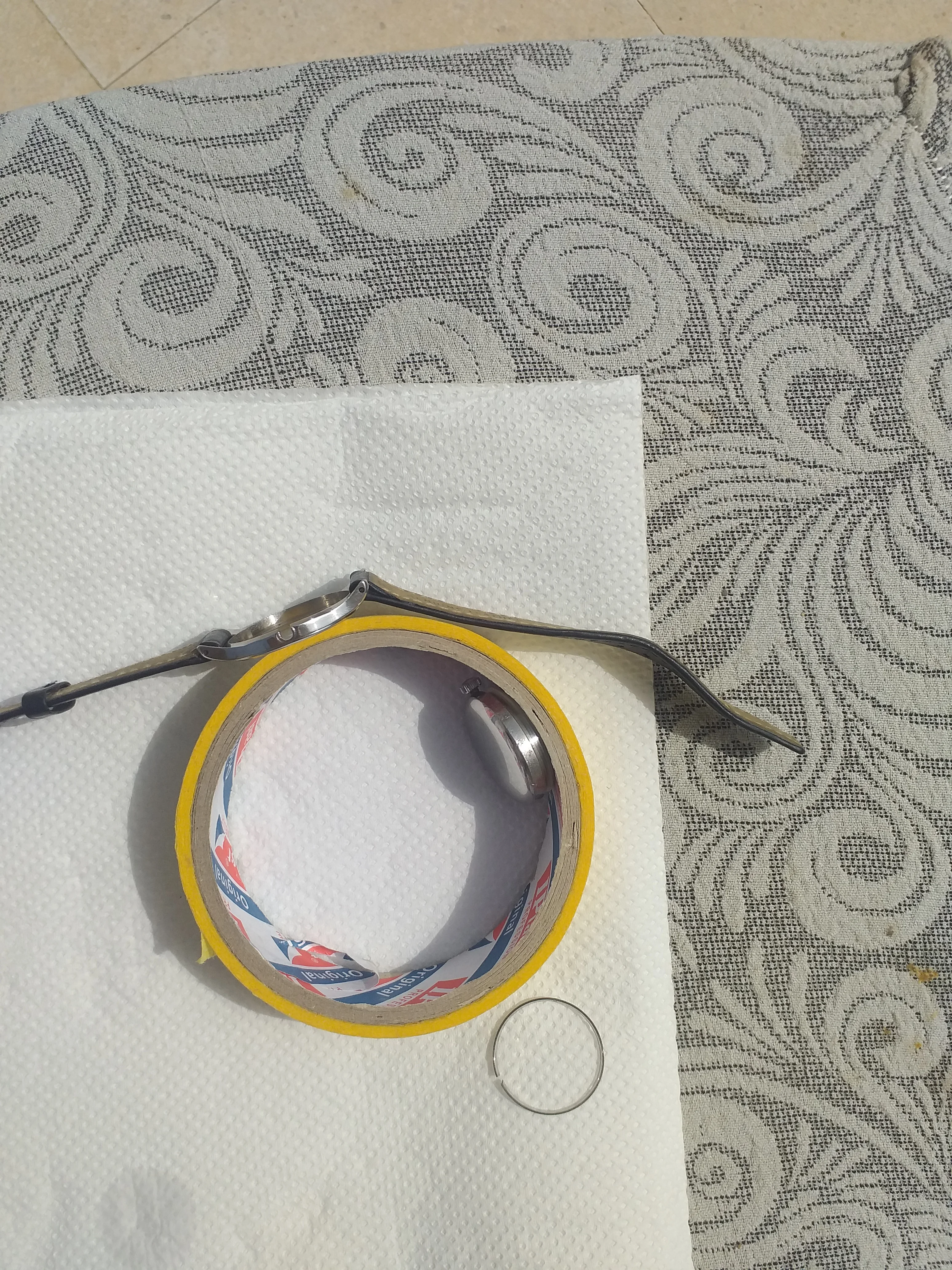

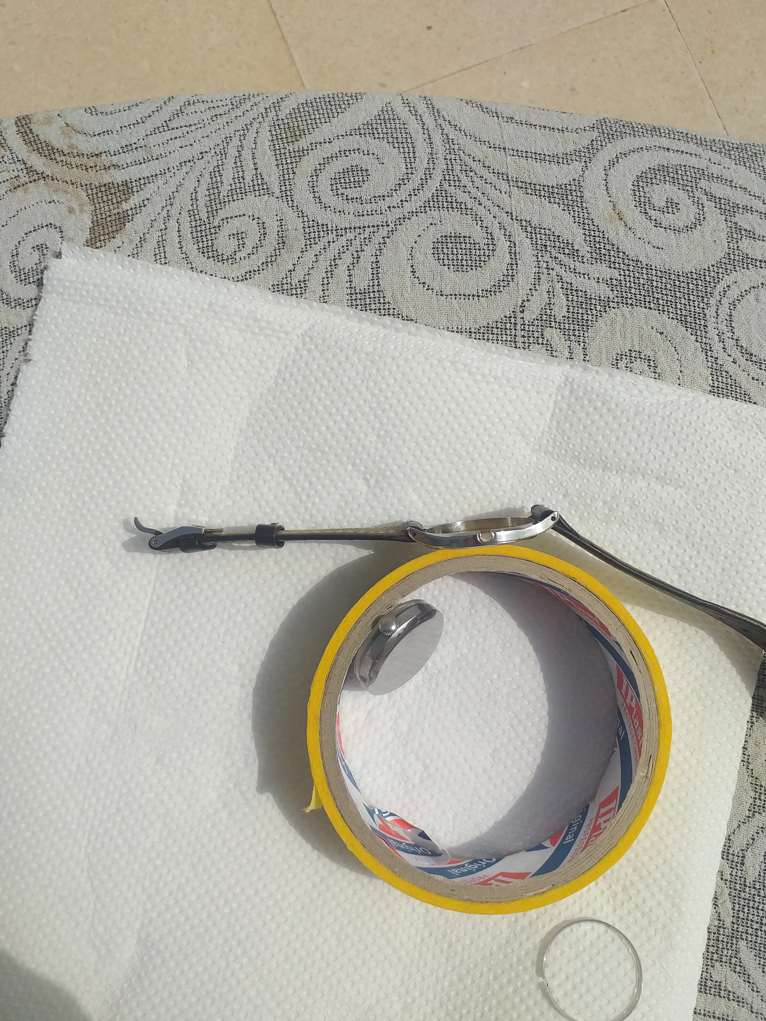

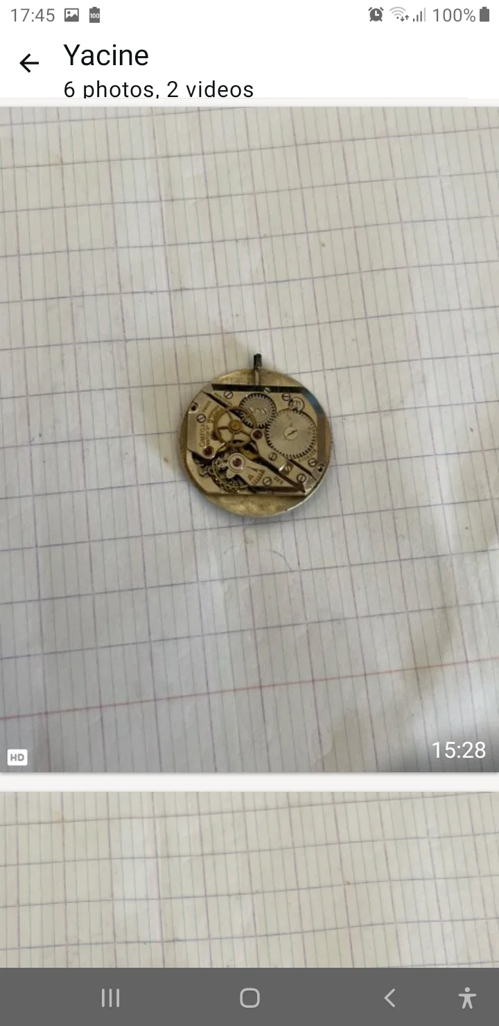

Hi everyone, I hope these new photos are much better to identify this unusual mounted omega case watch , I can't access to the movement, I don't know what caliber , please help, thanks

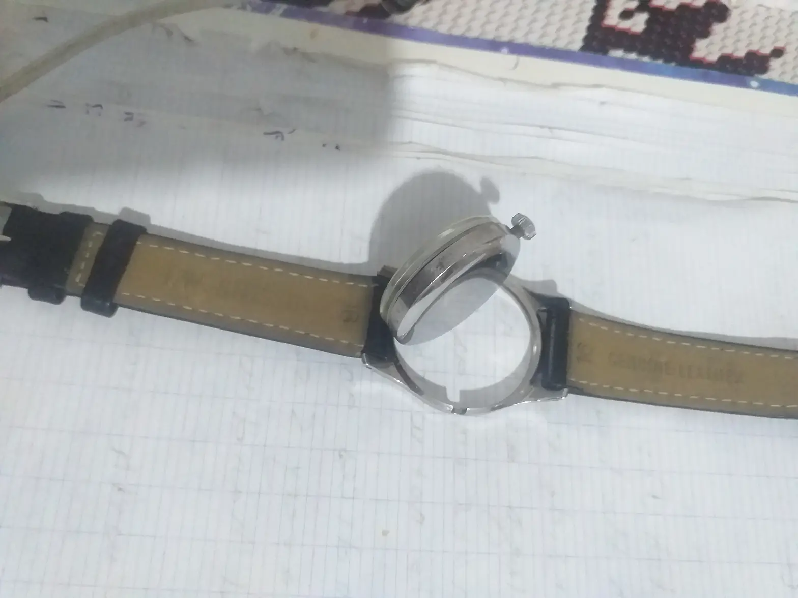

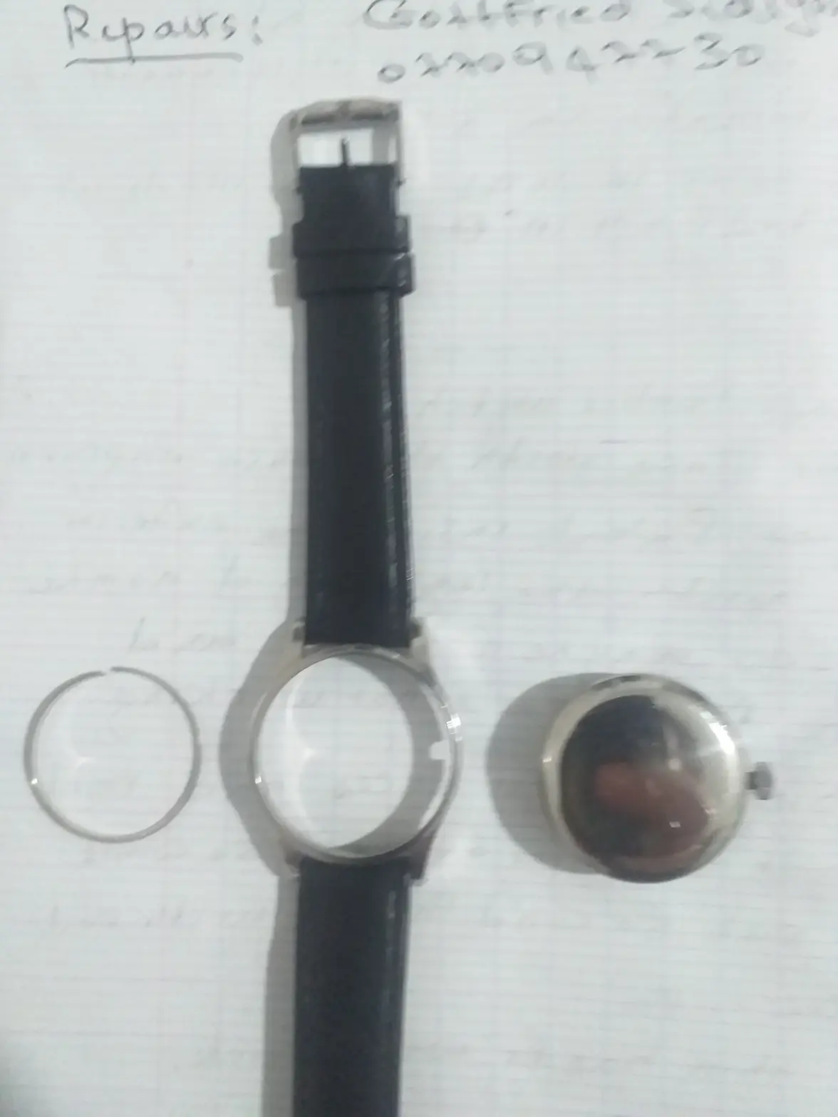

Hi everyone, I hope these new photos are much better to identify this unusual mounted omega case watch , I can't get to the movement, I don't know what caliber it is , please help.

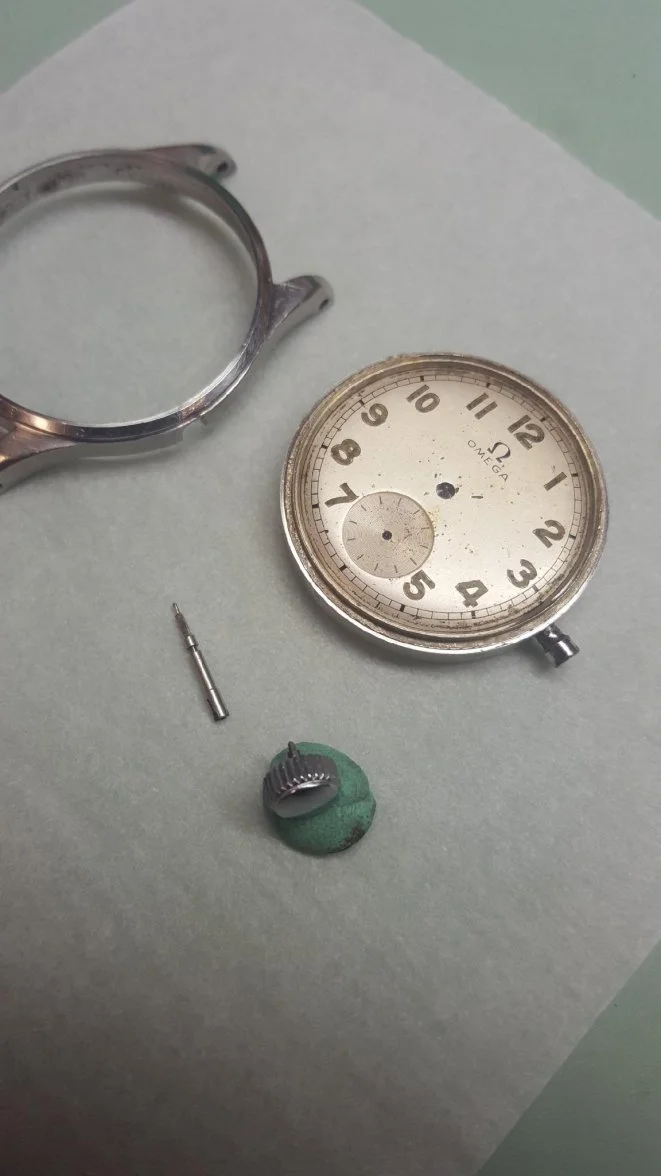

This is the other example we were discussing via PM in 2018.
I've been unable to come up with anything to relate it to an Omega model reference.
The case serial number dates to approximately 1943/1944. The movement serial number dates to approximately 1942/1943. The movement also bears an OXG stamp which means that the movement was imported into the US and cased there which was normal for that era.

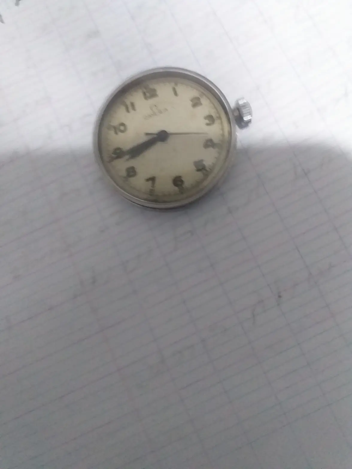

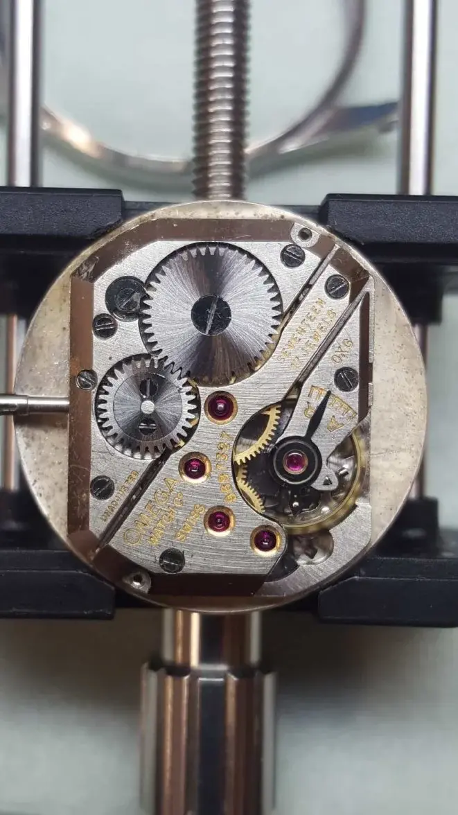

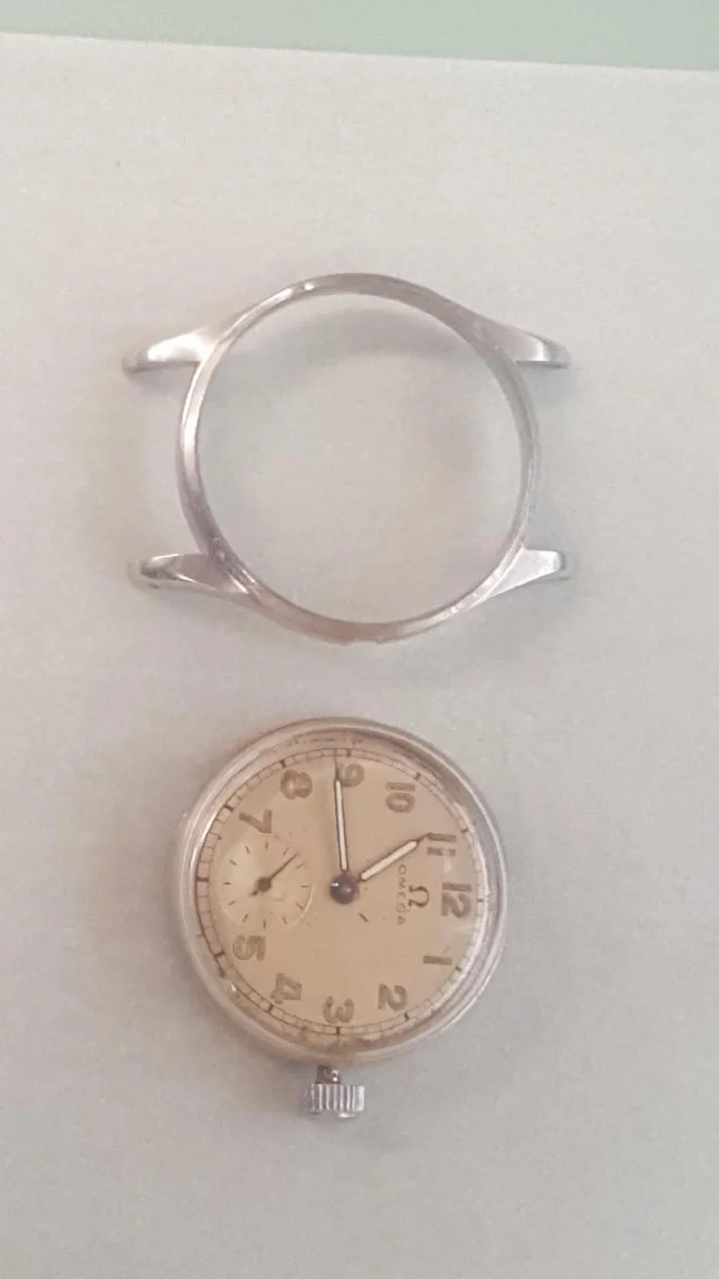

Hi there, I forgot to tell you that I managed to open the watch , it's indeed a R17.8 SC , thanks for your help .
