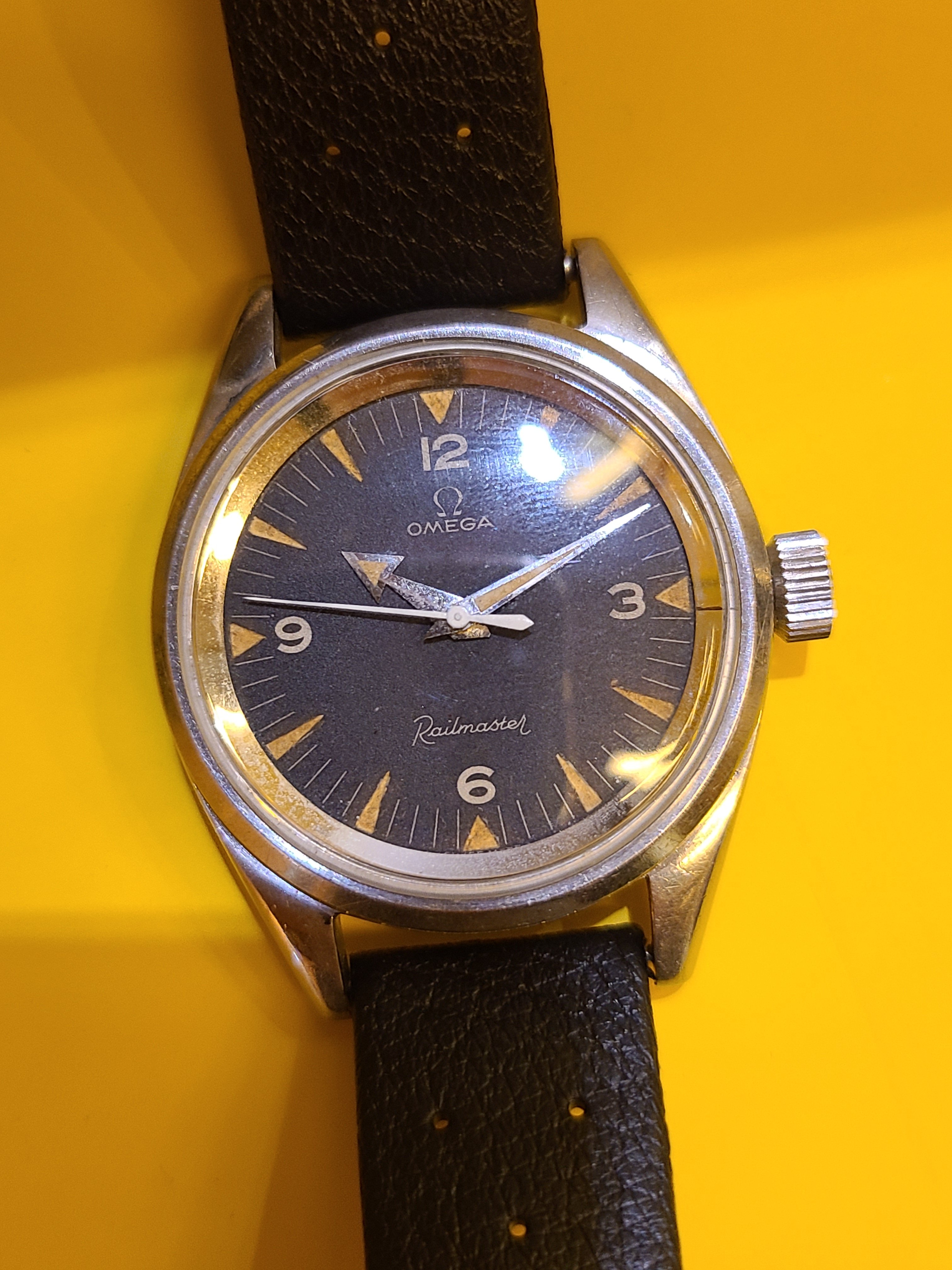

I ran across this Railmaster for sale locally today and wanted to get your feedback. Caseback stamped 2014-6. Case is pretty toast, pretty polished but movement looked good and nice dial. I think second hands and crown are wrong but price is nice ~5K usd. What do you guys think?

Check the inside and amag cage, inner cage back, and get the money. Kind regards. Achim

The hour and minute hands are indicative of an earlier RM, 2914-1 thru 3 perhaps. Second hand is incorrect. The minute hand lume appears too long. Perhaps not a RM hand?
365
455
It looks like a Mk1 with an amazing dial at a first glance. (Lume issues maybe) By all means I am no expert on these...
592
2,784
Besides the wrong second hand, the BA handset is absolutely wrong. Both hour and minute hand to short/narrow and as gemini4 also said, wrong lume area. And yes, should properly be a dauphine handset on a -6 ...

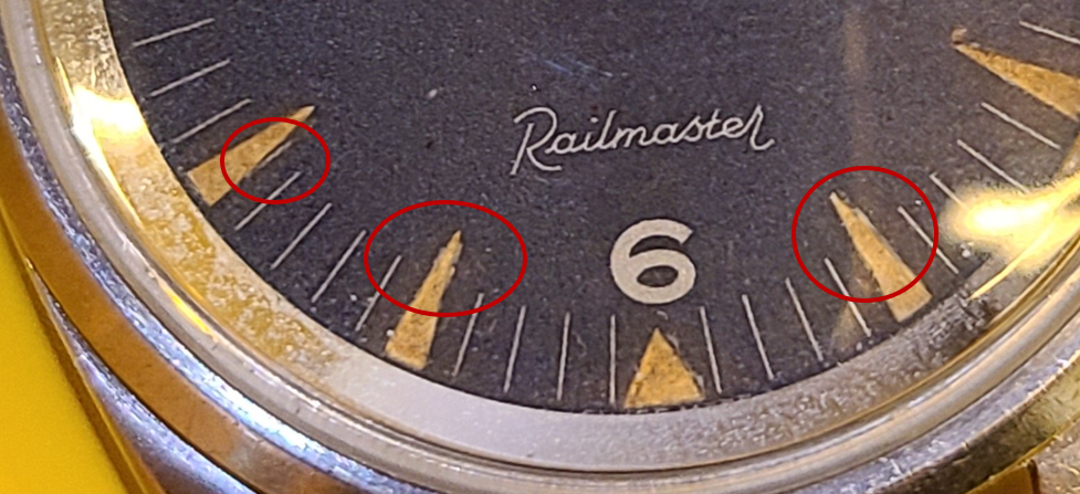

... and not sure I like the lume plots. Looks overfilled a few places.

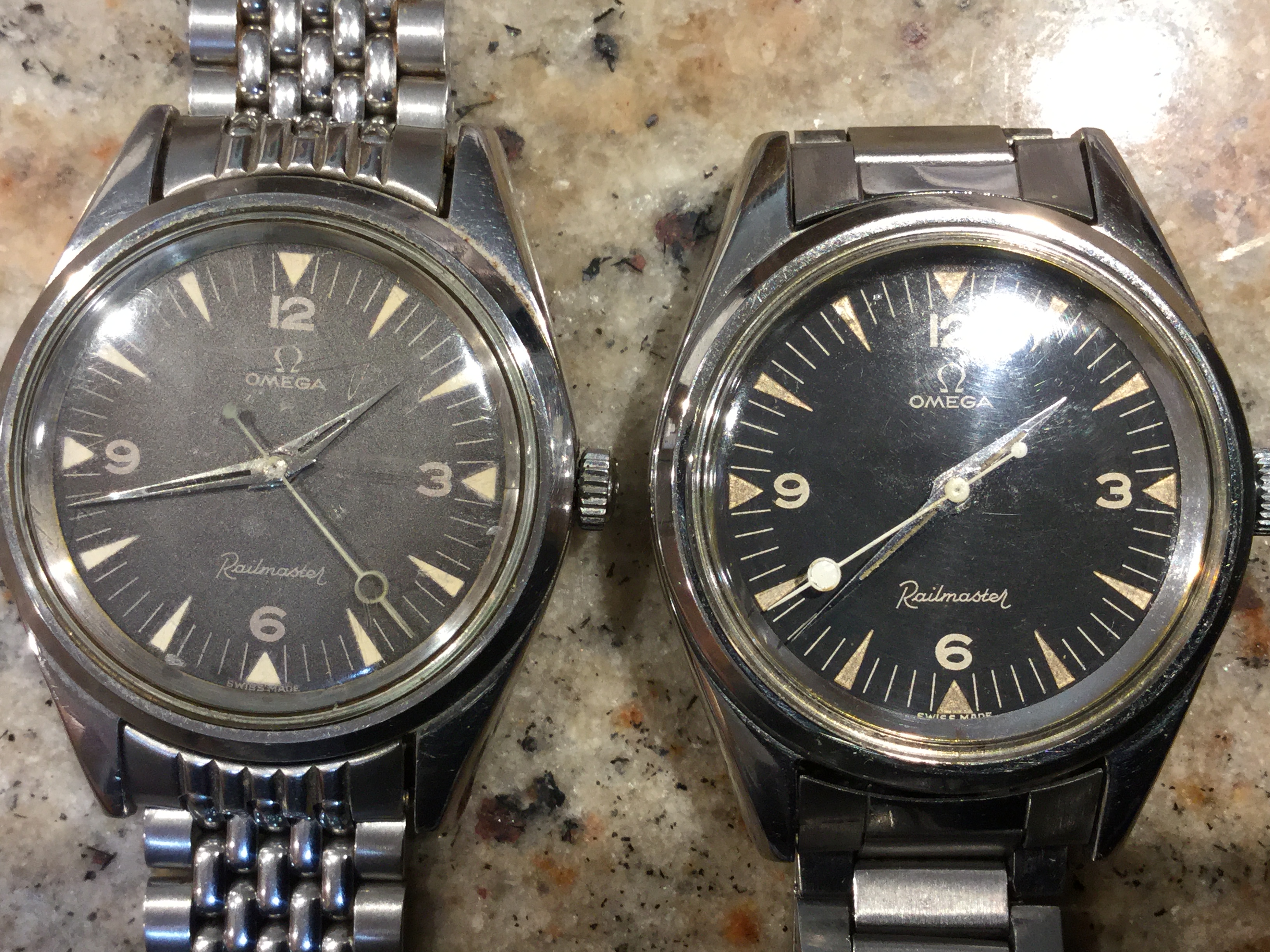

Compare to this

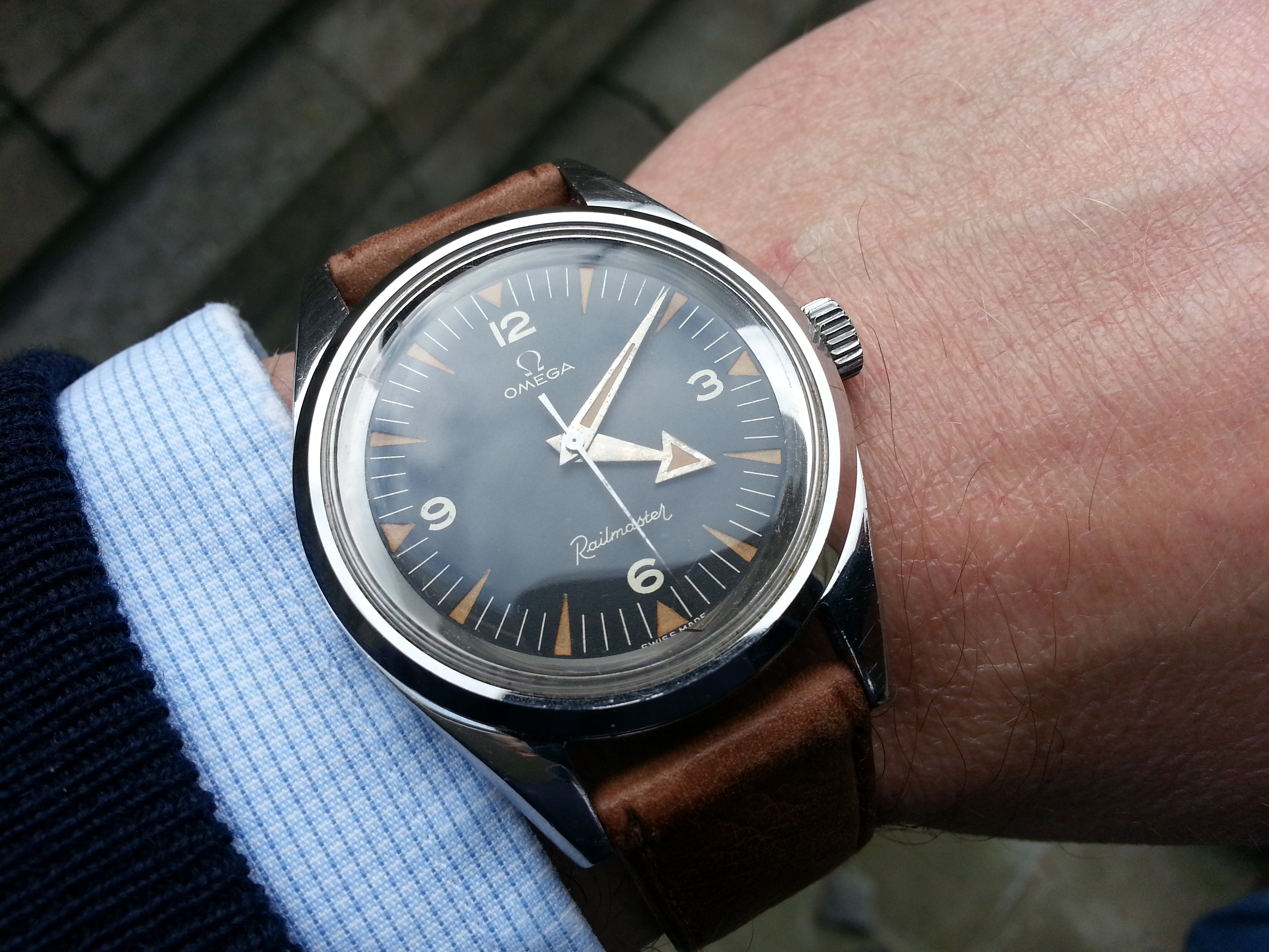

A pair of Railmaster 2914-6 with correct hands and lollipop.

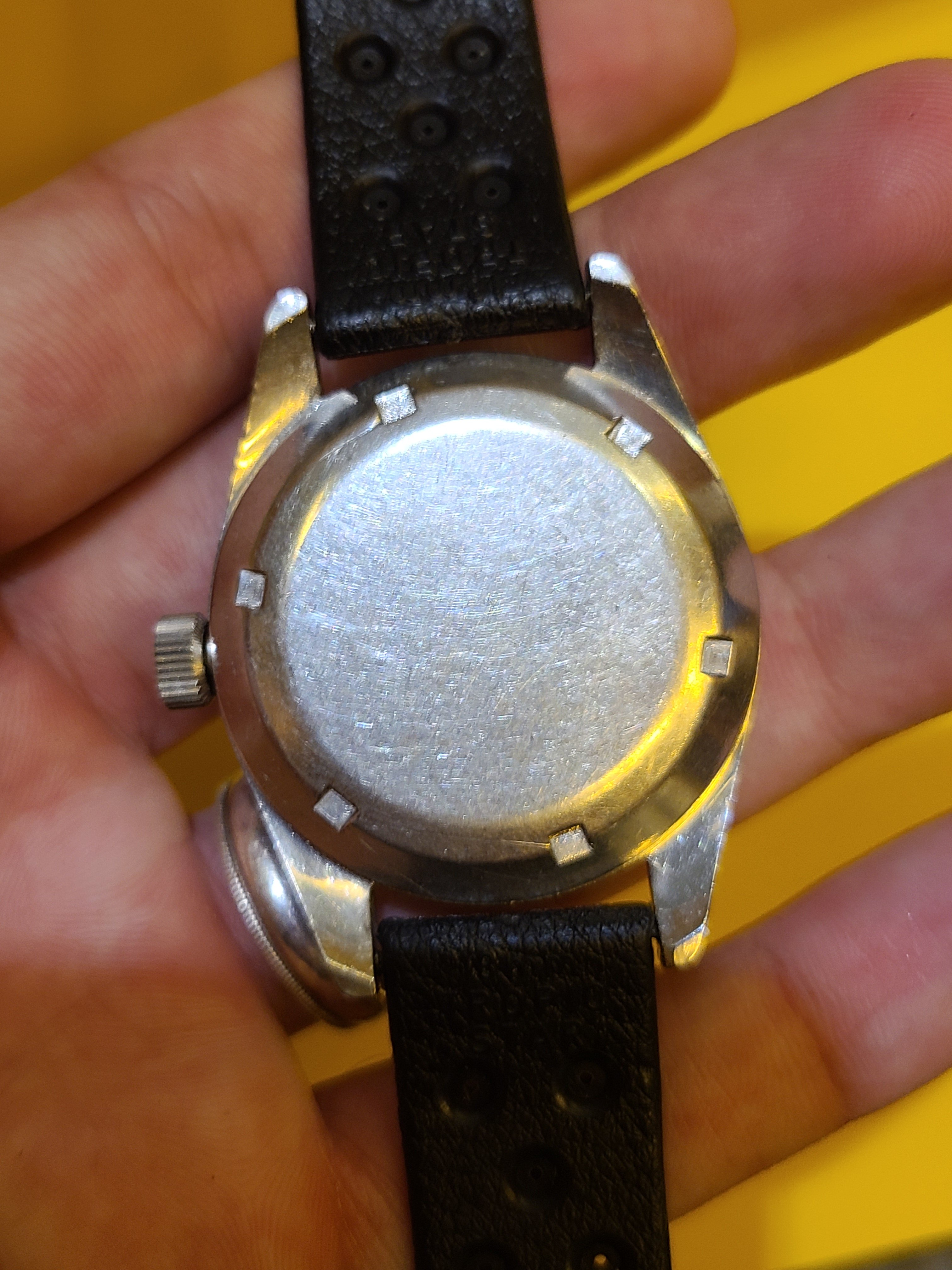

Inner caseback is 2914-6. Wouldn't let me take a photo of the movement but looked clean. Serial was early 2M. I didn't think BAs were right for a -6.
What do you think @kox is off with the dial?

As said the plots looks overfilled at places. Might be traces after lume touch-up or relume... or might just be lume floating or radium damage! The lume just usely is a bit recessed/crumbled on these dials. I would get a UV shot and better close-ups. Just a yellow flag to check up upon IMO.

Probably caliber 286 which IMHO is proper for a 135.004-63. Caliber 285 is generally found in a 2914-6.
1,605
6,485
Yes it was a 286 caliber. So sounds like a bit of a dog. Such a shame, it actually looks really nicely on the wrist.

For less than 5k it would be ok. Both calibers are fine for a that reference. But would need factory excerpt for starters. And the back engraving intact/ not too shallow. I'd have offered to swap the BA hands for the correct ones .....kind regards. Achim

I couldn't make out the back engraving. Maybe with a loop but its pretty much gone.
