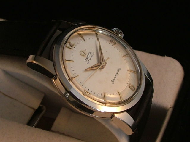

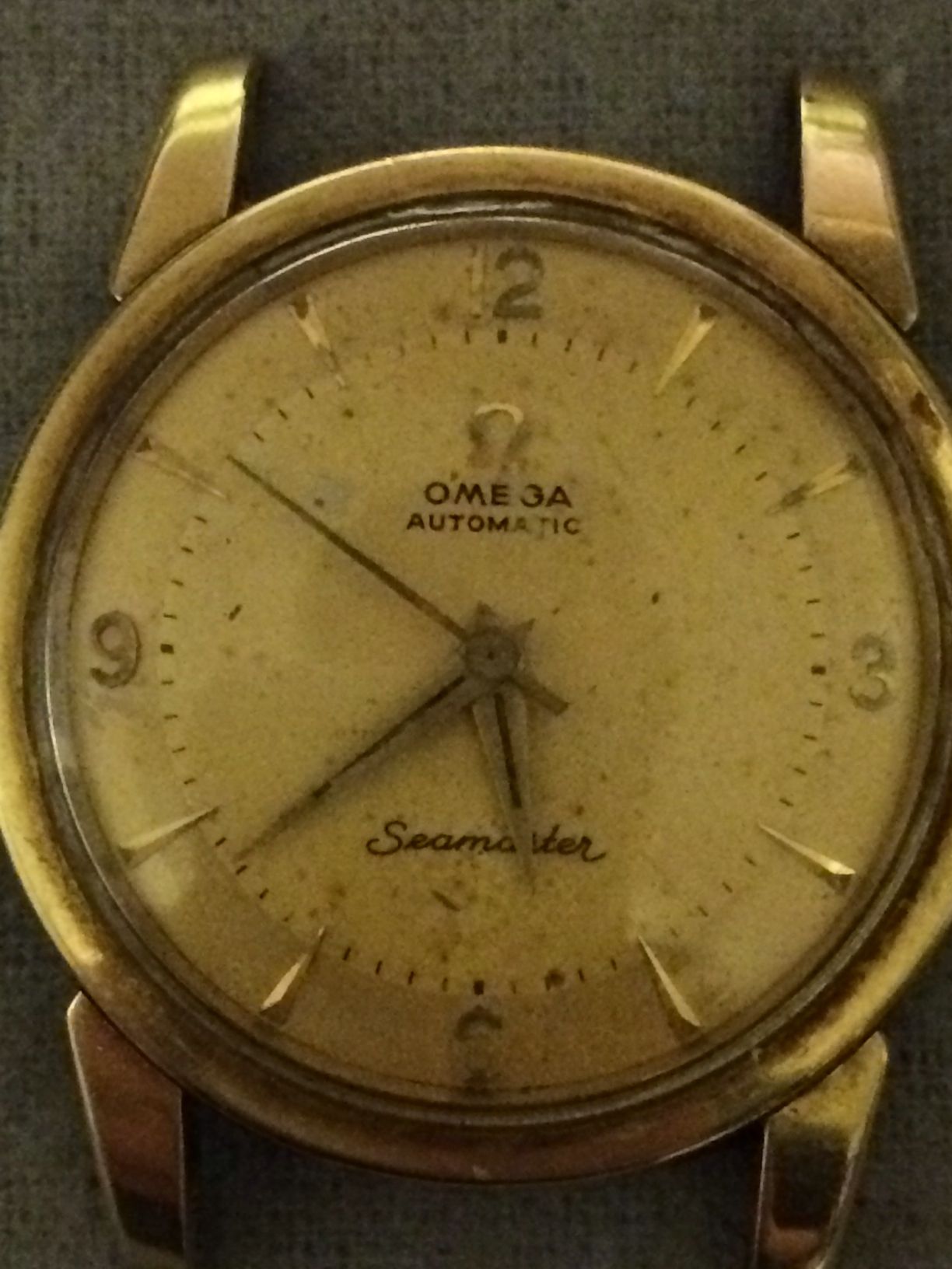

Hello everyone. I have been bitten by the vintage Seamaster bug after years of interest in various other watches. I have been looking at a lot of watches and trying to get familiar with the issues. I'm gravitating towards the 2846 case series and a few related dial designs within that.
Lately I've had my eye on one at a high priced dealer with a pretty good reputation (although that, like every other opinion here it seems, isn't unanimous). It has a quartered arabic dial exactly like the ones pictured in these two threads, with no apparent 'swiss made' (same S, m, and r in Seamaster, and heavier than usual line weight, same font everywhere else including the arabic markers):
https://omegaforums.net/threads/1956-seamaster-with-no-swiss-marking-on-dial.10258/
https://omegaforums.net/threads/advice-on-first-purchase-seamaster-1956-or-ref-2639-12-1952.108319/
I've run into a few others:
https://www.watchuseek.com/threads/omega-seamaster-vintage-new-purchase.769787/
https://www.chrono24.com/omega/omeg...-sliver-dial-moon-dust-patina--id16760427.htm

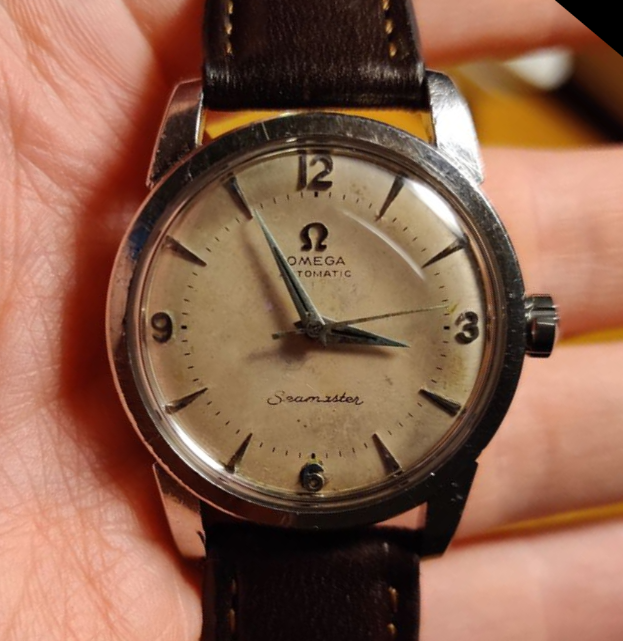

This dial gets mixed reactions at this forum. Quite a bit of skepticism and a few more or less tentative thumbs up. To me it looks like the lack of the 'Swiss made' might be a result of some incompatibility between case and dial size, or possibly because the crystal and expansion ring are not compatible with the dial? Is this a correct dial for the case or not? If not, is it in fact a redial?
To further complicate things, I found another dial with the same effect and the same secondary hour markers. Given the, to me, atypical-looking hands and crown, maybe the dial is a hodgepodge, but it seems again that 'swiss made' could just be hidden in the area beneath the markers which are just about flush with the (tension ring? rehaut?).
https://www.ebay.com/itm/OMEGA-SEAM...755553?hash=item1a90b25361:g:0SQAAOSwbSJeNu~T
Thanks in advance for any insights, corrections, etc!

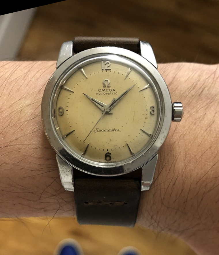

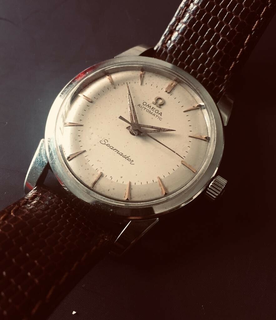

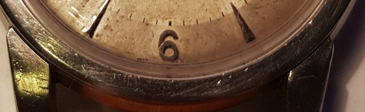

Most of the watches you link to have dial problems in one form or another- be it water ingress, heavy aging or possible unsuccessful cleaning attempts. Whatever the reasons the results are dials in poor condition missing areas of print, be it minute hash marks, logo text, or maybe even the 'Swiss Made'. Especially with less than perfect dial cleaning it's the Swiss Made and minute hash marks that can disappear first.
And there has to be a special mention for the CH24 seller of the overpriced $1500 POS with missing text, hash marks, Swiss Made and the rare and possibly unique 'pendulum' 6 o clock marker.....
To quote, "What is special about this watch is the way it has patinated like moon dust on the two tone silver dial"
The only thing special about this watch is that it has a deluded owner who dares to ask 5x its worth when selling.
Actually when I look closely it looks to me like this one has possibly some remnants of a 'Swiss Made'
10,804
16,814
Post photos not links, links can go dead so for the benefit of posterity a photo is best. On the one I could be bothered to click on and study, the rehaut was very high on the rim and Swiss Made is likely there but obscured. I would be very wary of any dial where Swiss Made or Swiss is totally missing, as opposed to just obscured or worn away.

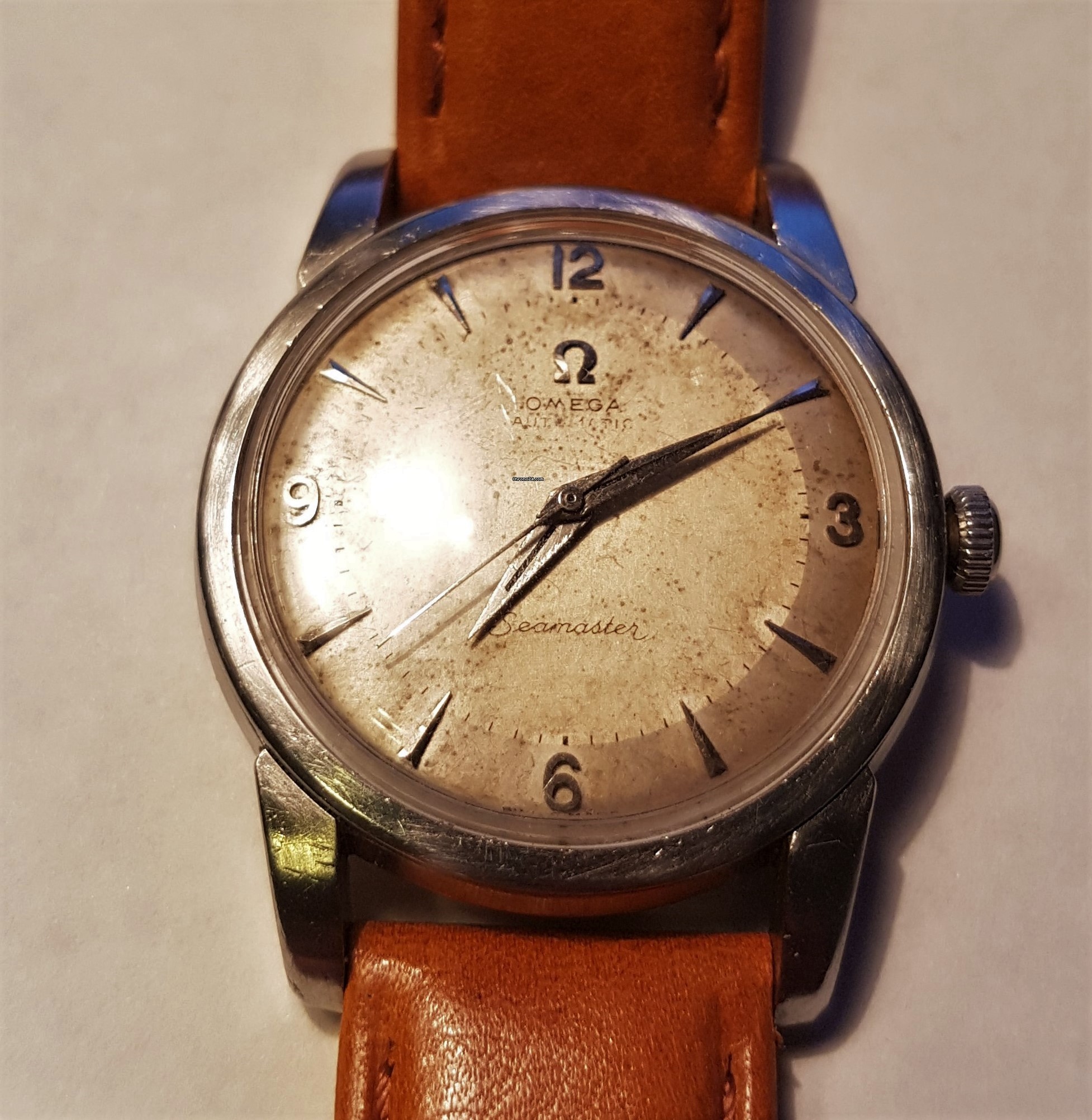

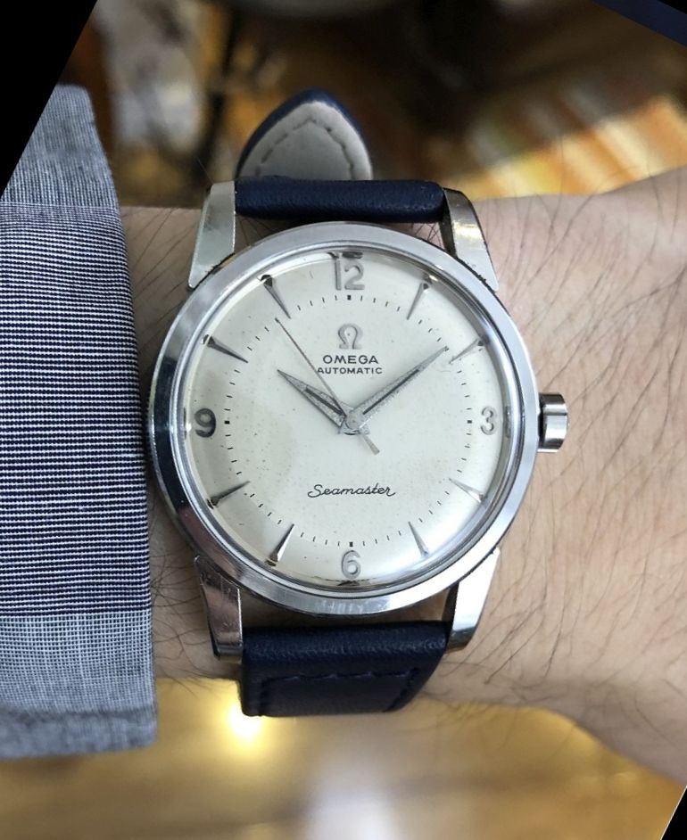

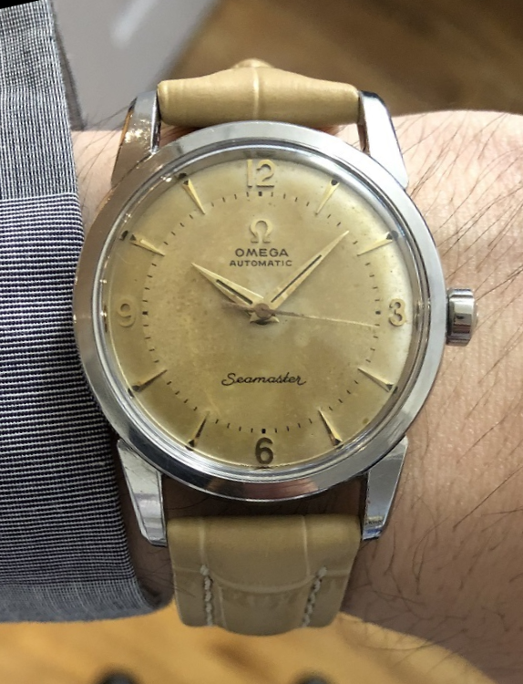

All - since I keep running into examples of this specific type, I am wondering if the argument can be made that it is original. Was the "Swiss Made" optional in some markets? Might these be an error ("Swiss Made" accidentally printed under the rehaut because the design calls for all markers to just about butt up against the rehaut?) Stock intended for another case design with a different crystal mounting method used in a case where the tension ring gets in the way? Or does the script and perhaps a legal requirement re: "Swiss Made" make it definitive that these are all redials?
Here's another one:
2,816
6,951

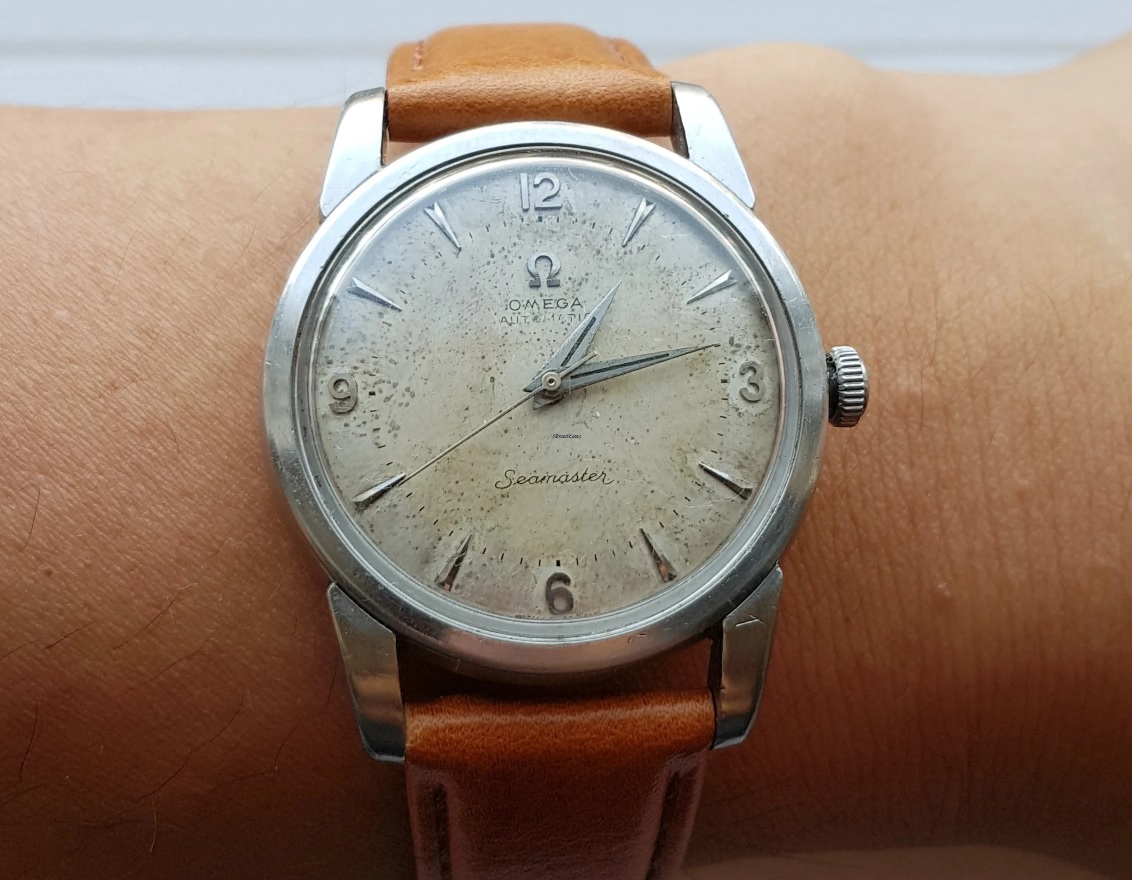

Reasons for no “Swiss” or “Swiss Made” on a 2846 Seamaster:
- Text has been washed off due to cleaning (some of your examples above)
- Text is hidden by crystal retention ring (common)
- Dial has been repainted (and they failed to include the Swiss/Swiss Made text)
That’s about it.
9,588
27,706
That’s about it.
This. No other explanations - and I might add, not for any other post-war Omega either.
I should add that the examples shown so far have looked good, as has most of the ones in the threads the OP cited. One of them featured a Seamaster were water damage had blurred the text, which made people say that it had been redialed which could be seen by the bad fonts...

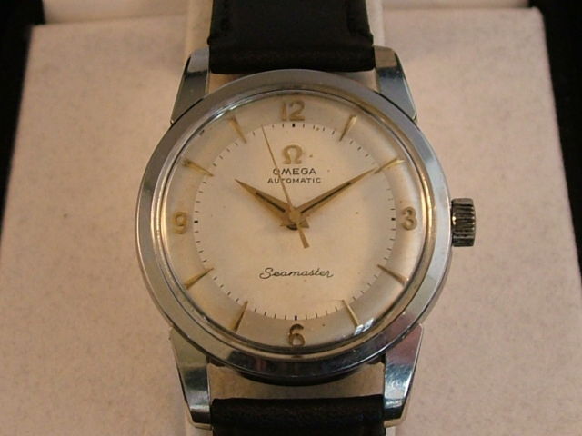

ConElPueblo - the truth is that by the time I had finished finding examples I had convinced myself that the doubters in the other threads were mistaken, and I had splurged on the one in the last picture I posted, from Omega Enthusiast's site. I've paid quite a premium for it, but now that you all have helped me lay my concerns to rest I will enjoy my expensive peace of mind. Although now that I've got the vibe for Seamasters we'll see how long it is until the next bout of obsessed research.
