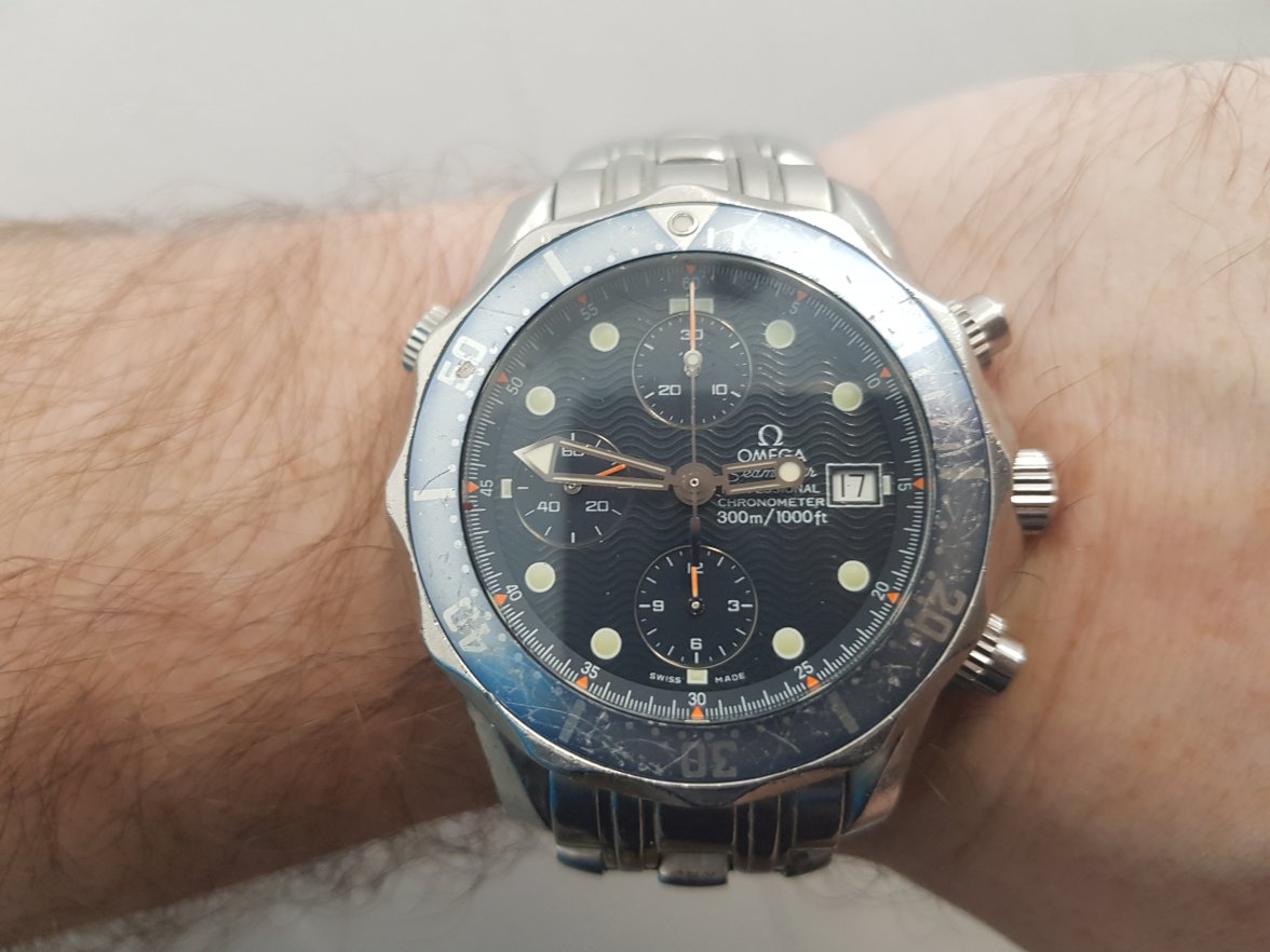

2006 Omega Seamaster 300 chronograph 2599.80 Fixer Upper

I would send it to Al to fix
I appreciate the plug, and the sentiment behind it. But the reality is, Omega is going to replace so many parts on this watch for the regular service price, they will loose their shirt on the service. I'm talking primarily about movement parts, not case parts, assuming that the inside of the watch looks similar to the outside. Right off it will be a barrel complete, most likely an automatic winding bridge, new rotor complete (you can't just replace the bearing in these, so an entire rotor is needed), a number of train and automatic winding wheels, and knowing Omega a whole new balance complete...that's off the top of my head. Then the standard case parts that are always included, so new HEV, crown, pushers, and case tube, a full set of hands, and seals.
Omega is a large company that can take losses like this on a small number of watches, knowing that they will make up on watches that really don't need much in the way of parts. For me I charge a flat fee for service, and charge for parts based on what they cost me. I would be working at a loss if I only charge $750 for this work, as the parts alone would likely total more than that...
As I've said before, often with modern watches if you run them into the ground (this qualifies for that I think) then the best place to send it is the service center.
Cheers, Al

Hi, the quote for the service is a flat rate Omega charge for Chronographs here in Australia. This price includes all parts relating to the movement itself, although I am not sure this includes the main spring.
Anyhow I have emailed them again for some clarification and I will post the response here. To be honest, I find this whole process very interesting and I appreciate all of your feedback so far. Like you, I am very interested to see how this turns out. I also don't expect this to come back to me in factory mint condition. I believe it will be quite a lumpy looking thing. We'll see.

I think the description for this watch on eBay would include "well-loved." Price seems right for the condition and you seem to have the patience for the refurb. Great purchase.

Omega can service the movement and replace the bezel, but the rest will never look the same unless they replace the case & bracelet too
That is actually possible. They might say that the case and bracelet must be replaced because they can't be refinished... in which case the referenced case restorer might be a good choice.

Indeed, I will have omega work on the internals and then I have can have the case refinished by a third party if it comes to that. I too believe Omega might decline some or all of this service. We will see what happens 😀

Well the watch arrived and using my human eyes and not a macro lens it actually looks quite ok. Also, I gave it a wound and it is running? I was told it was 'junk' and not working.
My main query is that the warranty card is dated 2001.3.04 but the serial number is 80049753 which I thought was a 2006 serial range. What do you guys think?

Omega have replied and provided the following information.
A full service is $1130AUD as of February 2020.
They will replace the bezel at a cost of $360AUD
So in total I will have this beautiful chronograph on my wrist for $2750AUD. This seems to be the standard price minus a service, so I feel like I did ok.
192
152
Running well but the chrono hand isnt moving, so as planned this will be serviced.
