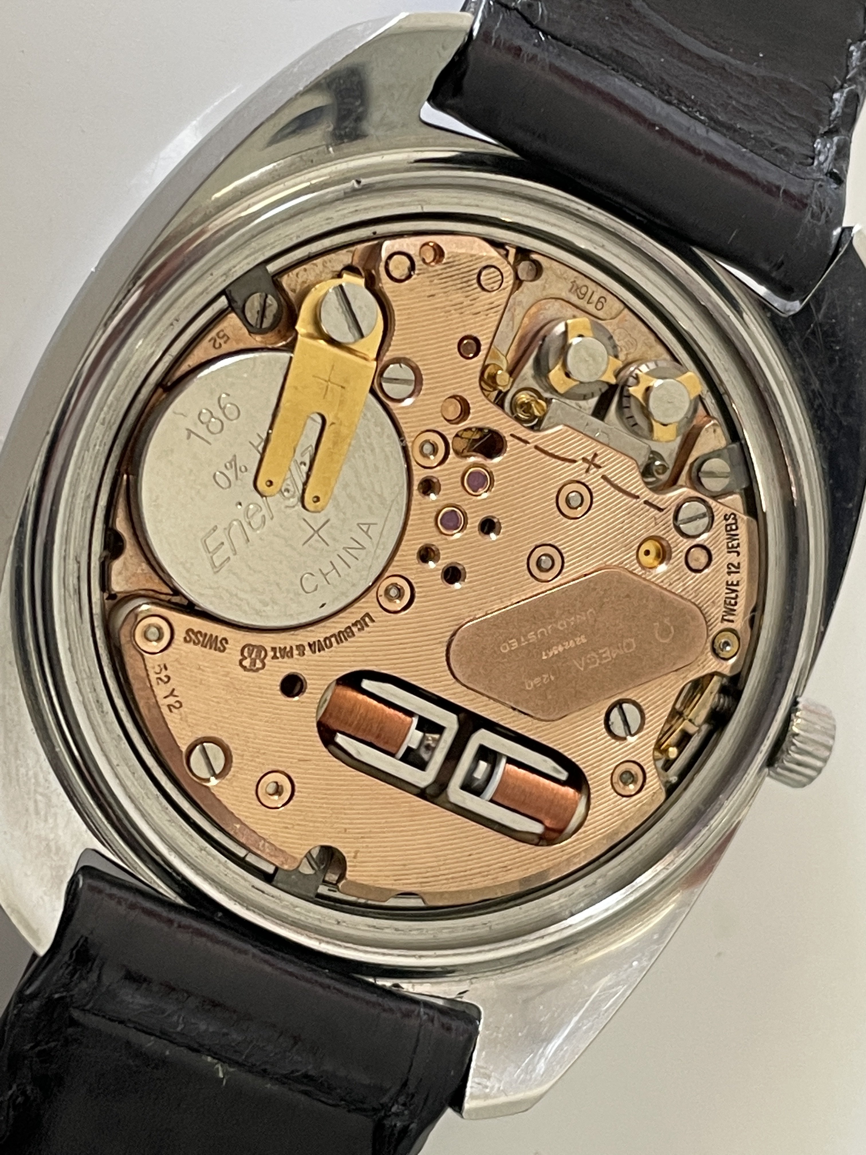

My watch wasn’t skipping teeth, I had no date wheel issues, it was just running fast and the problem was the battery.
I was talking about the OP's watch. Your watch is was running 5+ per day (I assume seconds). The OP watch is gaining 23 sec per minute which is 33120 seconds per day. I am suggesting that the OP watch was skipping teeth on the index wheel as described in the link I shared. This has nothing to do with a date wheel, every tuning fork watch has an index wheel.
9,357
78,340
Sorry, again my fault,
It was 5+ minutes per day.
4,857
12,285
I see. I would have the watchmaker who serviced it, adjust the watch so that it can run accurately on a Silver Oxide battery. I don't think you want to run alkaline batteries. Quoting from Rob Berkavicius' website (http://members.iinet.net.au/~fotoplot/accbat.htm)
"DO NOT use batteries based on any other cell chemistry than silver oxide or mercury, or severe damage to your watch may occur due to leaking chemicals or gas, which have nowhere to dissipate in a sealed watch except onto all the working parts. This applies especially to Zinc-Air cells, which at first glance may appear to be a good alternative to mercury batteries."
6
I hope this is a battery issue as it was working find - a replace the battery and it's running fast. Also, this from "deafboy" and thanks deafboy:
My watch runs fast or erratically with the new Silver Oxide Battery. What is wrong?
This is due to a phenomenon known as "double indexing". Double indexing occurs when the amplitude of vibration of the tuning fork increases to a point where the index jewel picks up 2 teeth on the index wheel, not just one as it should. The amplitude of vibration of the fork has increased because of the higher voltage of the Silver Oxide cell. For a complete description on how the index mechanism works, click here. It's well worth taking the time to read and understand this.
Can this be corrected by "re-phasing" my watch?
In many cases, the watch can simply be re-phased, and it will run fine, though very likely the built-in "safety factor" (described below) will be reduced. Occasionally, something else will need to be done to correct the problem. Many repairers used to "mix-n-match" coil sets and tuning forks to get a combination that works. Due to manufacturing tolerances, some forks vibrate at a slightly higher amplitude than others. The hope was to find a coil set/fork combination that worked ok. This can be a very laborious and frustrating process, not to mention the extra wear and tear inflicted on the movement by having to dismantle it so many times. Another method I have heard of is that some repairers increase the tension on the index and pawl fingers, hoping that the increased load will reduce fork amplitude. Needless to say, this is a practise which can only have disastrous consequences in the long run, as it will eventually destroy the index wheel. In 218 watches, double indexing can be a result of the index wheel not running true. In this case, there is really no option but to change the index wheel. Alternatively, use an Accucell 1 battery.
There is a better way of solving this problem
One of the problems of both the re-phasing and the mix-n-match technique of solving the double-index problem is that the "safety factor" built into the index mechanism is lost. This "safety factor" is the difference between the vibrational amplitude when a fresh cell is installed, and the amount of amplitude required to cause double-indexing. The safety factor is necessary to stop normal daily wear and tear and knocks causing the occasional double-index, and thus causing the watch to slowly and intermittently gain. There is only one way to satisfactorily solve this problem. This is to fit a regulating device to the watch which drops the voltage supplied to the Accutron electronics to a level it was designed for. In this case, the Accucell 1 solves this problem.
What are Accucells?
Since the first generation Accucells came onto the market some 10 years ago, they have undergone a process of refinement and development. I am now pleased to report that the "2nd Generation" Accucells that are now available are a significant improvement on the original design, and in fact now embody the same electronic principles that I used in doing coil modifications to Accutrons to make them compatible with Silver Oxide cells. Hence, they now deliver the correct voltage to allow an Accutron to start and run within their original design specifications. In fact, I am inclined to think that Accucells are now a more satisfactory solution than the coil modifications which I proposed in the past, especially for those watches which won't readily adjust to run on Silver Oxide cells.
There is only one negative issue with Accucells, and that is the design of the Accucell requires that a slightly smaller cell is used than the original cells, and this means that the time between cell replacement is reduced from 12-15 months to about 9-10 months or so. This is simply because the power stored in a cell is proportional to its physical size and the amount of active chemicals that can fit in it.
So, rather than modify your Accutrons, I strongly recommend that you consider using an Accucell if you are having problems with double-indexing and your watch running fast. As for owners of Omega f300 watches, and others that are based on the same movement (ESA 9162, ESA 9164, ESA 9210, and the micro-motor tuning fork watches Omega cal 1220, cal 1230 Megasonic f720hz), there should not be a need to use Accucells, as those movements were designed to run satisfactorily on the higher voltage Silver Oxide batteries as well as the Mercury based batteries which have been phased out now. However, running the Omega 1220 on Accucell-1 is recommeded, to keep wear and tear down on the micromotor.
