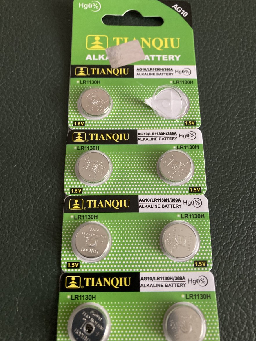

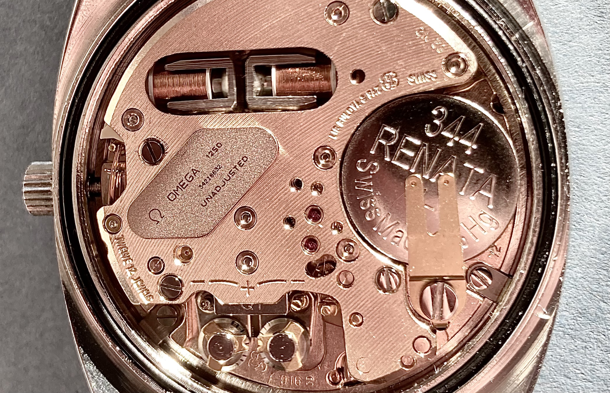

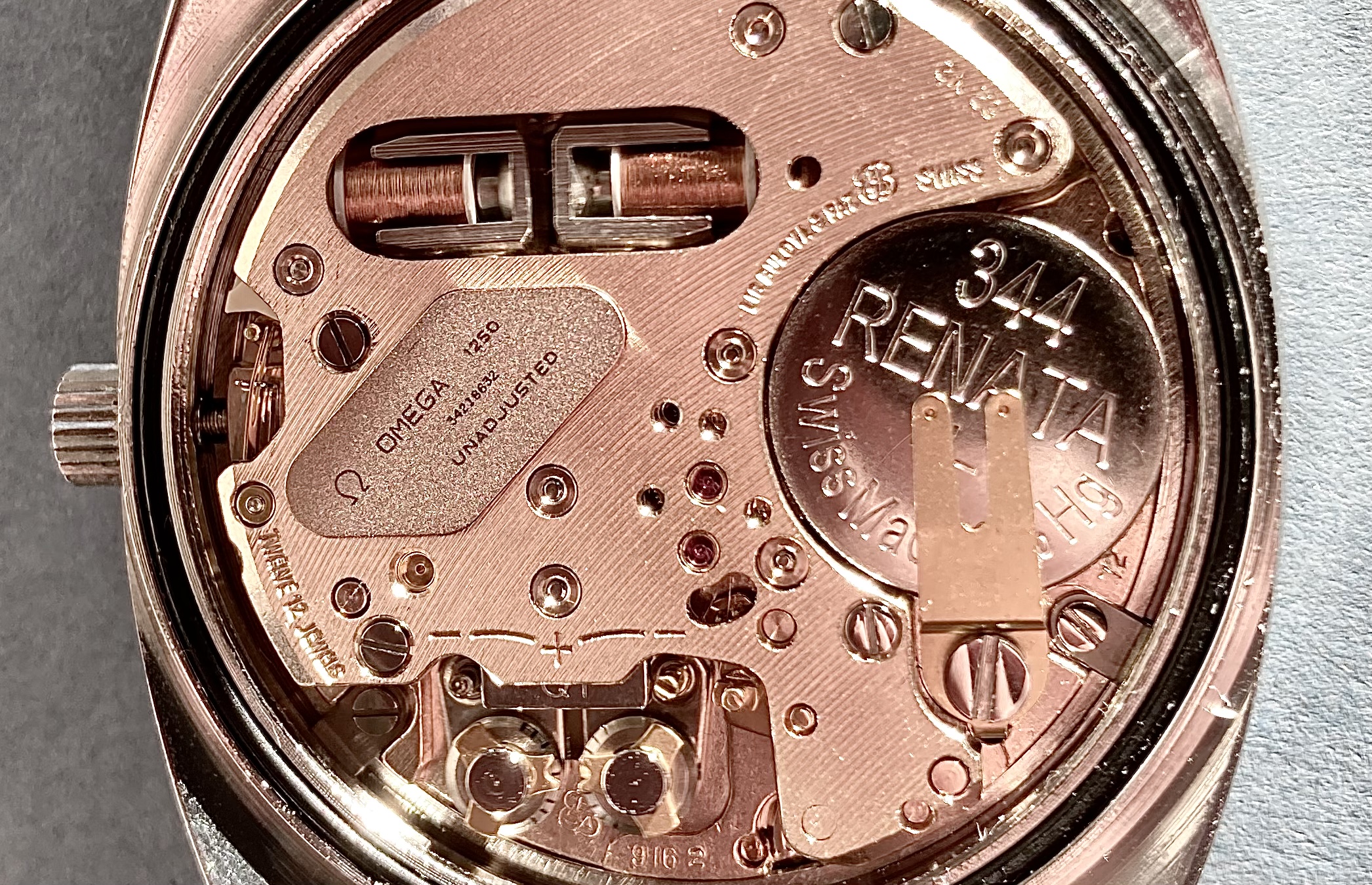

I bought this a year or so ago. The seller put a new Renata 344 battery in. The cal 1250 ran inaccurately.
I sent it to Croydon Watch Services who advised me that it would cost £300 + for a service and setting.
In the meantime, a Forum member in Turkey posted that he had had a similar problem but that he solved it by discarding the modern Renata battery and buying alkaline batteries, compatible with 1970 Watch movements on eBay.
I bought these and the watch runs perfectly although you have to make sure that the battery is seated right. When I’m not wearing it, I pull the crown fully out and the watch doesn’t run until I push it back in and re-set the time.
I believe that the watch was designed with these batteries in mind. They don’t last as long as modern batteries but I reckon that I can buy an awful lot of them for £300.

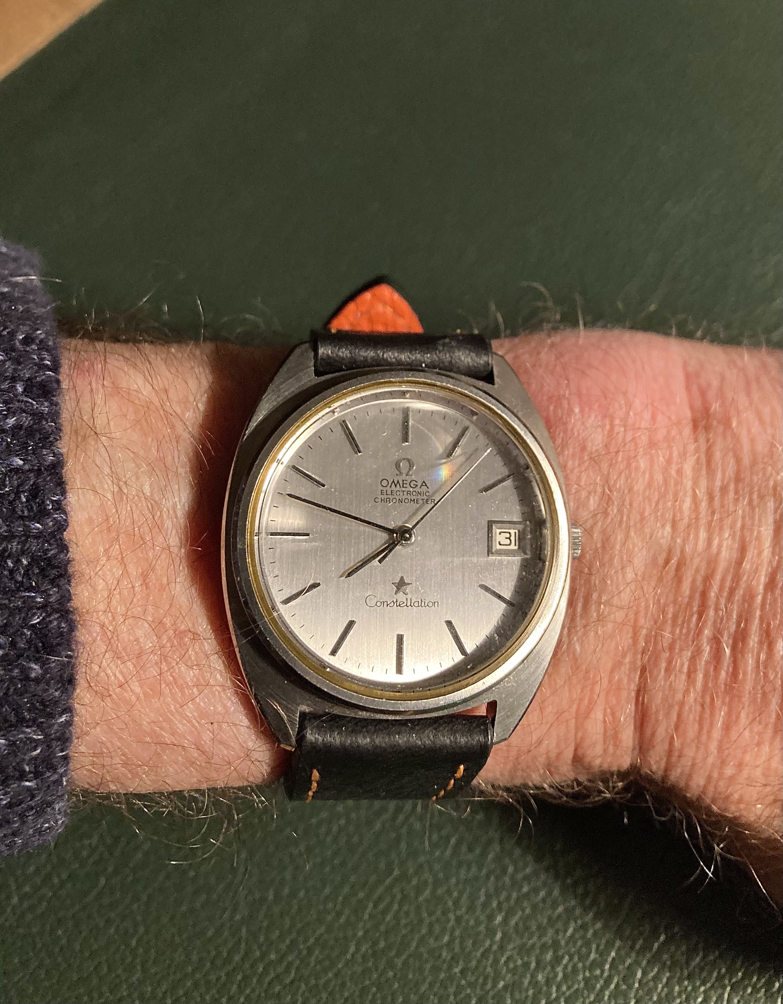

In fact, I’d almost forgotten about it but, prompted by your post I’ve set it and strapped it on.
And my present stock of batteries 😉

Regarding the battery. The battery I used is identical to your picture of your watch with the bad timekeeping (Renata 344)
9,357
78,339
Sorry, my mistake.

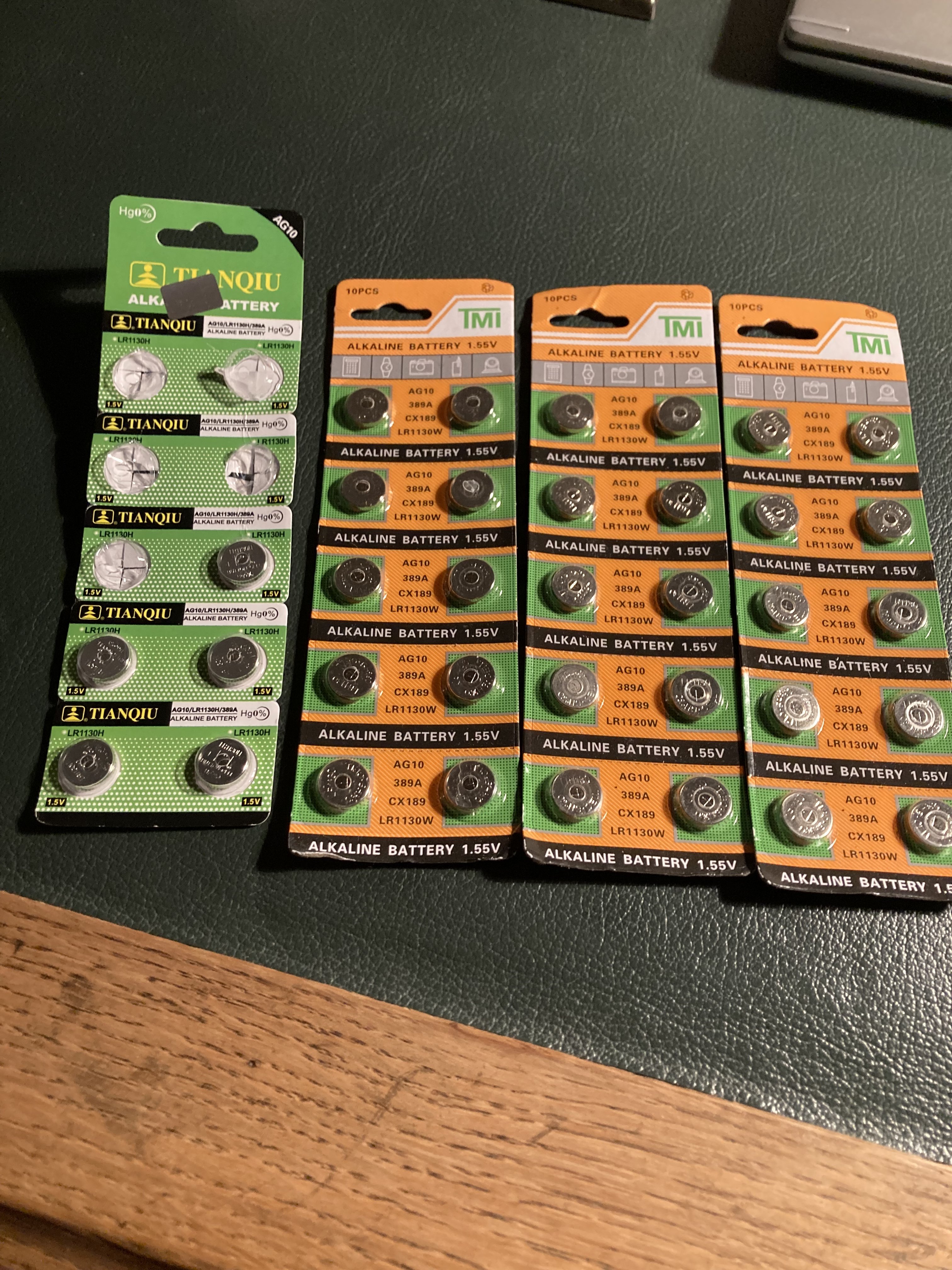

The photo with the Renata battery was the seller’s, when I bought it.
I discarded it and am currently using, very happily and successfully, the alkaline batteries in the green Tianqui packet, the orange packets are similar but spares.

Can you tell me if your watch was running very fast with the original Renata 344?
9,357
78,339
Yes, about 5+ per day.
With the alkaline battery it’s a chronometer
