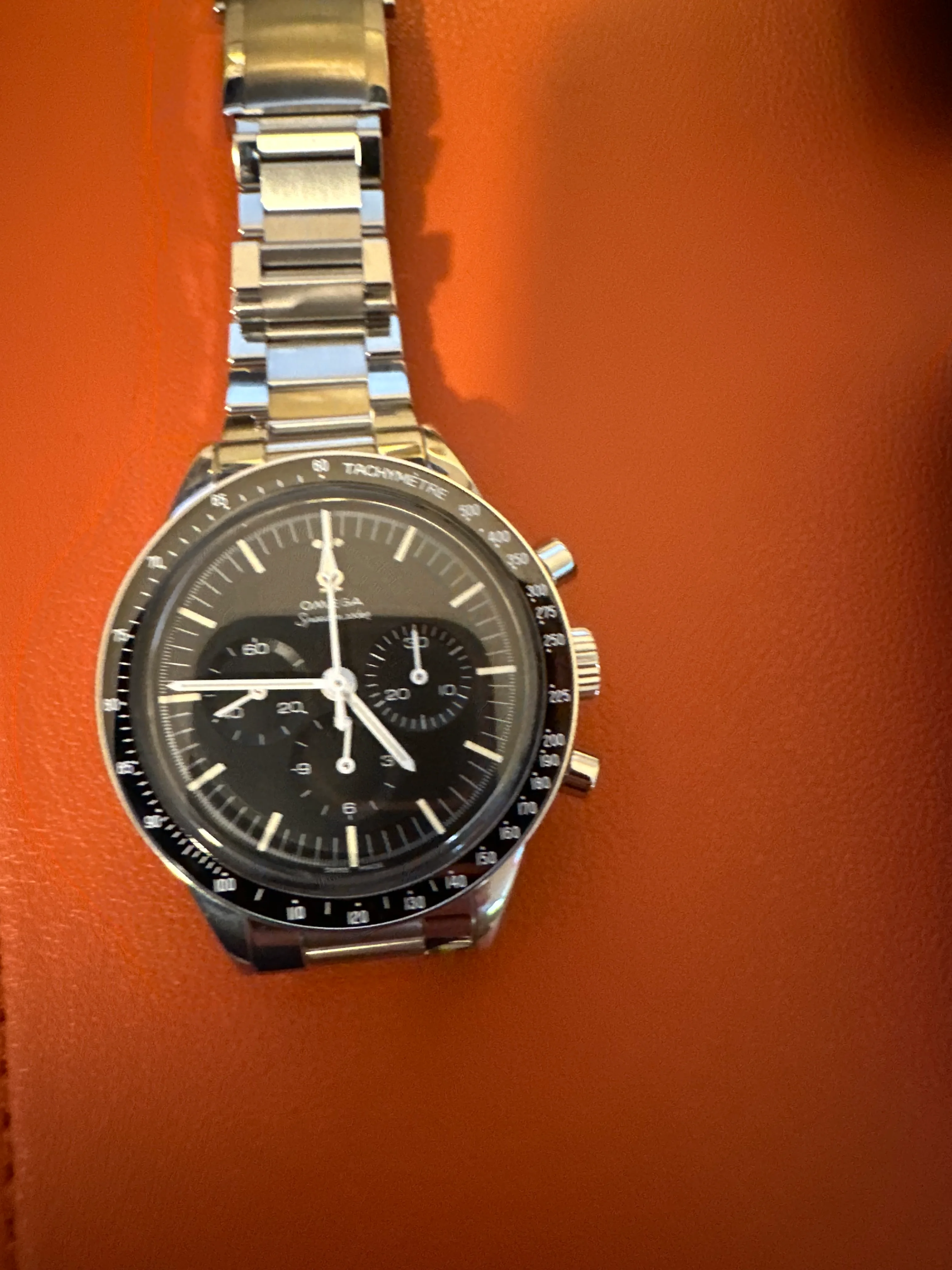

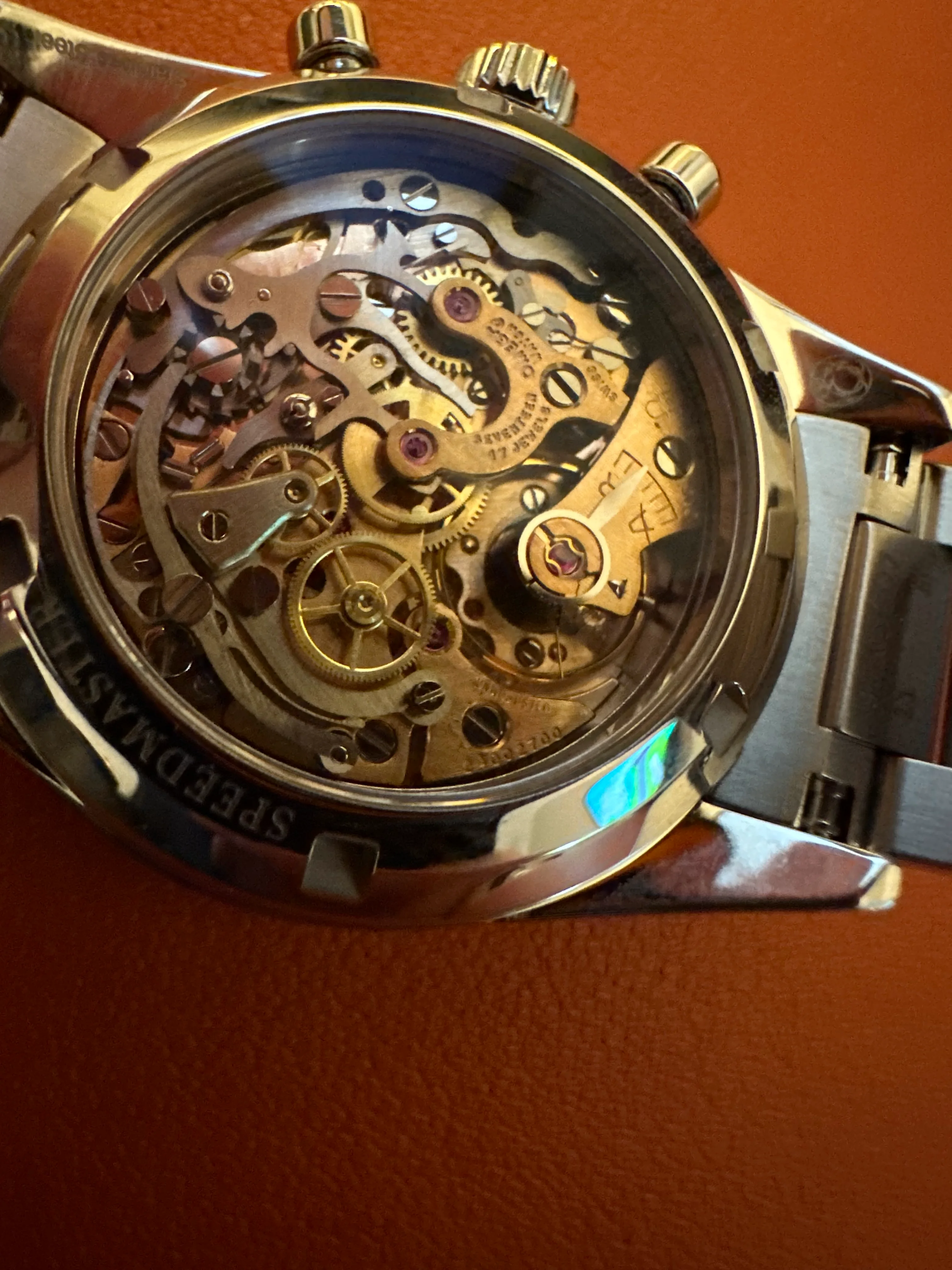

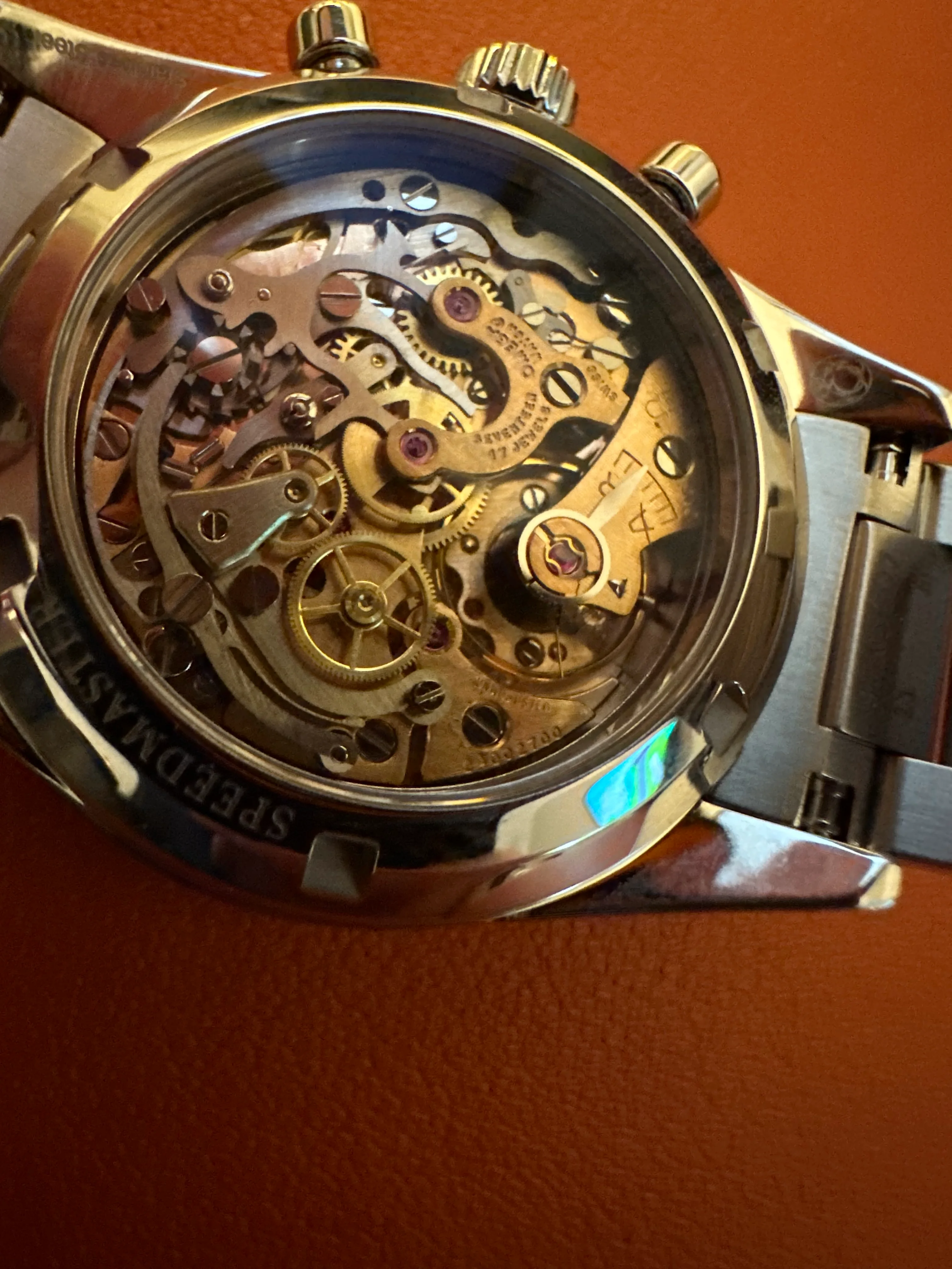

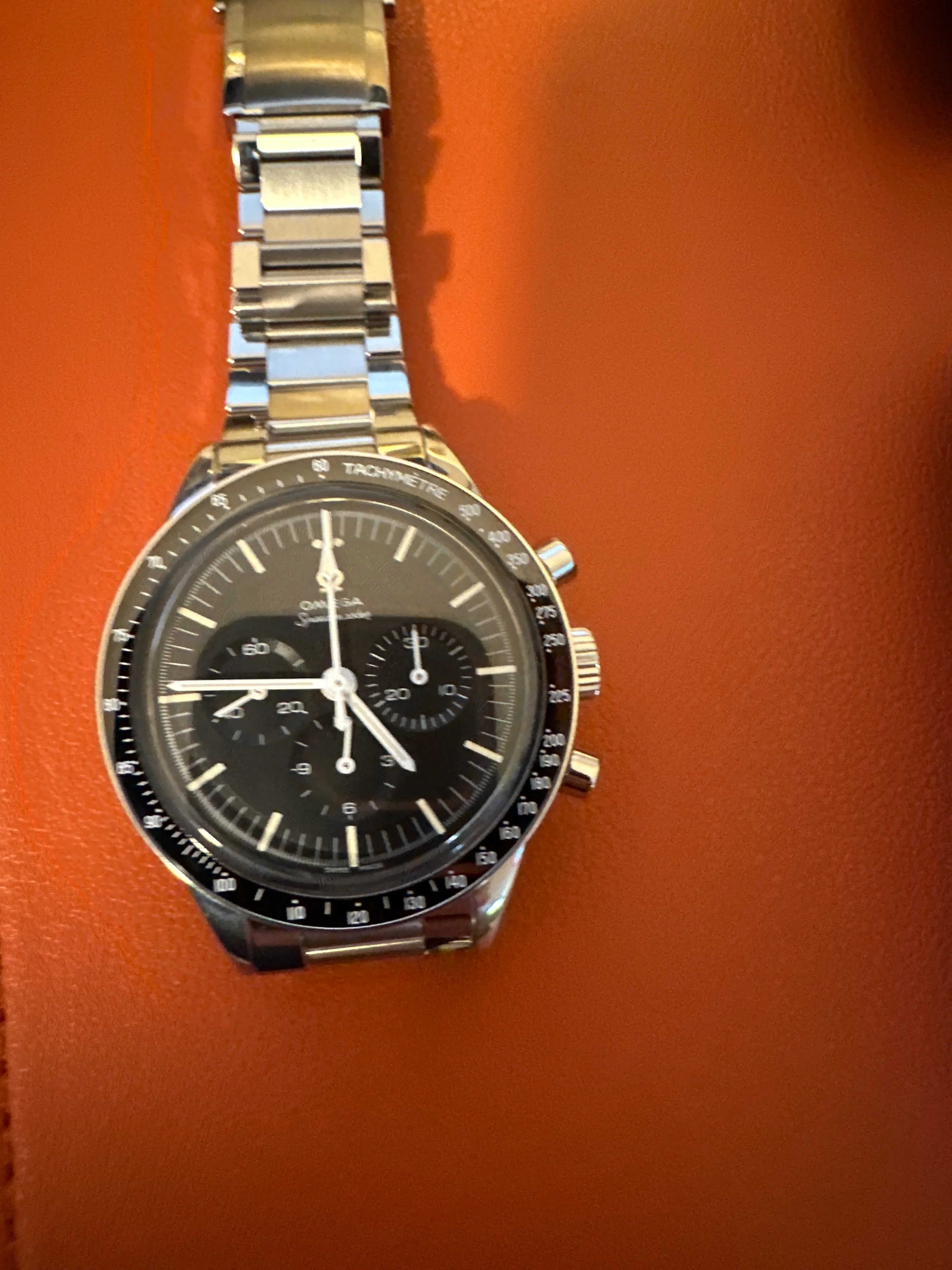

So the mission begins... picked up a 1966 321 movement with a production date of June 13, 1966 that is less than 300 from Neil Armstrong's serial number so very stoked. It was completely overhauled by Omega in 2018 so looks pretty much new and I currently have it living in the new Ed White set-up (literally the complete watch with this movement instead of the new 321) as I source original vintage 105.012-65 parts. So far I was able to acquire the correct HF case in really good original condition that has one of the original fat neck pushers still installed so consider than an early victory.
So the mission begins to source the remaining parts to put the movement back in its original home. Any insight on where to source older vintage dials, pushers, crowns, and case backs would be greatly appreciated (other than ebay which I have alerts already set-up on). Bezel and hands I may just go with service parts as I do plan to wear it often. Did find a DON ceramic bezel that was on the Silver Snoopy so that could work well.
Open to any advice from the experts on thoughts on what to keep historic original (assuming I can actually locate the parts) and what to keep practical as a watch that will be worn regularly. Not concerned on resale value as with all my watches I do not sell them.
Photos of the movement and its current home for the time being.

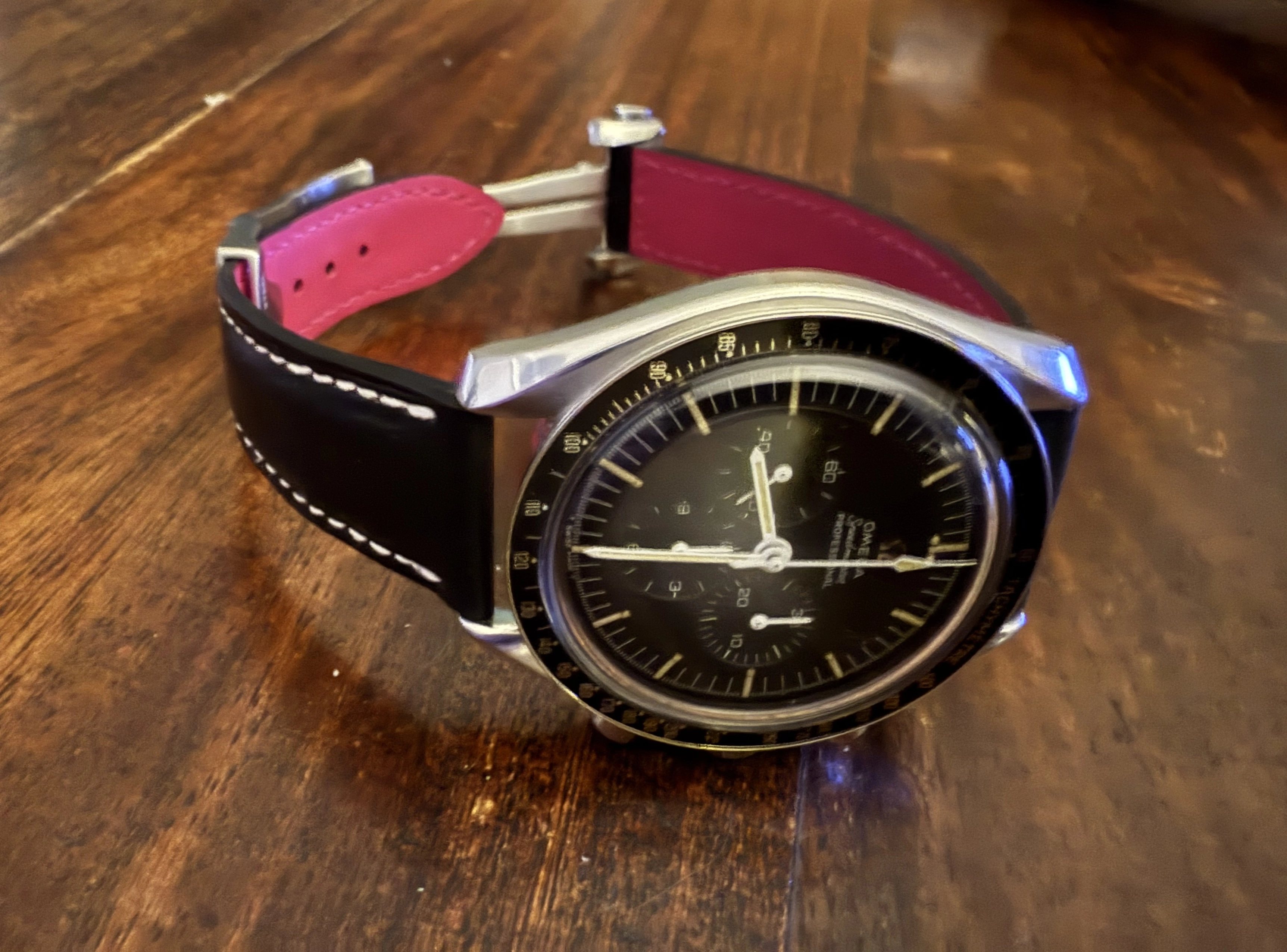

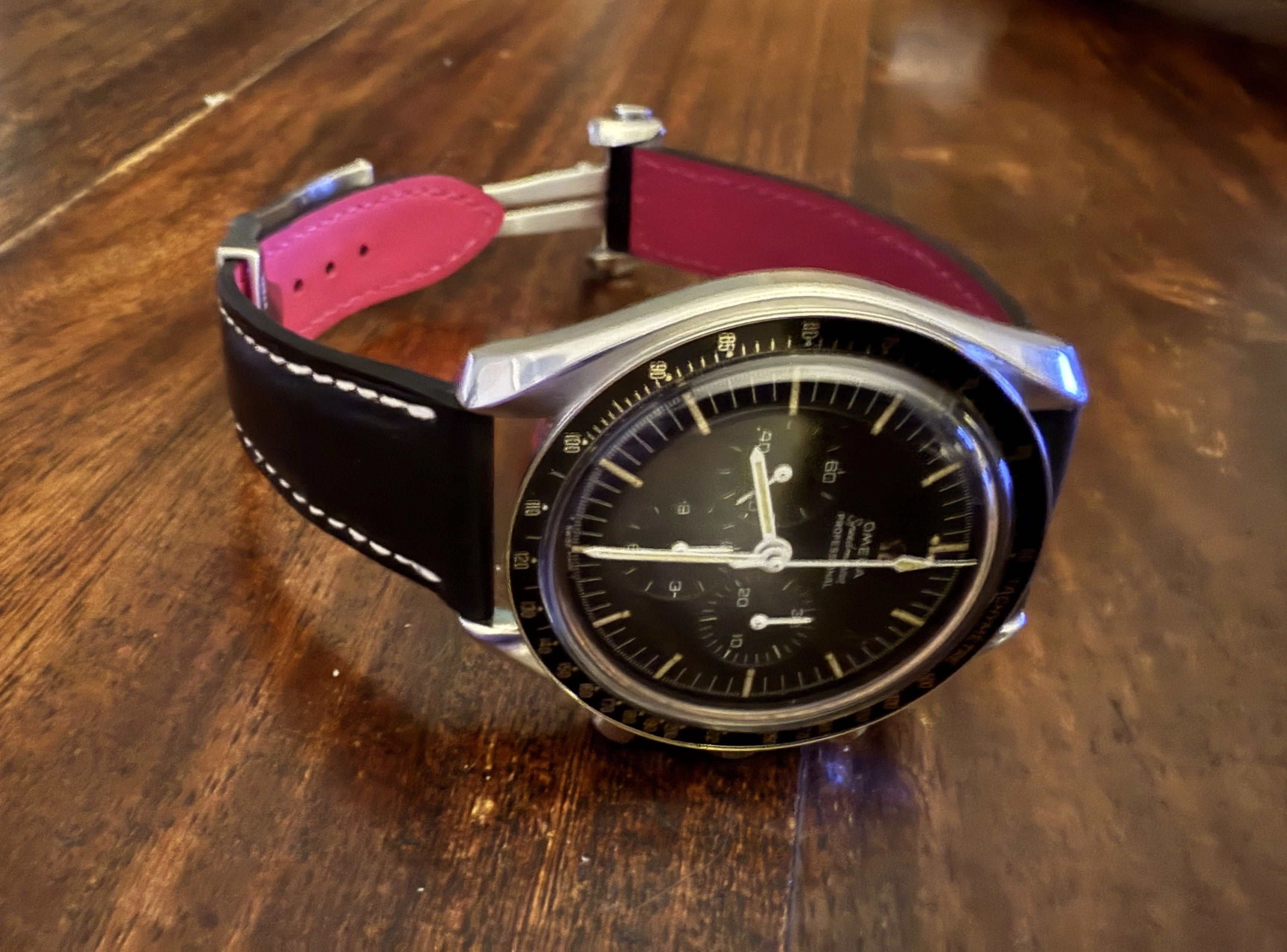

The project if finally mostly complete! I was able to track down an original case and dial from across world (literally) that are the correct versions to the reference of the month of production (used chronoholic’s posts as a partial guide). I am lucky I was able to find an original in mint condition dial as it did not think it was possible (found it in Belgium…). The one key part I am still hunting for is an original 105-012-65 case back so I have a sapphire one on for now. TM Watch did an awesome job overhauling the movement and putting it all together.
The ED White case the movement originally lived in now has a new heart beating as well. Was able to get my hands on a 2915-1 movement with papers so that is now living in the old case for now (or course with some broad arrow hands as throw back).
Here is a photo of the rebuilt 105.012-65 with its custom leather strap on it.
