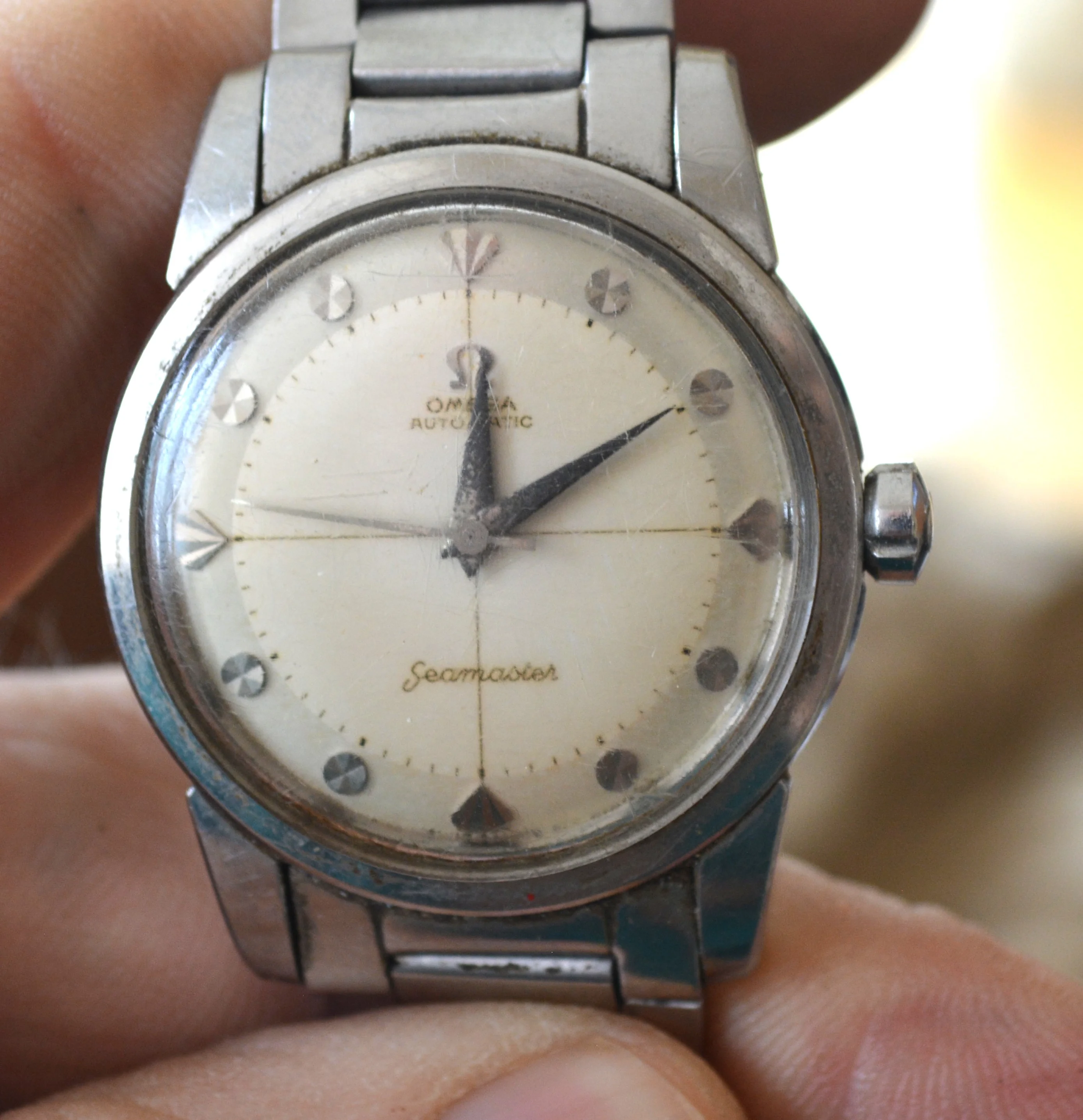

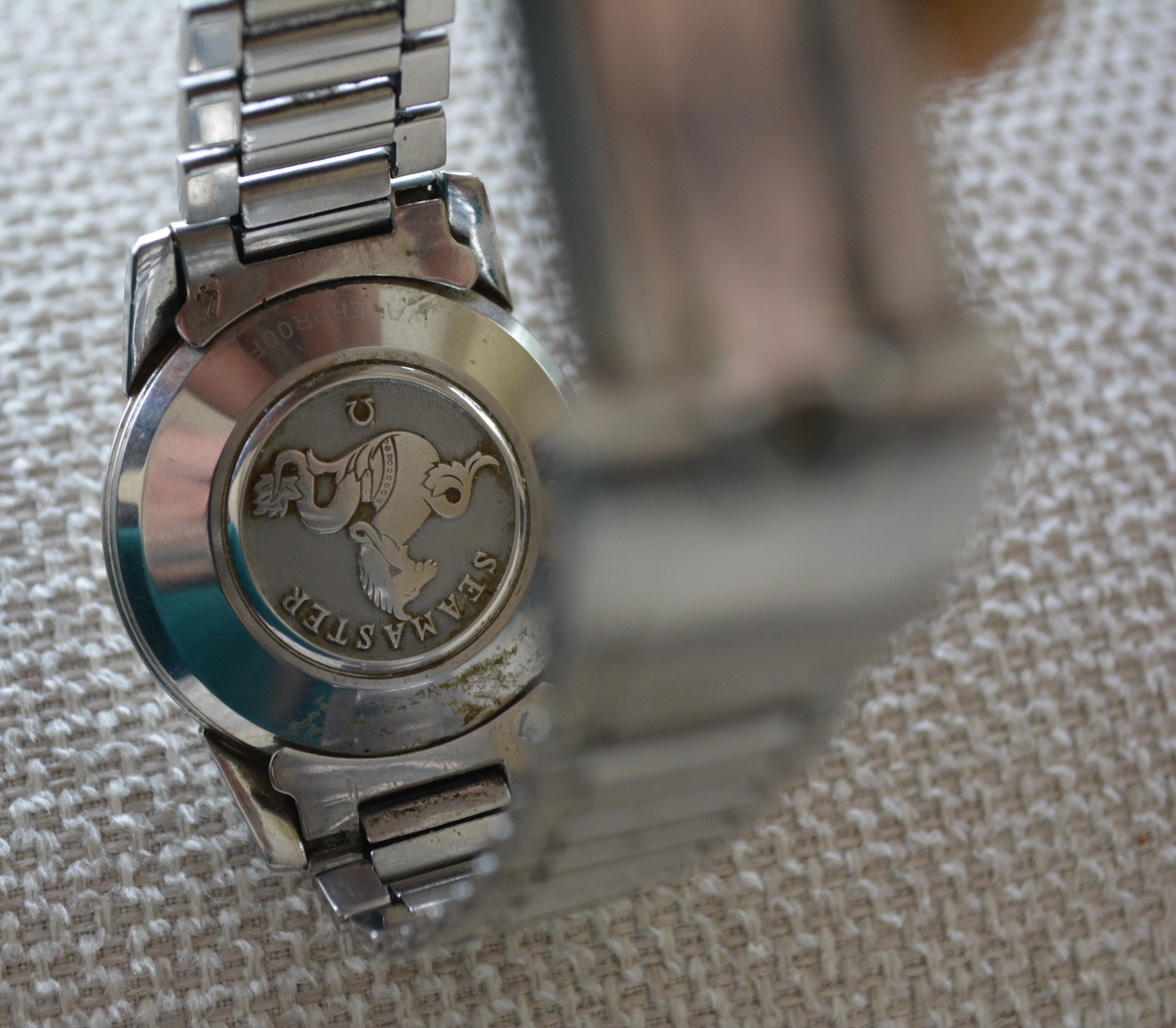

I inherited my father in-laws Seamaster watch and would like to please help in identifying it. I have done some basic research, and it look to have a cross-hair dial but I have not found one with similar hour markings. I was wondering about the bracelet as well. I would very much appreciate any help in identifying this watch. Also it appears to be running but I was wondering if it should be serviced or better to leave it as is. If service is required where is a good place to have it done?
Thanks!
10,283
16,103

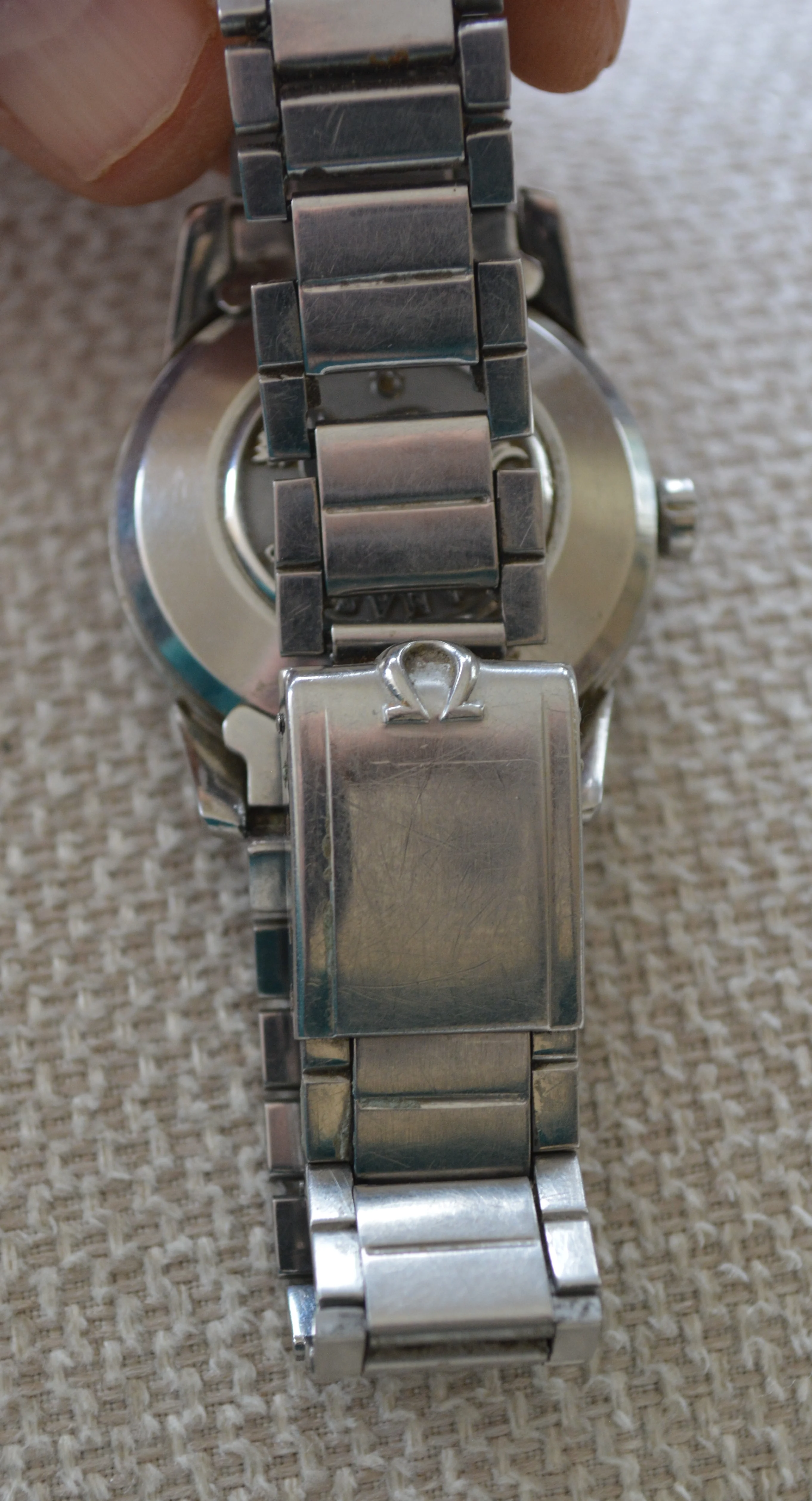

Looks like a late model 2846 or perhaps the 5 digit ref equivalent that came straight after. The big logo caseback suggests it is from circa 1958-60 or thereabouts. The bracelet looks to be a classic flat link (7077 or 7912 perhaps, not sure) and is quite valuable, perhaps more so than the head. There may be a date code on the clasp which could be quite instructive but I suspect it to be contemporary with the head so circa '59 too
There were dozens of dial variations seen on these. I've seen similar before but it is no surprise you can't find one identical.
7,796
35,403
That's a 7077 bracelet and a great dial with those arrow heads and discs.
12,910
22,329
Lovely watch. The big logo case, uncommon dial and flatlink bracelet are a great combination.
8,322
68,267
It should be serviced. If you post where you are, someone on OF will be able to recommend a good (comparatively) local watch repairer.
You could also buy some Polywatch online and polish the crystal.

I don't think the above estimate is far off, and certainly fair for an insurance estimate. But just to clarify about the flatlink bracelet. The reason they are valuable is mainly because they can be used for valuable watches, like vintage Speedmasters and Seamaster 300 dive watches. However, for those watches, wider endlinks are needed, and those wider endlinks are hard to find and valuable. So if you are looking at comparable sales of 7077 bracelets with 19mm or 20mm endlinks, you bracelet will not be worth nearly that much.
Of course, this is all moot, since you are not going to sell your heirloom ... right? Not only is it a great family piece, but it has several less common features compared to most similar Seamasters from that era (dial markers, caseback, bracelet) which makes it fun and interesting.
57
18

The watch is from approximately 1958, as the “big logo hippocampus” was only present for roughly a year.

And another thing regarding the 7077 bracelet, the most valuable will be both reasonably tight and also importantly having all 5 of their double stretch links. This one has 4 visible in the pictures, but does it have the 5th? A lot of these only have 3 as they were shortened at some point and they are certainly less attractive for a buyer as finding loose double stretch links is very difficult.

Thanks for your question. I double checked and it appears to have 2 stretch links on each side of the clasp. I never noticed until you asked but the two on one side have no spring action so I would assume that the springs are broken? Can these links be repaired? Thanks!

Urdelar used to sell replacement springs, but I just went to the site and didn't find them.

Thanks Dan, I suppose the springs are unique to the 7077? Also looking at the logo on the inside of the clasp with a magnifier I saw a date code of 4 on top of 58.
4 is OK, yes they can be repaired

The springs may be the same as in some of the other Omega bracelets, e.g. 1039.
