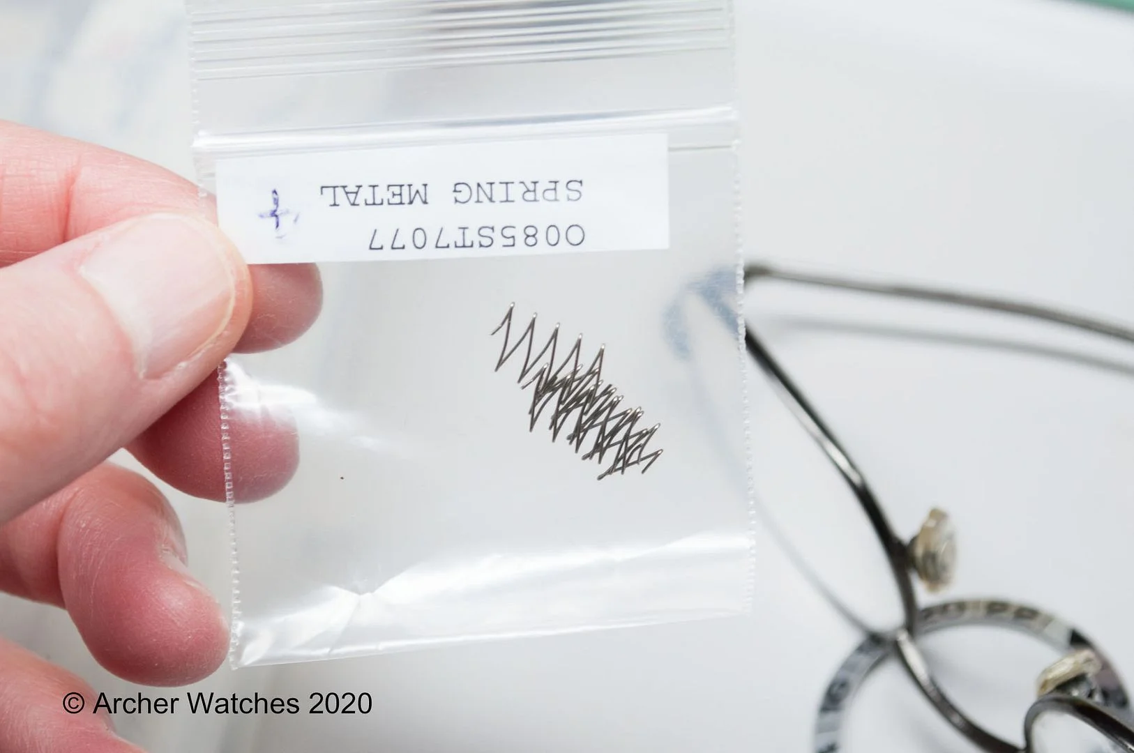

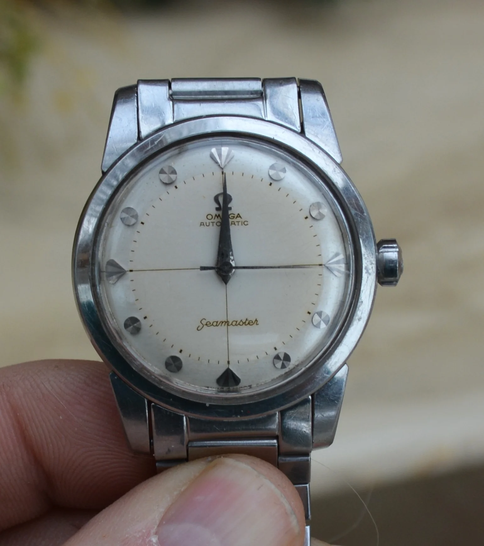

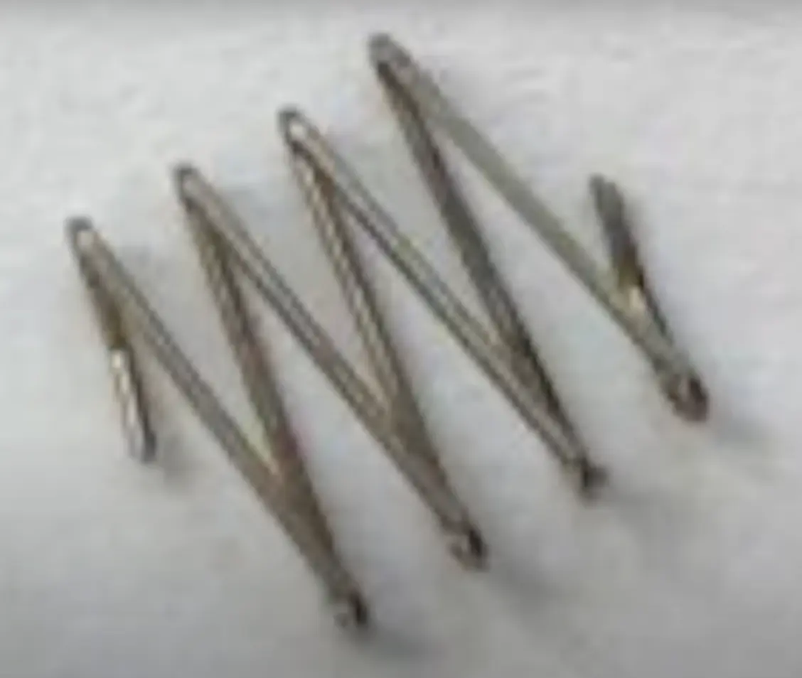

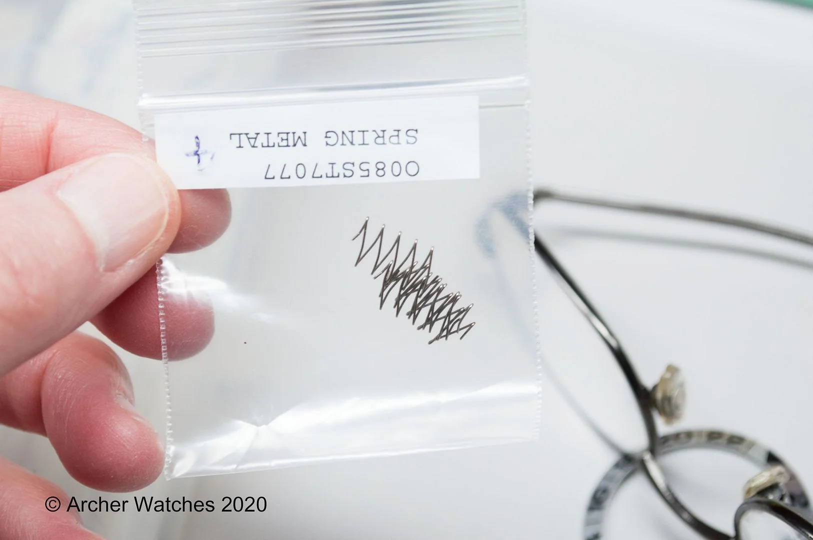

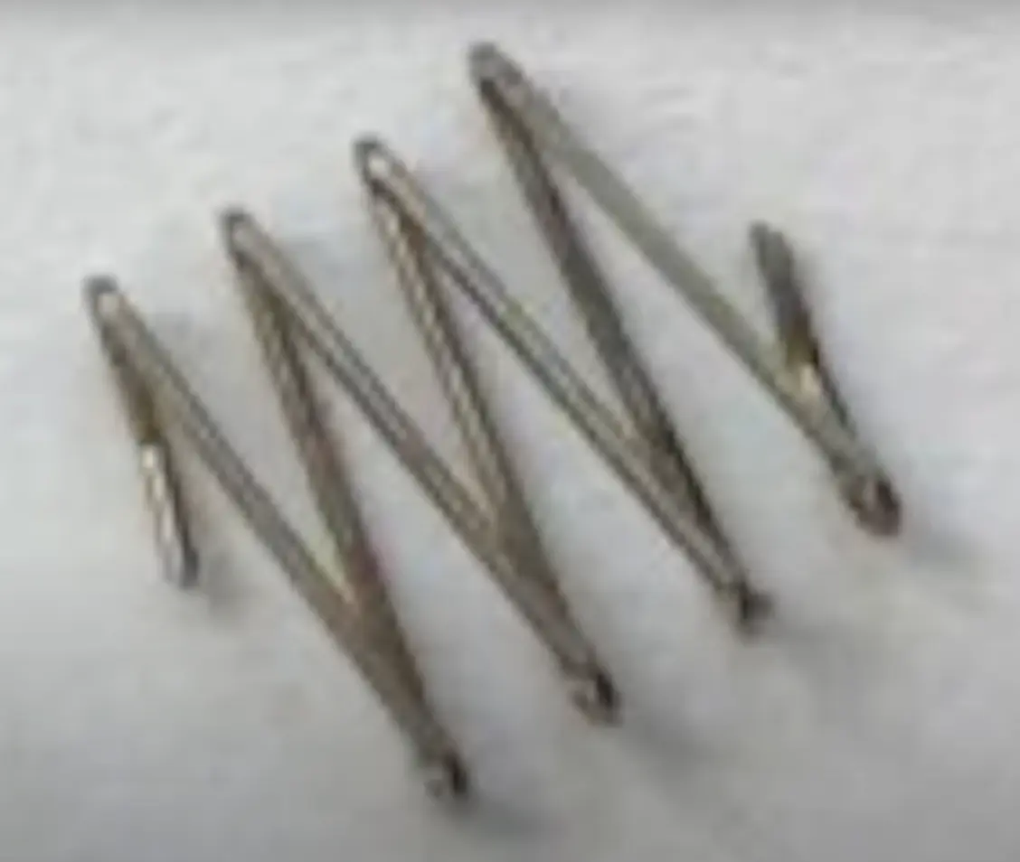

The springs may be the same as in some of the other Omega bracelets, e.g. 1039.
No, they are different in 7077's. At 1.48 you will see a 7077 spring
24,511
54,475
Oh, the zig-zag springs. I need to have something like that made for a Gay Freres bracelet. Although not as many zigs and zags.
29,815
77,159

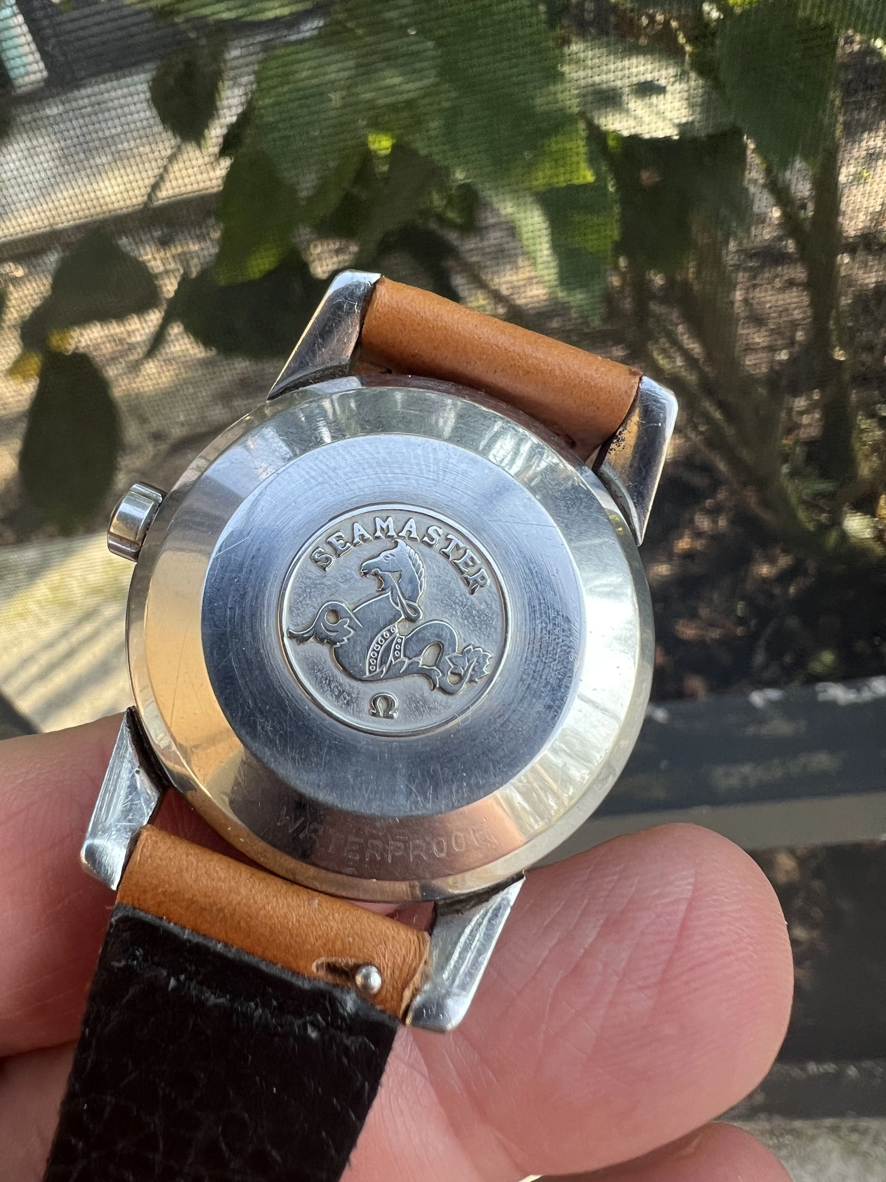

Thanks Dan, I suppose the springs are unique to the 7077? Also looking at the logo on the inside of the clasp with a magnifier I saw a date code of 4 on top of 58.
Thanks!
Yes, they are unique to the 7077 bracelet. Still available from Omega...part number is 085ST7077:

Thanks Cristos71, Dan S and Archer. Really learned a lot!! The video was extremely interesting and great to have a part number for the springs!! It looks like mine is the early variation of the 7077 and stamped with 4 58 date code. I also realized after looking at it again the bracelet does have 5 stretch links 3 on one side 2 on the other. Would it be best to have an Omega dealer do the repair?
Would it harm the value to have the crystal polished?
Greatly appreciate it!

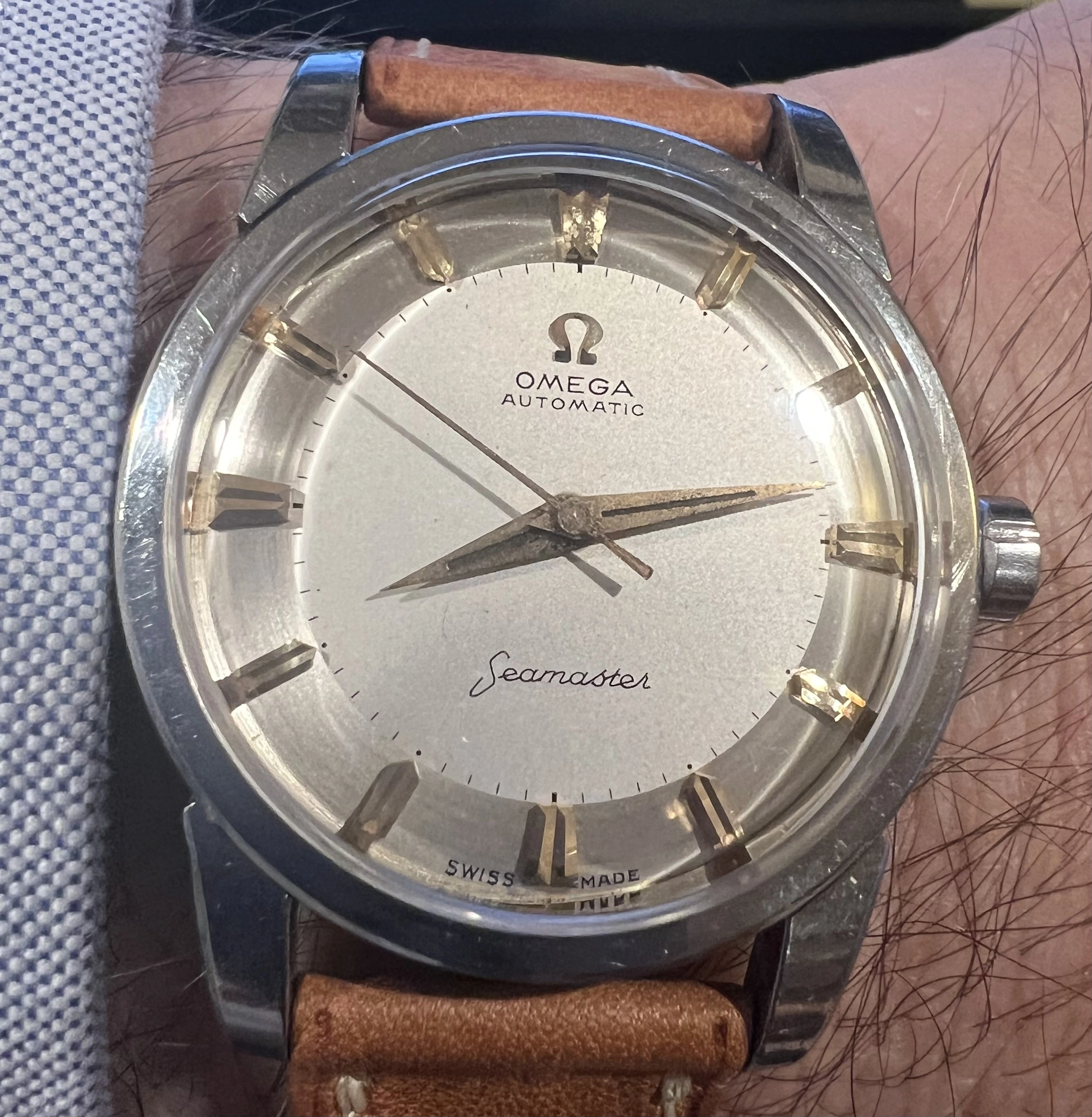

Because of all the great help I received here I thought I should give an update on the Captain's Seamaster. As suggested, I took it to an Omega dealer and had them only polish the crystal and
install the two stretch link springs. It was so helpful to be able to go there with knowledge about its age, movement, bracelet and even the part number for the spring! I think it made a big difference on how everything went there. Now the crystal looks great and all 5 stretch links are functioning. Thanks again everyone! I did have one other question. In one of the posts this was mentioned "Just FYI - being a Cal. 500 series and a "Bienne only" caliber. " Does that mean the movement was only made there?

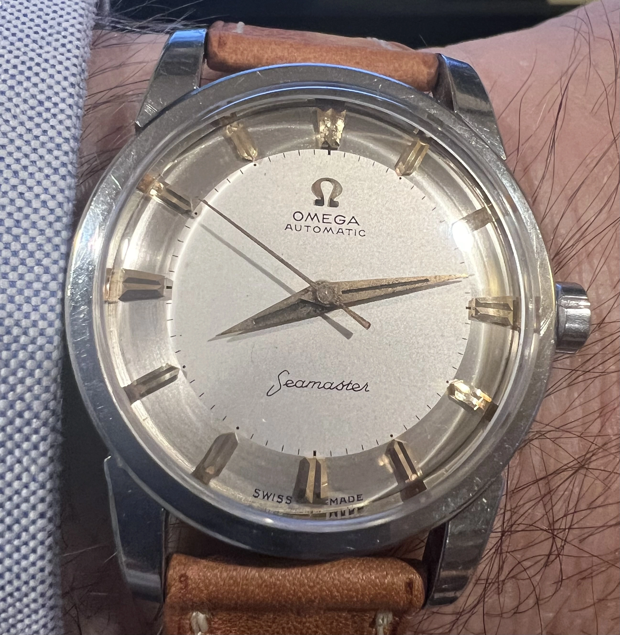

Lovely Seamaster ! My 2846 from 1958 (but without the big logo) sends Seasons Greetings

Thanks for sharing the pictures, like your hour markers!

really nice combo with that dial, case, and bracelet. Congratulations !
16
11
Thanks, I was very lucky to inherit the Captain's watch.
