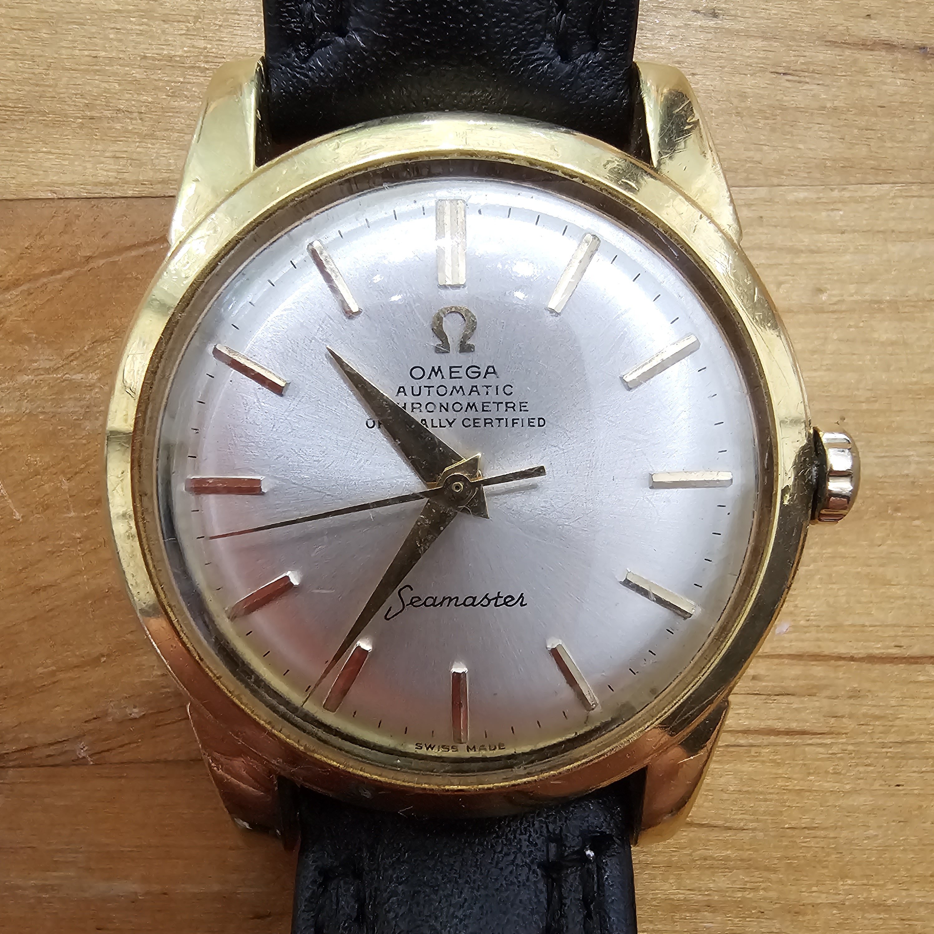

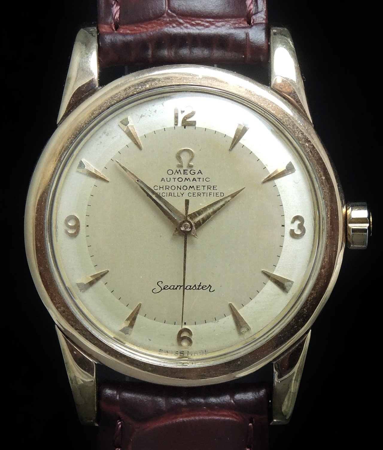

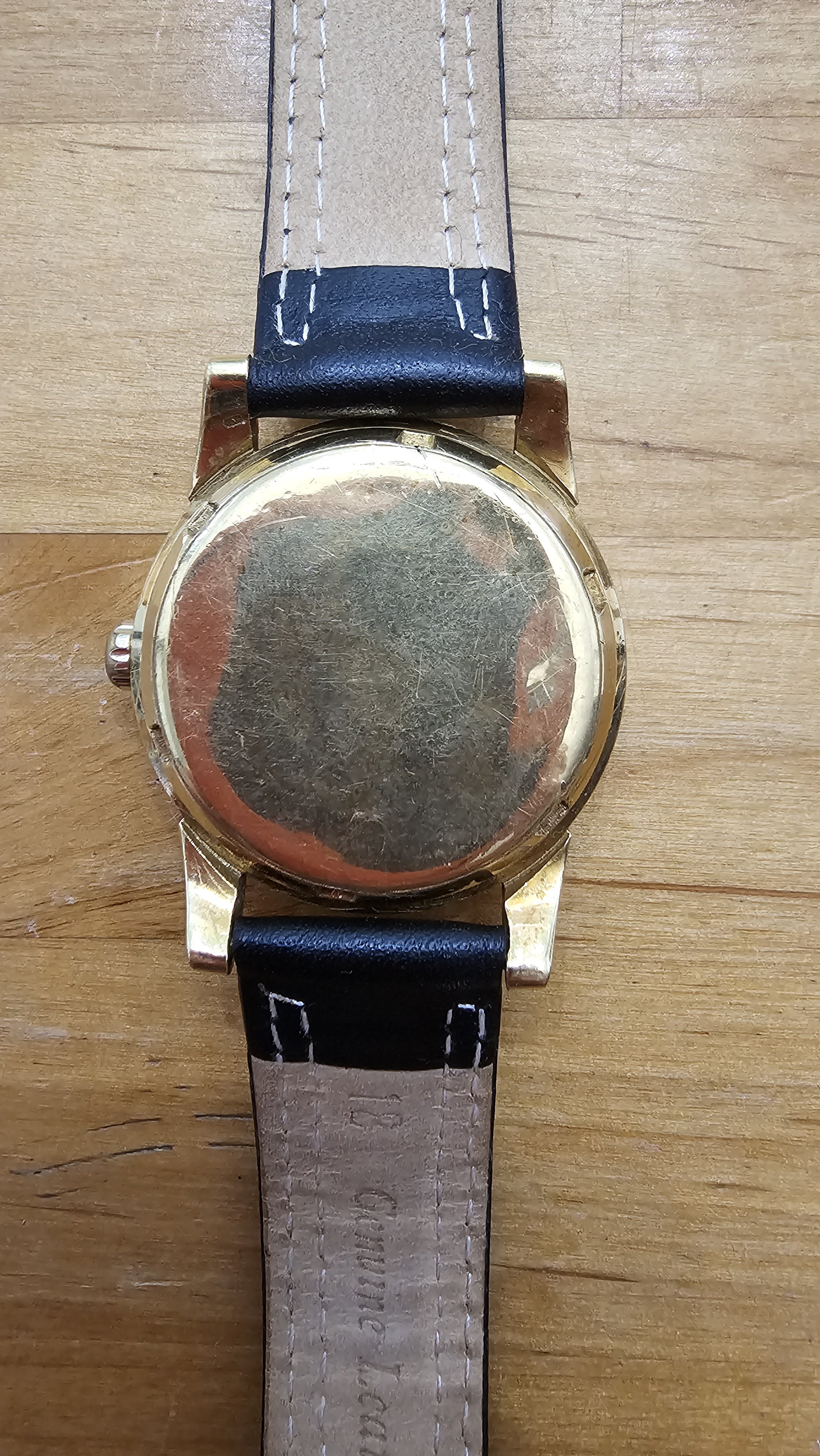

I inherited this 15 years ago or so. It was my grandfather's I believe he purchased it in the 50's in Chicago. I'm really trying to gauge a value. I have researched and seen anywhere from 1500 to 12k. It is 18k and sounds like it is a hammer automatic.
TIA
IMOLA20AE
10,804
16,814
Might be model 2577 if it actually does have a bumper movement. The dial looks later so might be a service item ie legit but swapped in. I'm not certain its not original but I've never seen a 2577 with that dial before, its normally seen later. The dial does look tidy but case looks knocked about. I saw your earlier comment about trading for a sub. I don't think you'll get anywhere that money. I'd be thinking maybe $1,500 to $2K tops if you are lucky. Its not the best example and presumably needs a service.
Looking again, the dial looks small for the case, or perhaps the tension ring/rehaut is missing but there seems to be too much real estate outside the minute track. This again suggests to me some monkeying about at some point.

Thanks. I appreciate your info. I'm sure it does need a service. I have worn it once in 15 years and other than that it sits in my safe. I can't seem to find any photos online of its exact configuration. Optimistically, I'd hope that is very limited and would demand a higher price. That's why I posted here to get unbiased opinions on it.

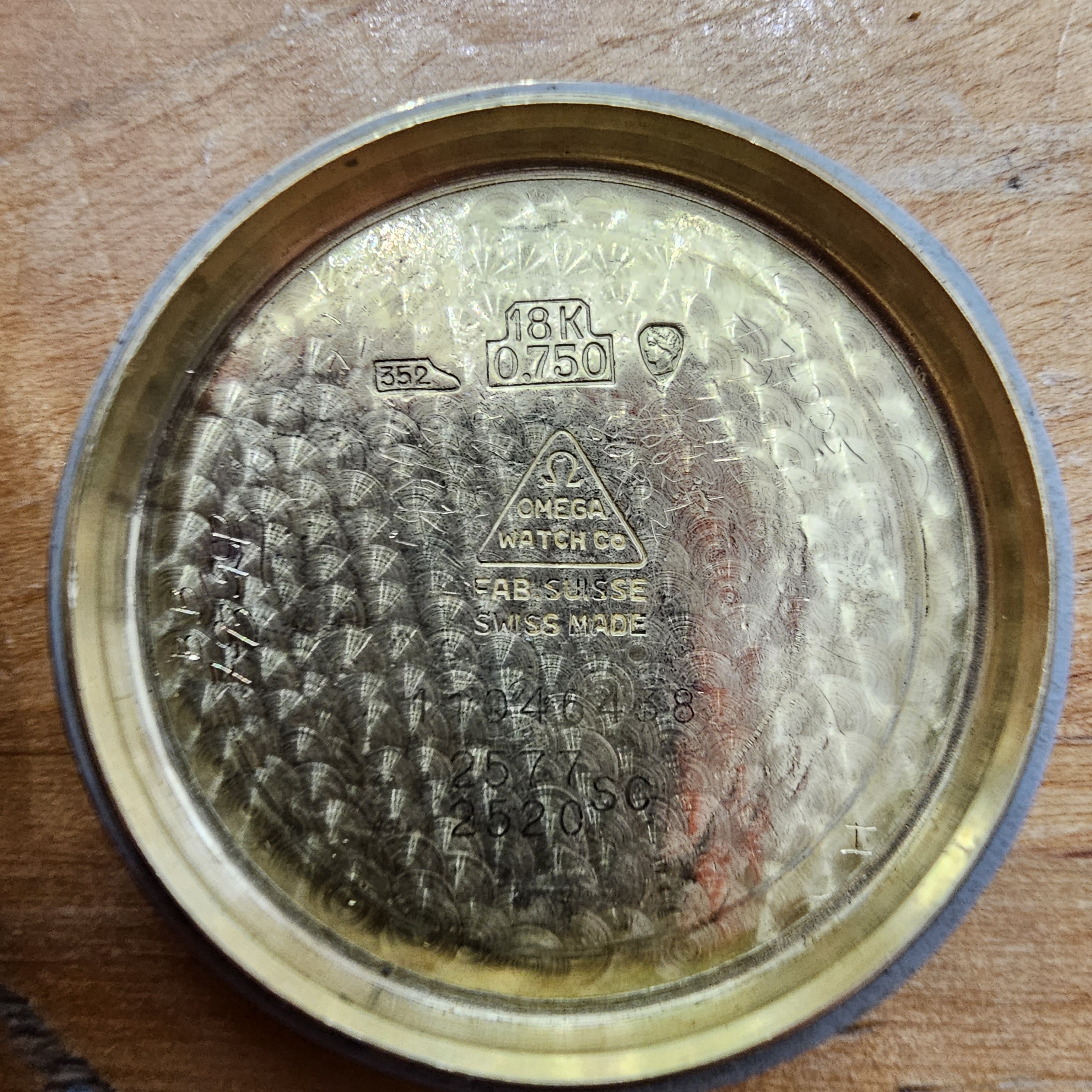

Once you get it open. You can get the reference number on the inside of the back and caliber to make sure all is correct

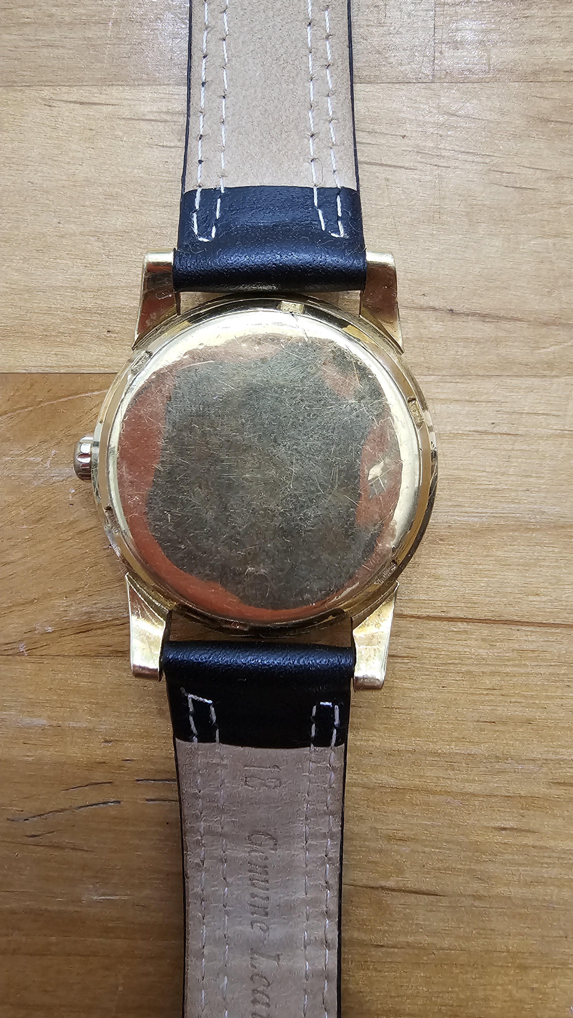

Crown appears to have been replaced,
10,804
16,814
Double marked case with 2577 (which was my guess) and 2520. I suspect 2520 is the gold chronometer reference so that is prob what you have there. Here is the Omega data for it. Note your dial is very different and the hands longer which was one of my concerns, though there is a lot of variety in dials at this period and often they differ from Omega's reference pic:

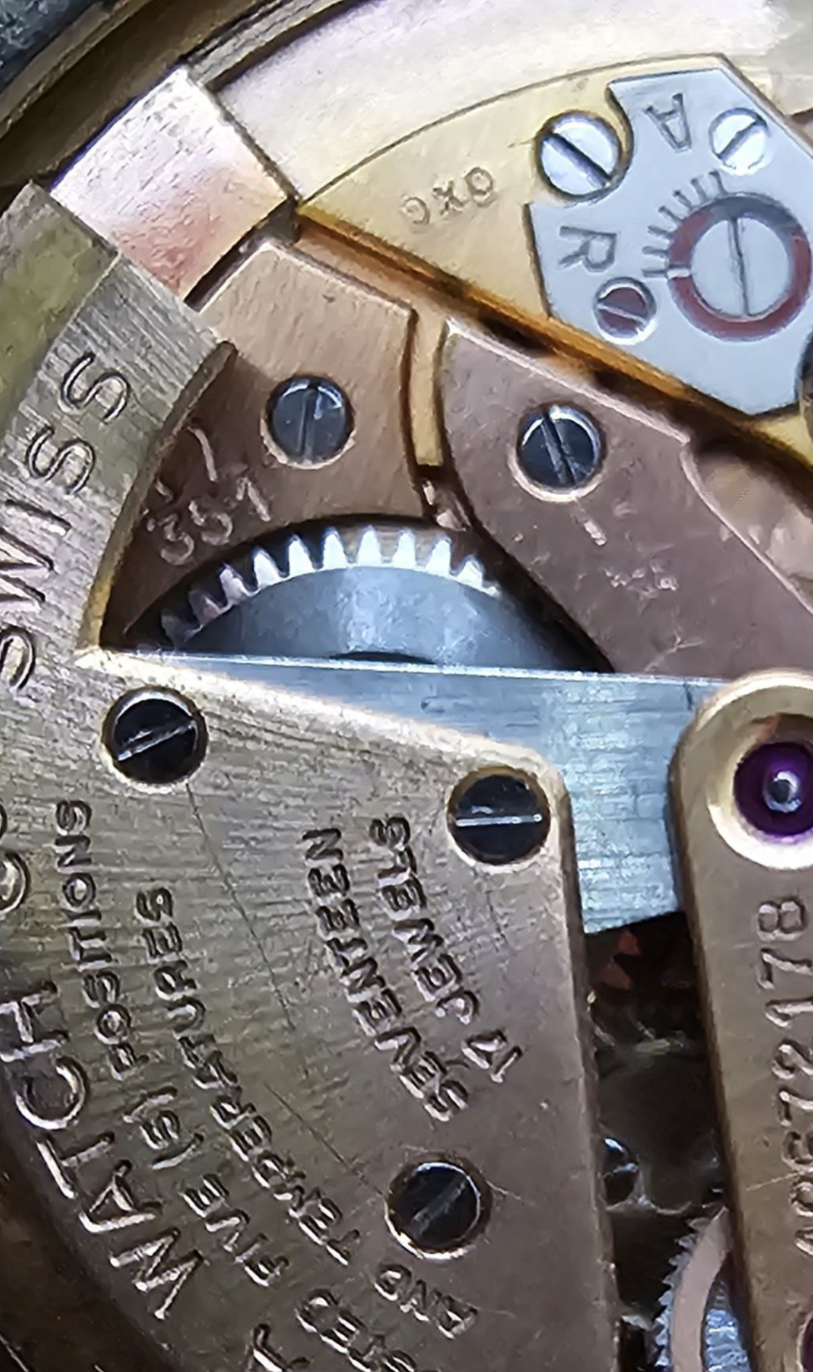

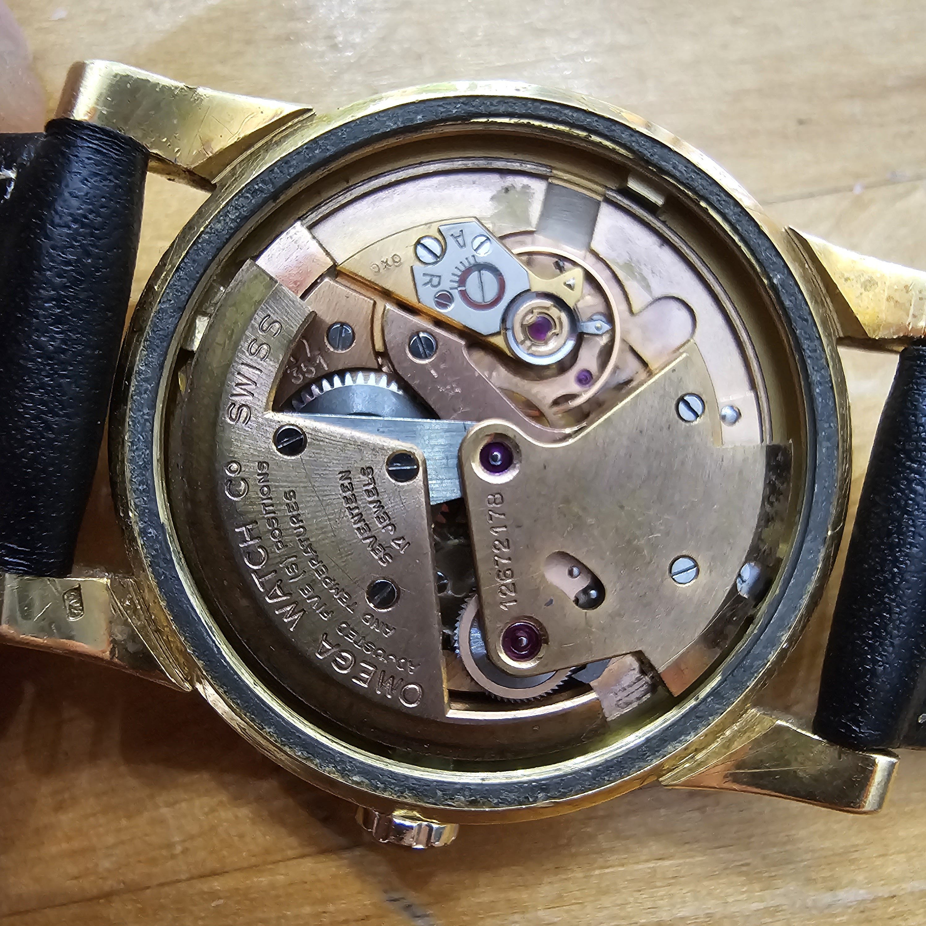

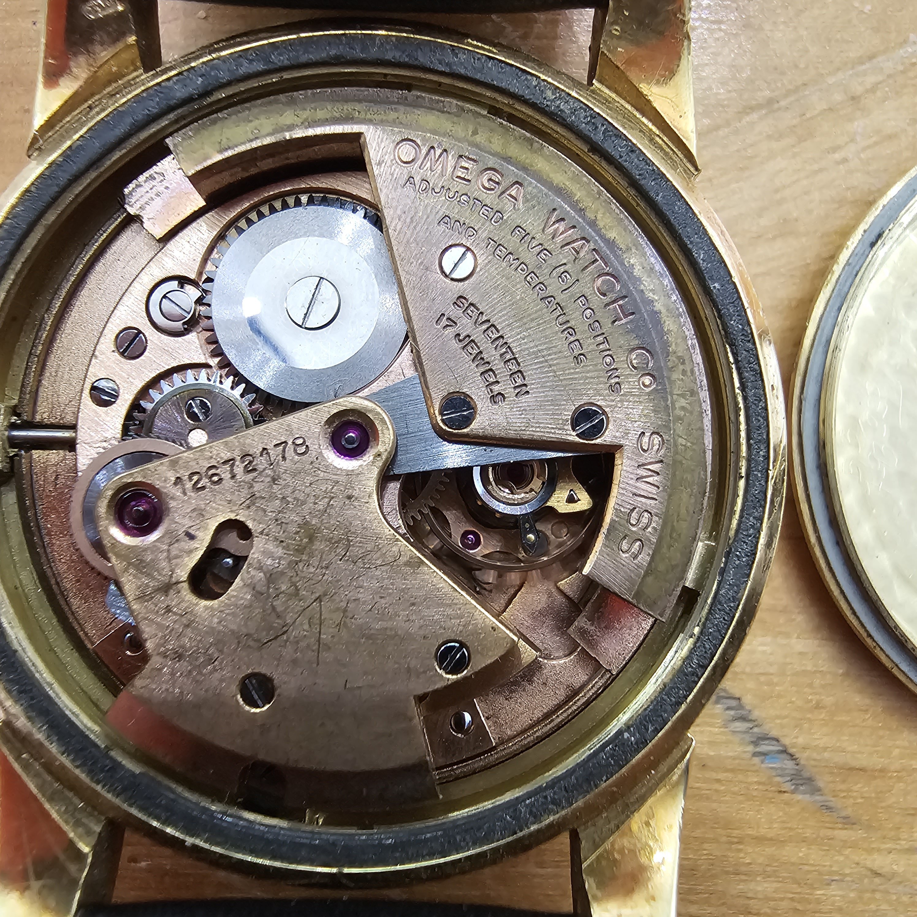

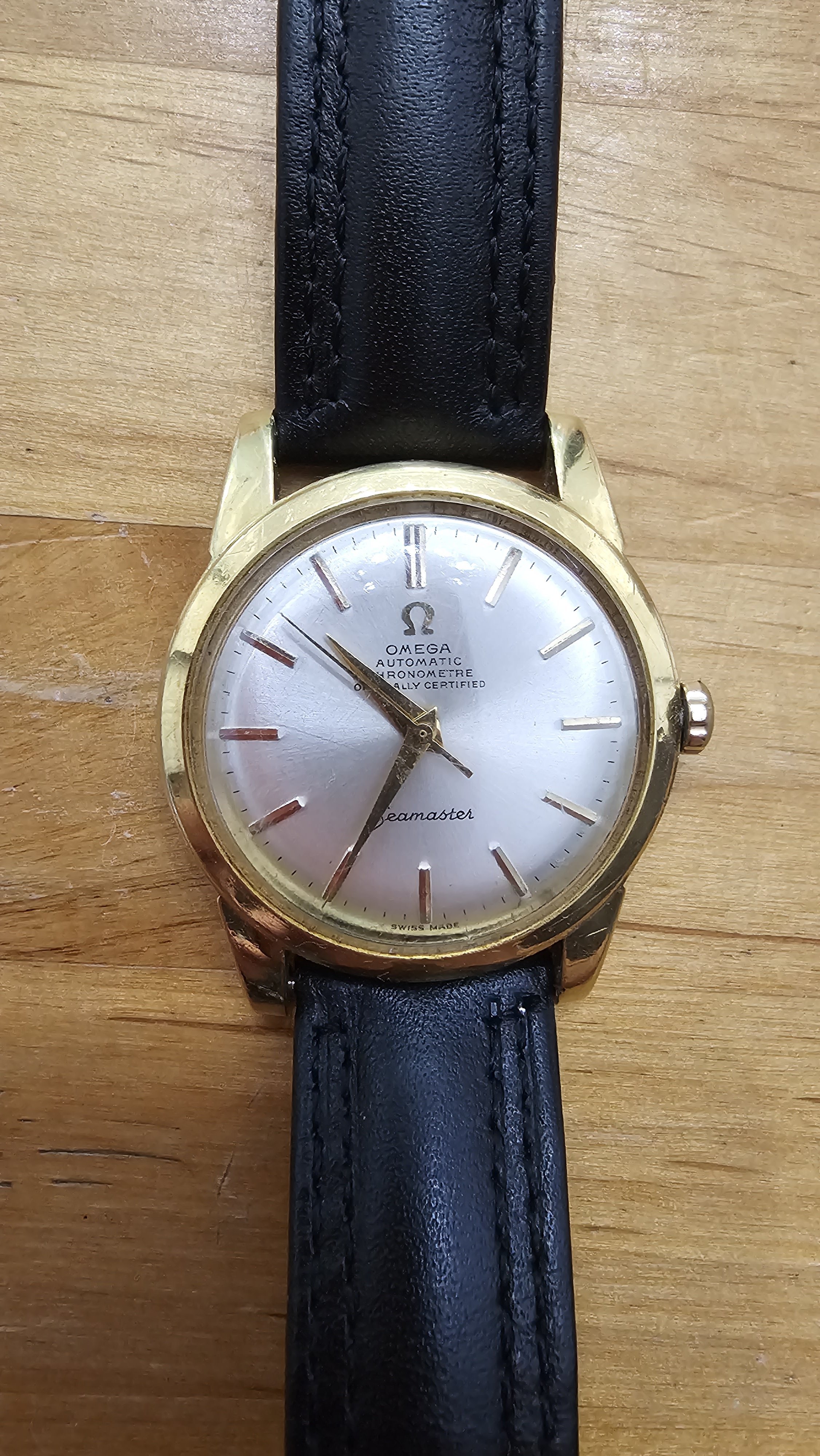

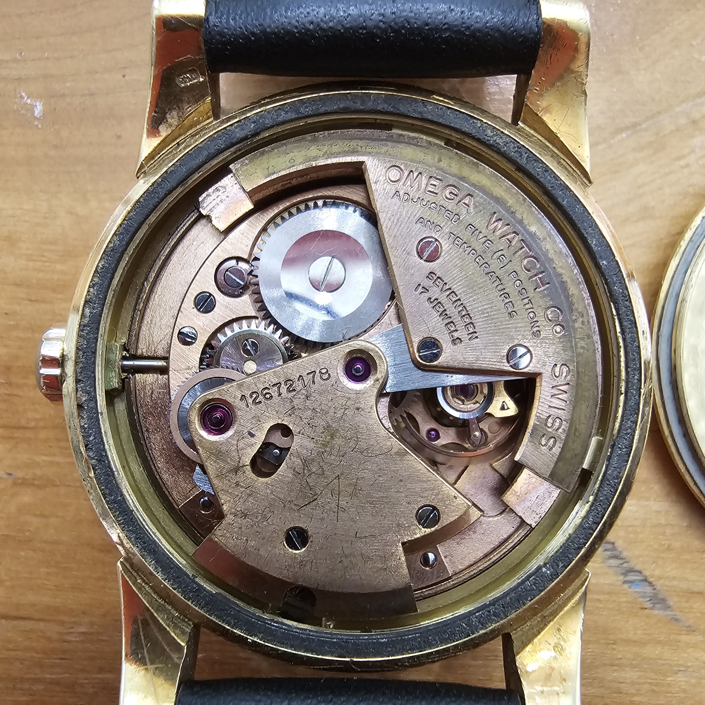

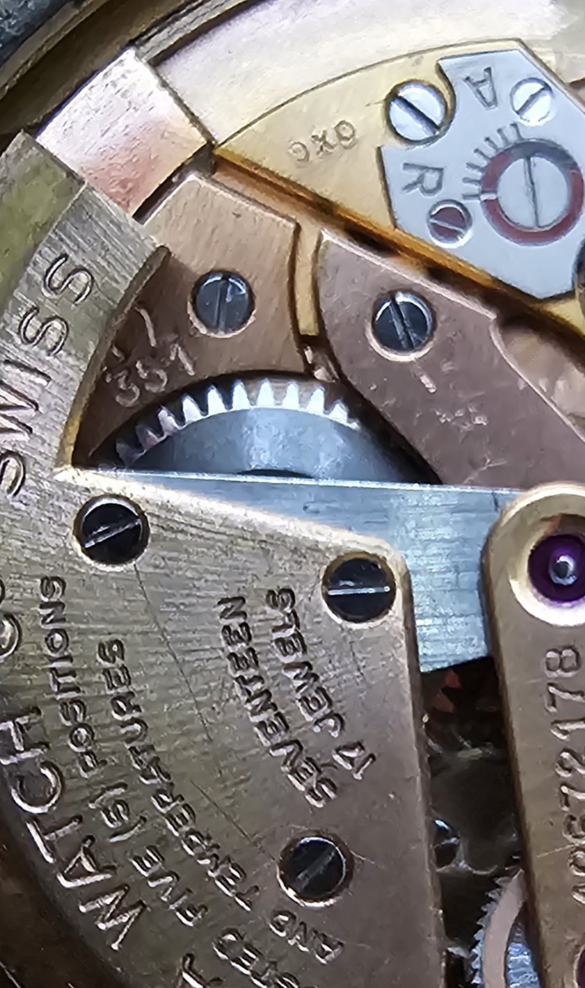

Omega caliber 352. I'm guessing dial refinished based off the movement condition which can't be cleaned up. Can service it, but wear is wear on the plated bridges
Balance bridge should look like this. Hidden in both movement images

Sorry to disappoint but that movement is quite damaged and that too has an impact on value for a watch which is not particularly rare or exceptional.
Whoever suggested this watch could be worth more than 2000 USD (or even 1500) I wonder what they’ve been smoking.

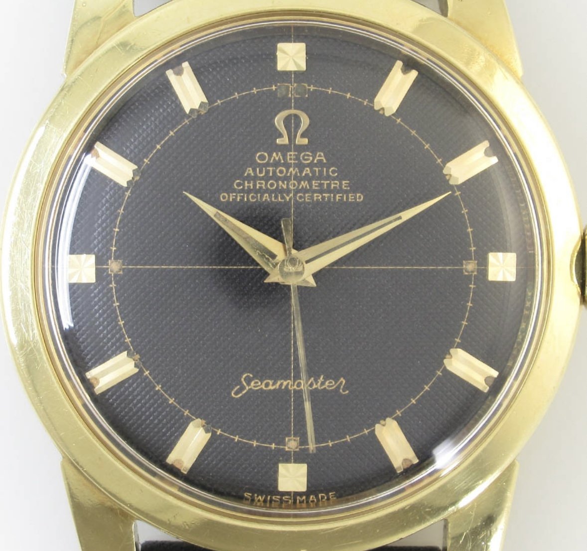

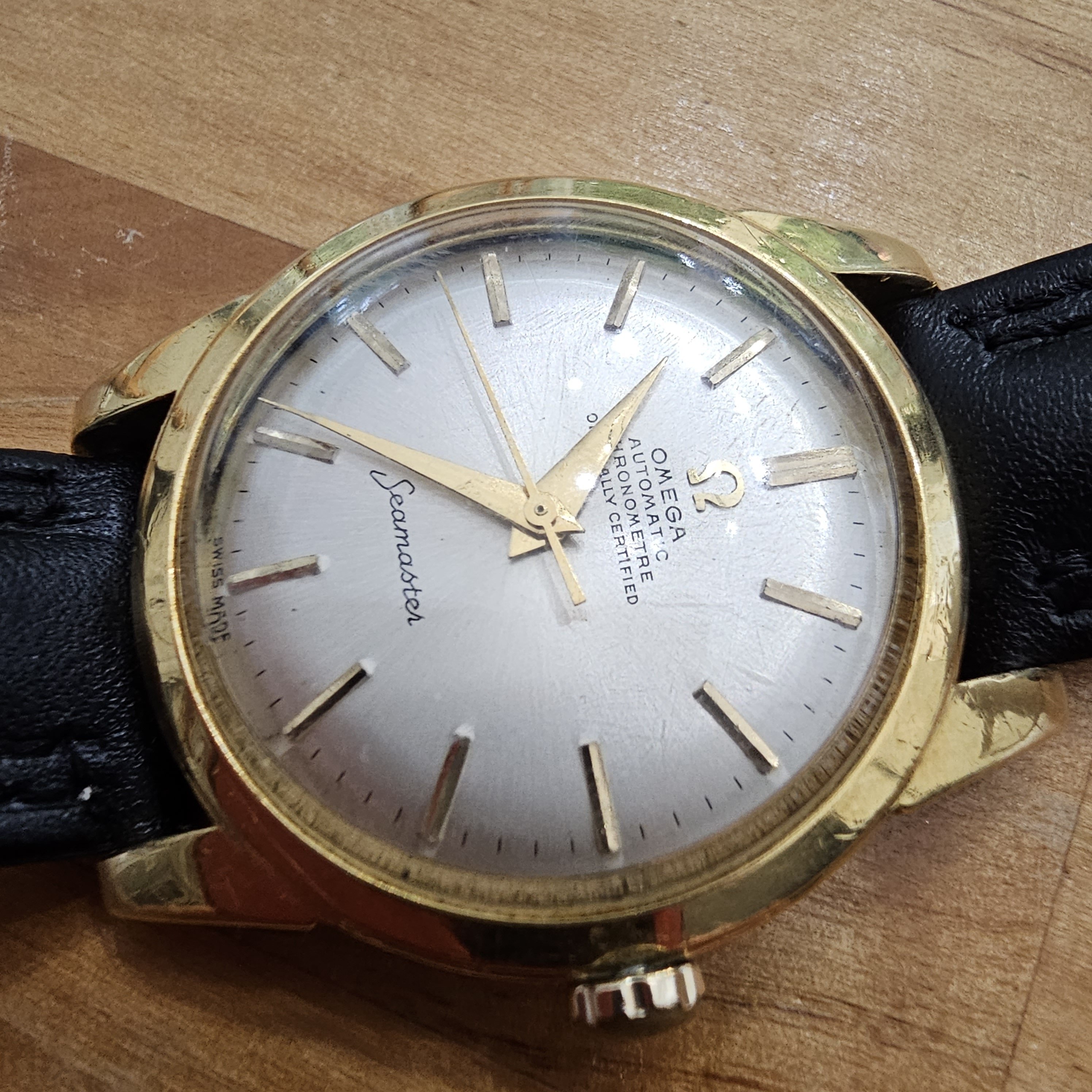

I believe that it might be the service dial.

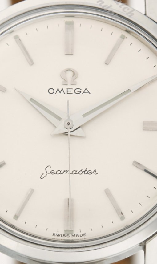

I found 2 pattern of the “Seamaster” font in the reference 2520/2577.
Compare to yours.
The “seamaster” font looks like 1960’s pattern.
Like this example (pic searched from internet)

Something wrong with this picture?
The case is Ref. 2520, which should be cal. 352, not 351. So there are parts that did not leave the factory together.
Which ones are anyone’s guess.
gatorcpa
18,835
39,173
gatorcpa
I agree.
The other reference in the caseback is 2577 which the OVDB indicates a caliber 351/354 (non-chronometer).
