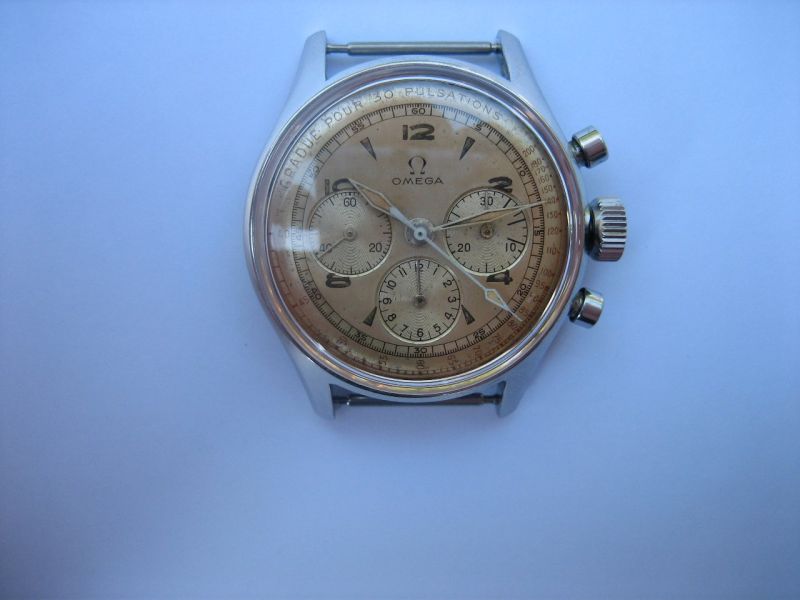

Does the date of Extract cause any concern here? I know they used to simply transfer information from whatever was written on the form, so how much of the information was submitted by the owner, and how much was from the archives?
Would be interesting to see a current Extract to see how different it would be...

I've had these exact questions and been waiting for those enthusiasts of the 2913/2914/2915 to chime in, but seems this watch is not one of those 😉
Also @mac_omega pointed out the alpha hands are incorrect, which is proven by the extract saying "stick" hands.

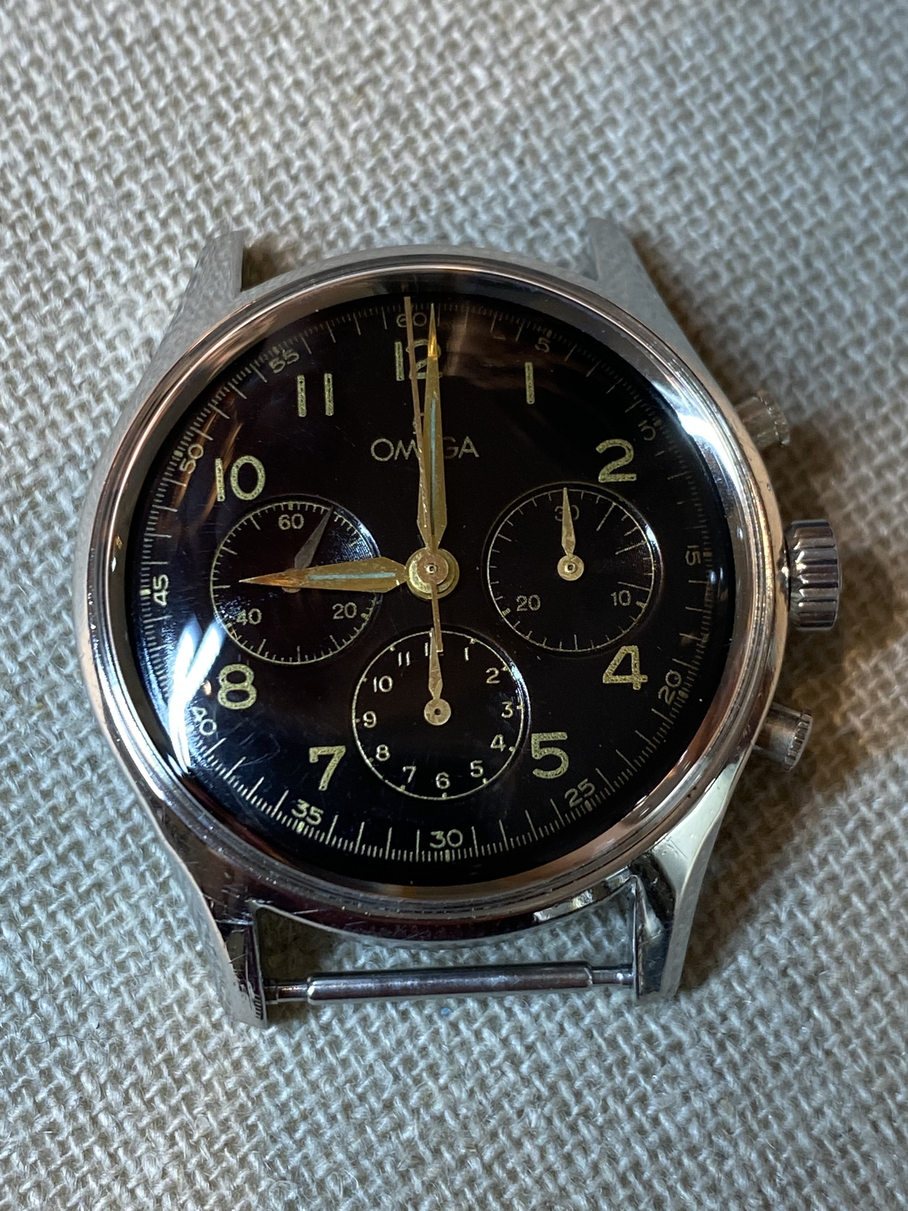

I was chating with my watchmaker yesterday (actually to remind him of me ;-) and he showed me what I thought was an interesting watch I had not seen yet, he mentioned that it was from argentinian military origin. He purchased it on the bay and I don’t think he has any extract of archive or more info from the previous owners really.
I took some pictures there (with his permission to check for more info later on). He is not selling and I am not buying. I am just curious (and found this thread coming back home). I found the watch lovely in person and wanted to know more.
Here are some pictures :
with what I read above I understand it is difficult to be sure but I share anyway.
Some consistency with what has been shown and discussed earlier :movement serial number, model code and dial.
And some not so consistent : like the hands (all of them).
I wonder if the shared knowledge can be improved here.

I'd like more pictures but my first impression is that it is a redial. Interesting that it is signed both 174-1 and 2451.

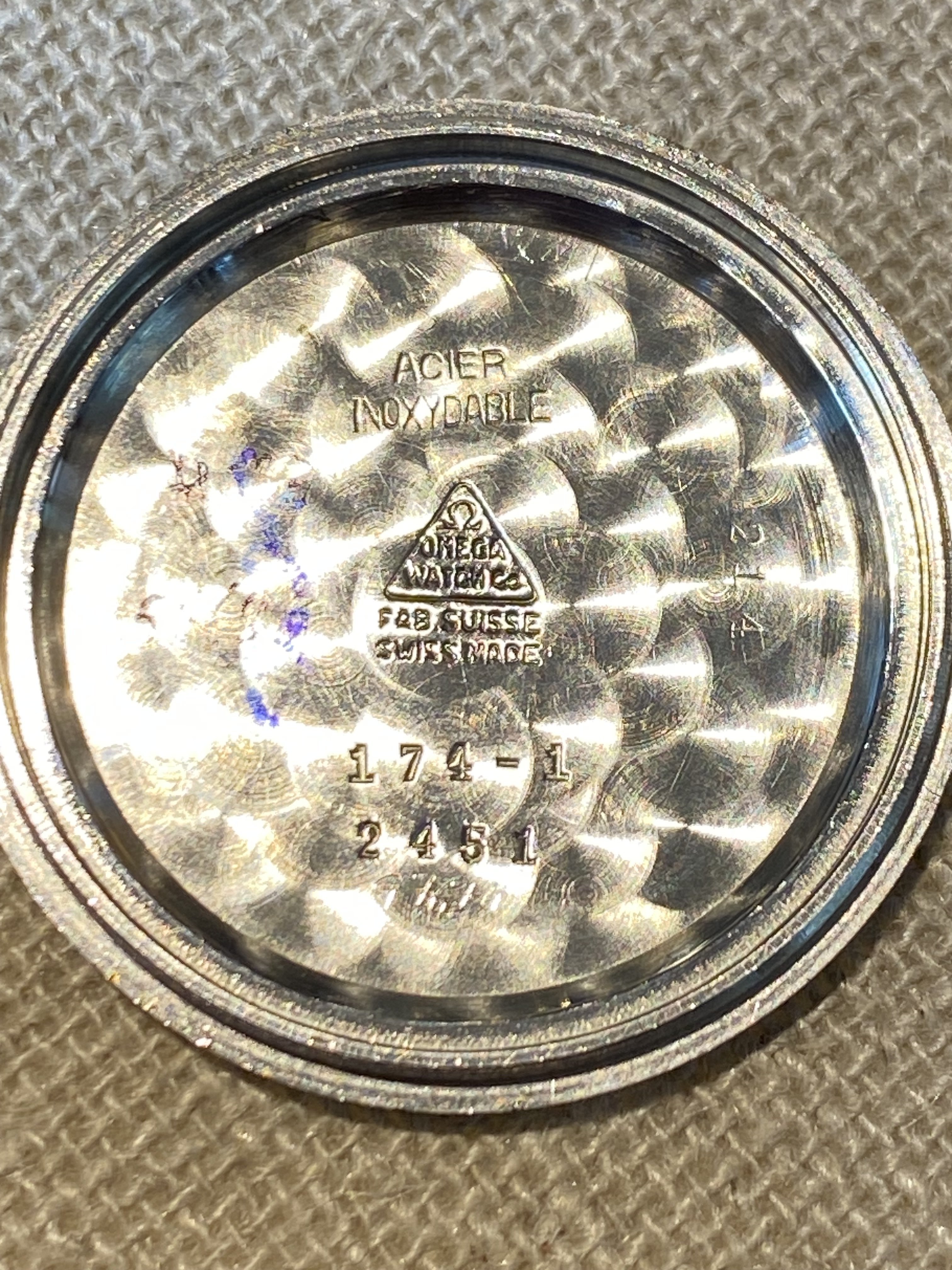

Do you also have a case back picture?

??? Military it is not . Military means issued. The Omega sign font does not correspond to the age of the movement either. Need an outside case back picture as well. 2 missing pusher caps often means: Trouble with that section ...

Unfortunately I have nothing more right now : I should have taken a picture of the case back though ! I don’t think it was marked with anything… but now that I think of it it could well be looking like a Lemania case back.
And I agree, having read this thread, that the odds of a Frankenstein/redial is quite high.
I don’t plan to be the bad news bearer but next time I see him I will ask to see the case back and for those who want better pics you can ask and I’ll do my best).

So my understanding for now is that this particular watch has/is :
- a possible redial (no Swiss made, not so well defined sub dials)
- wrong hands ?
- an original Lemania case (174) that « became » an omega one at some point (2451) : but that remains in the world of possible.
