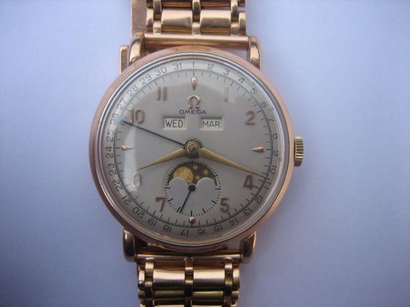

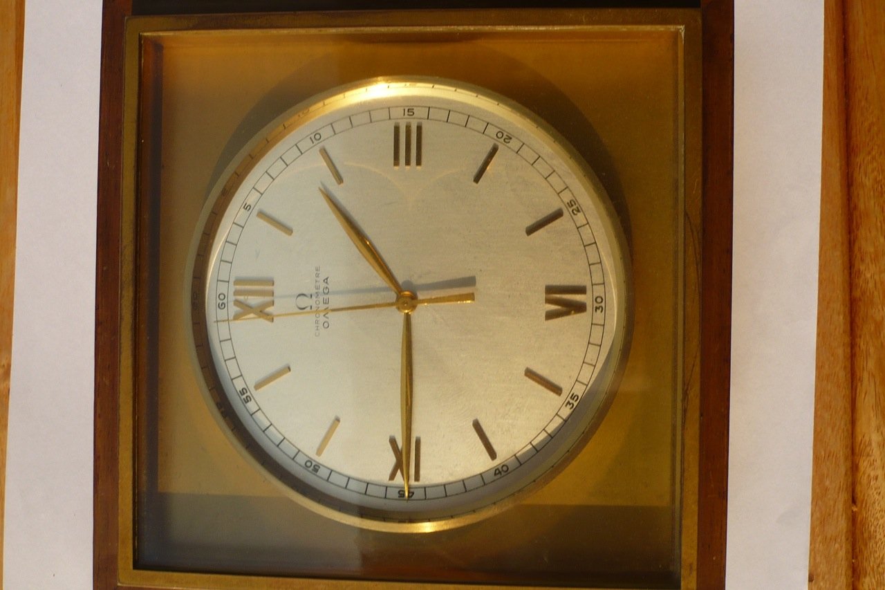

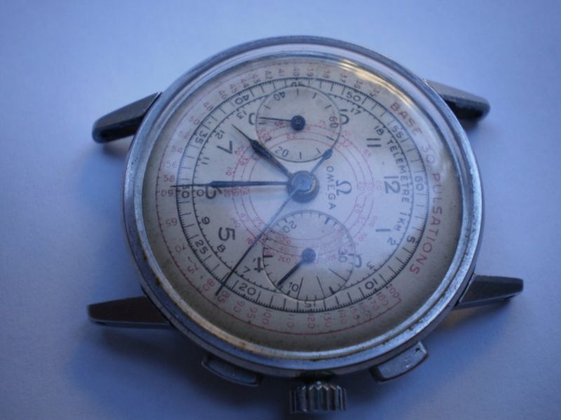

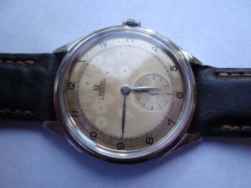

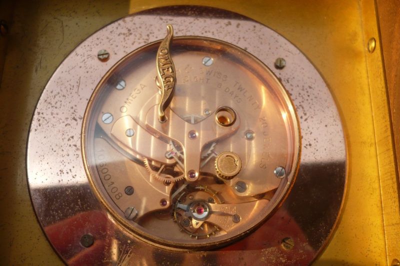

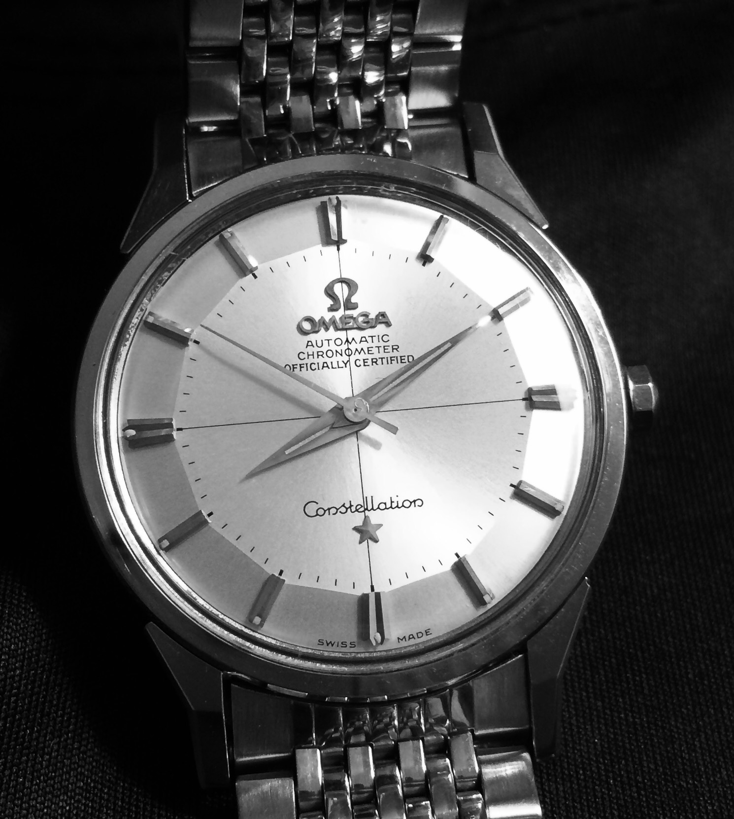

Some more pics if omega's I purchased over 15 years
