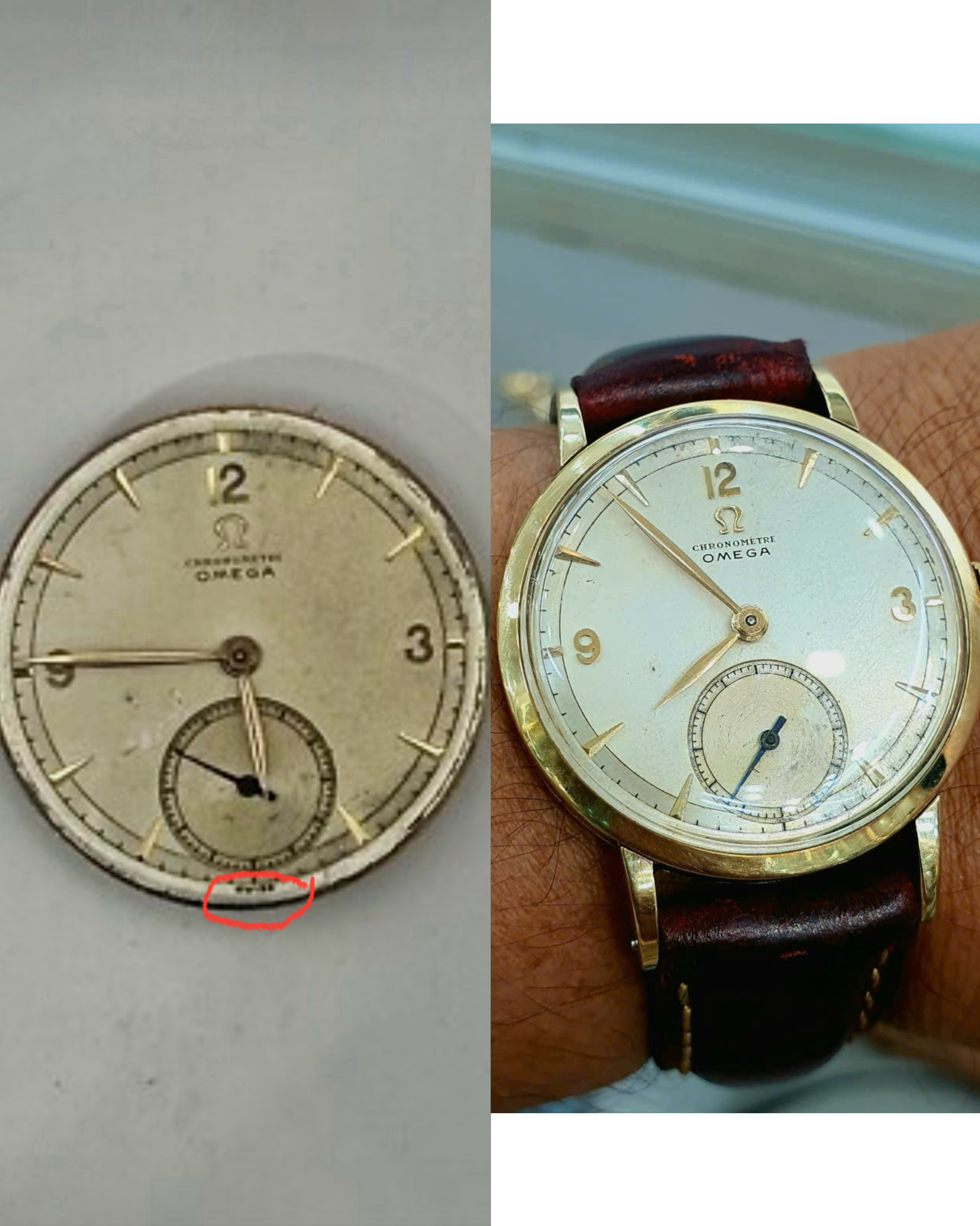

I practiced on dozens and dozens of garbage dials well before I tackled something like this. Whatever they did differently on thier pre-1960 dials made them so much more robust and easier to clean. After the late 50's whatever varnish they changed to made it very easy to remove paint and decals when attempting cleaning.
The textured dials (honeycomb, waffle etc.) Are also very easy to clean without removing paint etc. I'm guessing they used something different in the finishing because of the texture? I wish they used the old finishes on all thier watches, my life would be a lot less stressful 🤣🤣🤣

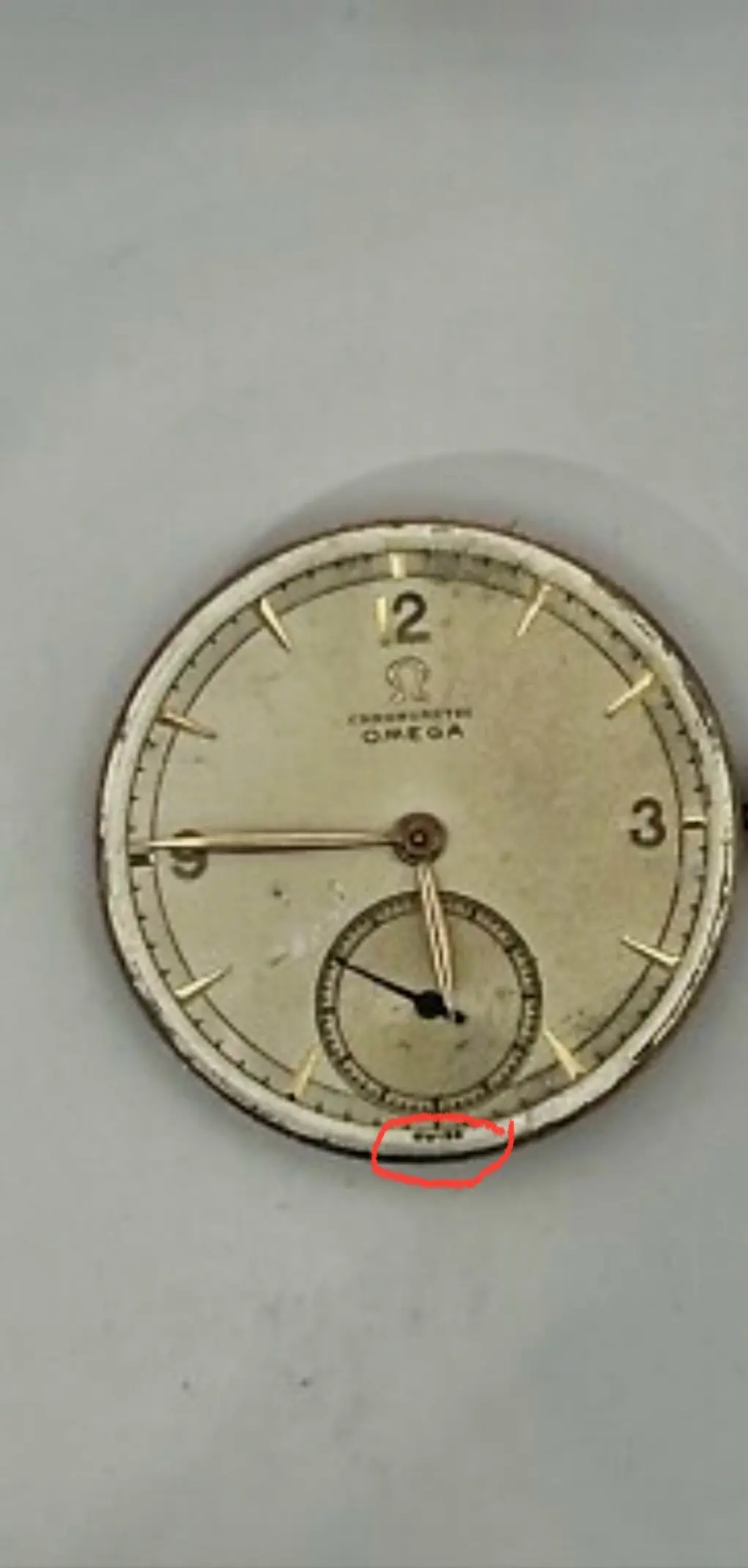

I think you're right. Dials from before the 1960s are easier to clean. This is what I did. But perhaps there's a small surprise. The "Swiss" inscription has disappeared without a trace. I think it was added later, but I don't understand why they did that😁
P/s: I only use warm water.
