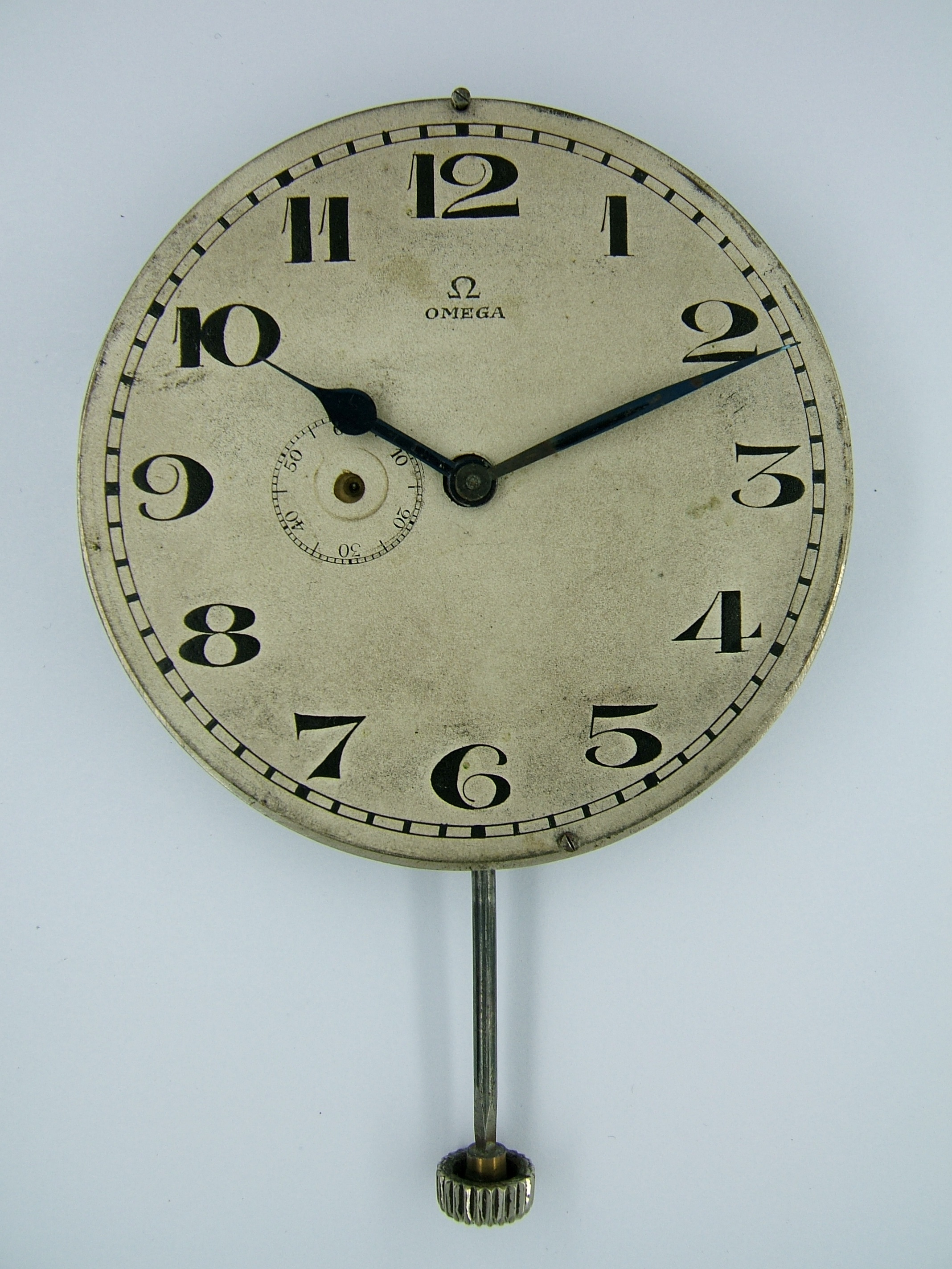

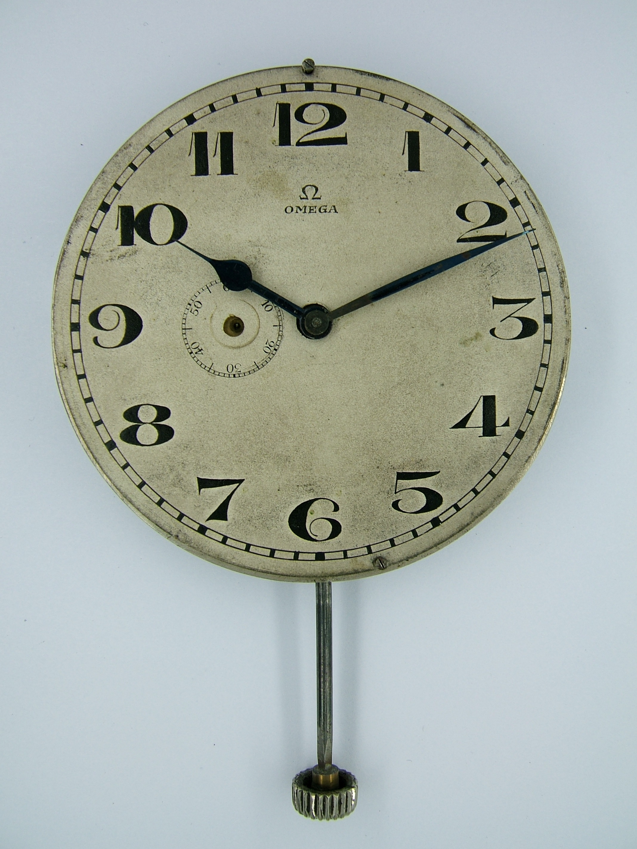

Interesting Carl. Thank you.
Sorry but I can’t offer anything on the Helvetia side - nor a sub-seconds at 3. Of little use but I have an Omega 18’’’S with the sub-seconds at 9 (which is the usual ‘variation’), a former car clock - therefore the opposite of your lépine and sub-seconds at 3. I think mine is genuine - but it came from S. America, so maybe: I guess 1912, movement number 4072907.
Tom

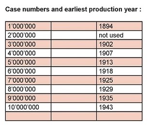

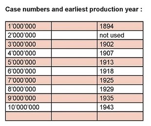

You mention about Omega not using 2 million case numbers. I then found this Omega table:
When setting up the serial number lookup on my site I did a lot of research using hallmarks, patents, inscriptions and other details to try to get an idea of how General Watch Co serial numbers relate to dates.
Working backwards I had managed to work out that it looked as if they had started out in 1895 at 2 million, my watch above with a 1907 hallmark is 2,600,000 for instance. I thought this might be a continuation from Louis Brandt and Frere numbering and was a way of displaying continuity when they moved lots of non-Omega brands to the General Watch Co. Now I know that Louis Brandt and Frere never used 2 million numbers things fall into place.
It looks as if something like this happened:
1894 - Louis Brandt and Frere began using serial numbers starting at 1 million.
1895 - Louis Brandt and Frere set up La Generale (General Watch Co) as a joint venture with the ebauche manufacturer Ed. Boillat & Cie and started their serial numbering at 2 million.
Louis Brandt and Frere and Ed. Boillat & Cie were also partners in the Central Watch Case Co which only made cases for Louis Brandt and Frere and La Generale so that could explain the desire to keep the numbering separate.
In 1902 when Louis Brandt and Frere numbering reached 1,999,999 they moved straight to 3 million to avoid the La Generale numbering range.
In 1911 Louis Brandt and Frere withdrew from La Generale and Ed. Boillat & Cie withdrew from the Central Watch Case Co in what may have been some sort of quid pro quo deal. Possibly Louis Brandt and Frere needed the whole of the Central Watch Case Co's output for the increasing demand for Omega watches. This date actually corresponds with a move of the serial number in La Generale cases from the top of the case back to the bottom so could relate to a new case manufacturer.
The withdrawal of Louis Brandt and Frere meant that by the time La Generale reached the 3 million number mark in 1917 there was no need to avoid Louis Brandt and Frere (Omega) serial numbers so they just continued right through to just over 6 million in 1973.
Incidentally in 1973 the serial numbers changed to two sets of two digits e.g. 49-73. The last two digits were the year and I think the first two relate to a factory ID as there are only a couple of variations. This change seems to relate to internal changes within SGT when Helvetia was closed and Silvana took over the Helvetia name though as far as I know the same factories carried on making the same watches within SGT.
So possibly there are two mysteries solved here; why La General serial numbering started at 2 million and why Omega skipped the 2 million range.
