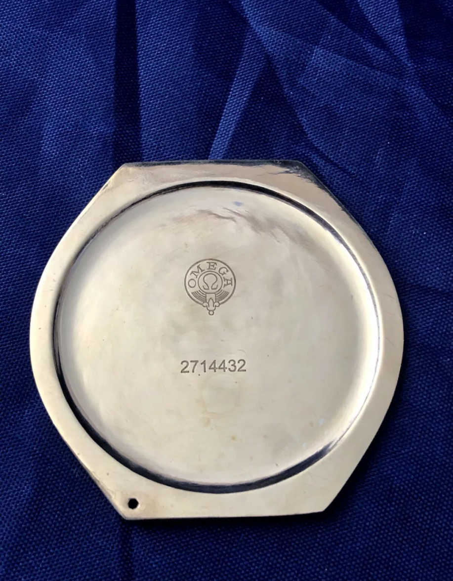

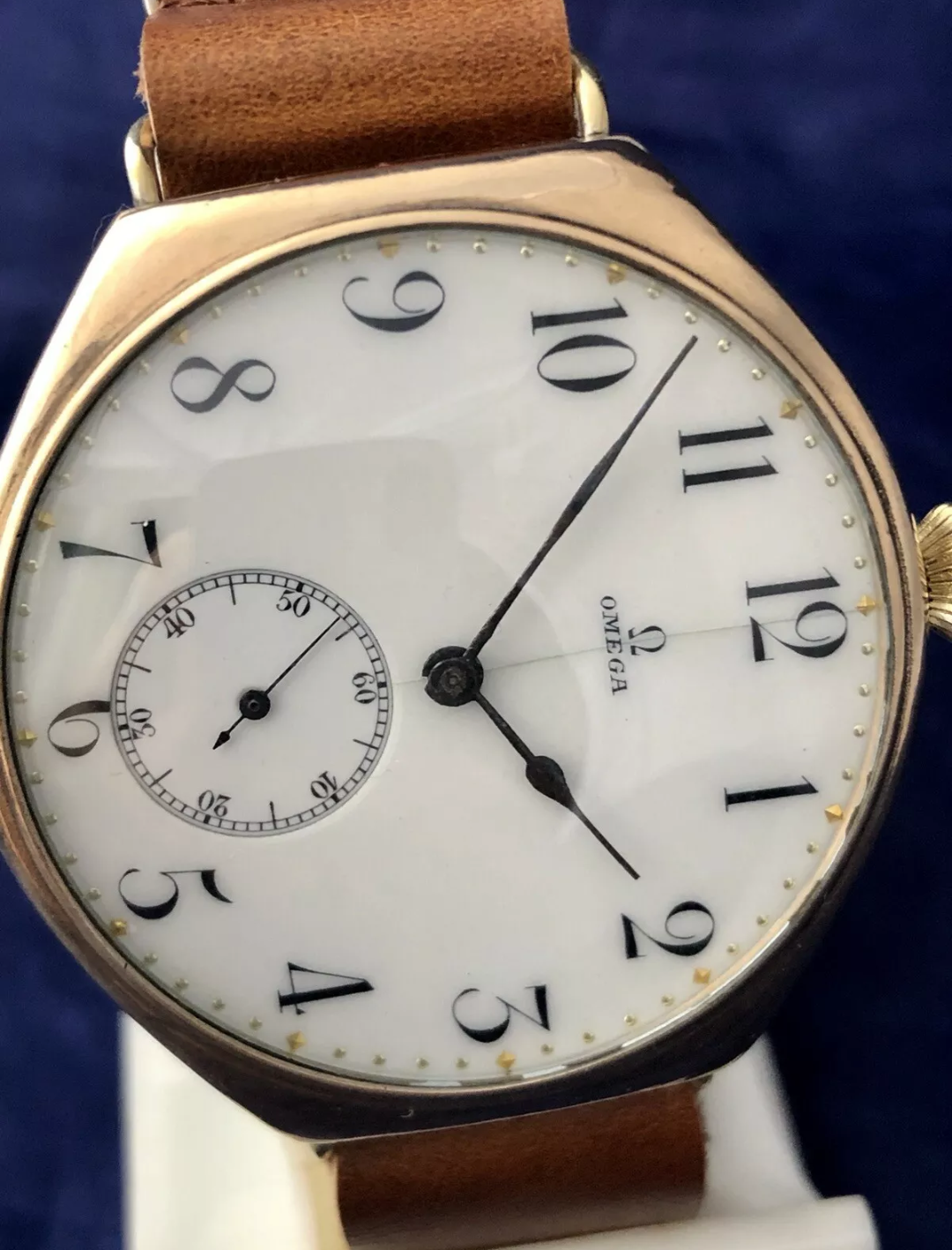

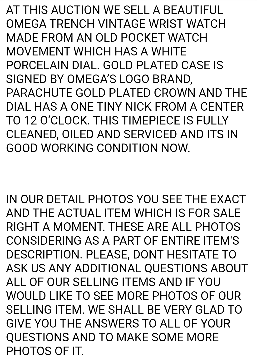

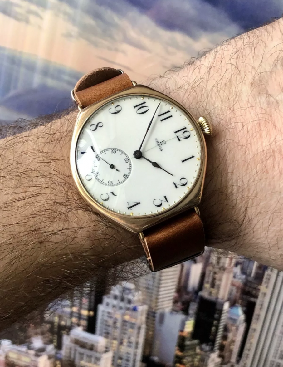

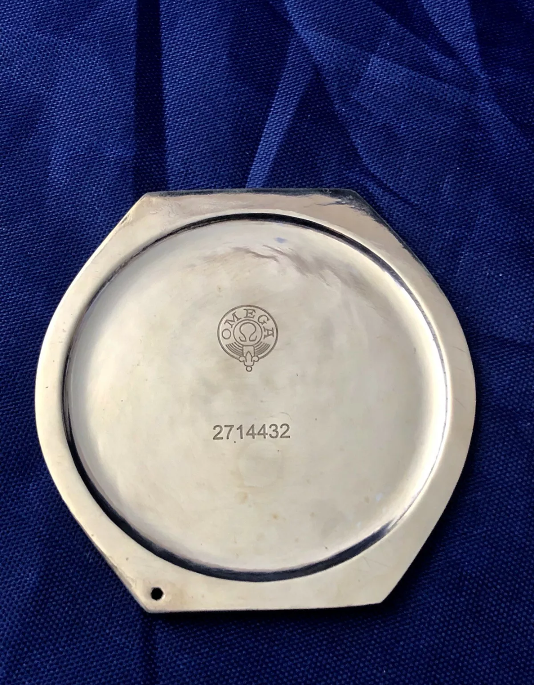

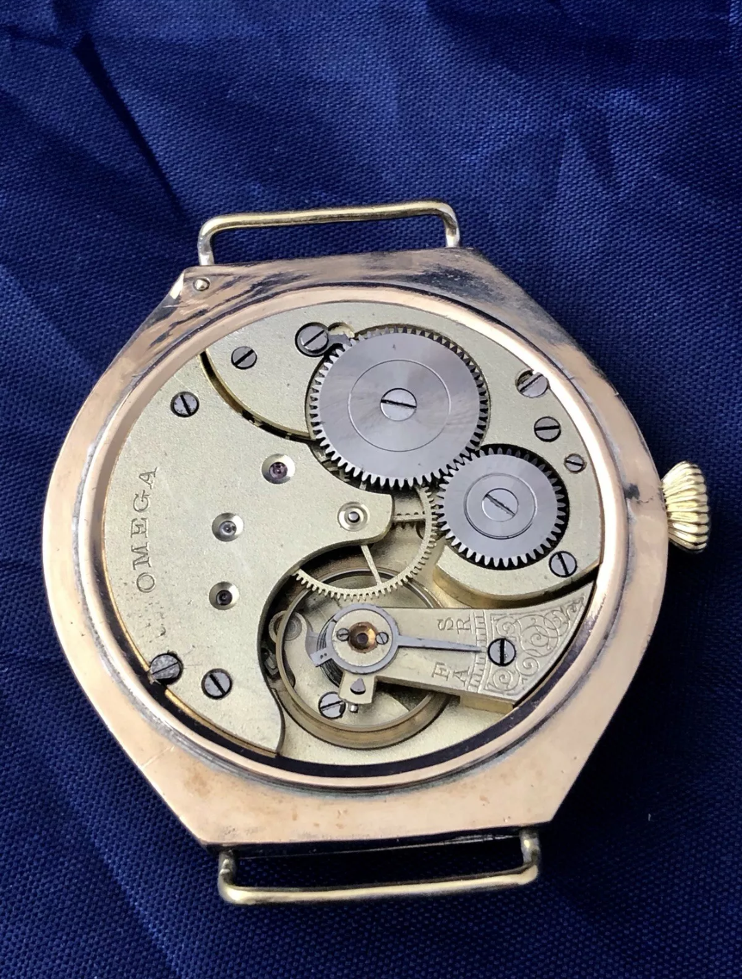

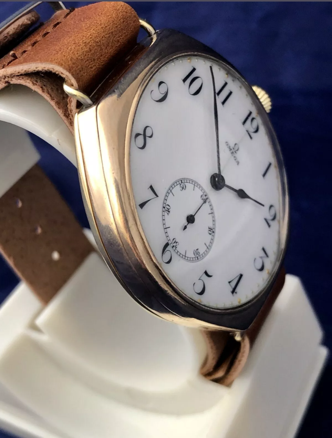

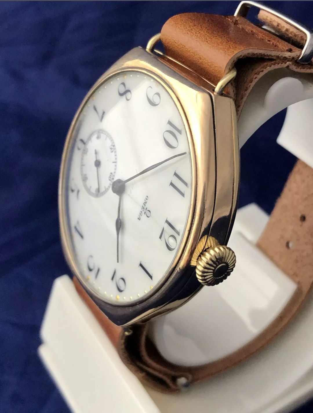

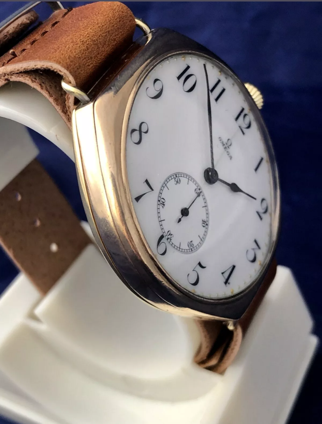

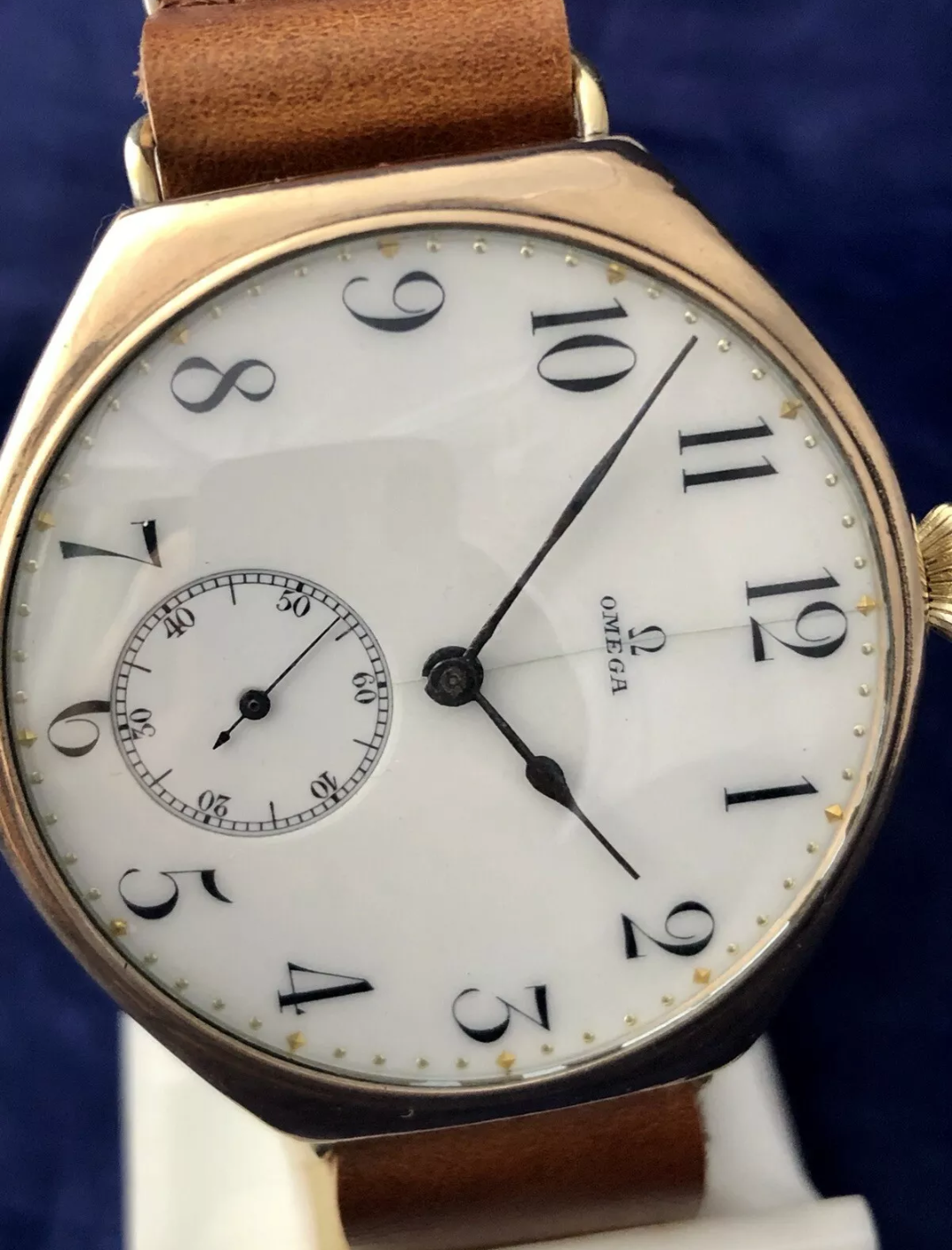

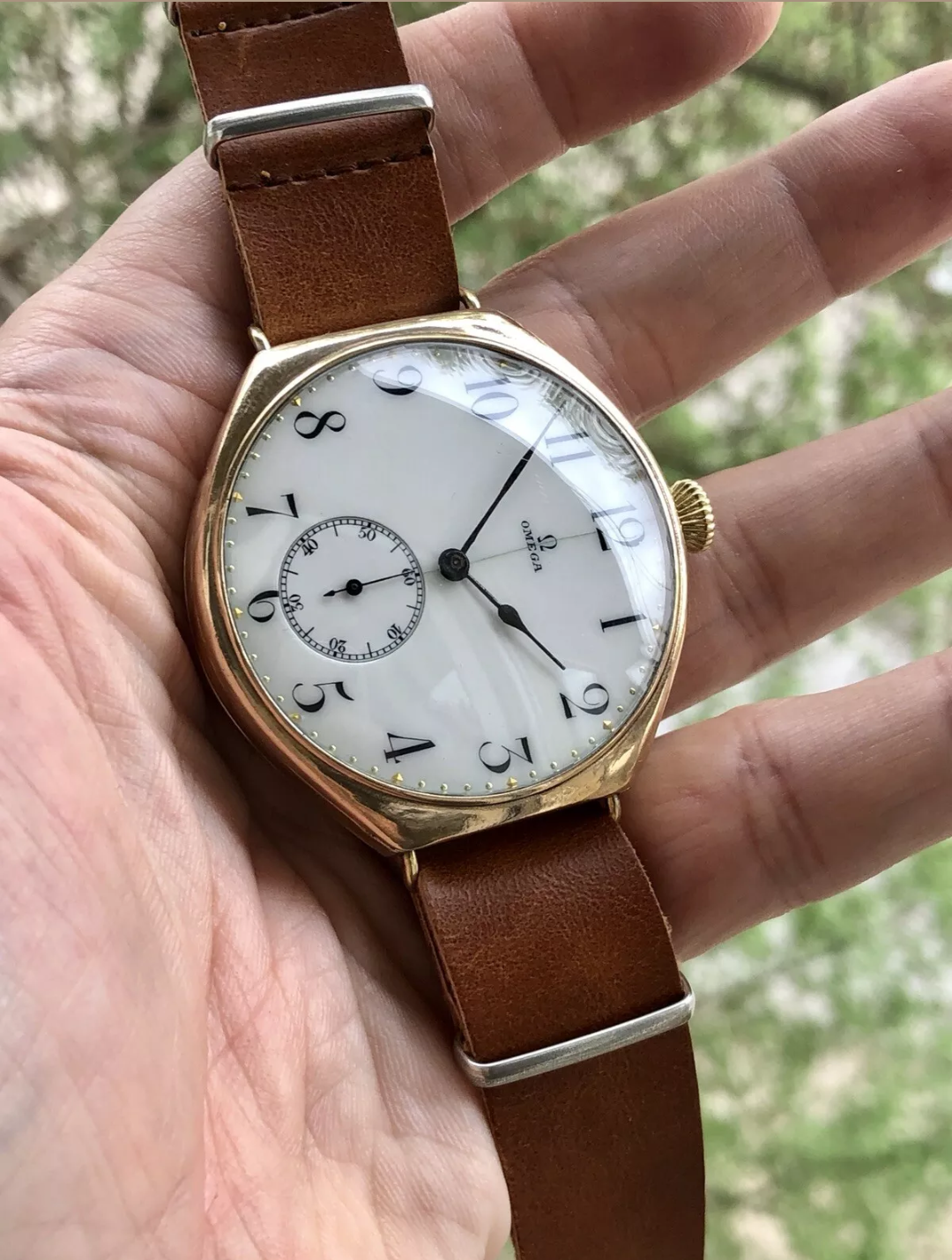

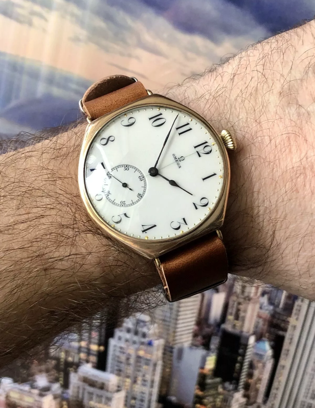

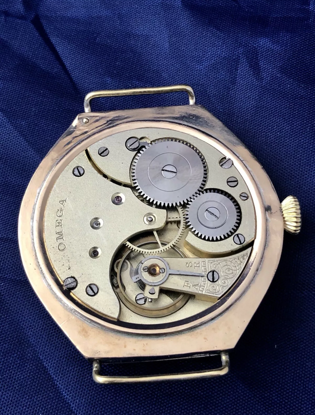

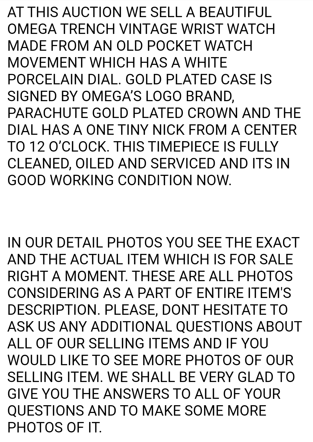

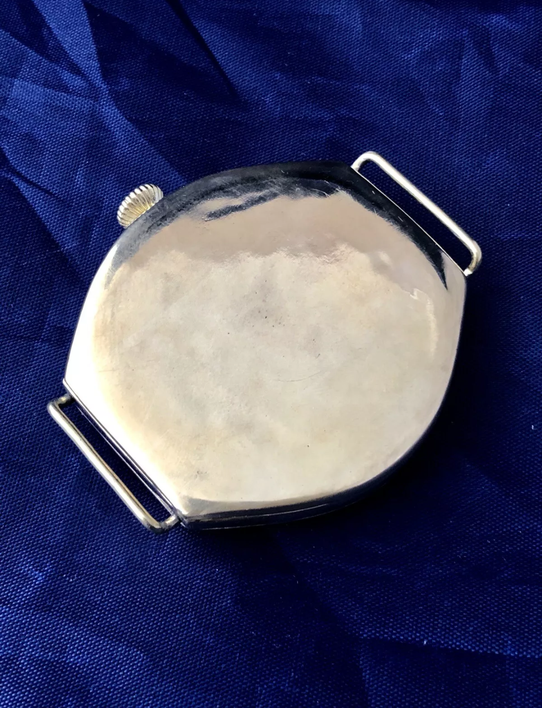

Im new to vintage watch collection, but i found this watch that i like....so i want to ask the community for help in identifying an Omega trench watch of it authenticity..attached are the pictures of the watch and the description left by the seller....year of the watch not been mentioned.

That’s a pre ww1 serial... and the case stamp looks correct.
This is outside my wheelhouse. But I’d not count it as a fake just yet.
There are some people that know these very early pieces on here.
18,730
38,879
Dial and hands look to be genuine, serial will be on the plate (under the dial).
Possibly a caliber 17''' L (Lépine movement) from somewhere near 1900 re-cased to a wrist watch maybe in the 1920s going by the case style.
Need to know actual movement diameter in millimetres to be sure though.
572
1,459

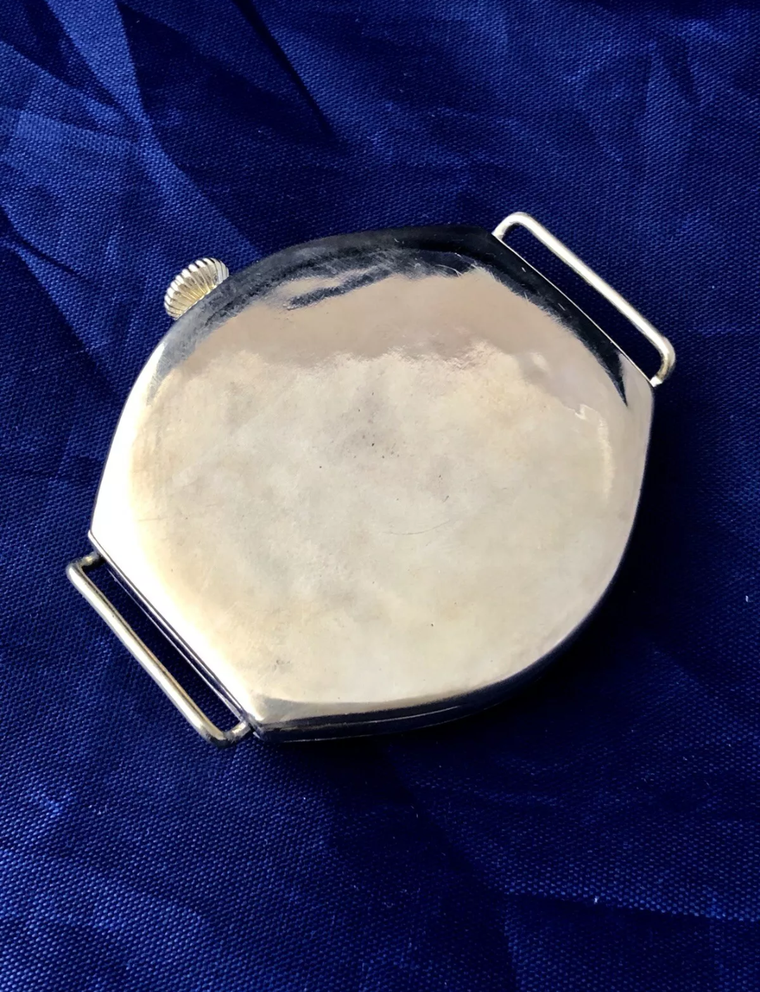

The movement will no doubt be genuine - and the movement number will be under the dial (as already described). HOWEVER... there were NO 2 million Omega case numbers! So the case is a fabrication, the Omega symbol (also wrong for the period) is a fake. Is that enough?
18,730
38,879
Do you think the case is more recent than about 1920 and made to look like it is "vintage"?
18,730
38,879
Or was it re-cased, possibly in France by somebody with an Ω stamp and they've used the movement serial, which would make the movement from somewhere near 1900.
I guess we'll never know anyway.
13,904
54,078
Recased pocket watch as the seller states. No collector value but if its cheap and you like it, that’s another matter.
